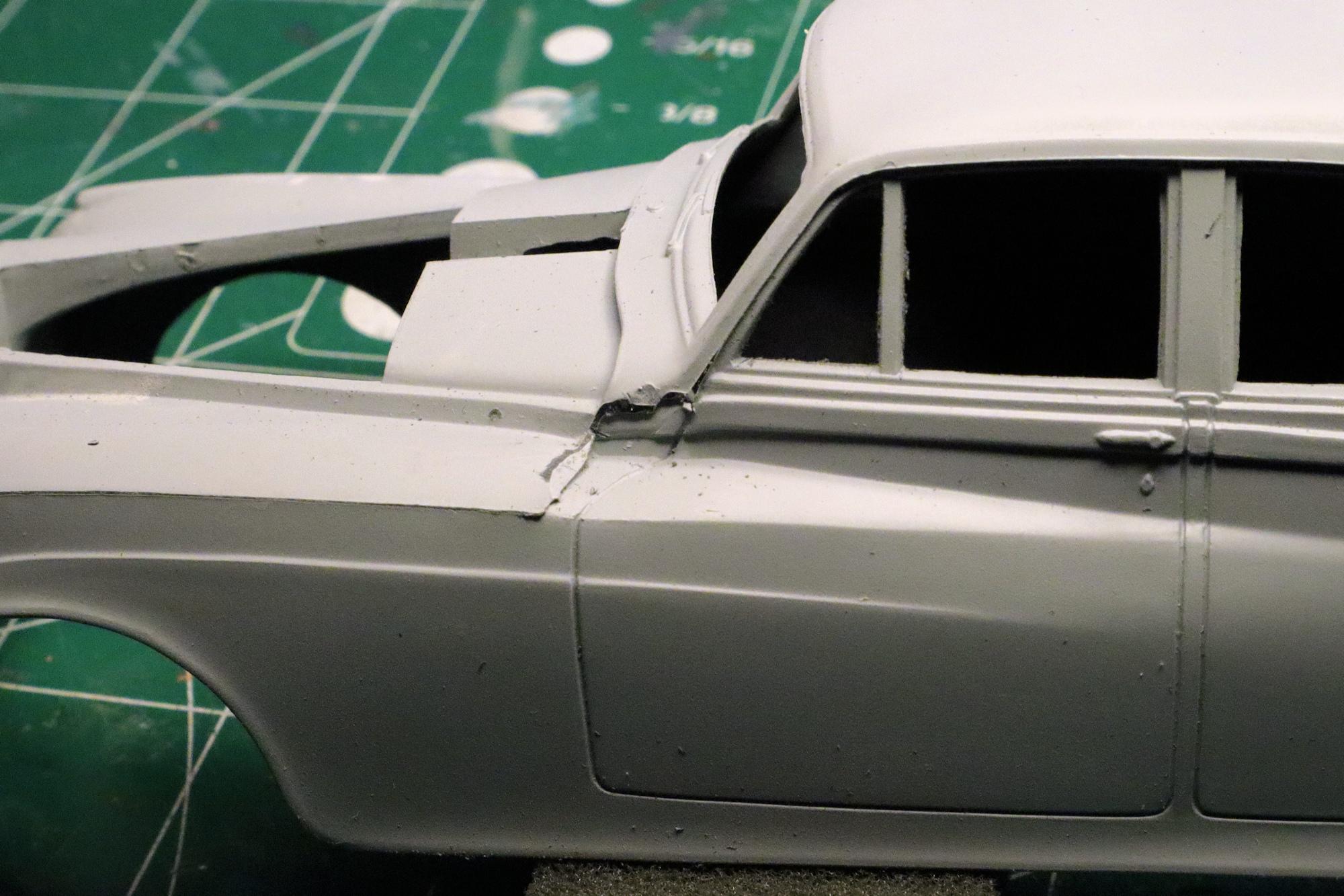

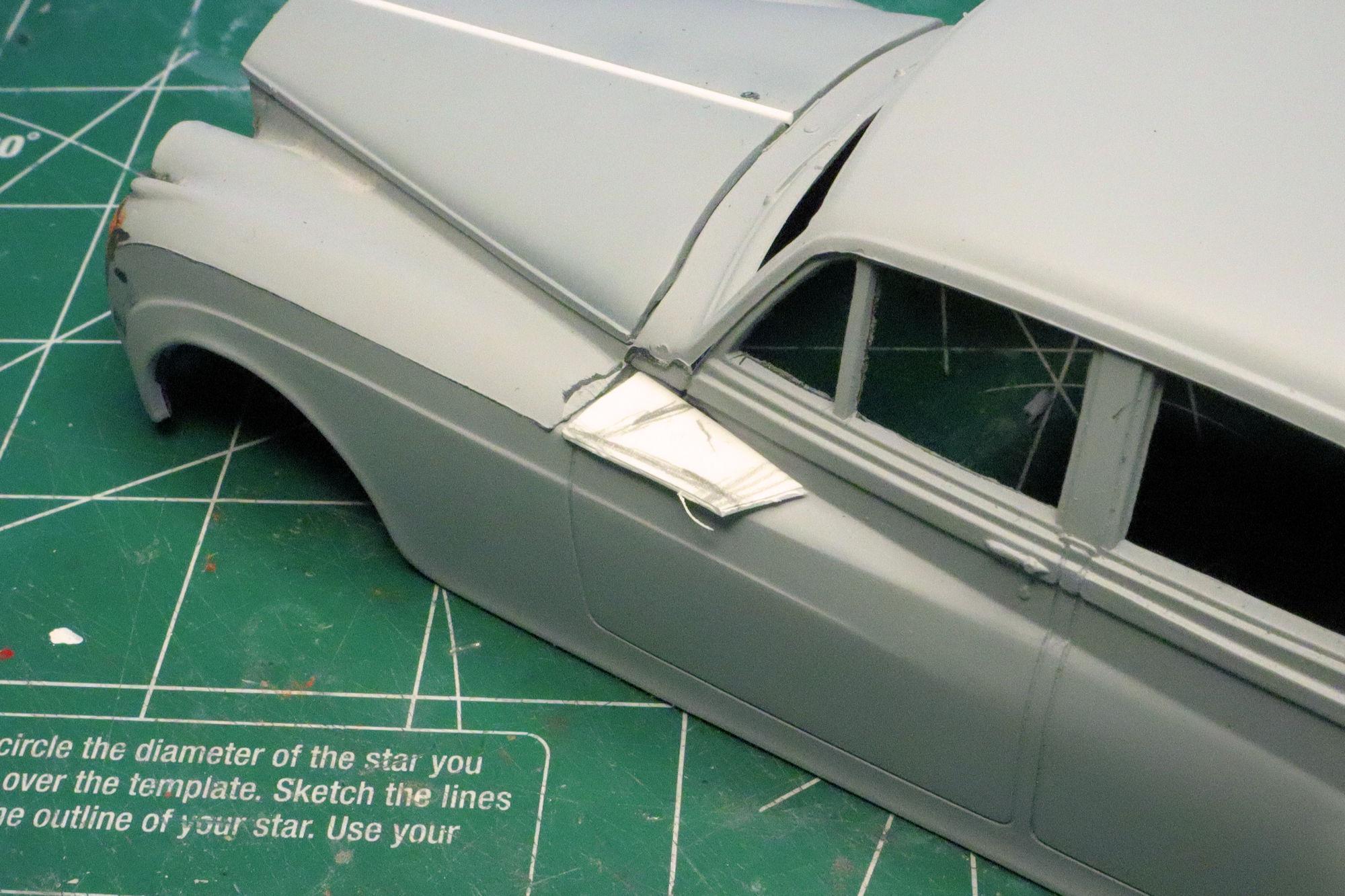

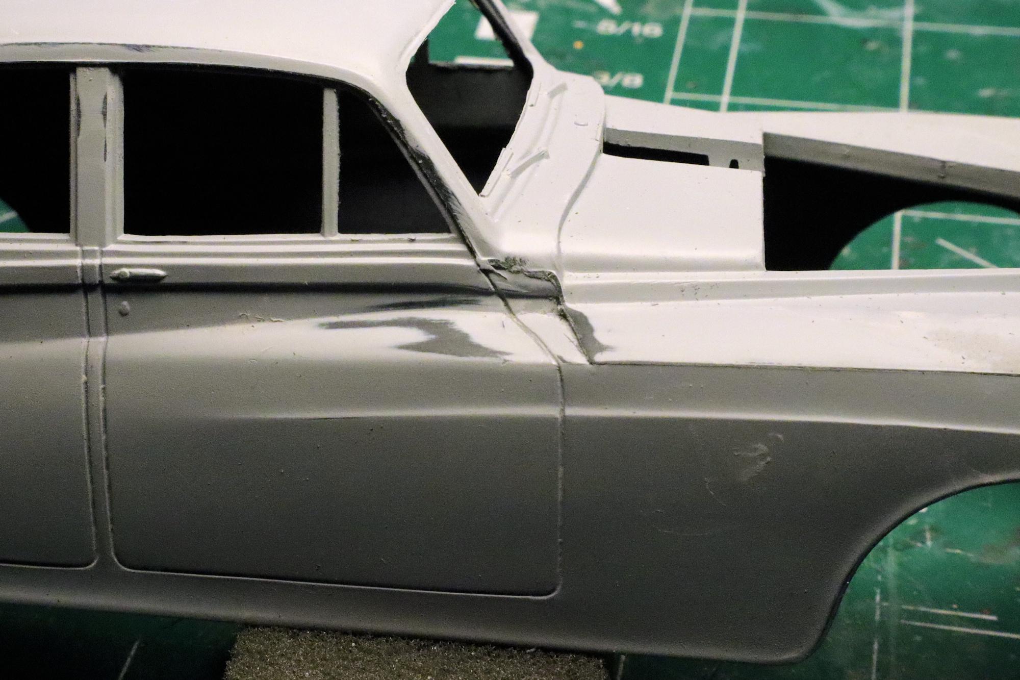

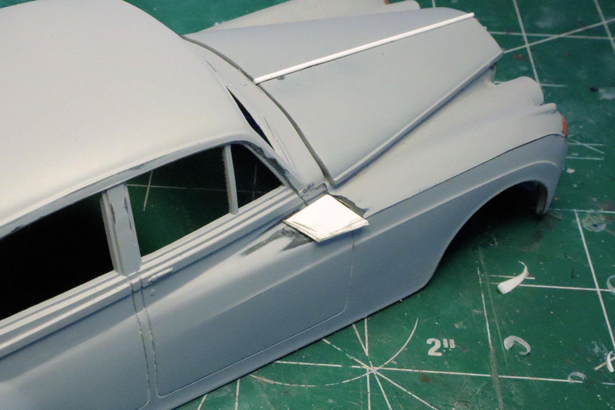

Hello Everybody! Here is another update on the Rolls-Royce Silver Cloud II. I'm calling this side done. I've sprayed this different primer because I want something darker under the gold to give it some depth. This side however is still giving me problems. There is a void under the styrene sheet I used to build up the area and the glazing putty just has not been doing the job of filling it. I'd use some putty to fill the gap, only for the gap to reappear during the next round of sanding. I suspected that this might happen but I had to try anyway. I decided that it was time to break out the CA and fill that gap for good. I would drip a drop on the gap, give capillary action a few seconds to work its magic, swipe off any excess with a cotton swab, then repeat the process until the gap had wicked in all the CA it could hold. I then dripped a final small drop on the gap and used some accelerant to cure it all. The bit of fuzz is from one of the passes with the cotton swab. It should sand off quite easily. A quick spritz of primer shows where the sanding and back-filling need to be done. It looks like I took care of that gap though. As always, thanks for stopping by to look and please feel free to post a comment or two. David G. -
