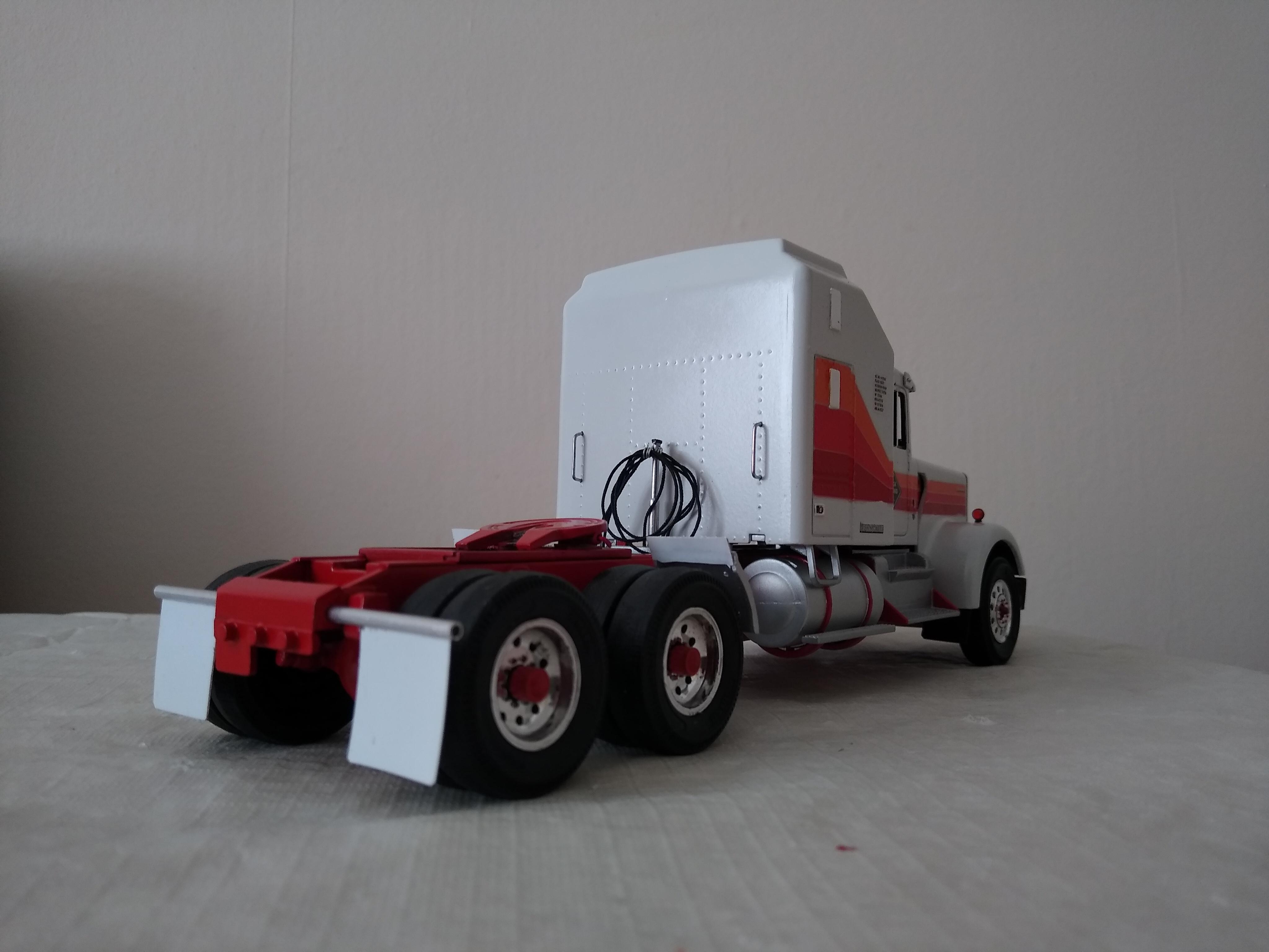

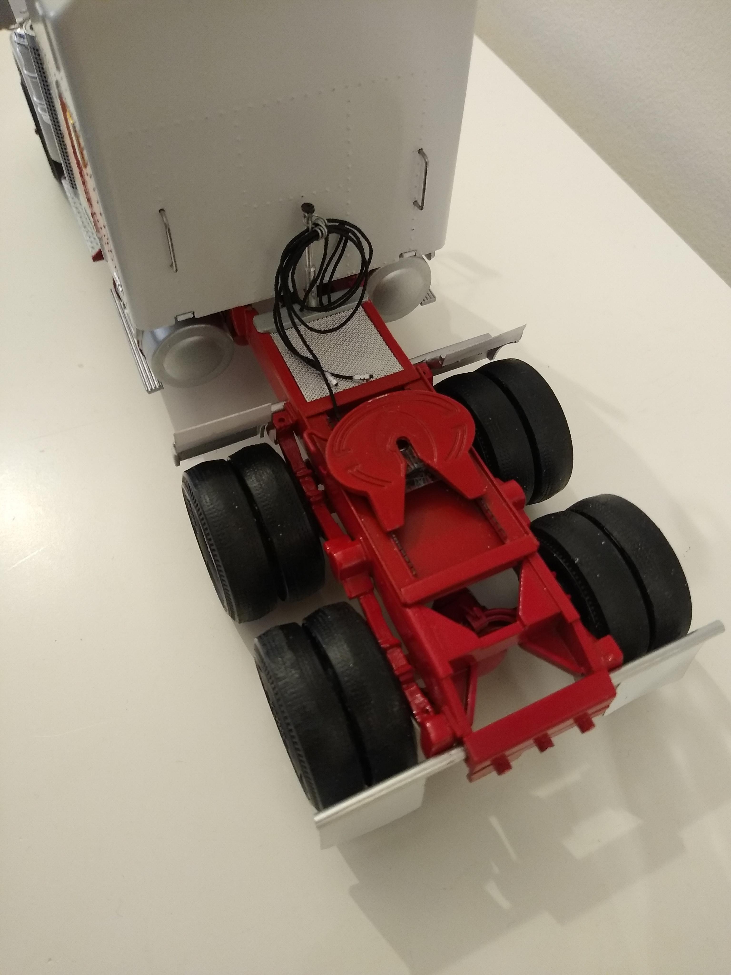

Piped up my tandems, did my usual alterations to the landing gear to make it functional and just had to mock it up. I know it's a minor change to the rear suspension but to me it makes such a difference. I'm very pleased with it. Still a lot of work to do tidying up and making things fit but I think I've caught the look. -

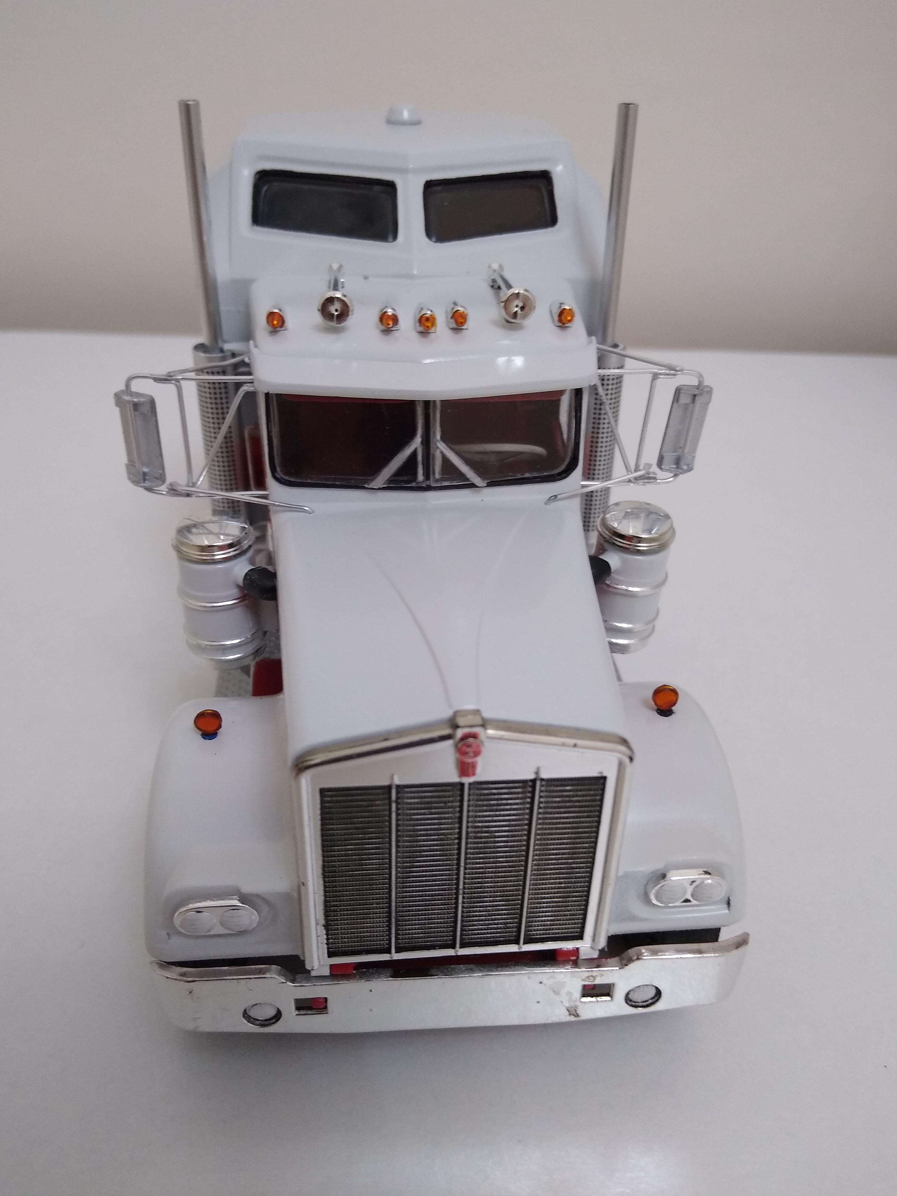

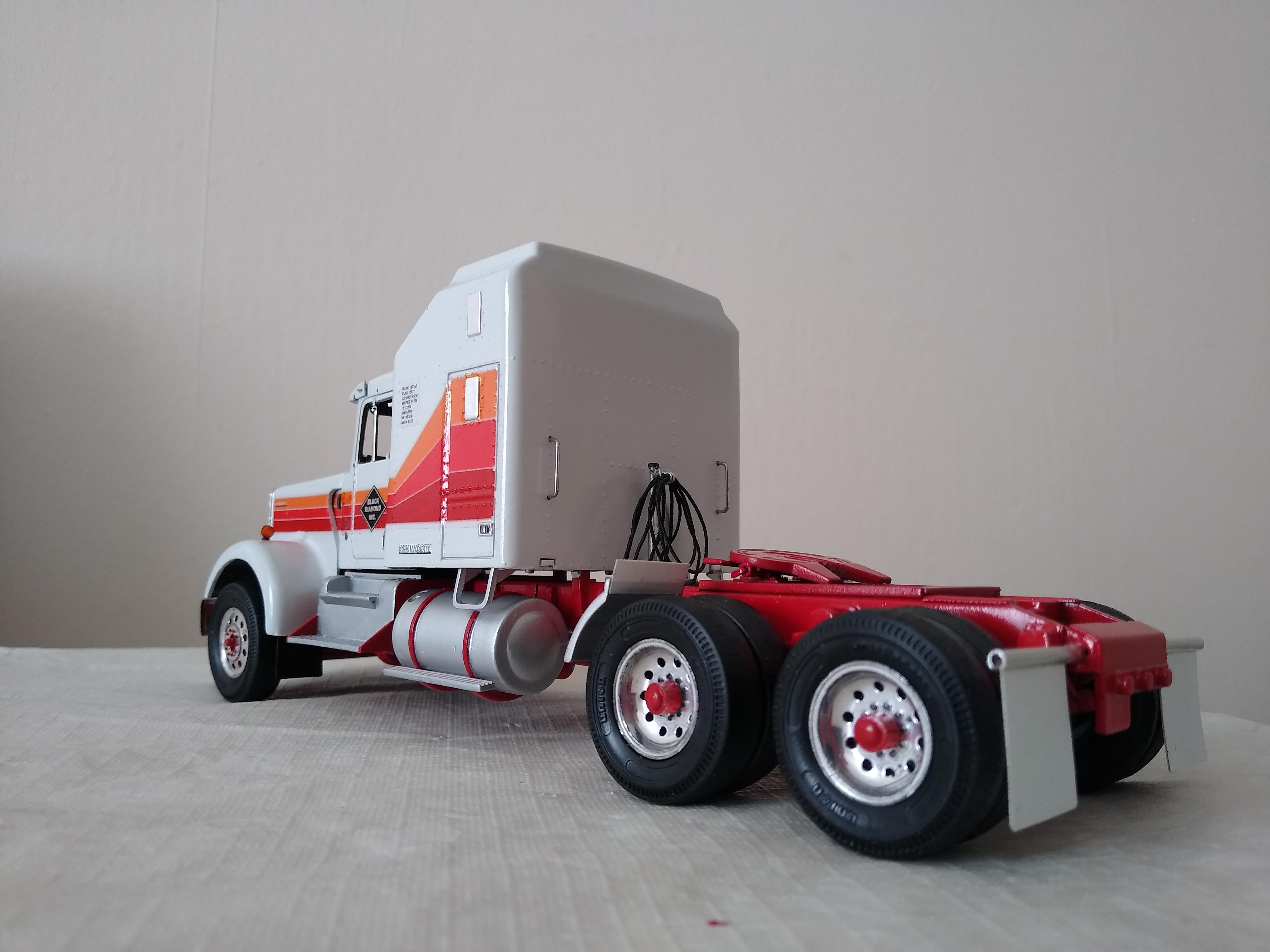

Here is the truck mated to my Trailmobile dry van. Looks right to me. I want to do an aluminium Fruehauf dry van as you mostly saw it with in the series. Typical that I've got six van trailers and none of them are right for it. Bought my paint. I had to settle for Rover British Racing Green metallic as there just aren't the stockists of automotive spray bombs anymore. Still cost me £22 for primer and topcoat!!!!!! I'm wondering about getting a gold to do a base coat under the green to maybe lighten the shade, knock the blue out a bit. Not sure if it would work though. -

Thanks very much. They do, with the "crooked KW" stamped out of the rear crossmember. The fact that it's the "crooked" emblem dates it to late sixties early seventies (I'm sure someone knows what year it changed). Your build looks great though, I don't think any of us could do a perfect Sundance, there were so many of them used by the studio and they didn't care about accuracy so we just do our best, and yours is excellent. -

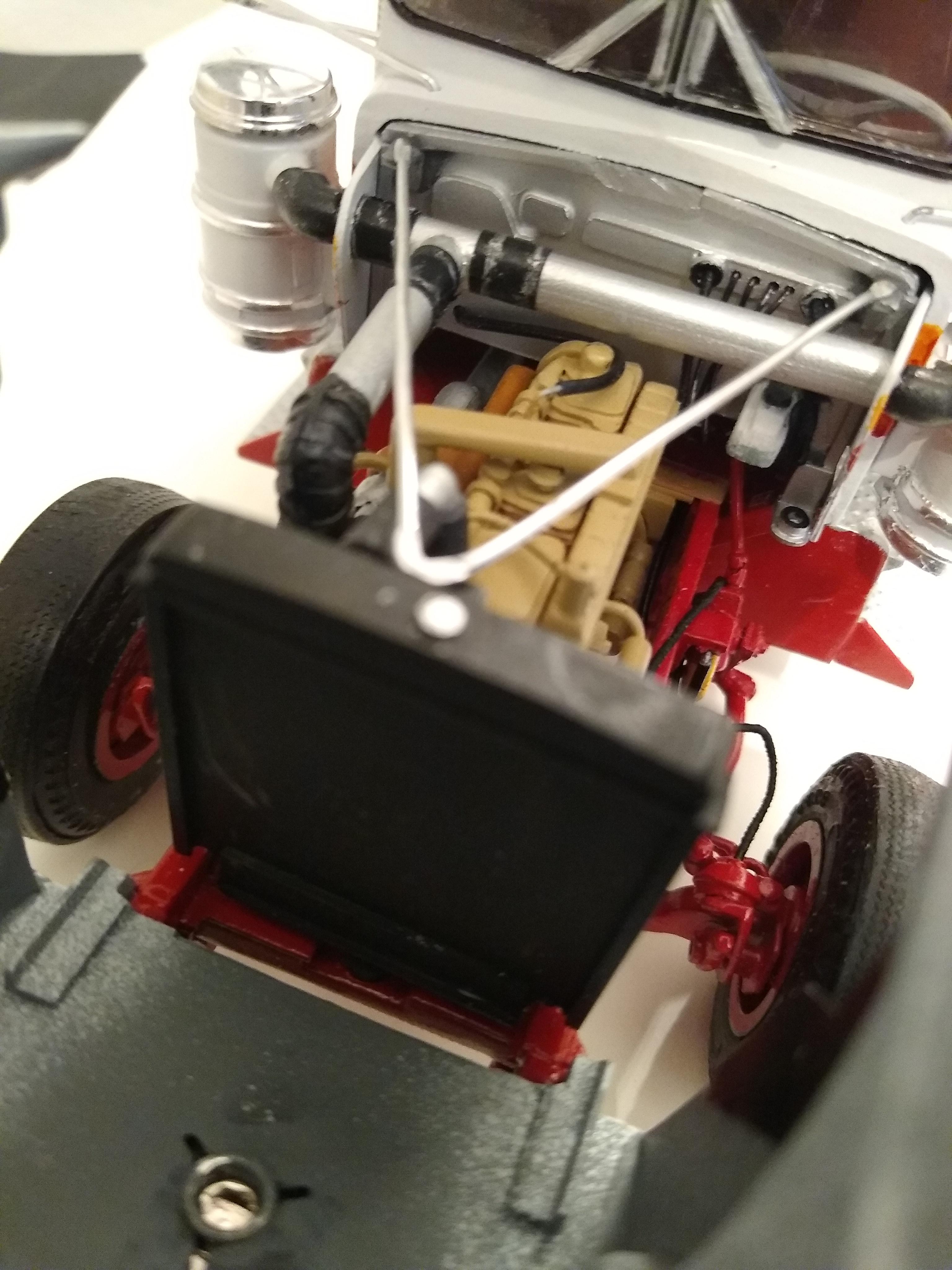

Got my air filters mounted and made mirror arms from 0.8mm ali wire. I've got to make the braces to the cab roof and scuttle panel but they can be done after paint. I used the T600 kit arms as a pattern and then cut the mirror heads off and transferred them across. Look better than the kit stuff if a little rough. -
