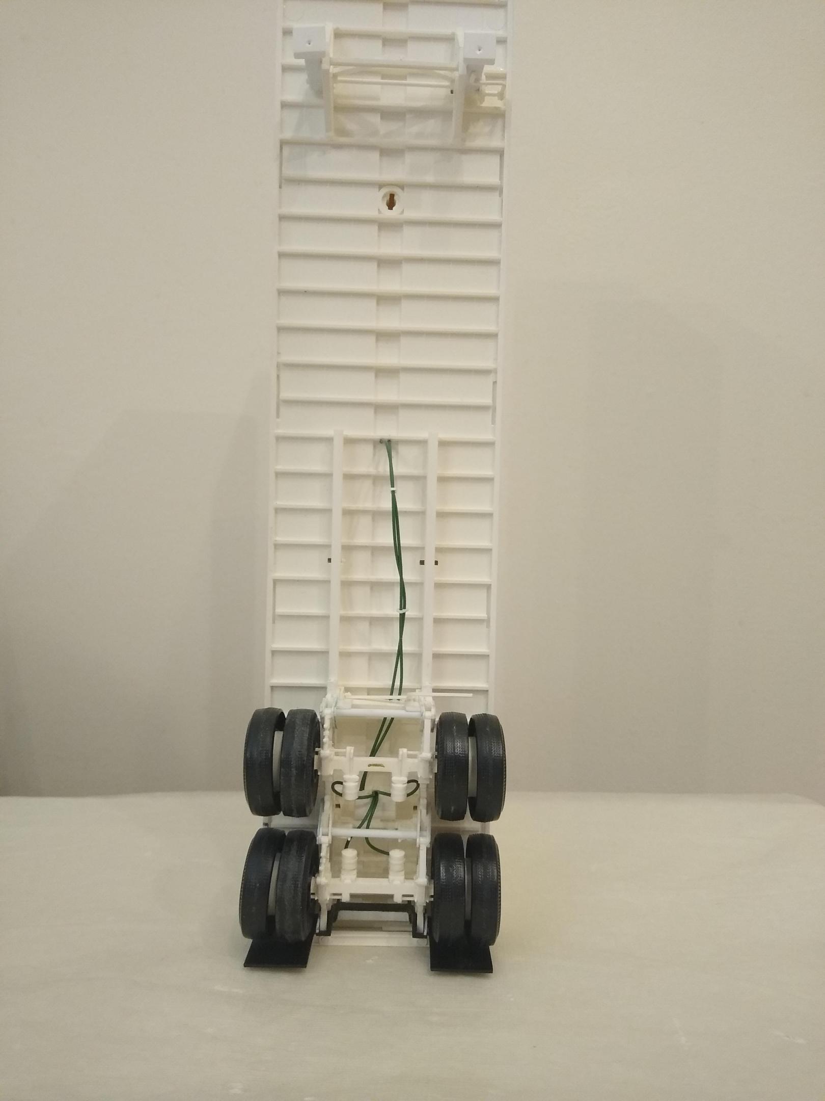

Rockford replied to Rockford's topic in WIP: Model Trucks: Big Rigs and Heavy Equipment
I still have considerable work to do on the tractor but I'm itching to start work on the trailer, particularly the suspension. The 1/32 Monogram Fruehauf vans come with the F2 spring suspension that has the wide side brackets. There was another version Fruehauf did, I think it was 'F2 Lightweight' because it had smaller brackets and crossmembers (I've worked extensively on both but never found out why the difference). This is the version Pruitt's truck used. After extensive Googling I established that the kit pieces could be modified to suit, which made things much easier. I took the original pieces and as well as doing my lowering procedure (documented in other builds) I reduced the size of the side brackets and crossmembers. I held everything in line with drill bits while I bored the holes through each set of brackets for the new tubular cross members. Added some 0.75mm strip around the edges to replicate the rolled lip. Results look really good I think. -
