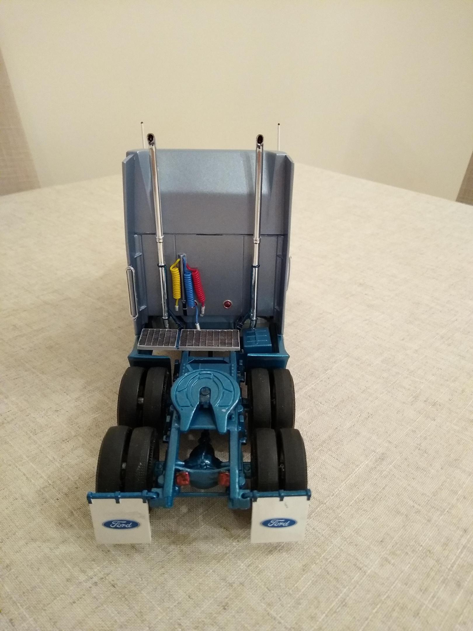

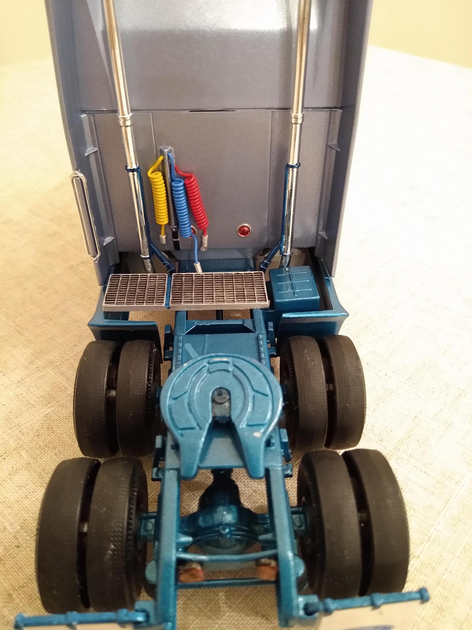

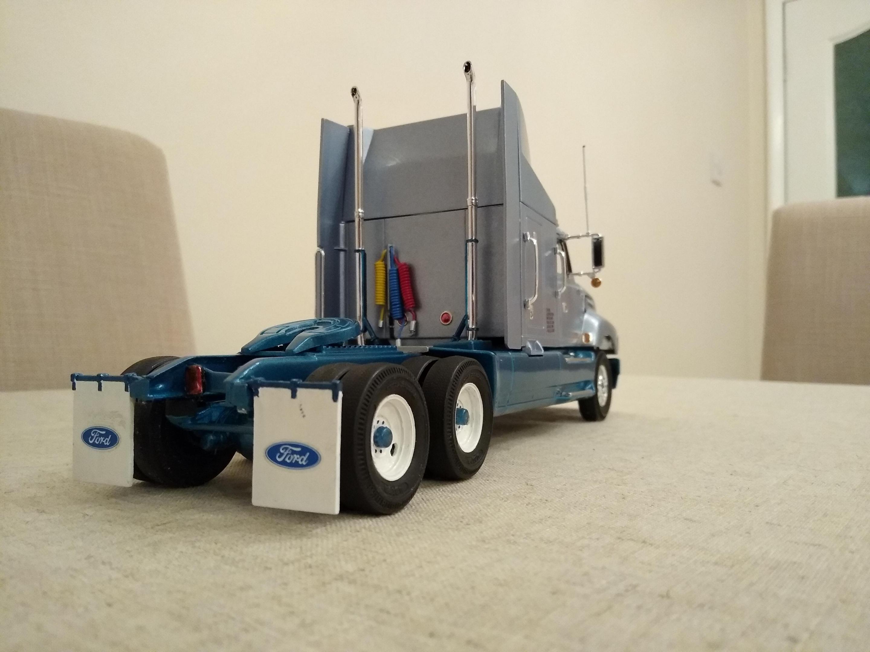

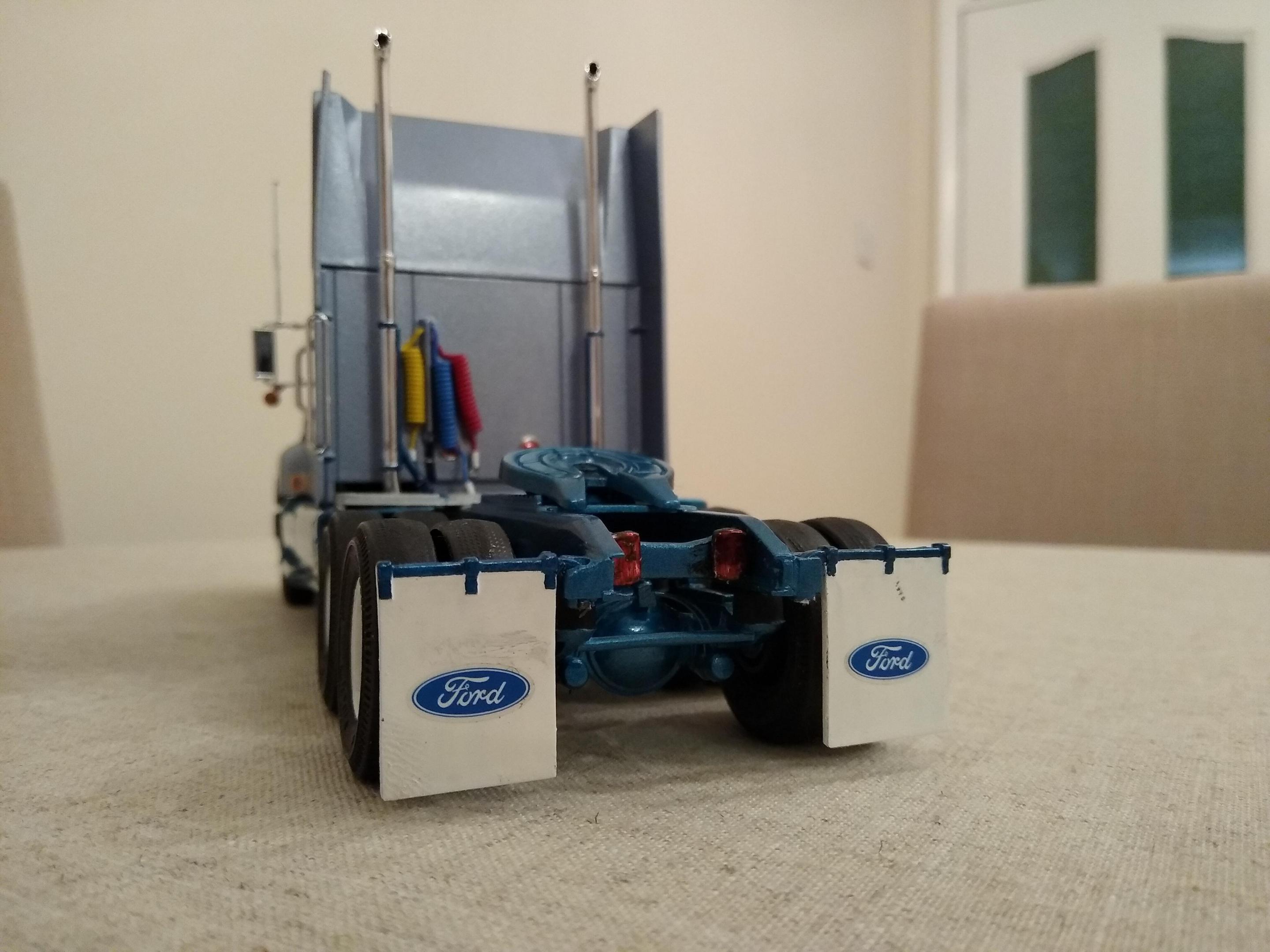

i added airlines to the rear of the cab too, Euro Suzie type rather than the straight hoses still in use in USA. Sadly, this is my last Monogram 1/32 Snap kit tractor but I have two trailers still to build.

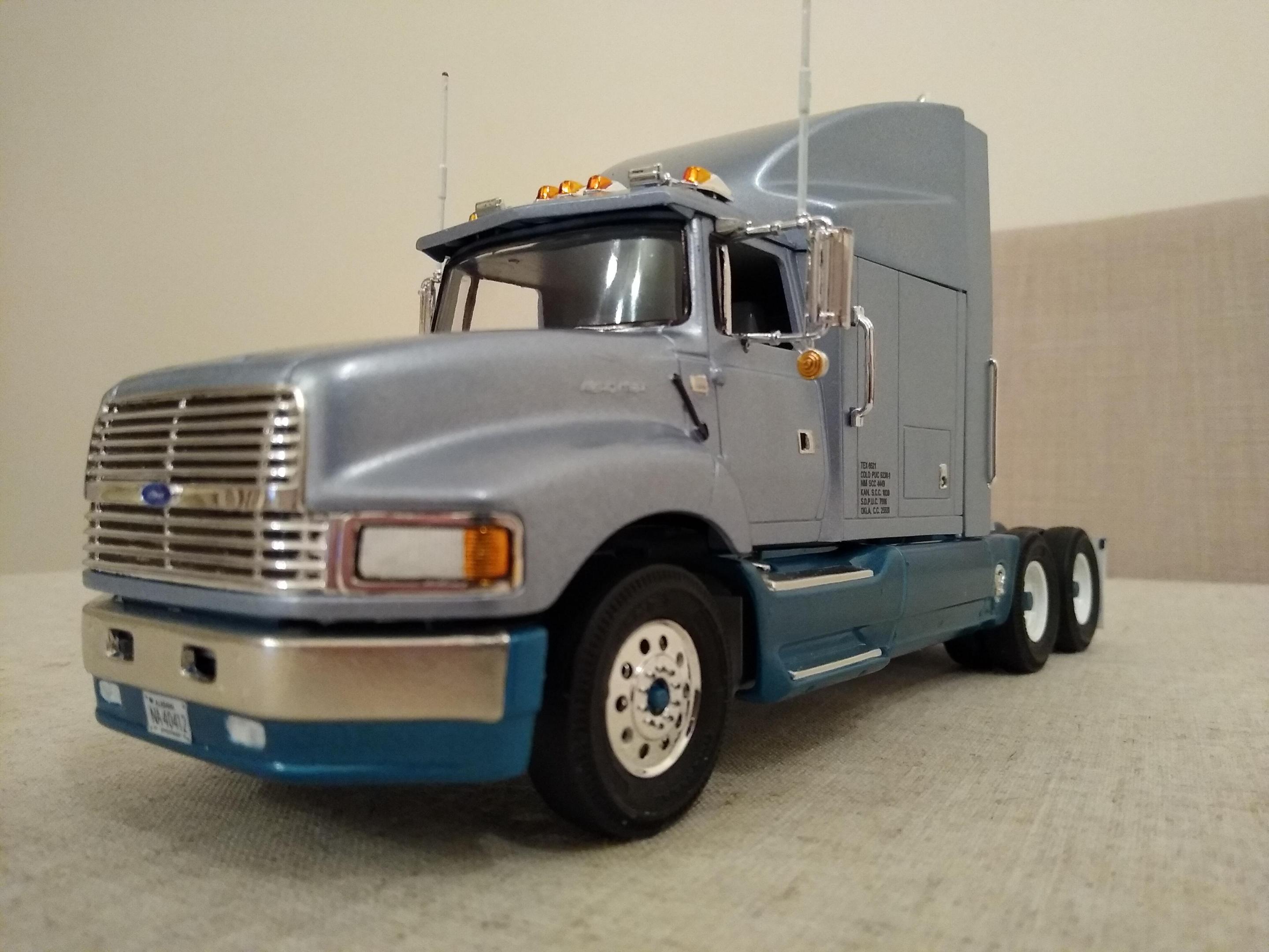

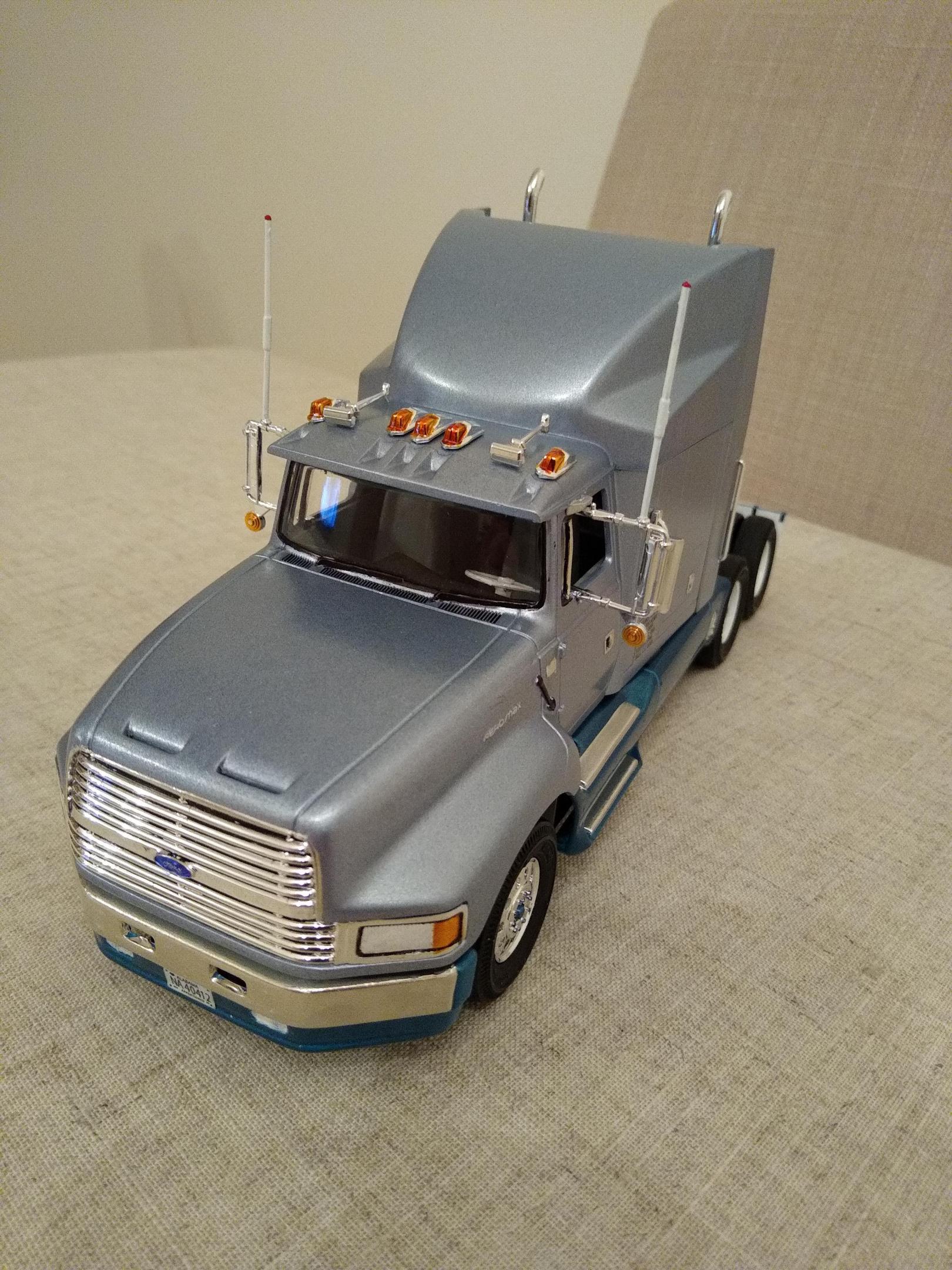

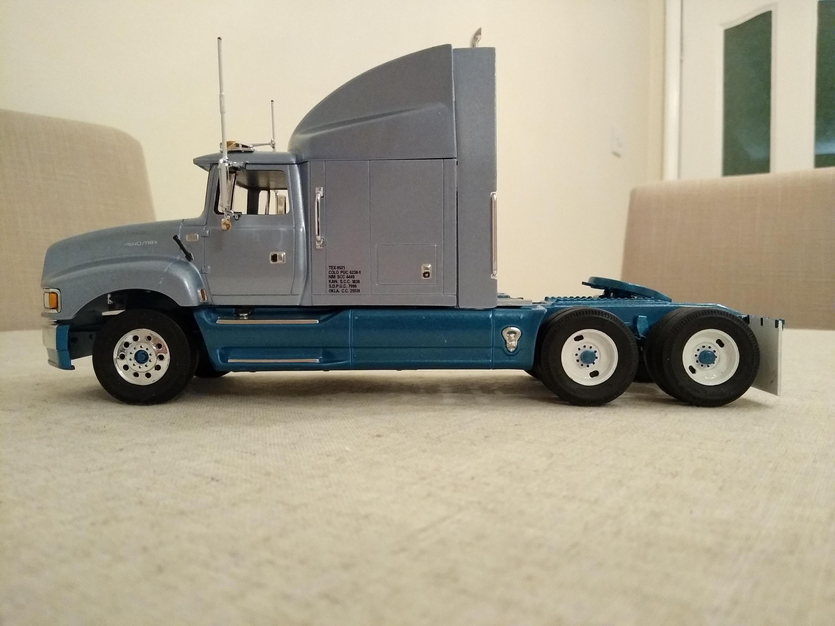

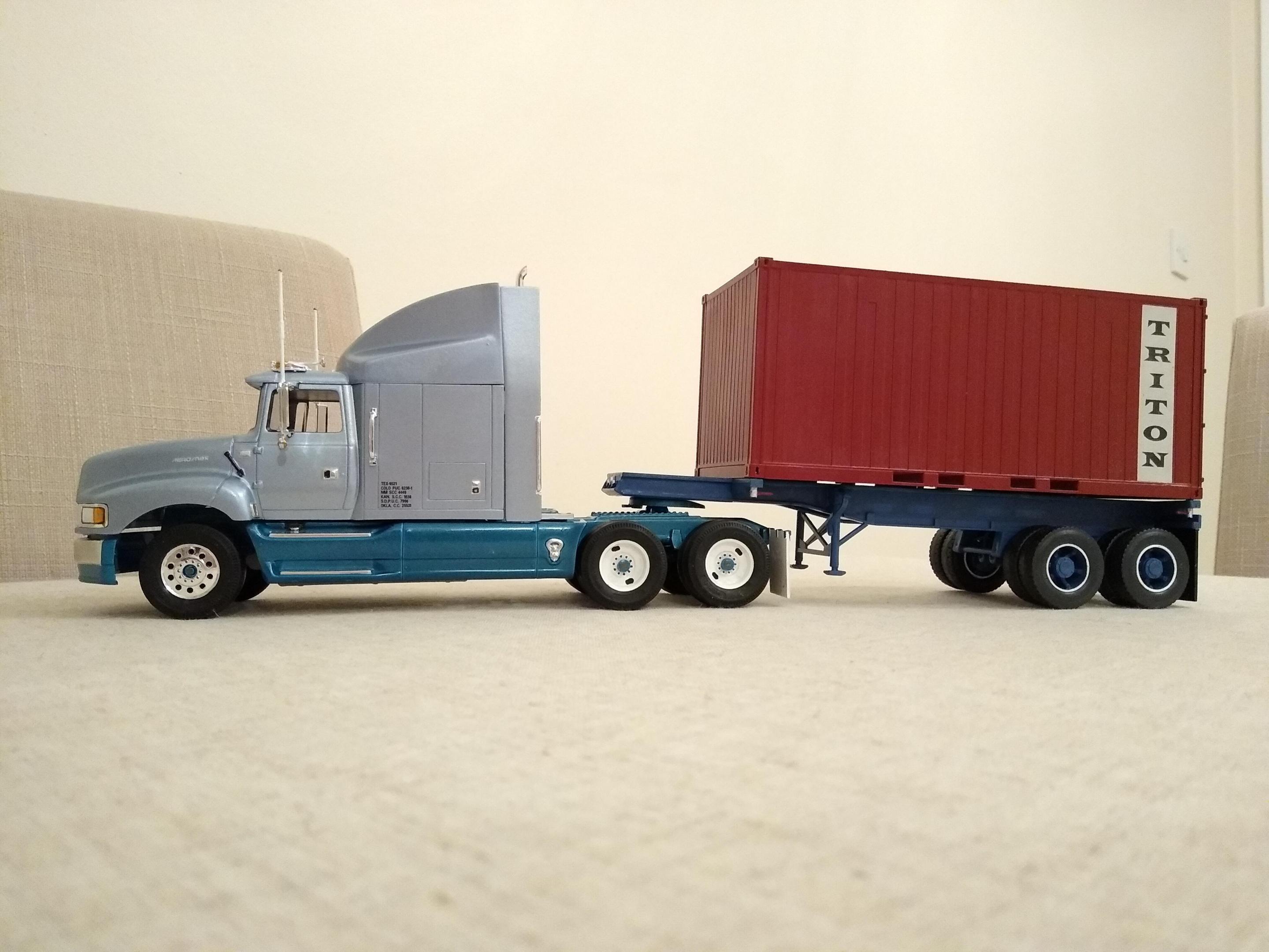

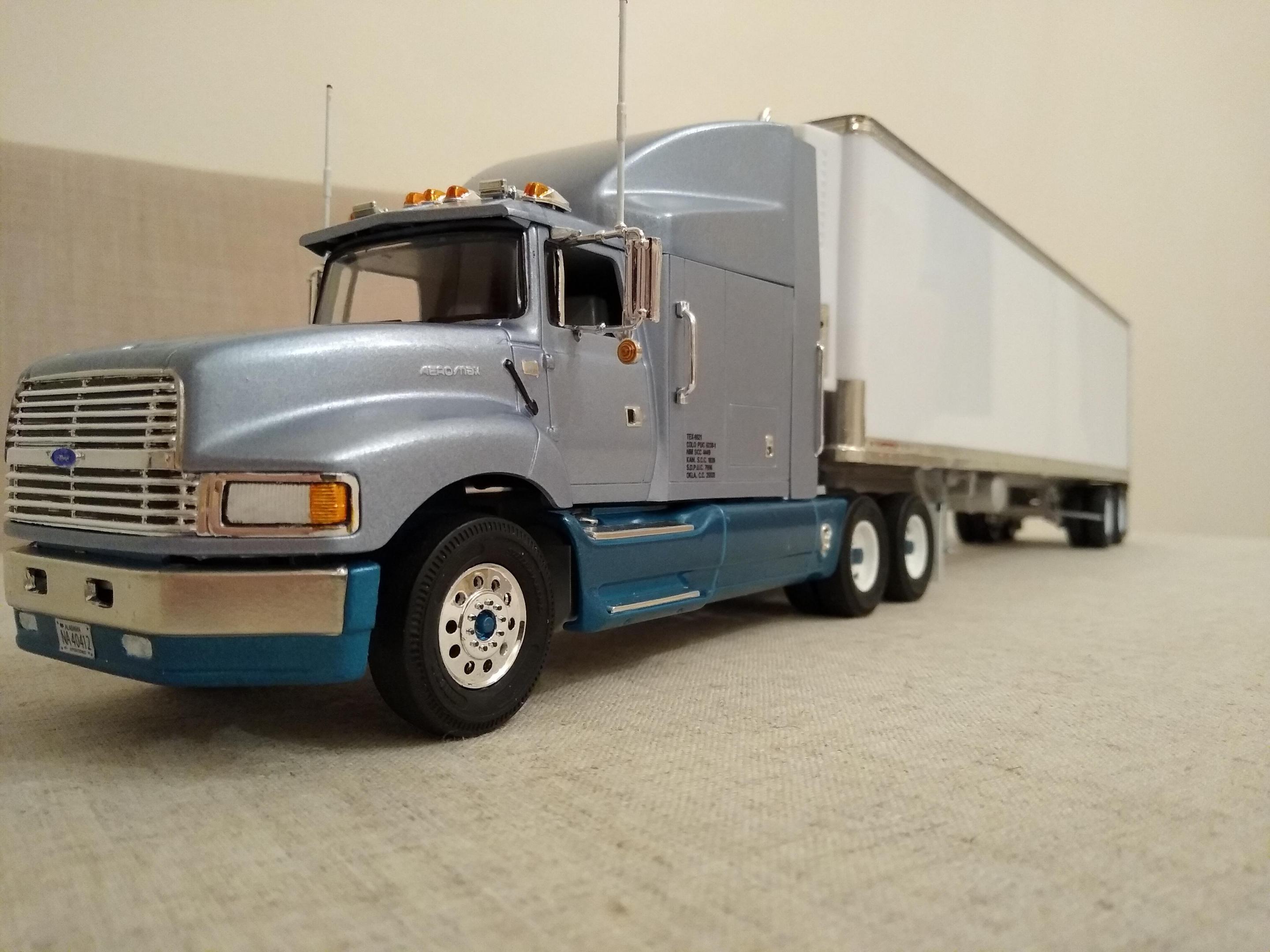

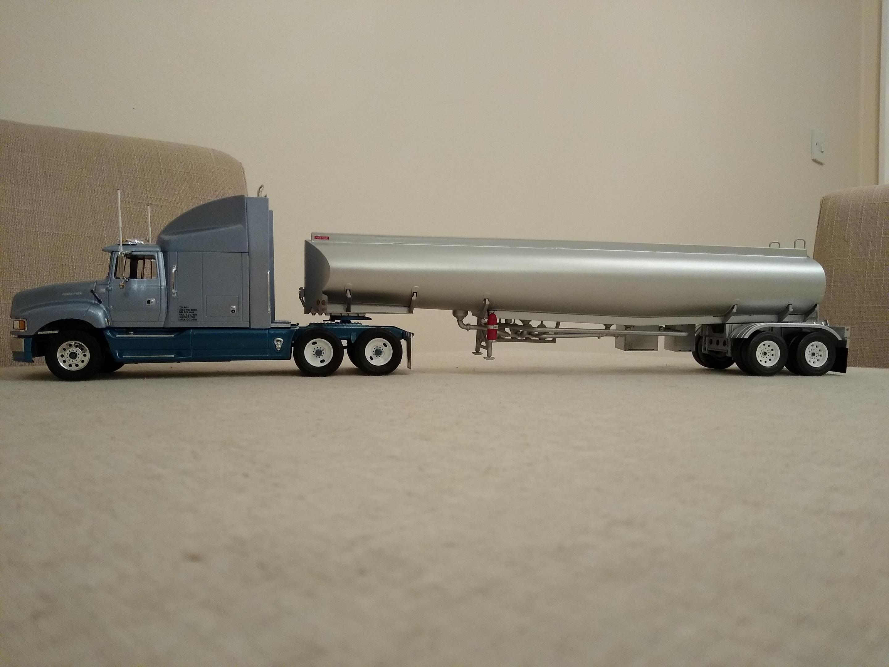

Can't say this is one of my favourite subjects. It's the beginning of the end of the trucks I fell in love with all those years ago. The chrome and steel of the old trucks is hidden behind the sterile aero kit and it does have exhaust stacks but they're relegated to behind the cab. Peterbilt 359 or KW 925, even LTL9000 it's not! However, it turned out ok. I added brake chambers, top and bottom flanges on the chassis, brake lines, converted the 10 hole alloys to 2 hole Budds on the rear, filled the empty rear axles and fabricated hubs on the rear axles. Tried adding white stripes but the decals turned to jelly when I used setting solution. Looks good with a van trailer but you see how all the aero kit comes to nothing in front of a tank or container trailer.

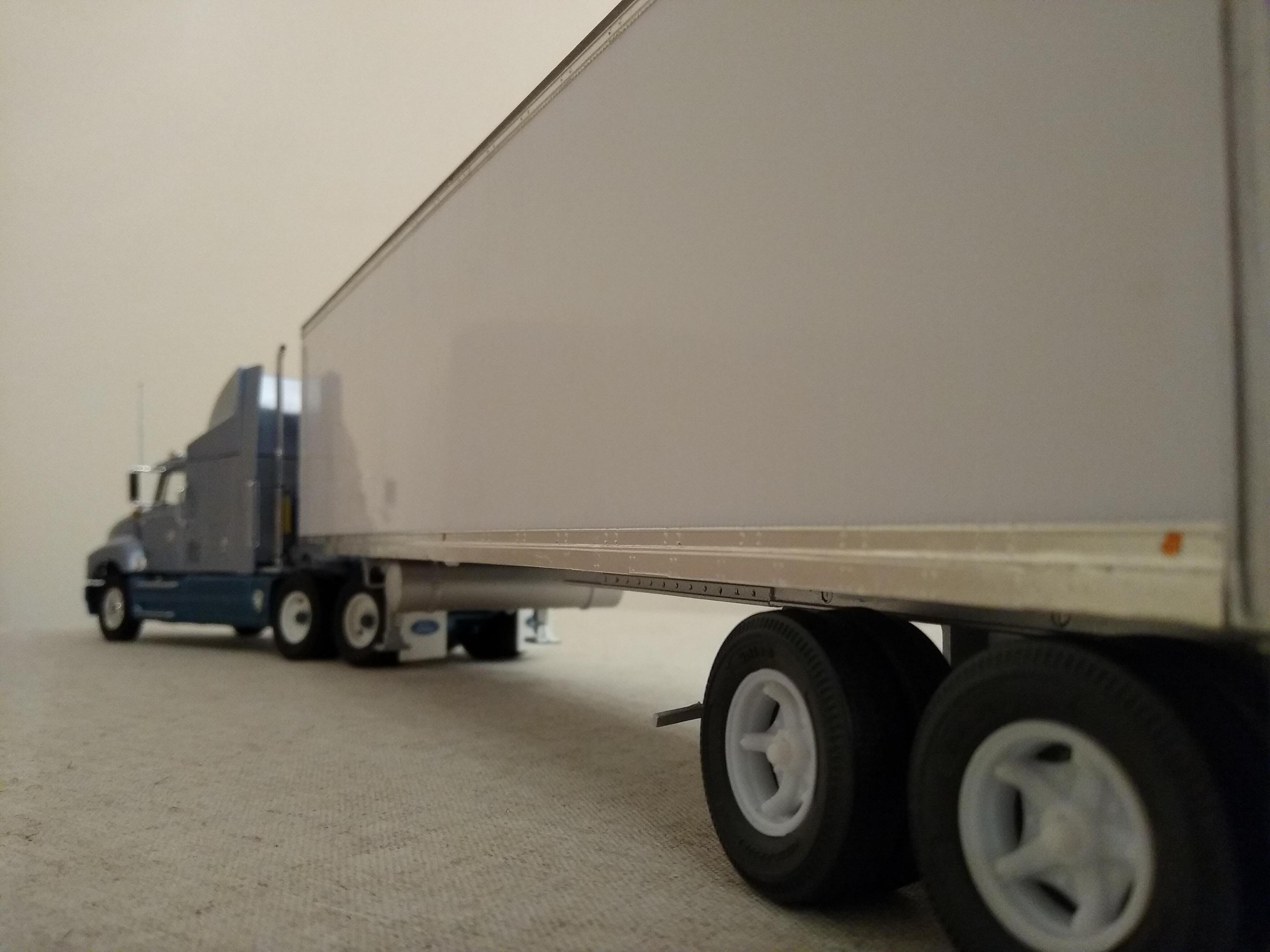

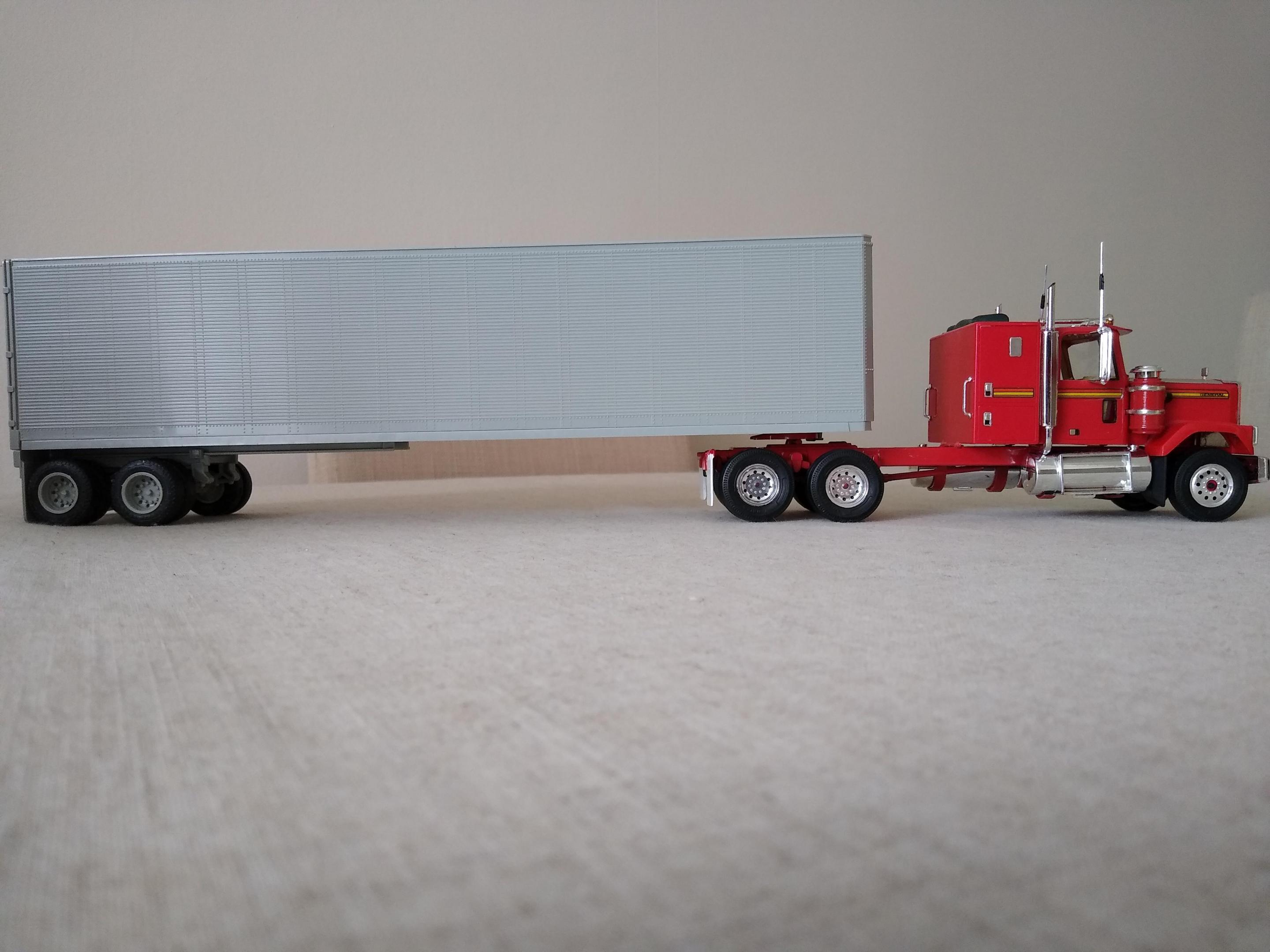

Having quite a Snaptite fleet now, I needed some trailers to go with them. Got the AMT Trailmobile van and the Monogram van for decent prices on eBay and was desperate to get them done. I love plain white or silver boxes. I've got one white already, the fridge van, so I might do the Fruehauf white and the Trailmobile silver. Both kits are a mixed bag but the Monogram Fruehauf is decidedly better engineered than the AMT. A drawback that they both have is ride height. Because they both have the sliding duals setup the rails stack up to make them sit too high. I've cured it before by just fixing the duals and deleting the slide rails but I was wondering if I could retain the slide feature and still lower the ride to a more realistic level. The rails sit on top of the ribs across the floor of the van. I eventually decided on channeling the ribs and dropping the slide rails into them up to the van floor. This allowed the slide rails to sit further in. Though the difference is marginal, the visual effect is far from it. Both trailers now look great sitting behind my GMC. On the Fruehauf I also used the two hole Budds I made for my Aeromax, they look fantastic, I wish they were easier to do because I'd make a few more!!
