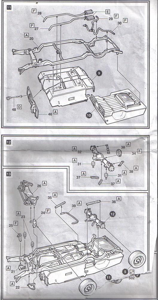

  17. Judging from the instructions for that kit, raising it should be easy. At the rear, shim the springs, parts 31. You'll probably have to fiddle the shocks, parts 38, to accommodate this. The easiest way is to cut the skinny end off, lengthen to fit the mounting holes (with a small styrene shim the same thickness as the spring shims), cement back together. At the front, the object, if you want to raise the model, is to lower the stub-axles on the spindles, parts 24, relative to the rest of the car. Sometimes, if spindles of this type aren't symmetrical, you can simply swap them side-to-side. Other times, it's necessary to cut the stub-axles from the spindles and move them relative to the vehicle (with the vehicle being right-side-up, naturally). To get the strongest result, drill the spindles to receive short lengths of styrene rod the same diameter as the original stub-axles, glue in place with liquid cement, and allow to dry thoroughly. MEASURING before and during the procedure is critical to get good results, and to get all 4 wheels on the ground.
