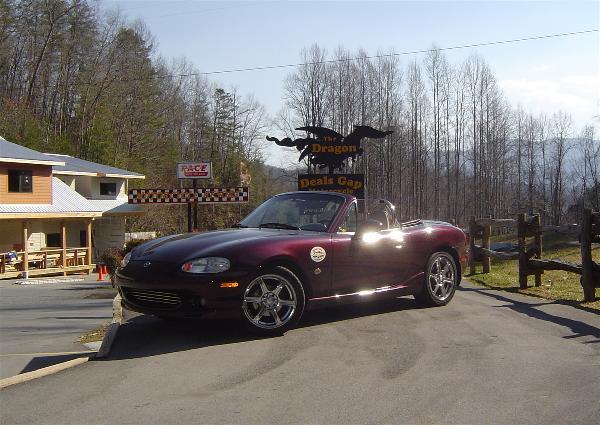

  6. 2000 Mazda Miata Special Edition (2318 of 3000).
