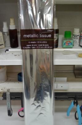

I just scored a pack of "Metallic Tissue" from Party City locally. As you can see by the pic, it's pretty shiny and you get twelve 20" x 24" sheets for $4.99 plus tax. I'm concerned about running out. :lol:
I measured the thickness and it's about 0.5 mils thick, as well as I can measure it. BMF measures about twice that thick. Also have a small bottle of Metal Leaf Adhesive I got from HL. We'll see how it works.
