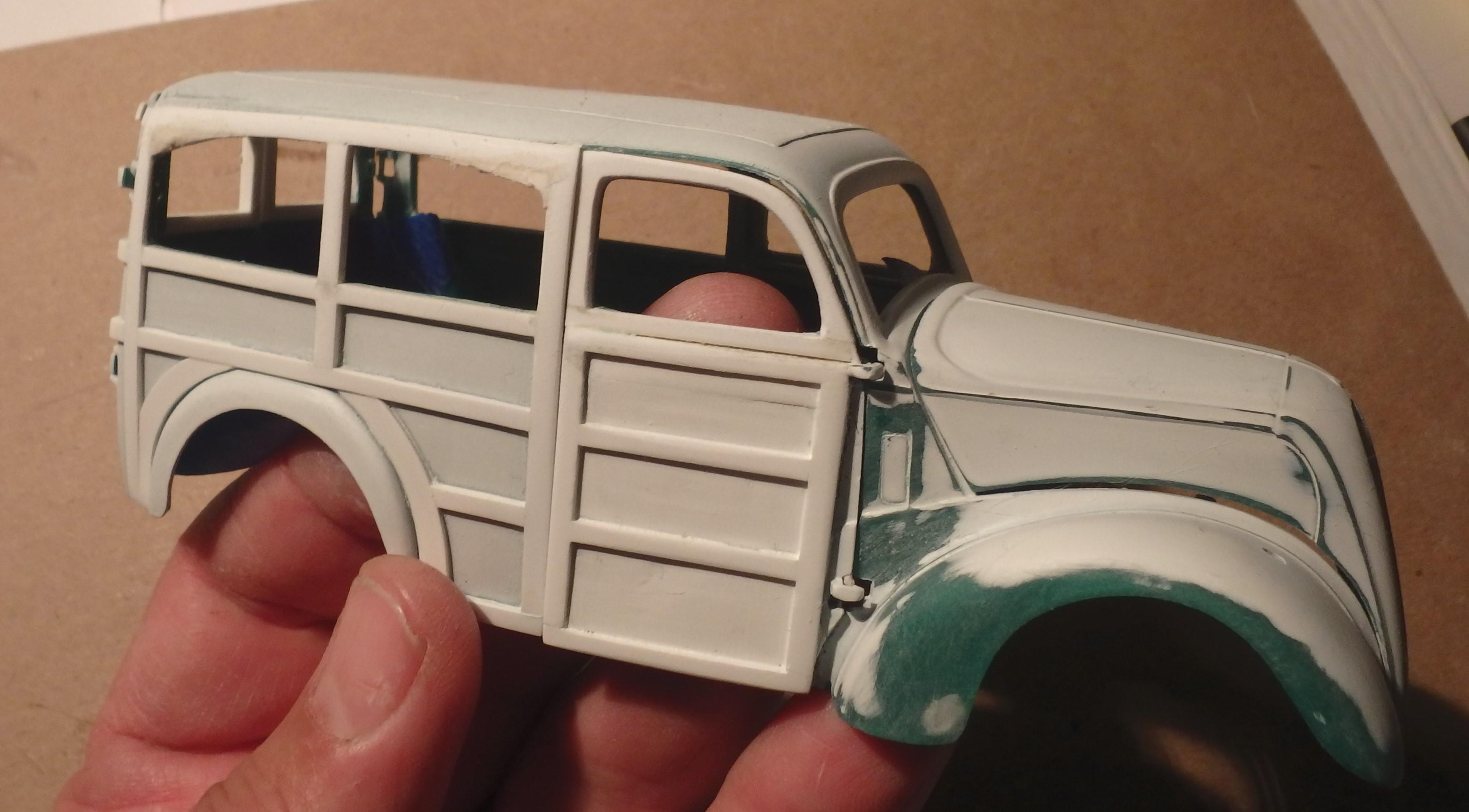

SpeedShift Posted November 23, 2020 Posted November 23, 2020 (edited) So, I won a Heller Citroen truck kit on Ebay (seller in USA) when gets here I'll post the engine side by side with teh 4 banger...then decide. In the meantime, I'll need to keep working on back dating the body shell to a stock Thames panel. I have PE grilles on the way from Model Car Garage, both the front and R and L side grilles in the hood. The photo Joe/Southpier sourced, as well as one I found in Gasser Wars magazine, indicates I need to add wood crossmembers across the top of both the driver and passenger doors, and trim/angle the wood cross members along the bottom of the roof rain gutter, to more accurately represent a stock Thames woody. Edited November 24, 2020 by SpeedShift

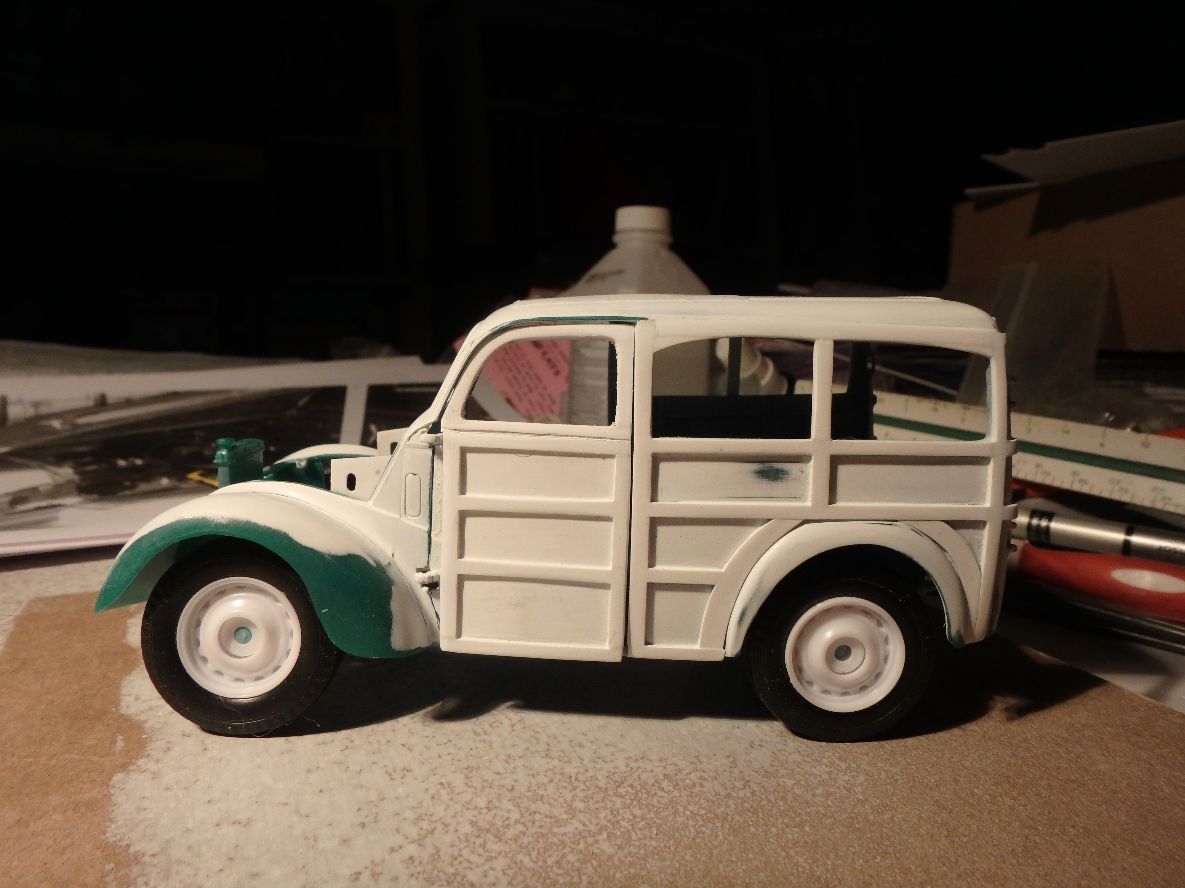

SpeedShift Posted November 25, 2020 Posted November 25, 2020 (edited) ....added angled window trim to more accurately match stock woody. Edited November 25, 2020 by SpeedShift
misterNNL Posted November 25, 2020 Posted November 25, 2020 Excellent and carefully done work towards an unusual subject.
SpeedShift Posted November 26, 2020 Posted November 26, 2020 (edited) Thank you....looks like the Revell kit flip front hood has to go, in order to back date to a stock Thames. Scribing the saw cut line next. Edited November 26, 2020 by SpeedShift
Modlbldr Posted November 26, 2020 Posted November 26, 2020 Beautiful work going on here. I.love what you are doing. Keep it up! Later-

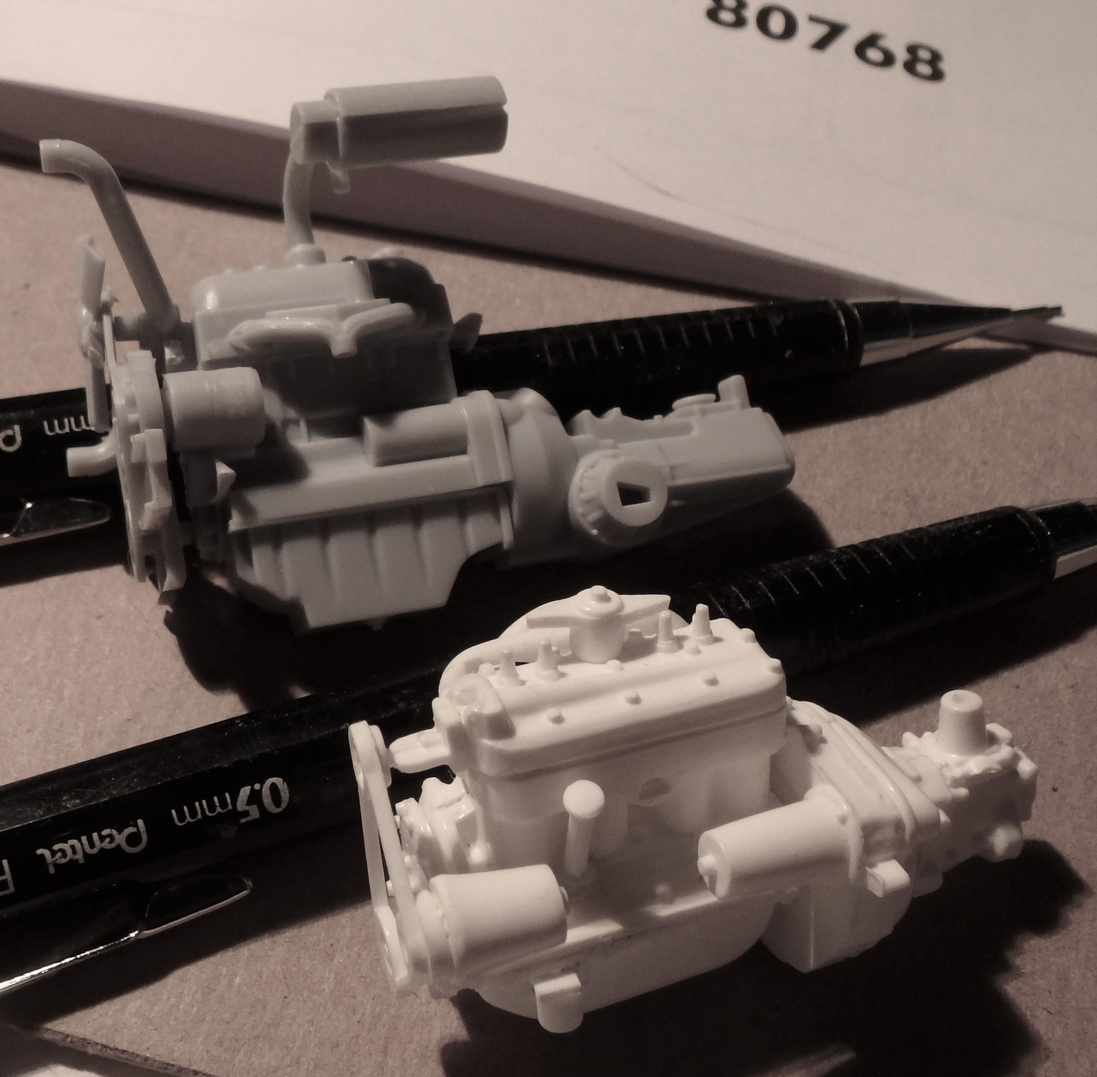

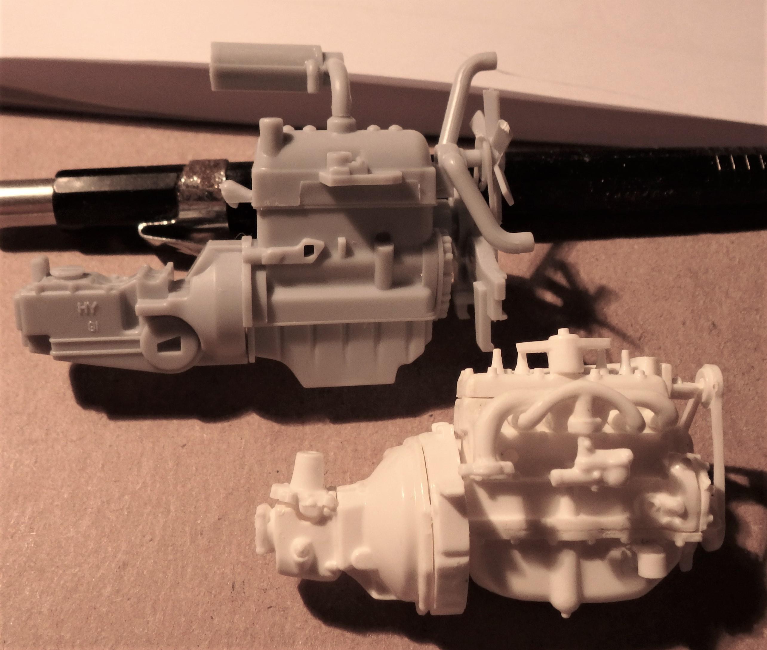

SpeedShift Posted November 27, 2020 Posted November 27, 2020 (edited) The Heller Citroen truck kit arrived.....I pulled the engine parts and made a comparison to the Revell 4 banger. When compared the stock Thames/Anglia engine pictures , the Heller engine (grey)is more accurate for the valve cover, exhaust and fuel intake location, but is a bit too large in height and length when compared to the Revell 4 banger (white) for the Thames engine compartment. I think I'm going to heavily modify the Revell 4 banger. Edited November 28, 2020 by SpeedShift

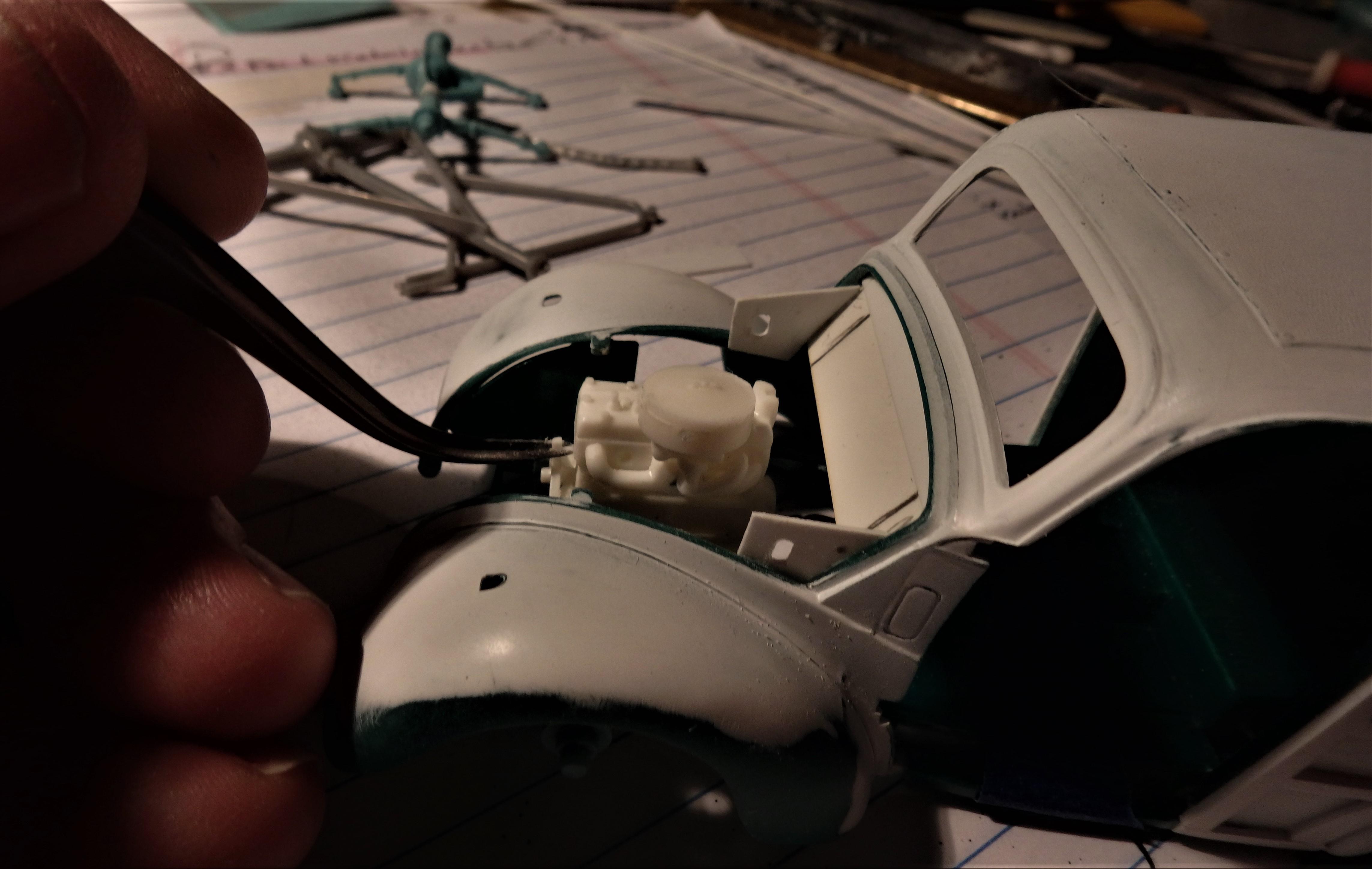

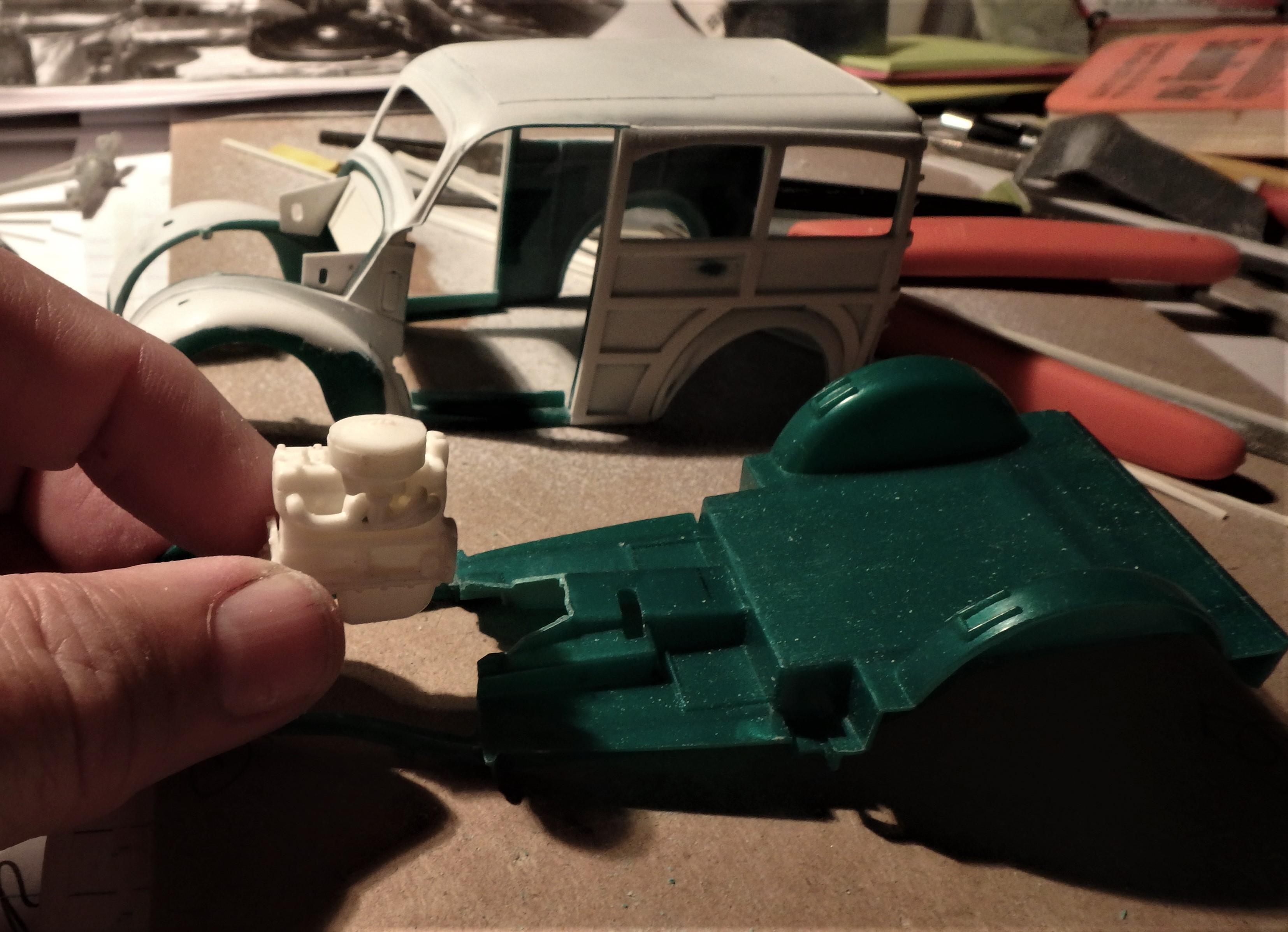

SpeedShift Posted November 29, 2020 Posted November 29, 2020 (edited) I modified the Revell 4 banger to match reference pictures for a stock Thames/Anglia engine. Reduced the engine bock size, switched the intake and carburetor and the exhaust ports from the right to left side. Scrounged an air cleaner from the parts stash. Air cleaner looks too large, but photos indicate different models had very different air cleaner shapes and sizes so maybe I'll go with it, or just sand it down. Edited November 29, 2020 by SpeedShift

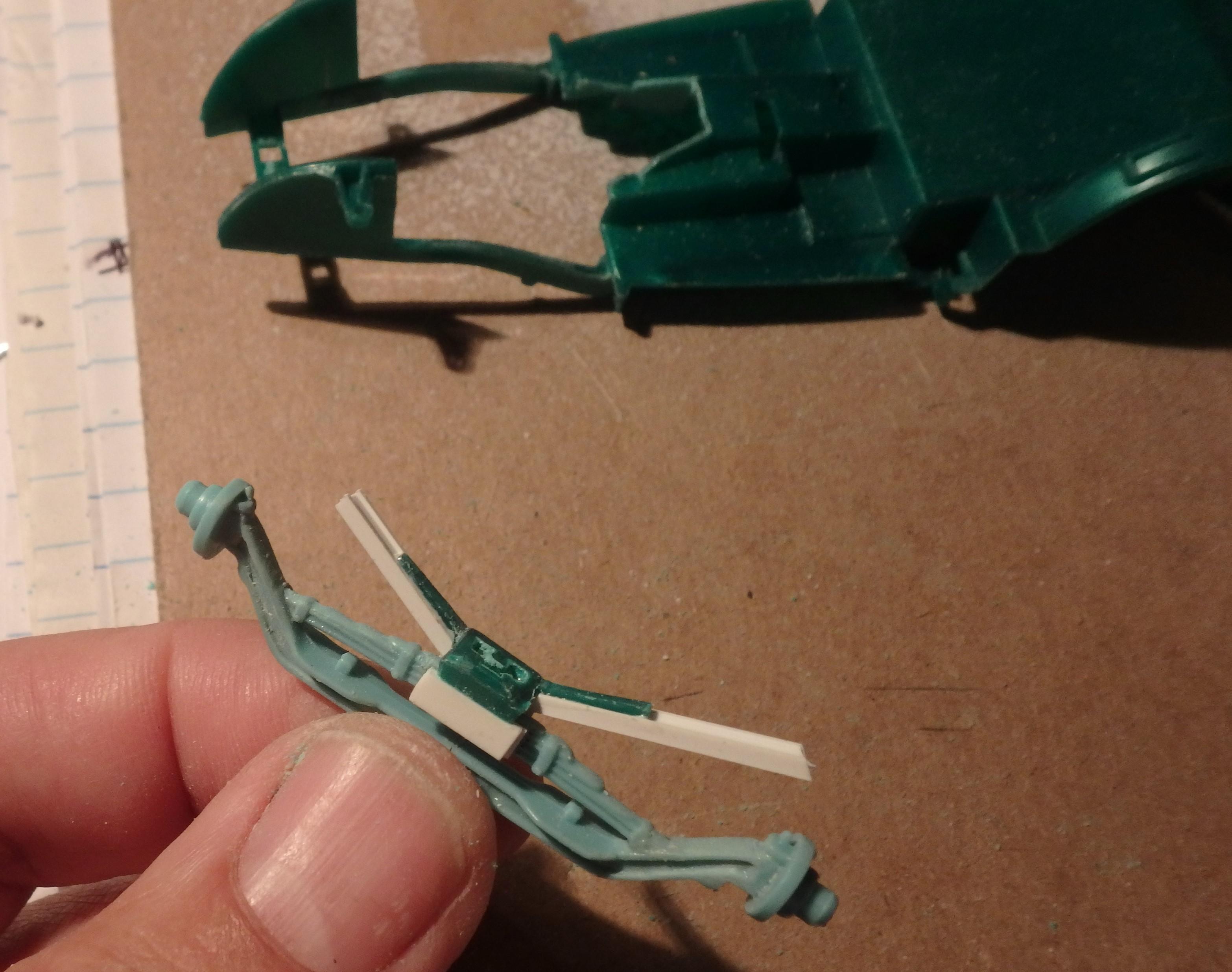

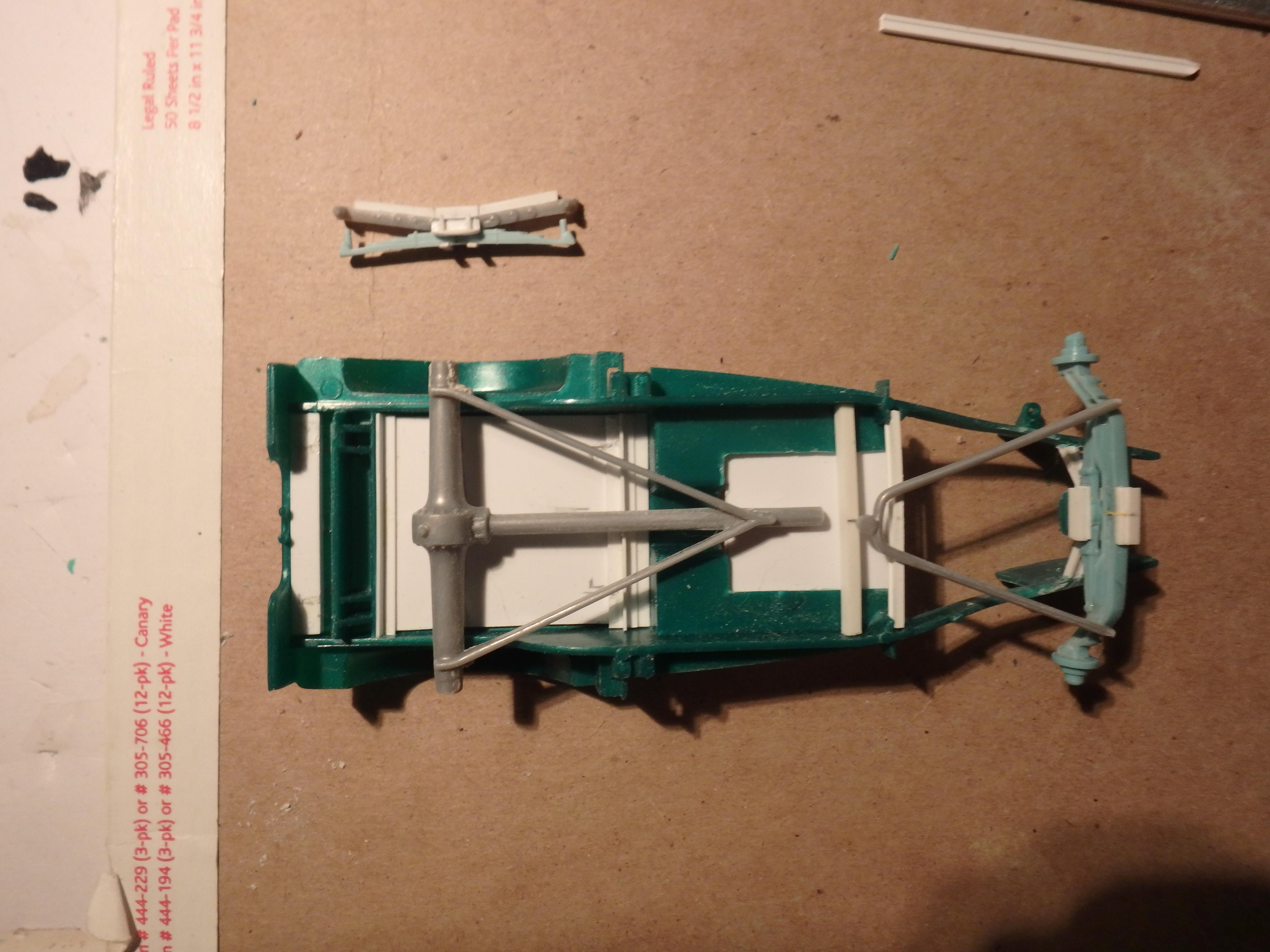

SpeedShift Posted November 29, 2020 Posted November 29, 2020 (edited) The engine compartment has a deck, like a battery tray in front of the firewall, so I'll need to adjust the space in the engine compartment to allow for that. The modified engine also needs to sit lower in the compartment. The stock Thames "Gasser" kit crossmember was made a bit large to accommodate the big Chevy fuel injected engine, which was located further back on the front frame, and the kit crossmember interferes with placement of the smaller Thames engine more to the front and positioned lower. I'll need to cut off the stock kit front crossmember with the new axle I made, and replace it with a smaller crossmember, to make the adjustment. Edited November 29, 2020 by SpeedShift

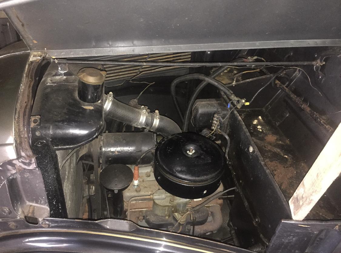

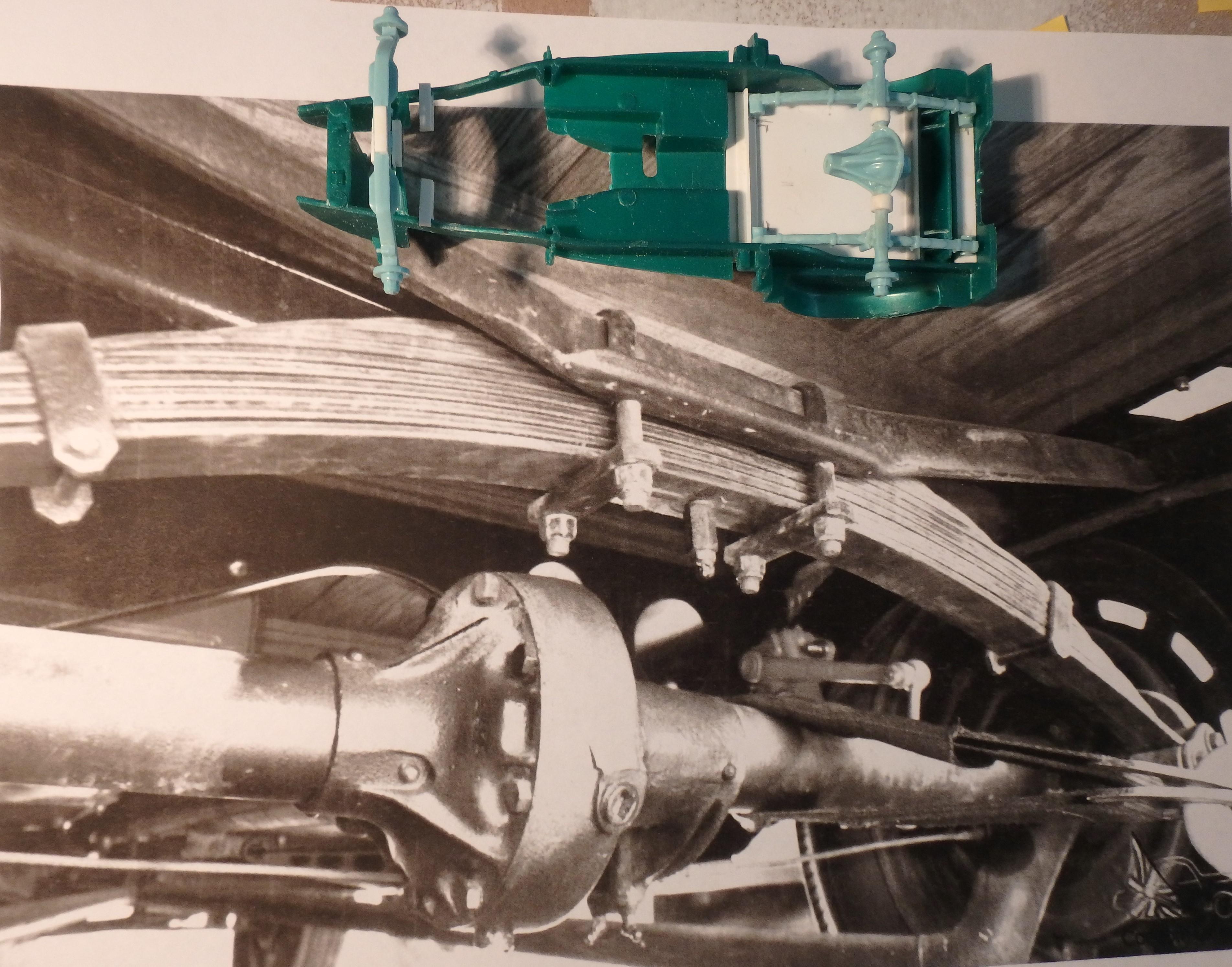

SpeedShift Posted November 29, 2020 Posted November 29, 2020 (edited) A new photo I found shows the stock Thames had a single leaf spring over an older model rear axle/differential...looks like my previous unit with dual leaf springs and 9inch has to go. Edited November 29, 2020 by SpeedShift
styromaniac Posted November 30, 2020 Posted November 30, 2020 The Revell 31 Woody or Sedan kits as well as the 29 Roadster Pick Up have been good sources for those stock Ford Model A suspension parts and axles.

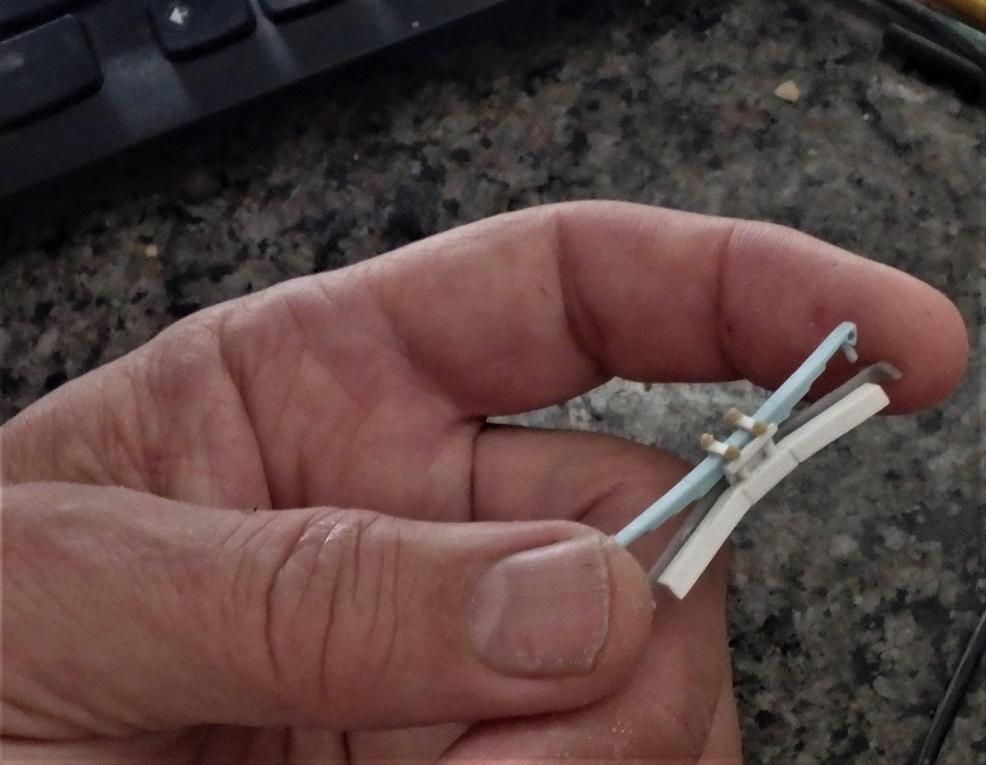

SpeedShift Posted December 1, 2020 Posted December 1, 2020 (edited) I think I have some of those parts....as well as some parts from older AMT KITS. THE SINGLE HORIZONTAL FLAT LEAF SPRING TOOK SOME TIME TO DIG UP, AS A LOT OF SPRINGS HAVE A BEND... Edited December 1, 2020 by SpeedShift

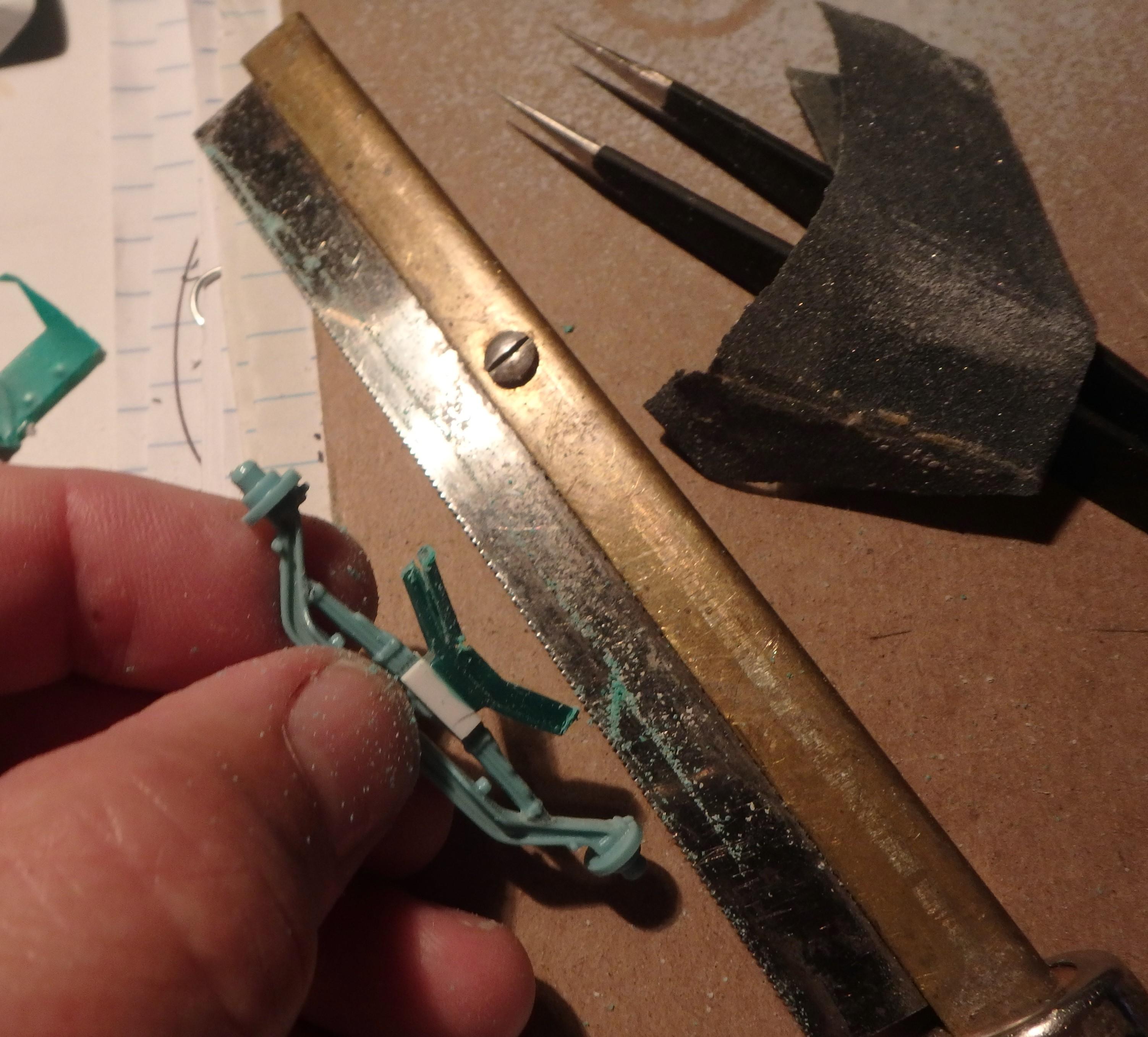

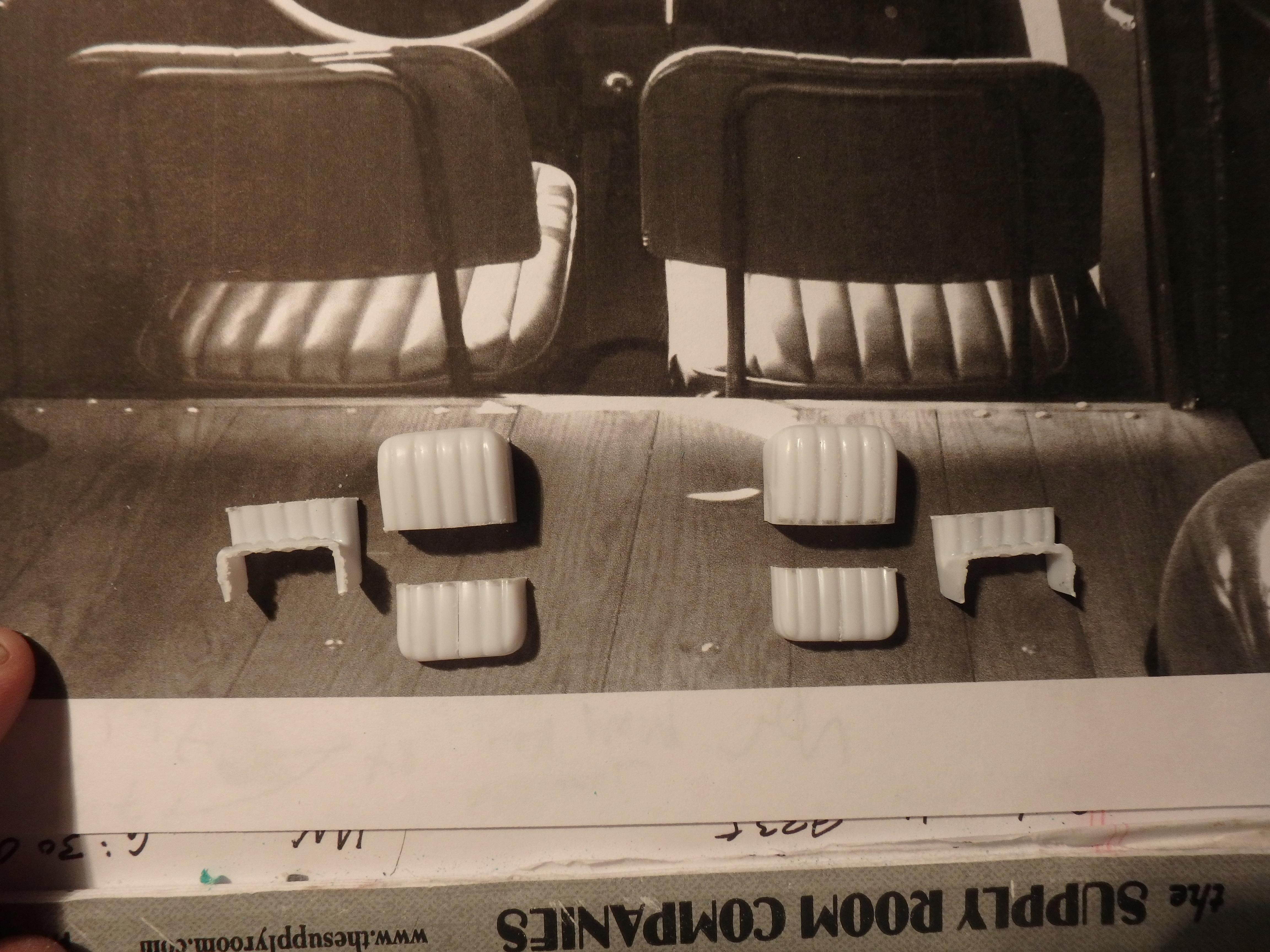

SpeedShift Posted December 1, 2020 Posted December 1, 2020 (edited) Got some PE saw blades from Model Car Garage so used one to cut the hood from the kit flip front end and grille. Found some pleated bucket seats that I sawed in two that will replace the bench seat I was going to use, and found a parts box dash board to modify. Here's the new component status as of this evening. Edited December 1, 2020 by SpeedShift

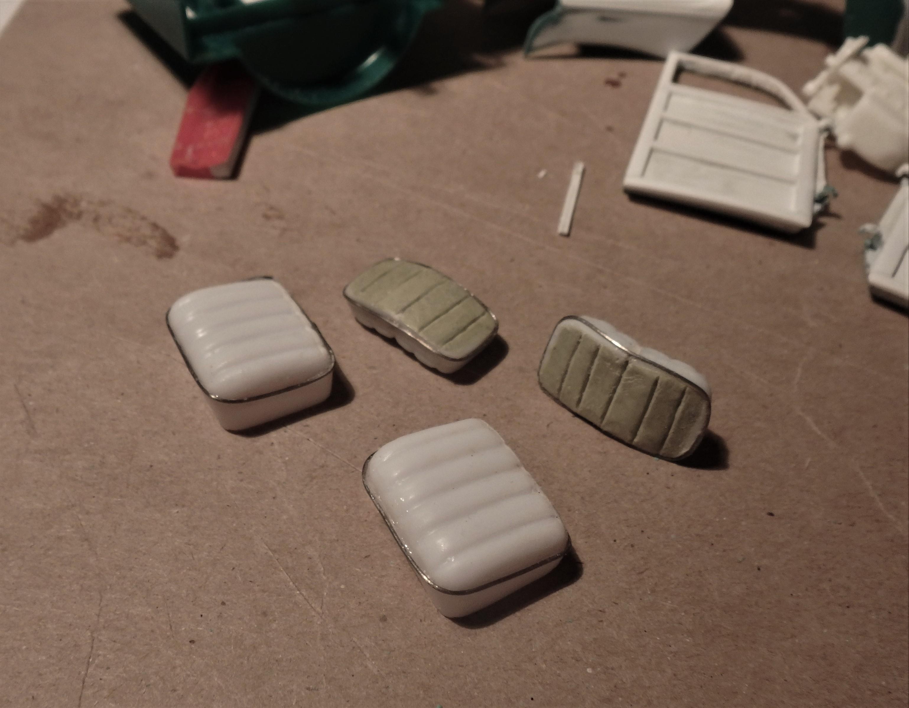

SpeedShift Posted December 1, 2020 Posted December 1, 2020 (edited) Bent the backs to the bucket seats and filled with epoxy putty...with wire detail. Will need to scratch build a frame for each. Edited December 1, 2020 by SpeedShift

misterNNL Posted December 1, 2020 Posted December 1, 2020 On 11/29/2020 at 11:53 AM, SpeedShift said: A new photo I found shows the stock Thames had a single leaf spring over an older model rear axle/differential...looks like my previous unit with dual leaf springs and 9inch has to go. Those bare sheet metal photos are perfect for your project. Very unusual pictures to take for any reason.
