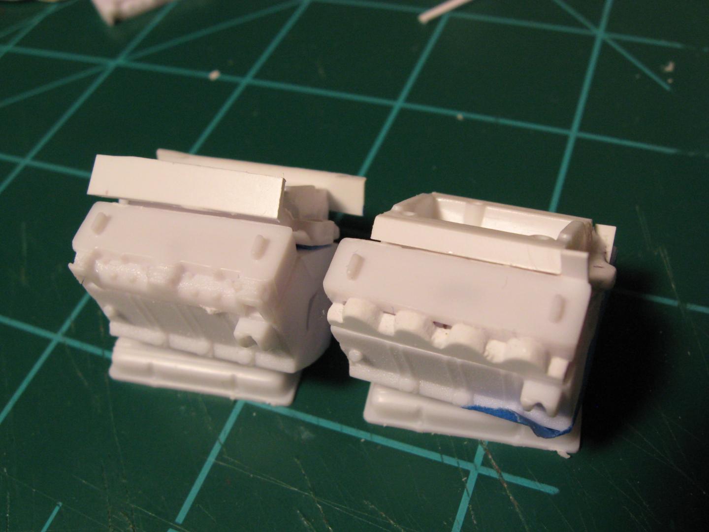

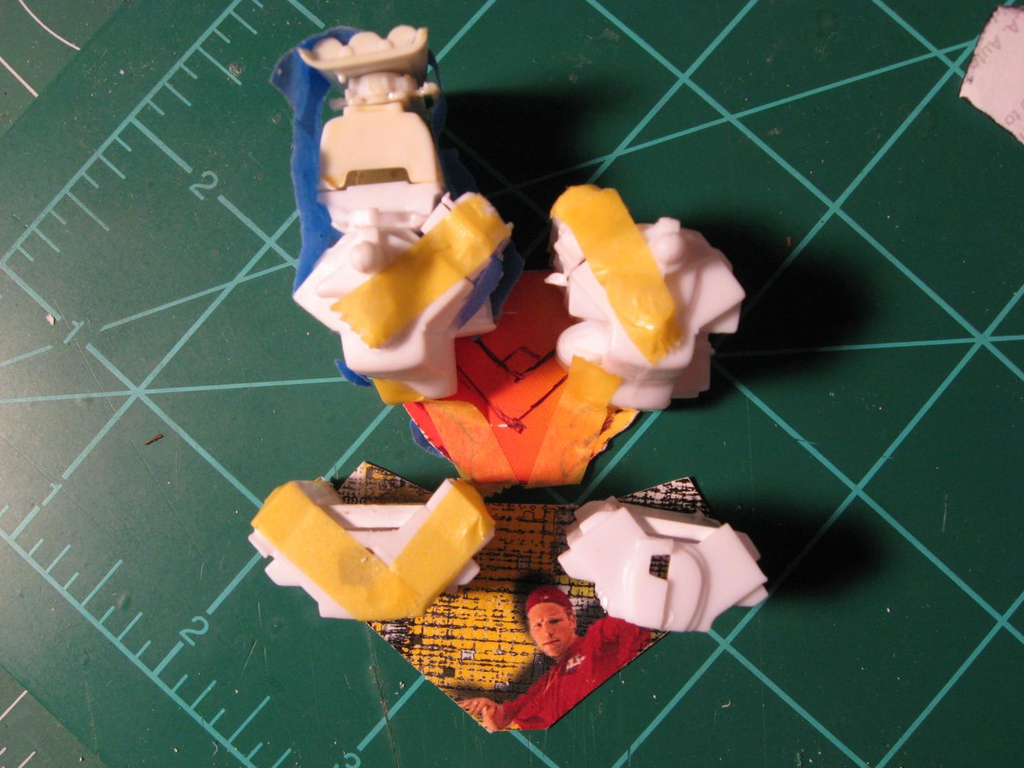

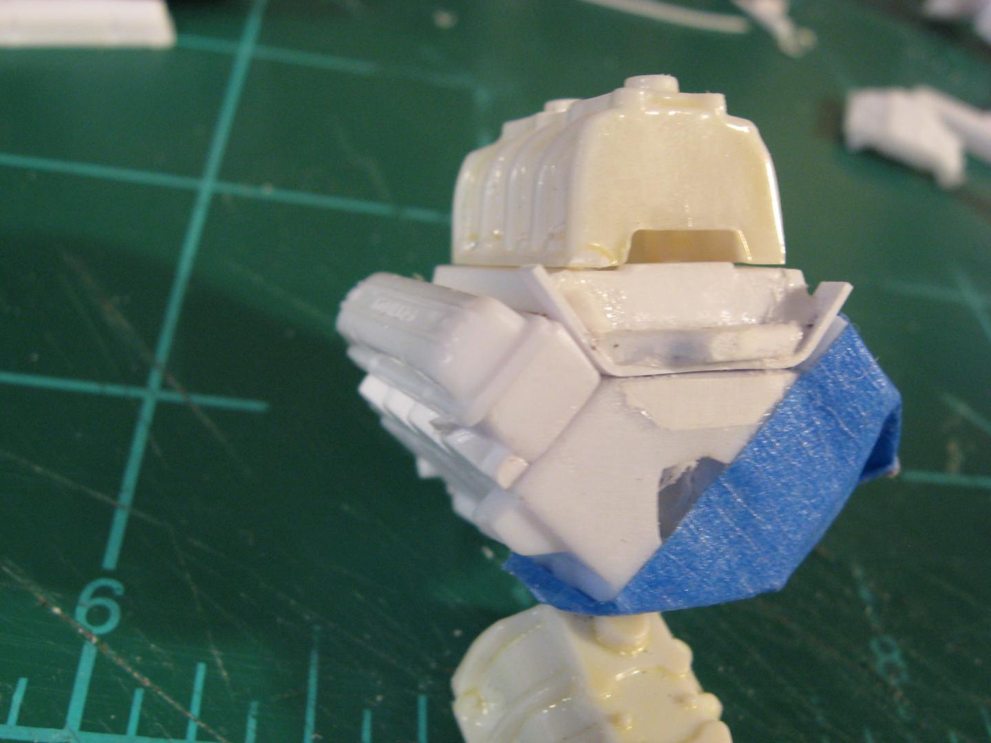

Ridge Rider Posted March 28, 2016 Author Posted March 28, 2016 (edited) Thanks guys. While doing some more research I found out the gearbox was originally built for a turbo 400 tranny. I was having a hard time getting the Allison to work. Now I can tweak the gearbox and use the caddy blocks. A mockup of the Camaro blocks. It was tighter than this quick picture and camera angle is showing but I didn't like it. The caddy blocks on the bottom-they do have a better look. I will use the blower but unfortunately it means more fab work in the engines than I was hoping for. Stock heads on the left- altered heads and manifold on the right. Another mockup . I hope I can pull off this conversion. I'm not hating it yet. Thanks for looking. Steve Edited July 9, 2017 by Ridge Rider

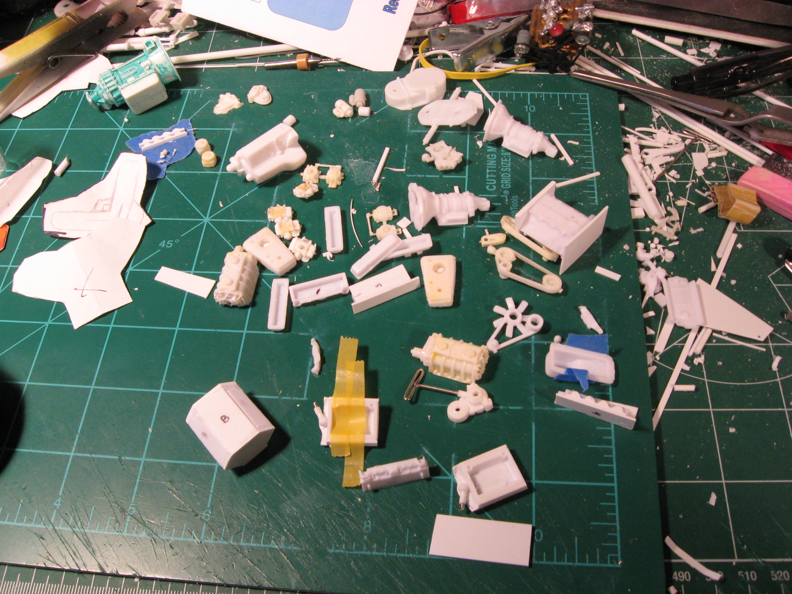

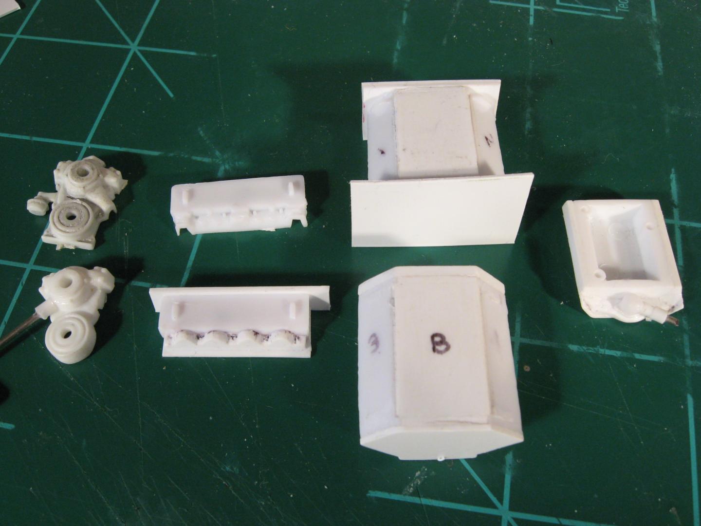

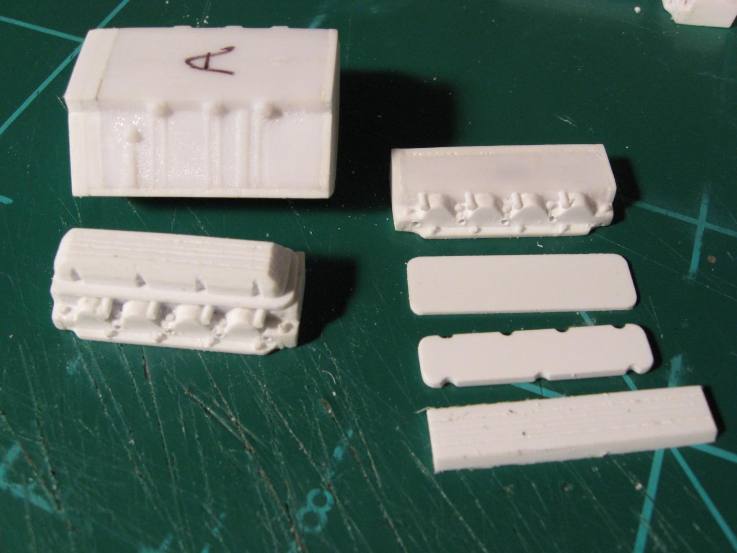

Ridge Rider Posted April 2, 2016 Author Posted April 2, 2016 (edited) Thanks for the kind words guys. I feel like I am playing that whack a mole game with this engine conversion. I address one problem to only have two more pop up. I am lengthening and heightening the block . The length gives me a little more room for the thermostat housing in the front and distributor in the back. I am heighting to fabricate a bigger and more realistic head, more realistic fit for the gearbox, and to accommodate the water pump/blower belt and pulleys. The mess before the staged pictures. I'm sure many can relate. In progress. Stock water pump, head and block on top row. In progress is underneath. The water pumps are from the parts box and may be Mopar origin. The heads are being widened and heightened as well as four even exhaust ports added. The blocks and an intake manifold. It is definitely more work in the engines than I was hoping or even planning for but it is just asking and needing these modifications. I still don't know if I will be happy with them but I will keep trying to move forward for better or worse. Thanks for looking. Steve Edited July 9, 2017 by Ridge Rider

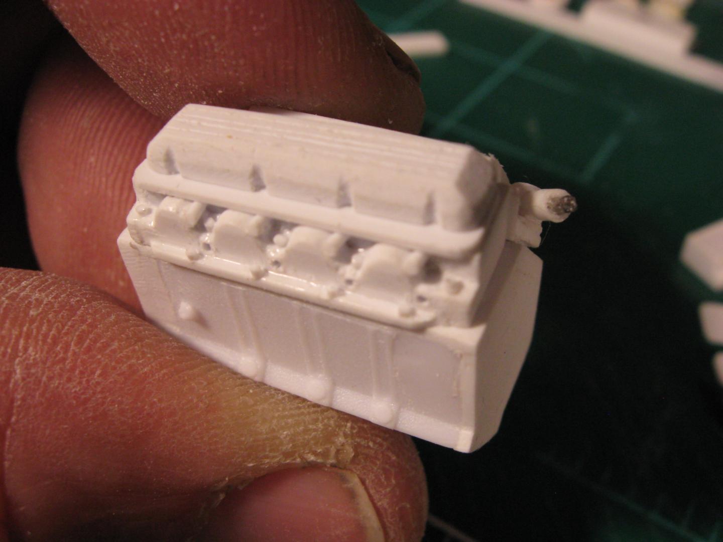

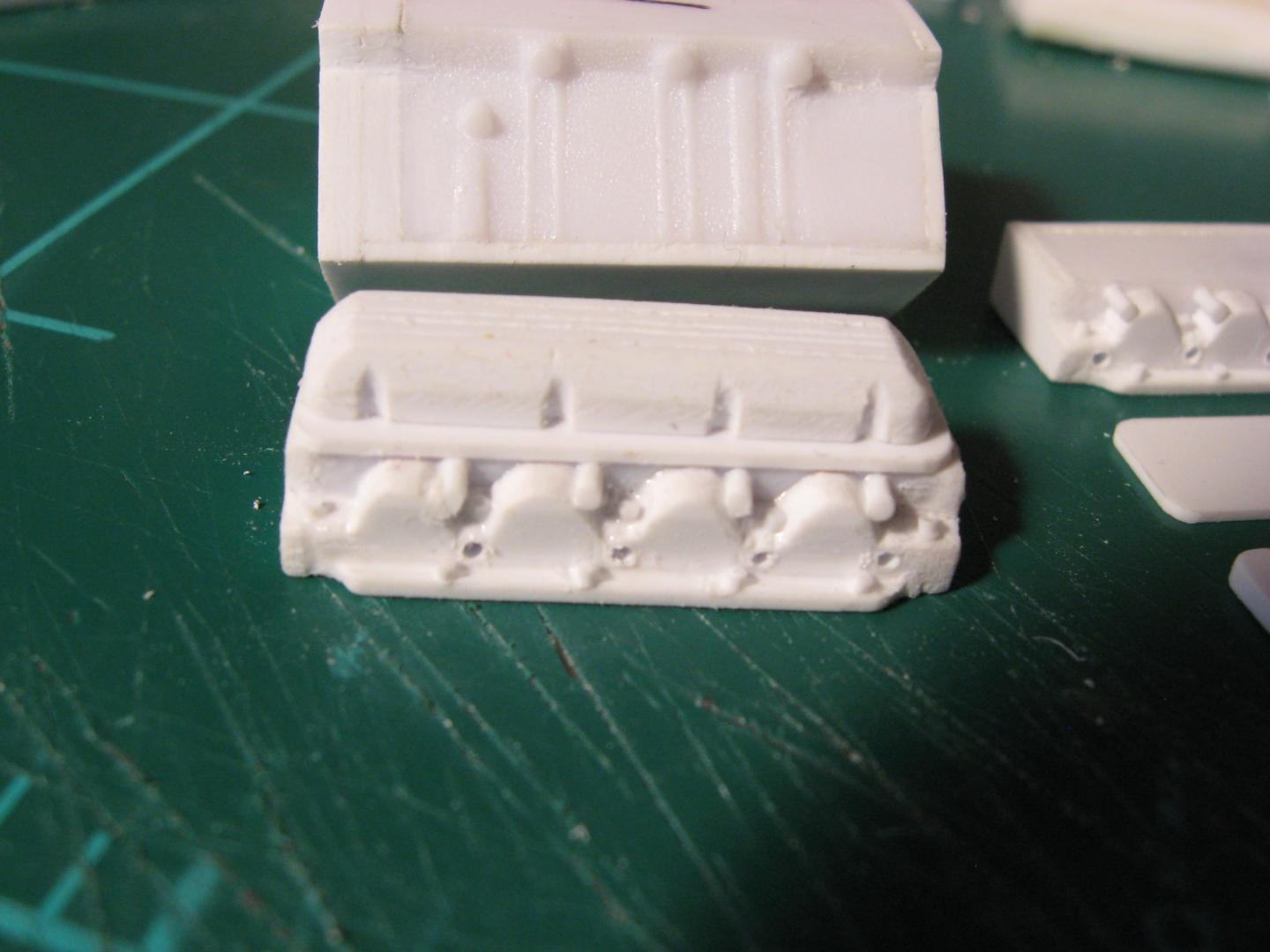

Ridge Rider Posted April 6, 2016 Author Posted April 6, 2016 (edited) Thank you guys-still having fun but I am probably putting more work/details than necessary in these engines. I am testing and expanding my abilities which I am enjoying but it is time consuming. The block was lengthened .030" in front and .120" on the back and heightened .060" in the middle and .030" over the cylinders. I would not suggest doing this the way I have but this is how I ended up with this. The heads are done but need cleaned up. They were made .030" bigger on the sides and back and look great if I say so myself. The valve cover is 3 pieces but the mockup is still 2 and looks a little off but you get the idea. I think these engines will work, I'm liking them more and more as they come together. I did drill the heads for plug wires, which will be another first for me, but I think this one should have them. Thanks for the support. Steve Edited July 8, 2017 by Ridge Rider

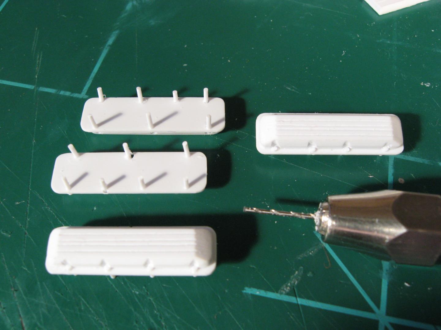

Ridge Rider Posted April 8, 2016 Author Posted April 8, 2016 (edited) Thanks again for all the support. To answer your question Tom, in all the research I have done there were 2 built. The clean and polished one (shiny and chrome) was last seen last May at the movie premiere in Sydney. I was not able to find any newer info or photos of either one since the premiere. I worked on the valve covers tonight and while not quite perfect they are going to work. I drilled holes in these to stick .020" rod through to simulate bolt heads. When they set up the back will be trimmed. Next up is finish the rear of the intake manifold and fit a distributor. Then i can work on the motor mounts and gearbox / tranny fitment. Thanks for looking. Steve Edited July 8, 2017 by Ridge Rider

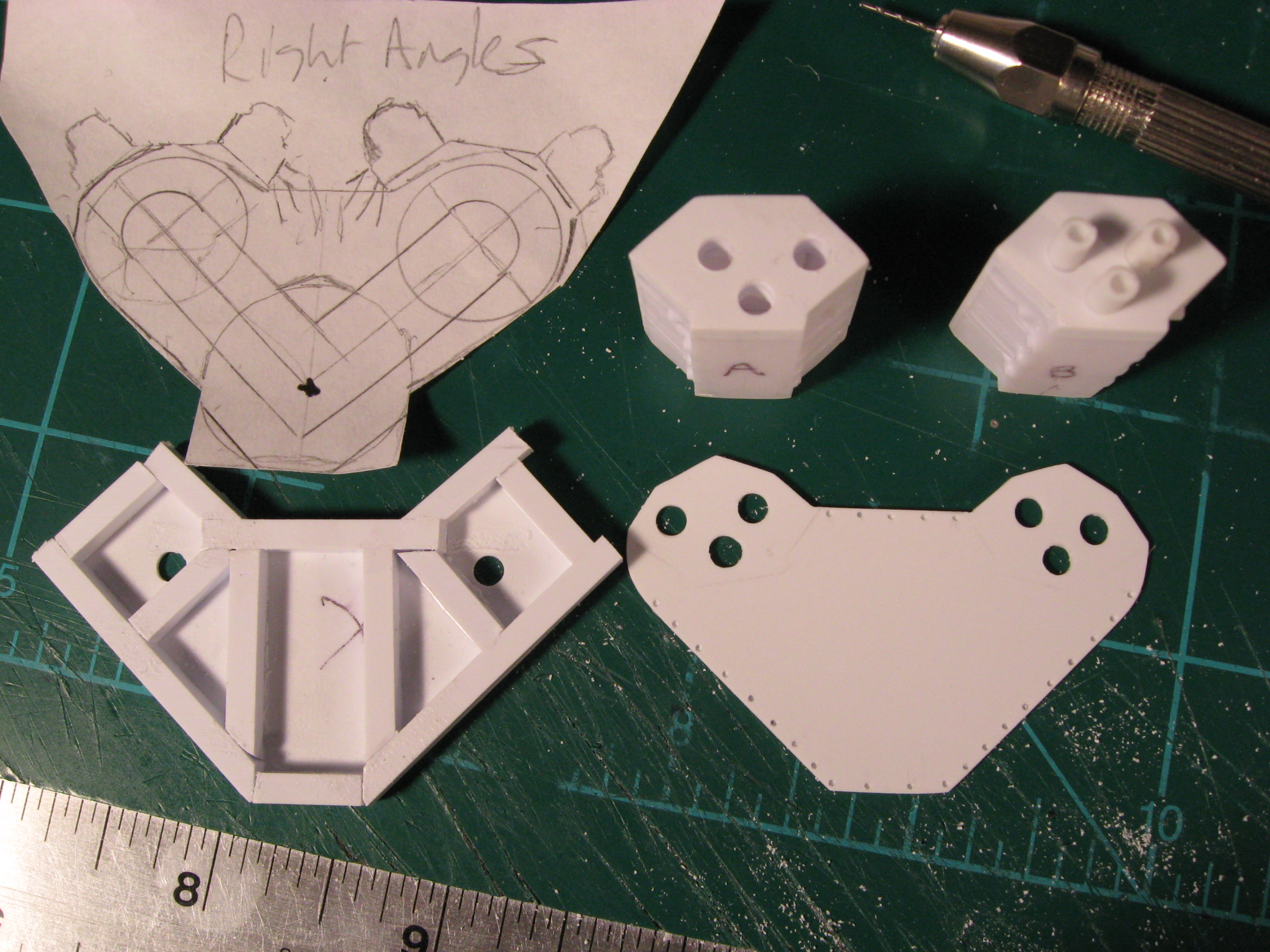

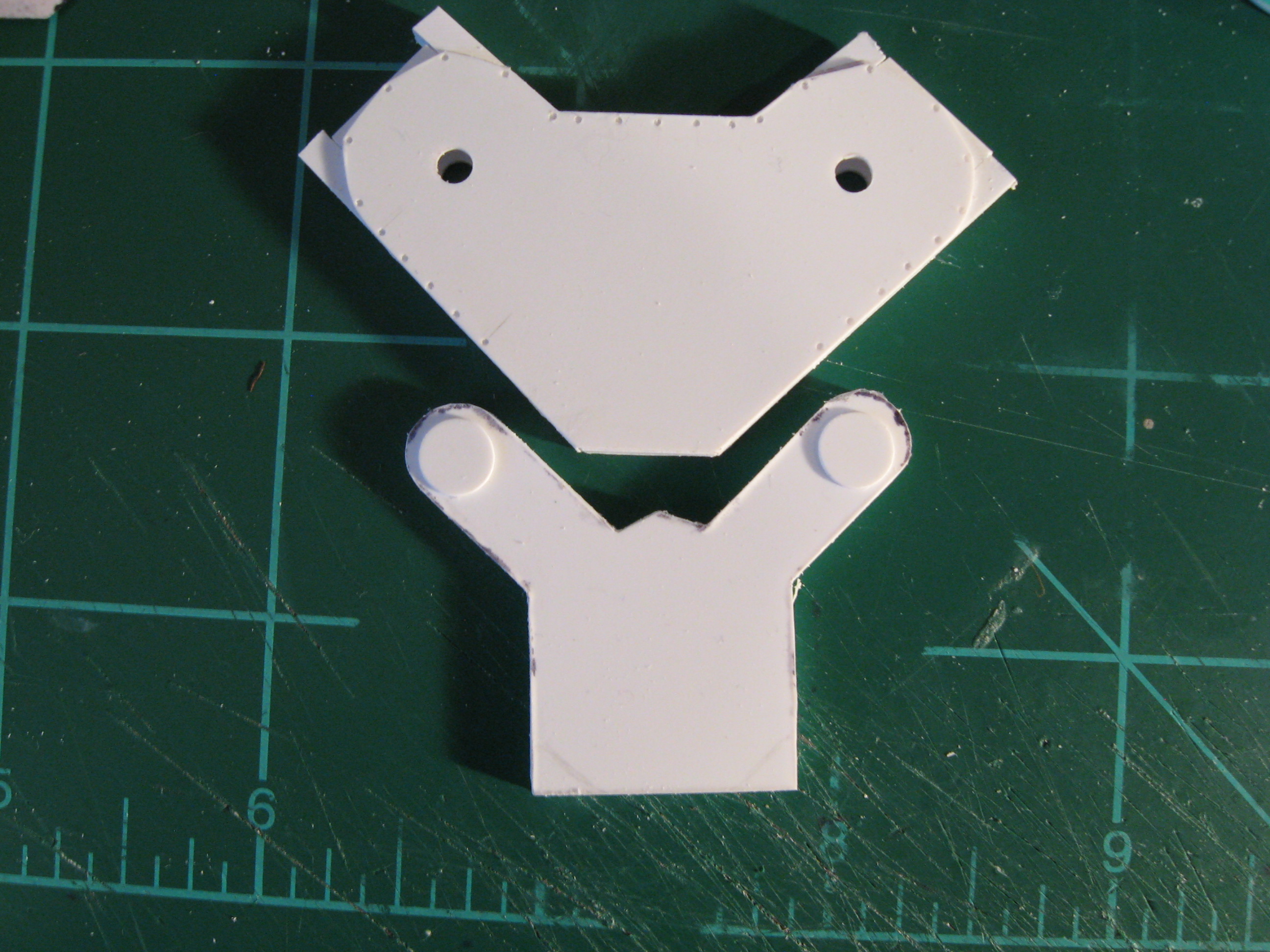

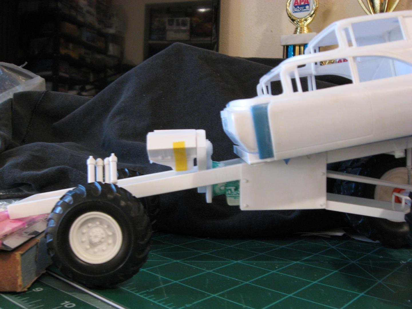

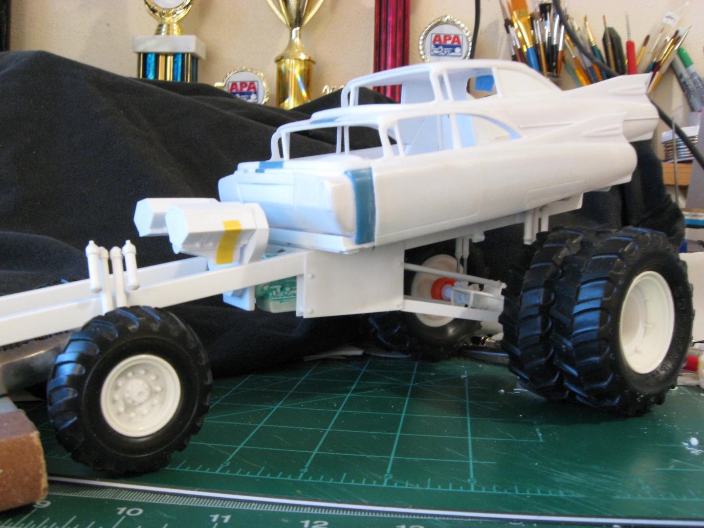

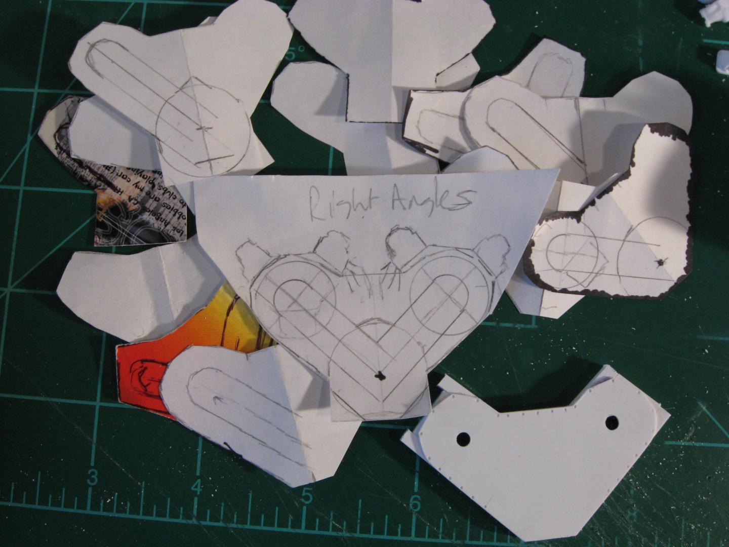

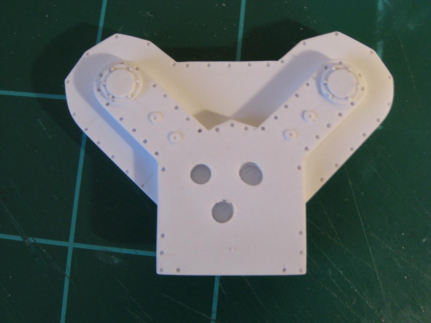

Ridge Rider Posted April 10, 2016 Author Posted April 10, 2016 (edited) I have been working on the gearbox-it took a few(cough) times to get what I think will work. I cut the plates out of .030" sheet and used .125" strips for the internal structure. Also drilled plates and blocks for quick location/gluing pins. Some quick mockup shots-the gearbox kind of looks happy. It's a little different from the 1:1 but it's whats going to work with this tranny. Thanks for looking. Steve Edited July 8, 2017 by Ridge Rider

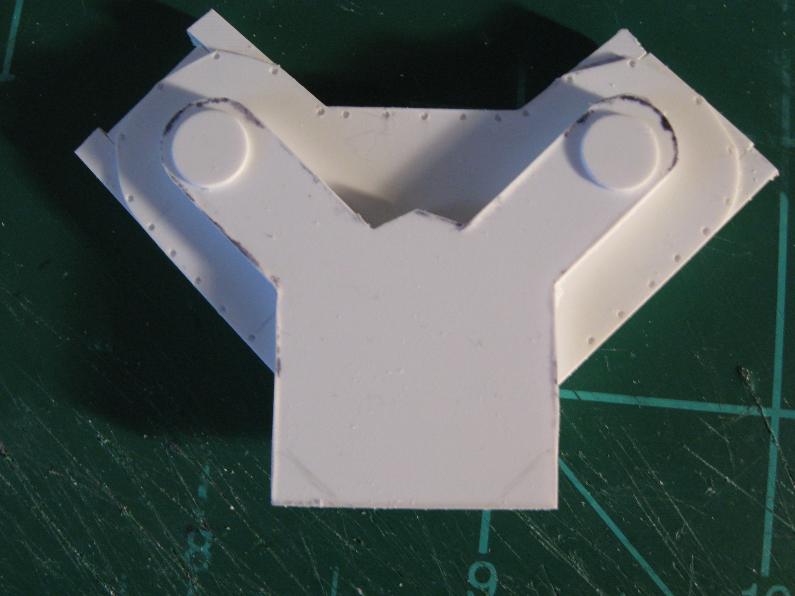

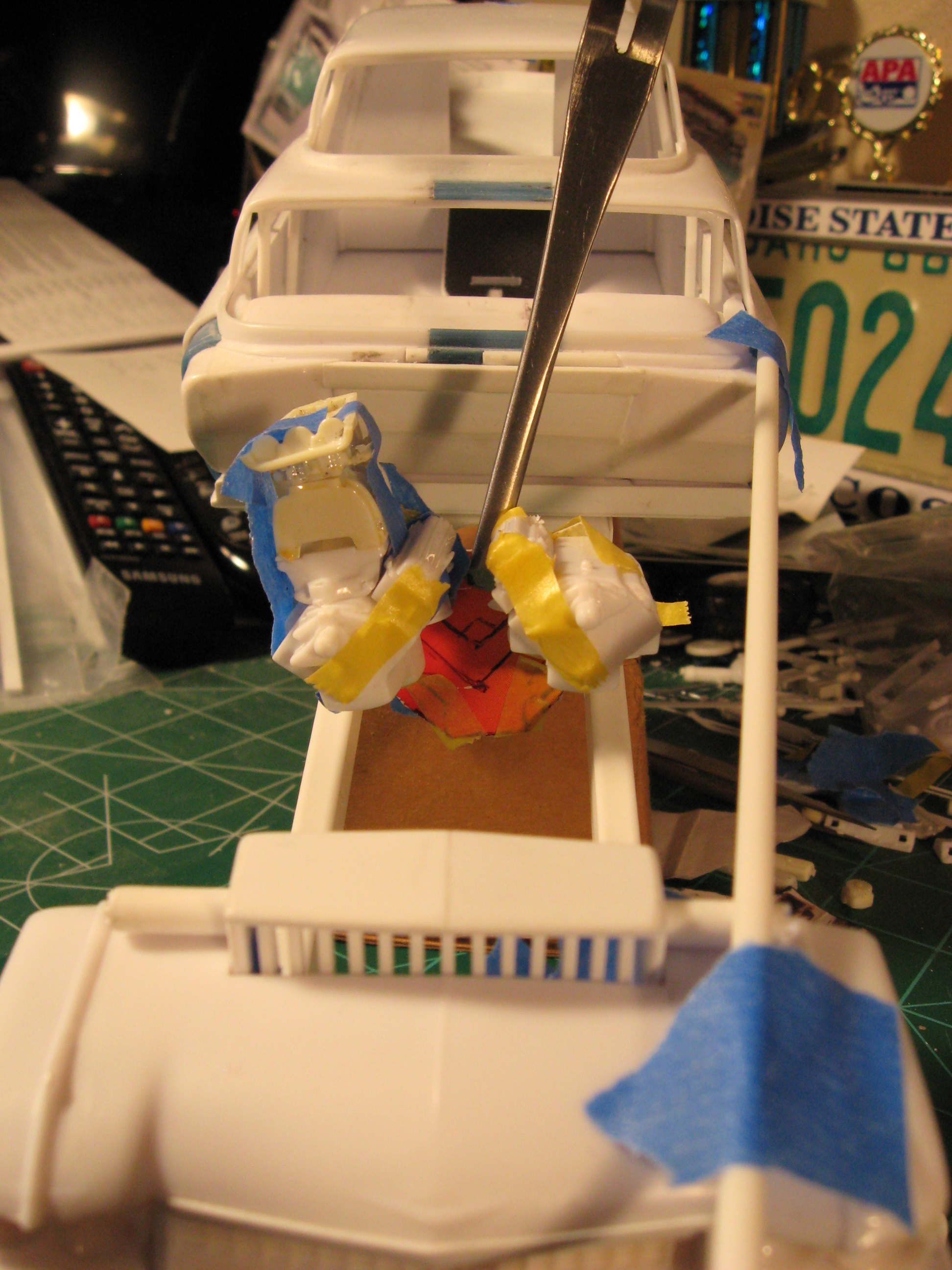

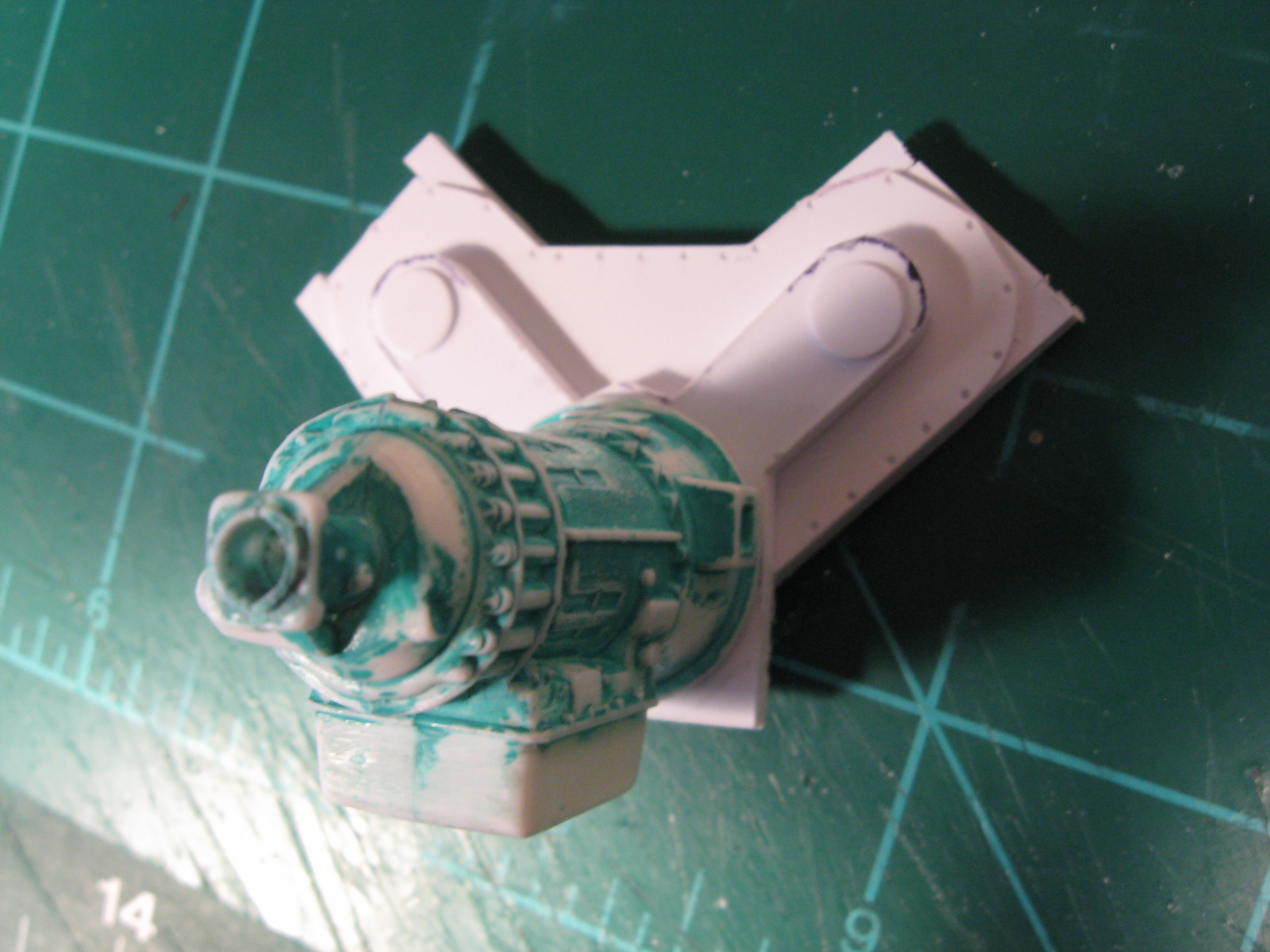

Ridge Rider Posted April 12, 2016 Author Posted April 12, 2016 (edited) I have managed to get the gearbox done and set up some spatial comparison pics. I think/hope it's going to work. Thanks for looking. Steve Edited July 8, 2017 by Ridge Rider
