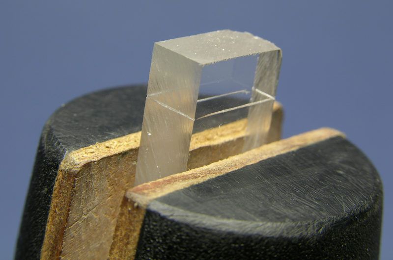

I started with a piece of acrylic (Plexiglas) which I cut to the scale length and width of the car.  The scribed mark denotes how high the car needs to be.

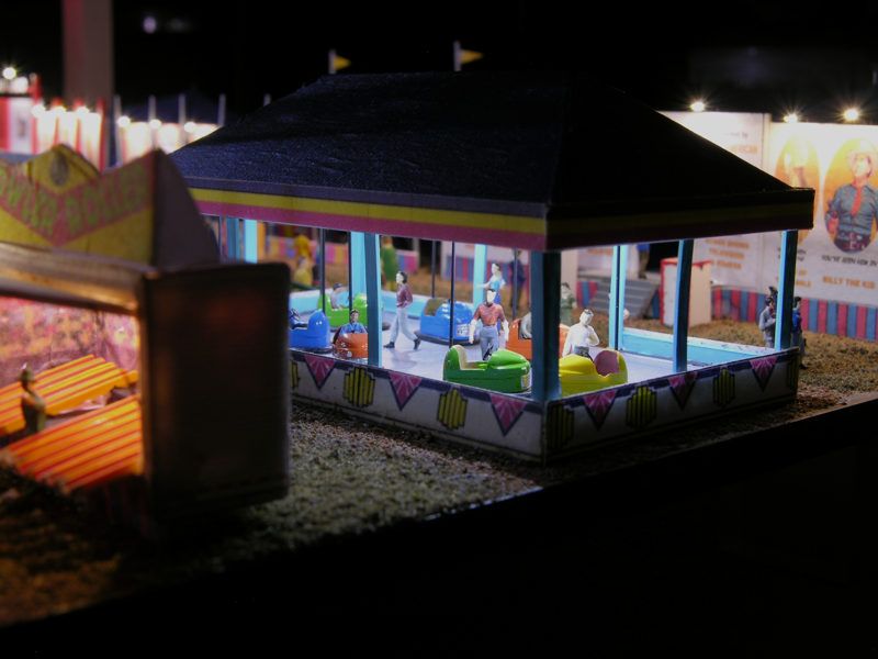

Here are the bumper cars placed on the track.
And a night shot.

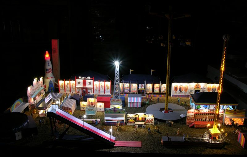

Here is an overall view of the new part of the midway. This is an early photo, before the people figures and final detailing was done.
