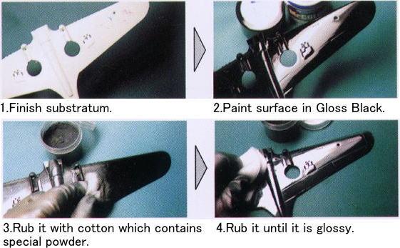

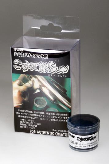

花火 Posted March 1, 2016 Posted March 1, 2016 here if I understand right, you are about to paint some wheels and made them looks like chrome, right? If it is goes that way, I recently had another idea. I also need to paint some racing wheels and make them looks like chrome but using any 'sliver' paint not enough so I found a tool by WAVE and here is the introduction: It looks really nice and chrome , but also it is said that this tool is very toxic. So if you need use it, make sure wearing gloves and mask. Anyway I'll go try this soon and I hope this gonna help you.

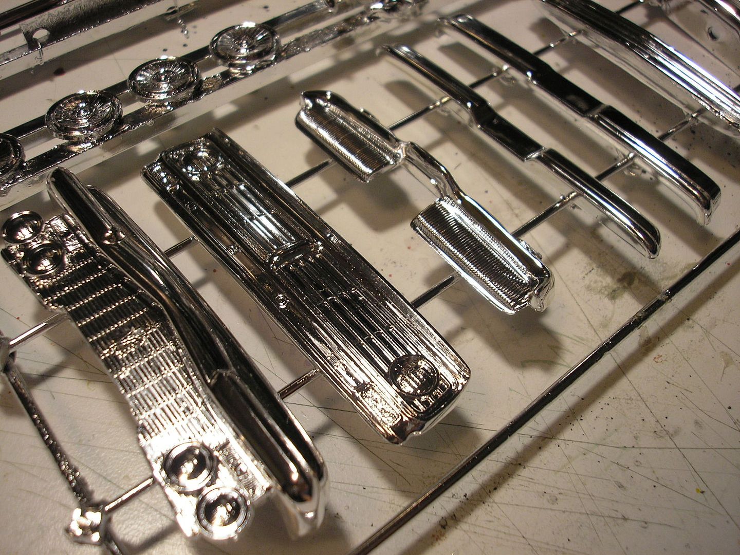

sbk Posted March 8, 2016 Posted March 8, 2016 (edited) I have used Chrome Tech, LMK, & Bob's Paint "Kustom Khrome". I've had beautiful results from LMK, other times, specks under the chrome plating. Same thing with Chrome Tech USA, some parts outstanding, others with runs or specks. Didn't care for Kustom Khrome, all of the hubcaps that I sent had tiny pieces of lint or something under the chrome. Plus, no plating where it was attached to the rack with "special tape" My modified bumper came back cracked where it was pushed down on that "special tape." Never again. Whenever possible, I send multiples of a part placed on different parts of the rack to hopefully insure getting one very nice piece. Bumpers & grille on this one plated by Chrome Tech. The hubcaps were plated by LMK. Chrome Tech again for the bumpers & grille on this one. Edited March 8, 2016 by sbk
