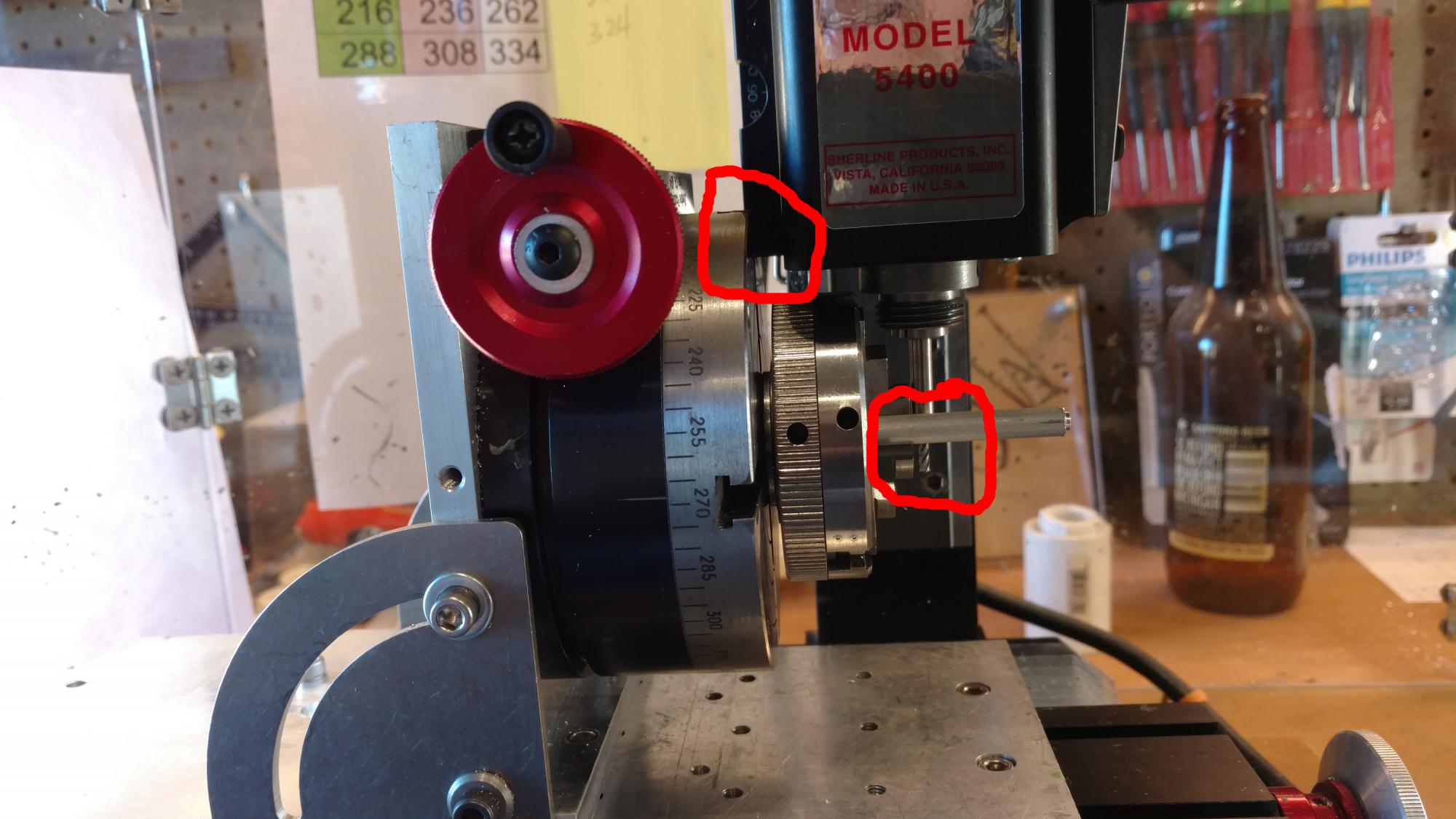

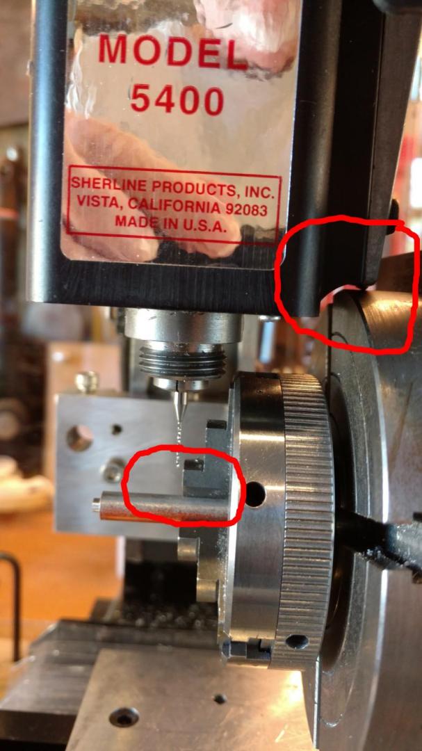

I got the rotary table back from Sherline a couple of days ago and I am very pleased with there modifications.  I can now get a bit within .5" of the top of a piece and almost flush with the end of the jaw with a collet used to hold the bit. The head contactling the Rotary table is still the limiting factor but it is much less of an issue.  The first picture is the after and the second is before.  You can clearly see the clearance difference.

pete, feel free to bore me with the details. how did rotating the handle in any way fix the relationship between the rotary table face / chuck  and the edge of the  head to the spindle centerline?
edit: forgot to mention, it would be best if when you show something like this you put the same mini carbide drill in the collet at the exact same depth and not change to a longer shank and larger diameter end mill to show your relationship change. the tooling change makes it look like extremely different.
