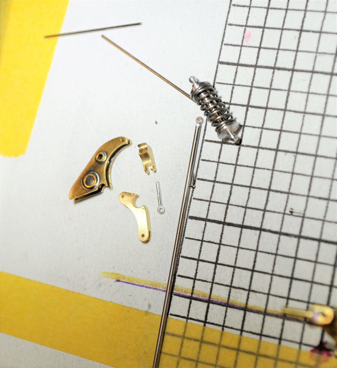

Codi Posted October 2, 2017 Author Posted October 2, 2017 As always, a thanks for following along and your interest in the thread. I do have to acknowledge that today's efforts were challenging thanks to the small factor of the part. Pete, I completely agree but I do get frustrated at times when I turn my head and then look back and a bunch of super talented builders have completed this, that AND the other thing, while I turn out a little at a time. Today I started the Enderle fuel pump. I wanted to capture the 6 ribs on the body of the pump, mine are .4mm x 1.0mm in length. I drilled holes down through the top and then machined half of it away to expose half of the hole afterwards. Put the brass rod down through the top and soldered them in place. Several flanges to make yet, 1 brass, 2 aluminum for the pump body. Then I'll solder the brass bottom flange onto the pump & media blast it for texture like the Cirello mag body. It will be painted but the aluminum flanges won't. There are a bunch of little bits and pieces to make up this whole thing, I underestimated how much effort it will take to make I think. What else is new right? cheers, tim

Pete J. Posted October 2, 2017 Posted October 2, 2017 Humm, very interesting way of doing that! Never thought of that. Another tool in the back of my mind. Thanks for the tip!
gasser59 Posted October 2, 2017 Posted October 2, 2017 My oh my. That part sure looks the part. Very inventive way of getting the ribs. Goes in my notebook. Thanks Tim.

Codi Posted October 3, 2017 Author Posted October 3, 2017 Dave, glad you like it so far. Lets just wait to see how the rest of it goes as I check another one off the list of parts to make soon. Pete & Brad, I can't take credit for that method, it was something I learned from Dave. thanks too!Tim - glad to see you checked it out and I appreciate your comment. Give me another 7 or so months and this one will be done, weather permitting for paint of course. Bob, I can always count on you to count the parts, I never really think about that to be honest as I fab something but it makes me smile when you remind me what's in it. Come the weekend I should have pics of the completed pump and it's valves. Cheers guys!

Codi Posted October 4, 2017 Author Posted October 4, 2017 Chris, I go back and check out YOUR Vega all the time. I see details in your pics that I try to capture or I'm reminded to add them when I would have likely overlooked them. You're a great guy and builder Chris and we're all looking forward to more of your creations. Randy, just remember I am the President of the Randy D. fan club so if it's all the same to you, I really have to have something to present at the next fan club meeting and you've not been giving me anything new to discuss or share. hint-hint.......... Today was a productive one. Pump body is pretty much done the aluminum flanges aren't secured just yet as I've still got to media blast the pump. A few pics to share. cheers, tim Here you can see the pump neck and the aluminum flange that the pump attaches to. Nothing has been permanently attached, just 2 mock-up pics. Barrel valve, return line fittings and a few other details to address and this will be done. Cheers!!!

Mooneyzs Posted October 5, 2017 Posted October 5, 2017 Tim... This fuel pump just Rocks my friend!!!! and that fuel pump neck is just killer. I love how you media blasted it to give it a casting look. I really like that. I may have to steal that idea and ask what the set up is or the tool you purchased for that. I have seen some miniature media blast guns at Micro Mark. Your work is really inspiring and its making me want to get to the bench. I do appreciate the kind words and you checking the pics out on the Vega. I should have an update for you here real soon. I was able to get a couple piece repainted and just haven't had time to install them. Yow know how bad I want to get the Vega done so I can start on some other really cool builds. Plus your's and a few others brass work has really inspired me to go with a Brass chassis on the next project.

Codi Posted October 6, 2017 Author Posted October 6, 2017 Yeah Dave, you're to blame for the madness. Thanks as always for sharing your insights with me too! Brad, as I gather more experience, the more fun it's becoming. Making far fewer mistakes..............not to mean that I'm not making mistakes, I assure you I am. Just fewer of them. YEAH!! Chris, I can't wait to see what you can do in the new couple of years with your mill. No doubt you'll catch onto it quickly, then you'll be hooked for sure. thanks too for the comments. Thank YOU Dave for always stopping by. Well, I'm no plumber and I've come to the conclusion I wouldn't want to be one either. But I did get started on the fuel pump plumbing and after making some good headway the last couple days, I can now envision it a whole lot better. More tedious fittings etc. to add but the pieces I fabricated in brass are a big step to getting this part finished. cheers, tim Gratuitous penny shot
