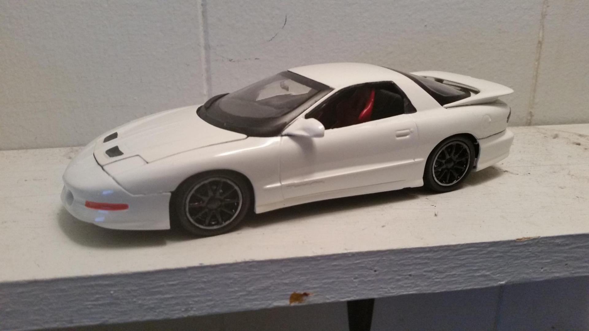

With my Firebird paint problem I posted a while back, I tried every single trick in the book and the red was showing through the white. When I tried the duplicolor that got rid of it but crazed like a siv requiring a strip job.  I tired the Walmart gray primer followed by the white on a red molded hood like Snake did and it still showed through (tell me, how did you not get the pink cast showing through?).
The only thing that worked for me without crazing was Rustoluem Automotive primer SEALER. That covered the red without bleed through and allowed me to put the Wal-Mart gloss white on without a hitch as seen here (sorry for the kinda grainy pic, but you see the point).
So in a way, how opaque your primer is does matter but some can be way too hot on plastic as i've learned (the wal-mart gray also crazed the red hood i tested). I usually use the Sears/K-Mart primer as that gives good results but seems to be prone to bleed through no matter what. But now i know what to do on red/yellow molded stuff in the future so its all a matter of trial and error.
