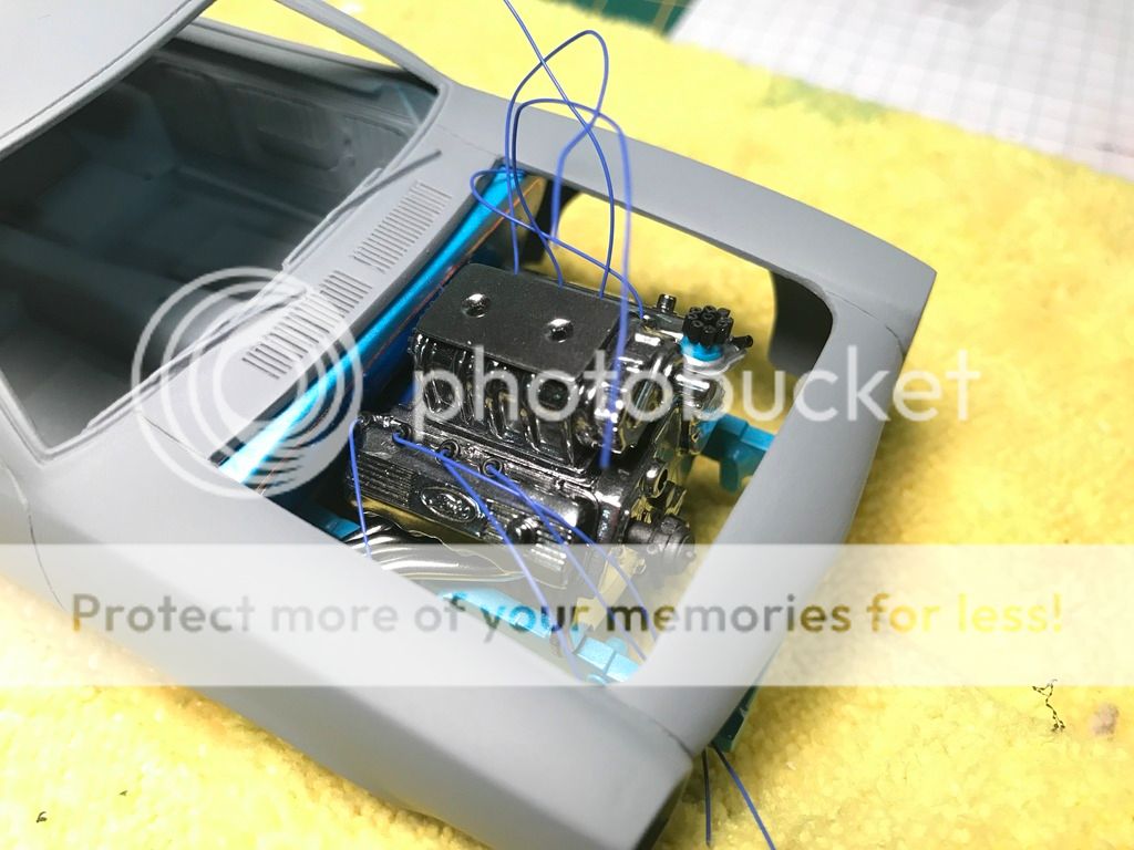

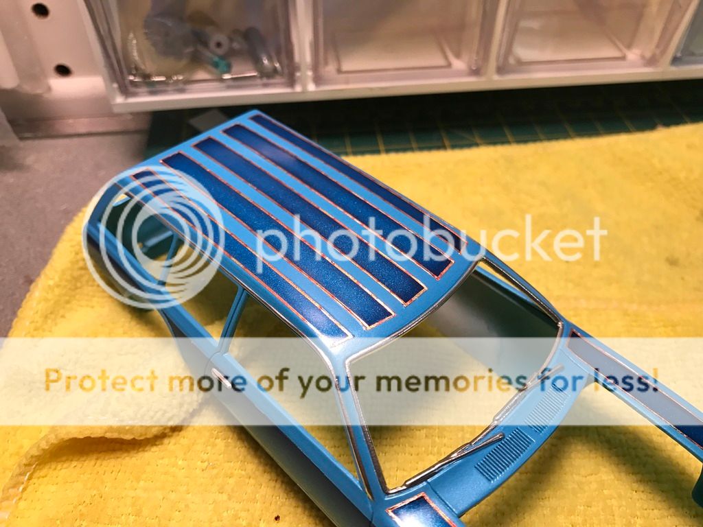

Impalow Posted November 16, 2016 Author Posted November 16, 2016 Thank you all! Ive had a busy couple of weeks and sadly the Pinto's progress had suffered.. I was able to get the rest of the gold leaf done last night, its not perfect, but it was good practice for the body. Once its cleared and all the suspension is installed I think its going to be just fine. I had to relocate the distributor... some serious clearance issues with this giant engine. Now that its up top, I am not really happy with my distributor boots. While I was ordering the rod ends to complete the front steering from RBMotion, I picked up a set of their boots that will hopefully clean that issue up when they arrive.

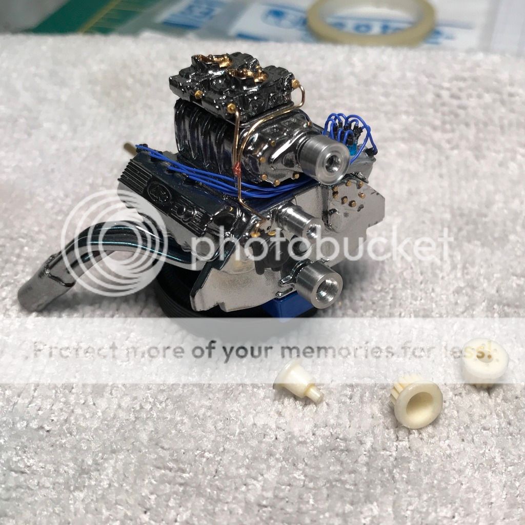

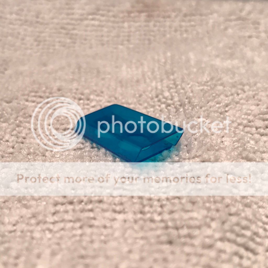

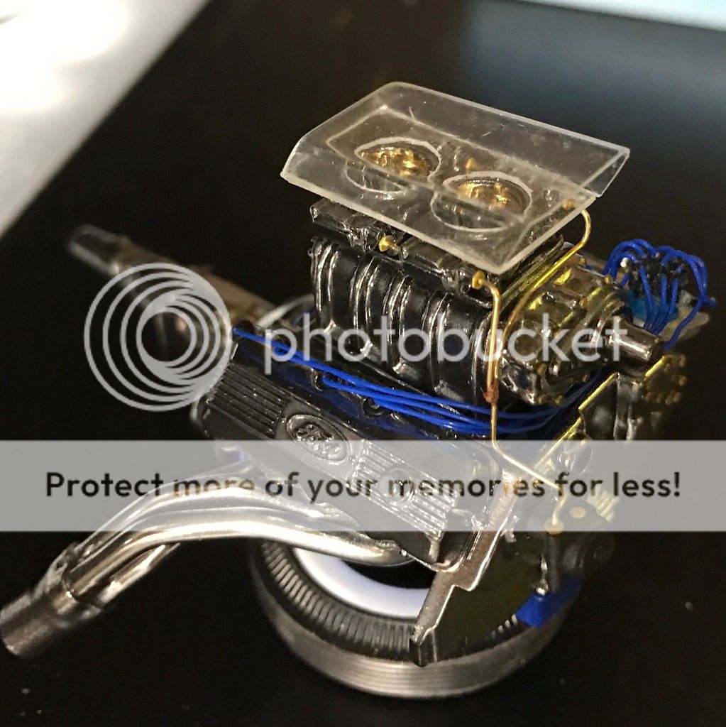

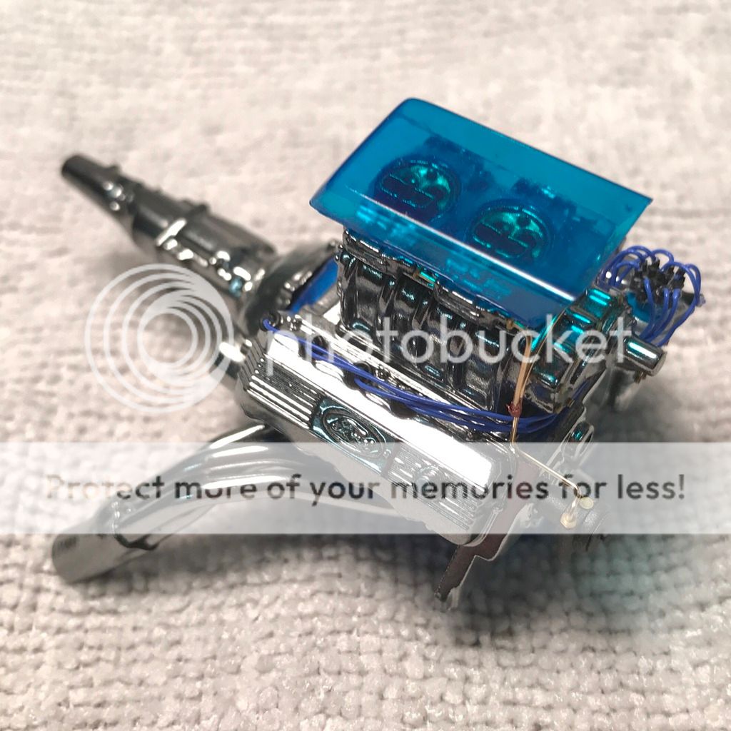

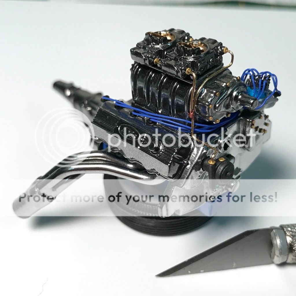

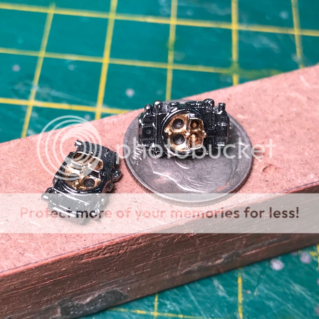

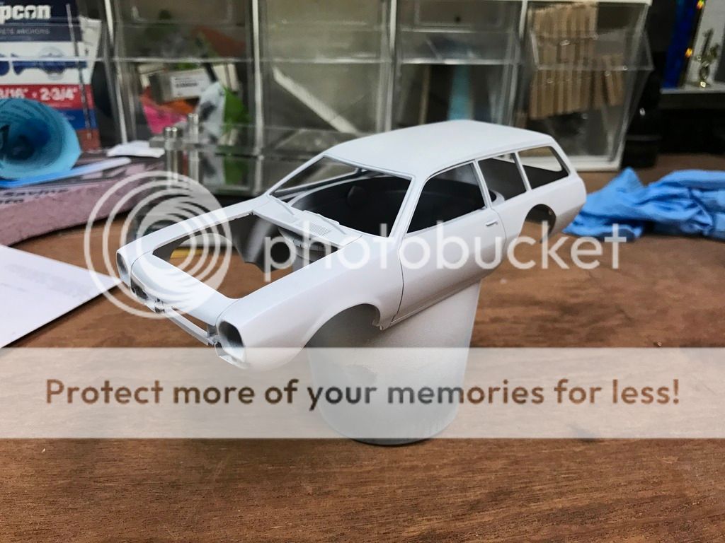

Impalow Posted November 21, 2016 Author Posted November 21, 2016 Thank you James and Stephen! I feel like I'm back and somewhat motivated on this bad boy. Body is in white primer and ready to paint, started laying out the panels and then I ran out of masking tape... doh. Oh well, I started working on the engine detail and the clear scoop. Chromed and detailed the carbs... they are still REALLY impressive. Gott'em installed, along with the fuel lines... added some brass bolts and fittings to bring the detail level up a bit. Then I moved onto the clear acrylic scoop... vacformed the top section over a shaped block of acrylic, then the bottom was made flat on the cutter. This little guy was a pain to get formed and assembled cleanly. Its not perfect, but I think it will be okay. I tinted it with tamiya clear blue, and then a coat of future (pics of that tonight)
bobthehobbyguy Posted November 21, 2016 Posted November 21, 2016 Yhat engine is nice. Great job on the clear scoop..
Impalow Posted November 22, 2016 Author Posted November 22, 2016 Thank you guys! I'm really quite proud of that little scoop, for being just 2 pieces it was quite a challenge. Got it tinted last night, then gave a coat of future to make it shiny and more transparent. and finally temporarily installed so you get the idea. its going be one of the last things attached to hopefully avoid buggering it up. I then ventured over to the lathe and made some pulleys... Masking tape should be in today so I can get back on the body and painting , I really would like to get the body and chassis cleared over thanksgiving weekend.

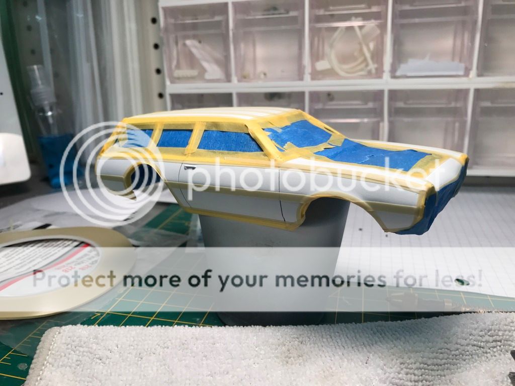

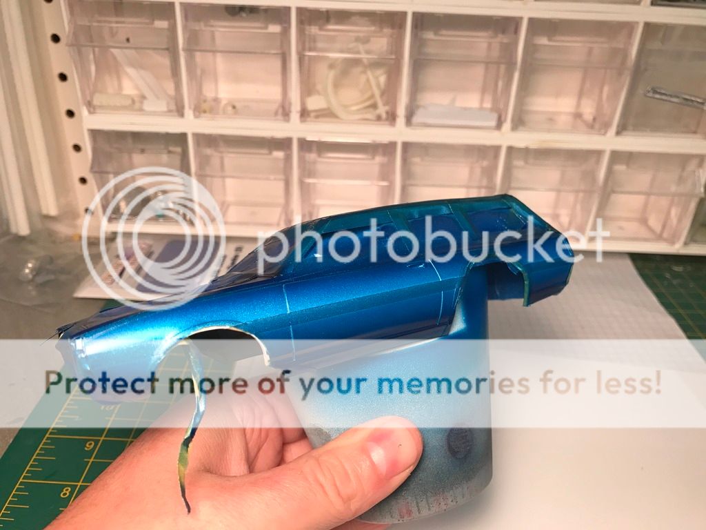

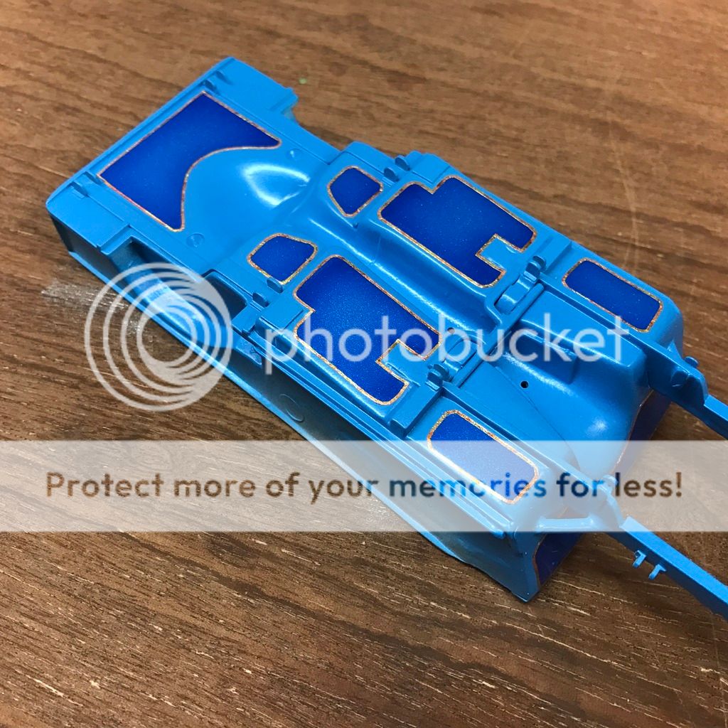

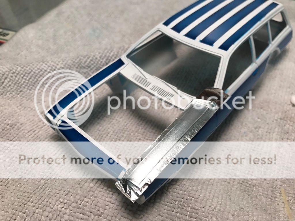

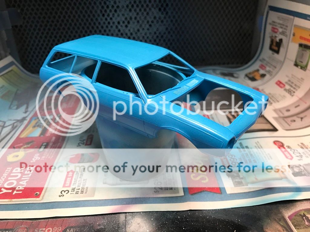

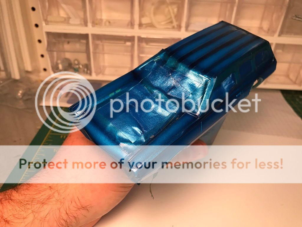

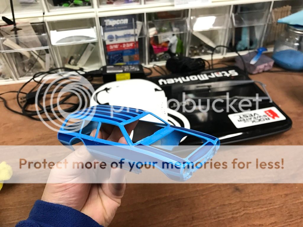

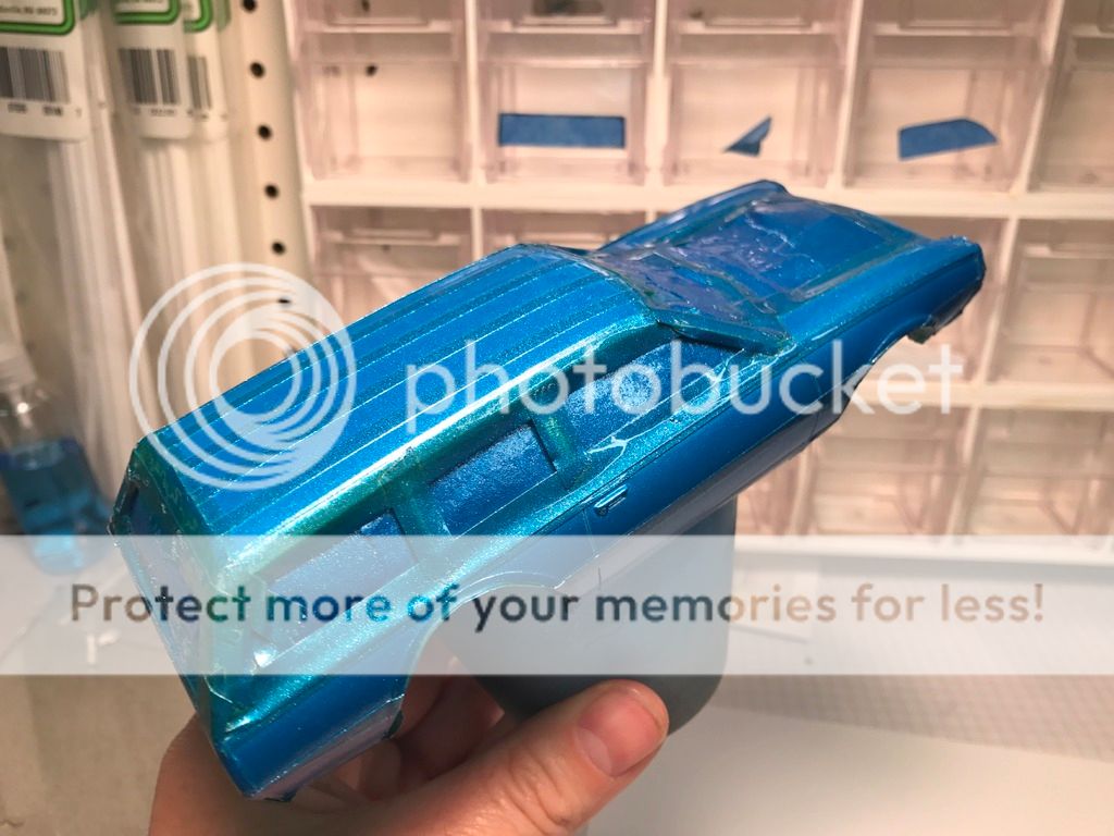

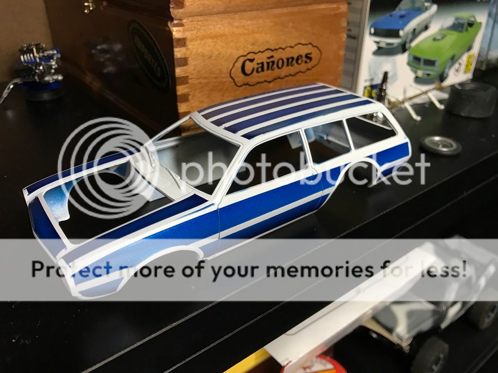

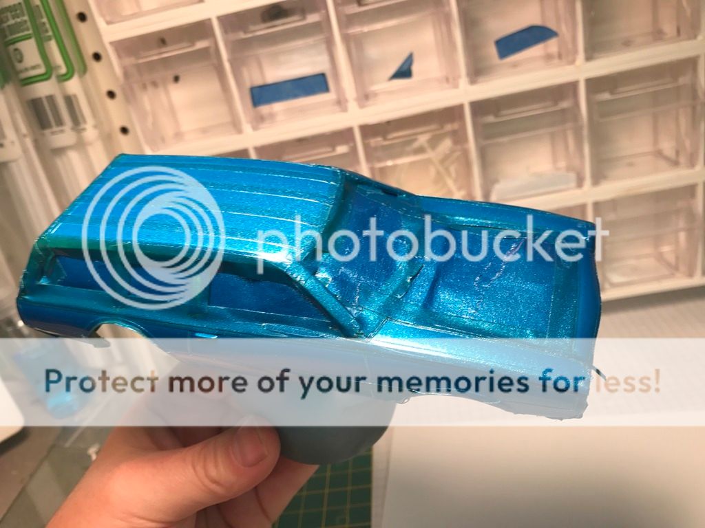

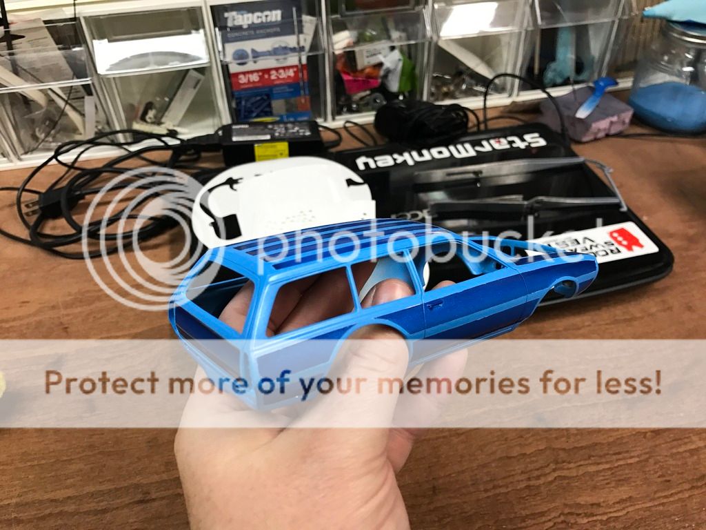

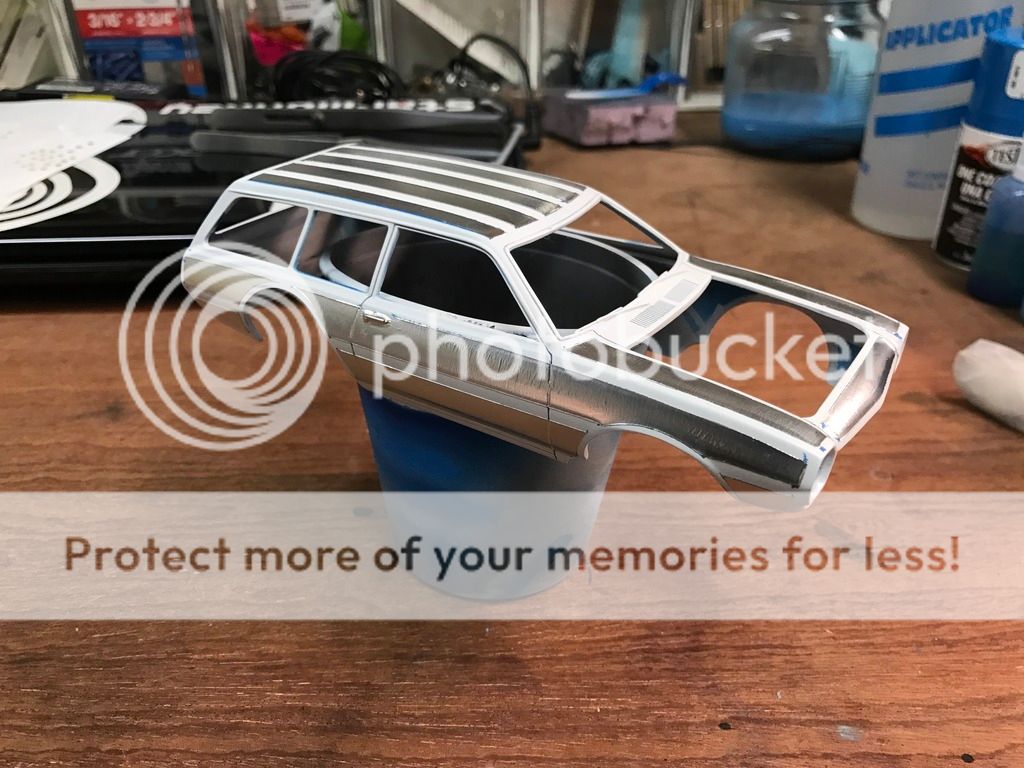

Impalow Posted November 28, 2016 Author Posted November 28, 2016 Always amazed by your creativity and your ability to pull off your ideas. Looking forward to seeing this one in person! Thank You John! I'm also excited to get this one all together and see how it all works. I did get the paint all done this weekend, took some time but the effect is what I intended... and that makes me happy. Shaded around all the panels with transparent blue: Peeled: Back mask all the panels with BMF (paint thickness leaves a nice edge to cut the bmf) : Light Blue sprayed!: Peeled again!: and now im working on the gold leaf outline... got all of the top surfaces done, next up will be the sides.
cobraman Posted November 28, 2016 Posted November 28, 2016 Body looks great ! That must have taken some time.
Lowlife ! ! Posted November 29, 2016 Posted November 29, 2016 Man thats a cool paint job ! Clever idea masking up again with BMF, must have taken you ages but well worth the effort ! Love that gold leaf, how do you lay that down without it snapping ?? You know I'm a fan of your work Eric, looking forward to more 'show cars' from you....
