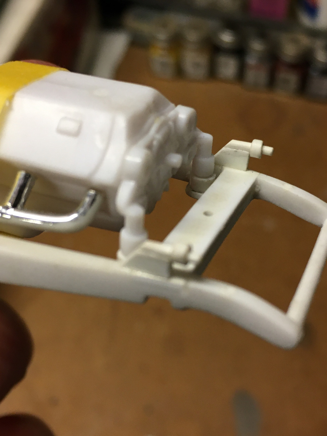

I also reworked the trans mount area of the frame K-member by trimming off the little hump with bolt detail and sliding it forward under the actual trans mounting pad then removed the rest of the unneeded rear hanging mass for a cleaner look. A loose K-member is shown for comparison.
