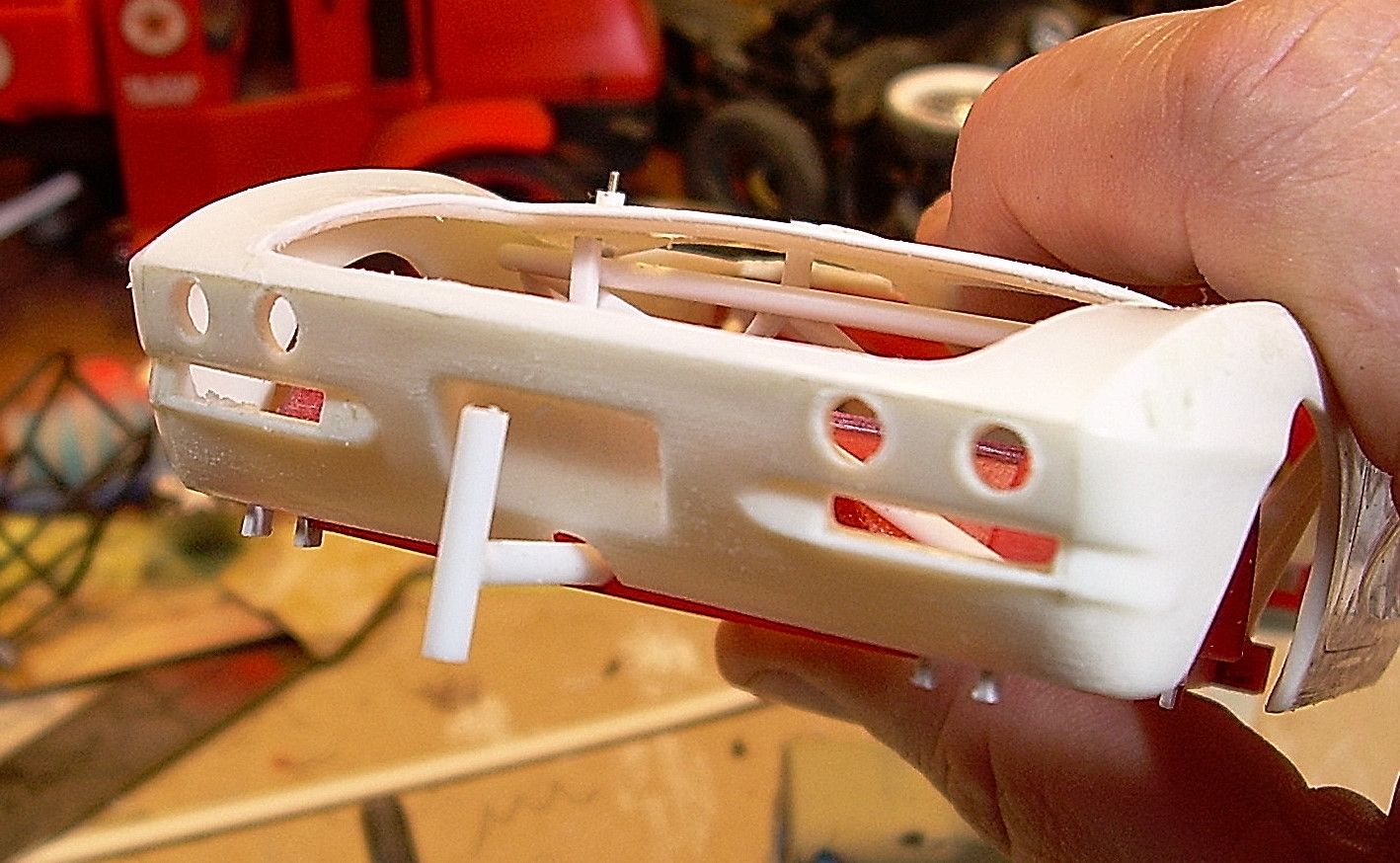

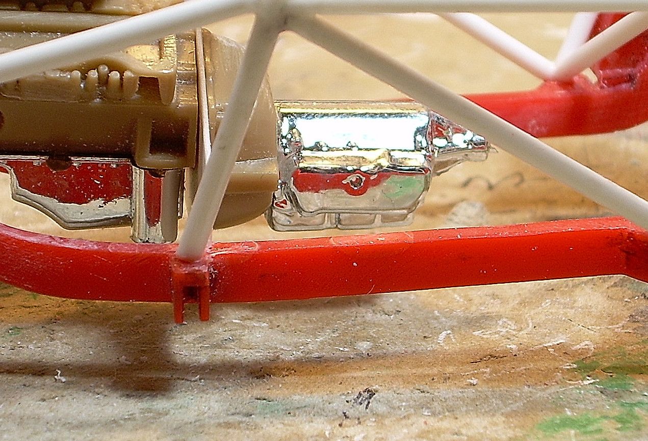

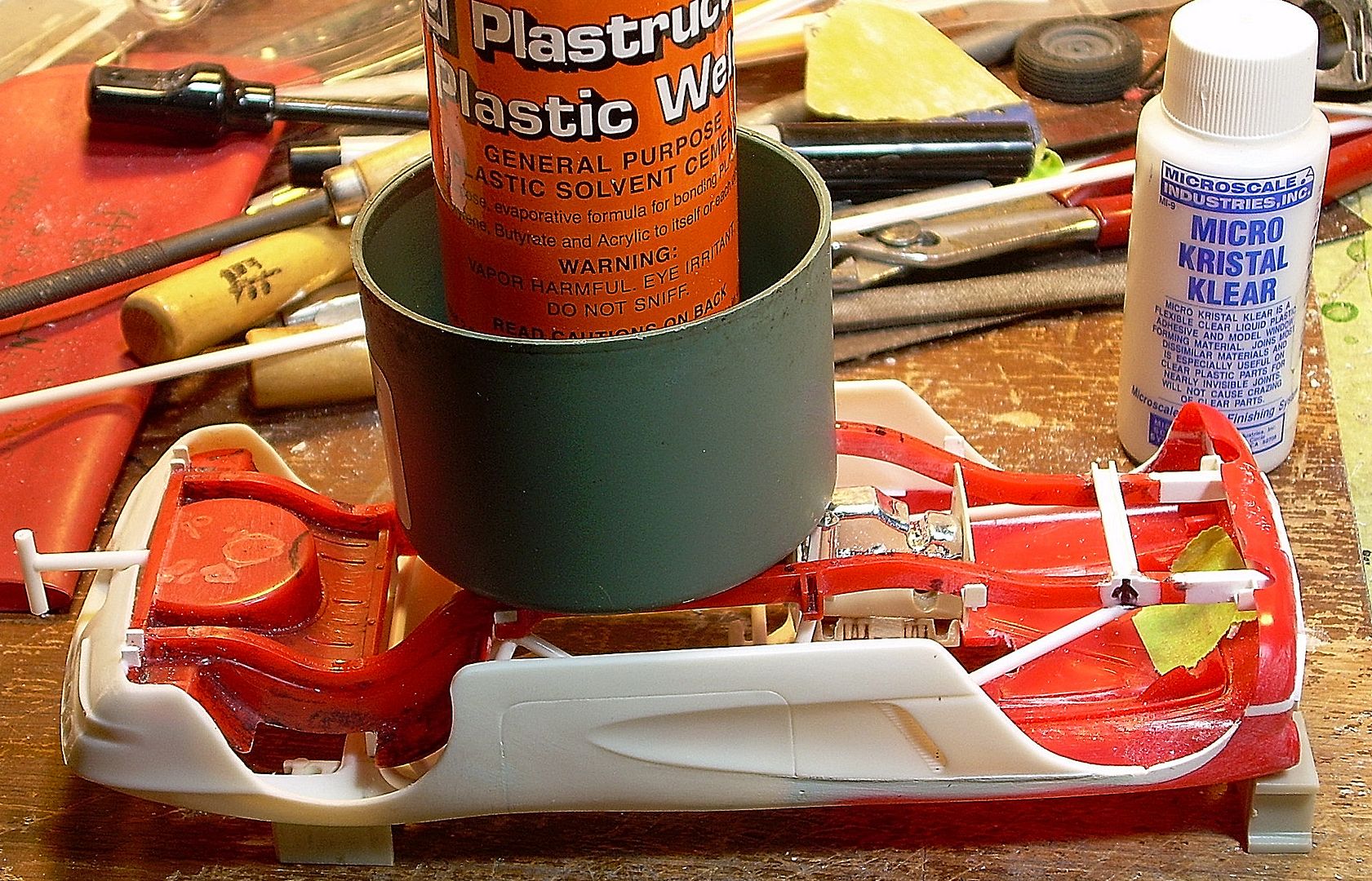

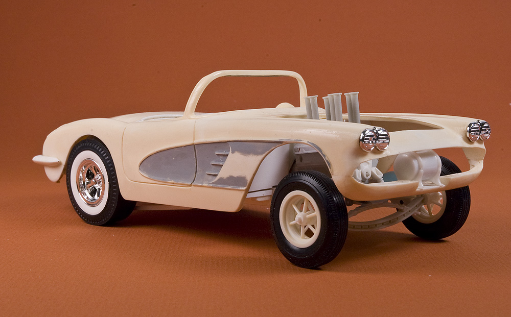

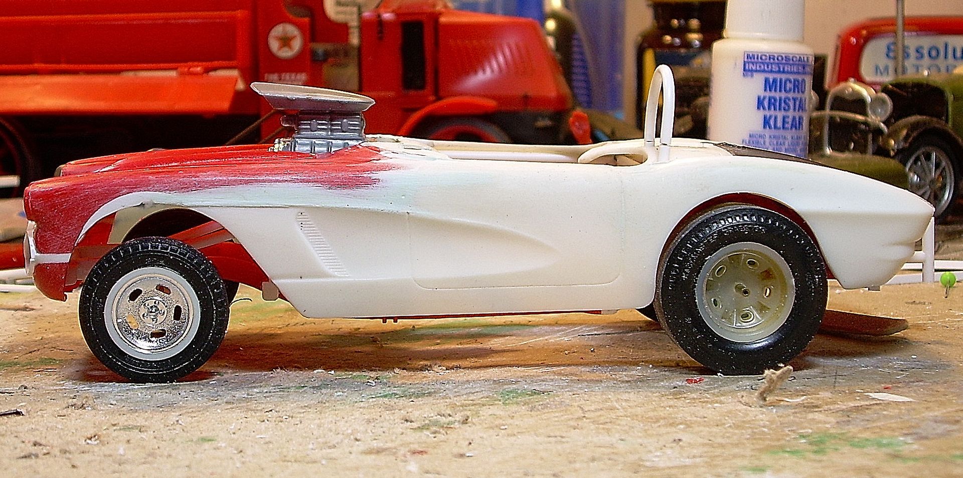

Ace-Garageguy Posted April 27, 2017 Author Posted April 27, 2017 Is there a tutoial on your glassing process? No, but I'm working on a potential magazine article. ---------------------------------------------------------------------------------- With the edge of the decklid opening finished and fitted, she looks like this. Nice and tight, and more symmetrical than the kit-delivered scribed line. I finally decided to go with parallel semi-elliptical springs all around, so I made up some spring hangers on the chassis, and started scratching a straight front tube-axle. Also decided to go with a B&M Hydro-Stick, after making certain it would be period-correct. Tube-axle coming along. All the scratchbuilt springs (they will all get more leaves) and brackets / hangers in place on the chassis for fitup. Made up a pushbar. Gluing the body to the chassis with removable glue, to use it as a jig to get the centers of the axles in exactly the right place. Checking final stance one more time. I really like this angle. 1
Snake45 Posted April 27, 2017 Posted April 27, 2017 Great sit! The front's not jacked up nosebleed high, like far too many seem to like to do it.
Ace-Garageguy Posted April 27, 2017 Author Posted April 27, 2017 Great sit! The front's not jacked up nosebleed high, like far too many seem to like to do it. Yeah, well...what can I say... Coming along nicely. Thank you sir. I STILL need to deal with triangulating that bay after the rear end and lift bars figure out where they want to go.

Ace-Garageguy Posted April 30, 2017 Author Posted April 30, 2017 Guilty as charged! John, I REALLY like that thing, and it's easy to see why so many people tend to build the nose-up attitude the cars assume at launch. It looks aggressive and fast, but to me, without a driver in the car so it appears to be under control (not static) the nose-up is just wrong (though your little Corvette isn't as exaggerated as some I've seen). Comes from a lot of time watching gassers launch during my misspent youth, I guess. My old brain is wired to expect to see models that look like what actually was.
Ace-Garageguy Posted April 30, 2017 Author Posted April 30, 2017 I like everything about this build, except the nose. It's to low, should be higher for a gasser look! See above.
Casey Posted February 19, 2018 Posted February 19, 2018 On 2/27/2017 at 10:05 PM, Ace-Garageguy said: No problem though. A strip of .030" styrene applied all around and carefully shaped will fix it, and allow me to correct the slight asymmetry of the kit opening-line in the process. It seems a new set of rear wheels snuck into the slicks without being mentioned... I hope you didn't part out a Revell "double" kit just to get those. On 4/26/2017 at 8:14 PM, Ace-Garageguy said: Also decided to go with a B&M Hydro-Stick, after making certain it would be period-correct. Which kit/parts pack is that B&M Hydro Stick from?
Ace-Garageguy Posted February 19, 2018 Author Posted February 19, 2018 5 minutes ago, Casey said: It seems a new set of rear wheels snuck into the slicks without being mentioned... I hope you didn't part out a Revell "double" kit just to get those. Which kit/parts pack is that B&M Hydro Stick from? 1) Those wheels are in one of the parts packs that I bought years ago before the prices got really stupid. Same as a set in one of the Revell double kits...as you obviously know. The 5-spoke Americans always get used first from those old sets, and the ones shown are often leftovers when you find a partial sprue. The R&M repop number is P-147. 2) That particular B&M trans in in the old Revell Cadillac "354" (there never was a factory 354) parts-pack.
