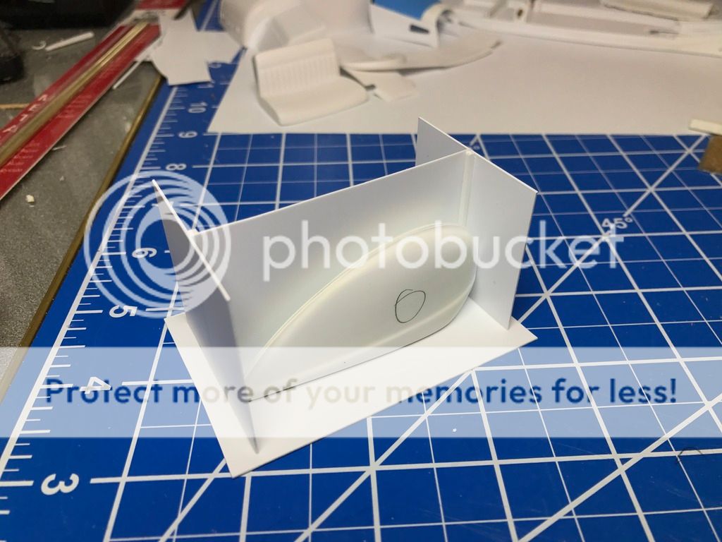

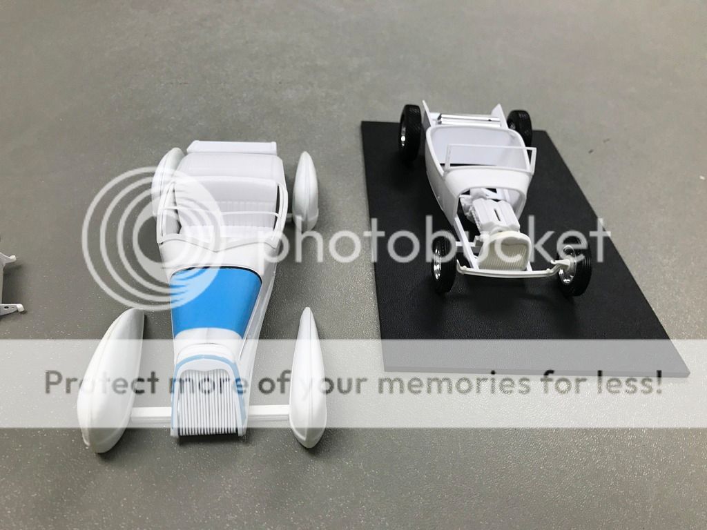

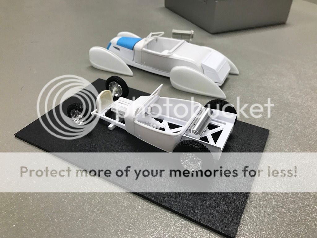

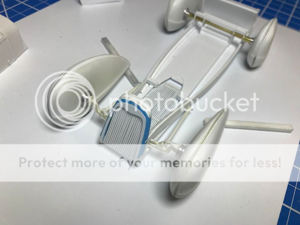

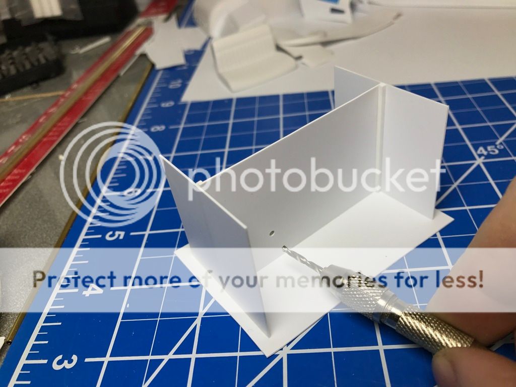

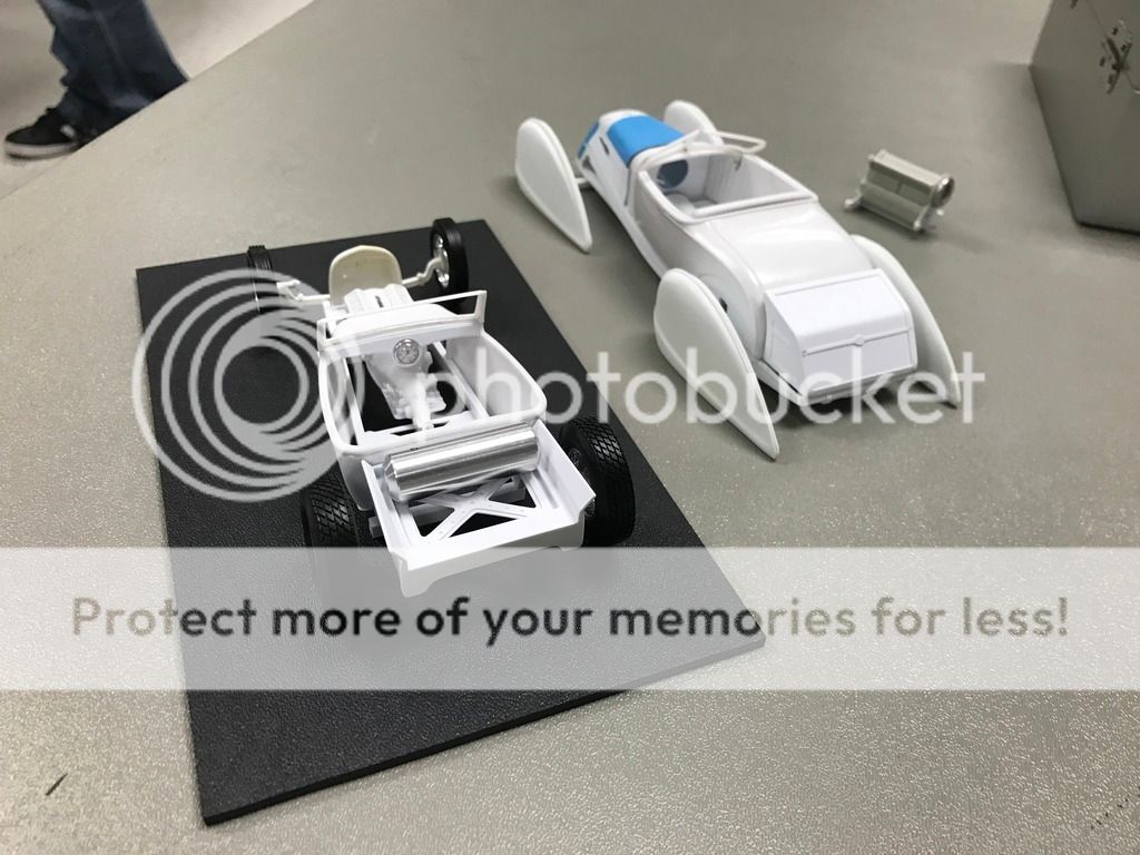

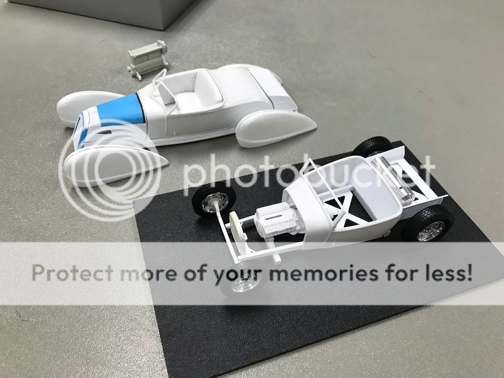

Impalow Posted January 18, 2017 Author Posted January 18, 2017 Thank you guys! If you needed a "plan B", you might consider tying the front and rear fenders together with running boards, and blending them into the A body like on the Bugatti at the beginning of your thread. This could be done without altering the body shell. The very heavy chrome along the sides adds a lot to the art deco look. Thanks ted that is a good idea...for some reason i want to try and keep these freestanding fender pods... But that is a great plan B if i cant get the alignment and support correct on the freestanding pods. Last night was the NCAM meeting, Andy and I took our WIP projects to show off to the club and for an excellent photo opportunity. Hard to believe these started as the same "kit".. hahahah Then on the way home my dad and I stopped for dinner... we were discussing how to mount the fenders.. and getting all the alignment correct. I was expressing my regret in not putting an axle center "boss" or something in the 3d print before vac forming. Since the fenders are an organic shape, they are going to be hard to drill all the same point for the axle. My dad said to make a jig, and a few quick napkin sketches later, we had it figured out. When i got home i had to try it, busted out some scrap styrene and it worked perfect. I know its just four holes, but i had been fretting over this. Those holes determine the ride height, as well as the fore-aft position of the fenders all of which would bother me if not close to perfect. Fender Drill Jig Fender in jig. Drill... Repeat x3 (making sure i had 2 lefts and 2 rights) Next up is to make some adapters on the lathe to attach those screws to the front and rear axle.... feeling a bit better about this.

bobthehobbyguy Posted January 18, 2017 Posted January 18, 2017 Brilliant idea of making the jig for drilling the holes. Just an amazing project.

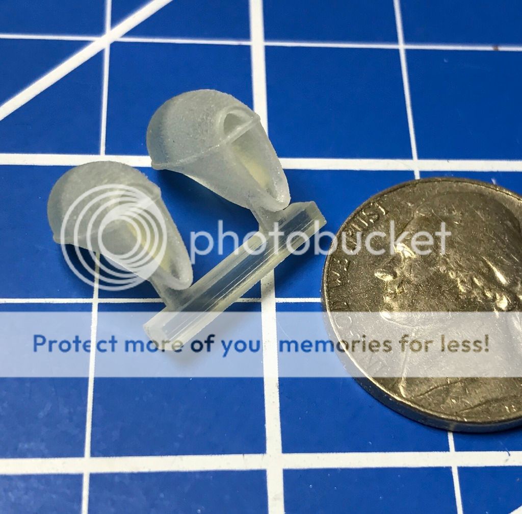

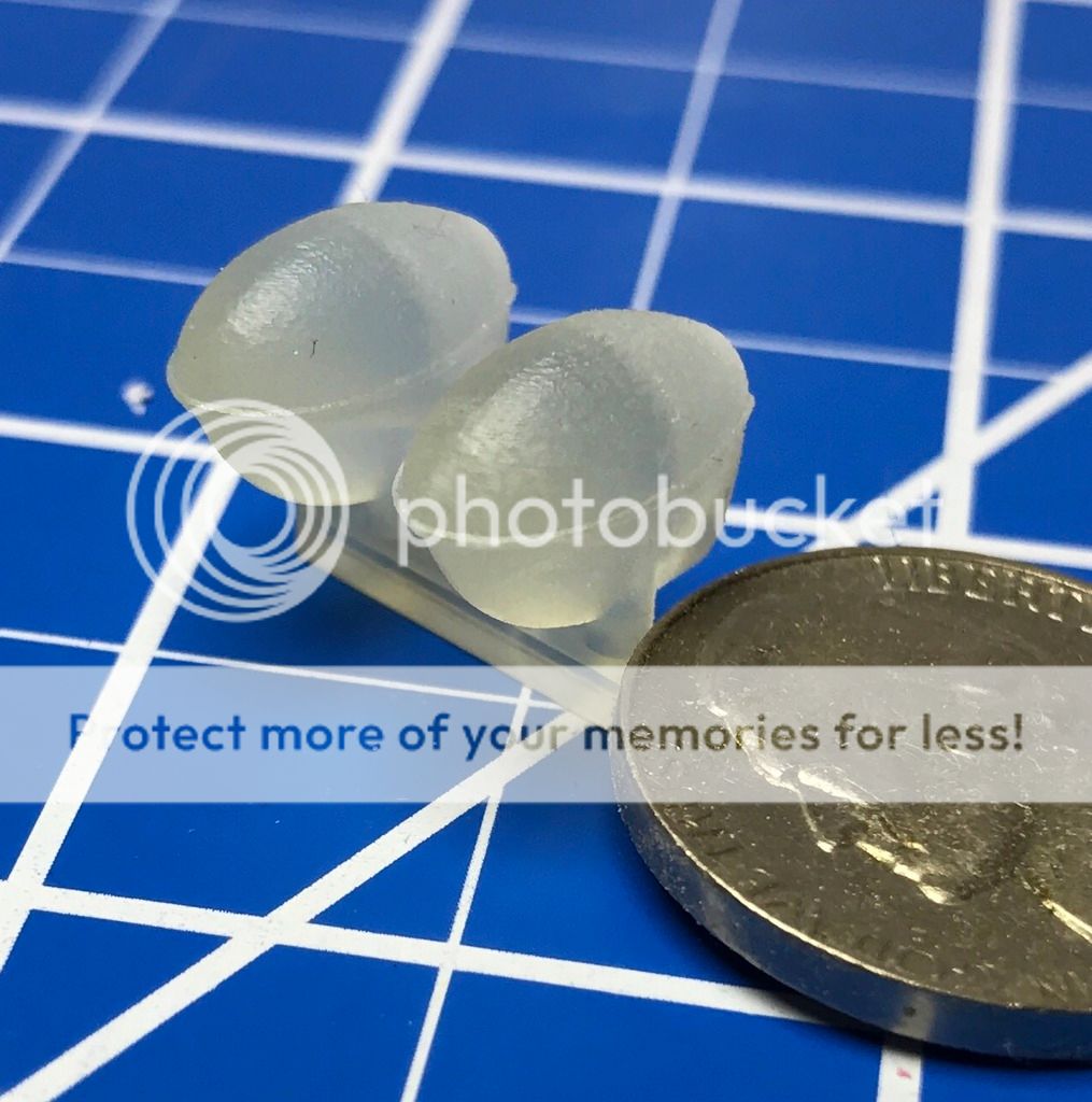

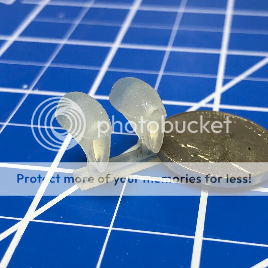

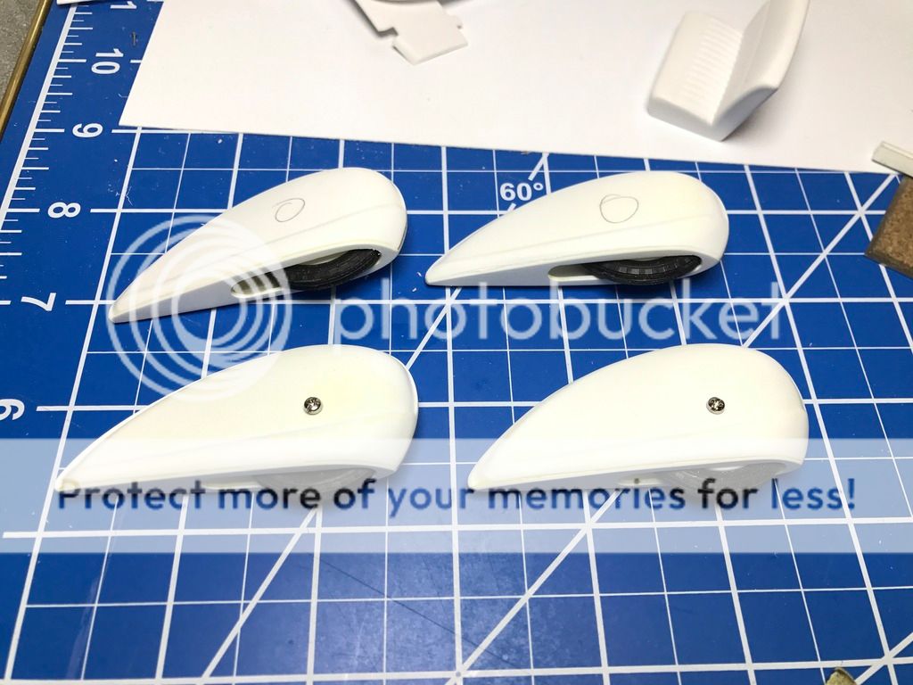

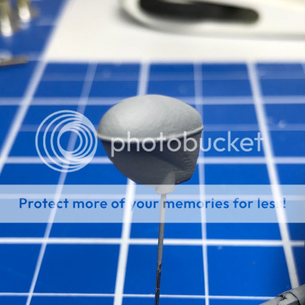

Impalow Posted January 21, 2017 Author Posted January 21, 2017 Shapeways prints showed up! wayyyyyyyyy better than I expected... Im totally stoked and can see this as a huge opportunity to be more creative on future projects. Straight out of the box. Removed from the block, drilled for pins, and one coat of upol primer. Here is the link to the shapeways store http://shpws.me/NepY these examples were done in the "extreme detail frosted acrylic", they are also printable in the "Ultra Detail Frosted Plastic which is about 2.00 less expensive and now has a 3 day turnaround time. (in hindsight i should have made a set of each in each material to see the differences, oh well, maybe the on next part)

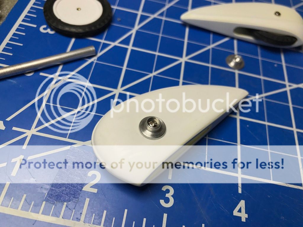

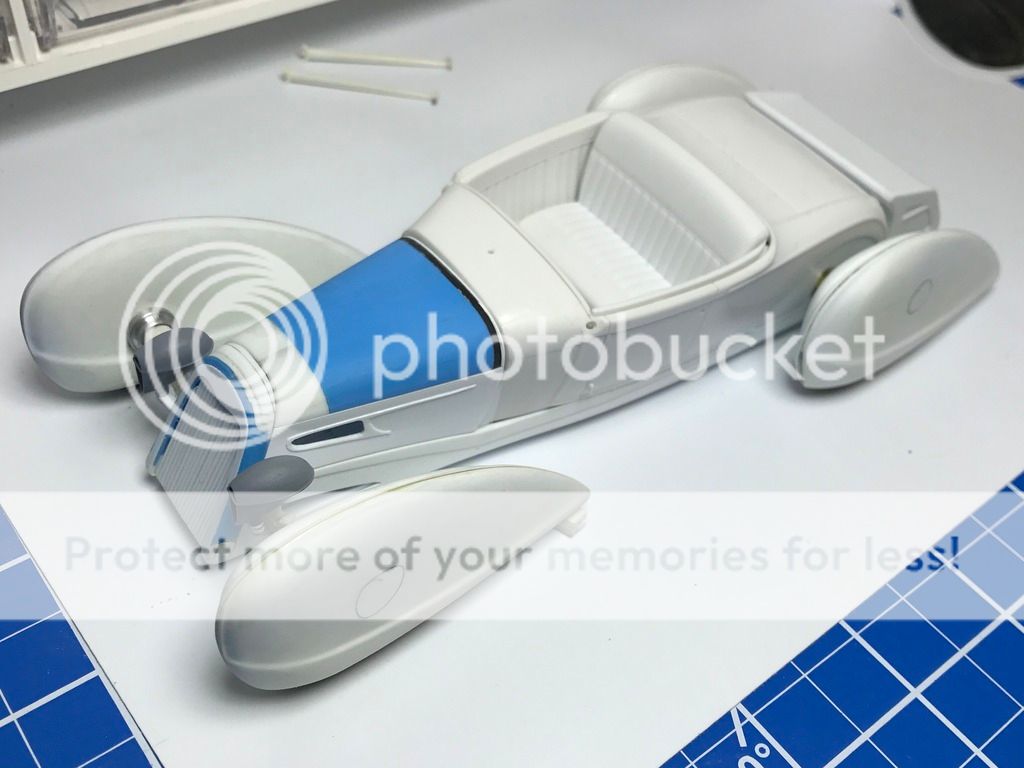

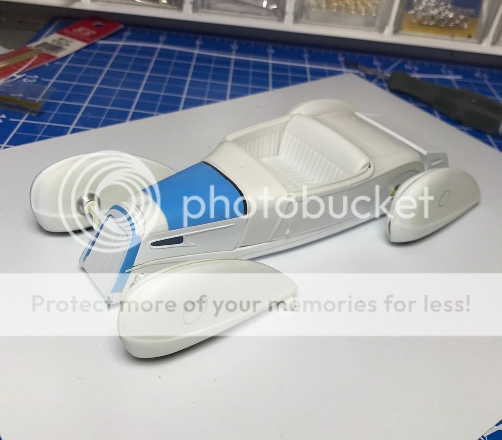

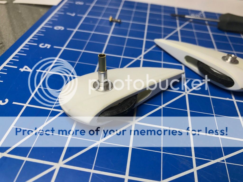

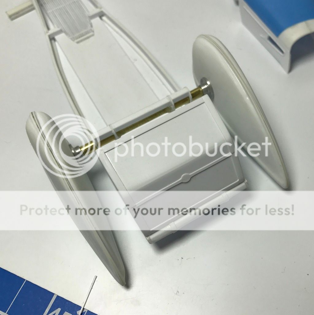

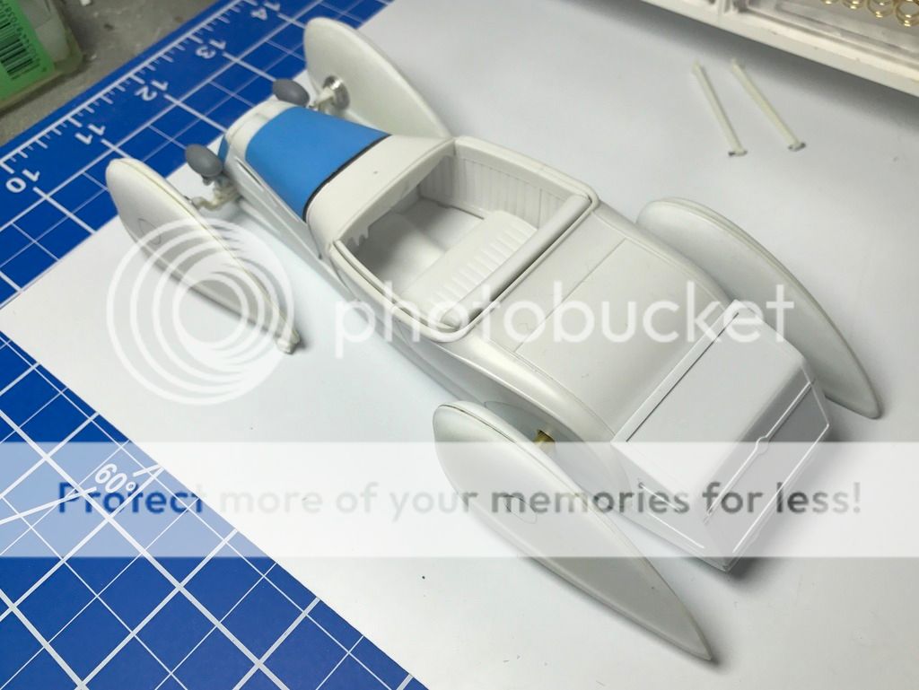

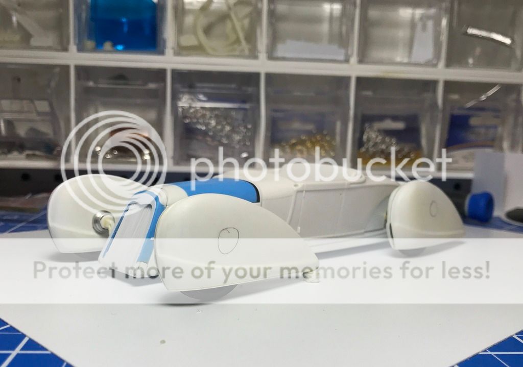

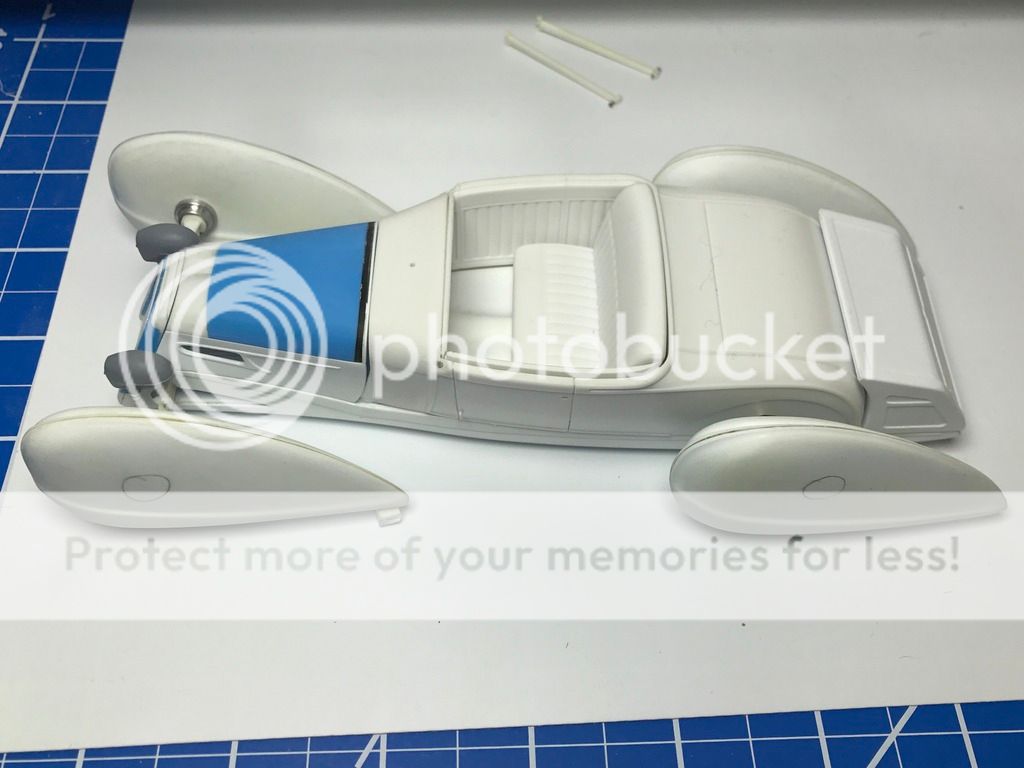

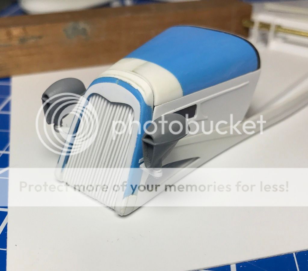

Impalow Posted January 23, 2017 Author Posted January 23, 2017 thank you guys! I made a little progress over the past few days and thought i would share. Turned some rear axle mounts on the lathe installed the rear axle then a made another one and got the rear freestanding then over to the front...Same deal... turned an adapter and used the the 29 kit axle. then another one Finally a freestanding Model A Streamliner...(well kinda, the back of the front fenders wanted to kick in, so theres a little block for now, until i epoxy it finally)

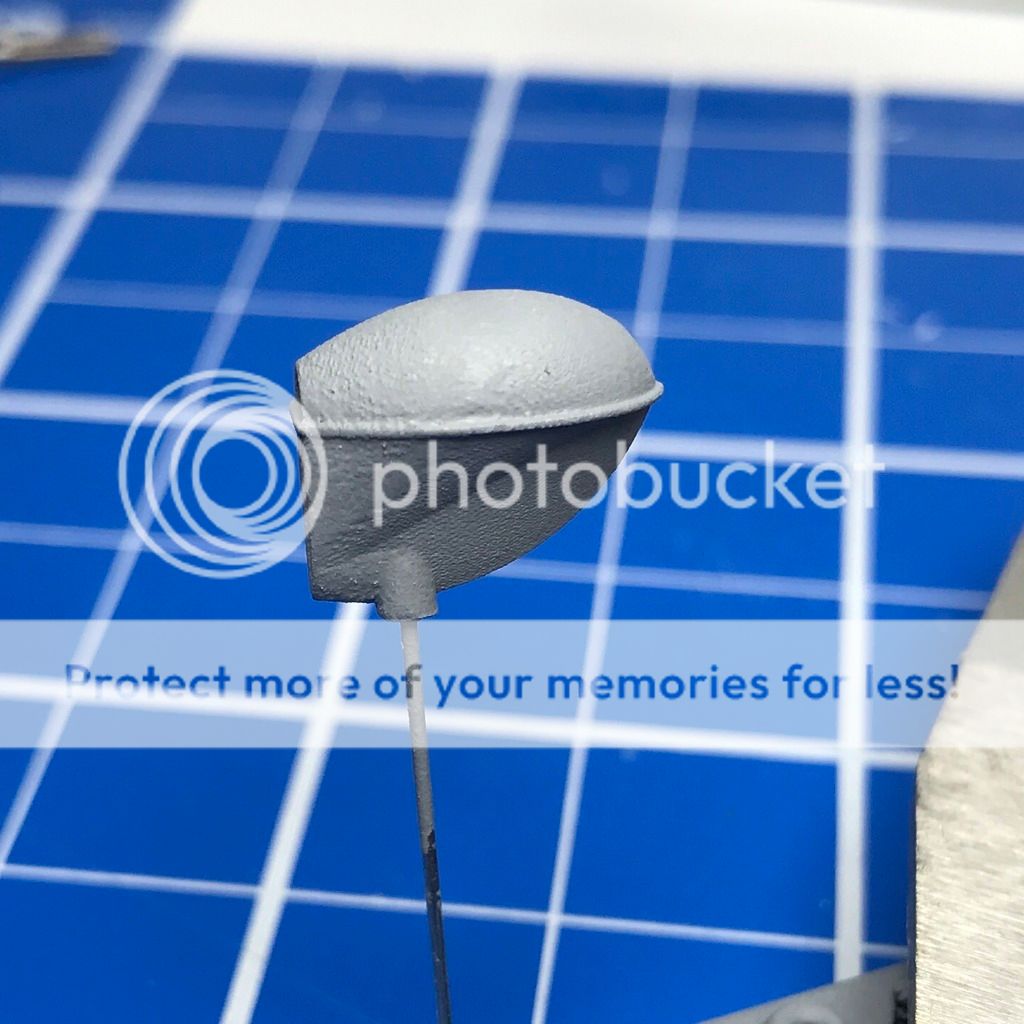

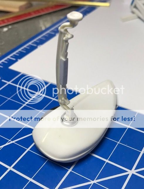

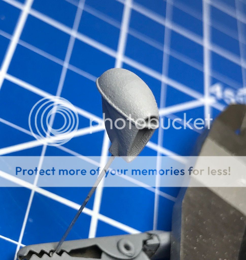

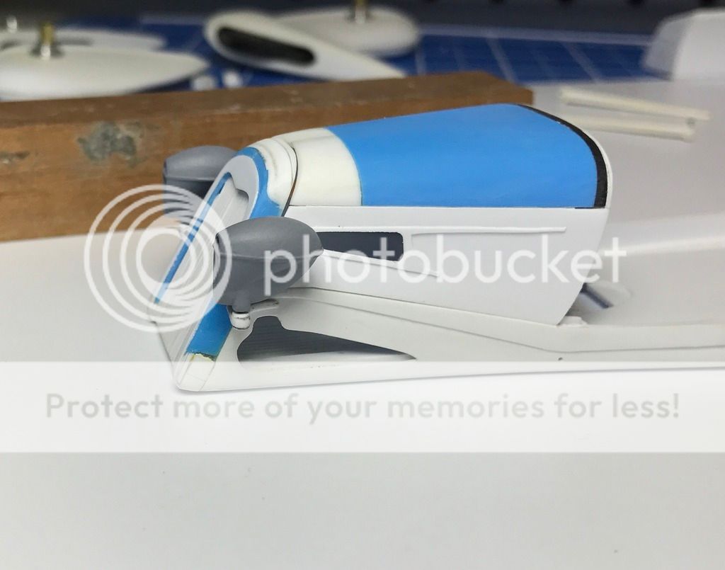

Impalow Posted January 23, 2017 Author Posted January 23, 2017 next up headlights and mounts Made these the "old-fashioned" way just drawn and hand cut on .020 then stuck some 1/8" circles from my hole punch top and bottom Then sanded to nice shape, drilled pinned and installed Headlight got a light sanding and then another coat of primer... almost ready for paint Some minor frewall work and trim to add... but im getting close to primer... and that makes me happy

misterNNL Posted January 29, 2017 Posted January 29, 2017 Question.When these lights are delivered from Shapeways are they ready to paint and install,and if you don't mind sharing,what do they cost?Thanks!
