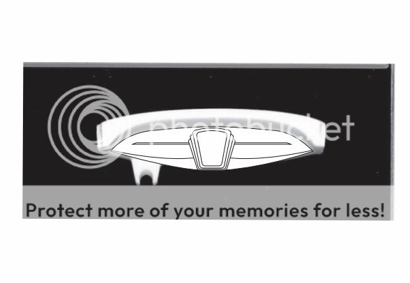

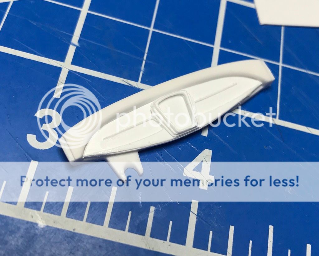

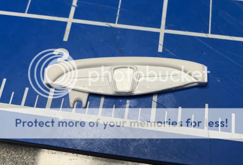

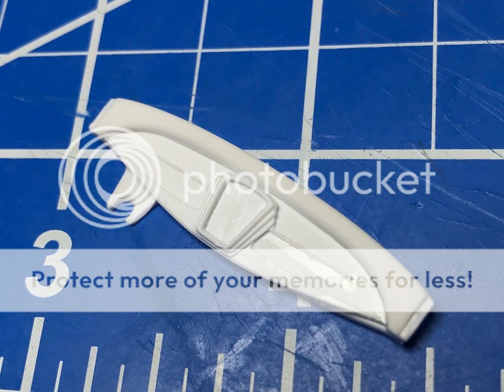

Impalow Posted January 30, 2017 Author Share Posted January 30, 2017 (edited) Question.When these lights are delivered from Shapeways are they ready to paint and install,and if you don't mind sharing,what do they cost?Thanks! Hey Tom! Sorry, I got some sort of nasty cold that has sidelined me for over a week here, anyway... First off cost wise... 9.00 or 11.00 for a set.. plus shipping... 9.00 is Ultra detail and 11.00 Extreme detail (my photos show the extreme detail option) I know that's a bit pricey but...Full disclosure... shapeways sets the pricing on their parts and the shop owner can add markup... I have less than a dollar of markup added to these parts. Here is the purchase link: http://shpws.me/NE9J As long as i don't lose or ruin one in trying to finish this project, I will have an extra set with me at Toledo for you to see in person. The first picture i posted is straight out of the bag from shapeways: They have some rough texture to them, and they have a molded in joiner block on the bottom. I was able to cut that off with a pullback saw, and then drill the mounting post for a pin. It was at this point i decided to just shoot them with primer.. since the frosted material is hard to see the texture. this is just primer and no sanding After letting the primer dry I sanded them with some 400grit paper, and then reapplied primer. This photo shows where they are now.... i'm predicting one more light sand and prime and they will be ready for alclad. Edited January 30, 2017 by Impalow Quote Link to comment Share on other sites More sharing options...

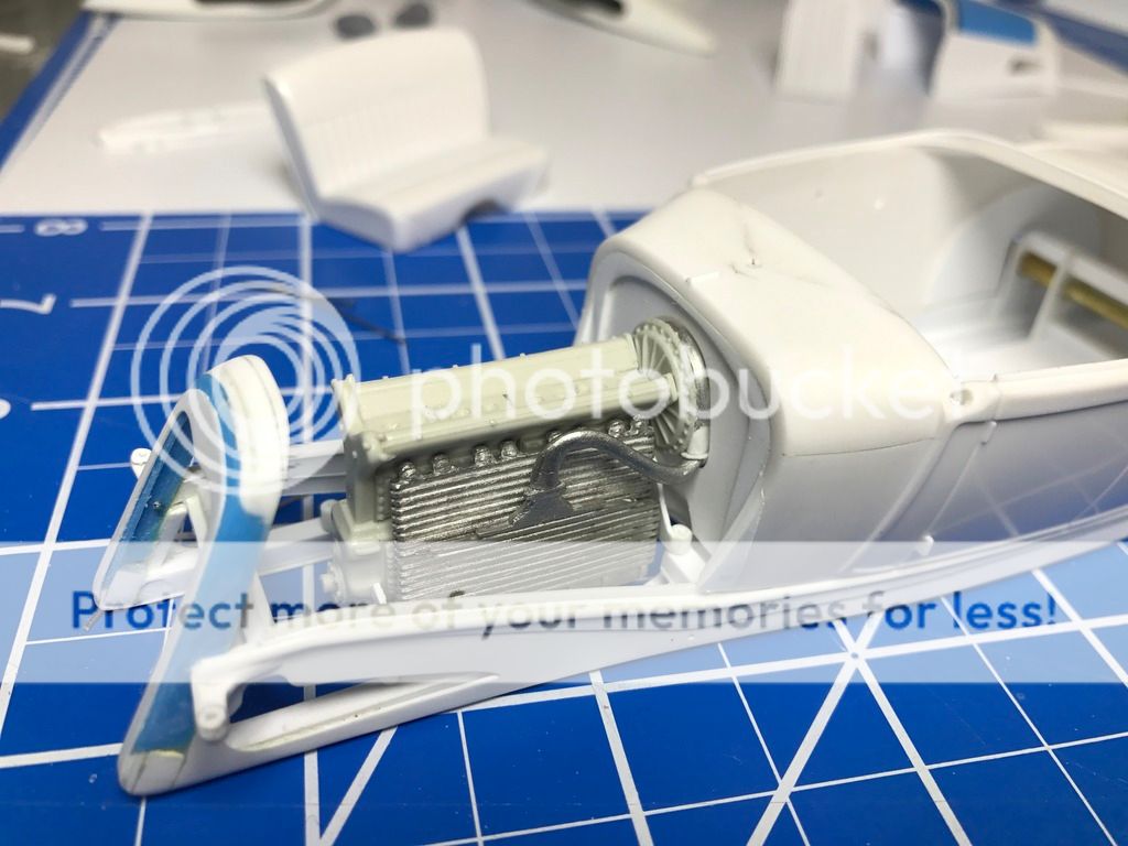

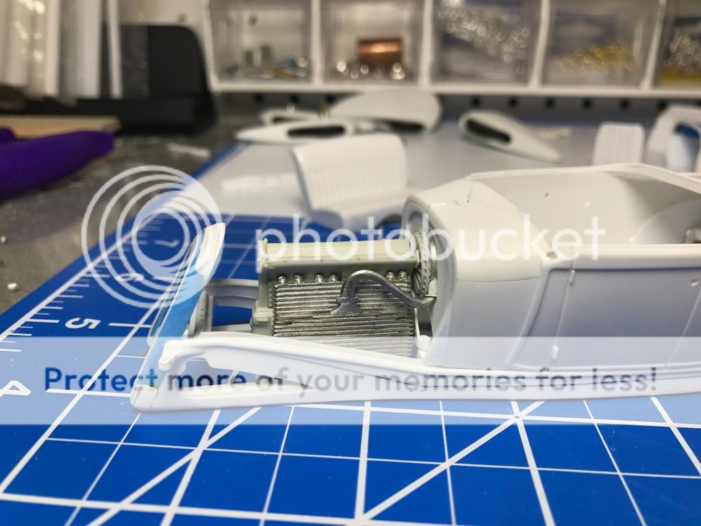

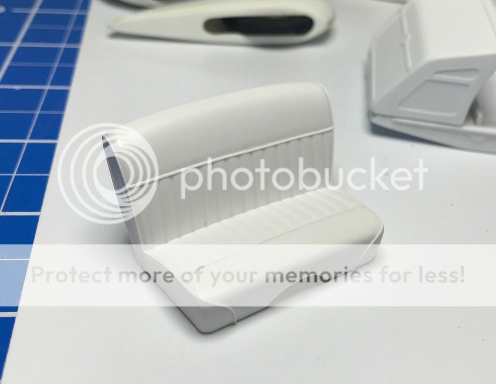

Impalow Posted February 2, 2017 Author Share Posted February 2, 2017 Thank you guys! Got the intercooler cleaned up and mounted last night, as well as modifying the firewall for the supercharger... I've never really worked with white metal parts before, it was pretty fun... hopefully when i get it painted and washed its cleaner than it appears now. I also added some piping/welt to the seat for a little extra detail. Exhaust is tonight... I hope. Quote Link to comment Share on other sites More sharing options...

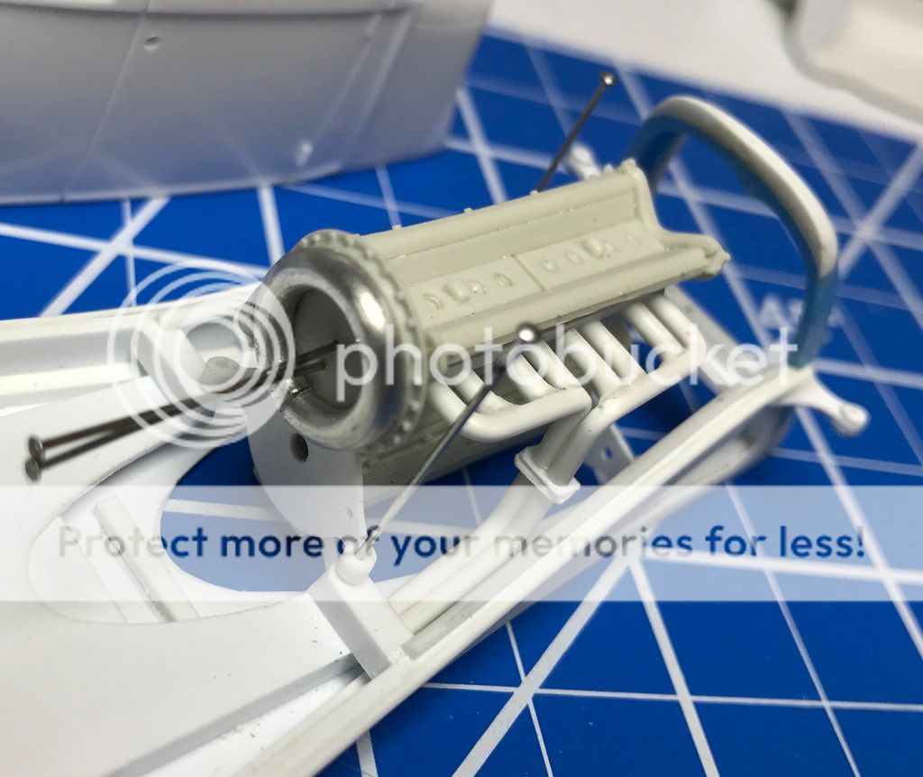

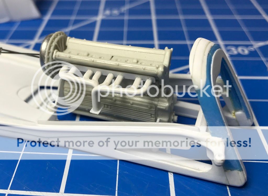

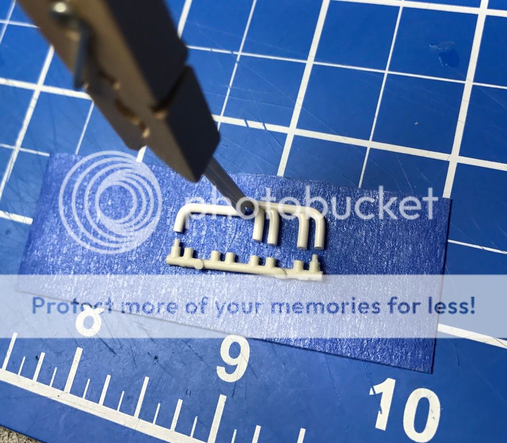

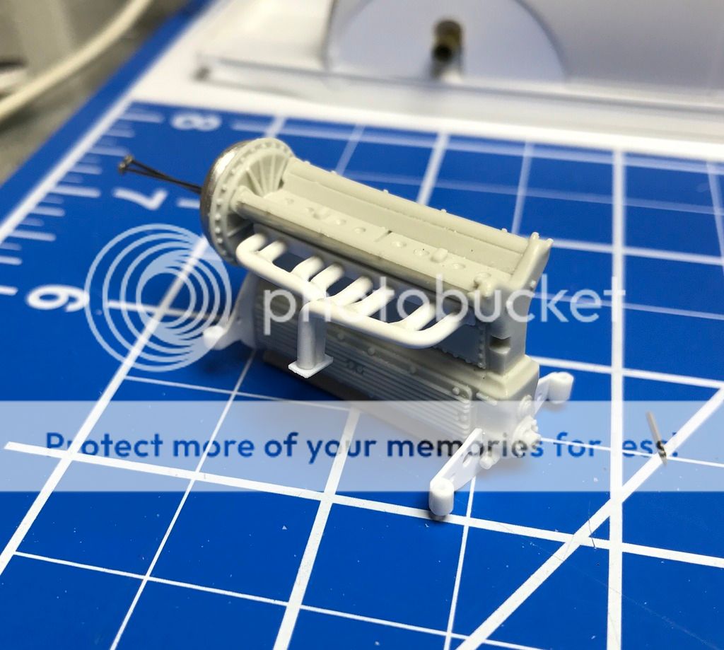

Impalow Posted February 4, 2017 Author Share Posted February 4, 2017 I made some progress on the header/and midpipe tonight. I'm really happy with how it turned out. First I used the extra intake manifold in the resin motor kit to make sure I got the port spacing correct got it all bent up and made some flanges out of .010 then the dual midpipe that runs back into the chassis plate. Quote Link to comment Share on other sites More sharing options...
Art Laski Posted February 4, 2017 Share Posted February 4, 2017 Continued good work! Fantastic job in the headers. Quote Link to comment Share on other sites More sharing options...

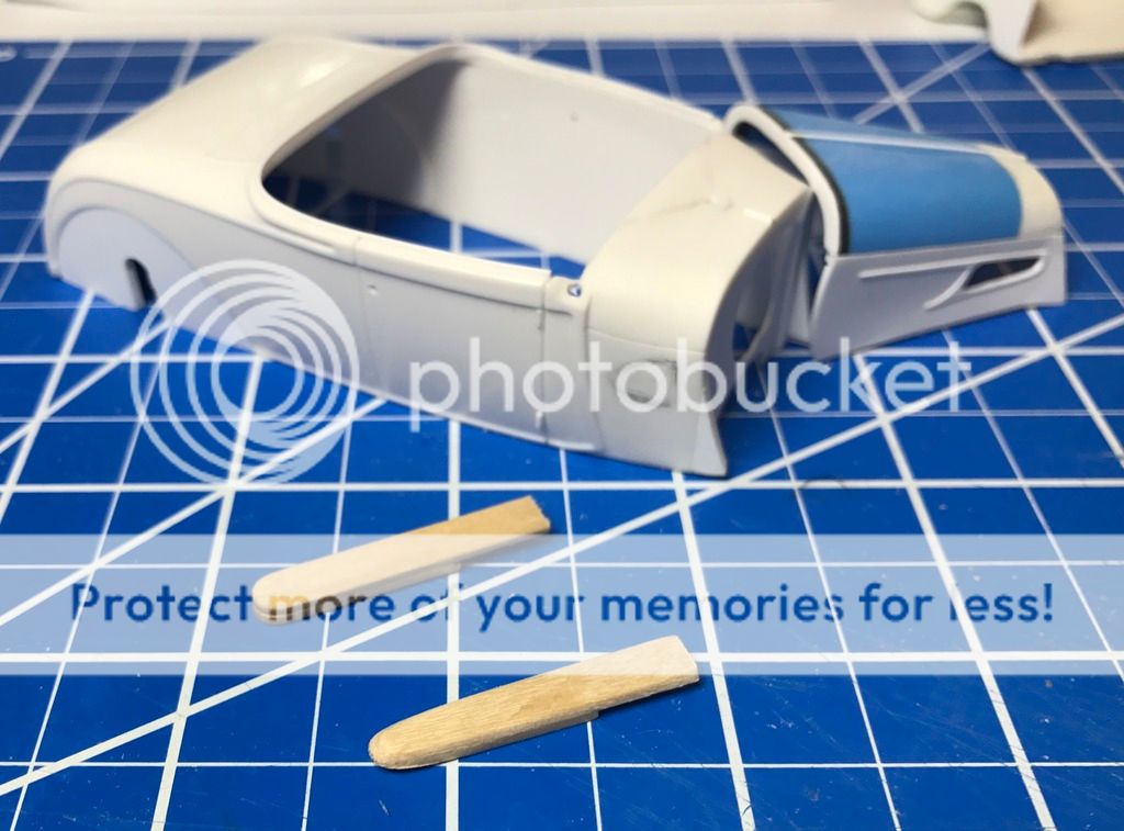

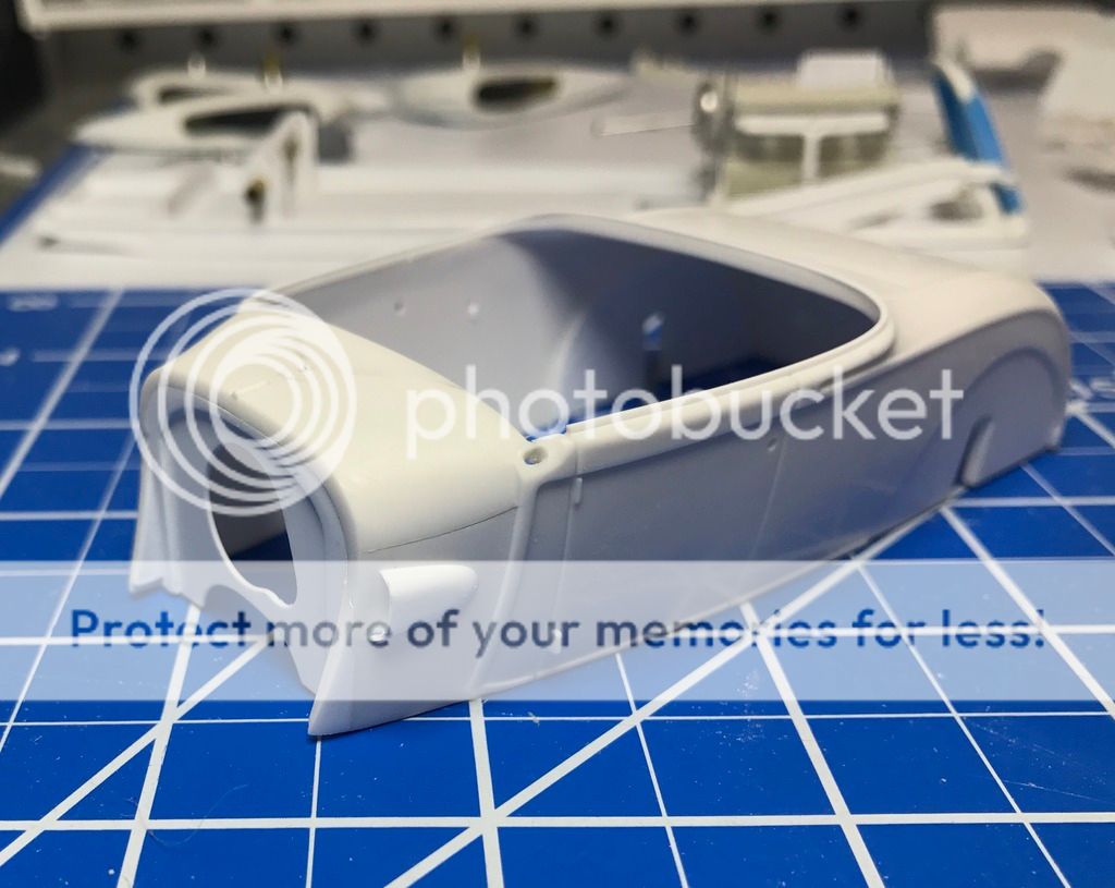

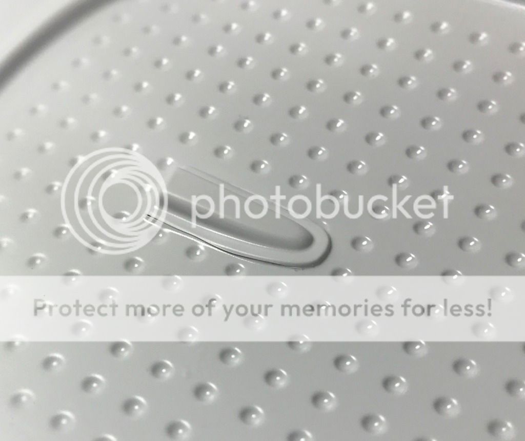

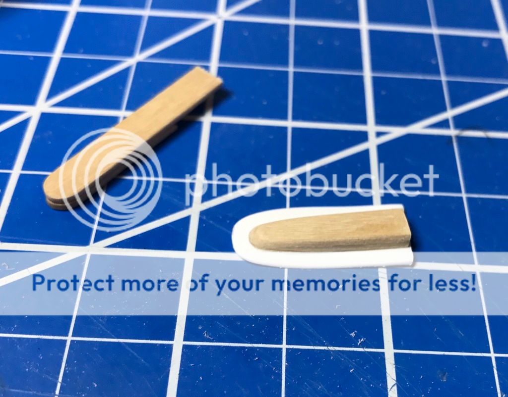

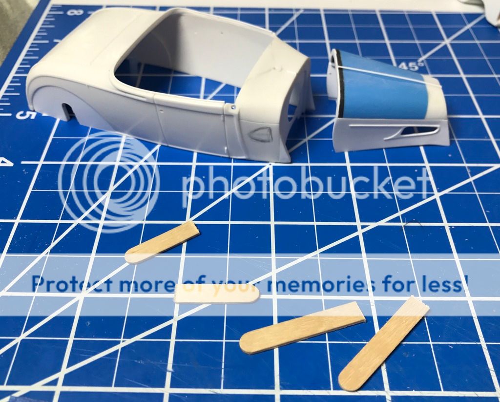

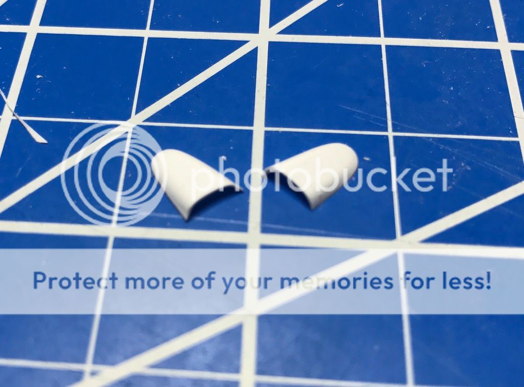

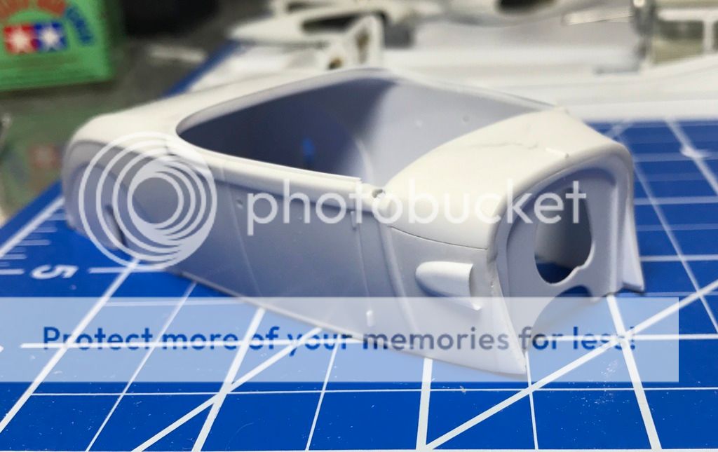

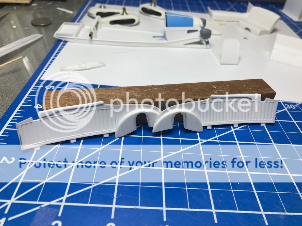

Impalow Posted February 6, 2017 Author Share Posted February 6, 2017 Thank you all! Your comments and encouragement mean a lot! A little over a month to go... and most of the fab work is done... Radiator, exhaust, interior pedals and trim, and then i should be ready to prime and body work! Yesterday I managed to get the air intake scoops made and stuck on the sides of the cowl. Started with some Starbucks stir-sticks. Glued together and sanded to shape. Added a styrene flange for easy cleanup Vacform Cleaned up and ready to install Installed! Sadly after all this work... I went back downstairs (after the game) and I must have accidentally puddled some glue in the scoops, and it turned them into raisins... I was using a new syringe to apply the glue inside.... couldn't tell how much i applied.... Luckily I have the pattern and can knock some new ones out tonight.... minor set back... no biggie. Quote Link to comment Share on other sites More sharing options...
tedd60 Posted February 6, 2017 Share Posted February 6, 2017 VERY nice job on the headers. As I see it, you made about eight 1/4 round bends, cut what you needed and glued it up. Yeah ... I can steal that! Quote Link to comment Share on other sites More sharing options...
