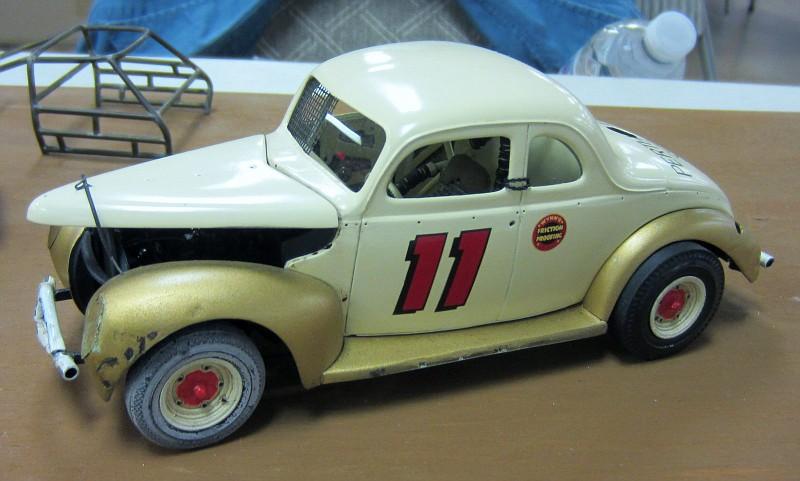

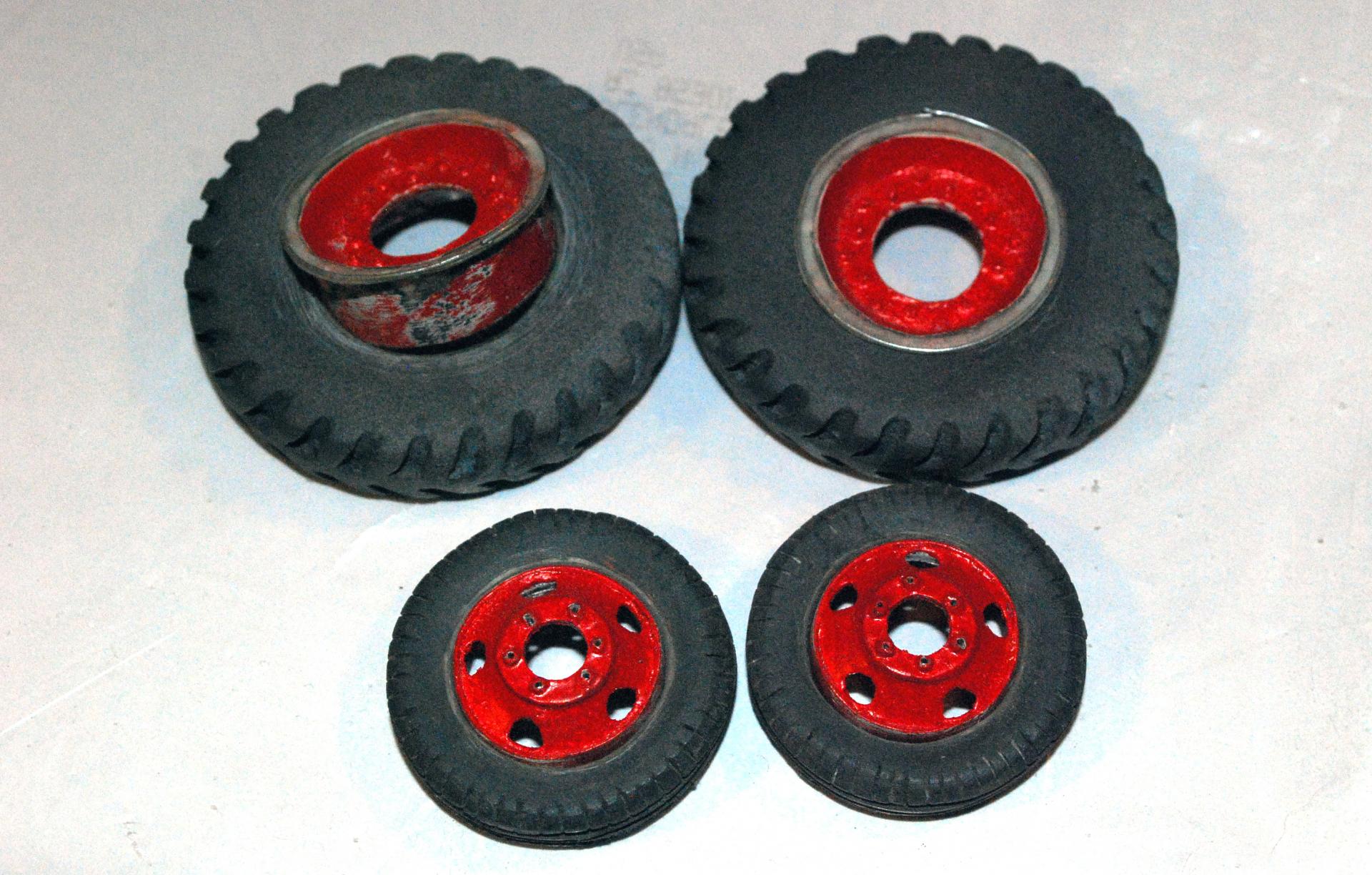

Not being a tooling designer not sure how difficult and expensive it would be versus the PVC molds. The military kits seem to have pretty good results.
Don't see why there would be assembly problems as long as tolerances are accurate. But even if they were molded together, don't see were there would be much problem painting except having to do a bit of masking.
Not completely finished with these, but they're (wheels and tires) made out of matt board and card stock.

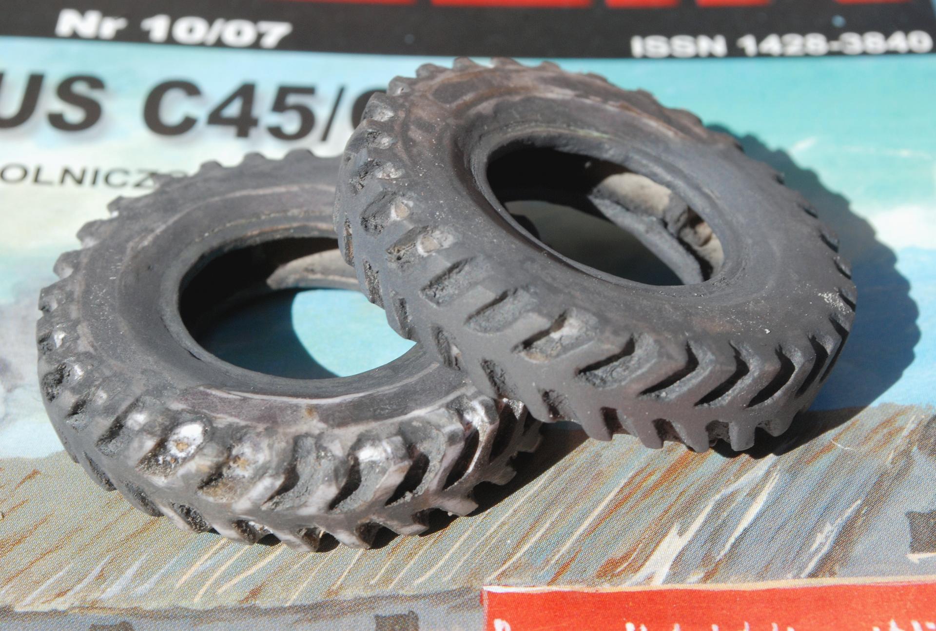

Sliks can, and have been done in the past, but tires with a tread are complicated, cuz you'd have to do the tread in several sections to make it work, see tasca Zundapp KS750 Motorcycle.
http://www.missing-lynx.com/reviews/german/tasca24004reviewbg_1.html

Comparing multi-piece cardboard tires made from several hand-assembled pieces of cardboard to 1-piece molded vinyl tires is like comparing apples to oranges.
I guess because vinyl (and rubber) are flexible (unlike polystyrene which is a hard plastic) it can be molded with complex tread pattern while using a fairly simple mold. At least that is what I gather reading this thread.  But to get the same level of detail in a hard plastic tire would take a complex multi-part mold (which is much more expensive to make).  There also are many  tires out there molded out of resin with very high level of detail but those are molded in rubber molds which makes the process workable. Unfortunately this molding process doesn't work for high-volume production of plastic model kits.

I'm not comparing the cardstock tires to 1-piece molded vinyl tires except to present a solution to the chemical reactions that seem to take place between the vinyl or rubber and polystyrene. I've had old kits with parts burned through by the tires, tires melt into the shelf, or eat the wheel rims off. It seems that chemically there doesn't seem to be a completely positive, workable solution for the problem. If so at that point the other solution is to use a non-reactive compound to make the tires out of. If styrene then for most would require a multi-piece tire like the example that Luc showed or a very intricate, multi-slide tool that would still produce at best a 2 piece tire. Maybe not the most desirable solution, but would solve the problem. If resin, then you're talking about a labor-intensive process. There are military kits that have resin parts in them so it is doable at a price Any of the methods would add to the cost of the kits. So it sort of comes down to pick your poison.
