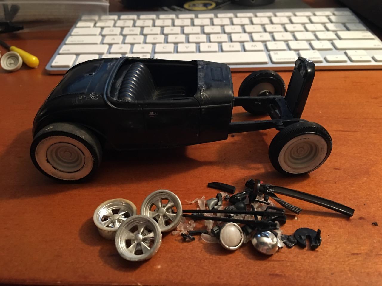

The tires are interesting, I can't tell if the whitewalls were painted or if they came that way. I usually replace the tires on glue bombs like this with the nice AMT whitewall Firestones available recently, but I kinda like these. The Cragar style rims definitely did not come with this kit, and even though I do kind of like how they look, they might be replaced with parts box steelies.

A quick update: With some prying, trimming, shaving and sanding, I'm at this point. Steelies and front suspension from the parts box. I'll need to make new engine mounts and figure out a good stance. Still doesn't look like much, but it's a start.

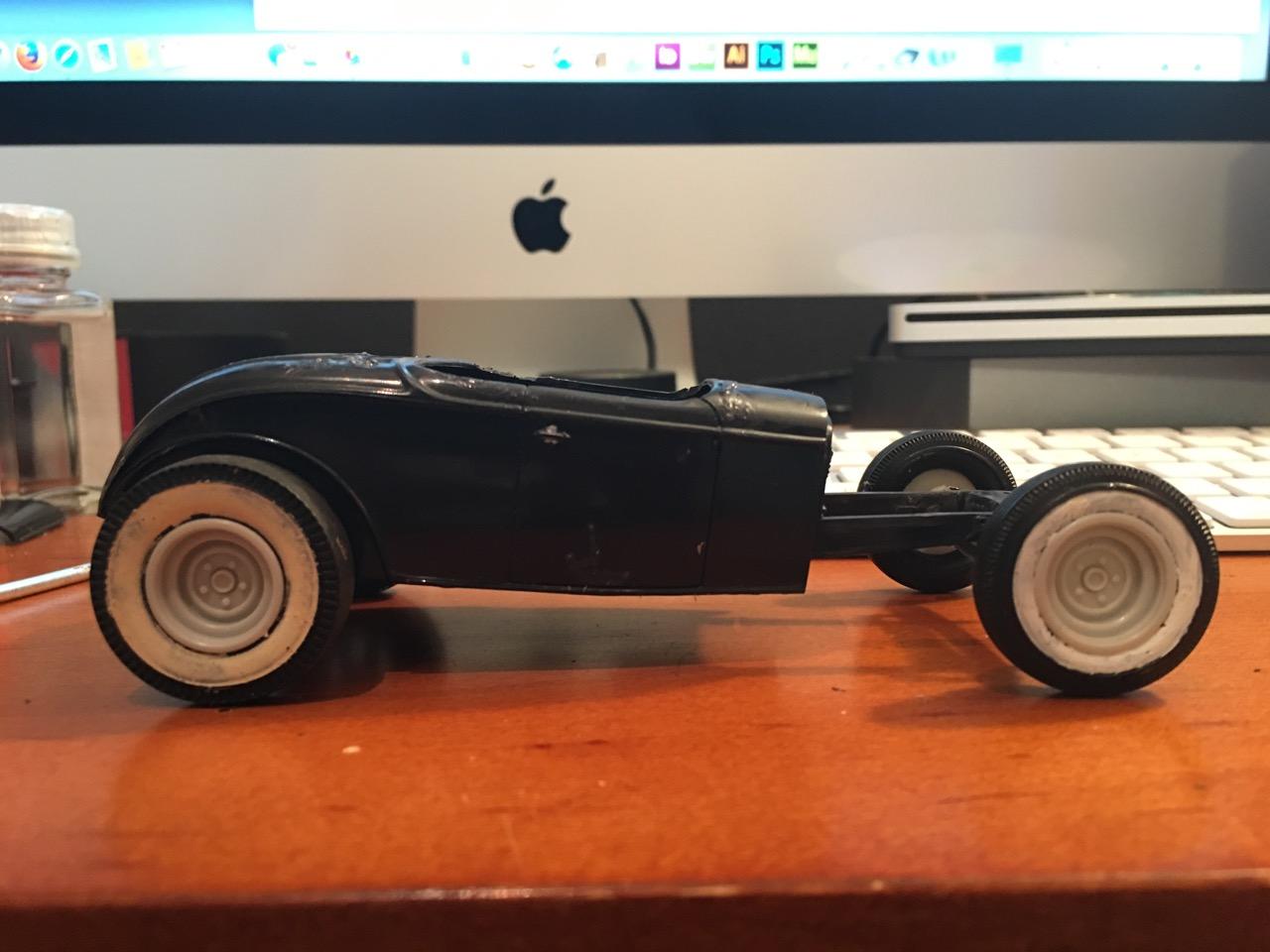

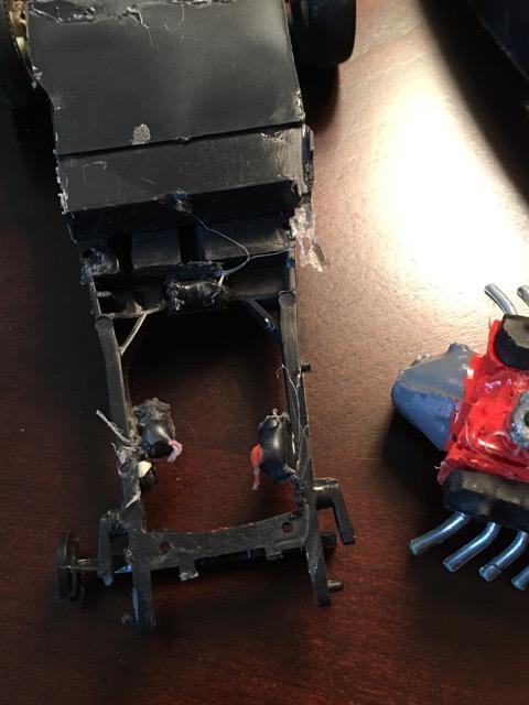

A few small updates.
I'm changing the stance by following Bill's lead with the wedge channel. The rear of the body of the AMT roadster sits on the molded in rear axle. I used some aluminum tubing and built up the hollow area there, raising the rear of the body.

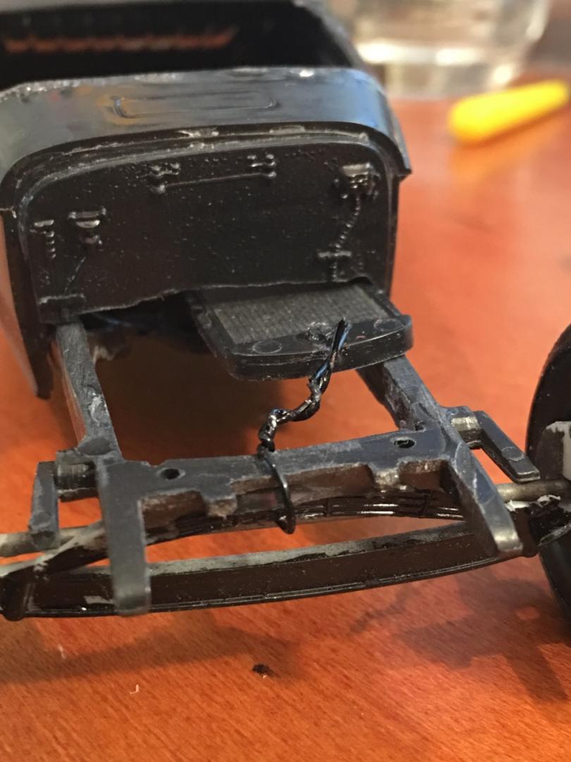

The front axle broke and has been replaced with a parts box one. I shaved down the top spring, clipped the nib off the top side of it and sanded. I used a Dremel sanding disk and "scooped" out a section of the crossmember and tucked the springs into the notch. Since the photo (below) was taken I've leveled out the cut in the firewall and sanded more of the frame.
The engine mounts on the frame were unsalvageable so they were trimmed off and the area sanded. I'll make new ones using the flat plastic where the numbering is on kit sprue.

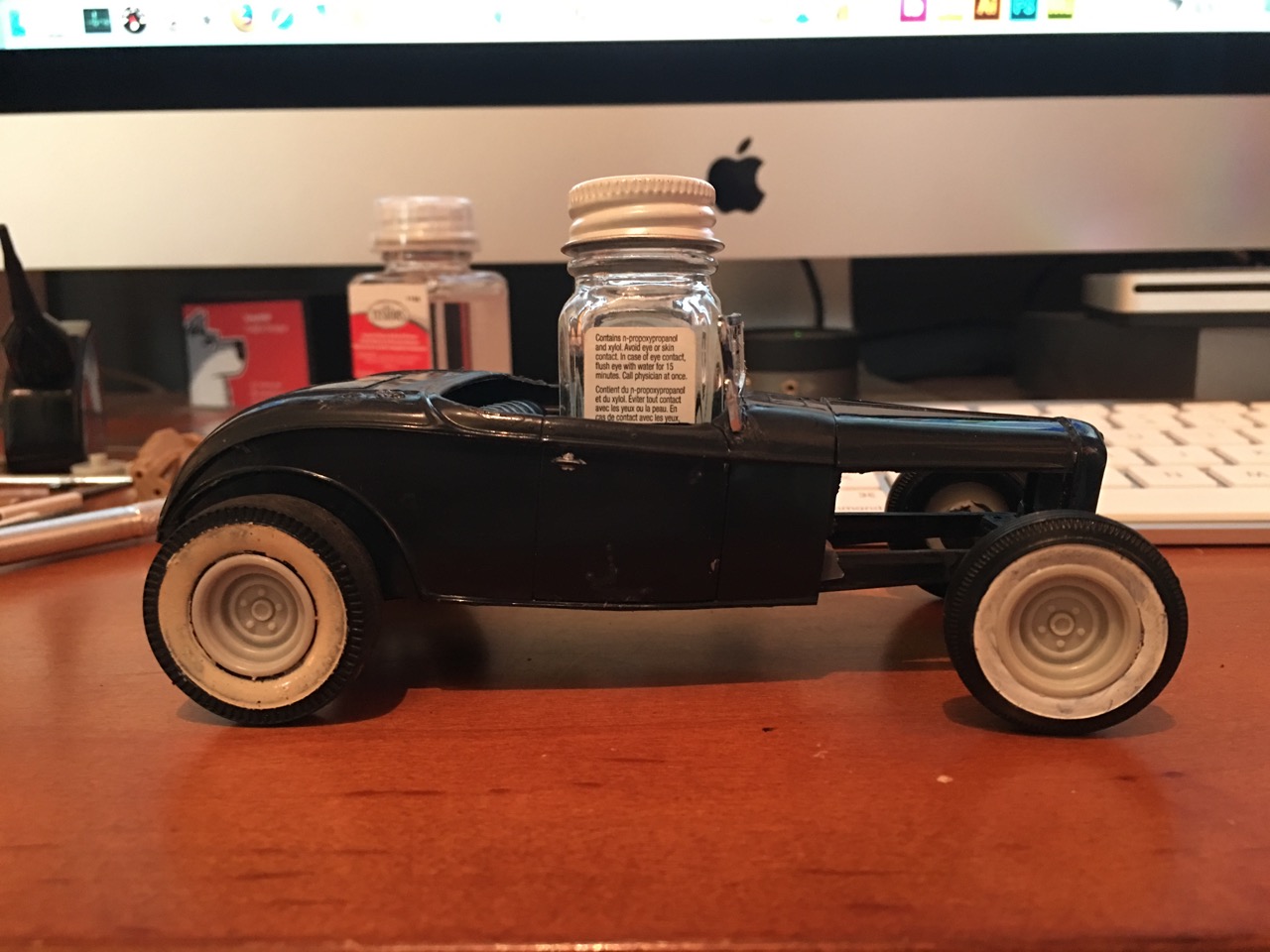

Ok, I made some more progress. Got the front axle set up and have decided to use a parts box radiator shroud as well. The new radiator shroud is a little thicker than the original one, and attaching the hood pushes it out just slightly, gives the appearance of motion.
A little less channeling towards the front than before. The scooped out crossmember and shaved axle springs have made a nice drop in the front.

Lookin' good!
When it comes to saving gluebombs, glass and headlights are an issue. Replacing curved glass is tricky.
As for body blemishes and glue spots--as long as they aren't on critical trim or details, cleaning that stuff up isn't really much harder than dealing with the mold lines, sink marks, and general wonkiness of brand-new kits! Especially the re-issues of older tooling. And if the blemishes are on critical trim...I build customs, so trim often gets shaved anyway.
Looks like you're "going with the flow" on this project. The last mockup looks great; just be careful to get that hood/grille shell lined up so the hood doesn't run uphill.
