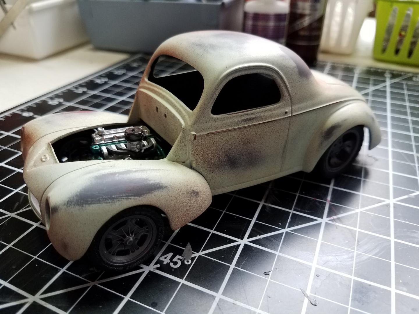

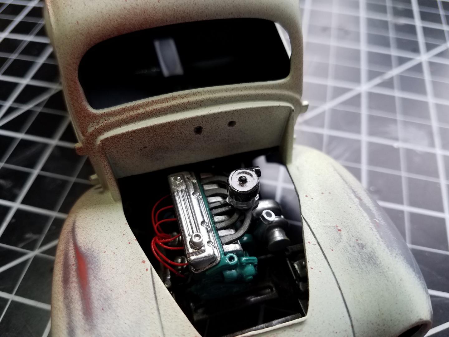

Jantrix Posted April 2, 2018 Author Posted April 2, 2018 And finally - paint. It's a pale green. This will be a patina rod so after a week or so of gassing out and hardening (Krylon enamel), I'll start to distress the paint. I was originally going for a black with dark green interior but because of the limited light in the interior bcause of the window size, the interior turned onto a black hole. I'll strip the black and go for a primer grey and dark green, with a little clear. More soon.
Pat Minarick Posted April 2, 2018 Posted April 2, 2018 2 hours ago, Jantrix said: And finally - paint. It's a pale green. This will be a patina rod so after a week or so of gassing out and hardening (Krylon enamel), I'll start to distress the paint. I was originally going for a black with dark green interior but because of the limited light in the interior bcause of the window size, the interior turned onto a black hole. I'll strip the black and go for a primer grey and dark green, with a little clear. More soon. Looking good Rob, I like the green ! Mine will be green too , all my Cannonball cars have been mostly a green color or partially green.

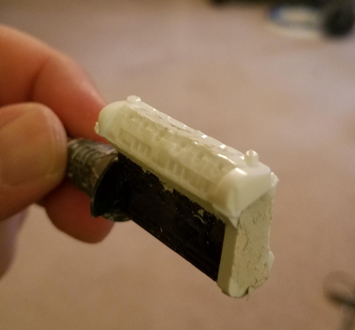

Fat Brian Posted April 5, 2018 Posted April 5, 2018 While I'm waiting on new wheels and tires to get here I decided to press forward with an engine mod I had debated since starting this project. Since I was previously trying to keep this build simple and within the realm of possibility I left the stock head and pushrod setup on the engine. Now that I have abandoned common sense I decided to go with an experimental dual overhead cam setup. Most early inline engines had the intake and exhaust ports on the same side of the head because the pushrods took up the other side of the head. Ford experimented with a crossflow head where the intake runners passed between the pushrods but the design wasn't any more efficient than the existing head due to the runners being so small. I took the concept one step further by converting the engine to a modern belt driven dual overhead cam design. I used valve covers from a 4.6 mod motor turned end to end and shortened a bit to make the cover for the straight 6.

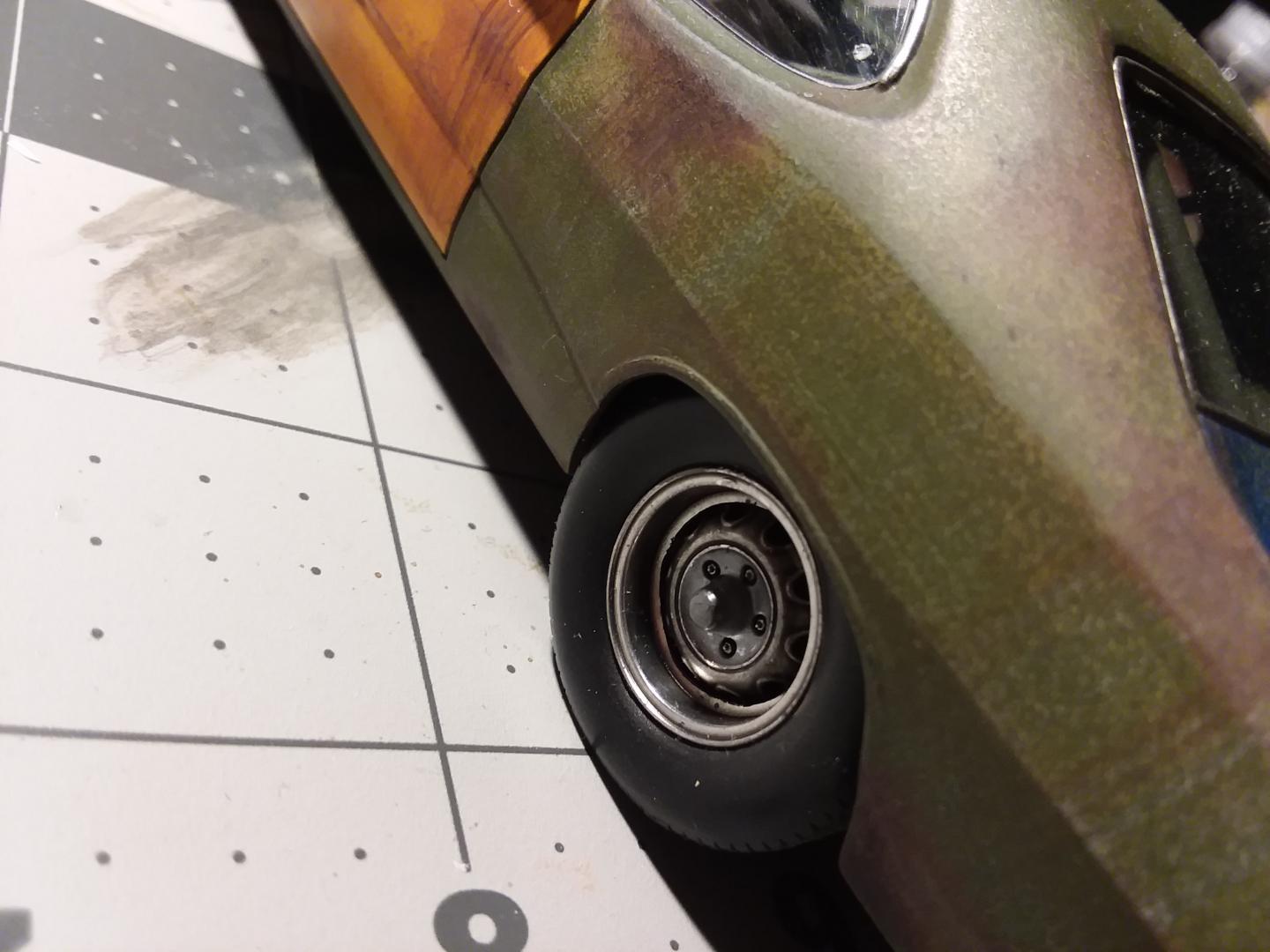

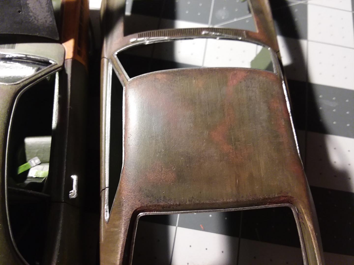

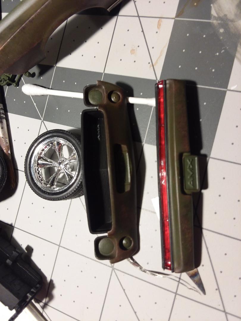

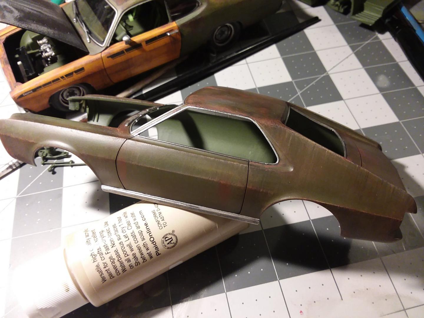

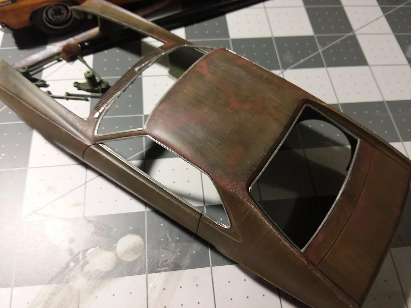

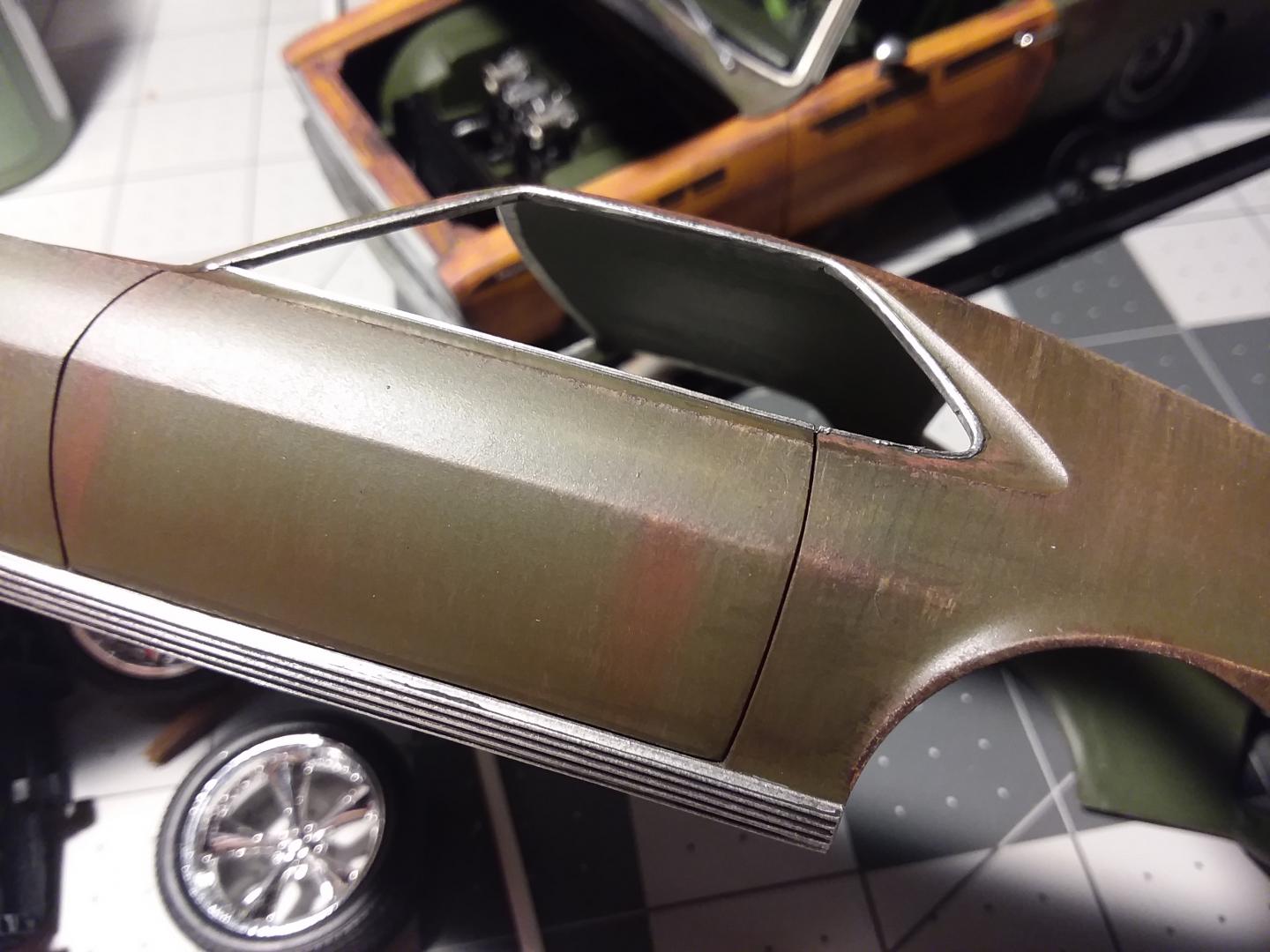

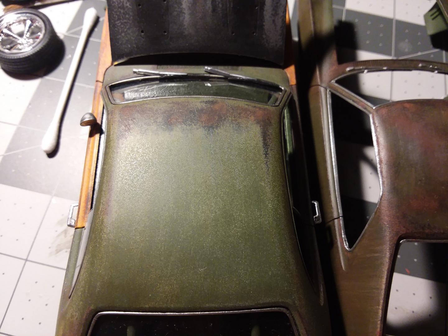

Pat Minarick Posted April 14, 2018 Posted April 14, 2018 (edited) Getting ready to weather up the AMX. Edited April 14, 2018 by Pat Minarick
KWT Posted April 14, 2018 Posted April 14, 2018 Everything is looking good guys. I finally made a SMALL bit of progress on the Datsun... Everything I wanted to be flat black is. Just barely beat the rain. Lol... Some of my parts have some serious warpage... Gotta see if I can get that worked out.
landman Posted April 14, 2018 Posted April 14, 2018 9 hours ago, Pat Minarick said: Getting ready to weather up the AMX. Pat, would you mind telling us how you achieved that effect?

Belugawrx Posted April 16, 2018 Posted April 16, 2018 Just now, Pat Minarick said: Thanks. would you like to explain how you achieved that look On 4/14/2018 at 10:04 AM, landman said: Pat, would you mind telling us how you achieved that effect?

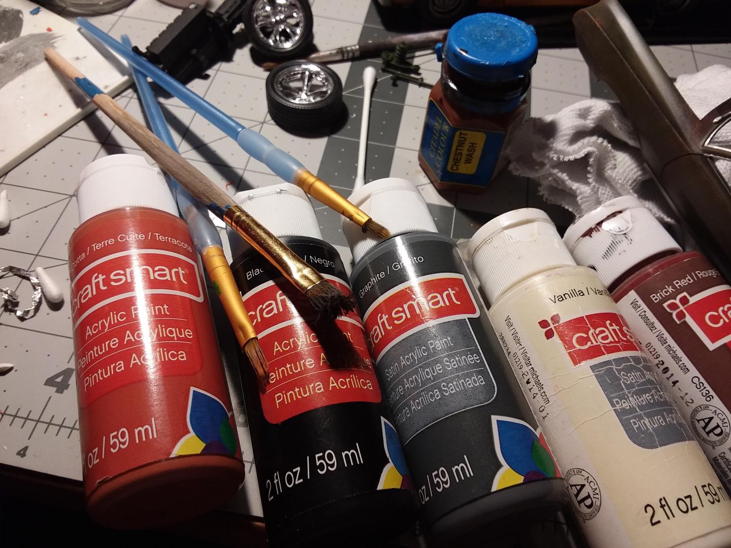

Pat Minarick Posted April 16, 2018 Posted April 16, 2018 (edited) 1 hour ago, Belugawrx said: would you like to explain how you achieved that look I can try. Fisrt paint the body flat black , gray primer, and then body color . Thin layers and let dry. Wet sand the body all over , in the places you want real rusty it's ok to go to the plastic. Then dullcote it. I use acrylic craft paint( Craftsmart ). Dab the bare areas with black. You can dry brush graphite gray in areas you want primer spots. Then dry brush graphite gray and vanilla in the direction water would streak down the body. Then I give the body a wash of Citadel miniatures chestnut or dark flesh wash. Blot excess of with a sponge , or add more streaks with a clean brush. Dullcote again. Go back to the areas you want rusty. Use black and brick red , bad both together with a old worn out brush till it looks the way you want it. You can use terra cotta got some brighter rust . Thin the terra cotta with a liner brush to add rusty streaks. Use the vanilla and with a really dry brush the body in the direction of the streaks to dull it up more. You can use a black wash in areas you want darker and body lines. Just build up layer till you get the look you want. Do your foiling on the trim and dullcote again . You can leave it like that , or go back over the rusty spots to give more texture. Hope you can figure that all out. Edited April 16, 2018 by Pat Minarick
