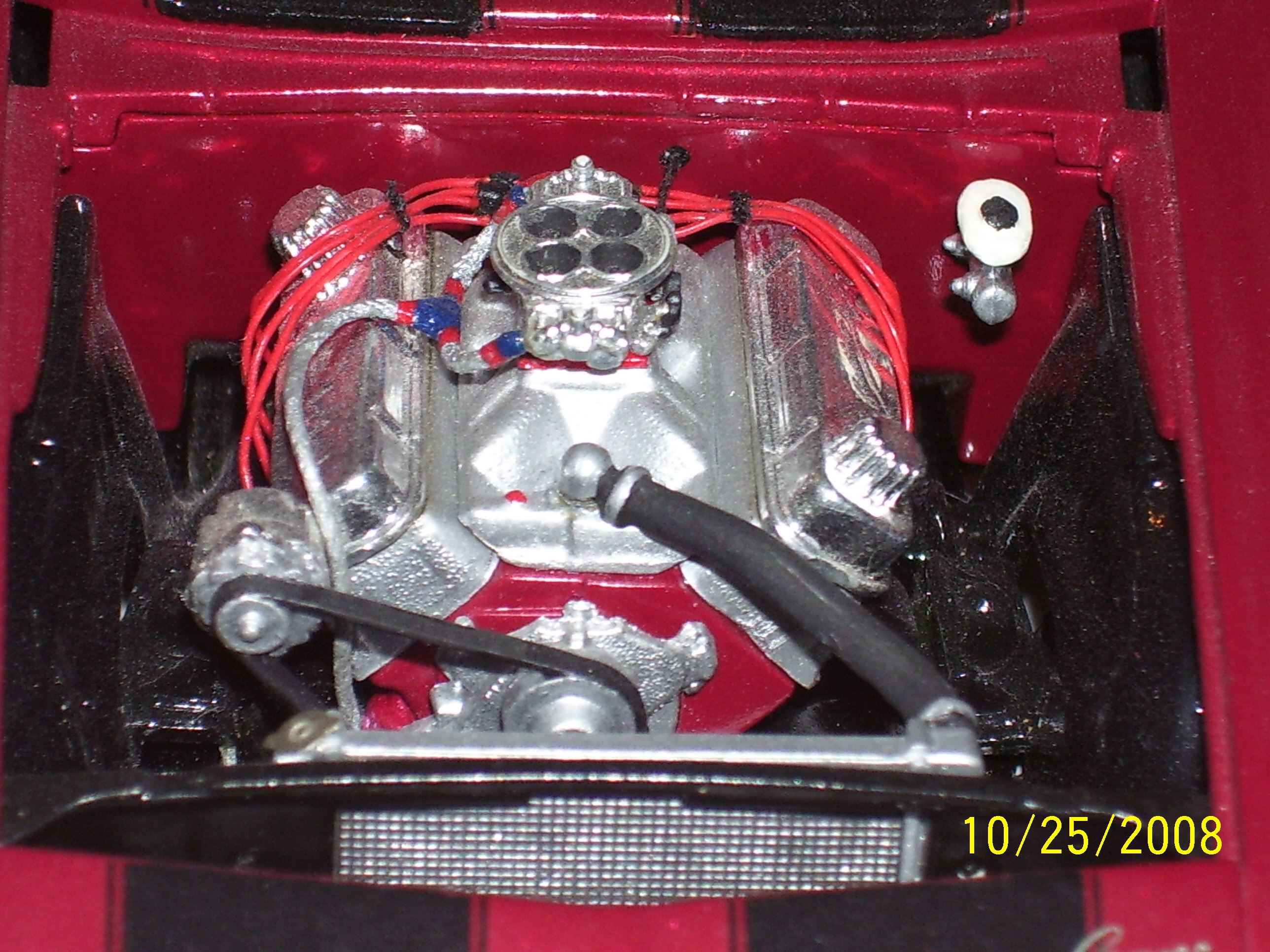

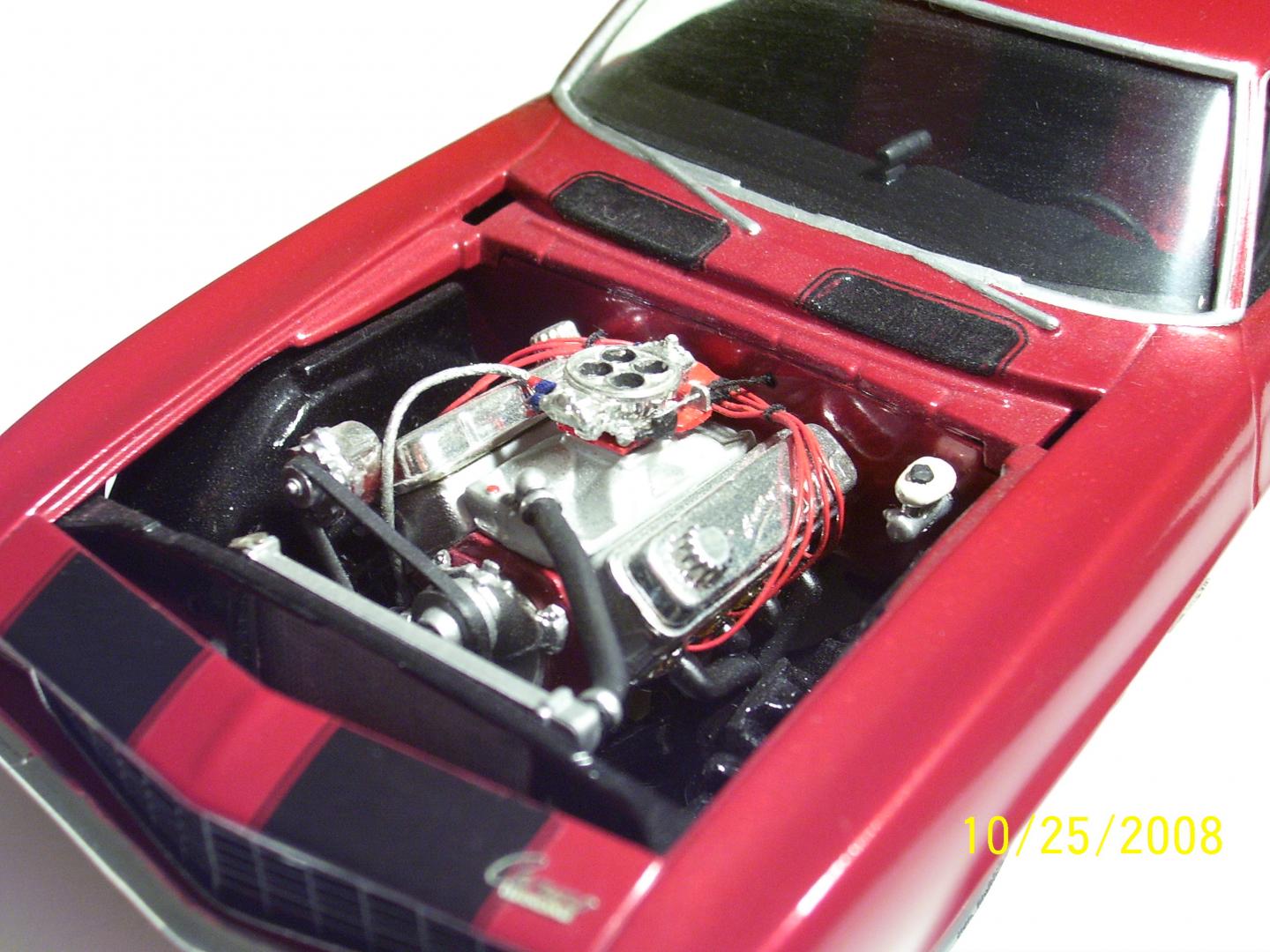

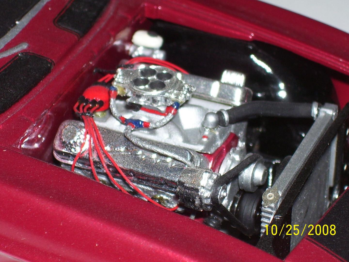

camarobuilder Posted March 24, 2018 Posted March 24, 2018 This technique may not be contest quality, but it will give you a cheap and easy representation of braided lines, without having to fumbl with separate hose ends and line. I actually use kite string that I paint with Testors "chrome" for the steel braid and simply paint red and blue bands around the ends to simulate the A/N fittings. I use a small drop of Devcon epoxy to make tees. Frank
