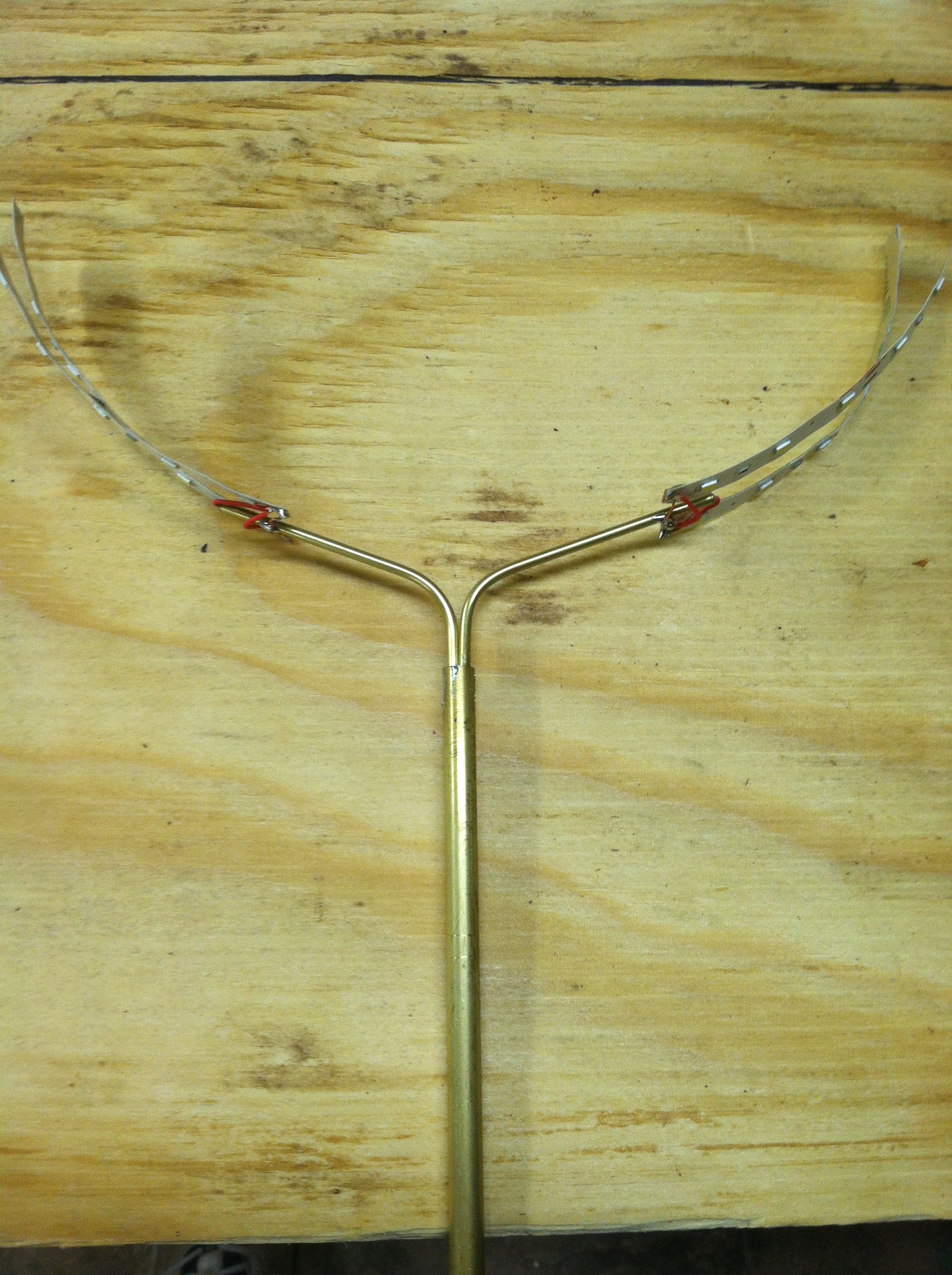

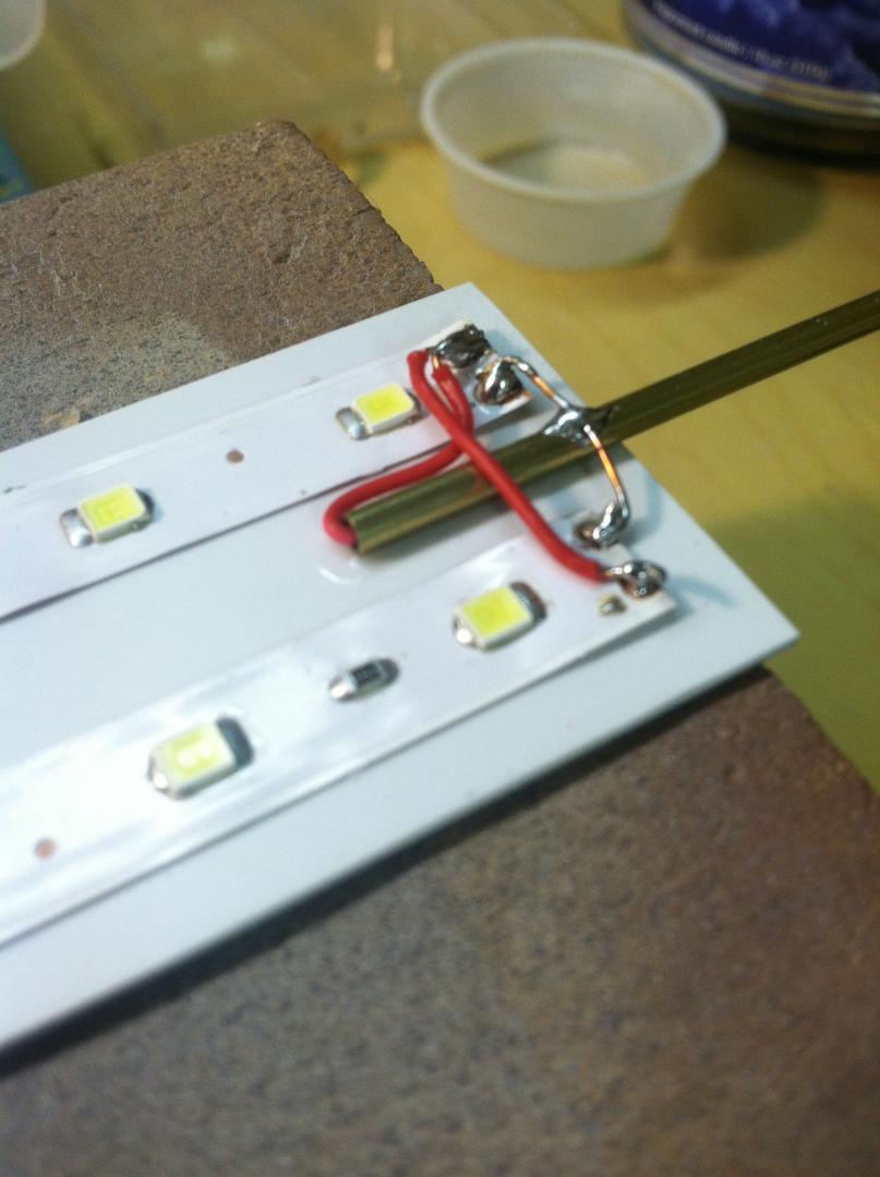

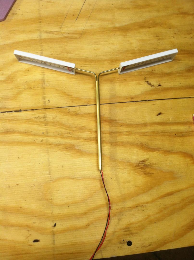

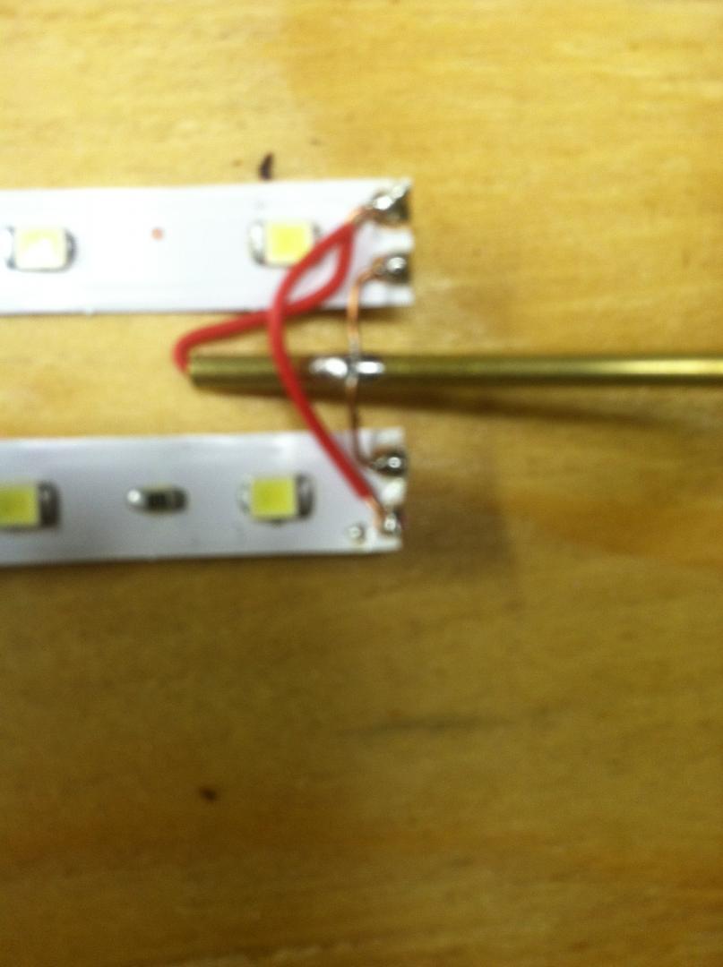

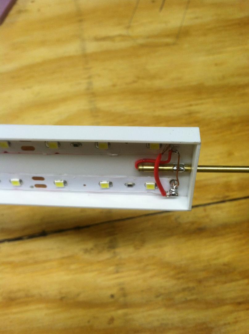

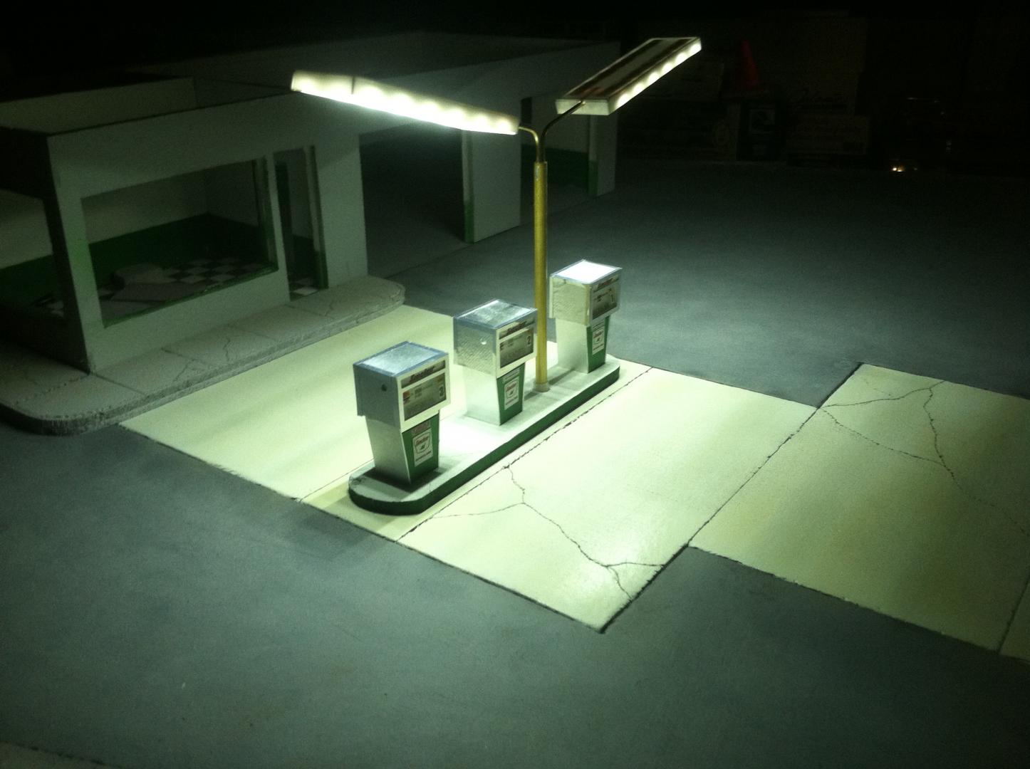

Ok so here is the latest update.  As mentioned before, I started on the island lights, islands and lot.  For the lights, I picked up some brass tubing and some led strip lights.  I wired the positive through the tube and soldered the ground to the brass. Sorry for the crappy pictures!IMG_2121.thumb.JPG.9b8d285e709196504b58bcc3930cde8d.JPG

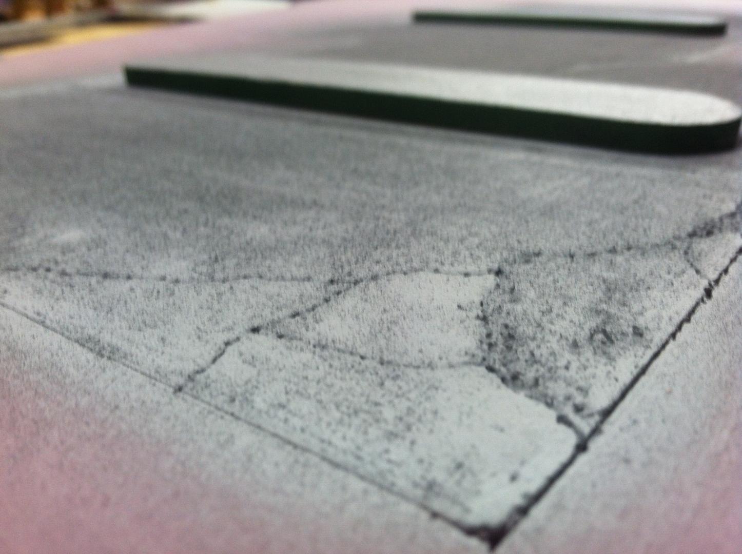

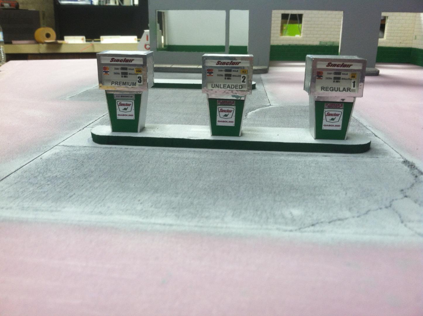

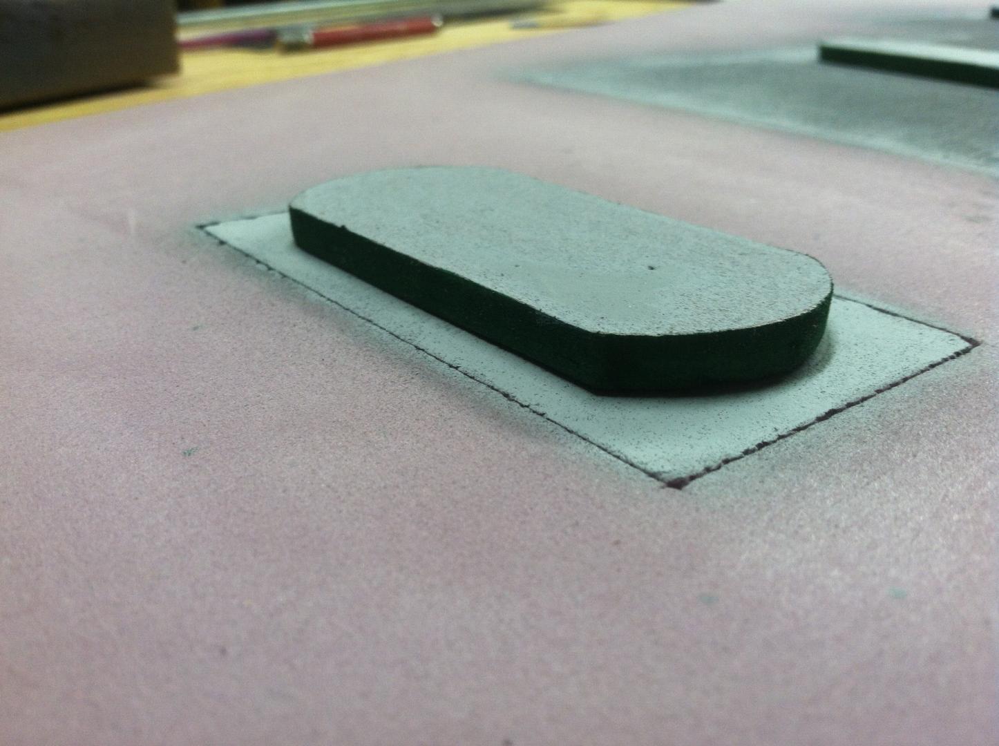

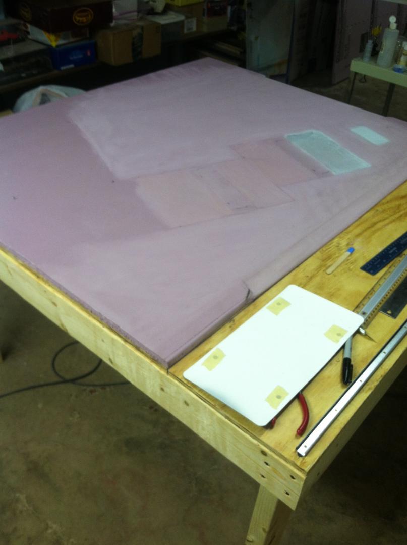

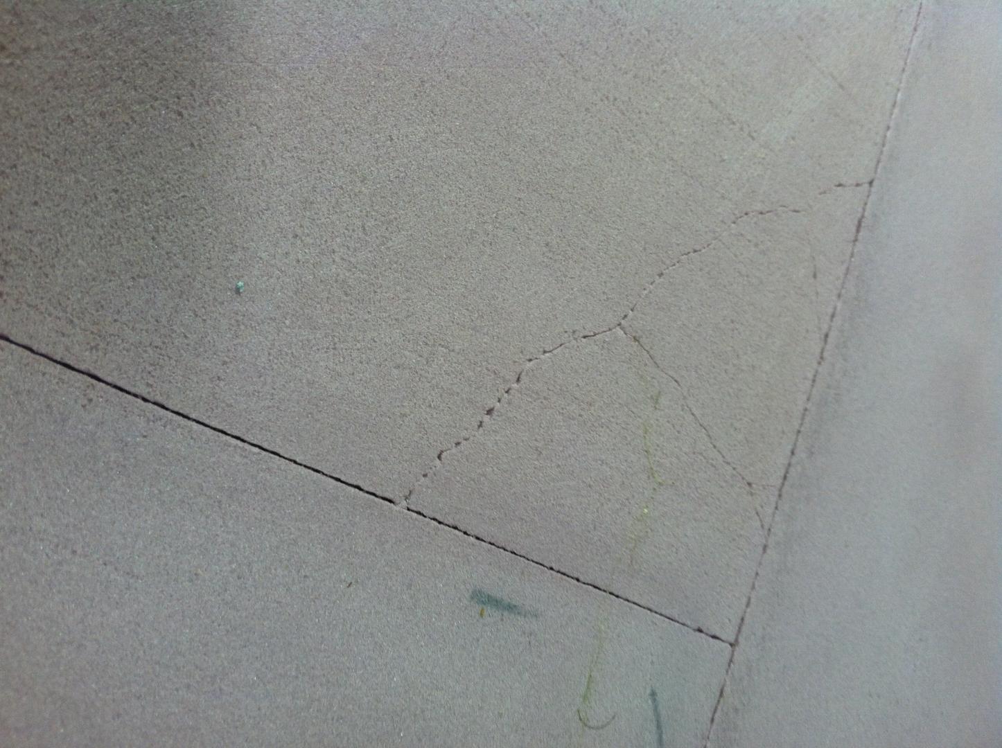

For the islands and the lot I picked up a sheet of 1/2 inch insulation foam, cut, and sanded  down the islands and painted.  I cut some cracks in the foam to simulate cracks in the concrete.  I need to do some more work on the lot and smooth out the pads a little.  I also need to add a couple more coats of paint for the concrete items.  Most of the lot will be pavement.

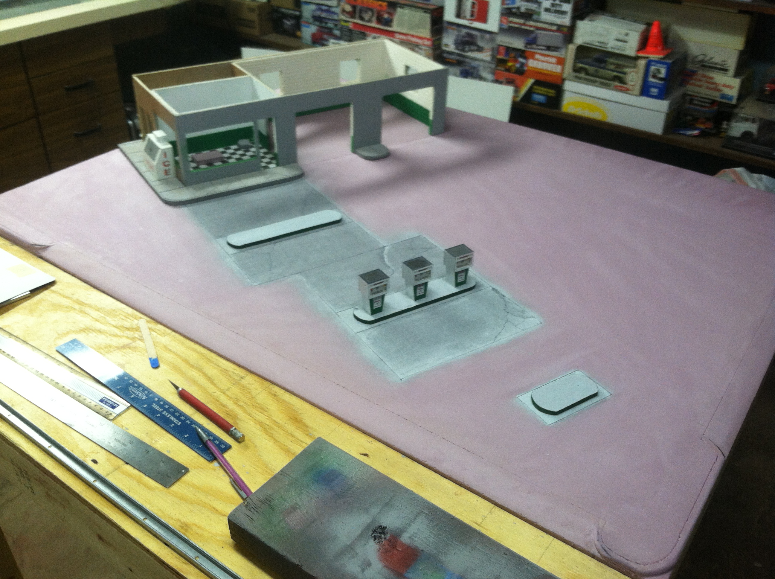

Here is a quick mock up of the layout.

The islands look great Bill, and those cracks in the concrete are a master touch. You shouldn't need to worry about the 4 feet by 4 feet section of the larger diorama and building the whole thing in sections is the way to go of course. This project of yours has started me thinking about adding a second section to my 3 feet by 2 feet 7 inches baseboard. The two streets of my diorama need to extend a little more to allow space for additional model cars.

The thicker "House" sign is styrene.  The pain is sanding off the red.  I recently looked up (googled) and visited a plastic shop about 45 min from my house.  I scored a 4ft by 8ft sheet of white styrene about 1mm thick for $17.00 so the thicker for sale signs will be no more.  The island lights are made of that material.  The cheap super thin signs are styrene also I believe.  They have a use but are not as rigid.  Those are only a few bucks and the white portion is transparent to a point.  That is what I used for the top "Sinclair" signage on the gas pumps so they light up nice  and disperse the light well without seeing the light bulb behind it.

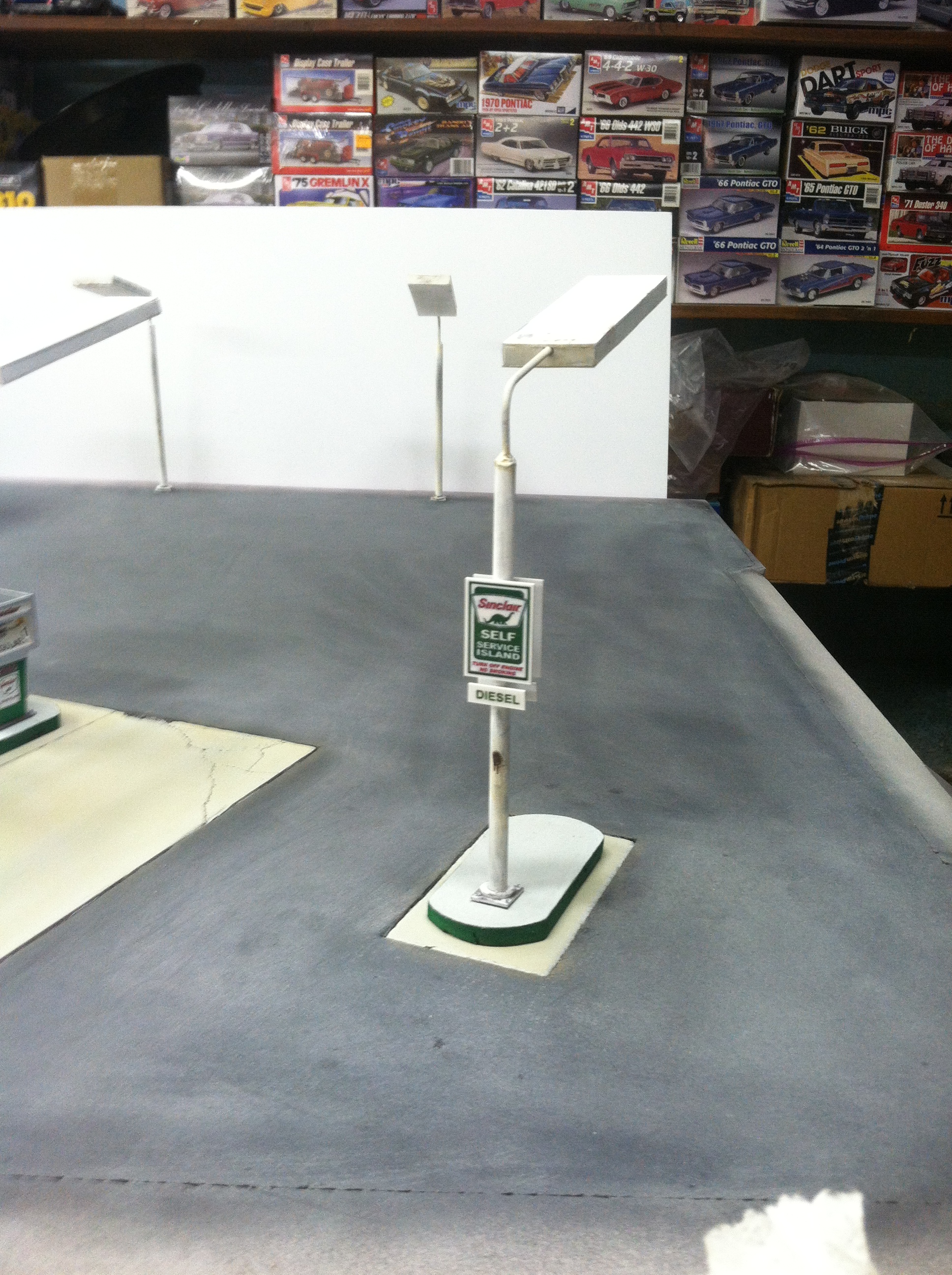

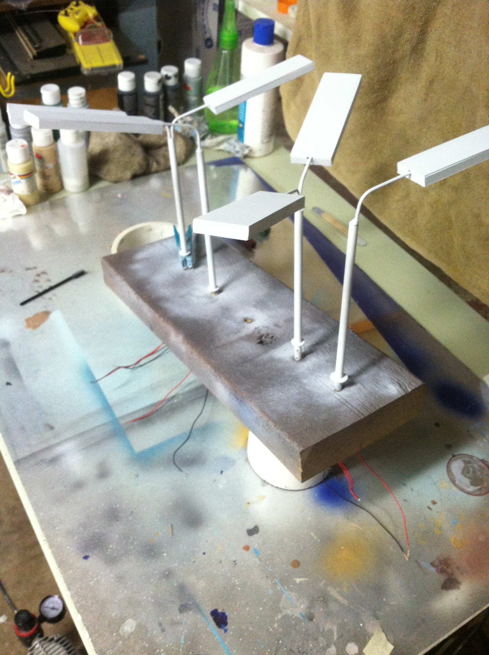

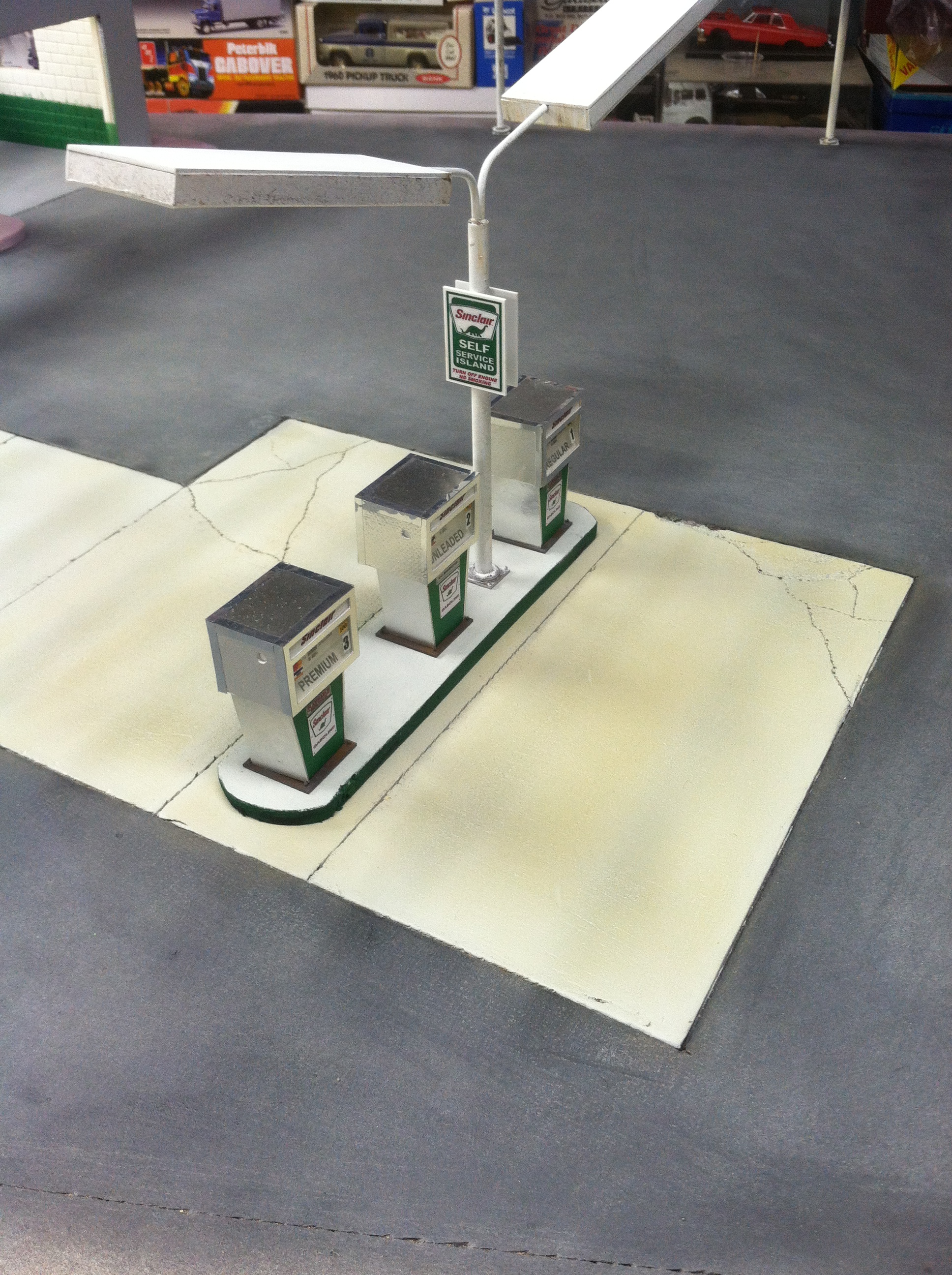

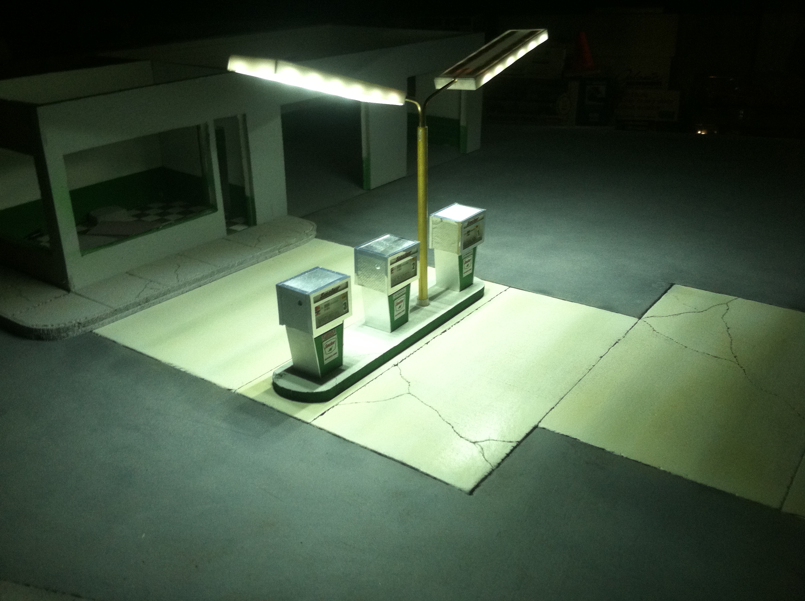

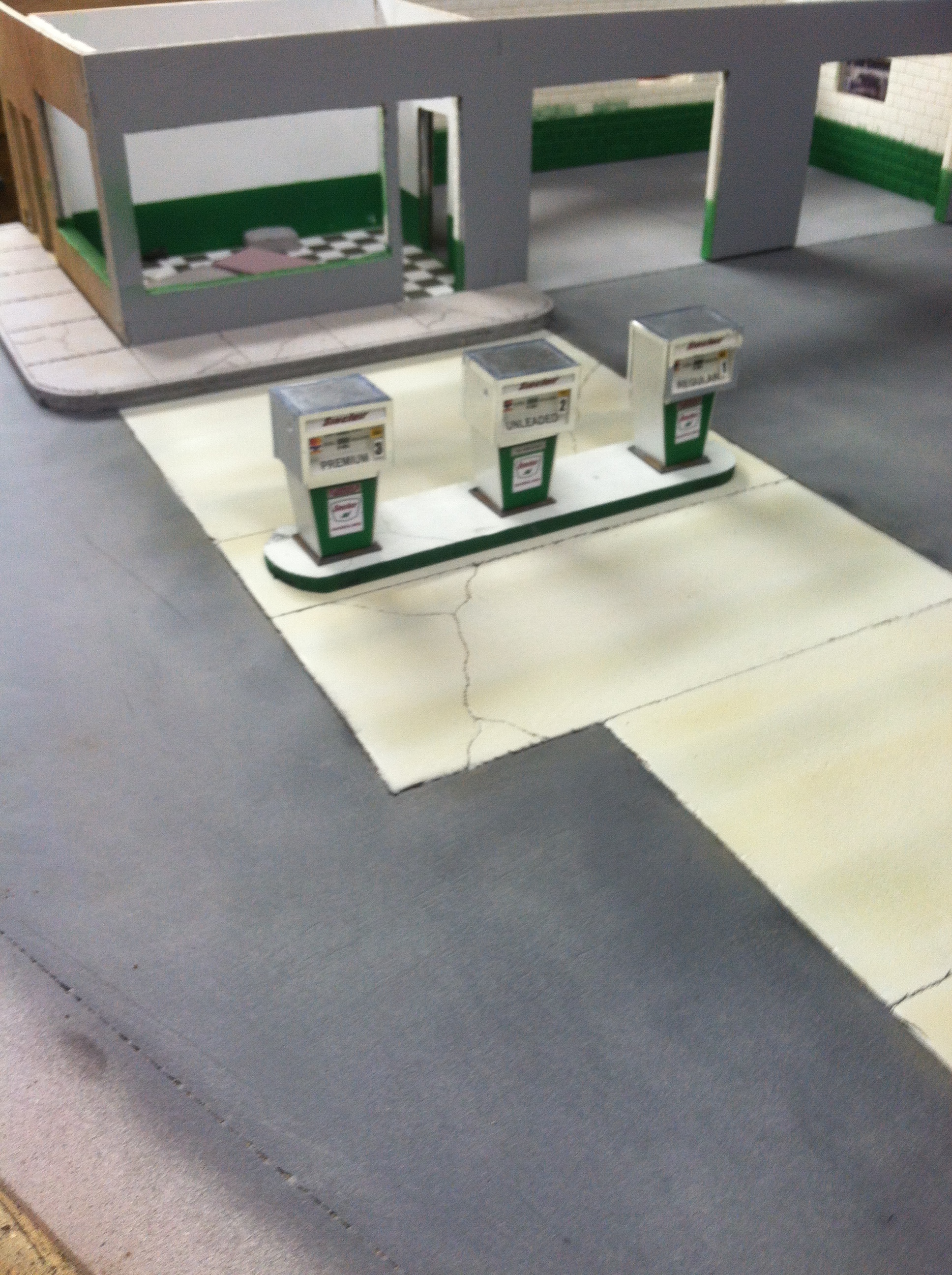

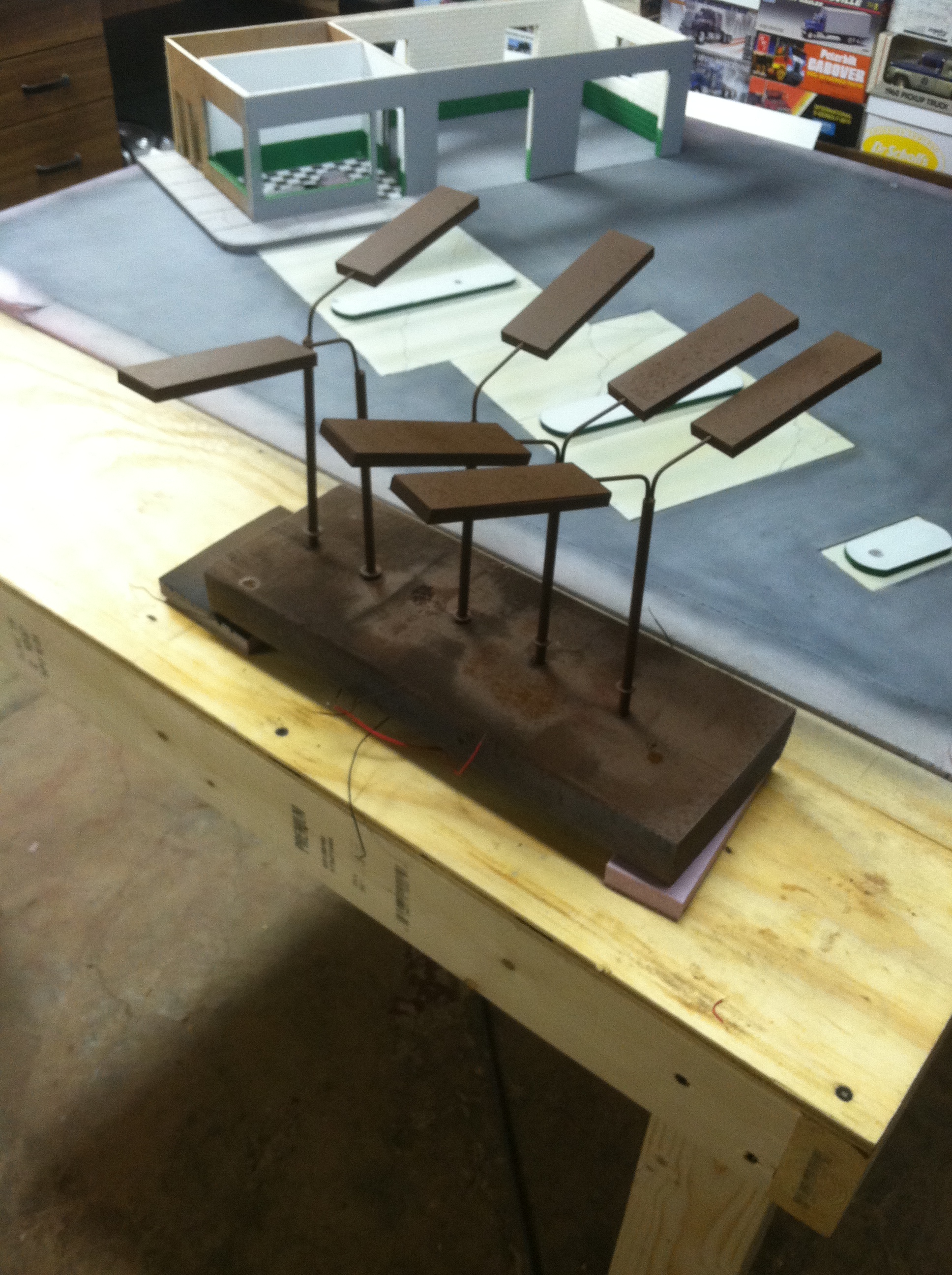

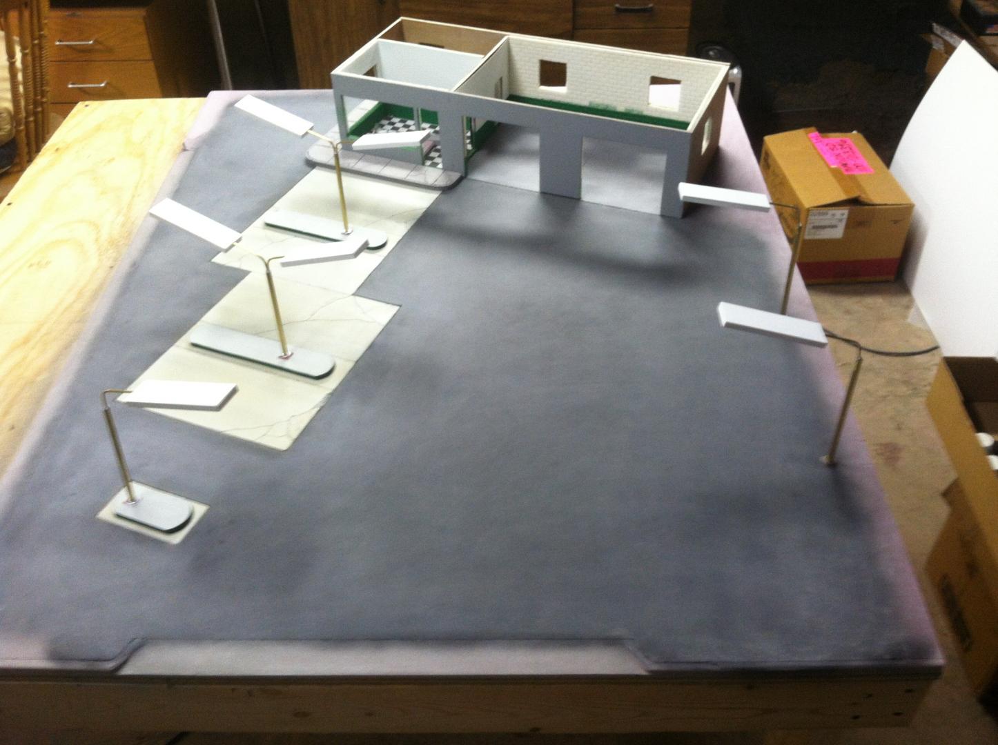

Another update on my progress.  I painted the asphalt, smoothed up the concrete pads a little, tested, completed, and painted all of the island lights.  The test photo shows light bleeding through the sides a bit so I put some reflective foil tape inside the light to solve this issue.  The lights were painted with a dark brown base color topped off with white, then weathered slightly.  The lens's were made from a cheap cutting board material from the dollar store that blurs things just enough to not see the led strip lights when off, but allows light through when on.  The asphalt was too black at first so I rubbed baby powder into the foam and a little fine dirt to give it a slight used look.  I set up another mock up to see if I am on track.  I will keep posting my progress. Thanks for following!

Bill..... just when I thought the gas pumps were brilliant, there you go with the islands and the lamps! This is excellent work on your part and you must be really pleased with the progress of it all. Looking at these images of your diorama, I can see where I need to be aiming for... and it is truly a very high bar that you have set !
Professional touches such as the diffused lighting and the subtle weathering of the lights and the asphalt are so important. I continue to follow this interesting project, and hopefully learning a great along the way..... thank you.
