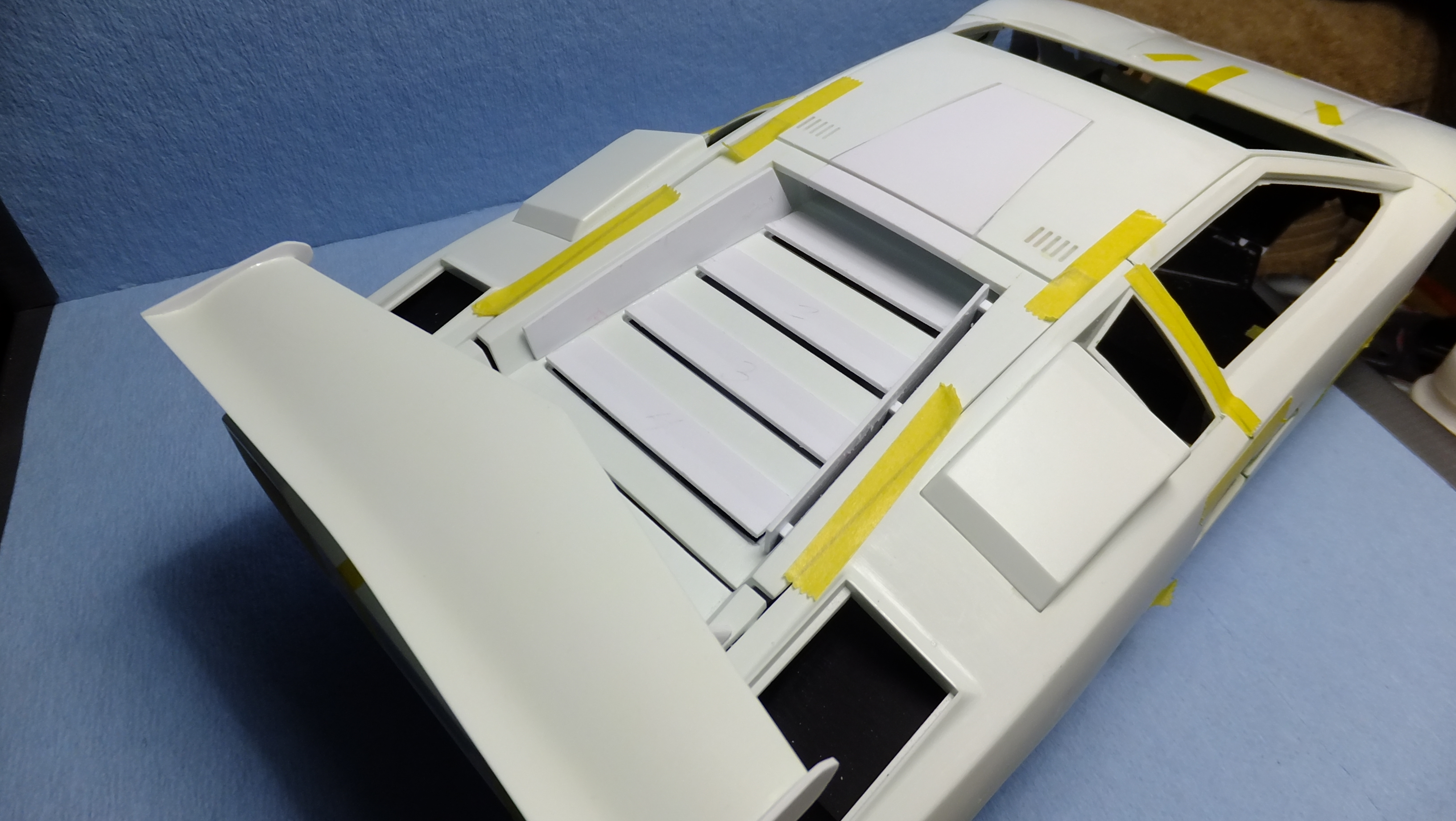

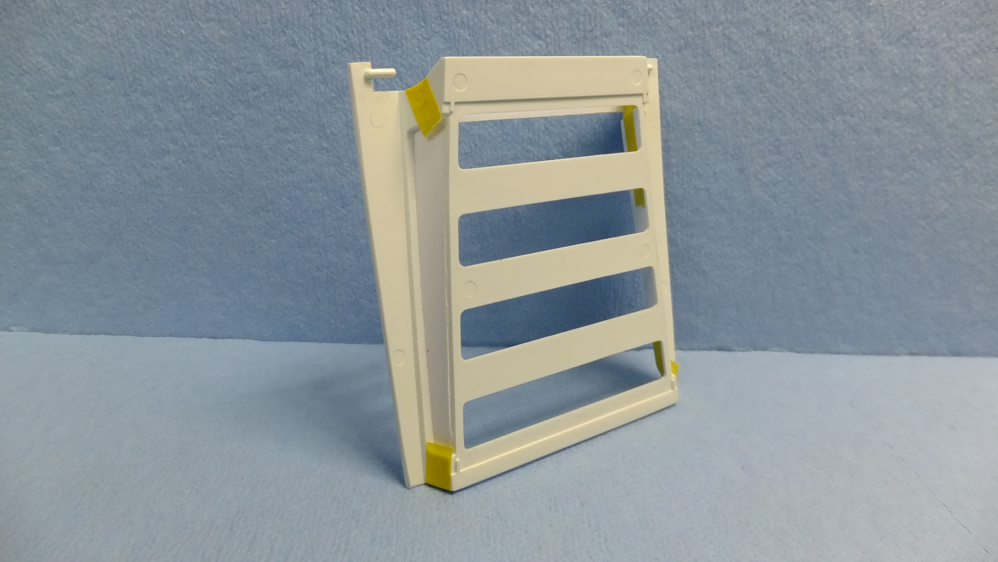

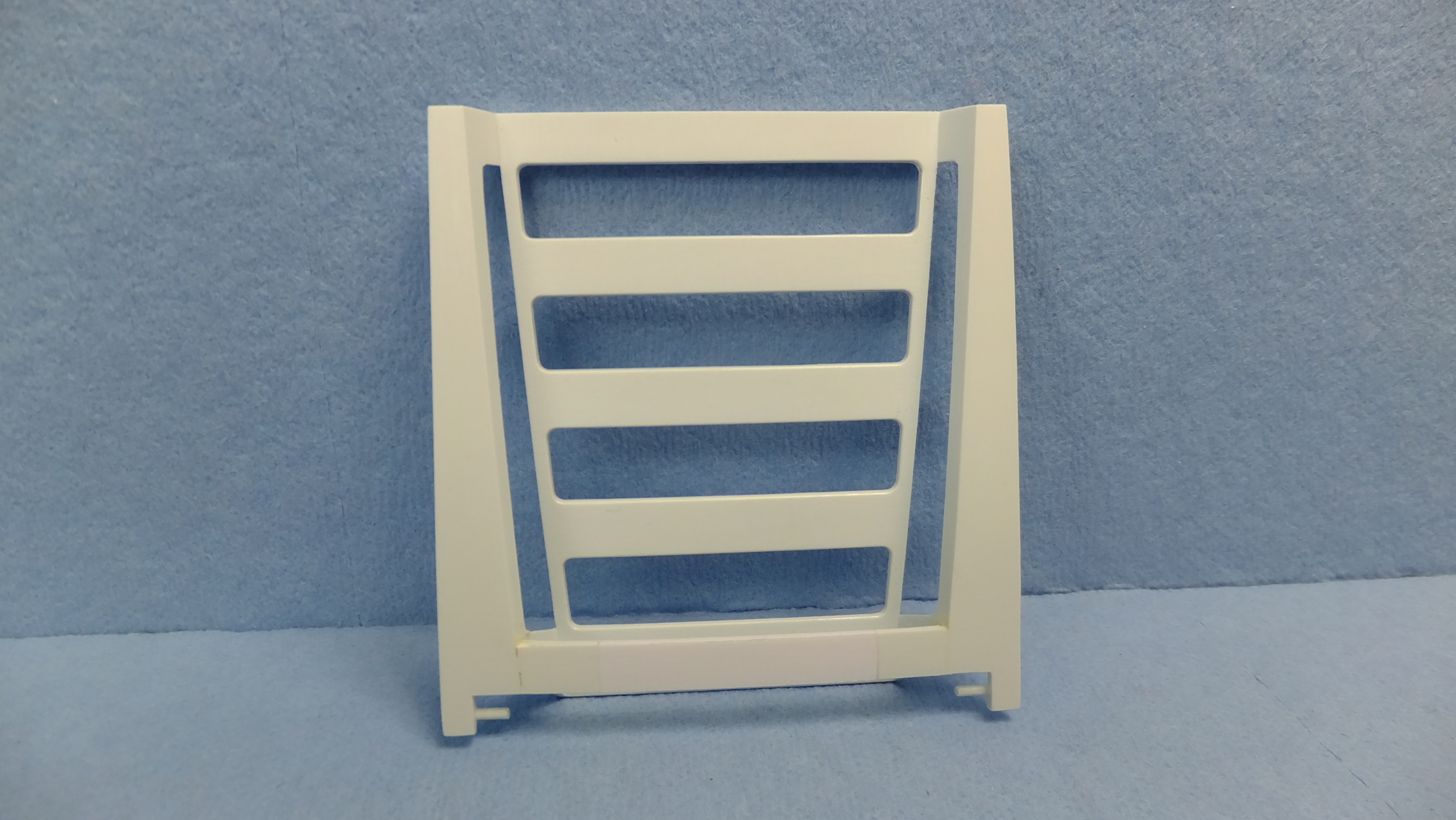

Dann Tier Posted February 12, 2019 Author Posted February 12, 2019 Hey, everyone!, I have started the hood change process...Here is the kit hood with only my crossmember change. the vents are black plastic parts...tossed a long time ago. I wanted to have the 1977+ hood, so the fun begins!

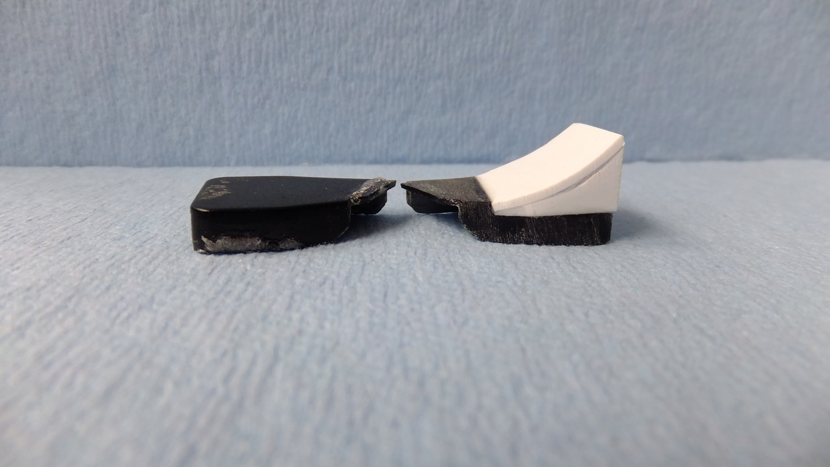

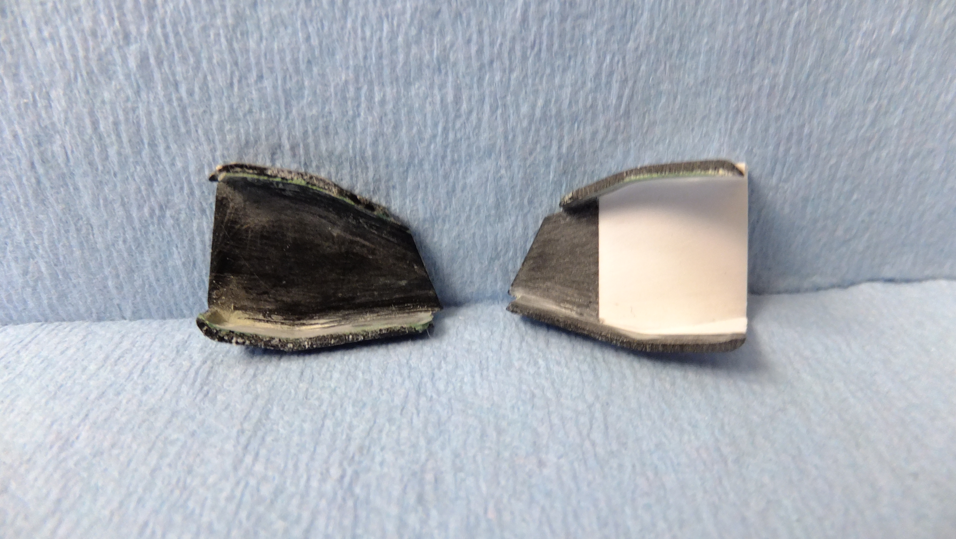

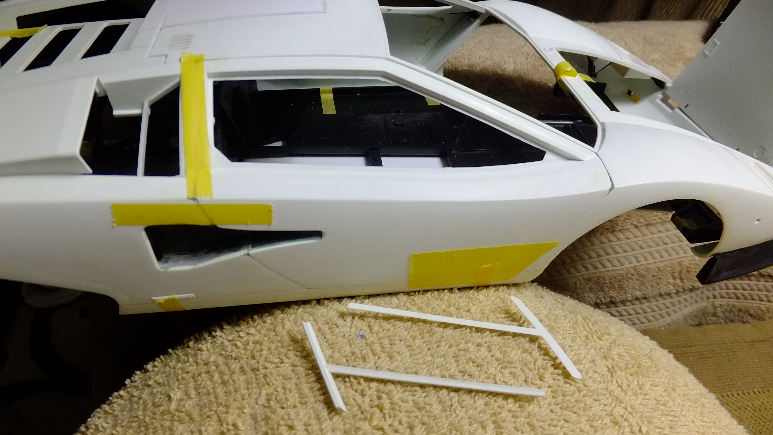

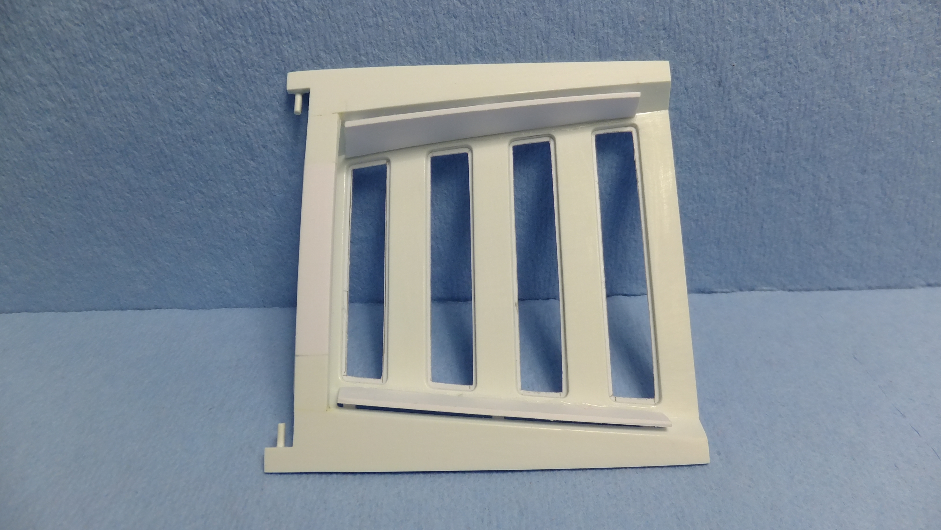

Dann Tier Posted February 12, 2019 Author Posted February 12, 2019 First, I needed to SB the side vents, so using the opening to make a template, I made the two parts, and glued theme in place with canopy glue. This served two purposes; 1) it made it easier to sand the top edges to match the top of the hood, and 2) it will help act as a hinge in a later step.

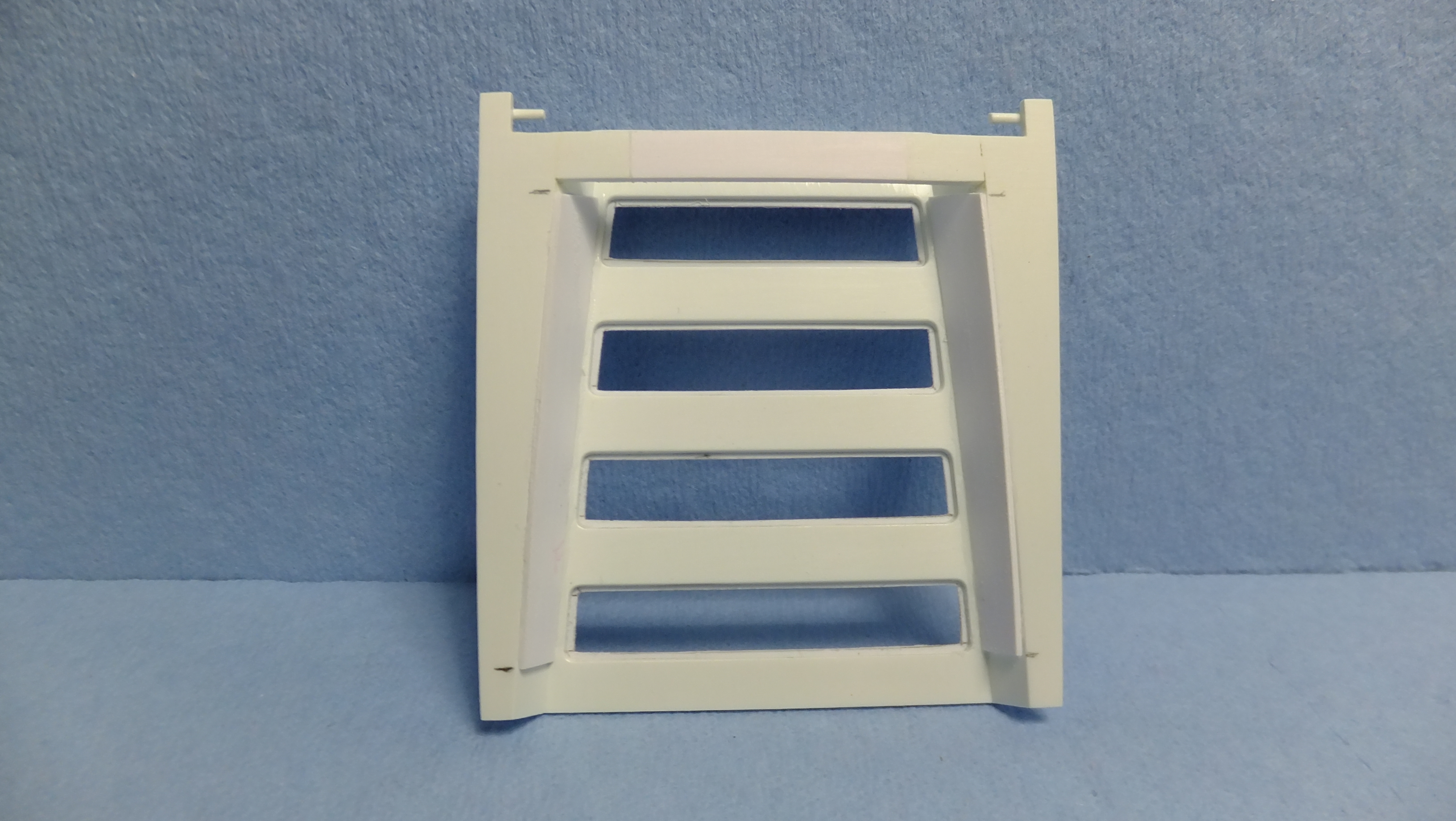

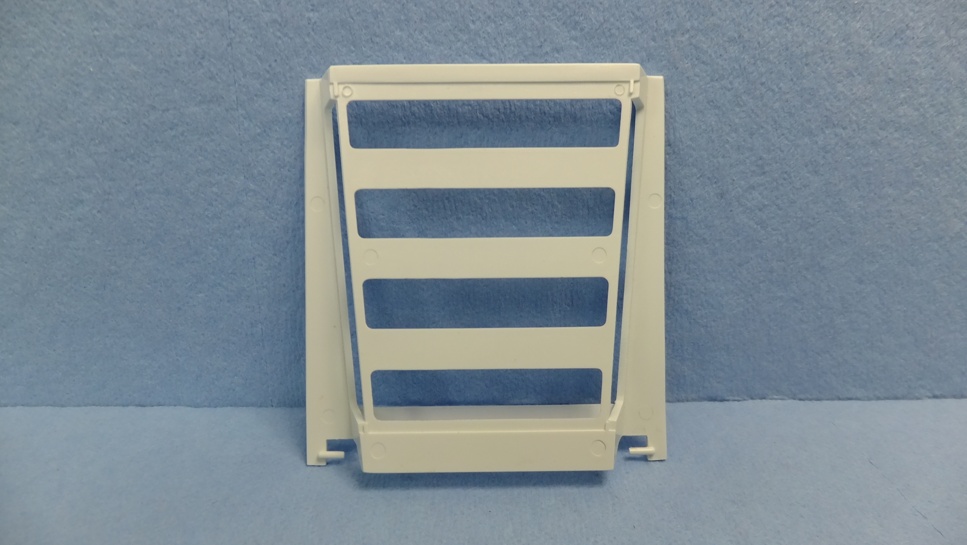

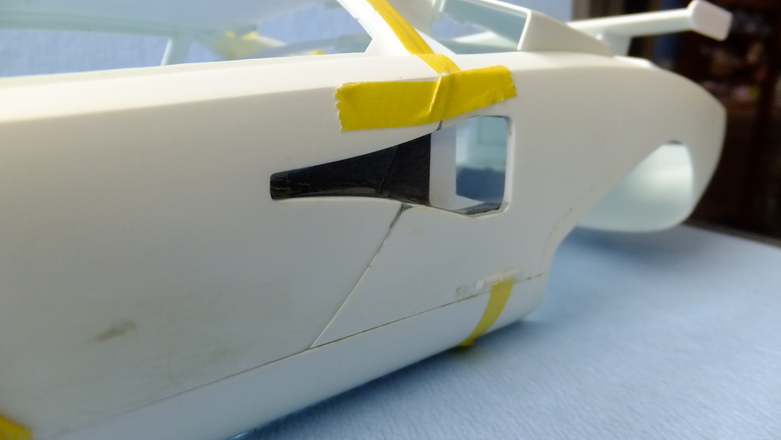

Dann Tier Posted February 12, 2019 Author Posted February 12, 2019 Using my thinnest styrene, I covered the openings with the proper overlap...

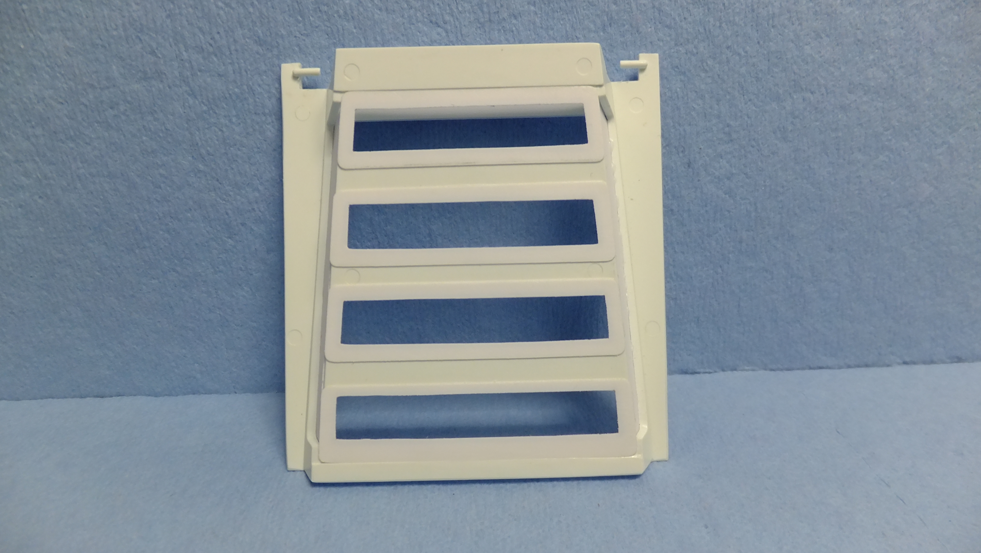

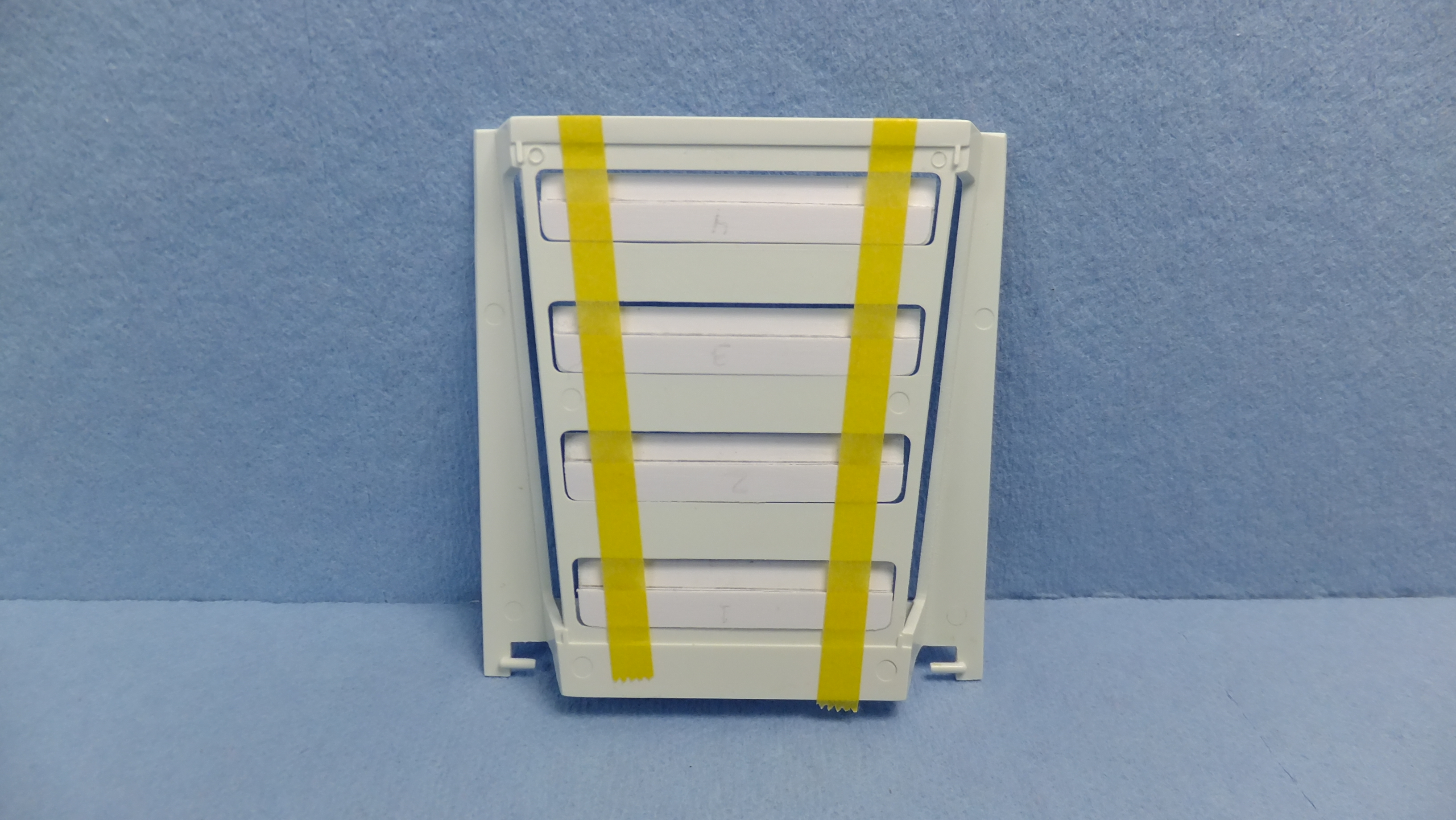

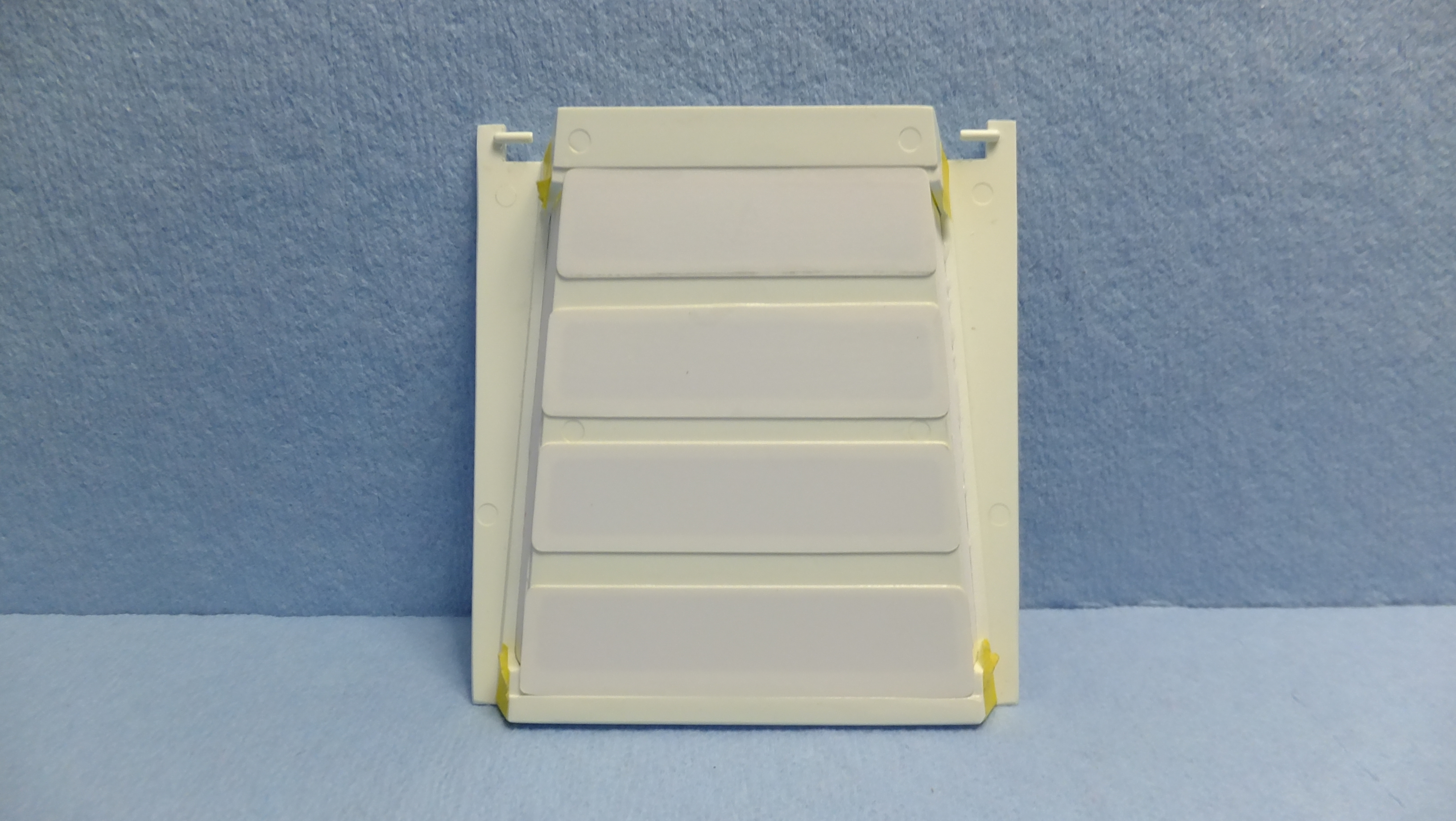

Dann Tier Posted February 12, 2019 Author Posted February 12, 2019 I was able to make a uniformed ridge, by using a piece of square styrene rod.....I just opened them with my Olfa blade.

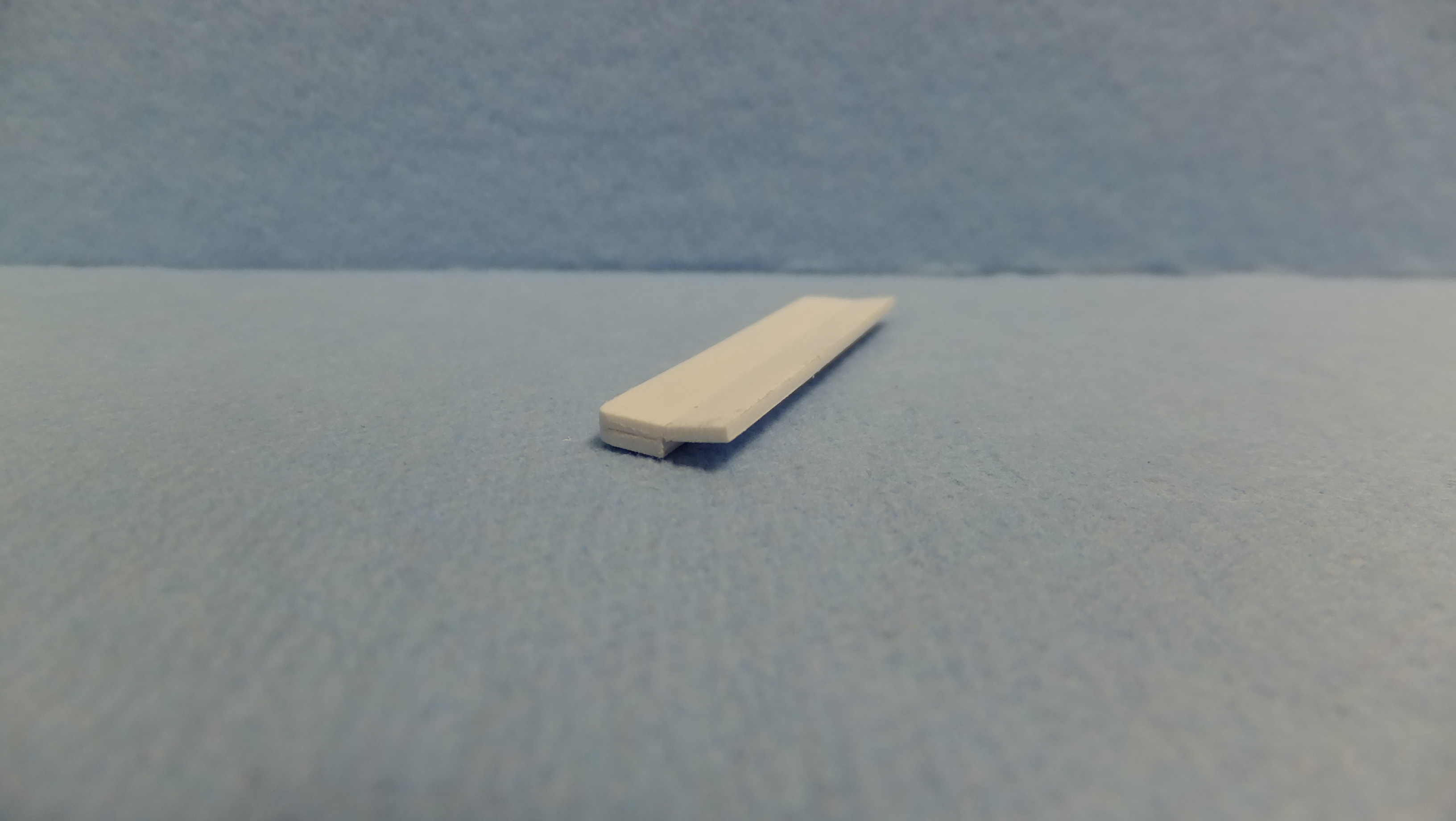

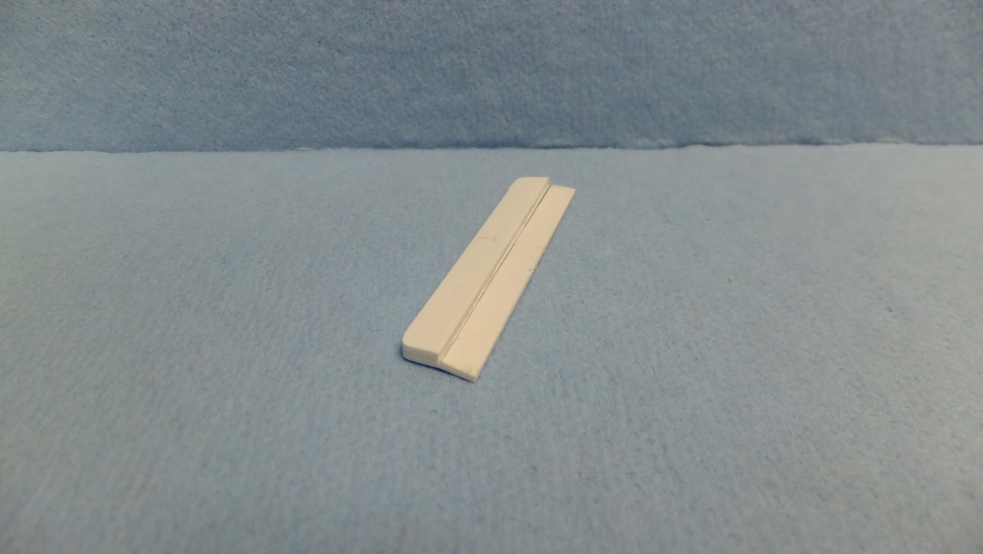

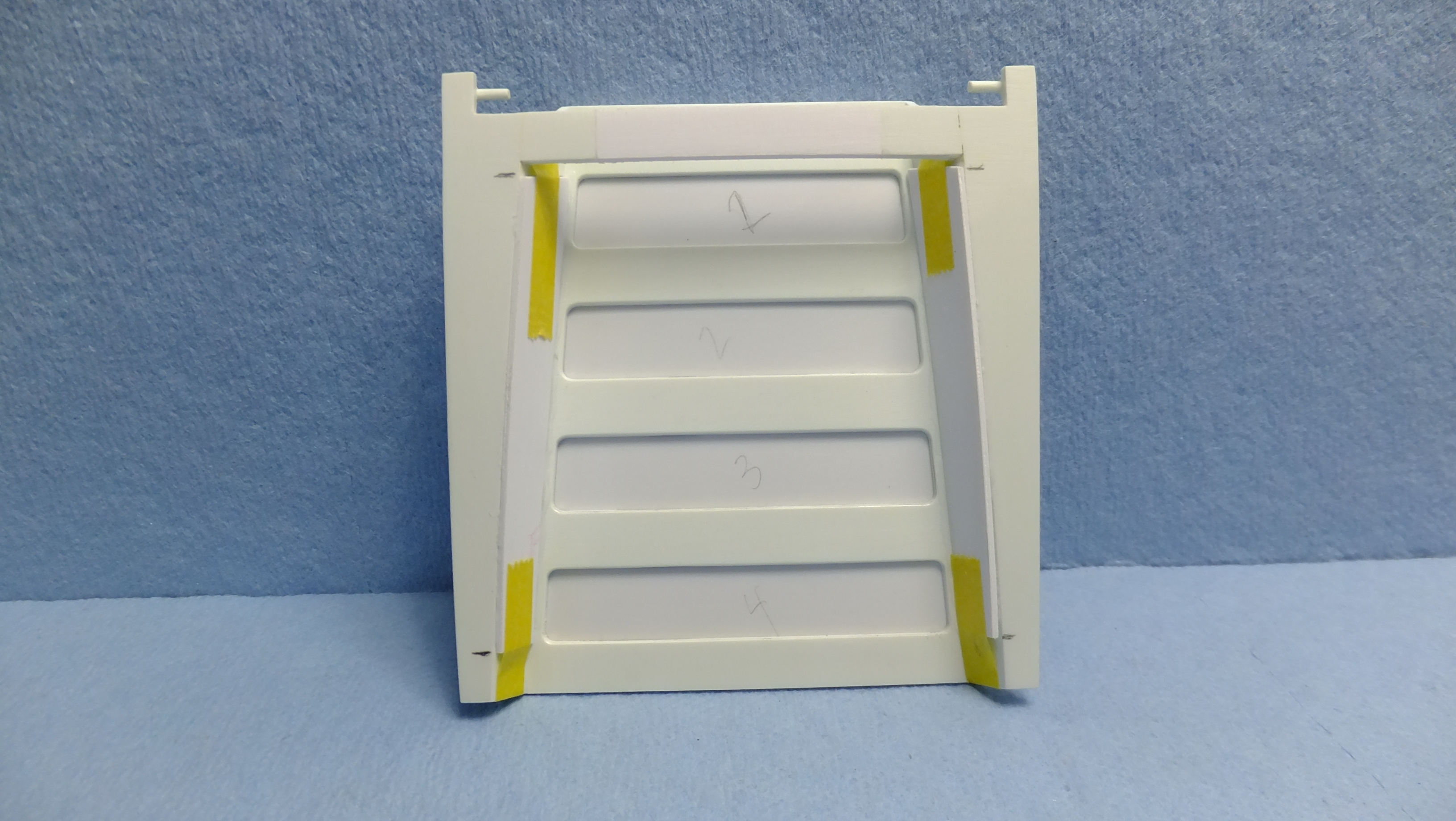

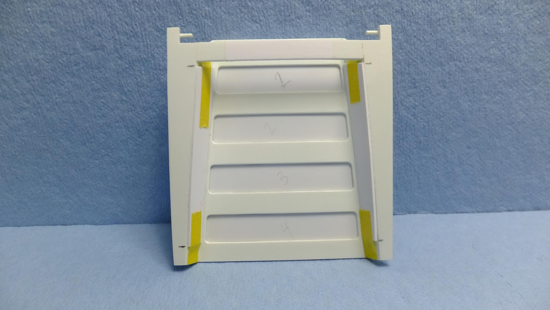

Dann Tier Posted February 12, 2019 Author Posted February 12, 2019 Before I made the ridges, I made a template of the openings to help me make these vent covers. First was to make strips that go half way across the openings, then make a full piece, and glue them together. With the top side facing down, I I scored the plastic twice, going half way through, using the half piece as a built-in straight edge. It was now time to carefully bend them up at a slight angle...about the thickness of the styrene. To keep it from breaking, or flattening out again, I used super glue to fill the cut -two applications.

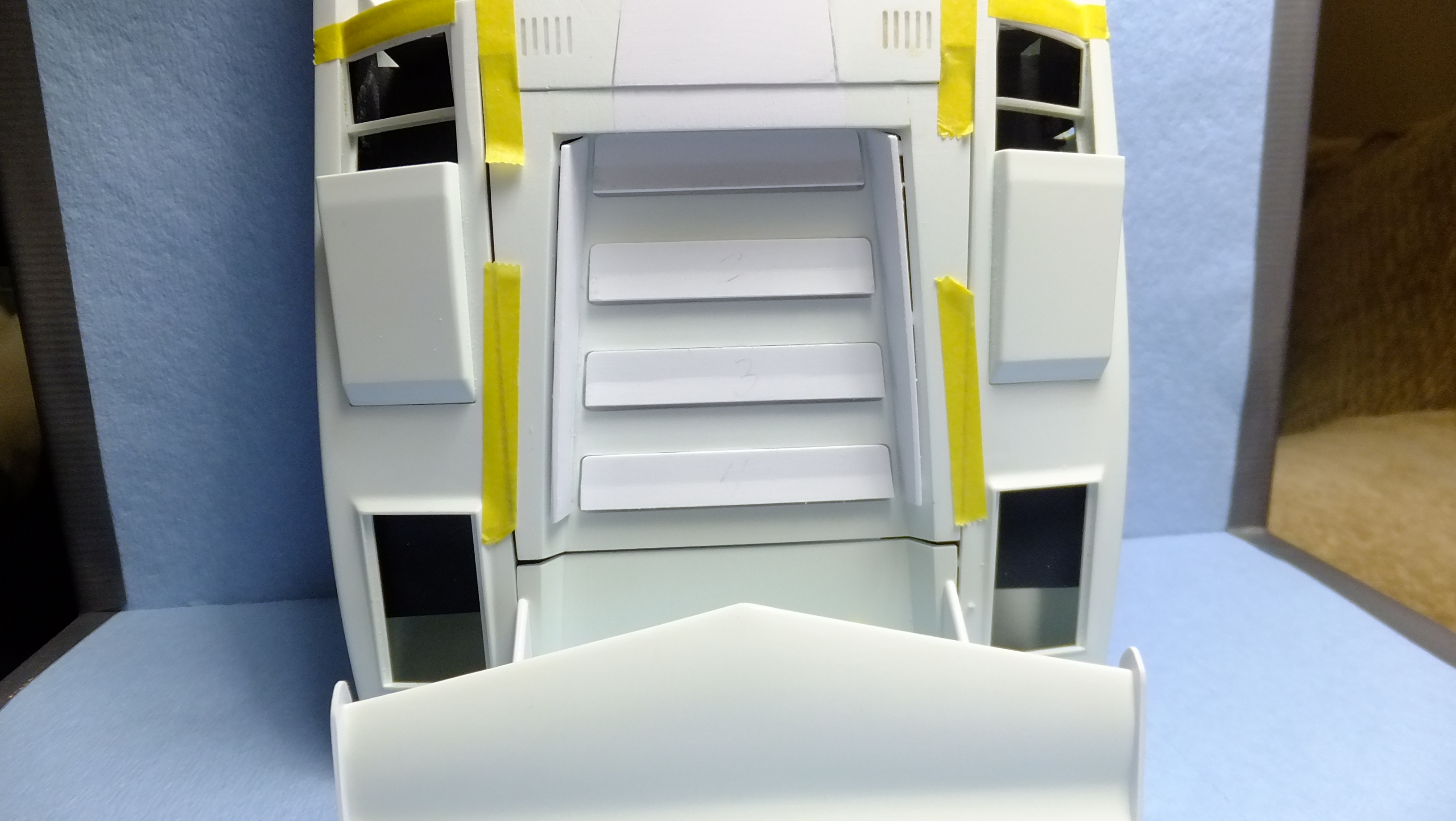

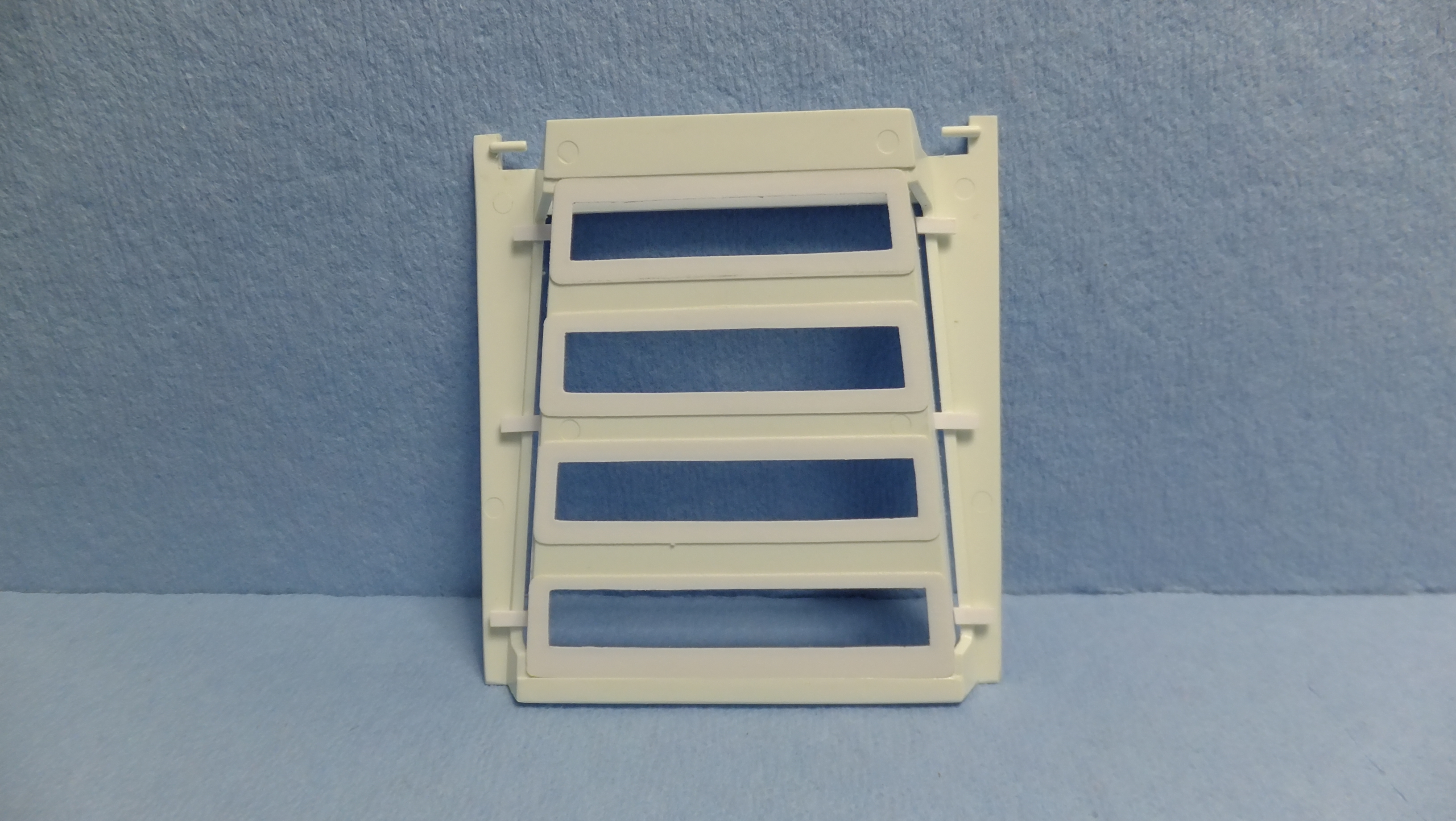

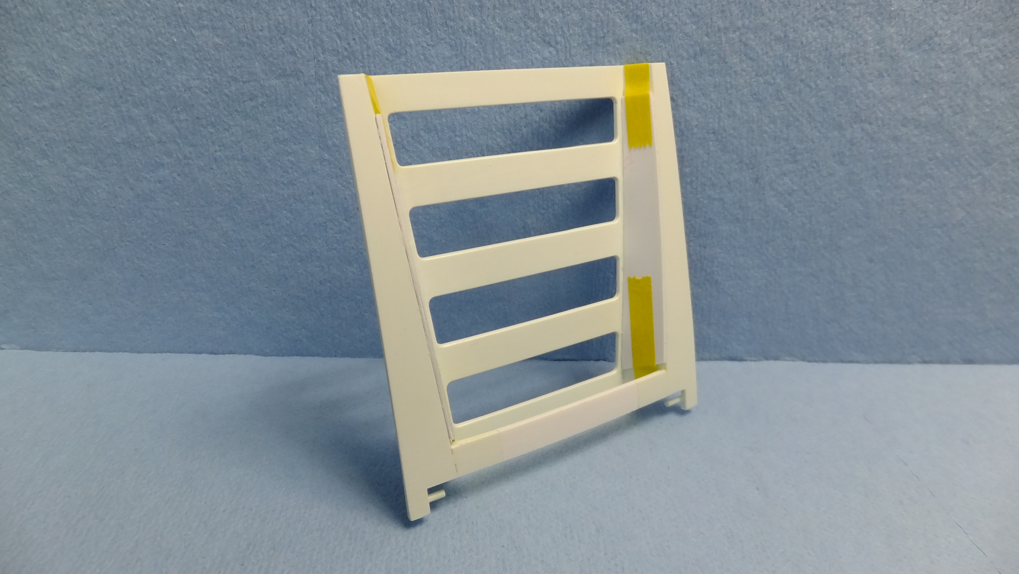

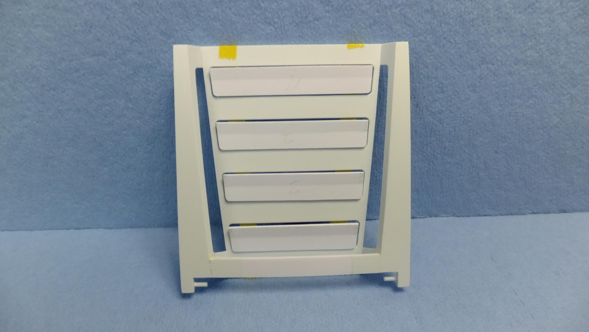

Dann Tier Posted February 12, 2019 Author Posted February 12, 2019 Heres the final test fitting, they will be glued down after the painting process, since the mesh needs to go down first.

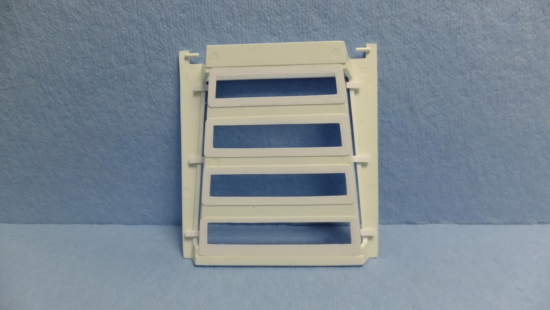

Dann Tier Posted February 12, 2019 Author Posted February 12, 2019 (edited) Time to finish off these side vents...First, I carefully used my Olfa blade to separate the top contacts, then removed the canopy glue residue. I then used rectangular styrene stock as the 6 spacers...only gluing them to the hood itself, NOT the sides of the vents. They will need to be removed, cleaned from all the canopy glue, and then glued in place. The side vents need to be blended in where they contact the hood. I will be sniping-off the excess on the spacers, when its all done. Edited February 12, 2019 by Dann Tier
Dann Tier Posted February 12, 2019 Author Posted February 12, 2019 Heres a loose test fitting of all the bits....i'm pretty stoked.

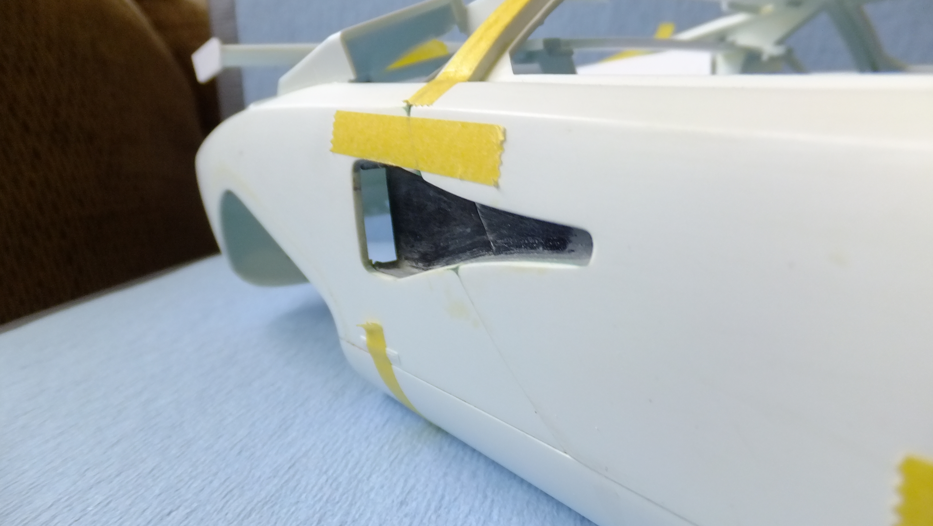

Dann Tier Posted February 13, 2019 Author Posted February 13, 2019 I'm quickly running out of things to change for the body....here's one of the last parts....correcting those shallow NACA ducts on the sides of the car!
