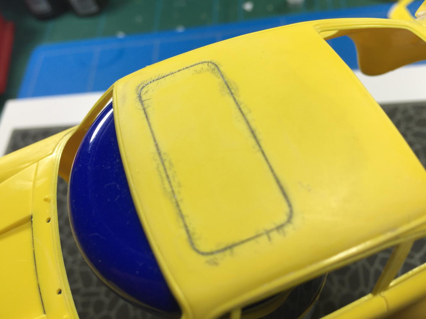

Tommy124 Posted September 26, 2018 Posted September 26, 2018 (edited) Hi folks, I'd like to start a WIP on this project. It's about this Fujimi kit: https://www.scalemates.com/kits/966180-fujimi-12450-porsche-911-carrera-3-8-rs Basically, I have started this kit already in May 2017. But gradually finding out about it's numerous shortcomings (more about that later), I put it aside for the time being. Some days ago, after finishing the Porsche 928 S, I opened the kit's box again and it clicked! So I decided to proceed with it. The first step I did last year already, is that I filled the panels of the sunroof. No Porsche RS ever came with a sunroof! I used styrene melted in glue for filling back then. I used this instead of regular filler because I heard that glue can help to prevent the appearance of ghostlines. Someday soon, we'll see if that's true... It does not look too nice but the surface is even and smooth as glass. There are quite a lot of aftermarket parts that I will use on this one. Nearly all of them are coming from Scale Production (SP), a German specialist exactly for these kind of things. Here are the parts: The 964 RS model comes with a different kind of rear bumper but the Fujimi kit has the regular Carrera one. So I cut that out and replaced it with a resin bumper part from SP: It took some sanding and filling with Plasti-Zap CA, but it worked out okay. The big rear wing has been fixed at this stage too: As can be seen, the wing needed filling as it's one part with the engine cover. On the lower side just aswell as the upper side: A little mock-up with the wing "board" fixed. I love that view! The Fujimi kit comes with molded-on door handles like this: Proxxon time! I also drilled 2 holes for the separate SP door handles to be fixed in later on: Like that: That's all for now. I hope you like my progress. Edited September 26, 2018 by Tommy124 1

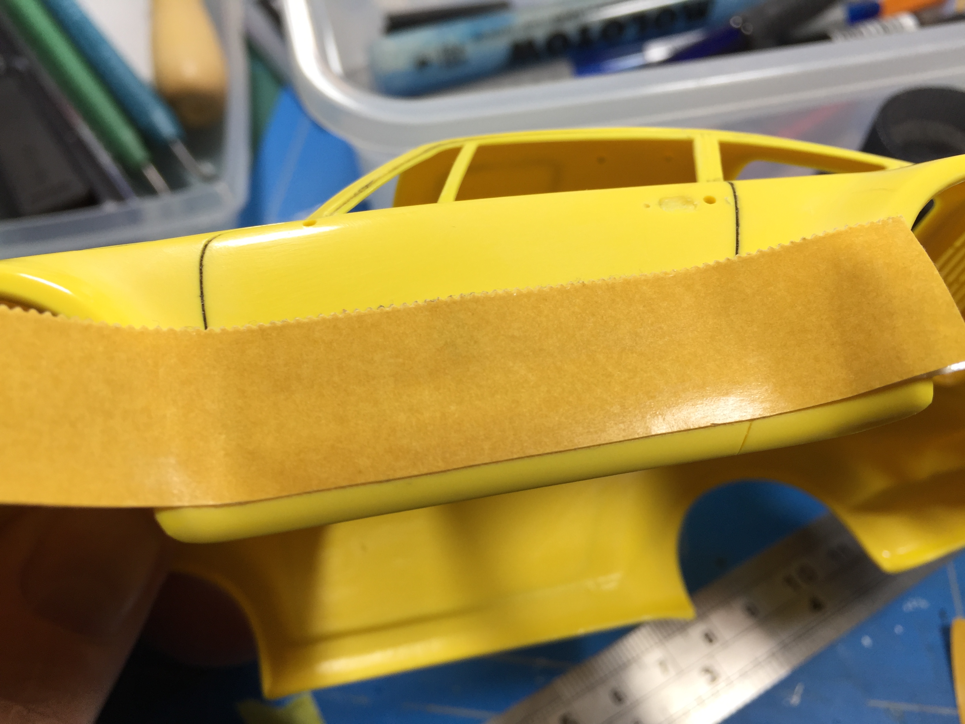

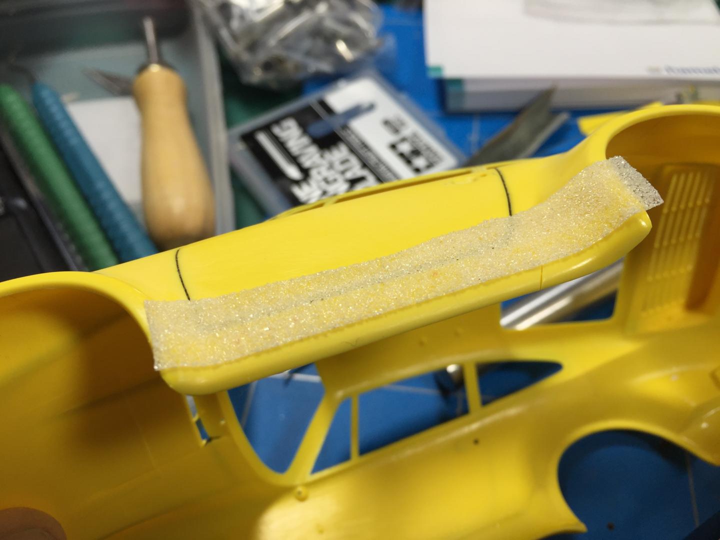

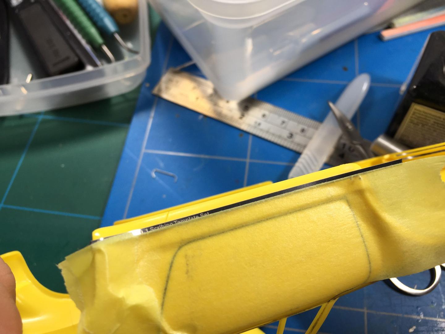

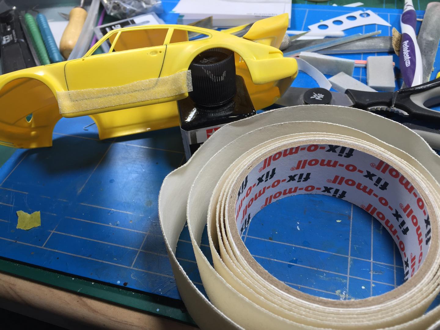

Tommy124 Posted October 2, 2018 Author Posted October 2, 2018 (edited) Okay... today I will post some images of myself having a hard time. I noticed that on the bottom of the real car there are some additional horizontal panel lines: As these panel lines are not done on the kit's body, I had to find a way of doing them myself, properly. The task was to find some kind of material that I could (temporarily) fix to the body as a "guide" in order to follow along with the scriber. The problem is, it has to be flexible enough in order to adapt to the body's curves but yet be hard enough not to move while scribing (in order to avoid uneven lines). These are some things I tried. Let me tell you, they all basically failed... Thick "fix-o-moll" tape (originally used for sealing windows) - too rough and uneven... Double-sided adhesive tape - too soft: PE part fixed to the body using tape - too unsteady. I even found myself trying to fix PE scribing templates to the body using white glue but that failed aswell. If the body was even and not curved, it would not be any problem at all, but this way... Eventually I managed to complete the lines using several more or less unsatisfactory techniques. I have not made any photos of that so far but will show the lines once the body has been primered. However, I would really appreciate any tips and tricks on how this can be done better. Be that on materials themselves or alternative methods, your feedback will be much appreciated! Edited October 2, 2018 by Tommy124

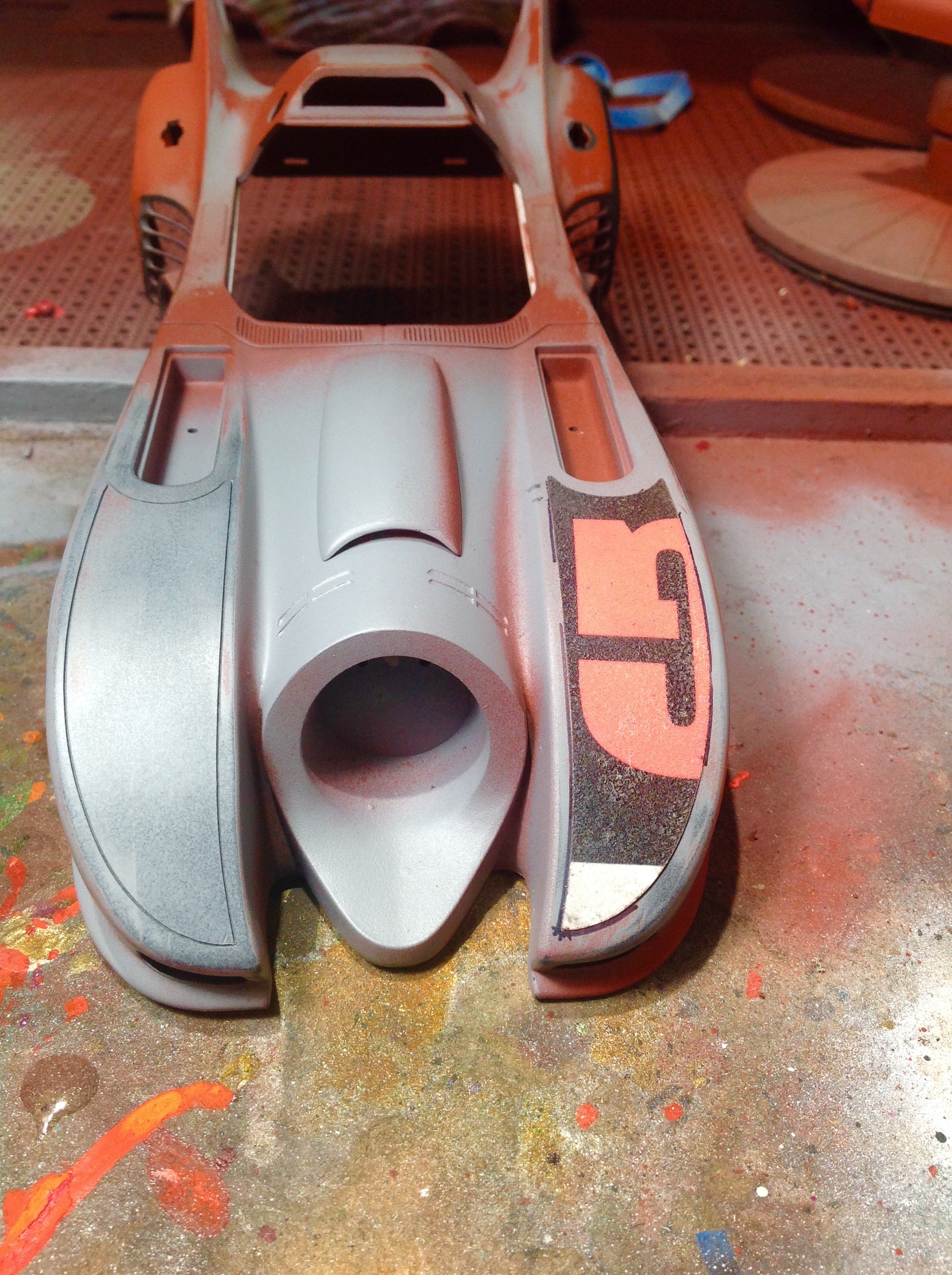

Rider Posted October 2, 2018 Posted October 2, 2018 Alex, I use 3M Super 77 Spray adhesive. Styrene card stock, 0.020" which is more then flexible enough while still providing a good edge. . The spray adhesive is only sprayed on the template then the template is placed on the body, it secures it quite nicely.
Matt Bacon Posted October 2, 2018 Posted October 2, 2018 Dymo labelling tape (the kind you used to have with a little handheld machine that you dialled letters into and clicked to emboss them in the coloured plastic tape so they appeared white). It works for single curvature surfaces very well and can be reused repeatedly. Not so good for compound curves because it doesn’t bend in two directions at once. For that specific problem, I’d stick the body shell firmly to a piece of glass or smooth tile, either double sided tape. Mount the scriber horizontally on top of a block of wood or plastic the correct height to move the cutting head along the body at the point where you want the line. Then just slide the block and scriber gently over the glass and the point will hit the body the same distance up from the lower edge all the way along. If necessary to get low enough down, start with a scriber blade or sewing needle to make the first guide line, then take the body off the base and use the regular scriber to cut the line deeper. best, M

Rider Posted October 4, 2018 Posted October 4, 2018 (edited) Thomas, when it is only sprayed on one object it is not permanent and removes without any additives, any residue left behind simply rubs off. I have painted 1:1 cars with the lace treatment found on low riders. I use this stuff for spraying the lace to attach it to the body of the car. It's only permanent if you spray both objects, then join them. It's actually contact spray adhesive. The instruction on the label used to state it's not permanent if only one object is sprayed. This is no longer included in the user instructions. Regardless, I have been using this product for close 15yrs for many projects. It clean up with turpentine which is not harmful to styrene, at least not for simple clean up. As also mentioned Dymo tape is a great solution too. This is something I also use for straight lines, you can find it on evil bay. Edited October 4, 2018 by Rider
