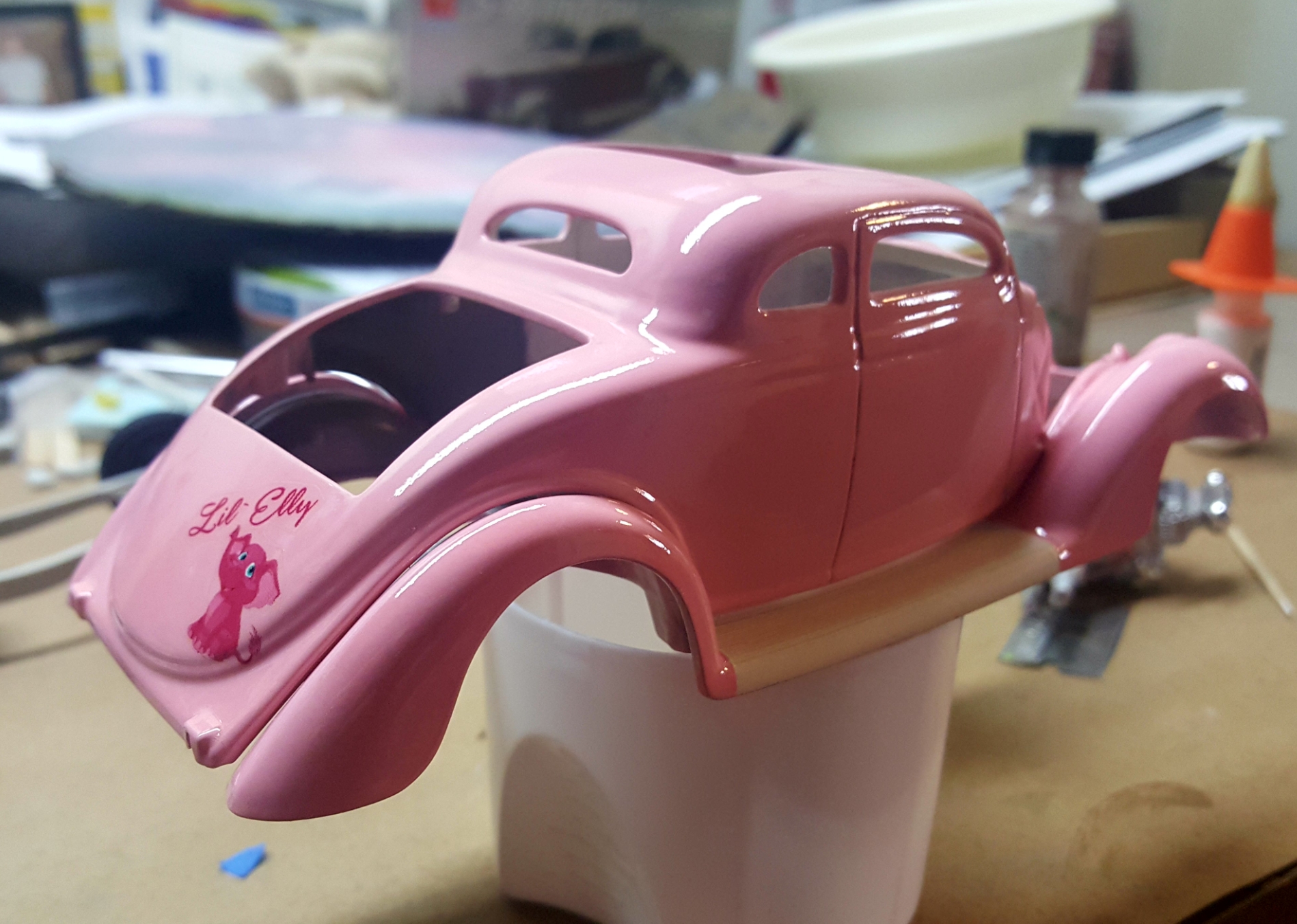

I have been working on the 36 but I confess It's taken the back seat to all my sorting and organizing. I wasn't to happy with the door lines maybe rushed the body work around the door frames...
My dingis cousin cut them away from the top so it's been a fairly comlicated chop and getin those back in place has proven to be nearly impossible... compounded by my perfectionist ways, I can't be satisfied. So in an effort to hide the "Jagged" door lines, I added a panel seperater wash... The color is light too to use a black wash so I'm trying to correct it at the moment...

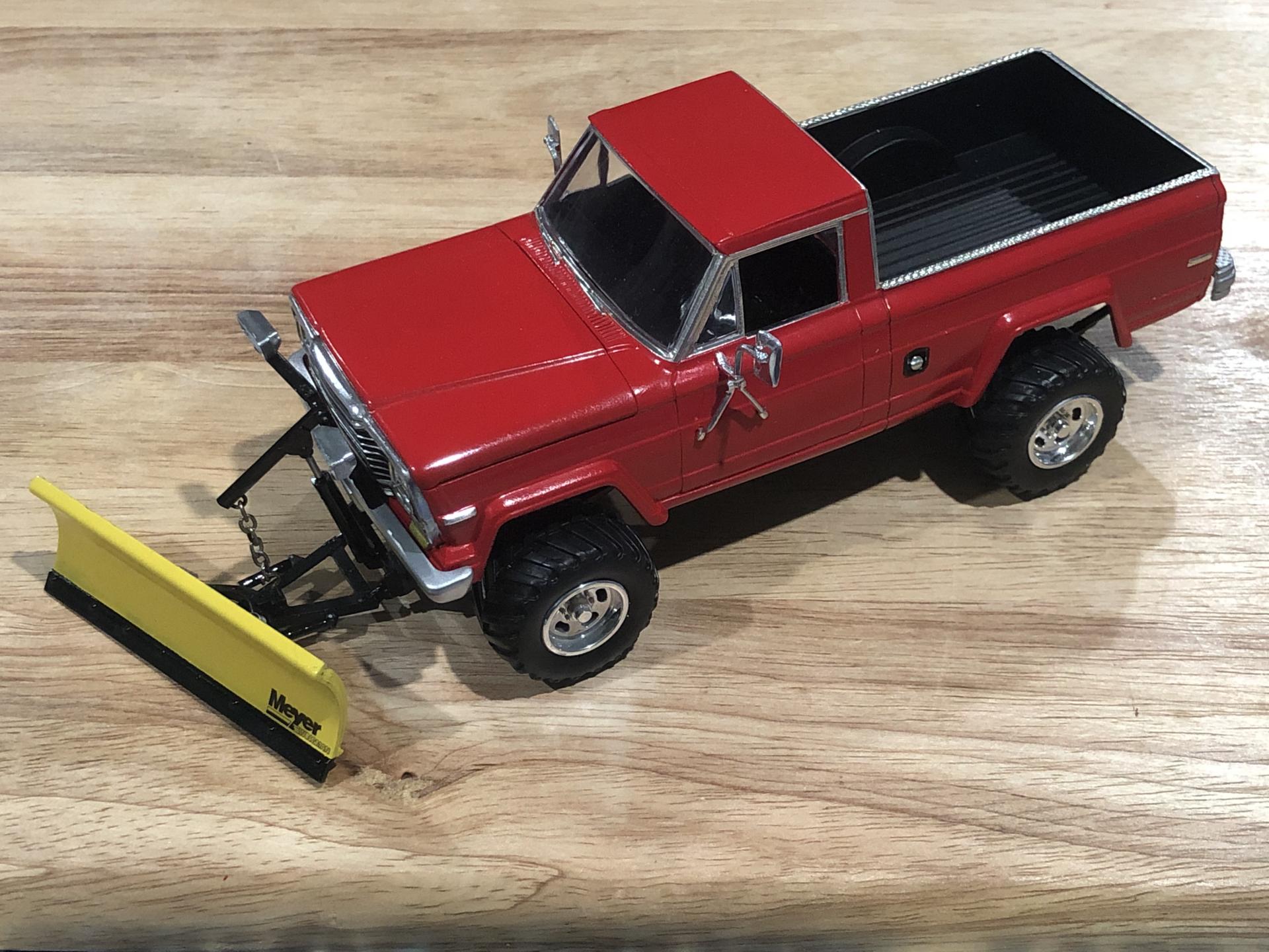

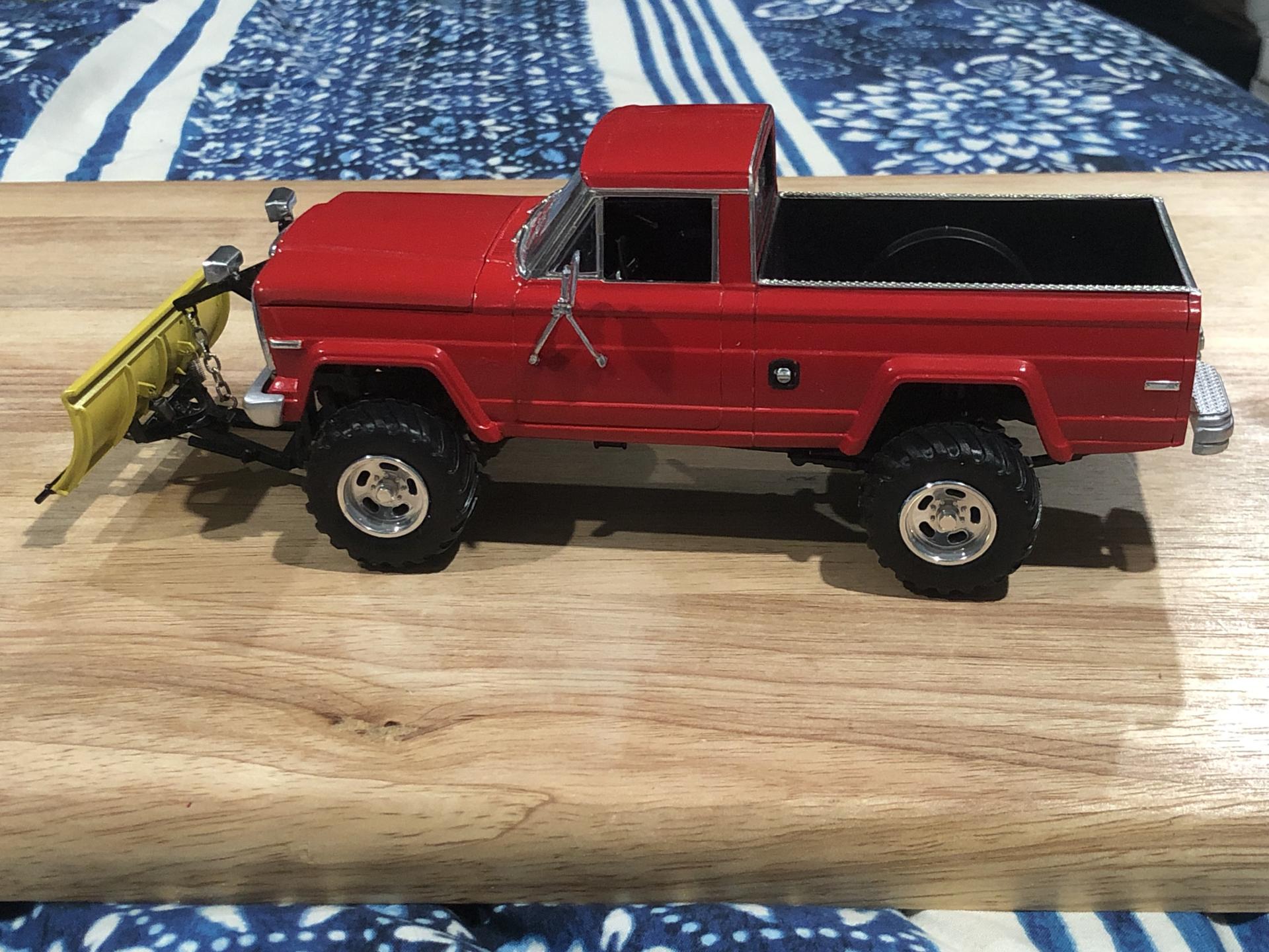

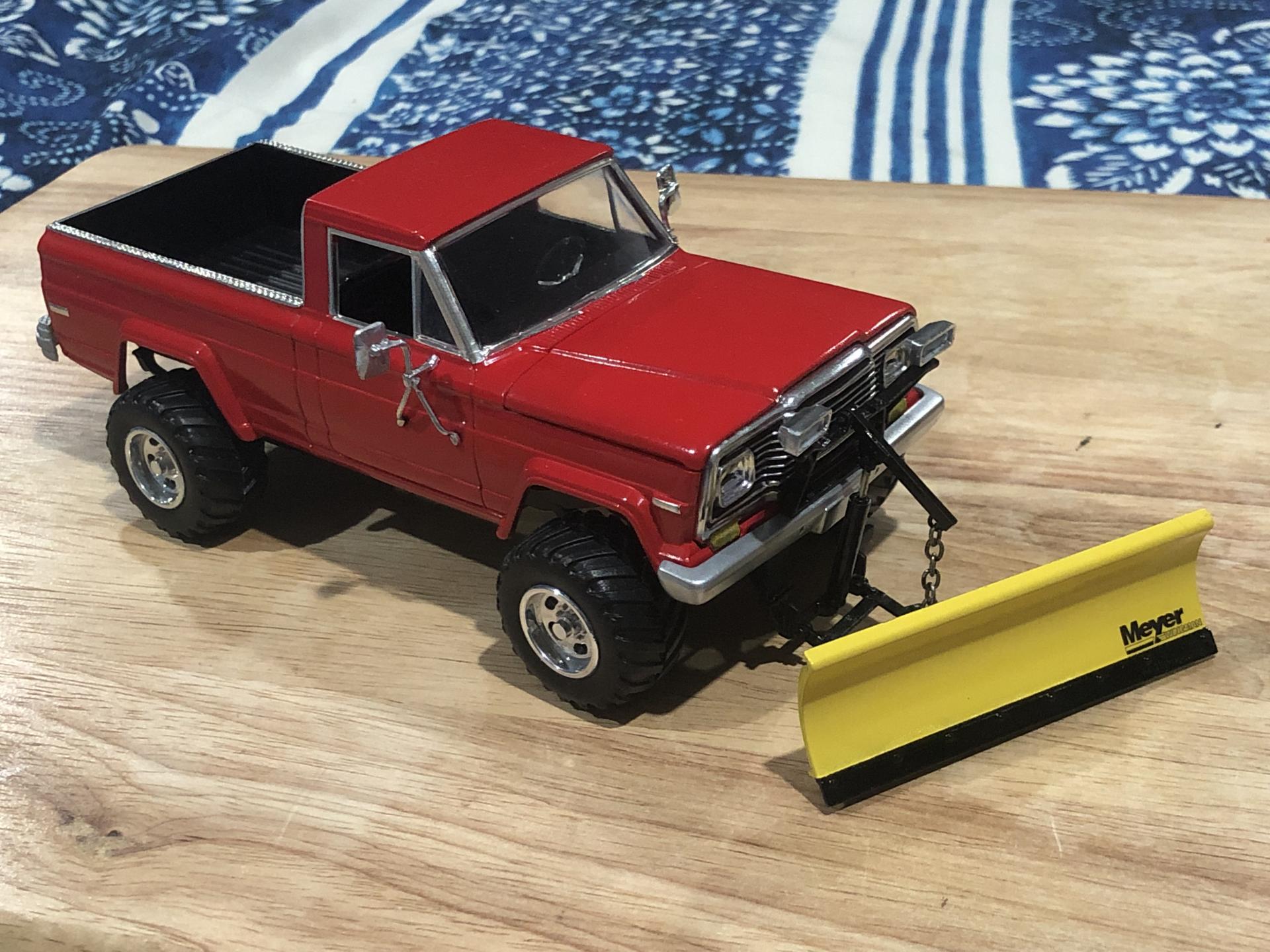

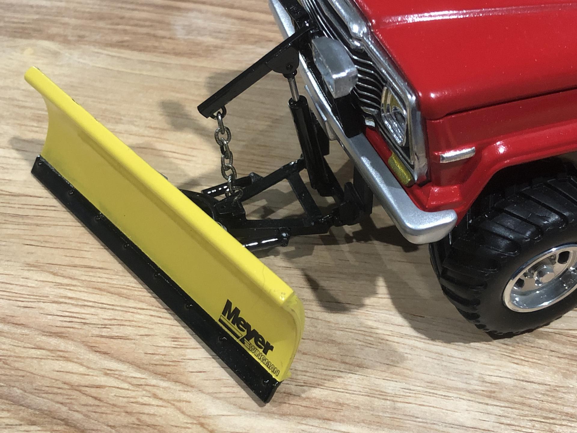

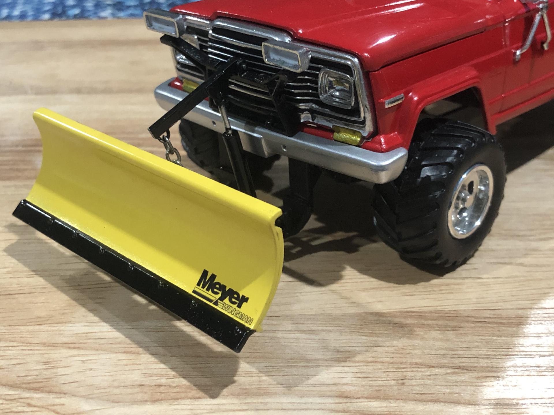

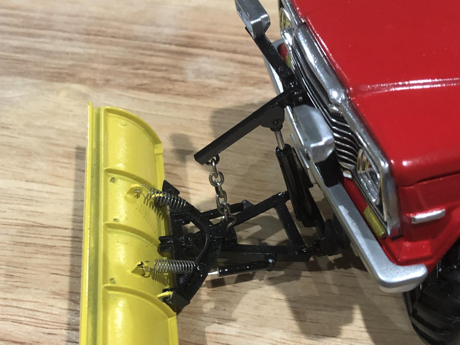

The Honcho is done!

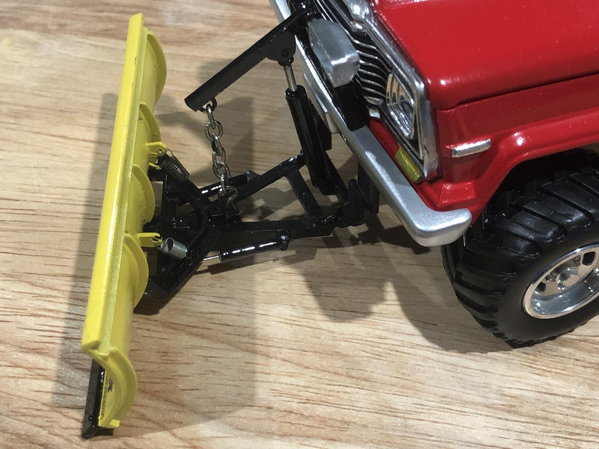

I’m very pleased with this one! It’s been a long time in my mind. It is just as I wanted and more thanks to a friend at work who suggested making the plow fully functional.
It pivots left and right, raises and lowers, and tilts forward. I wasn’t sure the springs would be strong enough to pull it back upright, but they do!
The tires are from a Matchbox Gravedigger and tje color is Duplicolot GM Torch Red.C18684C1-7489-4742-94BE-1C9875C5EB32.thumb.jpeg.88f41550d8648630b426ea7f8ab33db1.jpeg
All three pistons operate.

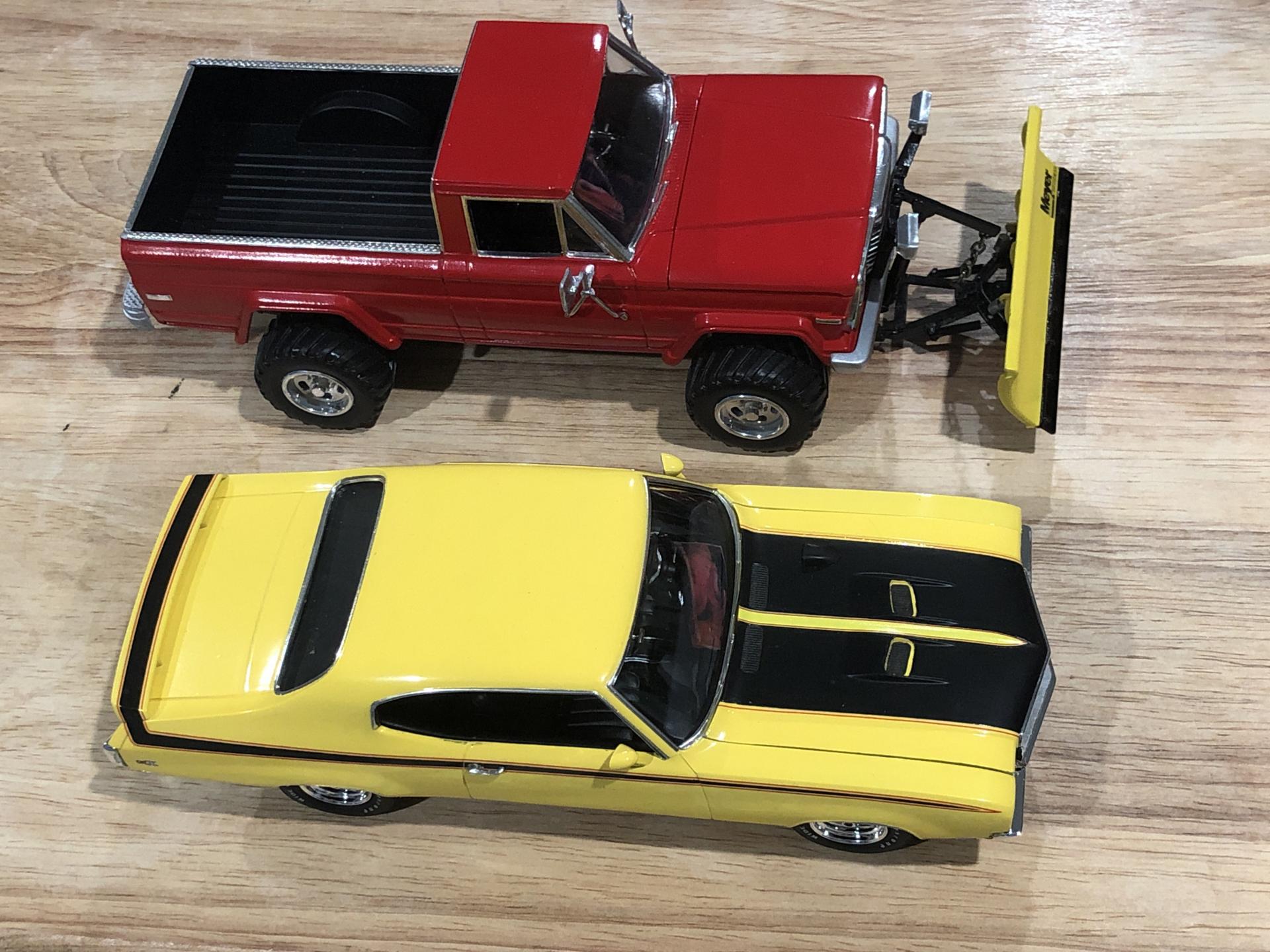

And here they both are!

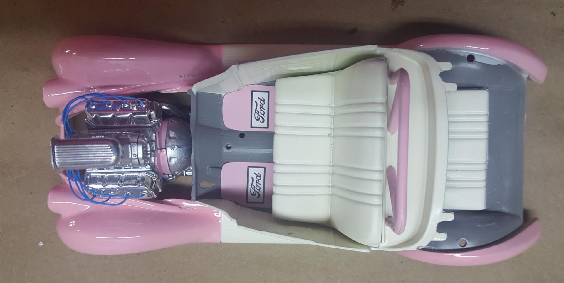

This is inspiring me to get my Ford done. I'm slowly trying to get it sorted out but I'm thinking at this point I'd be better off trying to get the 55 done... The front fenders were sawed off at the front running boards... At the moment I'm re-attaching that.
My cousin was really going down a bad road with this thing and I'm glad he stopped when he did...

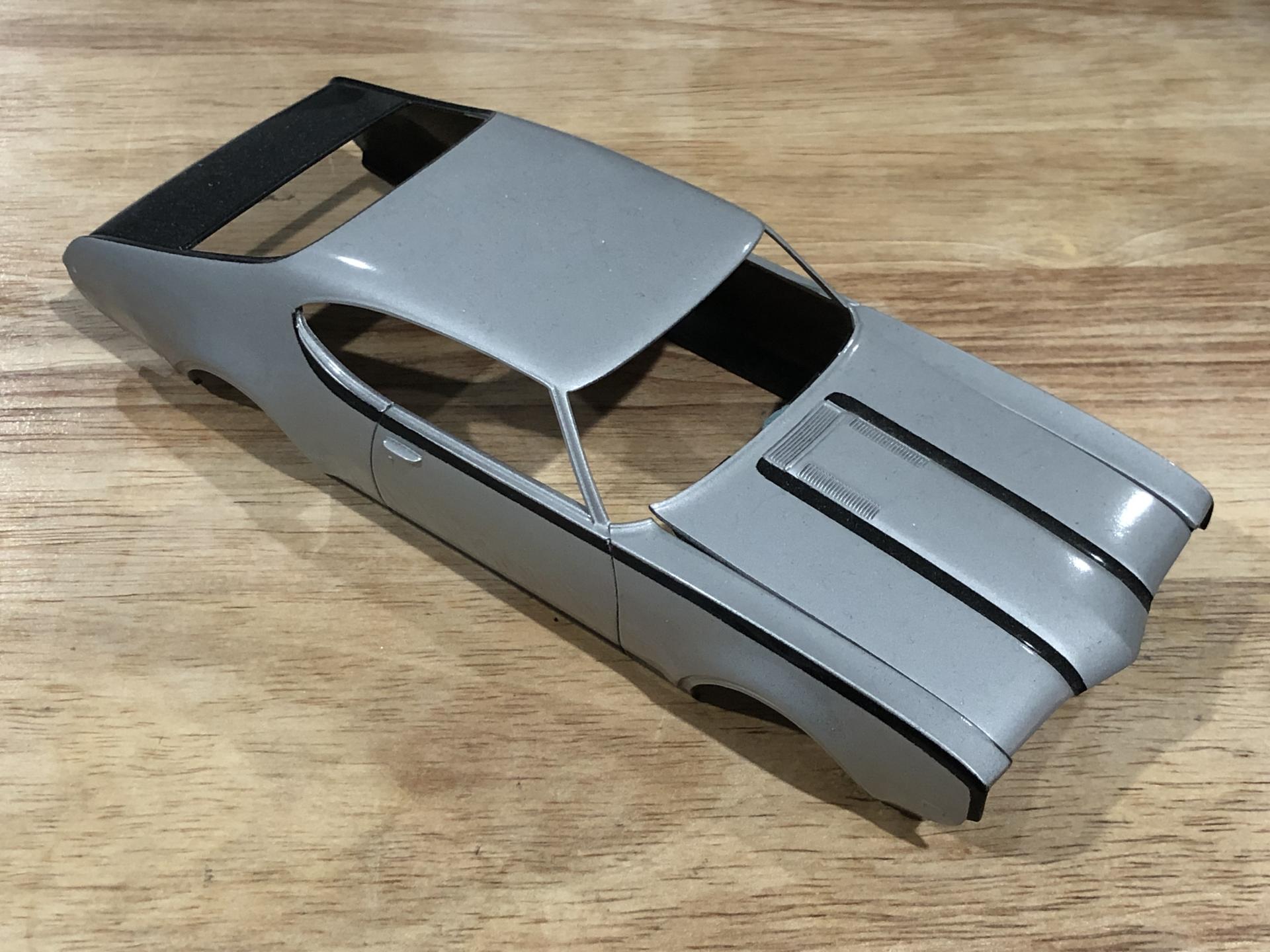

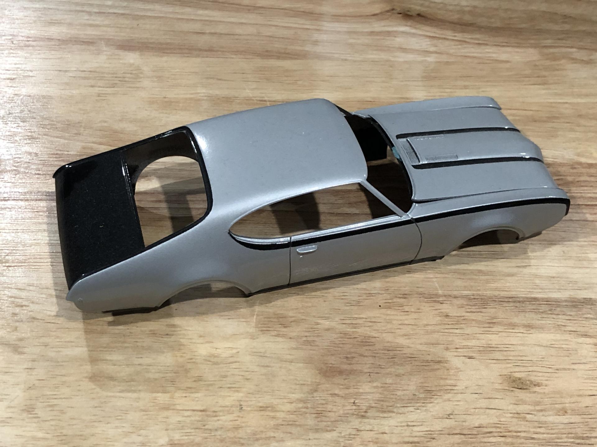

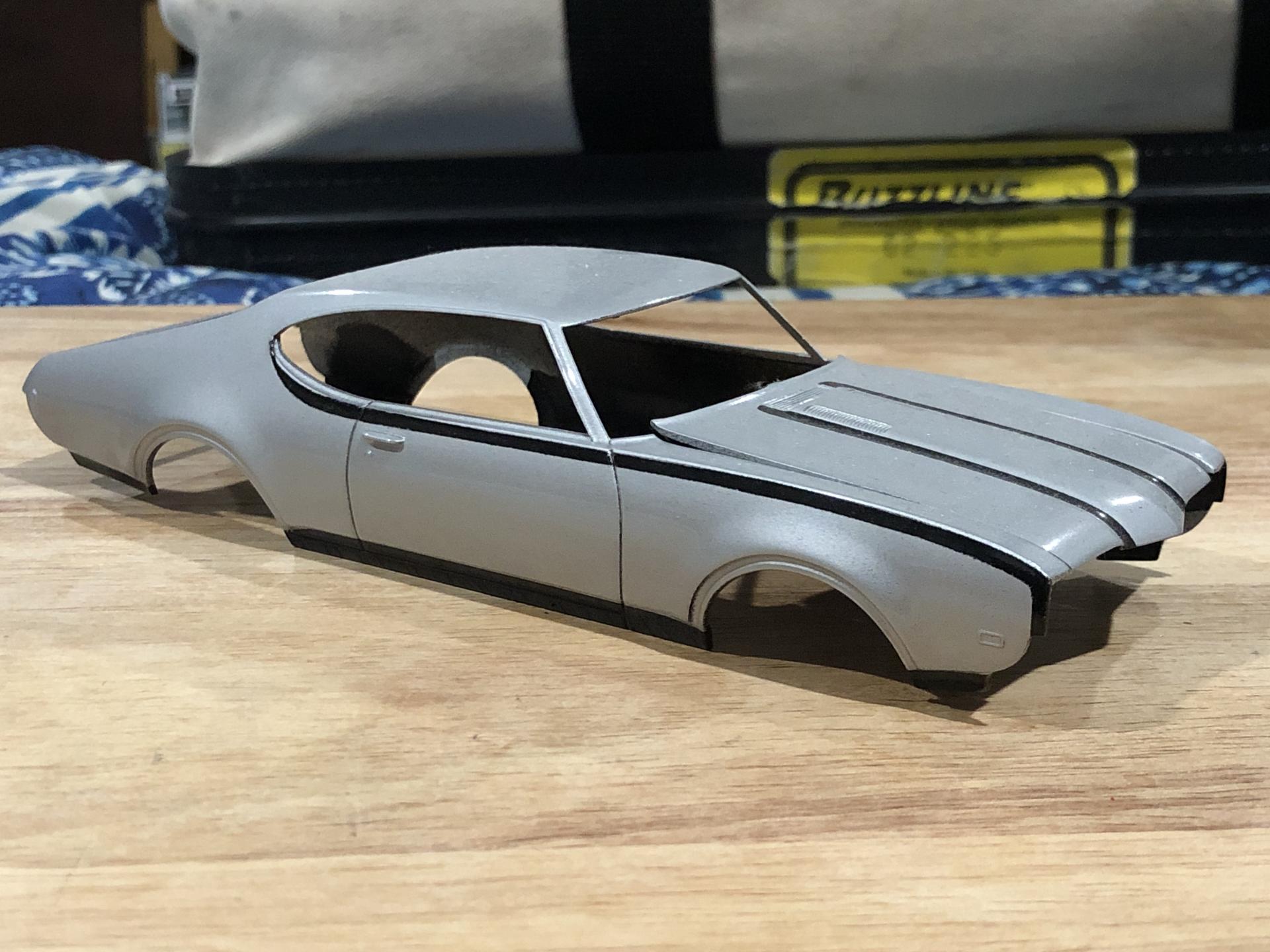

Six more weeks huh? How about I Git this one done?
Painted about 10 years ago. It’s always sitting on my bench.

Looks like the perfect candidate. What is it, a '68 Hurst/Olds? You delaring it? I'll add you to the list. GITTER DONE!
It’s a 69 with a Modelhaus 68 conversion kit. I have a 68 diecast that I’m wondering if the interior can be used ....

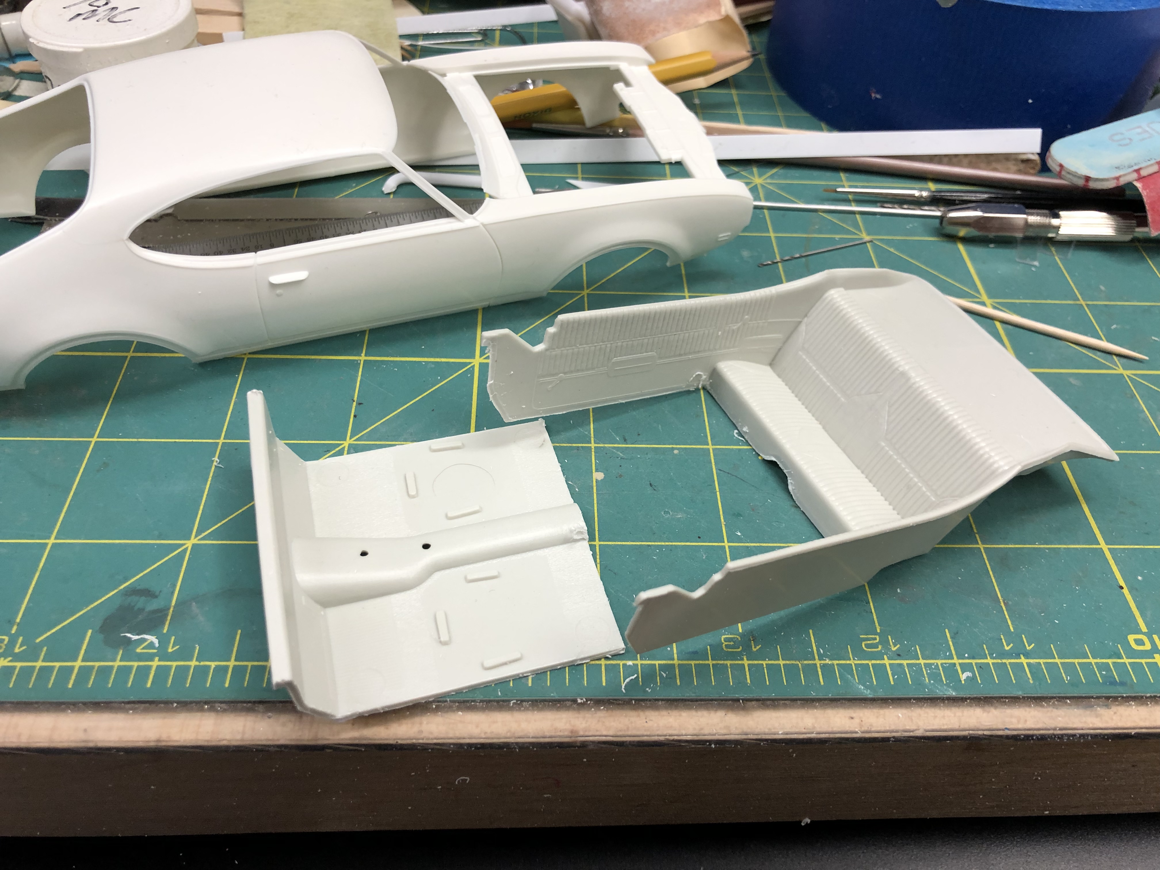

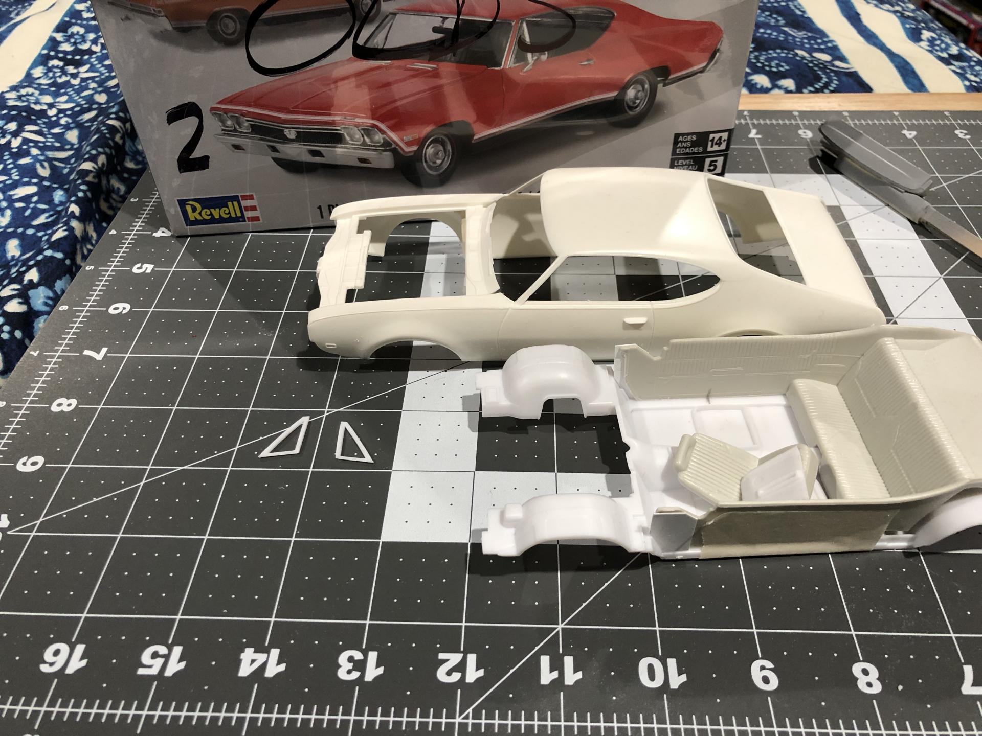

Never mind that suggestion. I just compared the 68 interior to the 69 and they’re identical. So I think I will just build the interior off the floor of the 68 Chevelle with the 69 parts. I’ll add door handles and armrest for extra visual detail since the 69 tub style interior is very flat.
Edited by Superbird McMonte

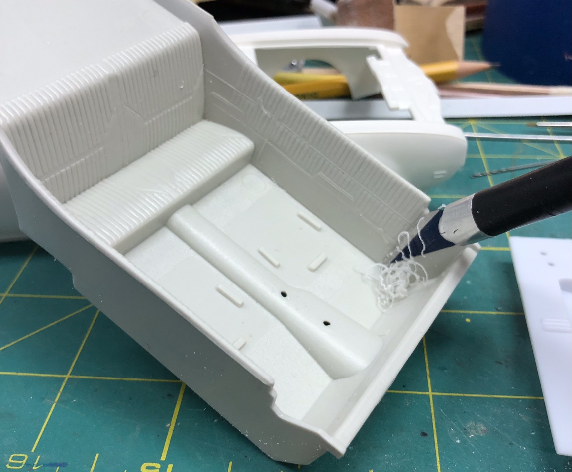

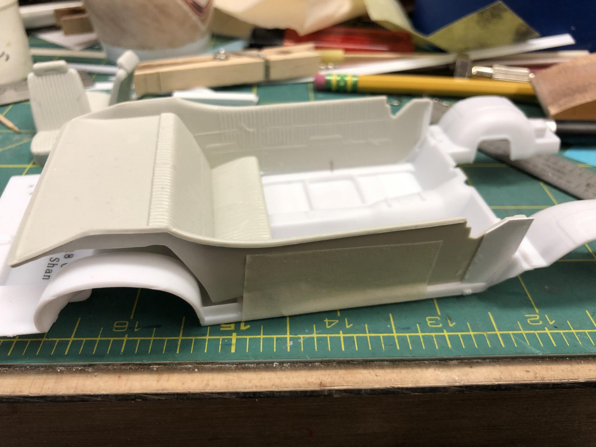

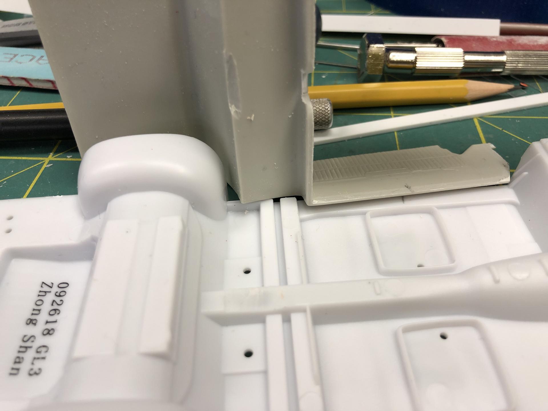

 I remove the floor from the Oldsmobile interior so I could use the rest on the 68 Chevelle interior floor boards.
 Take your time and work slowly, I think this will work perfectly.
 All I had to do to make everything sit properly was to grind the corner where the seat back and seat meet and the top of the driveshaft tunnel.
 As you can see here the door panels are sitting square on the floor. All I had to do was add a little material to the end of the kick panels. That will be painted black.
 Last night before went to bed I removed the door vent windows from the Chevelle. I trimmed them only removing what was not needed from the Chevelle and they dropped right into place in the Oldsmobile! No modifications necessary!
I did not mount them on the doors yet since this is just a mock up the body. The painted body is at work. Maybe tomorrow during one of my breaks I will install them.
