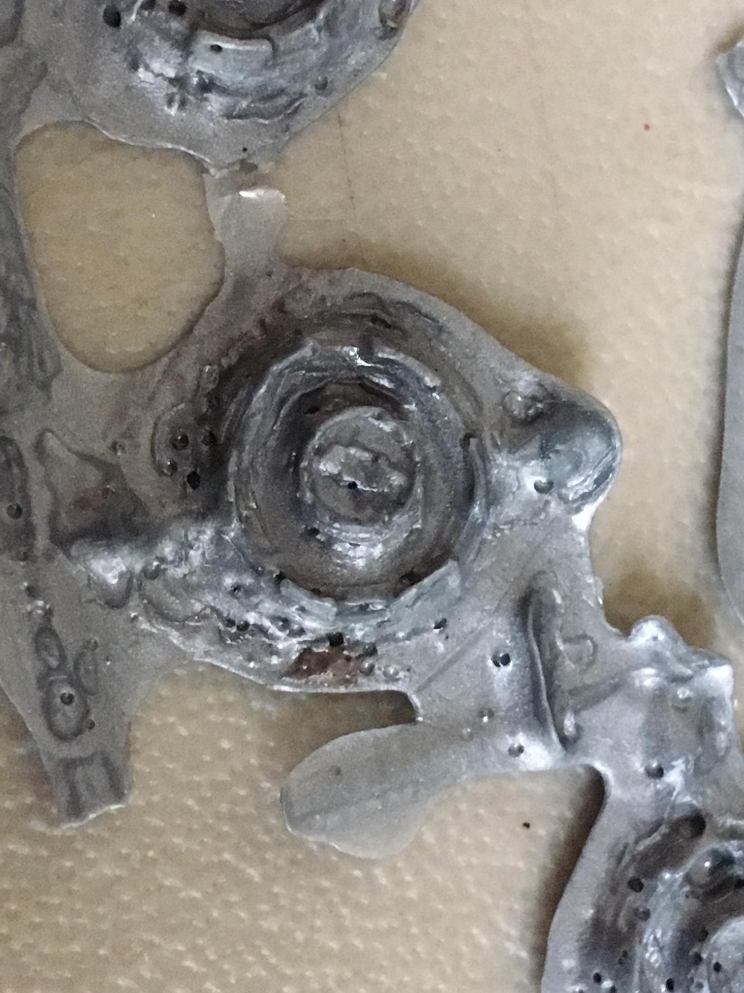

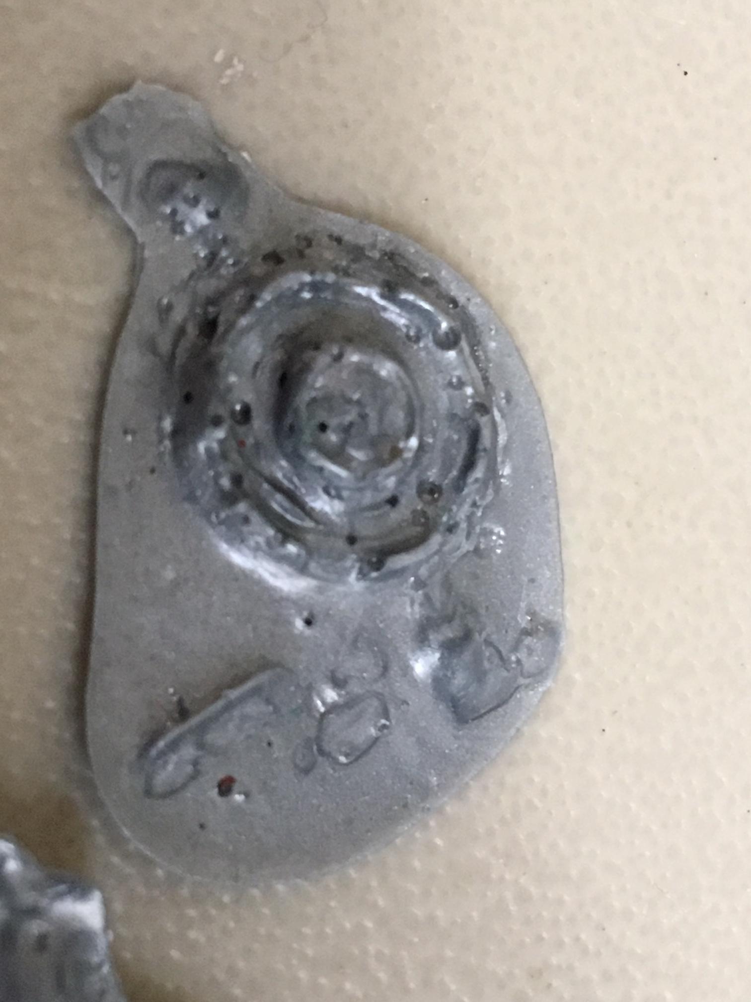

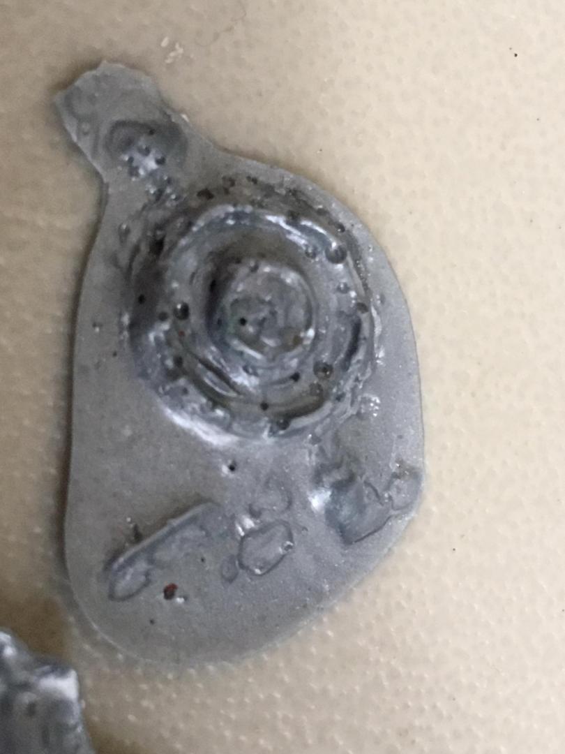

Oldmopars Posted December 9, 2018 Posted December 9, 2018 So, the other day I bought a can of MEK to use as a solvent to join styrene (AKA model glue). It "melts" styrene. This gave me an idea. I took some sprue and chopped it up into real small bits and put it in a jar with the MEK. I stirred it till it all melted. I now had "melted" styrene. I did not have modeling clay handy, so I used some silly putty. This is where the part failure came in, I did not know that Silly Putty reacts with MEK. However it did give me enough positive results to want to explore this further. I could only cast things like hub caps or other things that are one sided. The melted styrene needs to be exposed to the air to off gas, so I can't pour it into an enclosed mold. But, it shows promise for replicating small items. I could mold in 2 halves and glue together. This is no replacement for Resin casting or 3D printing, but could come in handy to make a replacement for a missing hub cap, valve cover, etc. I think I need to try this with Modeling clay, or some other non-chemical based clay. Something organic would not react with the MEK. Anyway, here is the first try with a silly putty mold.
Ace-Garageguy Posted December 9, 2018 Posted December 9, 2018 Don't really expect to get anything usable with "melted" styrene. The MEK is a solvent, and as it dissolves the plastic, which goes into suspension in the solvent, the mixture's volume increases over what the original volume of the plastic is. Obviously. So, when it "dries", the MEK solvent evaporates back out, the part shrinks by a rather large percentage, and will most likely also warp because of uneven evaporation for any number of reasons.
Snake45 Posted December 9, 2018 Posted December 9, 2018 I experimented with this a couple decades ago and found it just didn't work very well. There are better and easier ways to achieve the desired results.
Oldmopars Posted December 9, 2018 Author Posted December 9, 2018 I am aware that this would never work for anything of any size. But, for a small part it may work. Making a mold out of silicon and casting it is a fair bit of work for one small part. I am hopeful that this could work for real small parts and be faster and easier. If nothing else, it will be fun to play with. Only loss is an oz. of MEK and some old sprue. I have plenty of spare time.

peteski Posted December 10, 2018 Posted December 10, 2018 Like Bill said, the solvent which makes styrene liquid has to evaporate in order for the styrene to solidify again. Regardless of how small the part being cast is, there will be shrinkage, pinholes, etc. Not really work the effort (unless mediocre-quality parts are what you are after).

Ace-Garageguy Posted December 10, 2018 Posted December 10, 2018 A little applied science and striving for repeatability would be good if you really want to try to make this work...which I believe at this time to be not likely. To control part-quality-destroying shrinkage, you'll need to determine the absolute minimum amount of solvent required to liquefy a given mass of styrene scrap. Accuracy matters. For instance, if you get something like a 20% volume increase with the liquefied material, you can, of course, look for a 20% shrinkage rate when the stuff dries. So, in that case, a mold that's made from an existing part would produce a copied part that's 20% smaller than the original in overall volume. Not really acceptable (and this is why tooling for many metal-casting processes is made larger that the desired finished part...to compensate for shrinkage). On the other hand, if it's only around 5%, you might get away with making small parts.

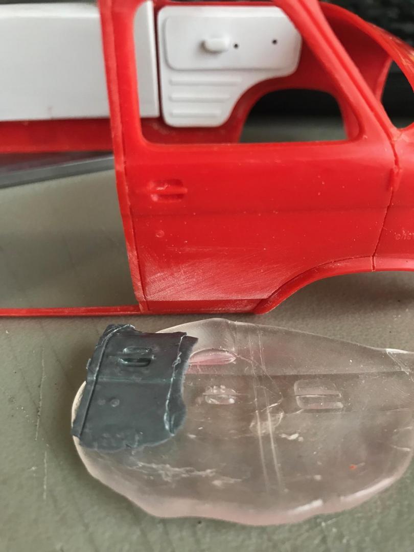

Oldmopars Posted January 9, 2019 Author Posted January 9, 2019 Well, more playing around. I got some of that molding polymer that you melt in hot water and form around stuff. (See Blue Stuff). I then used my melted (In MEK) styrene and molded a new door handle for my Van, I am changing the sliding door to a pair of singing doors and needed a new style handle. It worked very well. I poured in a large amount of styrene so that as it set and the MEK left, there would be enough left for my handle. It worked great. I let it dry for a day and now I have a very nice styrene door handle. I know this does have limited uses, but this worked for me. I also cast the same thing with Epoxy and now with Superglue/CA. Going to see what one I like the best.

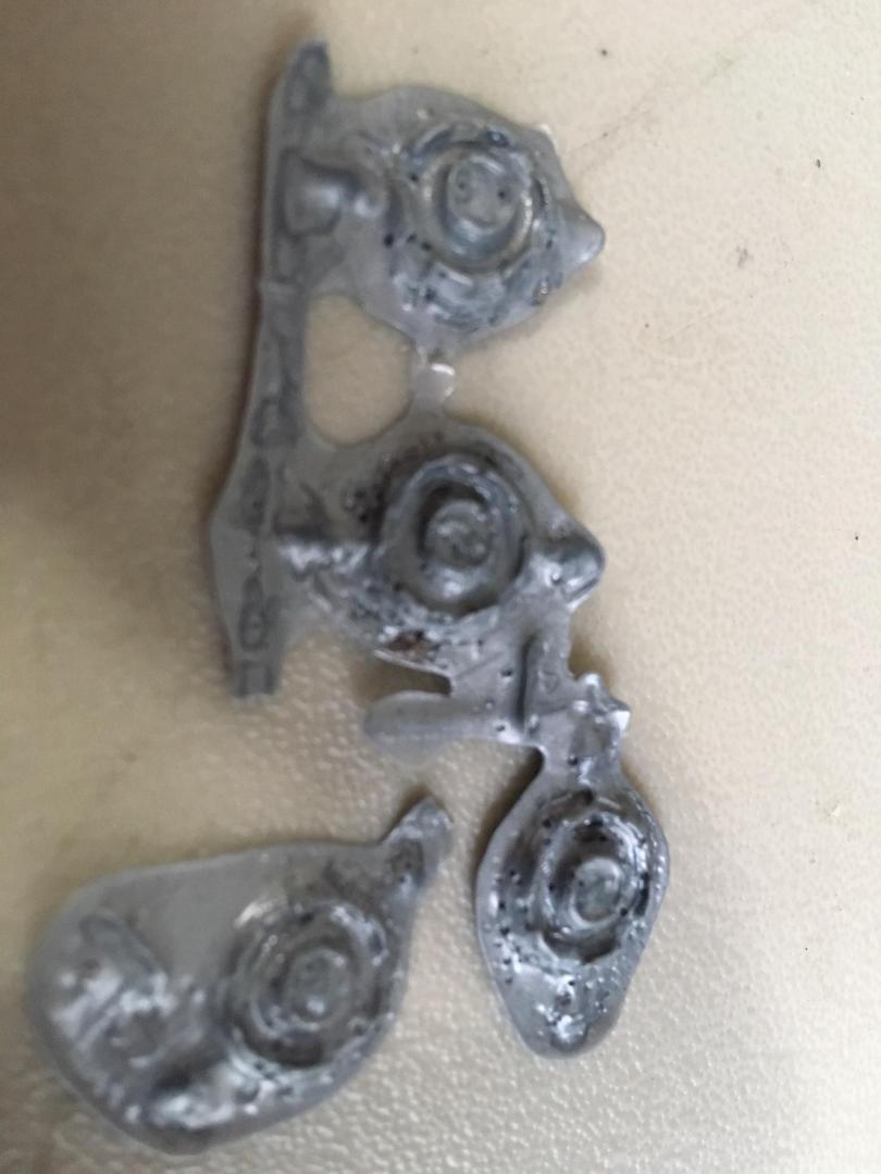

68shortfleet Posted January 9, 2019 Posted January 9, 2019 I too have experimented with this. I am using Evergreen stock melted into Tamiya ultra this glue. I made my mold from a half used leftover tube of Permatex blue automotive RTV cause I had it laying around. I started with something simple. This is the fan from the Revell 32 Ford kits. On the left is the kit piece, on the right is my first part out of the mold, not really useable in my book, in the middle is the second part out of the mold, this is a pretty decent part and showed me that this is possibly a viable method for a one off part. Your not gong into production with this.
Oldmopars Posted January 9, 2019 Author Posted January 9, 2019 On 1/9/2019 at 10:32 PM, 68shortfleet said: I too have experimented with this. I am using Evergreen stock melted into Tamiya ultra this glue. I made my mold from a half used leftover tube of Permatex blue automotive RTV cause I had it laying around. I started with something simple. This is the fan from the Revell 32 Ford kits. On the left is the kit piece, on the right is my first part out of the mold, not really useable in my book, in the middle is the second part out of the mold, this is a pretty decent part and showed me that this is possibly a viable method for a one off part. Your not gong into production with this. Expand I came to the same conclusion, I wanted a way to replicate just one part without a huge hassle. I have found that the Epoxy was a little better in some ways, but requires I use CA glue to put things together. I would never try to replicate a large item, or a large number of items this way. But, it can be done and it does work in a very small scale.
68shortfleet Posted January 9, 2019 Posted January 9, 2019 I have also done the stock-ish firewall from the Revell 32 Ford Rat Roaster kit. I didn't have as good of success with it. I have a useable part, but did get a little(very minimal) shrinkage as some mentioned would happen, but I also got a little bit of warping that would be easily fixed once its glued to the car body. The bigger problem I had was pin holes throughout the part. Haven't found a way to overcome that with liquid styrene. However, I do believe that any of these small molds that I have made would easily accept resin also. Which should produce a better part.
Ace-Garageguy Posted January 9, 2019 Posted January 9, 2019 I have to give you guys credit for getting better results than I believed you really could. Not show quality, but a LOT better than I'd expected. Nice job of perseverance.
