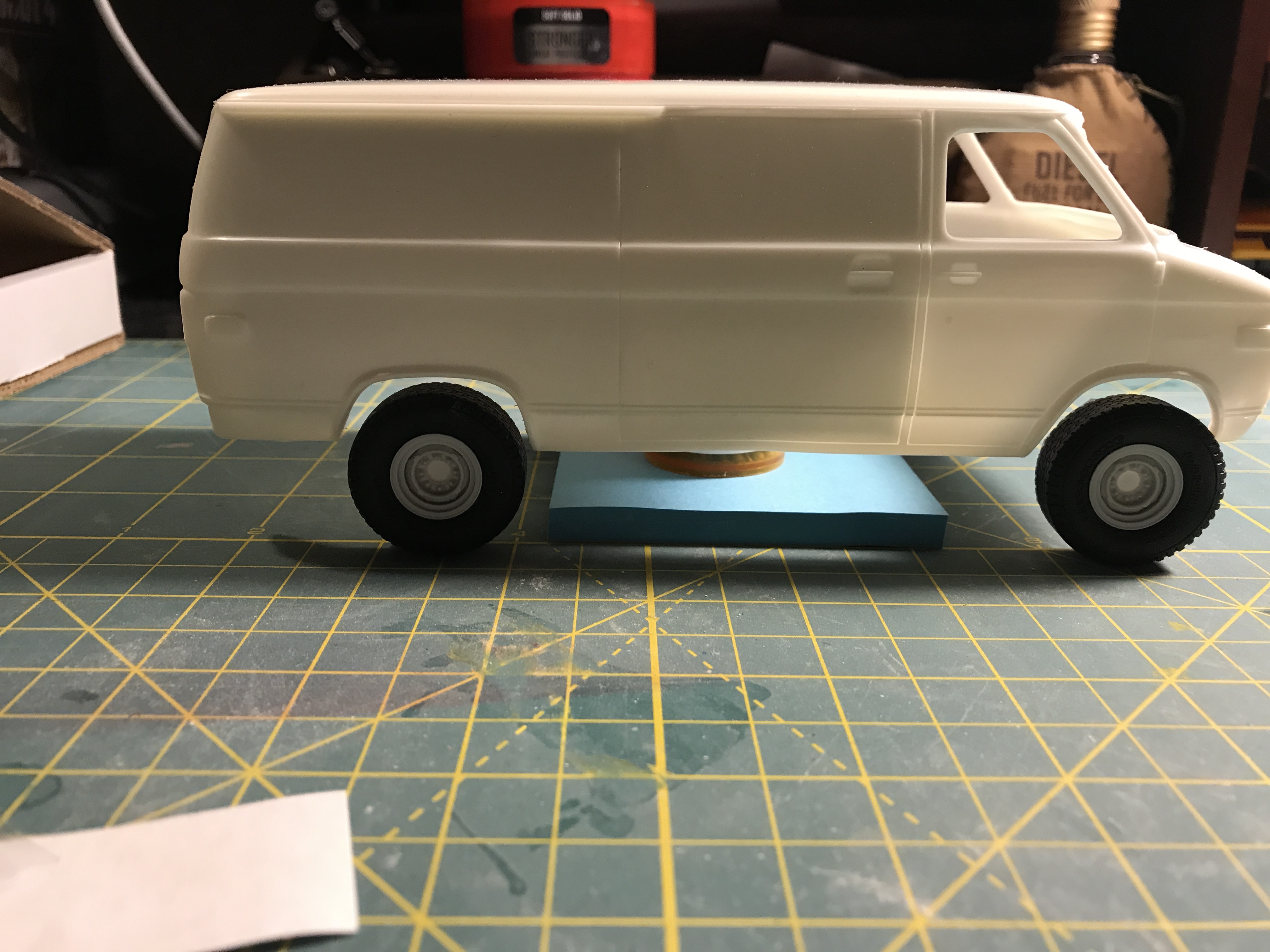

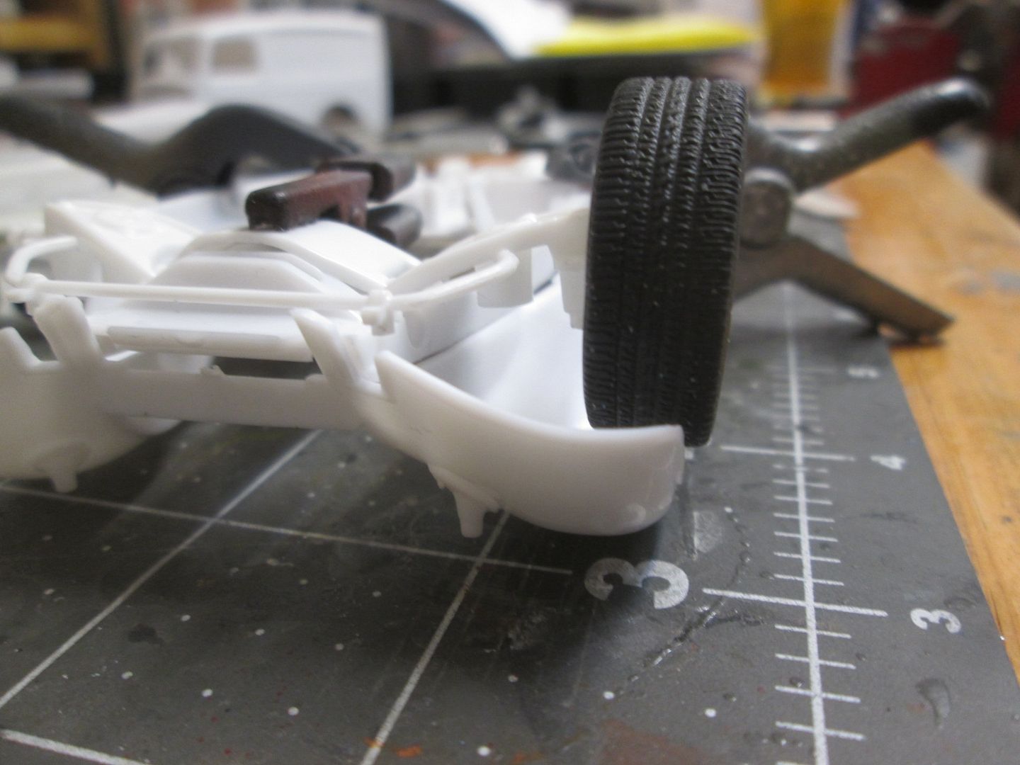

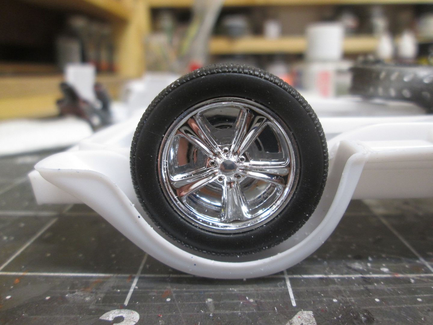

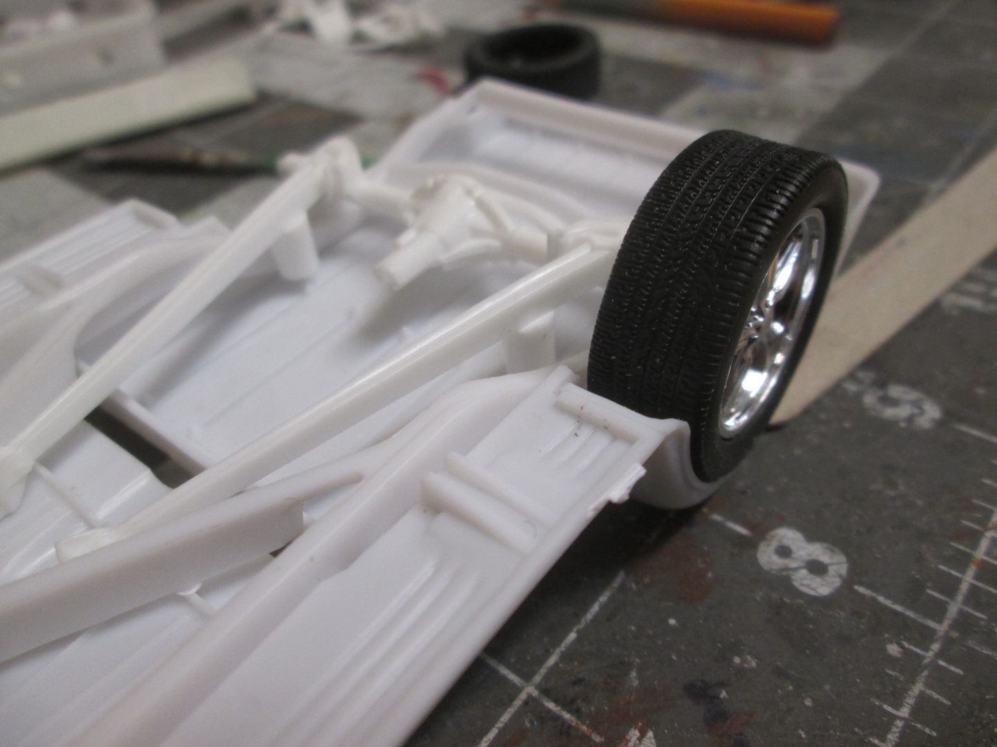

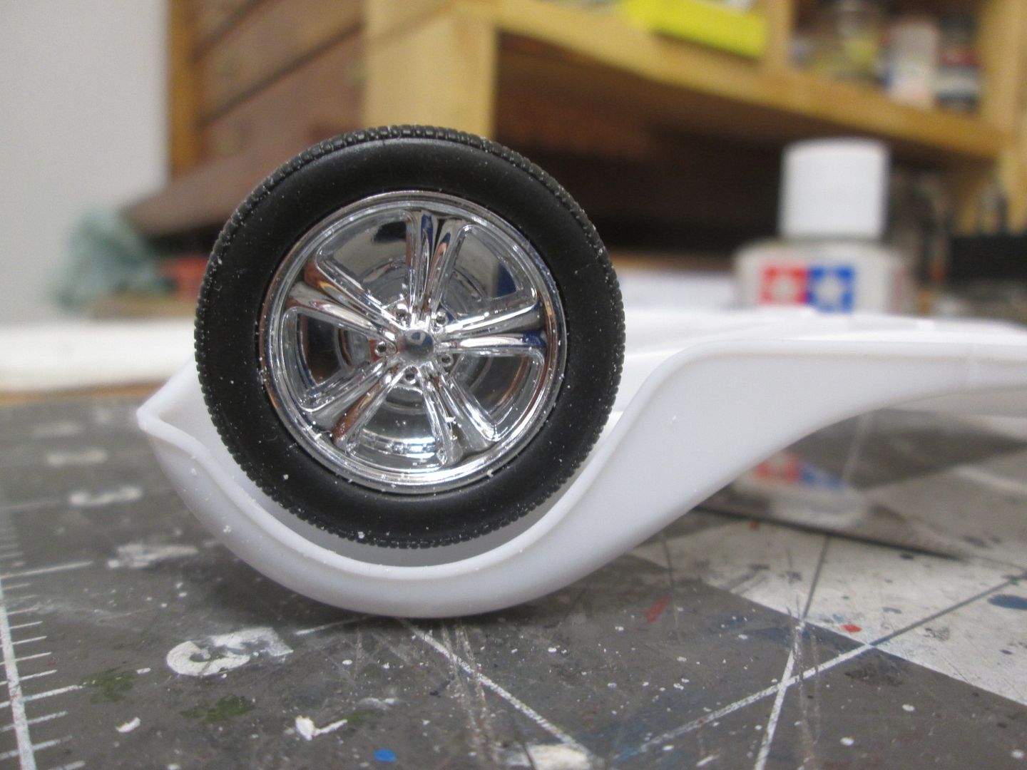

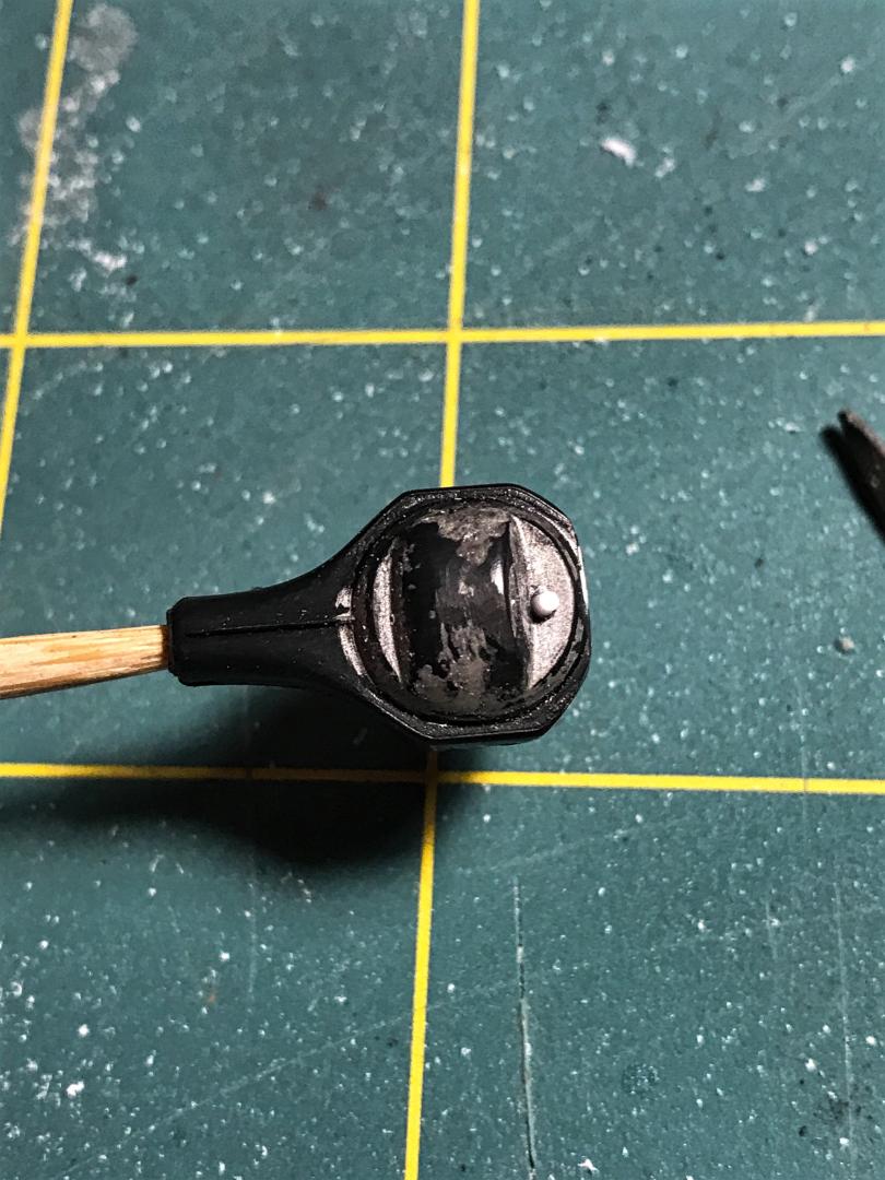

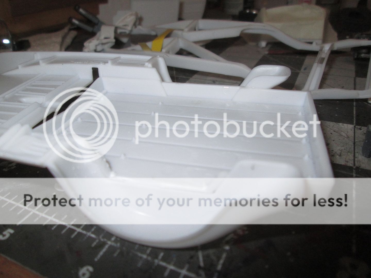

DPNM Posted January 20, 2019 Posted January 20, 2019 (edited) I have been working on the Amtronic, I try to do at least something everyday. Spent a lot of time just sanding the body for paint prep. I used 400 grit wet or dry, sanded dry, to knock the sheen from the plastic. I started to fab up the center console, I made a mini fridge and I was able to strip most of the flat black from the engine. I've reached a snag. The low profile wheel/tire set that I was going to use isn't large enough in diameter. The rear squats too low with the front tires in place. I have an ad in the truck trade section but this is what I need: I am looking for a complete set of pickup on road tires, with the inner and outer wheels.I prefer something a bit wide but beggars can't be choosers. I need the tires to be somewhere between 1-1/4" to 1-5/16" in diameter. The '58 Chevy's are 1-1/8". Semi wheels and tires are too big. If you have a skinny set I may need two sets to run duals. I'm sure I can find something here to trade for them. Edit: I worked on the center console. If you look at the first pic there were 5 gauges on the drivers side and a raised portion representing a glove box opener on the right side. One gauge I drilled out for the shifter and I sanded off the rest. I put in what was important. CUP HOLDERS!!! I had an Ebrake lever off the 911 but I seem to have misplaced it. I found one from a Ferrari 308 rebuilder that I have. It's in the brake on position but I can live with that, at least I know the model won't roll away. Edited January 20, 2019 by DPNM

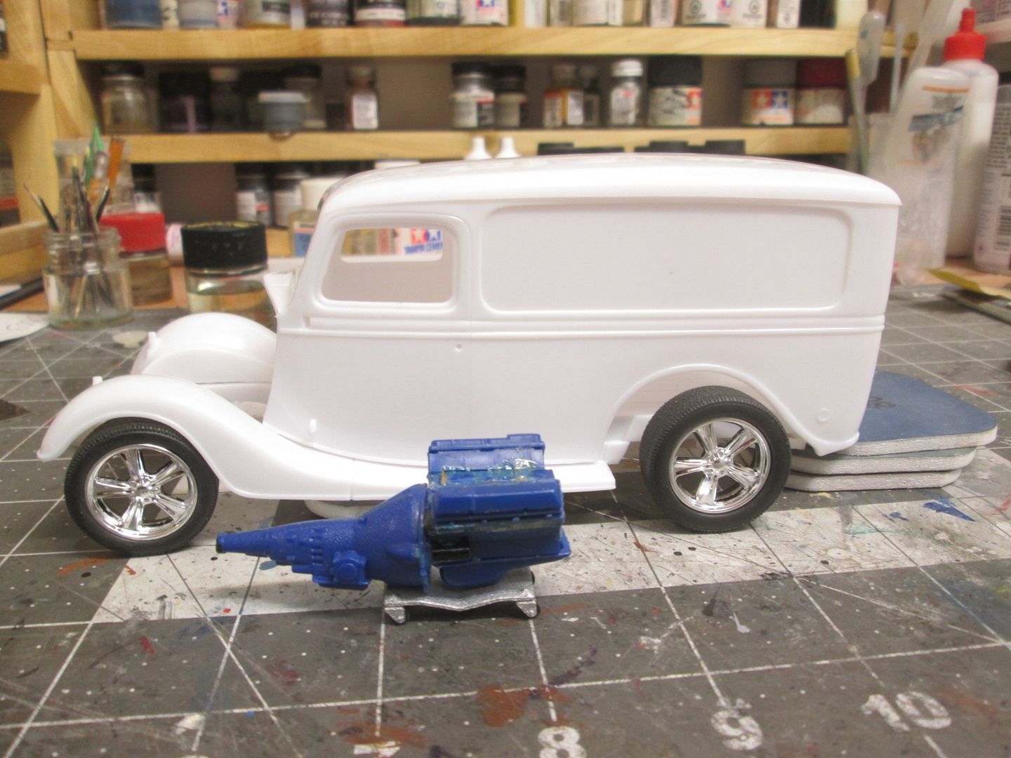

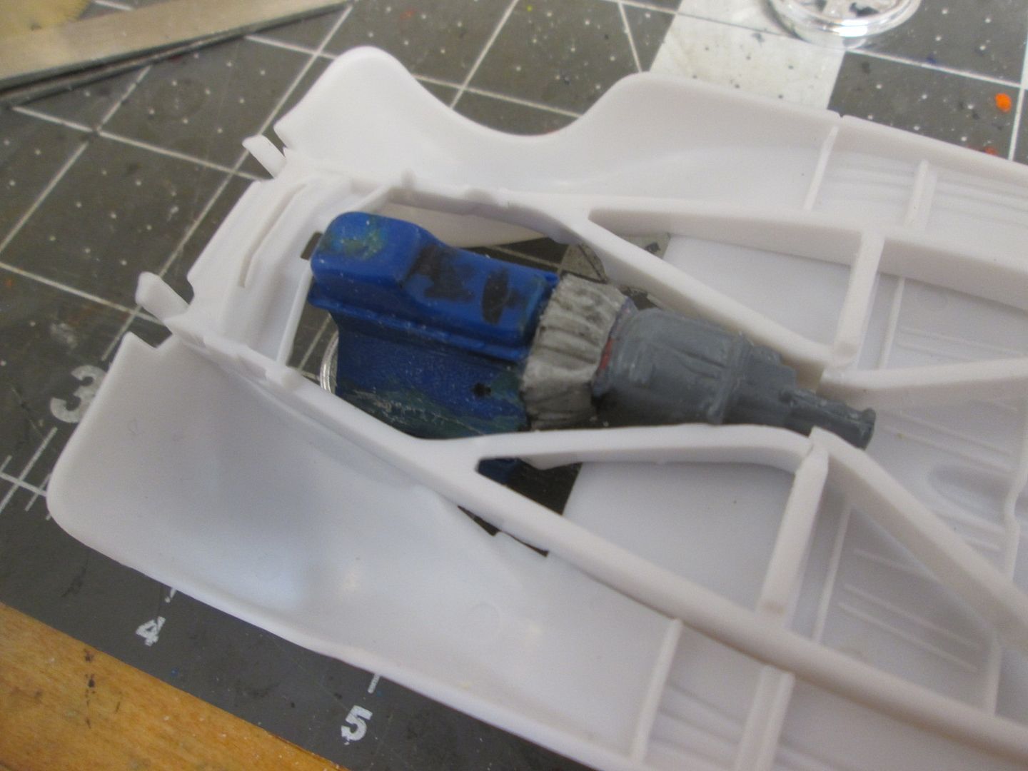

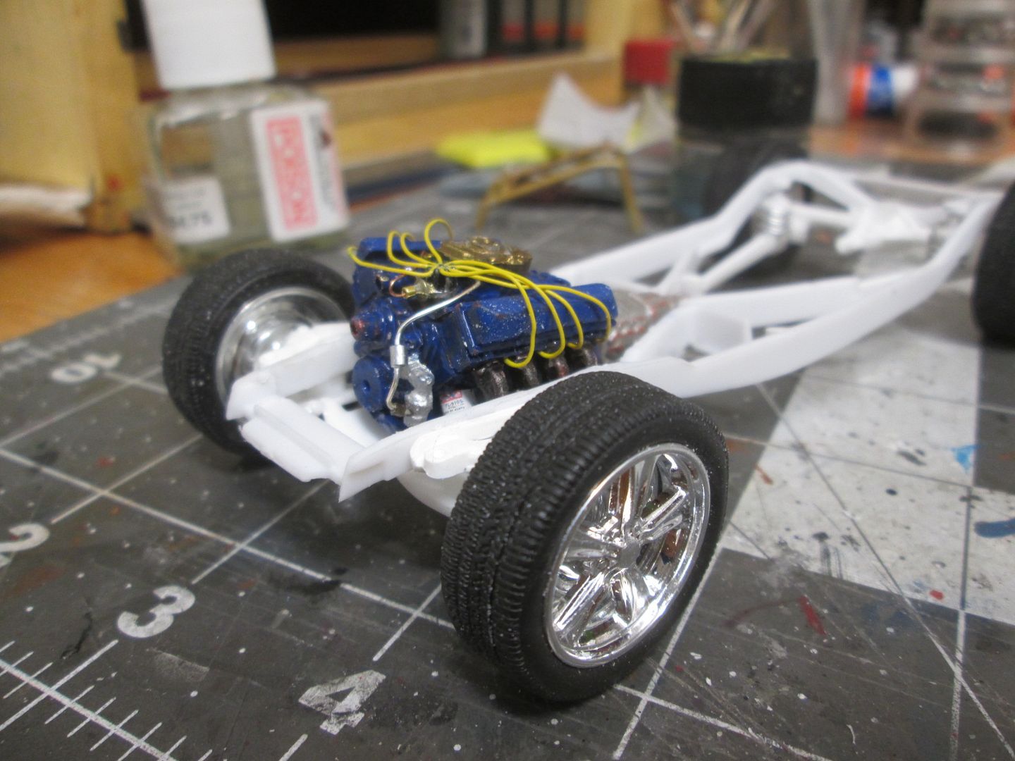

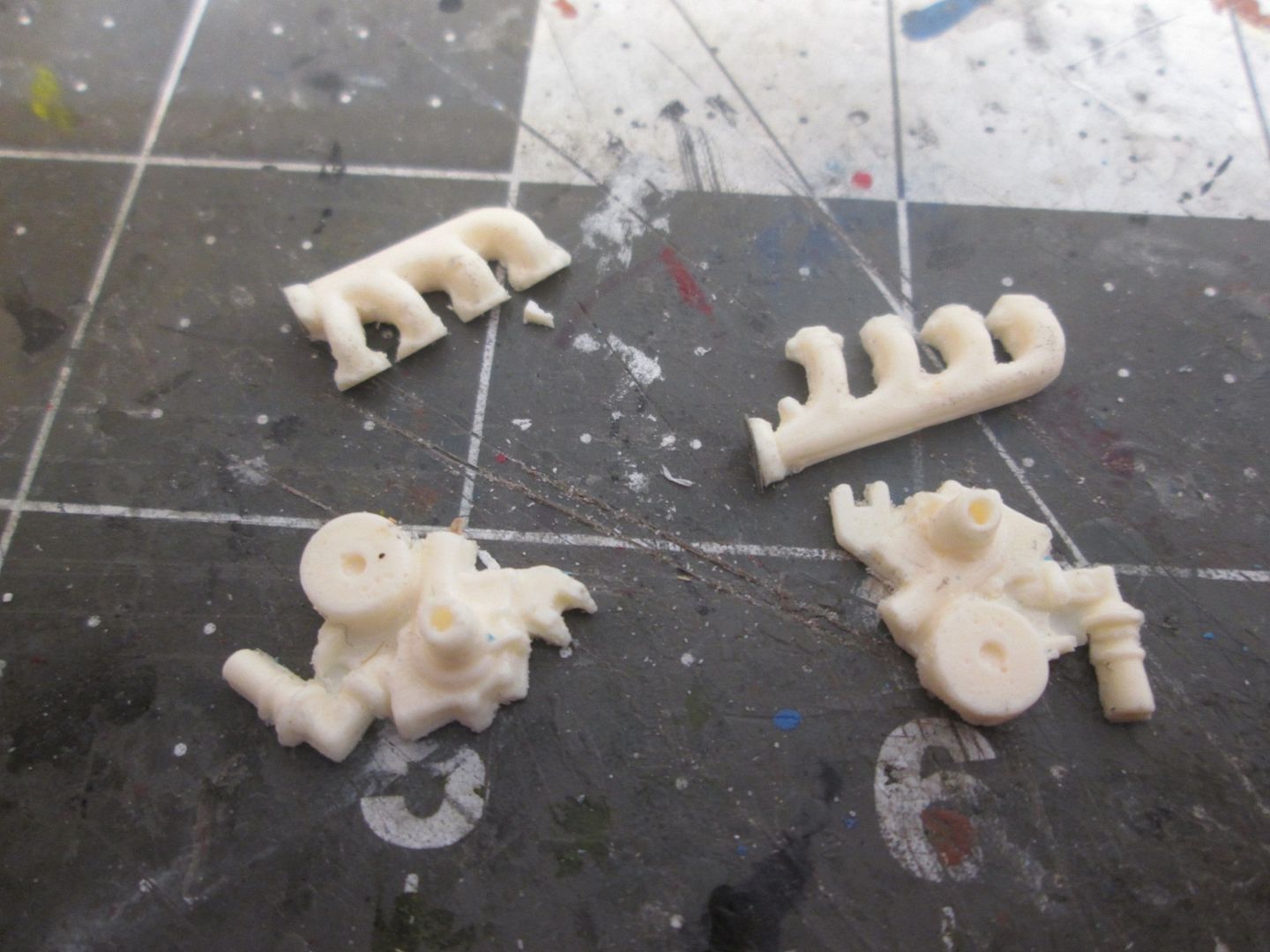

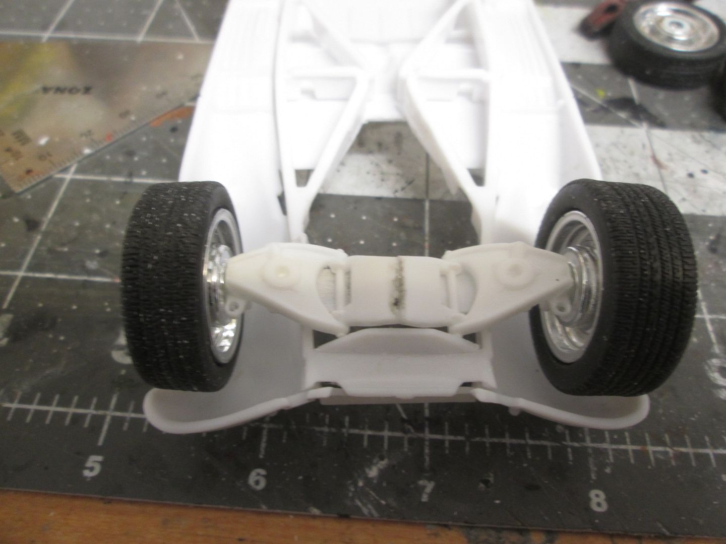

landman Posted January 21, 2019 Posted January 21, 2019 Found an intake manifold, bell housing and a manual transmission for the engine. Cast a few parts. Modified the frame of the '37 to accept it. I'll be using big wheels with rubber band tires. looking at ways of making them fit inside the fenders. Ended up narrowing the front suspension. No solution yet for the rears.

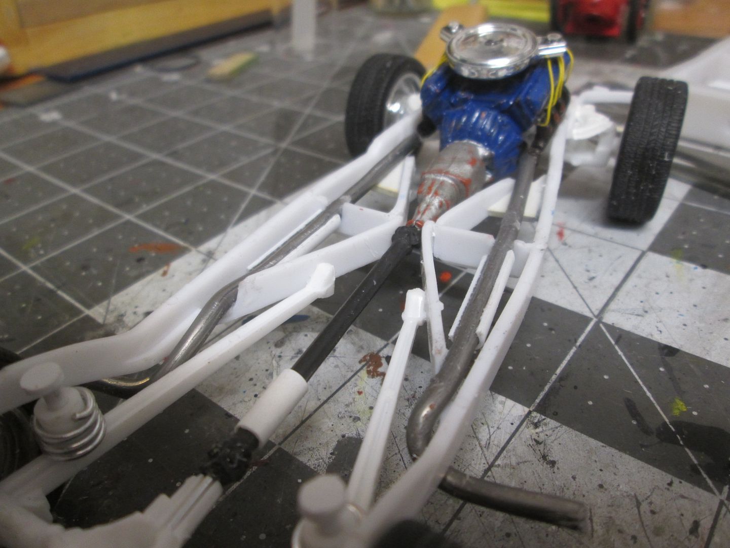

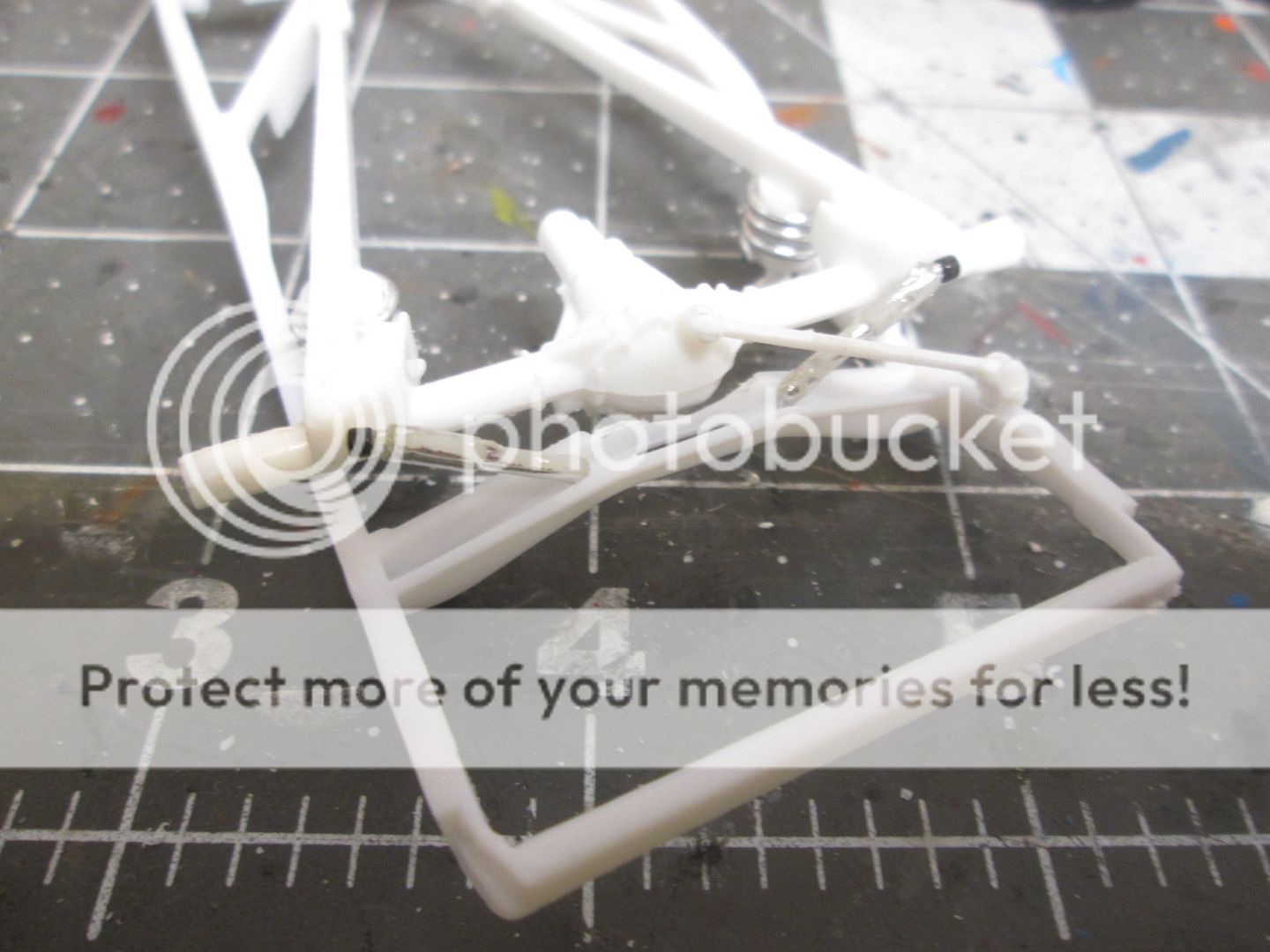

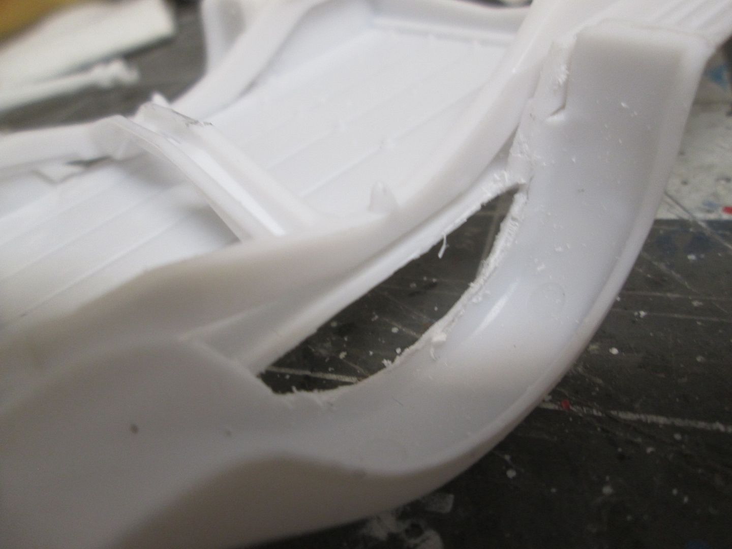

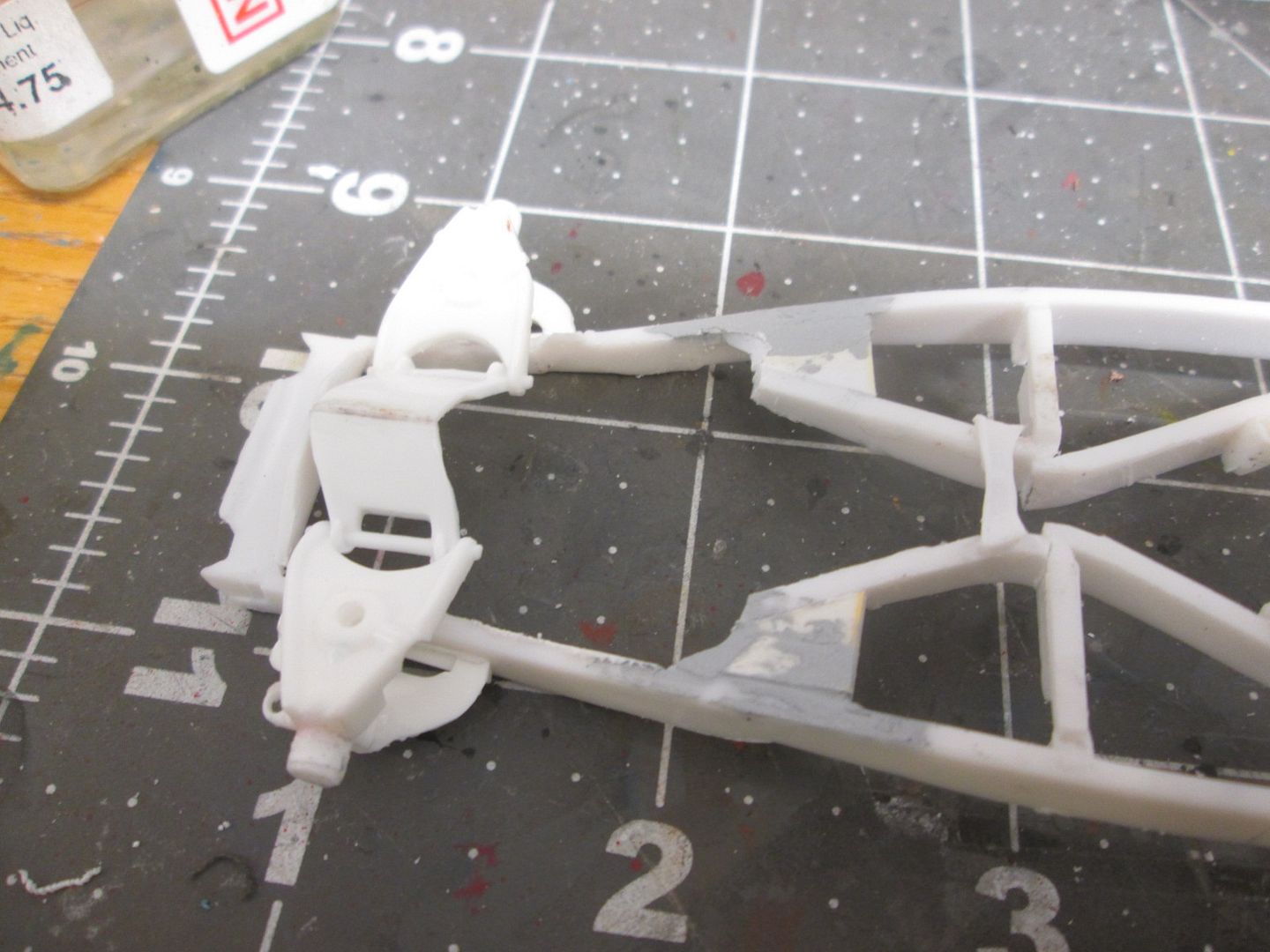

landman Posted January 22, 2019 Posted January 22, 2019 After playing with various positions, I found that if I removed the front crossmember and replaced it with a channel I could get the front suspension pretty well where I want it.

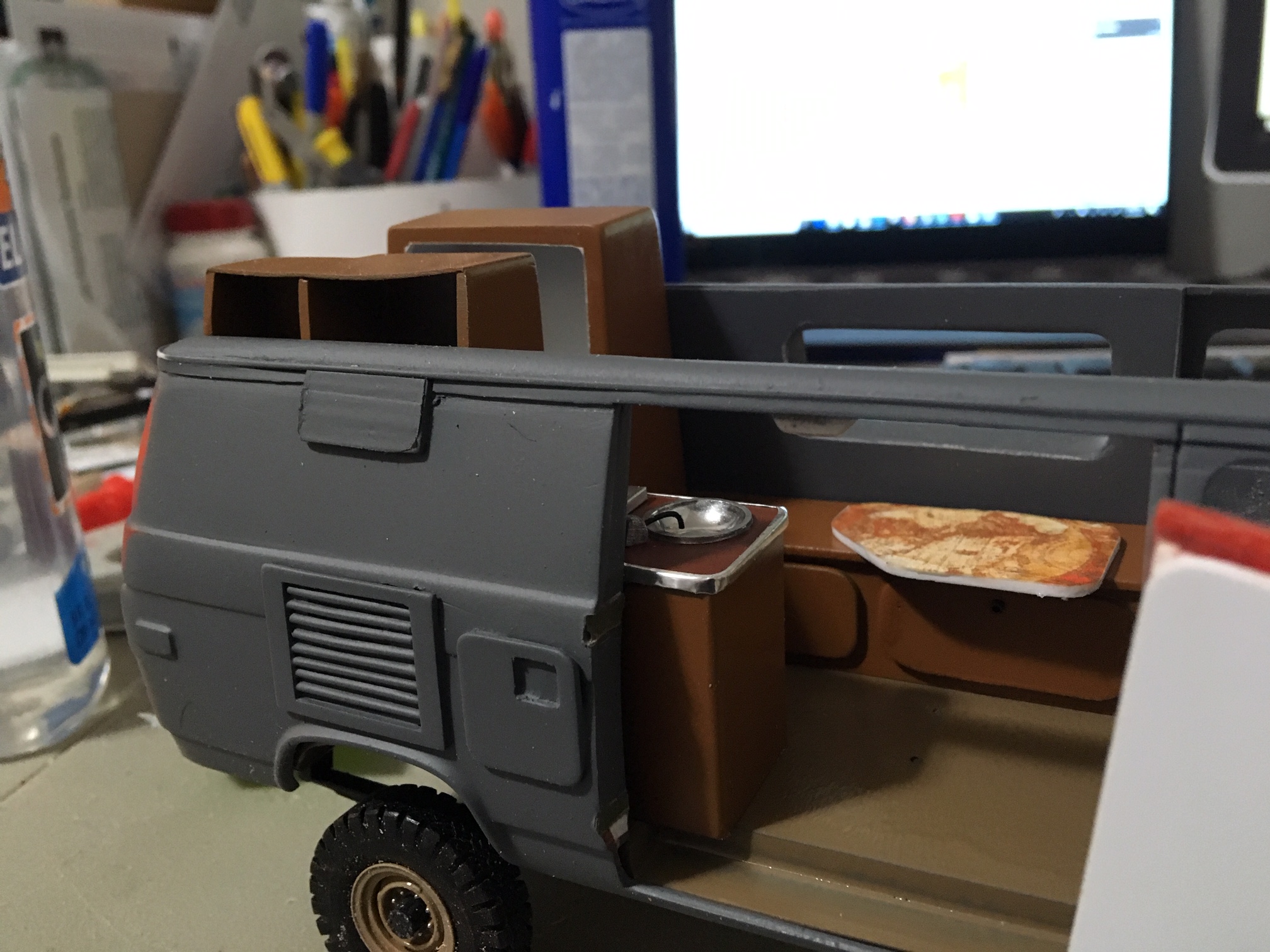

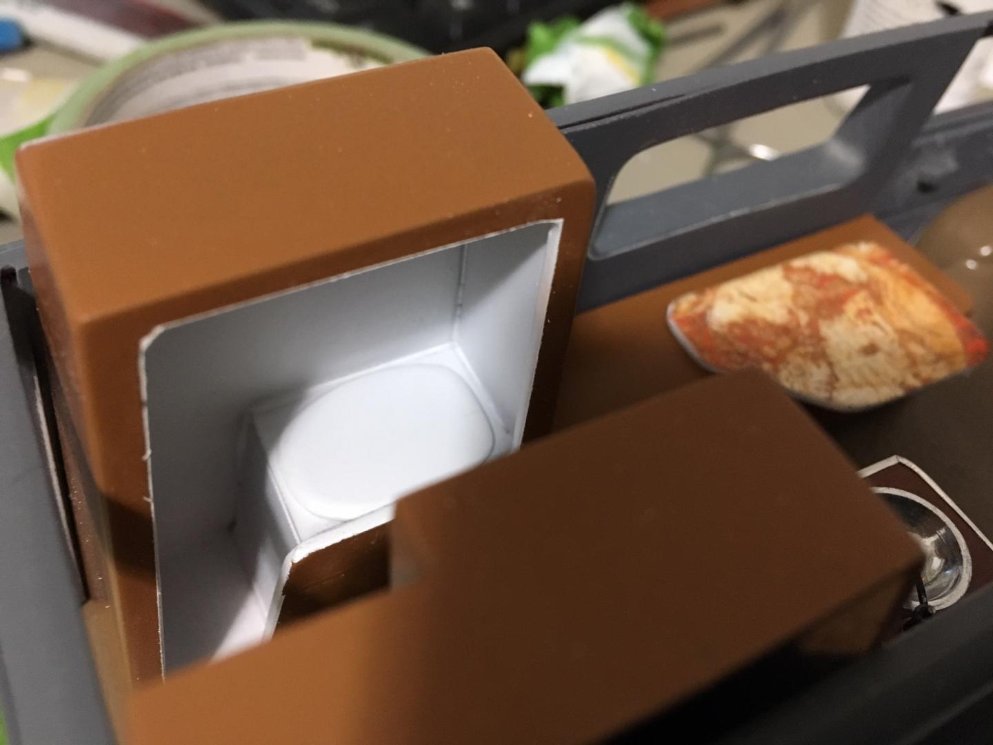

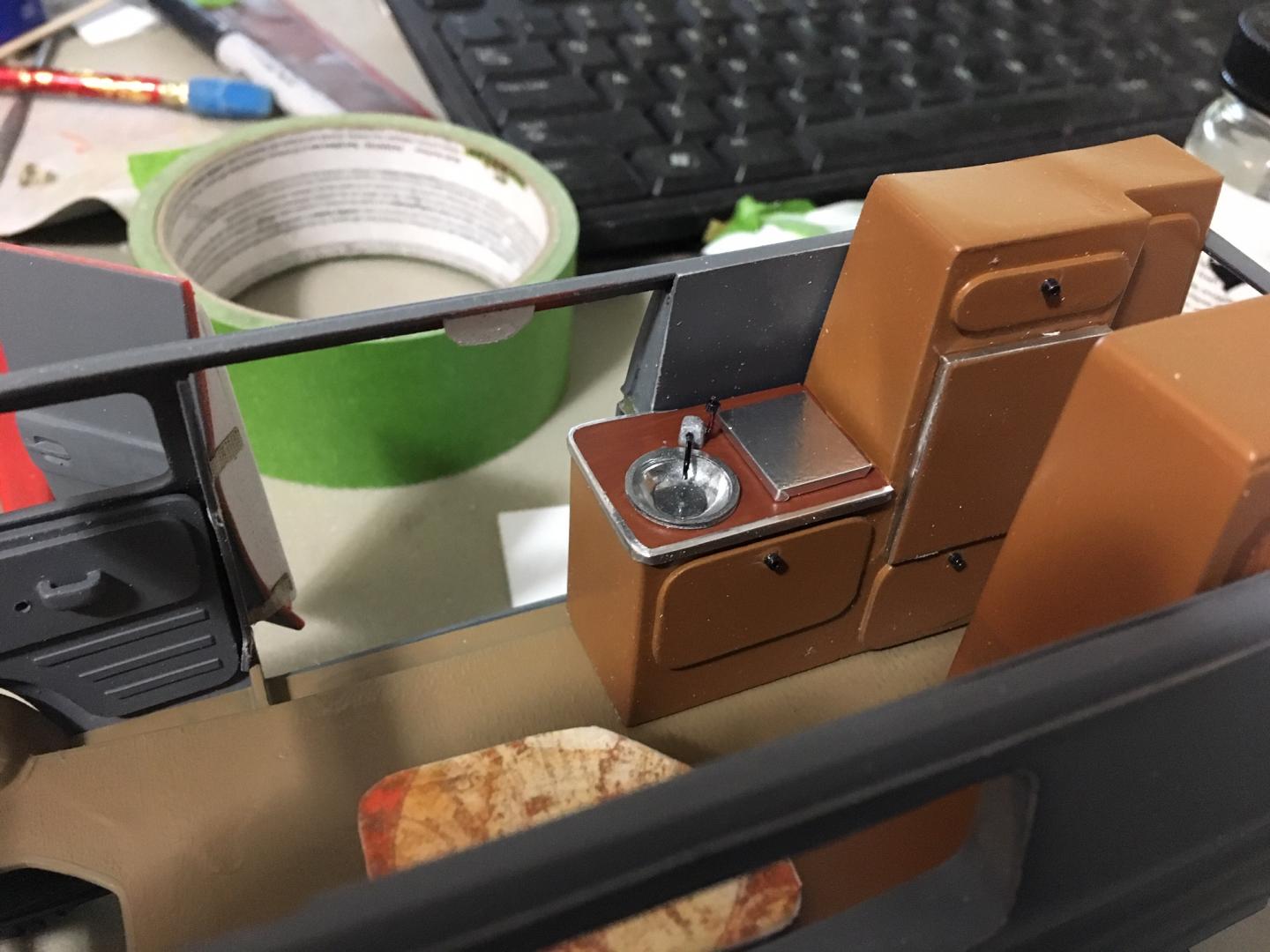

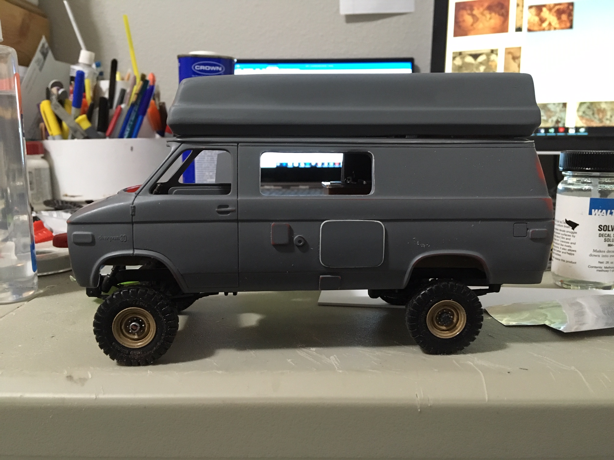

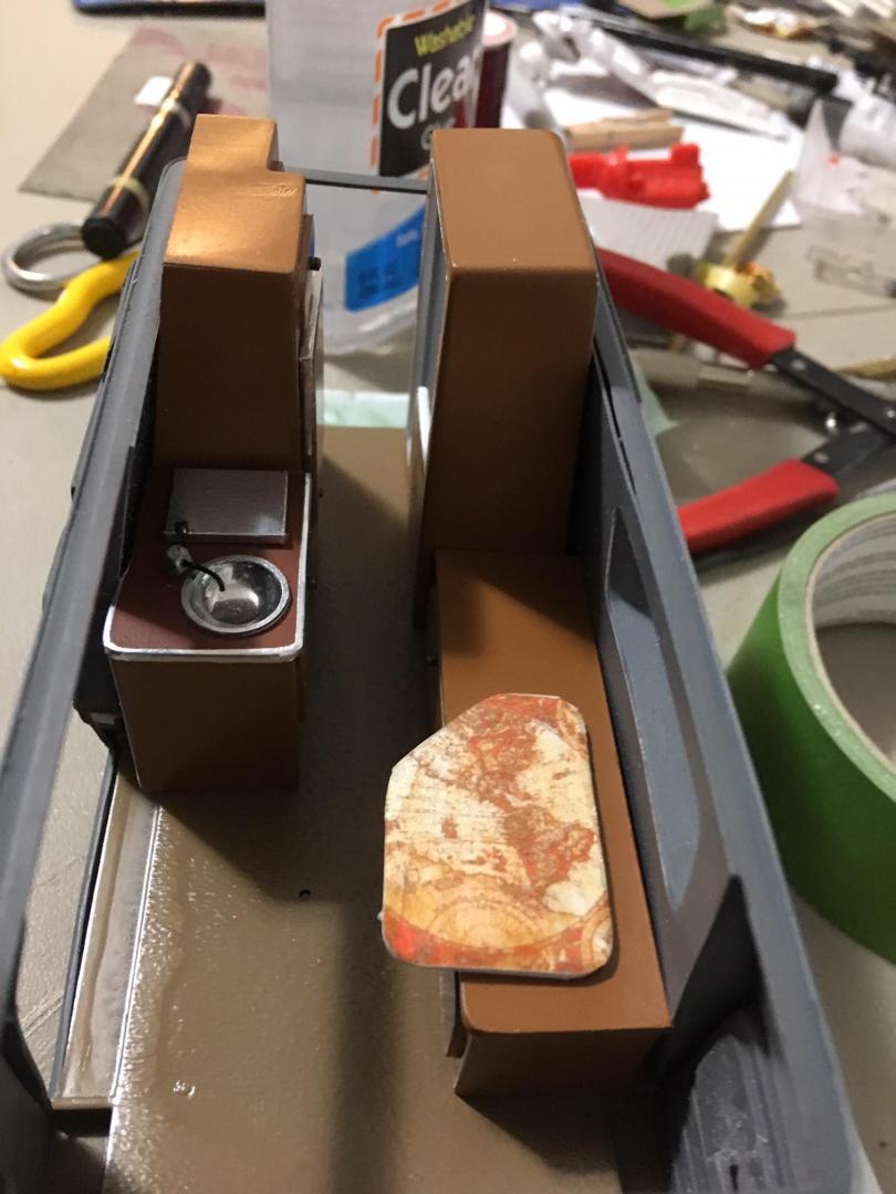

Oldmopars Posted January 23, 2019 Posted January 23, 2019 (edited) Been plugging away at the Ultimate Adventure Van. I have most of the interior camper stuff build and painted. I made a table and covered it with a map, cleared it and hit it with some Future to make it shine. I then trimmed it with foil to have that shinny edge. However that is not shown in these pictures. I chromed the sink, added a faucet and the stove. The stove is shown with the cover down, when the lid is up it acts as a firewall to protect the van interior walls. This is what all these vans and many small camper had. All cabinet doors are rounded like in the Westfalia style campers. The fridge is still square as they all are. I have the roof in what may be the final primer coat. One more sanding and it may be ready for some color. The side window will have flat glass mounted on the surface and I hope will be black or at least tinted. Still looking for some dark tinted clear plastic. I am thinking I may find a plastic bottle or something from the dollar store that will work. I plan to print some kind of era correct floor, but my printer died and I need to replace it, so that will have to wait. Final shot is a mock up, still a ways to go. Edited January 23, 2019 by Oldmopars

Jantrix Posted January 23, 2019 Author Posted January 23, 2019 17 hours ago, Oldmopars said: I plan to print some kind of era correct floor, but my printer died and I need to replace it, so that will have to wait. Final shot is a mock up, still a ways to go. Are you doing a period correct 70's van? I was going to suggest a photoreduced solar panel on top.
Oldmopars Posted January 23, 2019 Posted January 23, 2019 3 hours ago, Jantrix said: Are you doing a period correct 70's van? I was going to suggest a photoreduced solar panel on top. I already have plans for a solar panel. It is not going to be a strictly 70's correct van, more of a 70's van that someone found in good shape and is using today. So like if I found a low mile original 73 Chevy camper van and started using it today. It may have 2 or 3 solar panels. My theme is more Ultimate Adventure than "70's" van. I just really like the 70's era vans and want to keep the 70's feel.
Rusty92 Posted January 24, 2019 Posted January 24, 2019 On 1/21/2019 at 7:36 PM, landman said: After playing with various positions, I found that if I removed the front crossmember and replaced it with a channel I could get the front suspension pretty well where I want it. Going to sit very nicely. I had passed this kit up before but it looks like a lot of fun!

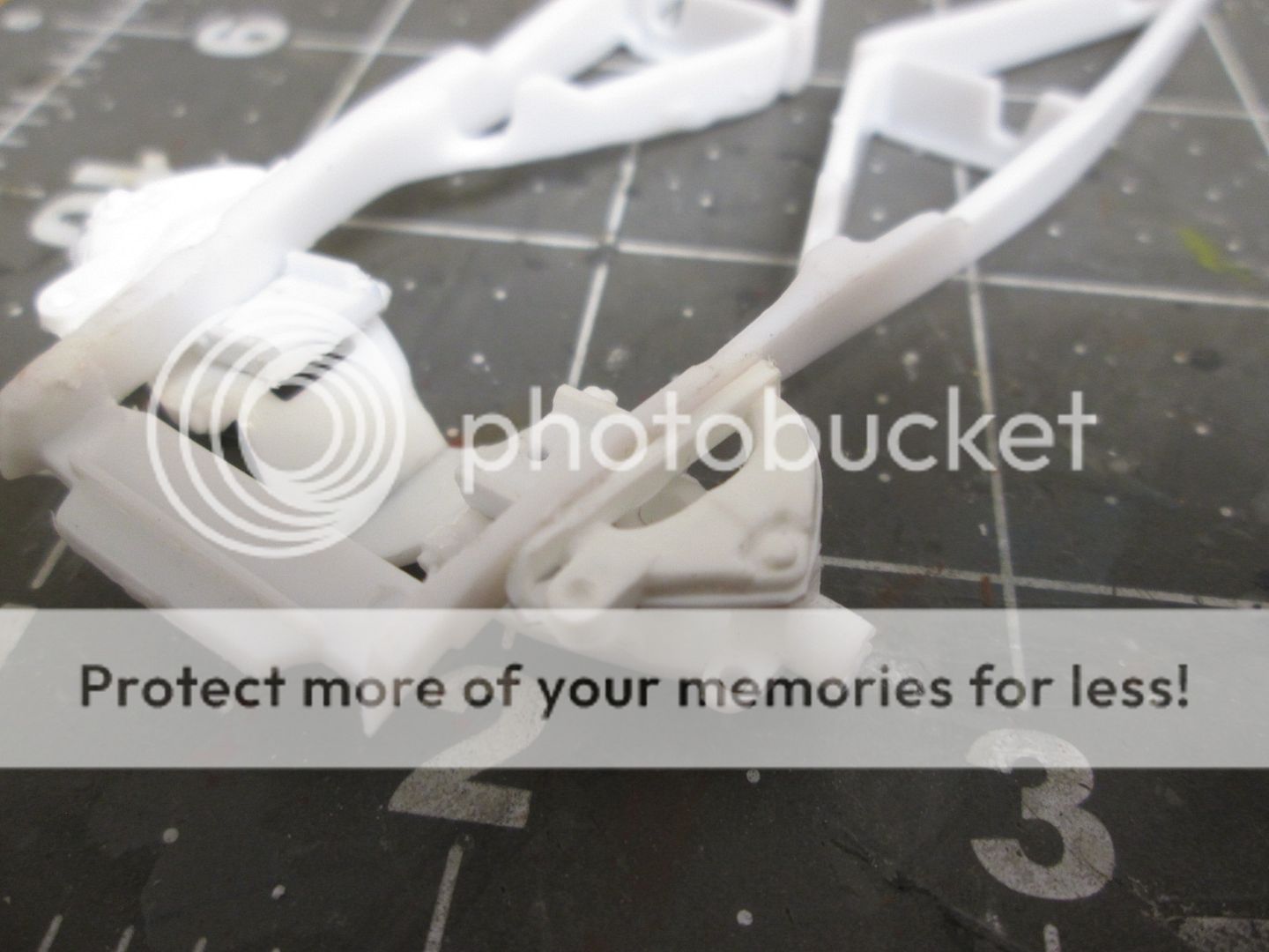

landman Posted January 25, 2019 Posted January 25, 2019 Similar mods to the rear fender wells allowed the wheels to tuck in. I'll decide on the level of rake later.

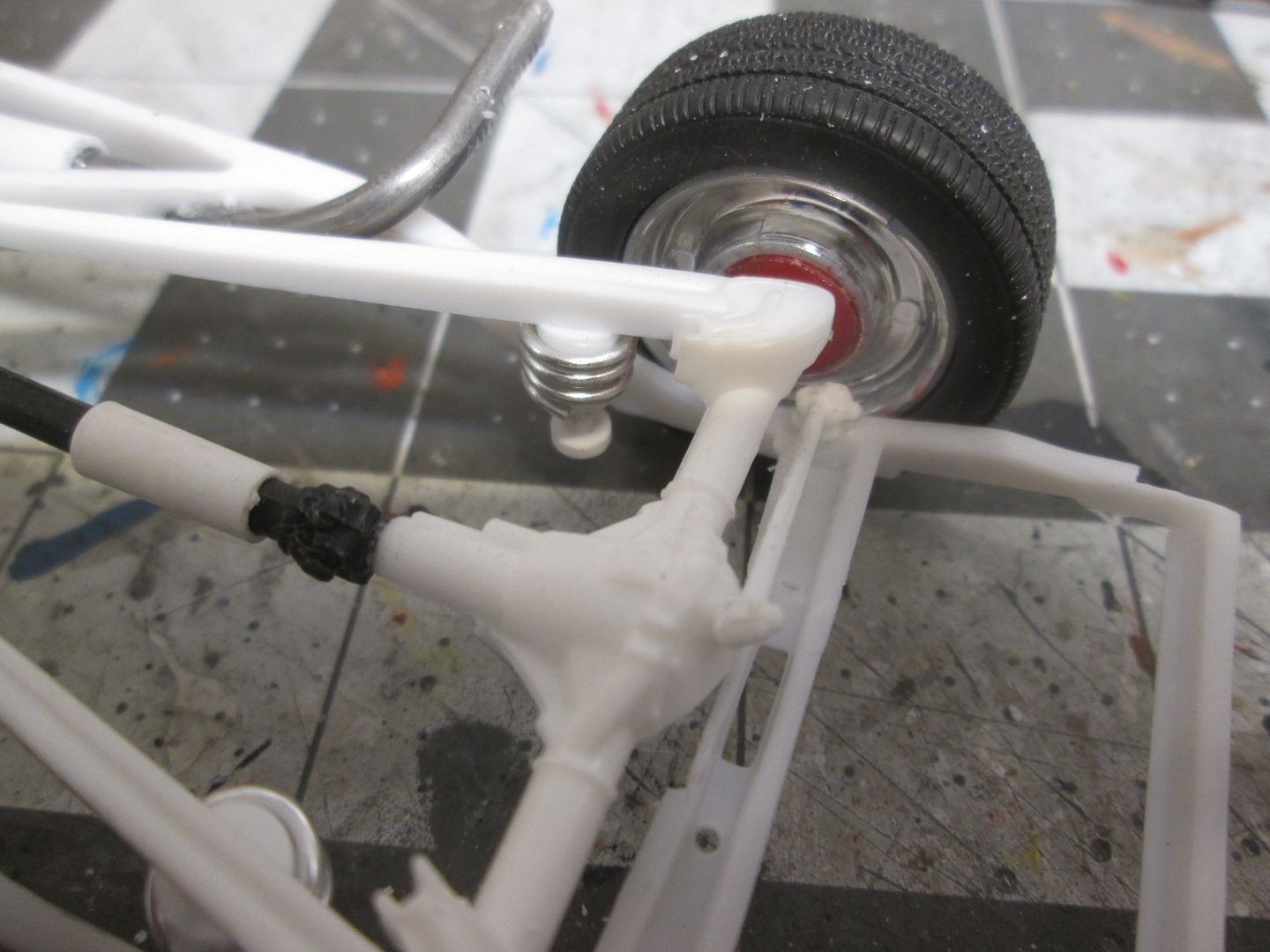

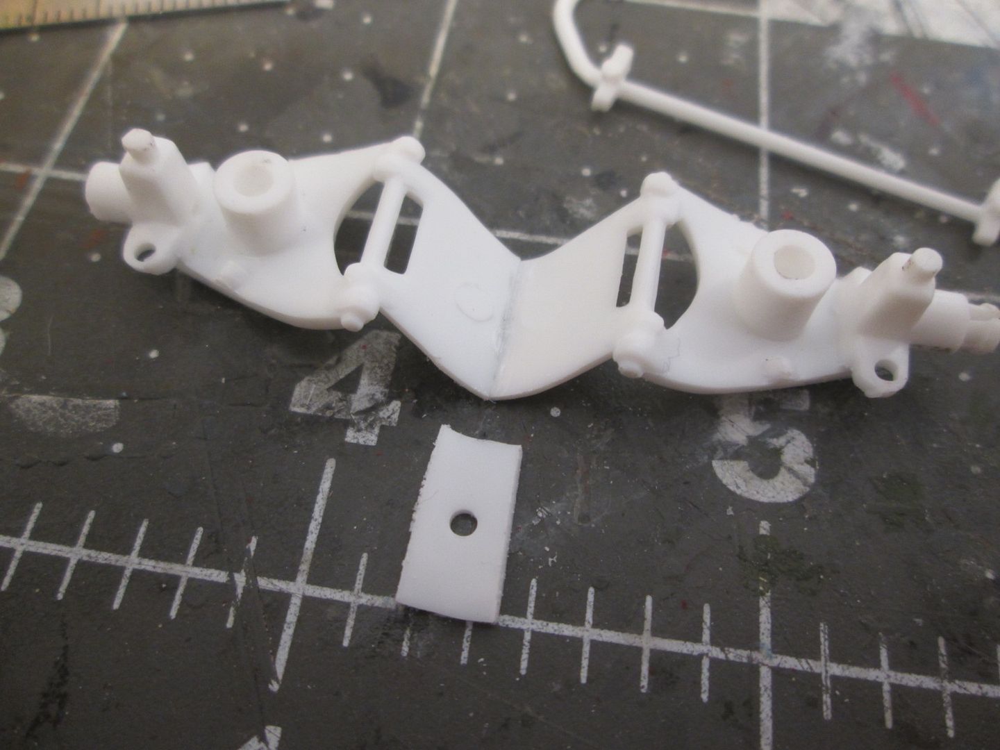

landman Posted January 26, 2019 Posted January 26, 2019 Stole some upper A-arms from a junk front end.

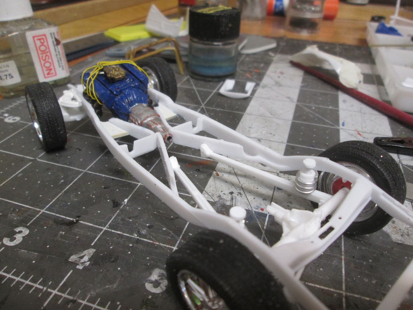

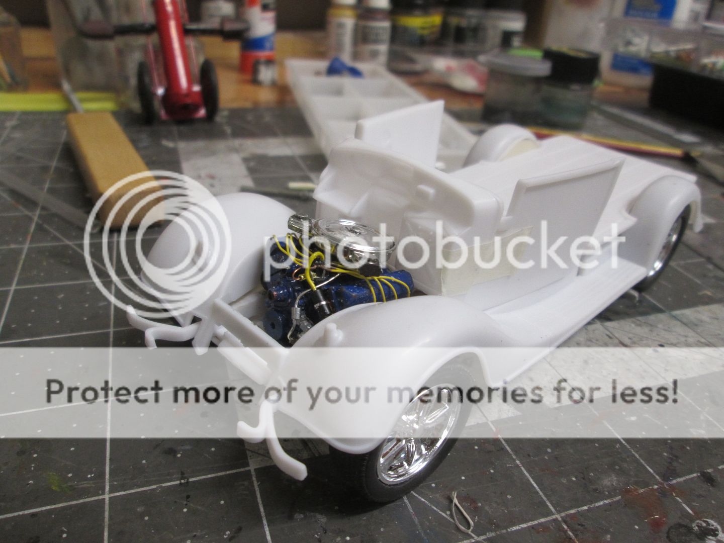

landman Posted January 27, 2019 Posted January 27, 2019 Now why didn't I leave the flathead in there and build it stock. This is proving to be a lot of mods. are those rear shocks too "splayed"?

Lordmodelbuilder Posted January 28, 2019 Posted January 28, 2019 Landman, your build is looking good,but ,yes, I do believe the rear shocks need to be at less of an angle. Also,the panhard bar should be as parallel to the axle side to side .

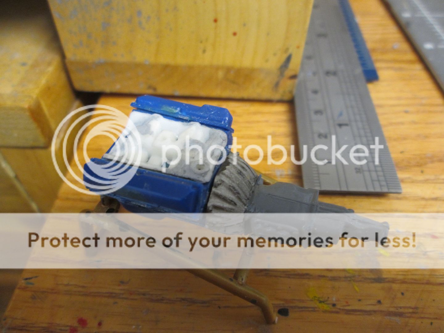

landman Posted January 29, 2019 Posted January 29, 2019 The 460 is a very tight fit. Added exhaust and driveshaft. Had no choice but making them come out in front of the wheels à la AAR. Straightened out the panhard rod.

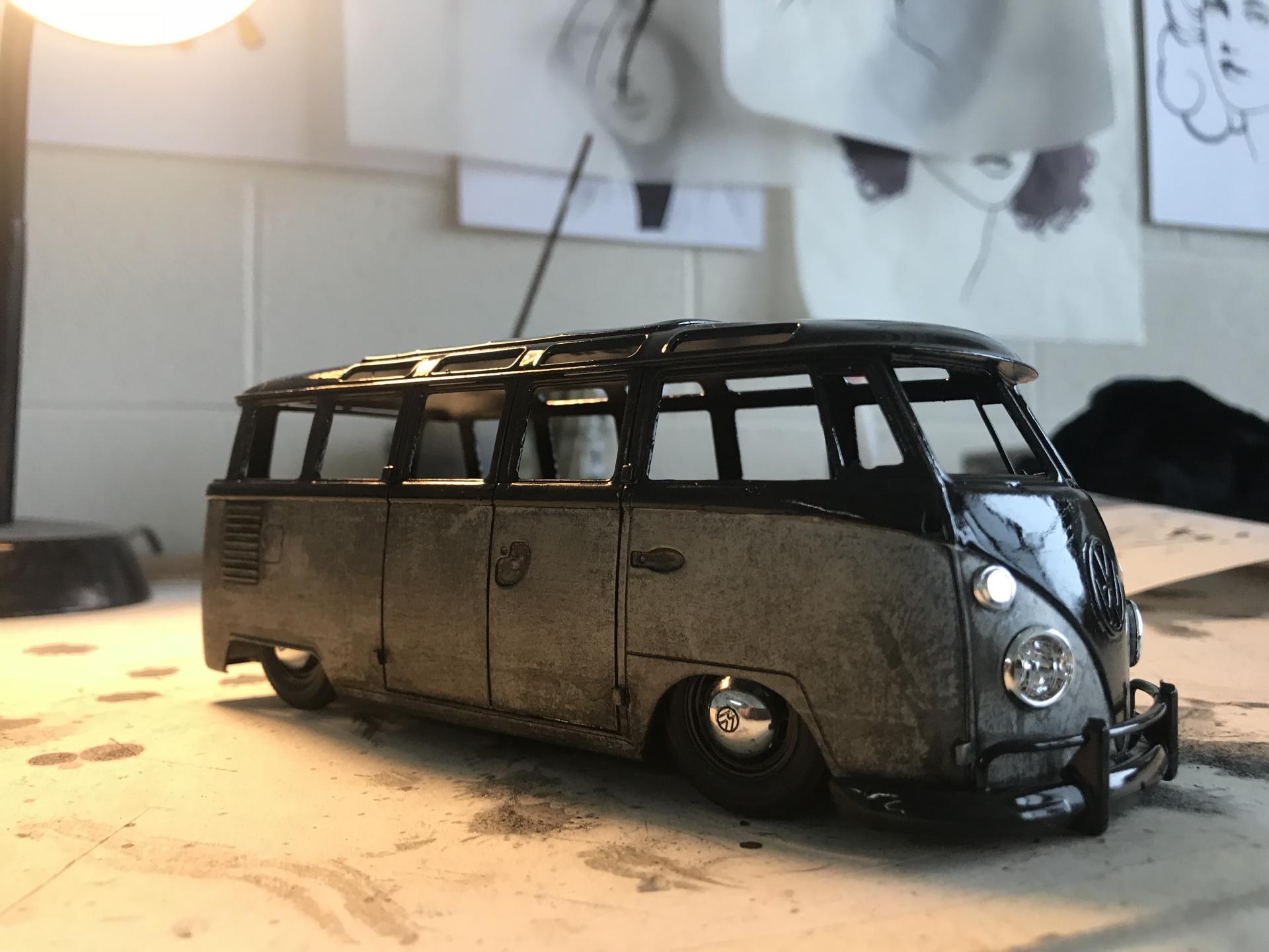

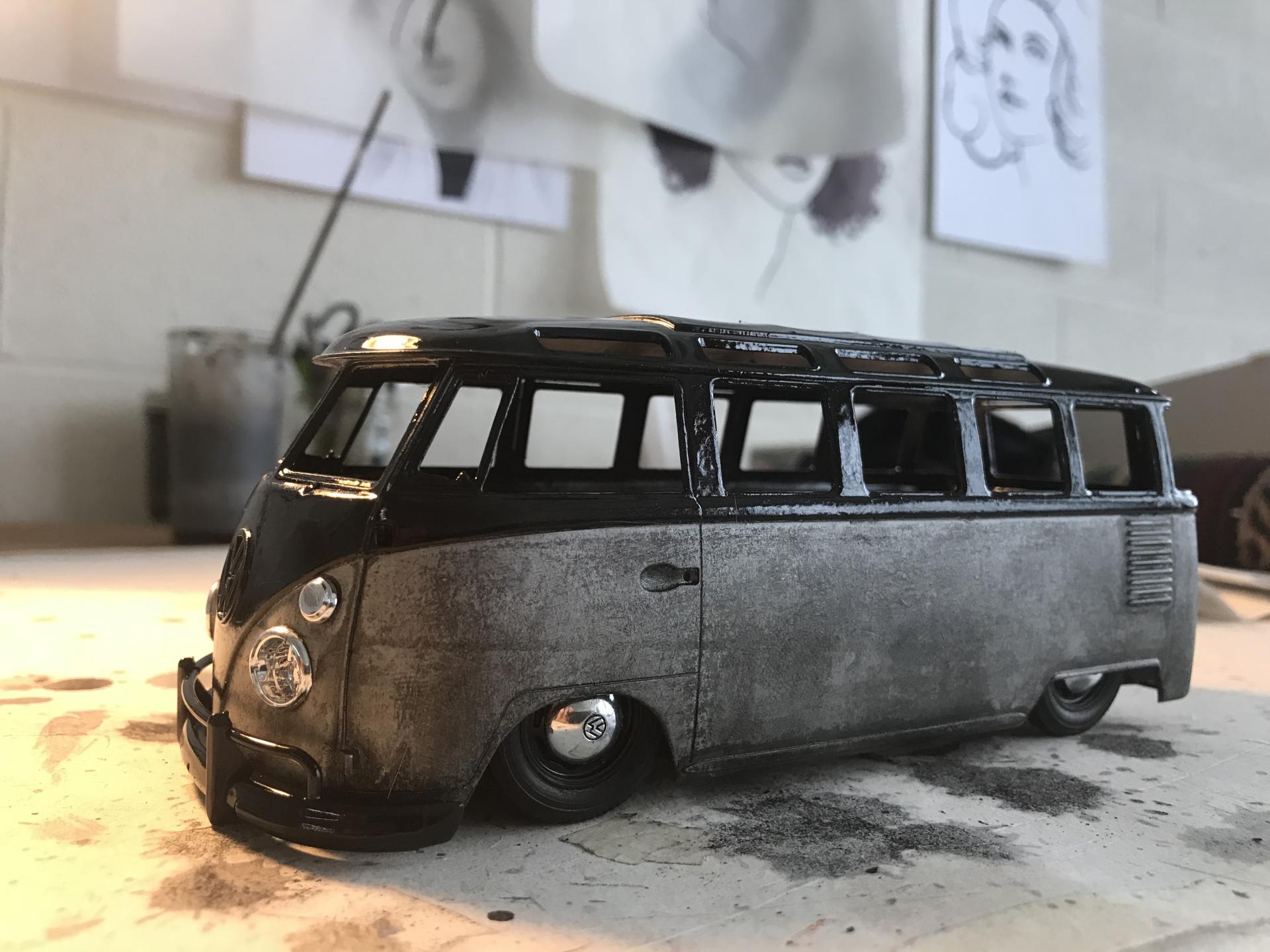

oldcarfan Posted February 2, 2019 Posted February 2, 2019 I'm late to it, but I'd like to have a go with this VW Westfalia. I've been looking for a suitable subject and finally remembered I had two of these in storage. I did some online research today and it's a popular thing to re-power them with Subaru WRX engines. I probably won't do an actual engine since it is invisible in this vehicle.
