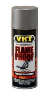

GaryR Posted August 27, 2019 Posted August 27, 2019 (edited) It was VHT spray can paint, used barbecue it looked cool on fabricated headers ! Like a black chassis, or metalflake, or tufted interiors, it was for looks. It was just the style back then. Headers are frequently made of multiple pieces of tube, bare metal is ugly! There were other colors than white, black was used sometimes, even red, but white was the coolest. I believe it began around 1960 or so. https://www.vhtpaint.com/high-heat/vht-flameproof-coating Edited August 27, 2019 by GaryR

mr moto Posted August 28, 2019 Posted August 28, 2019 It started when VHT paint came out and you'll notice that many of the early drag cars with white headers also carried VHT sponsorship decals. It came in a number of colors but if you want to draw attention to your product paint the headers bright white!
