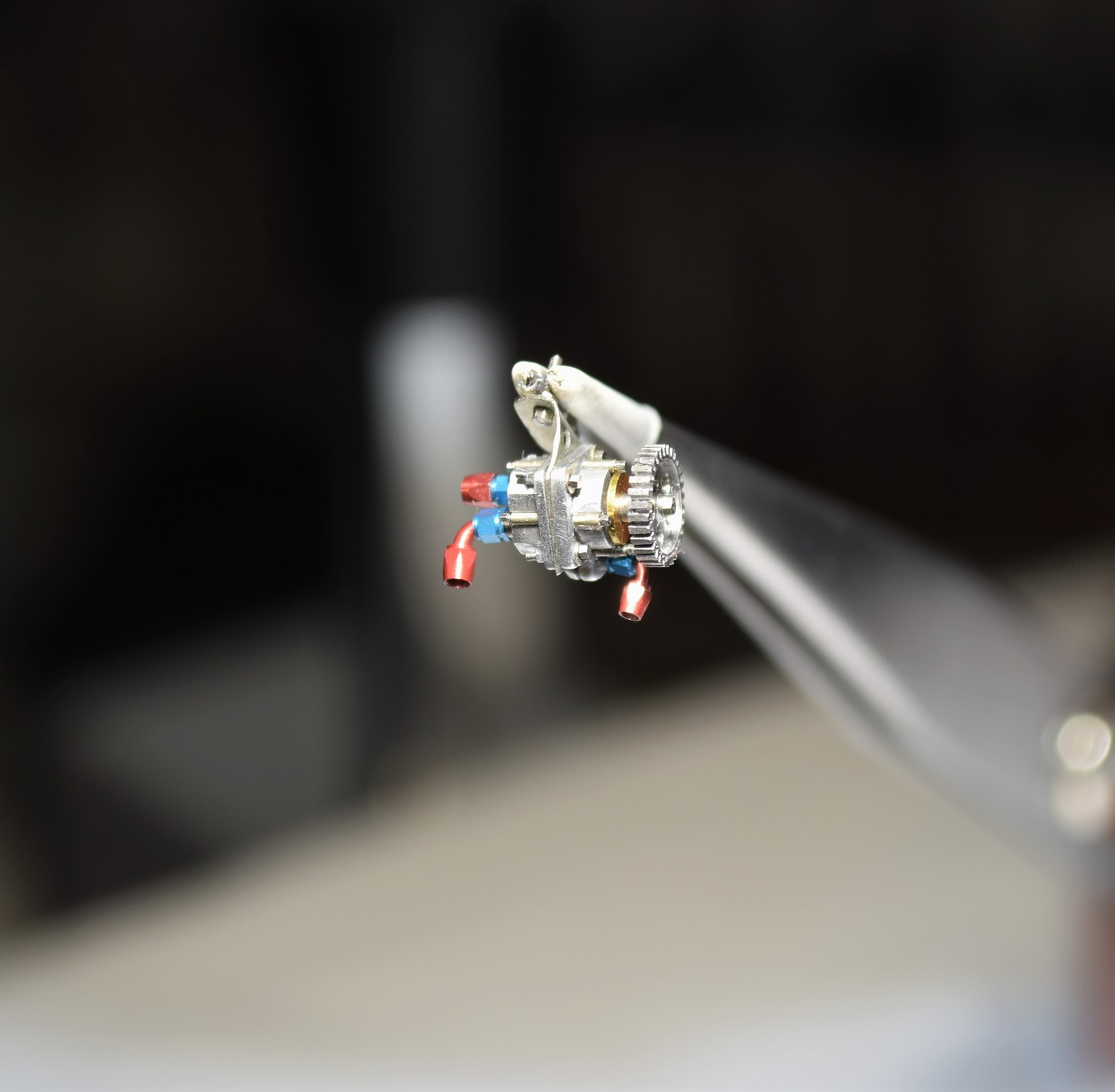

Codi Posted March 13, 2020 Author Posted March 13, 2020 Hey JC, I had read something along those lines earlier. Chevy and Mopar protested their use in drag racing as they swore Ford had developed or was using some sort of fuel injection when they first appeared. Got the dry sump pump done. It was a headache. I know now what I'm in for when I attempt to make the carbs now. In this piece there is a grand total of 58 pieces counting the bracket, pieces I machined and every last nut, bolt and washer. Machined the gear itself out of steel for the contrast in color/look. Got a few things to address on the block and then I'm onto the heads finally. cheers, tim The gear itself is not affixed permanently as of yet. I'll do that after the entire assembly is installed on the engine.
AmericanMuscleFan Posted March 13, 2020 Posted March 13, 2020 Hi Tim, Glad to see you back!!! This dry sump is totally amazing! Your ability to make such small parts with all those details will always amazed me! That's FANTASTIC!!! The carbs setup you will attempt to make is very nice, rarely seen and intriguing and I can't wait to see your magic operate again... Very inspiring subject! I do love these old Pro Stock so much. Francis
