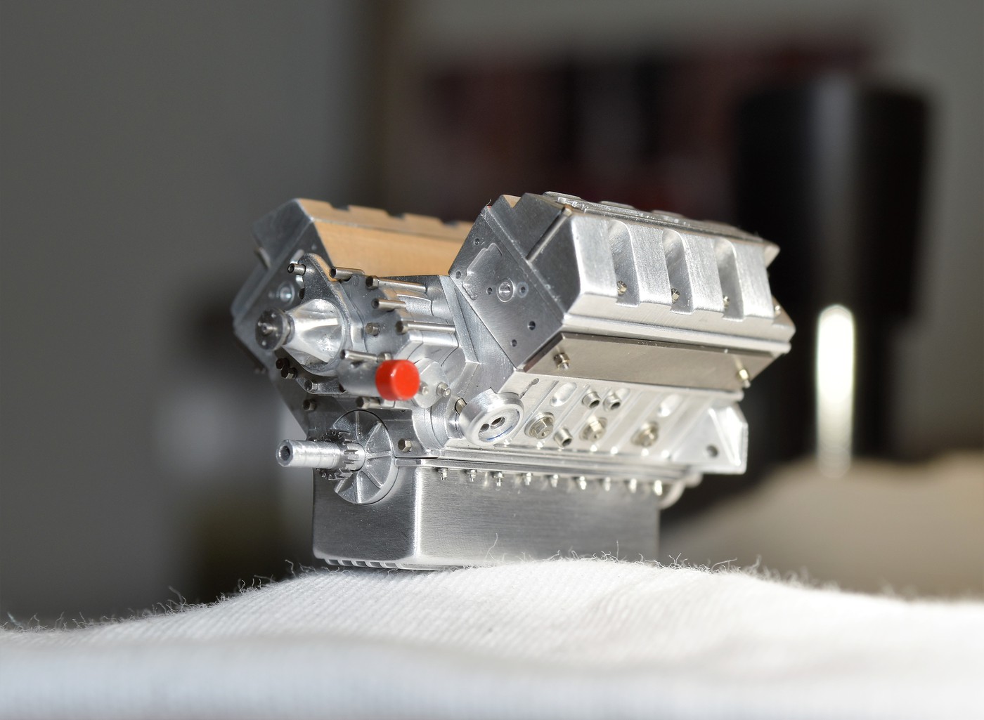

AmericanMuscleFan Posted April 4, 2020 Posted April 4, 2020 Glad to be the first one to make comments on your latest update and I must say that this big block (very big...) is simply fantastic! What else can I expect from you but these ultra clean and accurate parts! Magic still continue sir... I love it! Take care, Francis
Codi Posted April 9, 2020 Author Posted April 9, 2020 Thanks everyone. Block, heads, v.covers detailed. Oil pan yet and then onto the carbs. cheers, tim
Claude Thibodeau Posted April 9, 2020 Posted April 9, 2020 Hi! Great workmanship. Bravo! But what gets me smiling is the rubber cap on the water-pump. Just like any respectable fabricator would use while an engine is around a milling machine, just to be prudent... CT

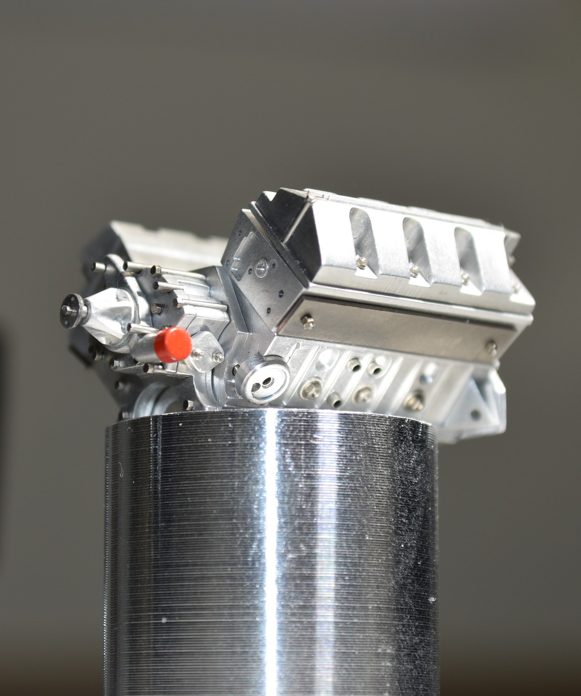

Codi Posted April 9, 2020 Author Posted April 9, 2020 Thanks for the chuckle Claude. The cap is actually machined on the lathe from alum. and painted red but I'm glad it looks realistic. Some days are more productive than others. I added the bolts to the pan and I'm going to start doing some experimenting on some ideas I have on how to make the carbs. 1 more pic but it's hard to get everything in focus on some of these shots. cheers, tim

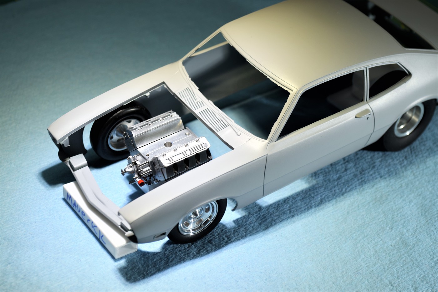

Codi Posted April 10, 2020 Author Posted April 10, 2020 Hi there Bruce & Joe........and thank you too. I wanted to take a moment before working on the carbs to see how the engine fit the car based upon my earlier ride height etc. and that it would comply with the rules. All is good. The #1 cylinder lines up beautifully with the front spindle and a 10% maximum engine set back. The intake/carbs will fit under the mandated max. 7" tall hood scoop and there's plenty (?) of room between the heads and sides of the car. I keep these photos/numbers for future ref when it comes time to do the chassis. Please remember that the engine will NOT be in the car when finished, but it still should fit nonetheless. Happy Easter to all that celebrate the Holiday. Tim

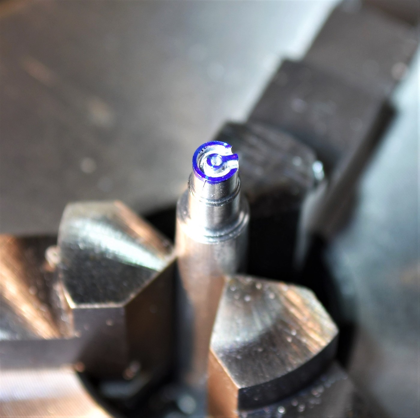

Codi Posted April 19, 2020 Author Posted April 19, 2020 Pete, the ties were something I bought 4 or 5 years ago. If you're in need of a few, let me know. I can probably spare you half a dozen if that works. cheers, tim Thank you Brad for the compliment. At times the most fun is the time I've spent recently experimenting on the "how to make it" part of the build. It's fun when an idea comes to fruition. Making slow but steady progress. cheers, tim This pic was one of my recent experiments. It's a machined venturi for the carb(s). The width of the "arm" that extends out from the center needs to be narrowed down to .3mm and extended in length by about .4mm. Doesn't sound like much but in scale, it will make a difference. Only 8 of the little buggers to make. Also figured out (finally) how to machine certain angles etc. One last big step to figure out then I can onto drawing/making them. cheers to all, tim
