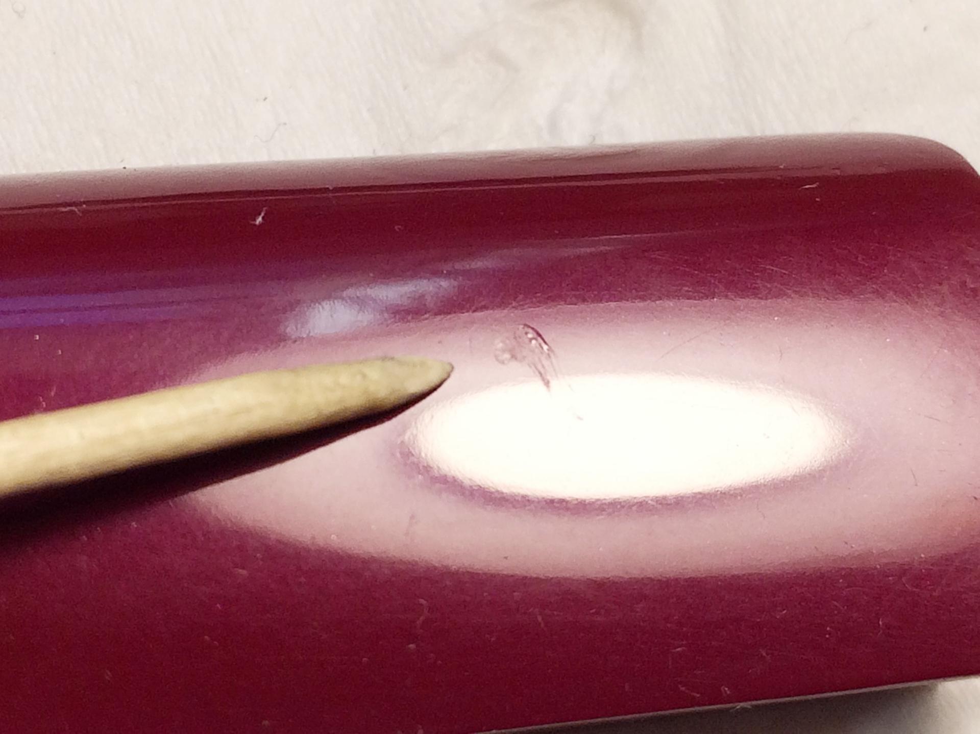

Nice job on the hood and hinging.  I assume you will address the ejector pin marks as you move ahead.
Two were puttied before, hared to tell, but yes.

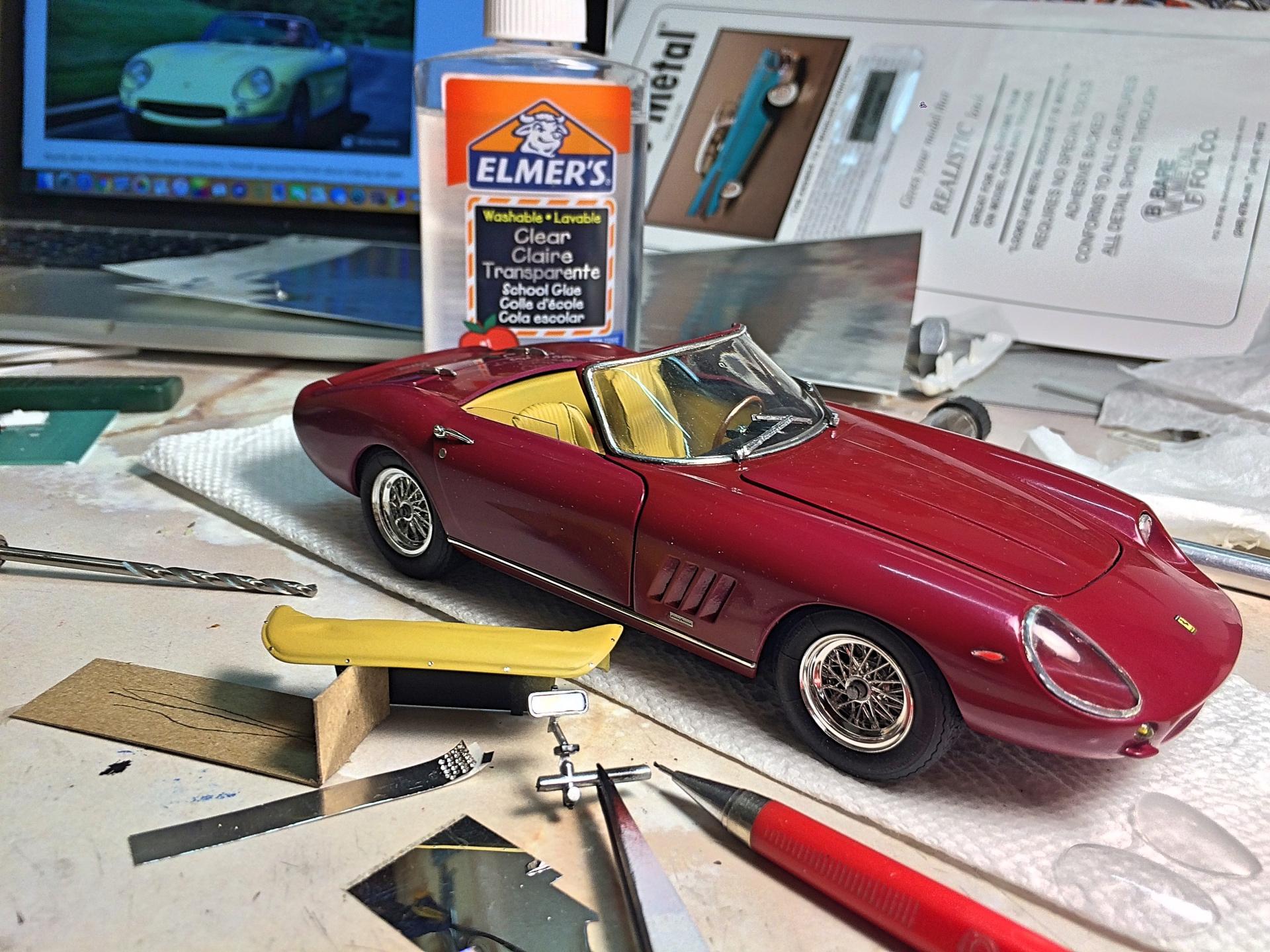

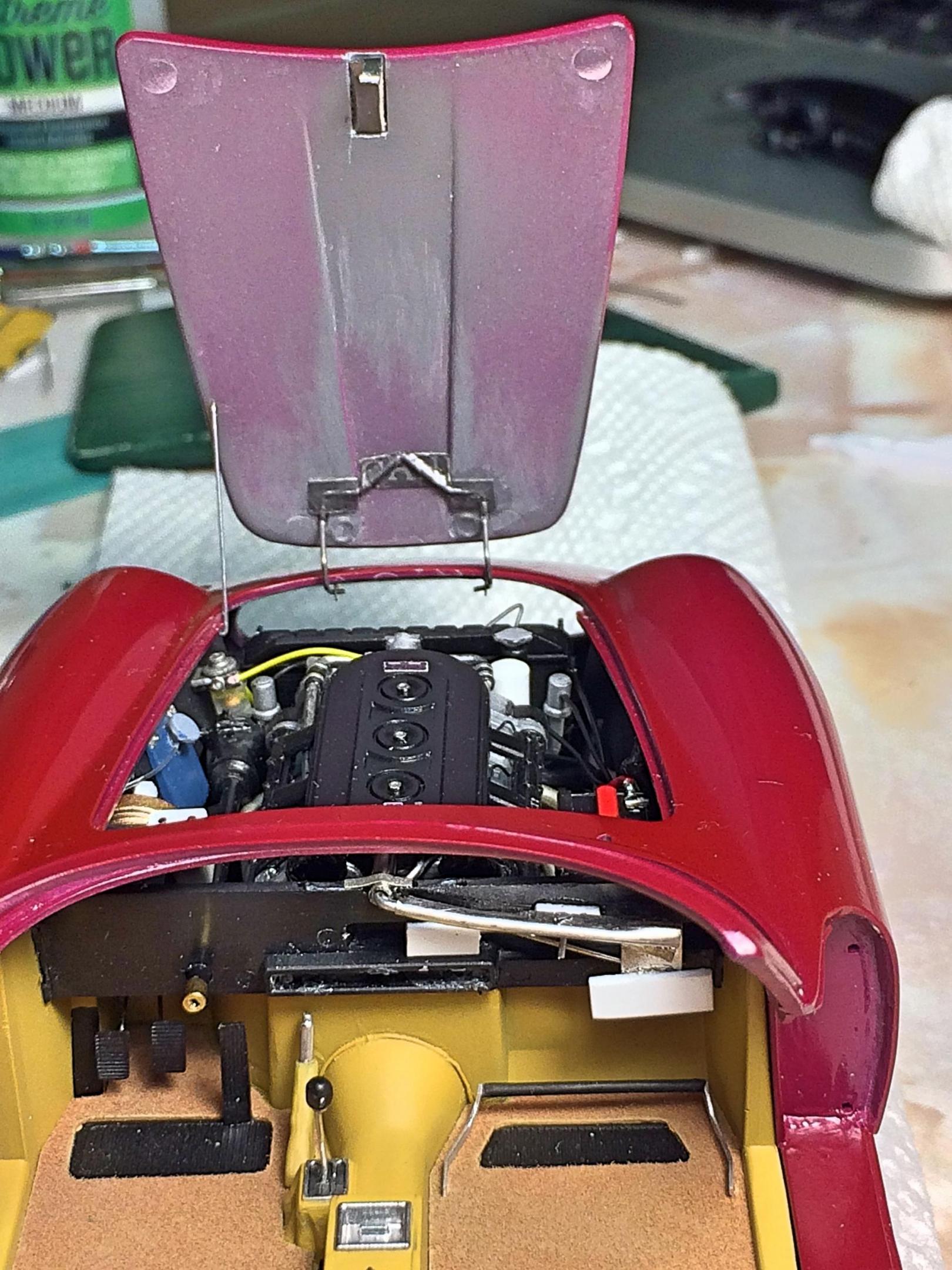

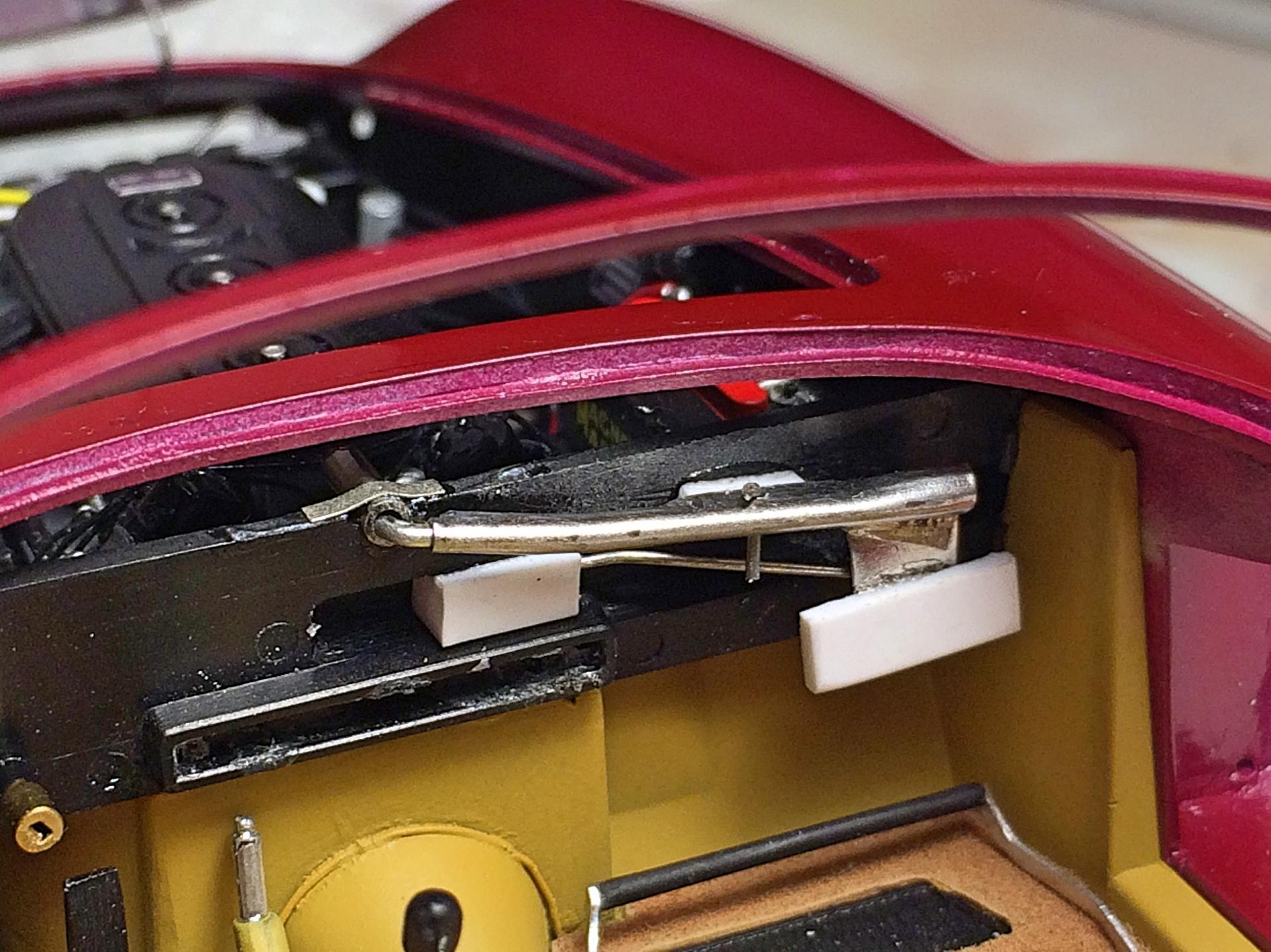

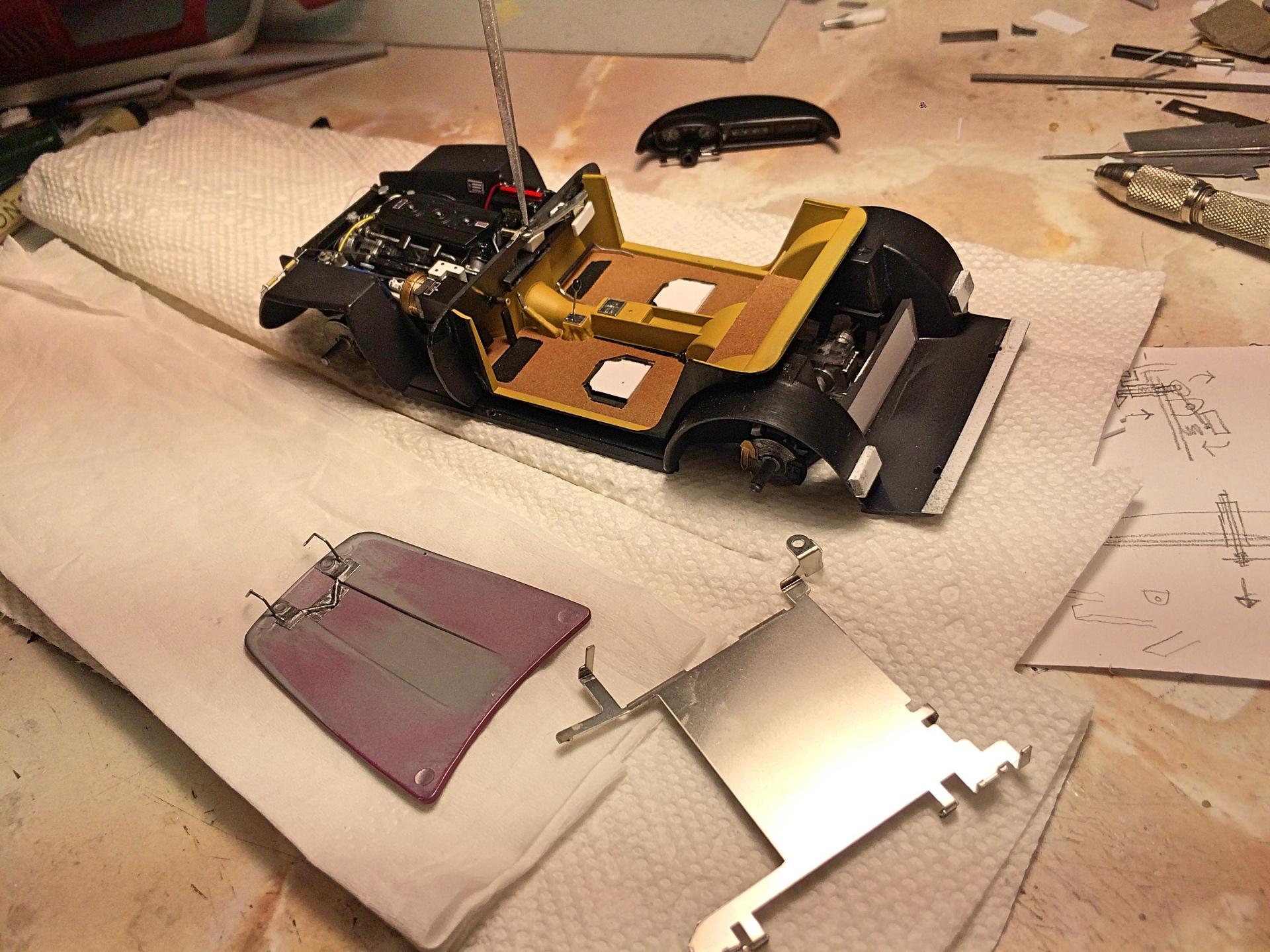

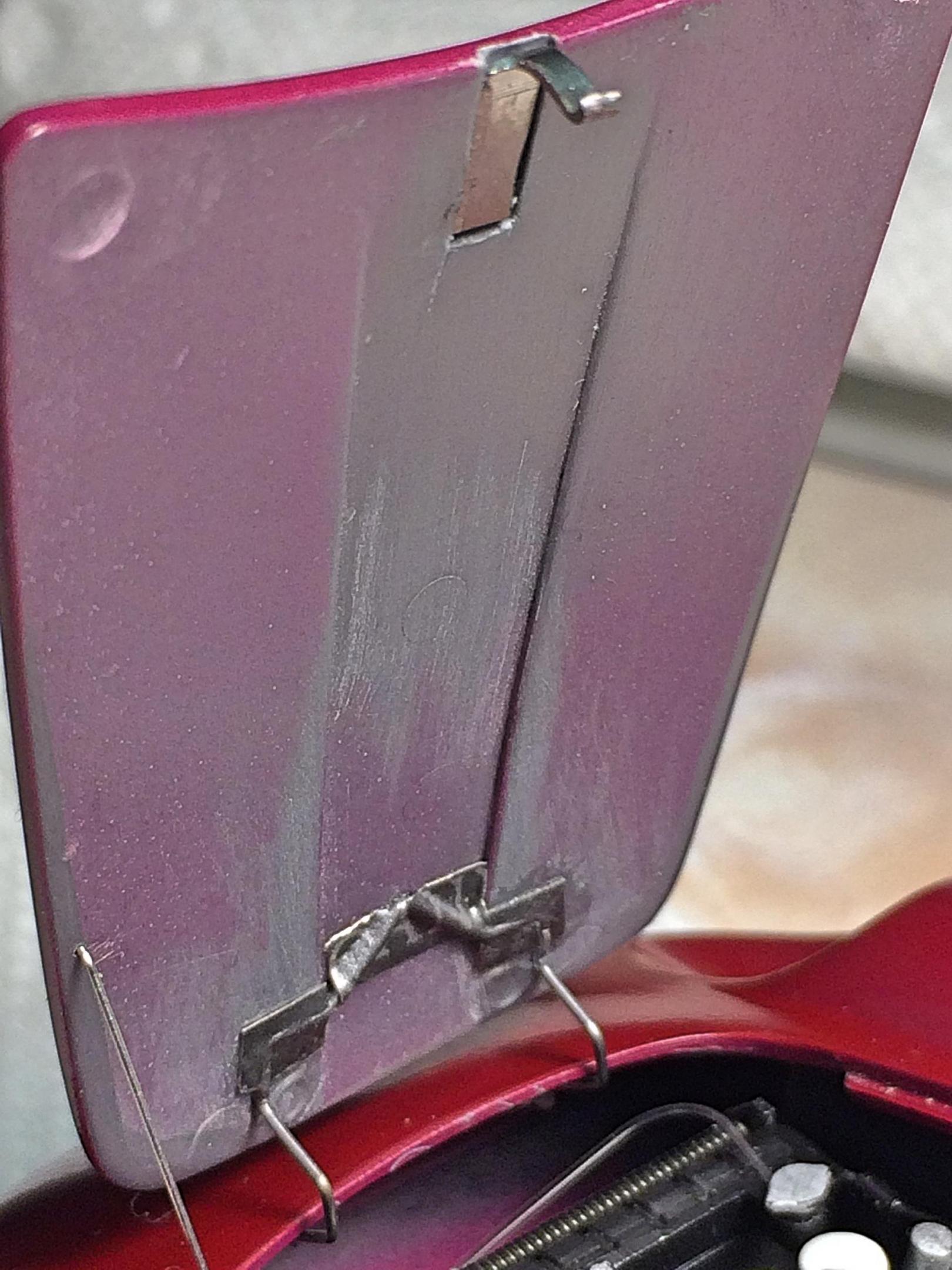

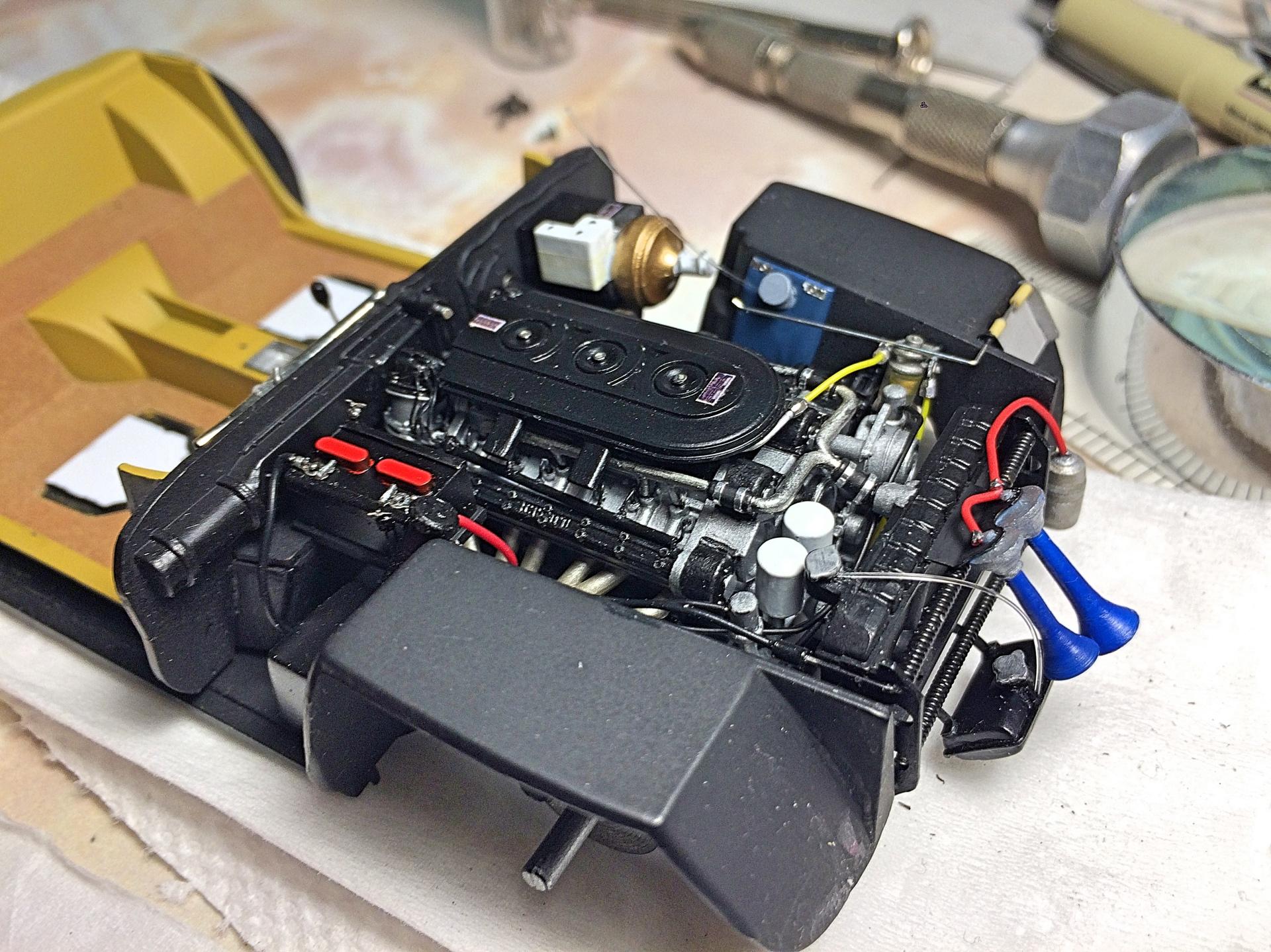

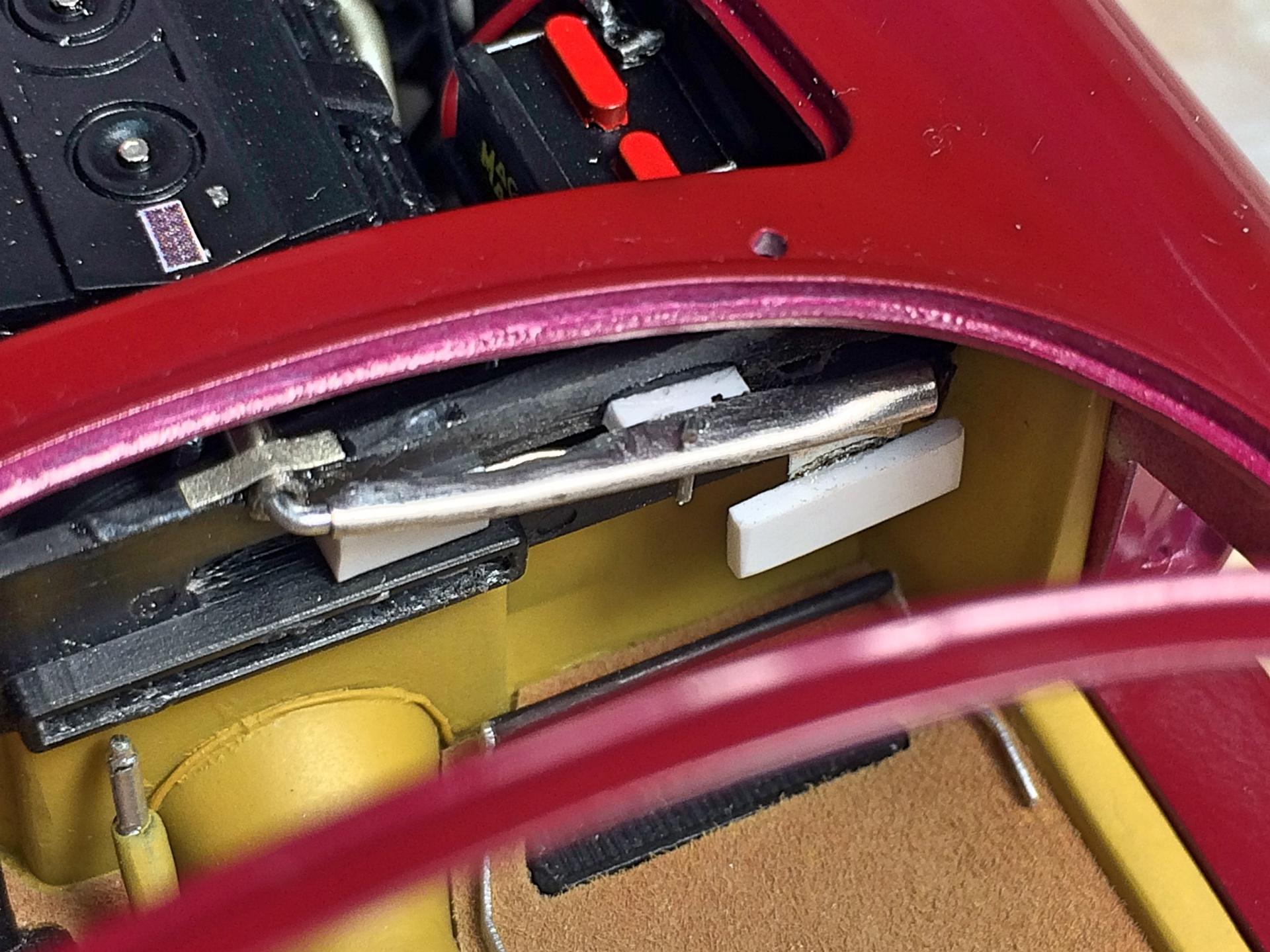

Thought of something else to prolong finishing, made a working hood latch.  I'm having tight tolerances which is keeping the hood from closing snugly, thought of using magnets, but thought this might work.  Used coffee can steel, paper clip, steel tube, guitar string, and steel from salvaged electronic device that went bad.
I drew the basic concept, but it was trial and error and remaking parts.  Needed to fit under the dash was the first requirement.  There is slop with the paper clip wire in the tube, then the "L" is loose in the folded over steel arm.  Have an "L" wire for the hinge pivot, so it can be taken out for multiple adjusting.  Started with a coil spring, just too much effort to push, so used a guitar string wire.  The white plastic rectangle will be painted like a fuse box, will wire each fuse made from clear stretched sprue, and have a teeny tiny fuse clamp added to the tool bag. ?
Added the latch to the hood.   Used the scraper tool to make the recess, sure glad I got a set!  Now the question, looking at pictures, appears the hood inside was painted black, but really want to add cigarette foil for insulation, which would cover all these not-realistic parts.
Made a video, but need sleep...... ?
Those are a bane on a lot of models.  You are doing a GSL quality level model.  The only reason I mentioned this is that, at times, one can get so fixated at correcting something or adding a detail that they accidentally miss something like this.  In the last photo of the hood latches I can see that you can still remove the hood.
Keep up the great work.  I have not been inspired to do that amount of detail to a model for several years.  You, and Dann Tier are inspiring to think about going at that again.
6 hours ago, beeRS said:
Amazing latch! So, you press on the fuse box to release the catch?
Just above it, too much twist in the arm on the box itself.
Spillchick stepped in last night, HARD to tell. ?  This plastic is also silverized, so when I remove anything, there is a shadow of the shape, things pop out after painting, so that is more of a challenge.  Thanks for saying that too about GSL level, best in the world show up and kick you-know-what, feel luck to get anything.  This forum is great for inspiration!

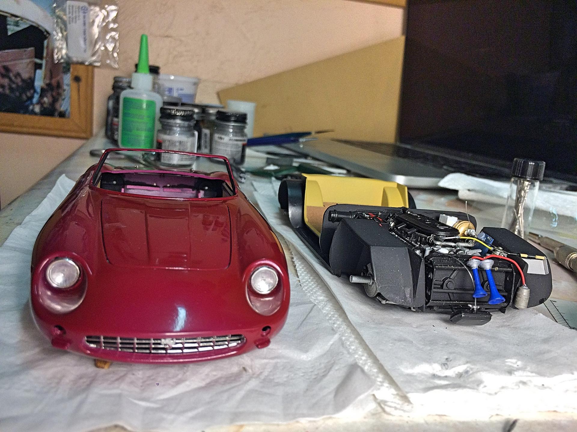

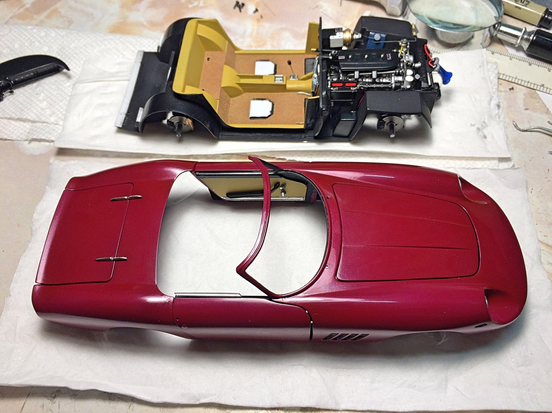

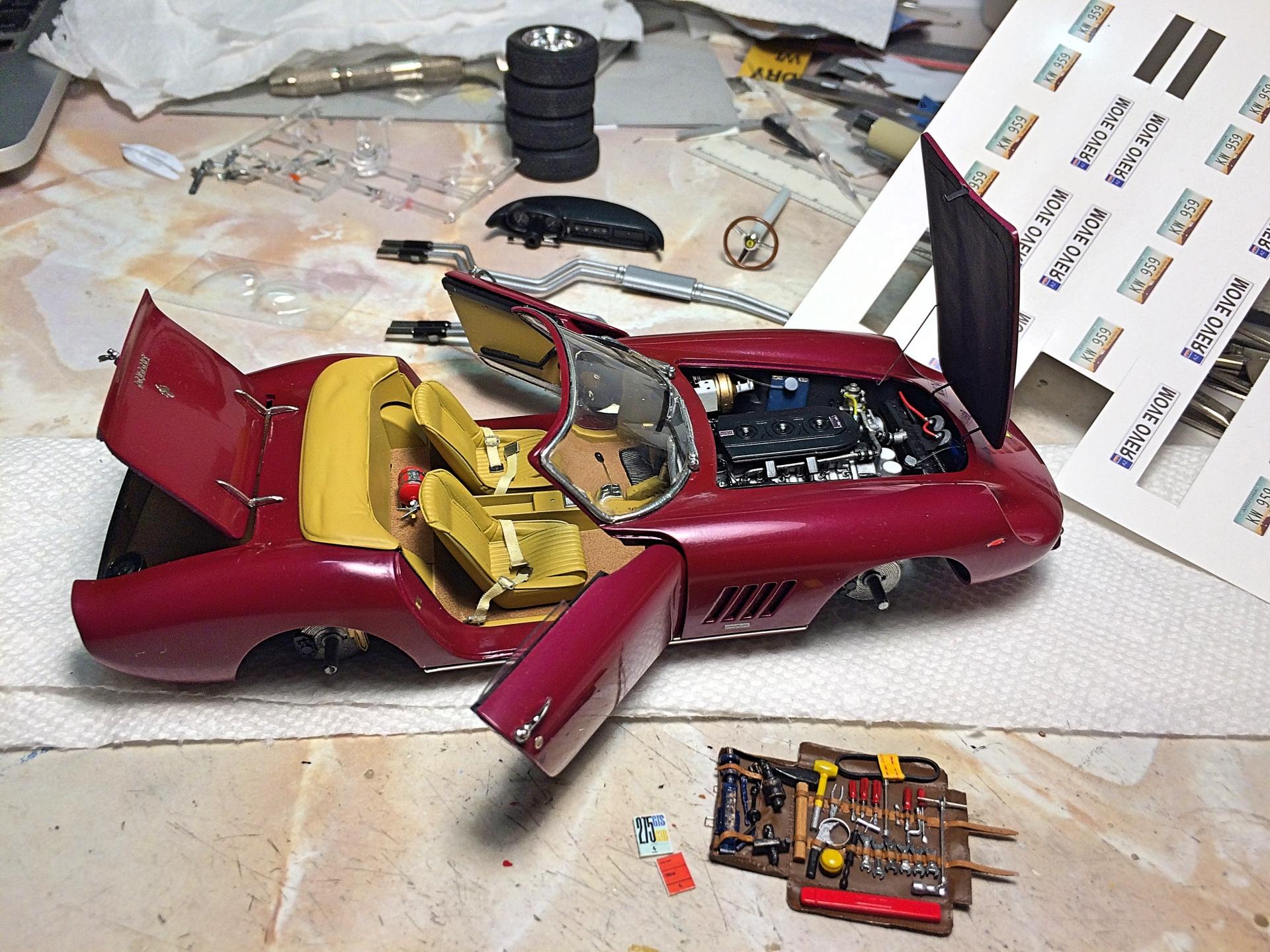

Got the final details done, more like redid several things to reduce conflict fitment.  Think it's ready to button up.

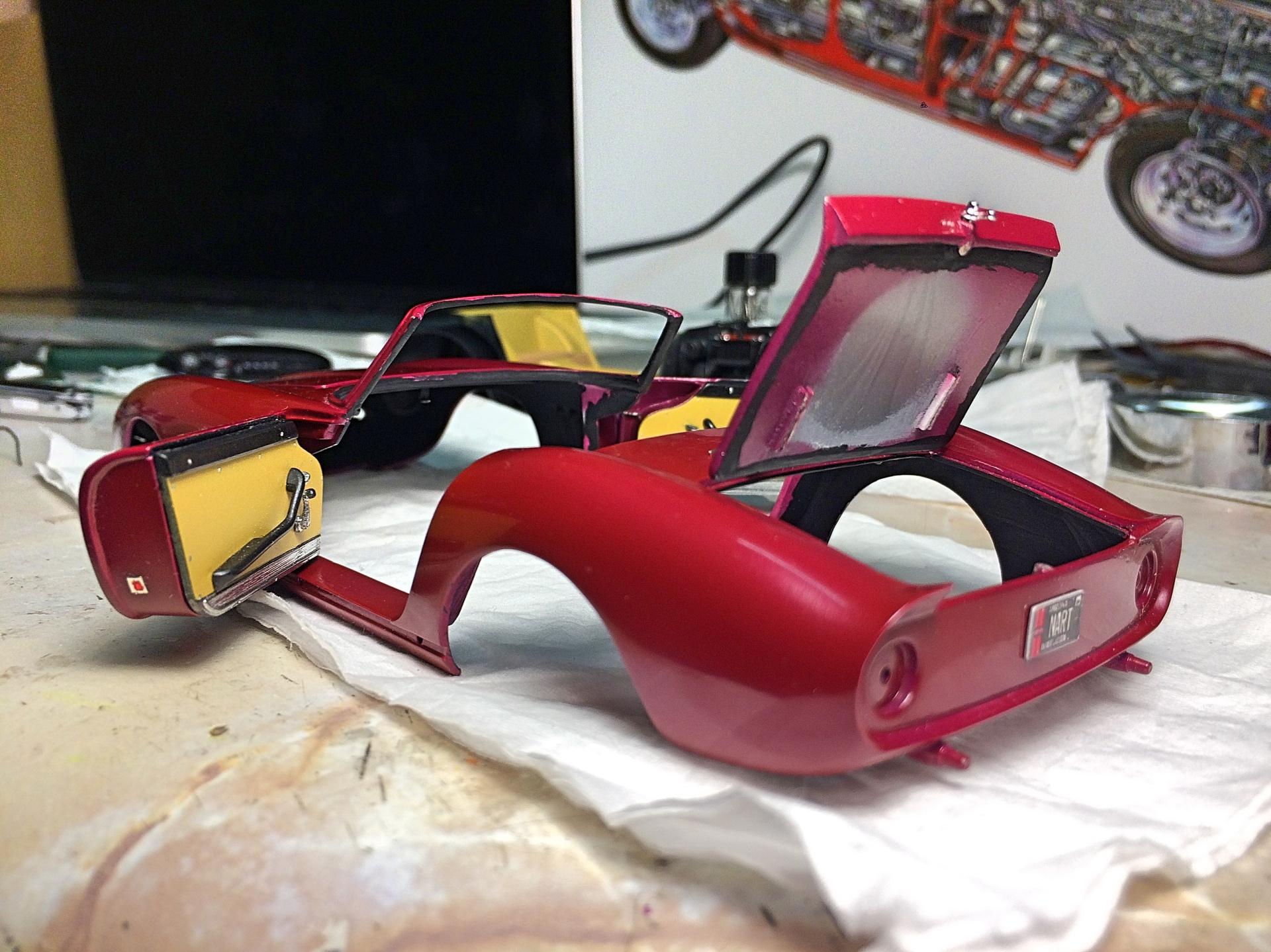

Got the doors and trunk hinges done.  I described the fusee chain way back, glad it worked the first time it was all glued in with superglue.
Glued the headlights in, before painting the inside flat black.

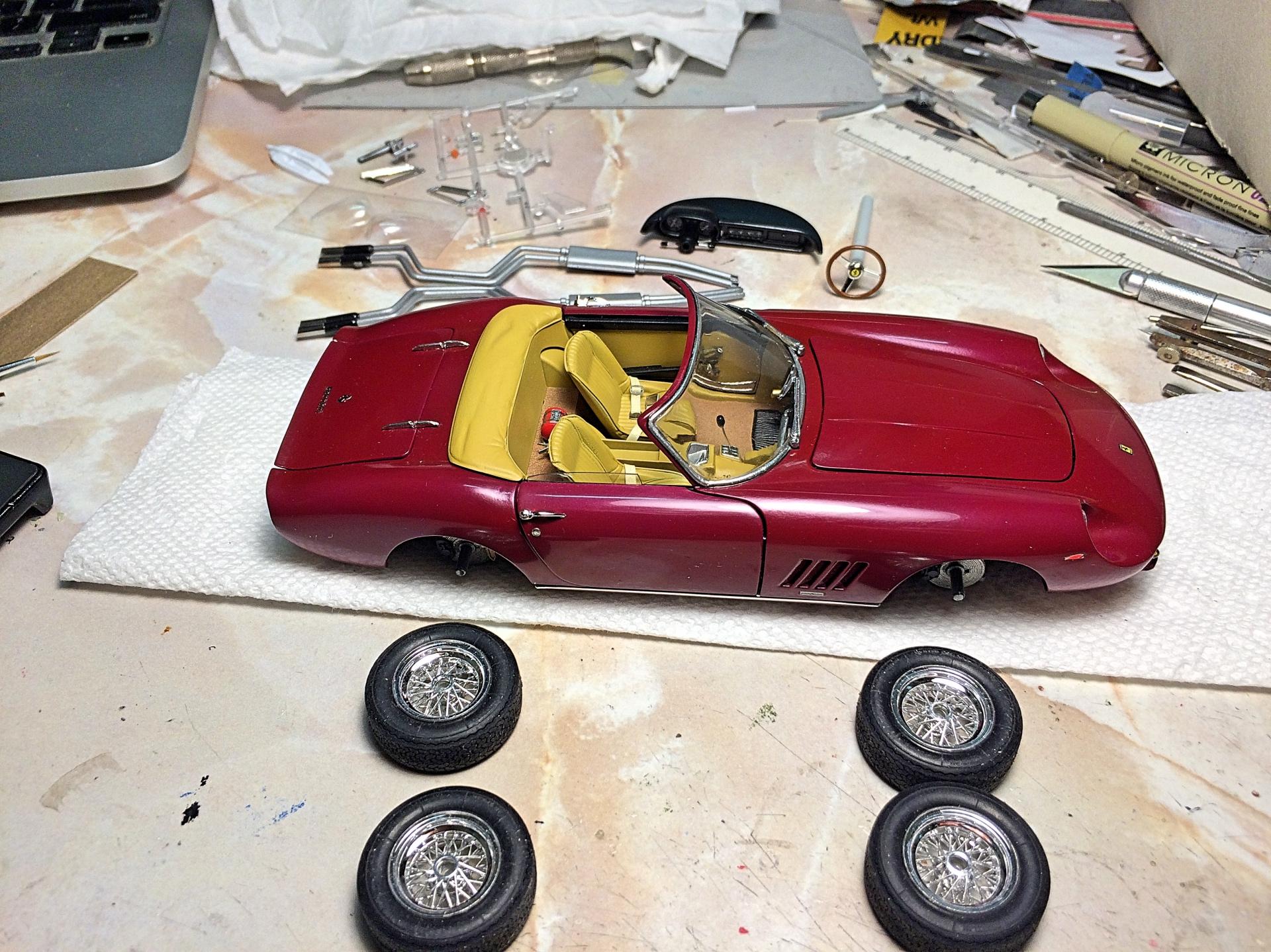

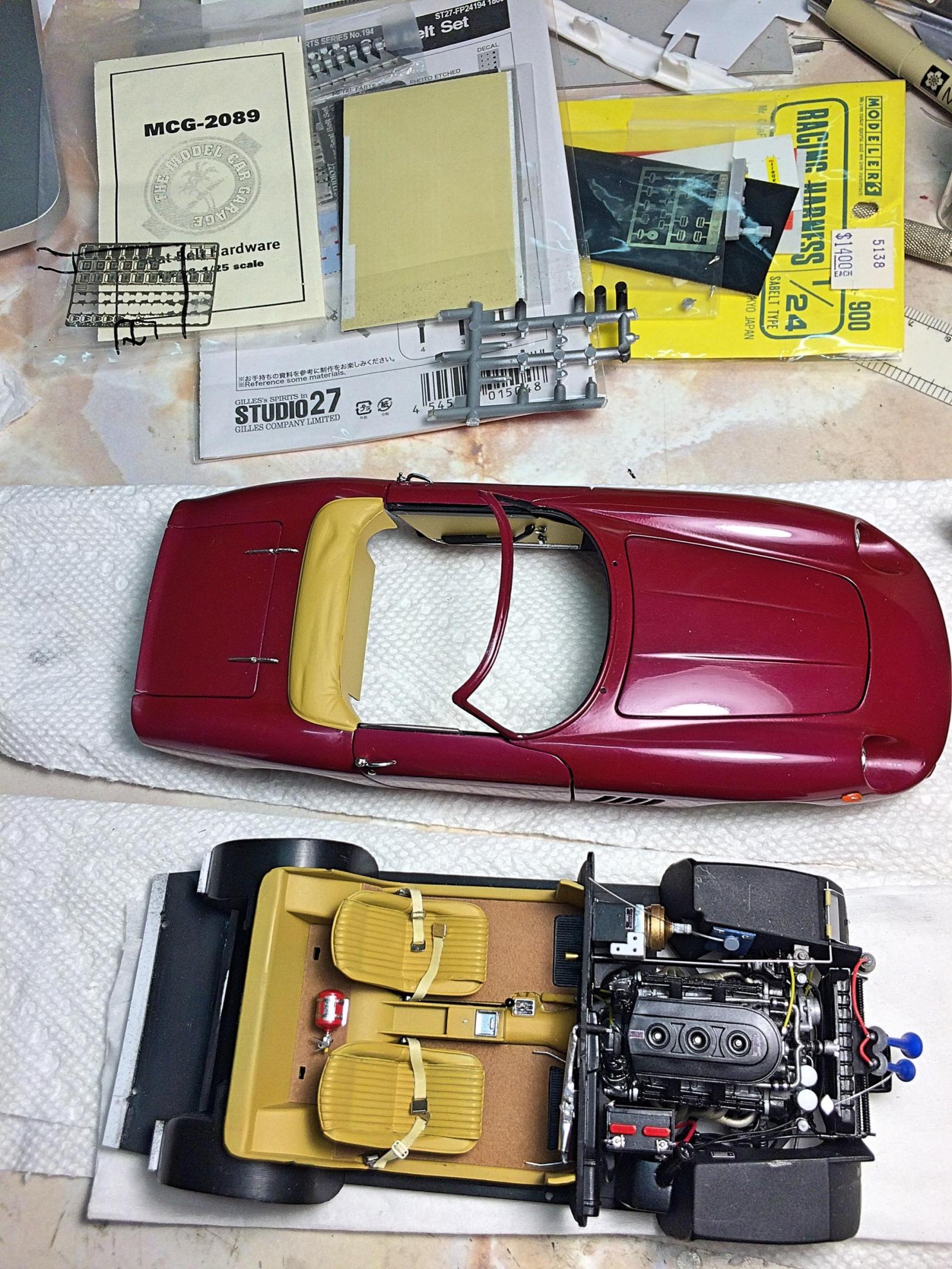

Glued on door handles, taillights, and one of the tiny teardrop lights on the fender, but that looks huge after sticking on, not happy with that.
Seatbelts were culled from 3 sources, Detail Master buckles, Studio 27 belt material, and one photo-etch part from the Modelers set.  Finally got to install the fabulous Hobby Design fire extinguisher.  Of course the seats are glued in too!

1 hour ago, Belugawrx said:
This is looking really good Kurt !
You managed to cram that engine bay full of detail ?
Thank you!  It was a challenge picking what to duplicate, there is so much more, but there is a limit.

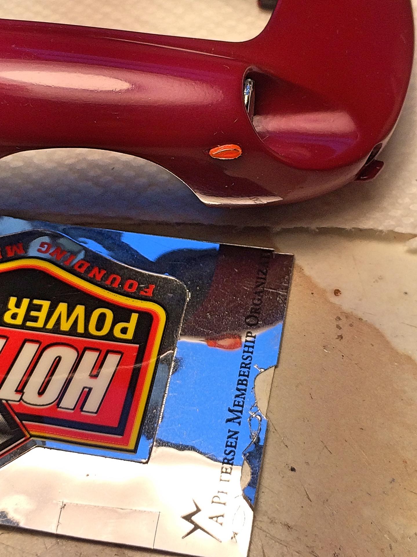

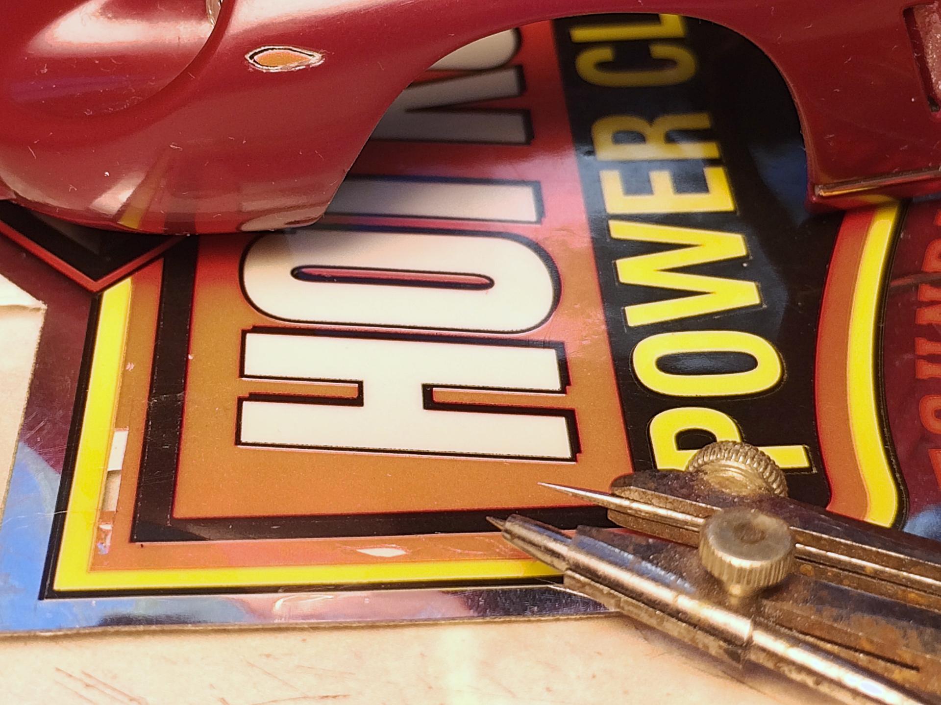

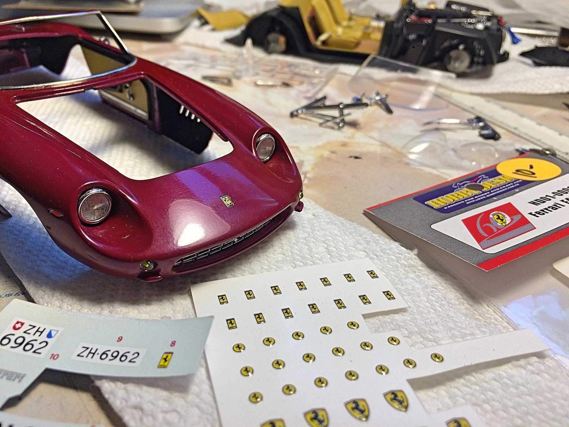

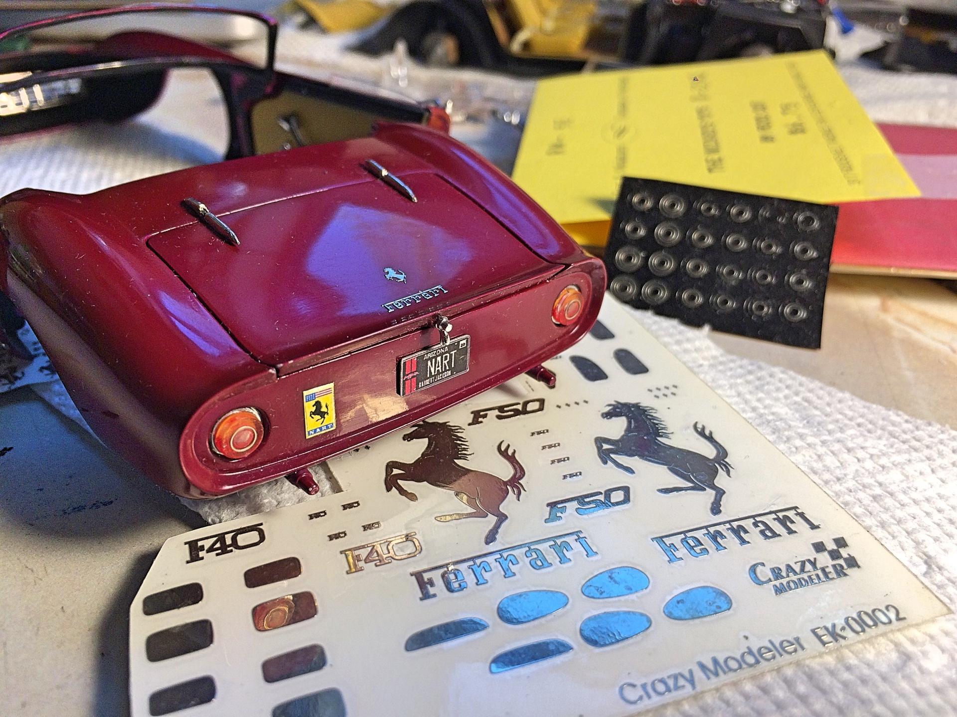

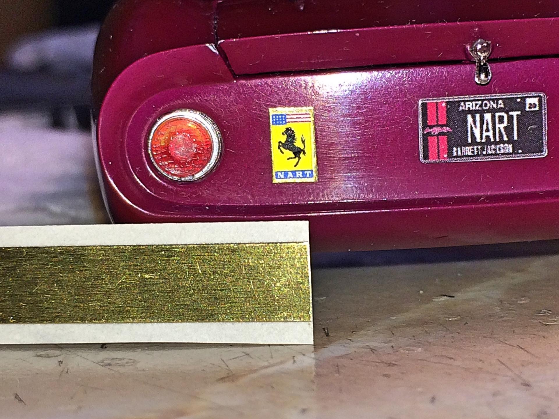

The trafficator lights were driving me nuts.  Italeri did a good job making really tiny lenses, but painting them wrecks the detail, and when put on they looked like ****.  They have chrome trim, but that would really test the limits for paint or BMF.  So I used this sticker, and a new #11 blade.
The special N.A.R.T. badge was brass porcelain cloisonné, so I used a gold sticker to put that on.  (close-up pictures sure make it look rough)
Hobby Design emblem for the front.  Getting the turn signals in sure was a challenge!
Crazy Modeler makes a nice stick-on photo-etch (or some other process, don't know) emblem set, so that's on the trunk.  Replicas & Miniature of MD Wizzard-of-Os put on the taillights.

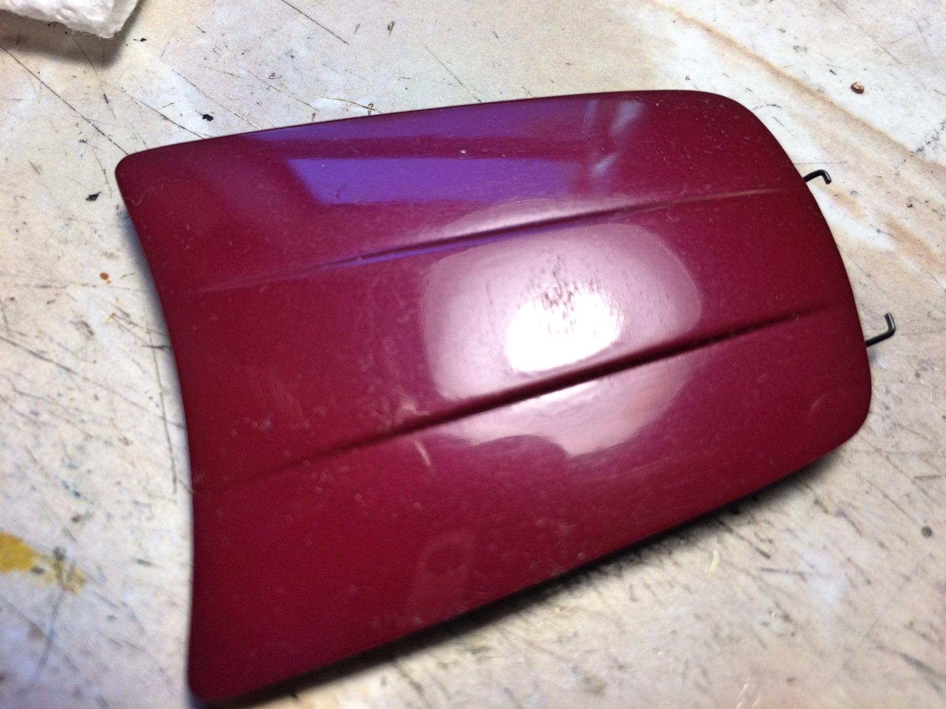

Screwed up the hood. ?  Long story....

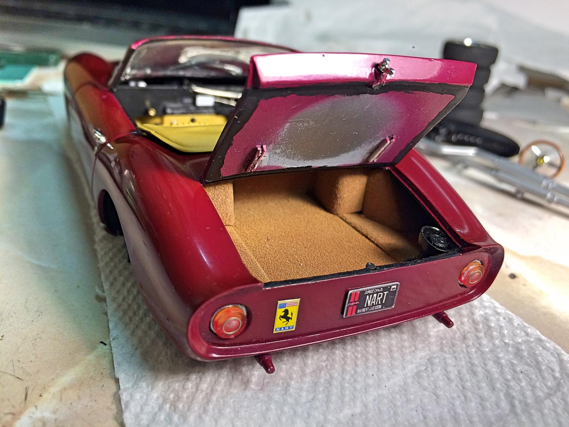

Installed the trunk carpeting, used lots of Tacky glue.  I had dislodged the magnet and lost it, lucky to have some still.  Gas filler is now in.  Just need to figure out the lid finish, will look for craft paper at Hobby Lobby tomorrow.  You can see how I glued in the fusee chain.

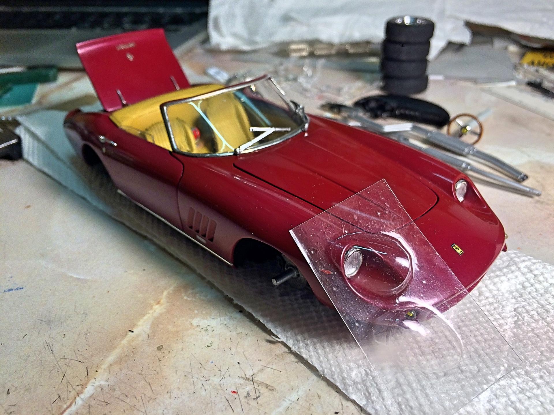

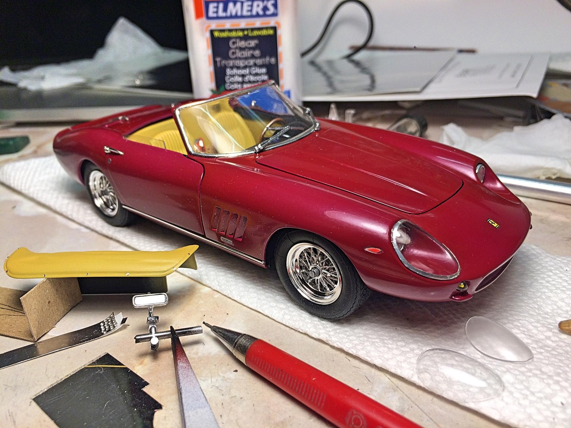

Got one headlight cover done!  Wish I could go thinner on the frame, but the BMF barely sticks on as it is.  The mirror is part of a scavenged camera LCD screen back, very thin and just like a mirror, "glued" in with black paint.  I almost get blinded working on all this shiny stuff. ?  Added snaps to the cover, using a .5mm mechanical pencil and aluminum tape.  Got the wheels on! ?  Carefully drilled a little bigger hole.  Need to evaluate the offset, if there needs to be a spacer so they don't look so old fashioned.
