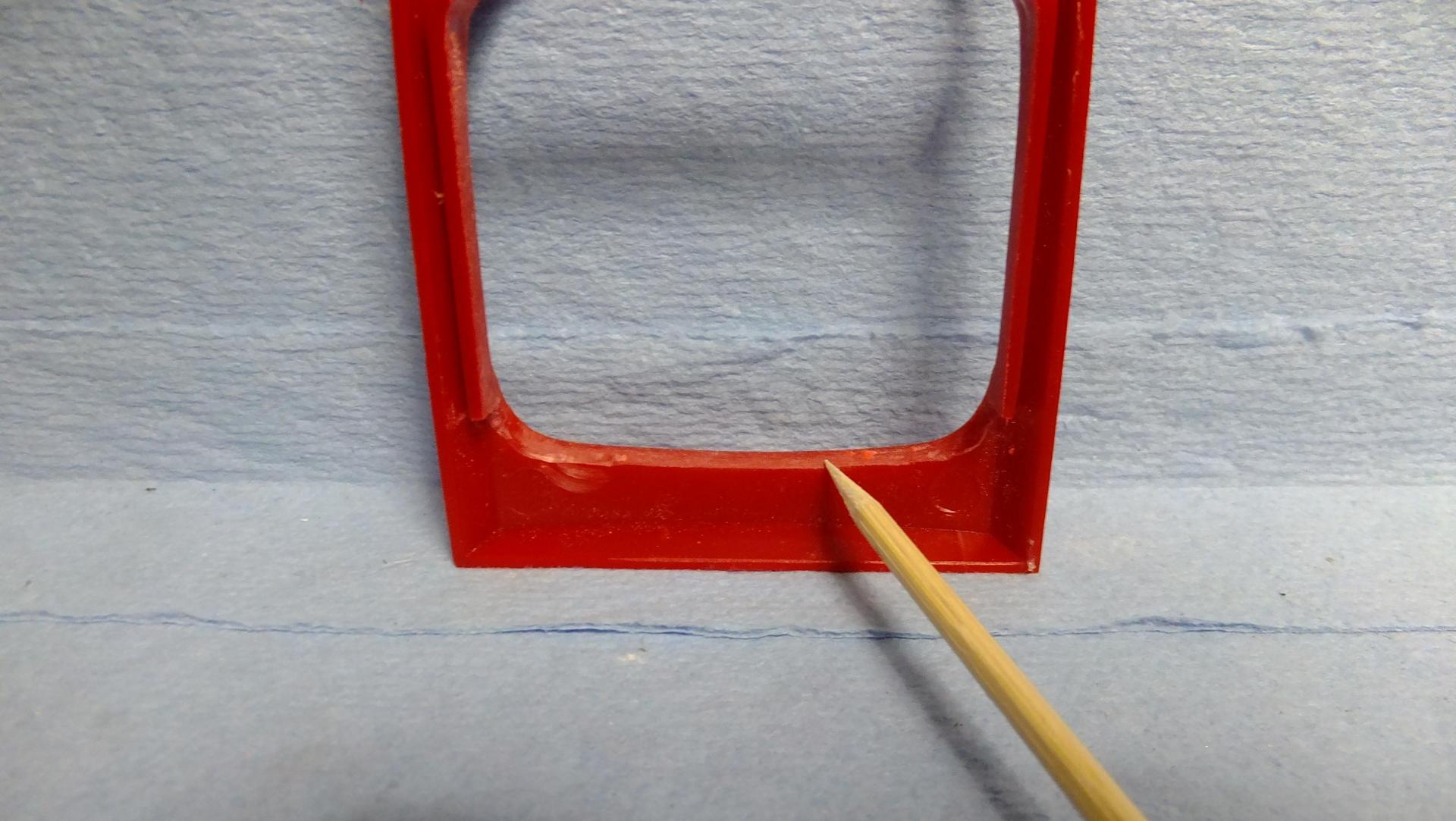

-Photo 1; In order to make things more realistic, i need to remove this rather large windscreen contact point.

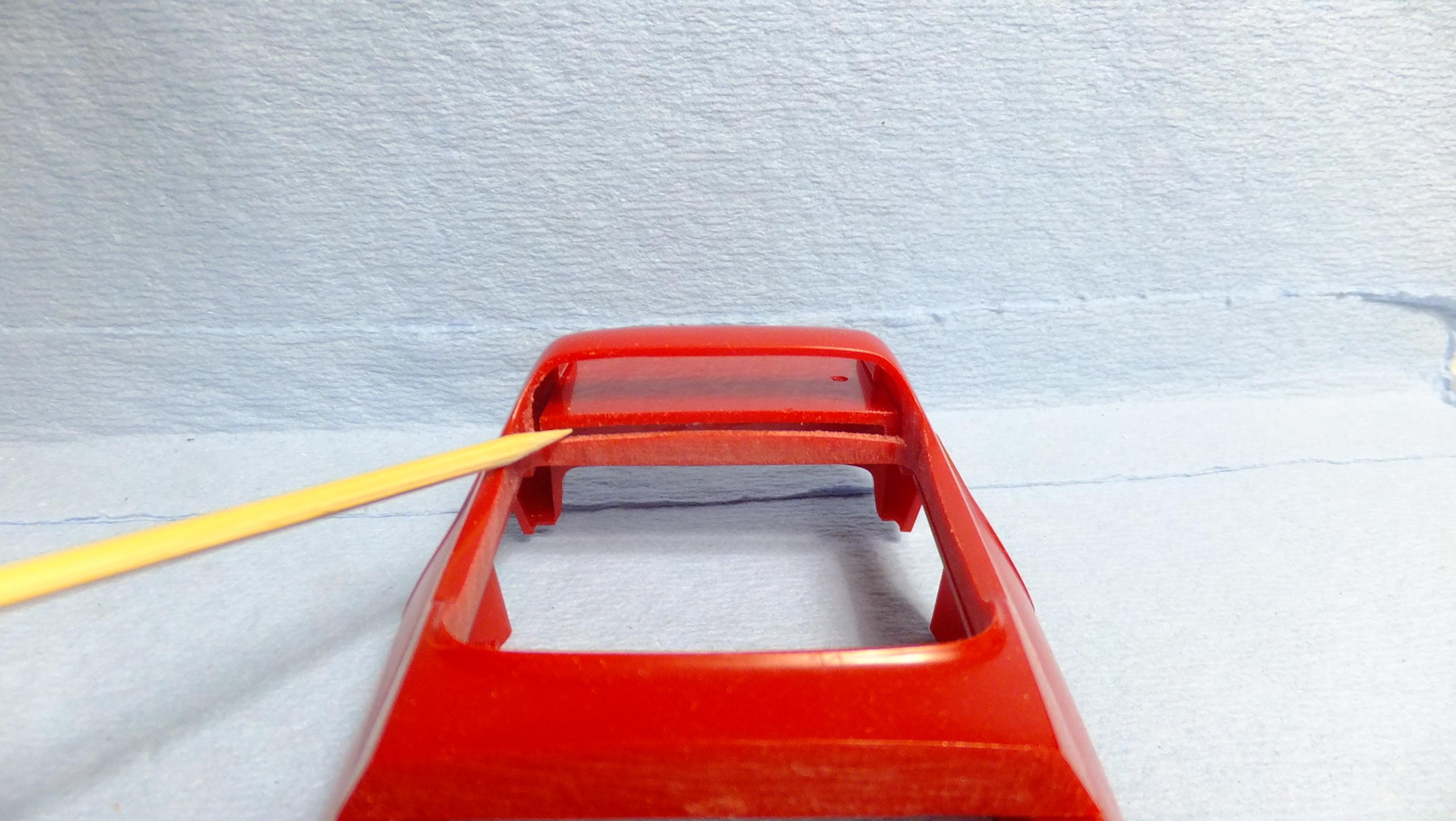

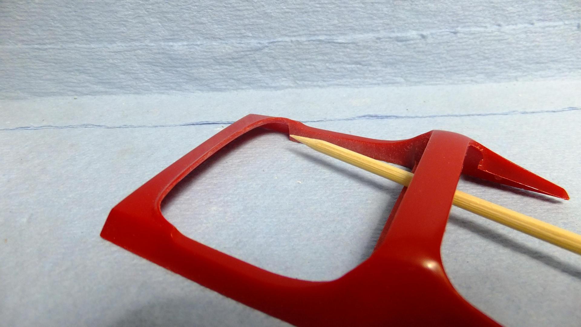

-Photo 2;  I also decided that it would look much better without this ridge behind the seats...its a visual obstruction.

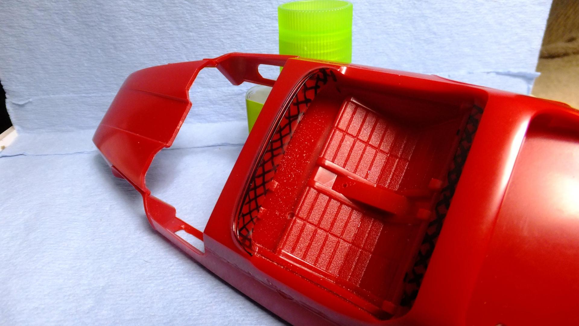

-Photo 3; ...next, its time to fill in those sides of the Malibu? Bar.
-Photo 4; This is a rear view of that ridge behind the seats...looks to me like an engineering goof-up.

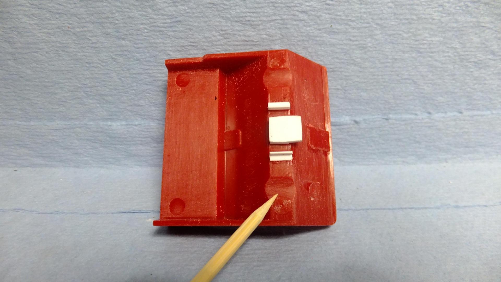

-Photo 6; After cutting that ridge away, i needed to cut the back lower still, to allow for a styrene tab to be attached in order to add a strip of body filling plastic to be blended into the rear deck.
-Photo 7 & 8; All cut-away ready for better things!

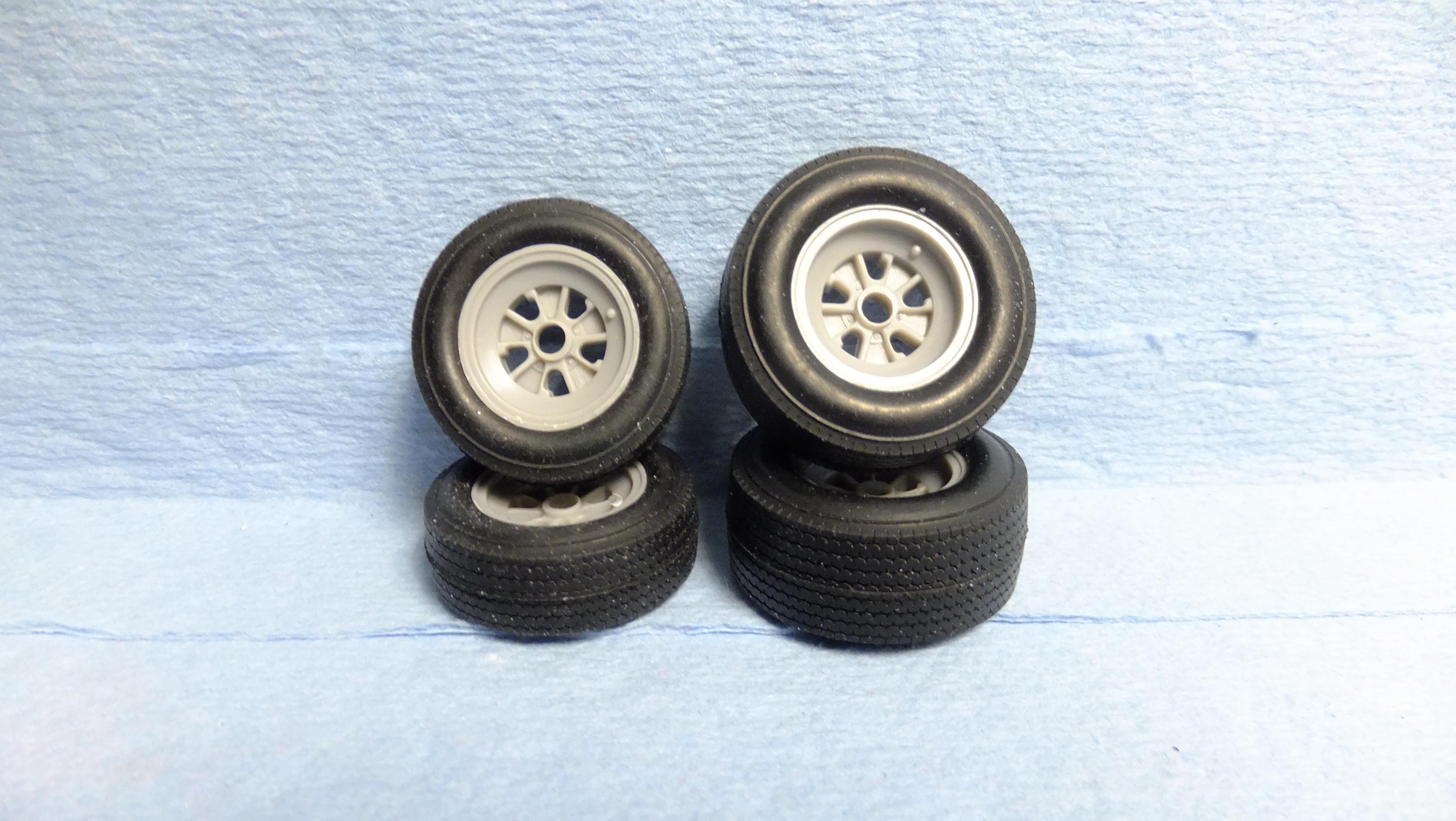

Here are the wheels, and tyres i am using....the tyres are from a Fujimi GT 40 kit, and the wheels are from an Accurate Miniatures Grand Sport Corvette.

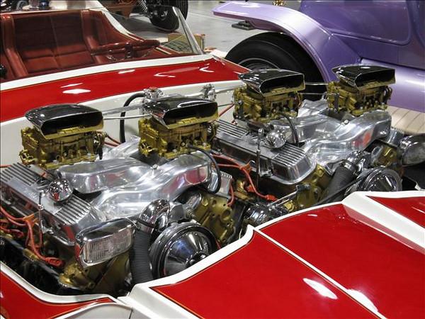

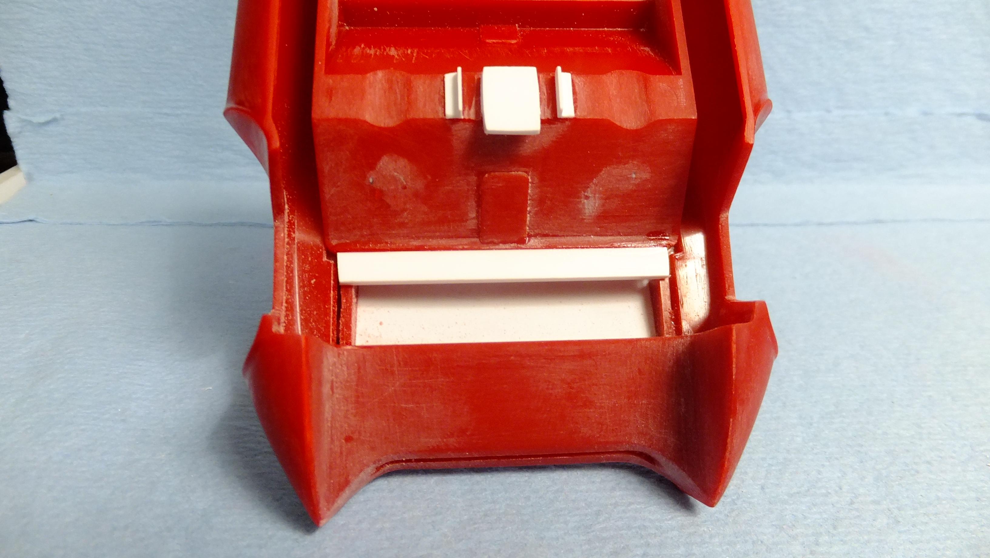

Little bit of an update here. I cant believe that the headlamps were actually mounted on the engine blocks!!......so i decided to move them, and shape them in a way that i think better suits the design. I have simulated LED headlamps for them....should look knarly!! Photo 3 shows the filled in section of the body. For some reason, this bit was screwing with my head....to me it doesnt look even, and squared, but i measured it all over, and it is, lol....cant wait to get primer on this bugger so it stops messing with my head!, lol

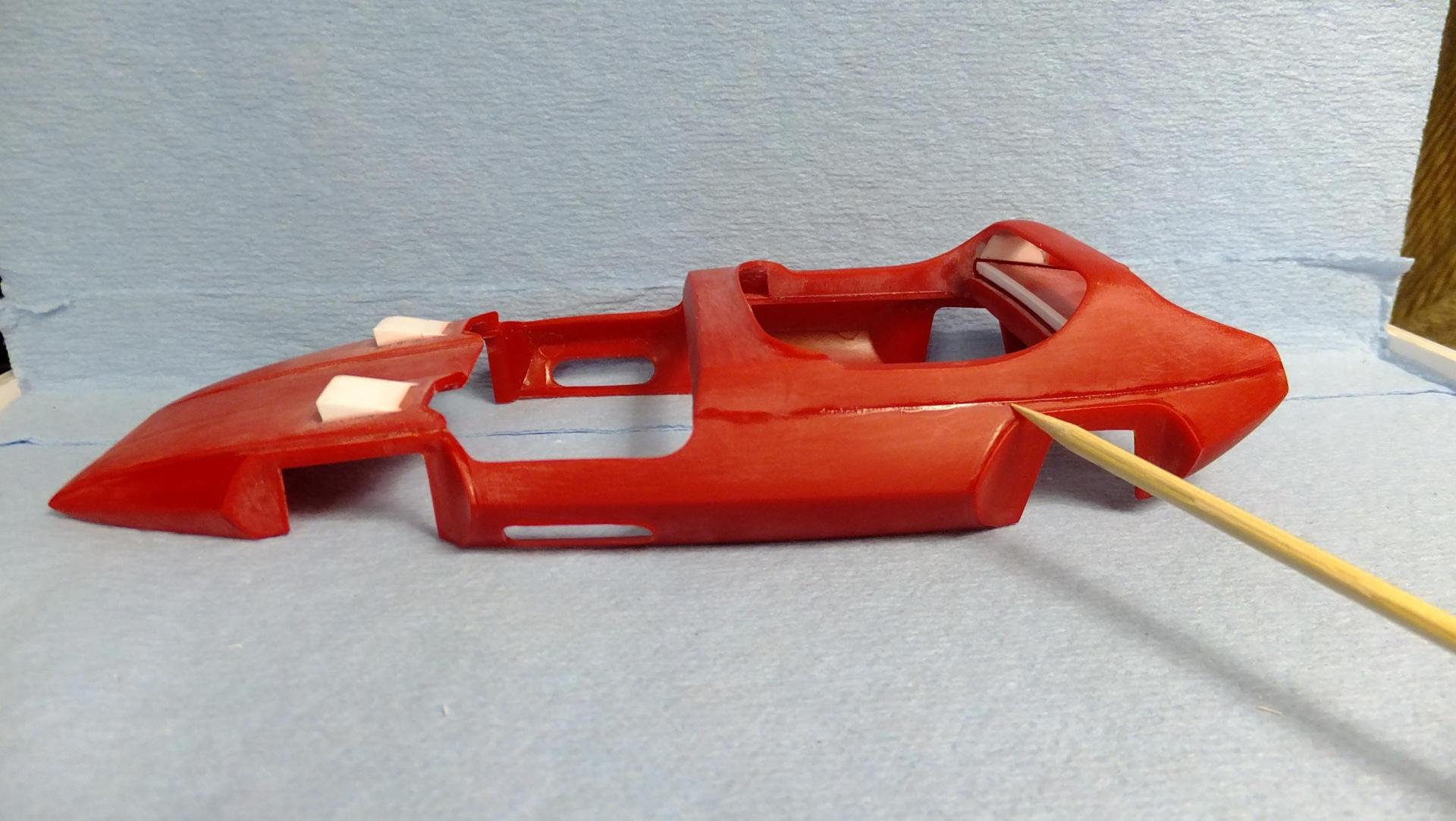

Hey, everyone!, new update here!.....all the body parts are glued together, and i'm in the proccess of doing the final filling, and sanding!!  I normally dont finish my bodies first, incase i have to modify something, but i dont have to worry about that with this one, so i will be painting it within the next few days.

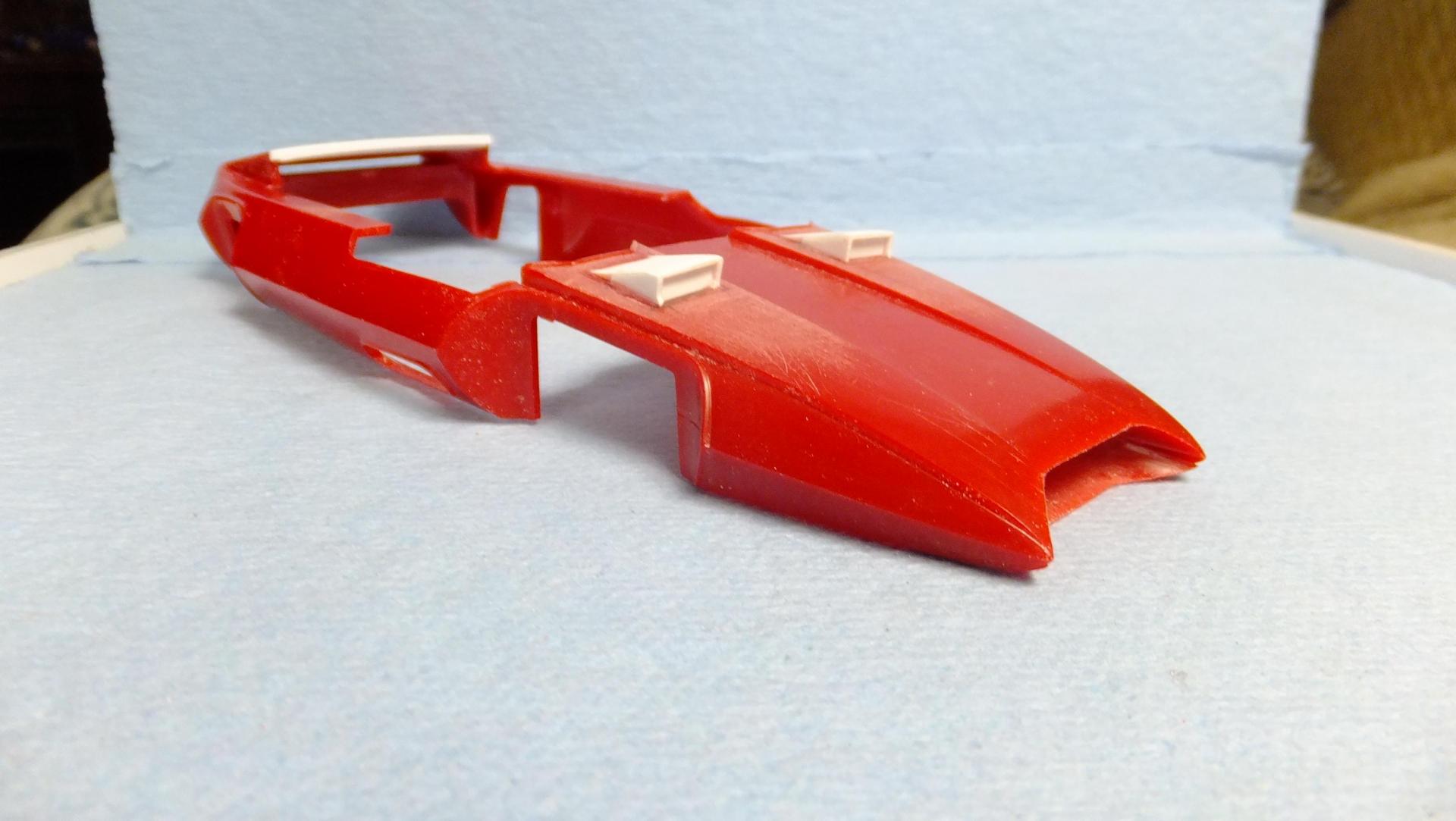

-Photo 1; I added super glue to fill the main seams in.
-Photo 2; I will be filling the base of the Malibu bar next, and blending it in.....then paint!!

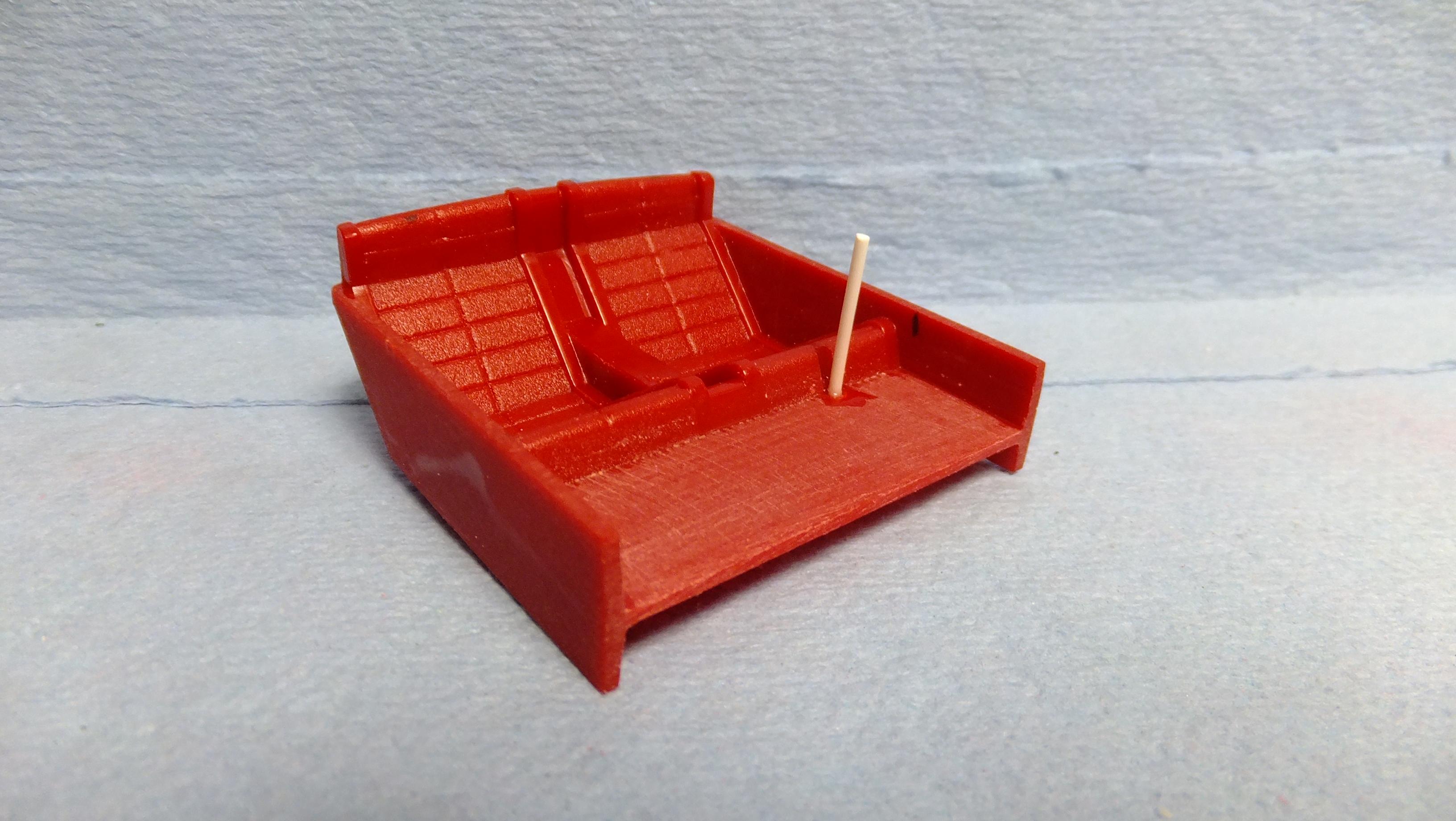

_photo 3; I attached this crossmember for a couple of reasons...1) to make a solid contact for the front of the interior tub, and 2) to give me something to add my SB peddles to....could come in handy when i attach the dash, and SB center column as well.

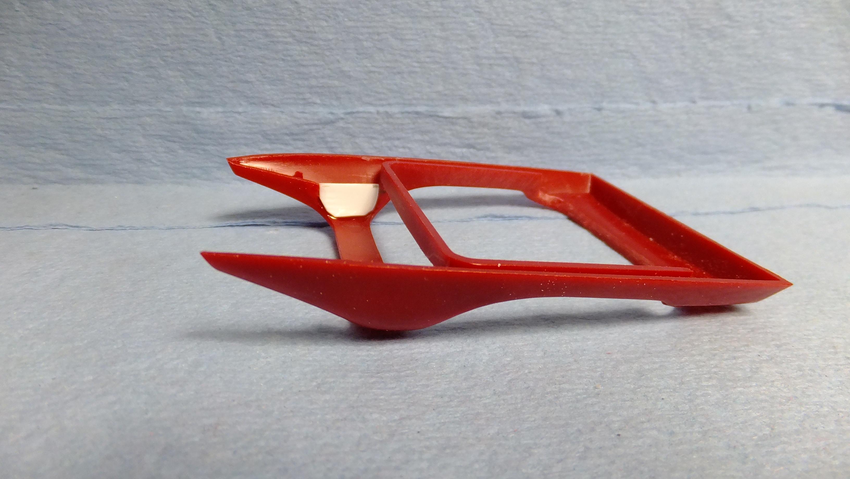

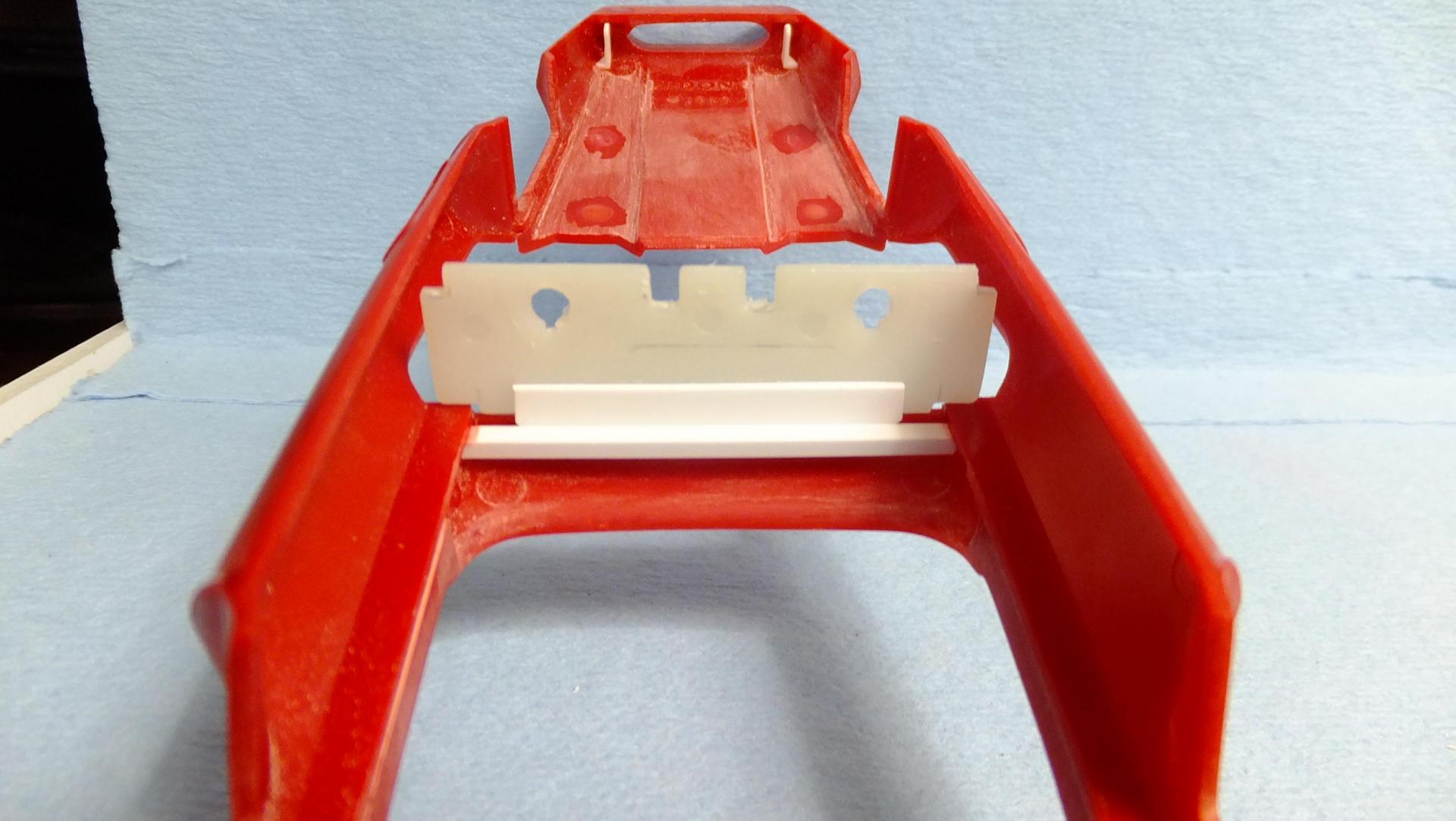

-Photo 4; I needed to put a new rear interior tab on.

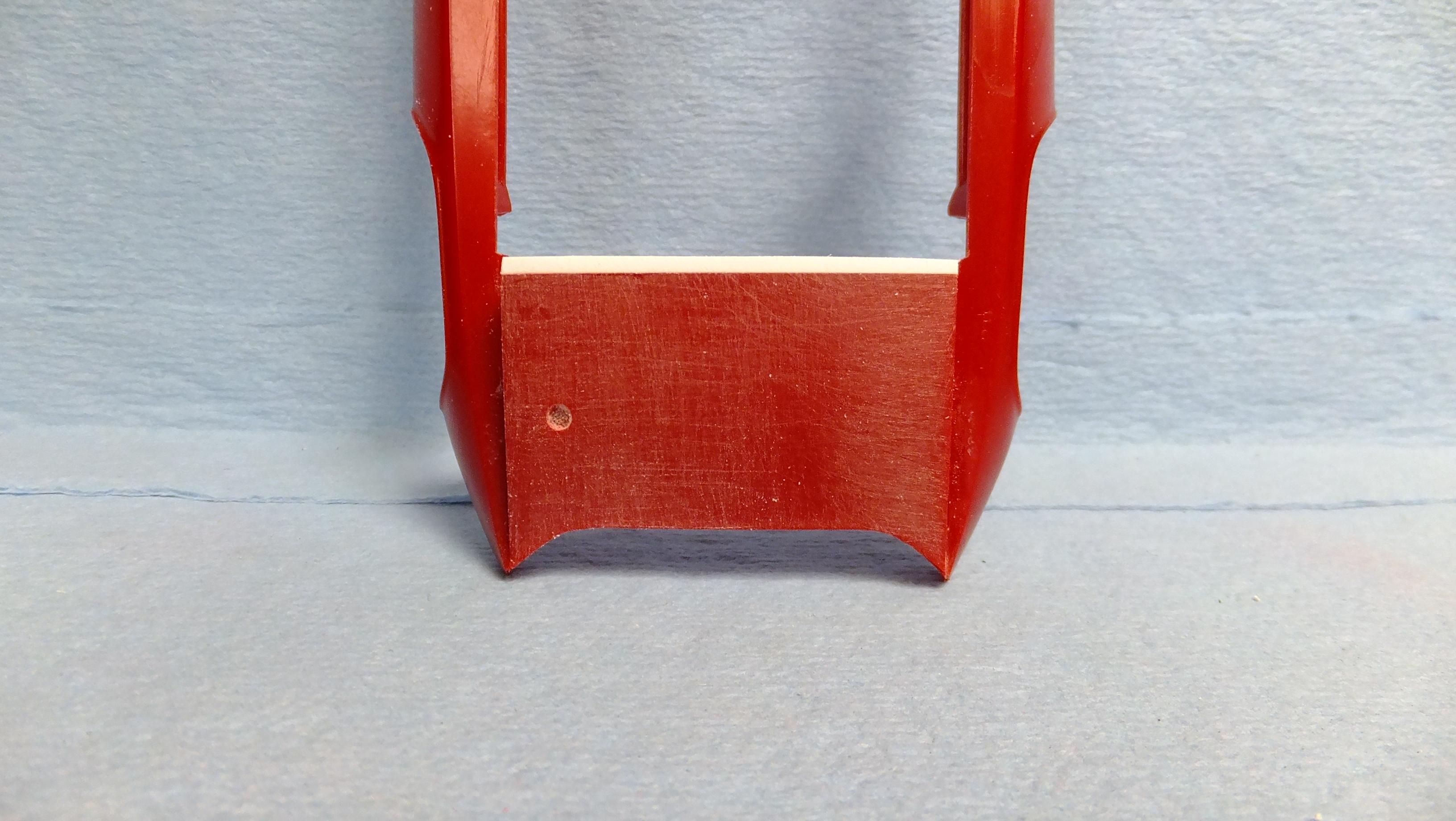

-Photo 5; I made sure that i left just enough space with the interior crossmember, so that the tab i added to the firewall would still fit.
-Photo 6; Another view of the rear interior tab in place...
-Photo 7; ....and another view of the interior crossmember.

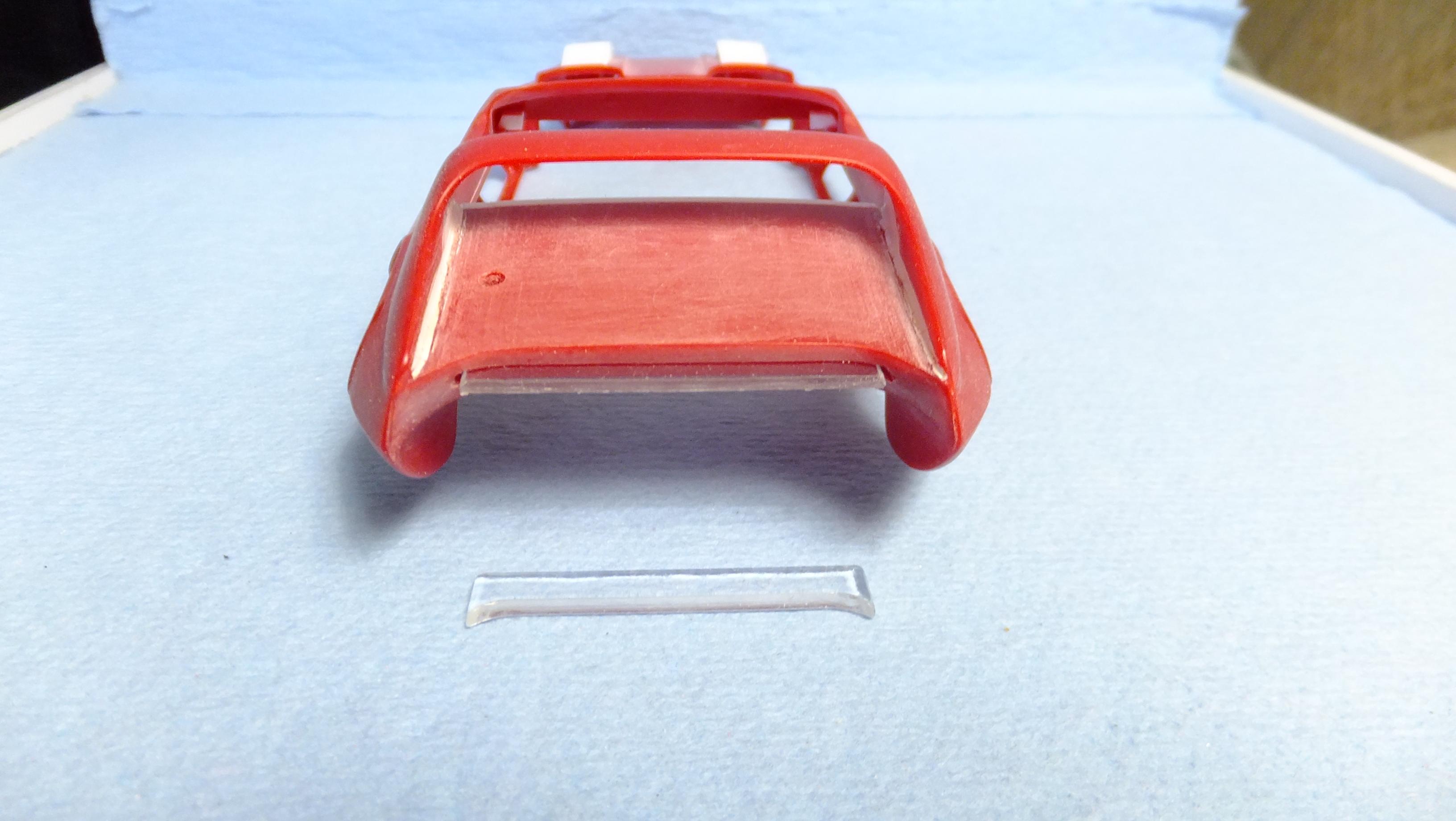

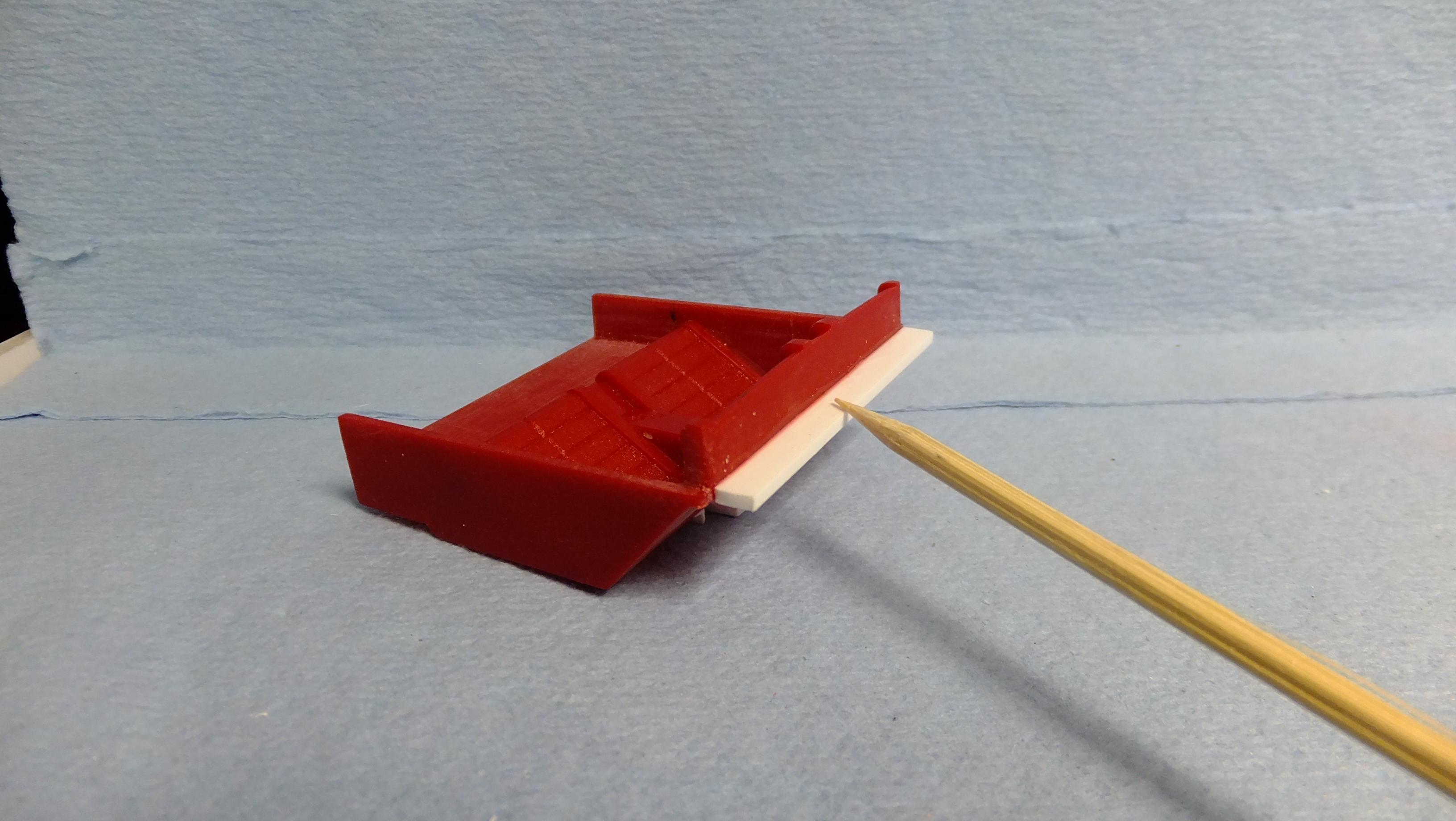

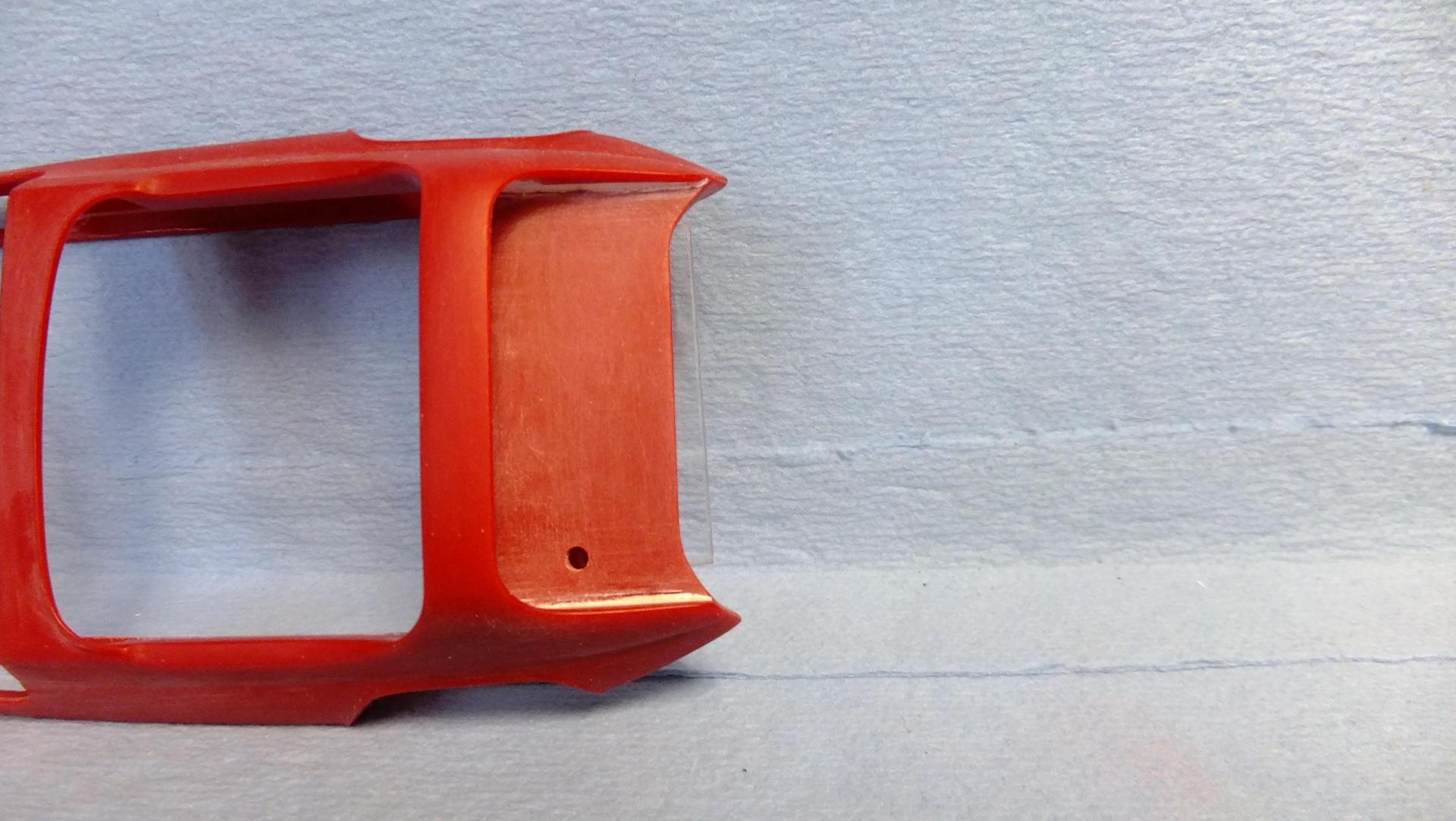

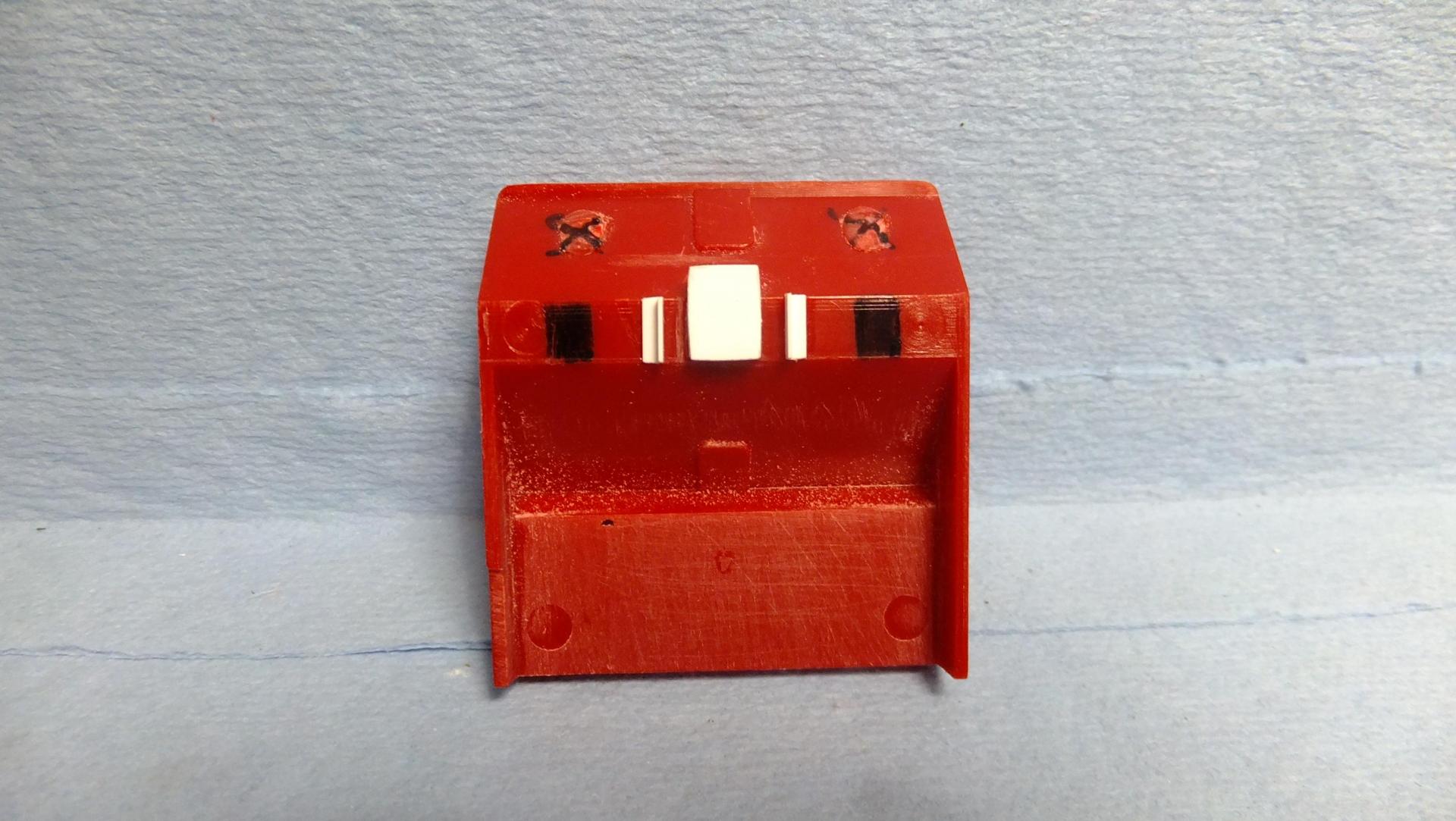

Even though my butts getting kicked by a cold, i still managed to plug away a bit. I have everything filled in, and sanded...whilst doing that, i noticed that the tailight in the kit was made upside down, with the wrong body line angle.....sooo, i made a new one
-Photo 1; I started with a sheet of clear styrene that i left slightly smaller all way round to compensate for paint thickness....you dont wanna try to install it with zero tolerance!!
-Photo 2; In order to keep it from slipping through, i made it go all the way back and touch the back of the interior tub.
-Photo 3; While it was in place, i traced out the shape, and cut it.

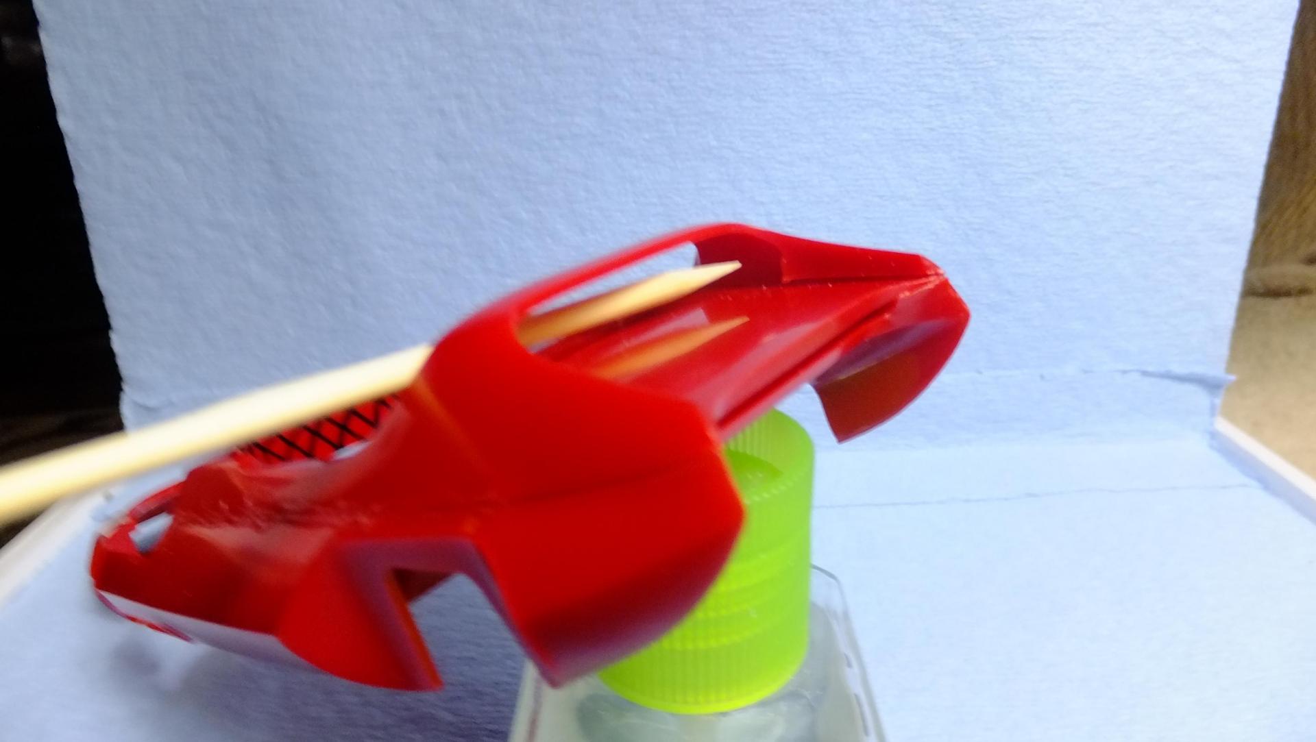

-Photo 4; This is what the light is suppose to look like...the kit had the opening upside down.
