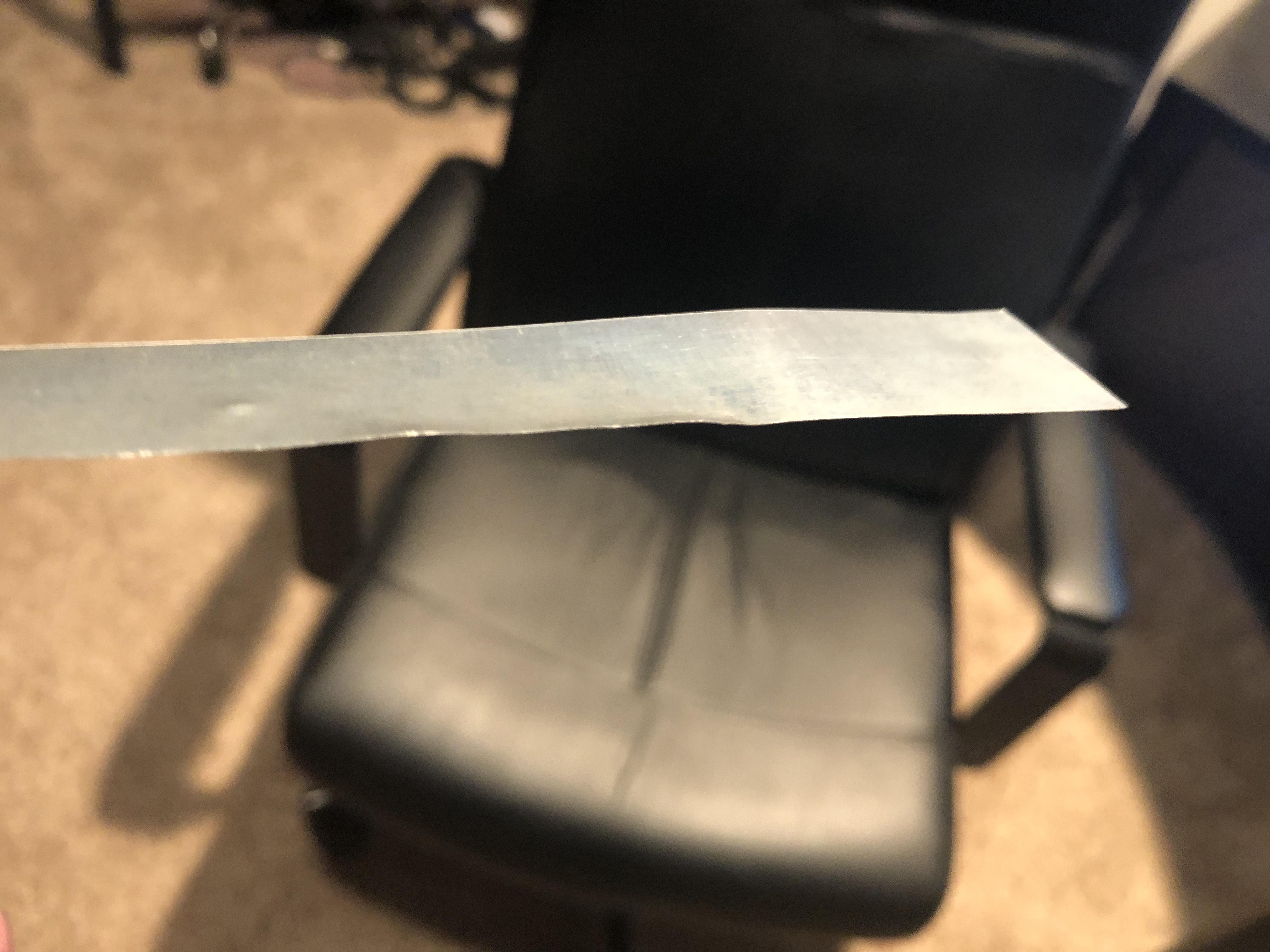

Lorne Posted January 7, 2020 Posted January 7, 2020 I see a lot of various metals mixed in with styrene these days! A really cool material to add is offset printing plates!! Go to your local print shop and ask for used AB Dyck (popular printing press machine) printing plates (print shops usually throw them out, if not recycling). They are a super thin medal plates. They polish to a super chrome finish and cut very easy (scribe and snap very flexible). Very cool stuff!! And FREE!!!

iBorg Posted January 8, 2020 Posted January 8, 2020 Long time printing educator here..... At one time 3M sold E plates. These had a really nice polished surface. These were discontinued about twenty years ago as they required some pretty nasty chemicals to develop. The presses that use these were smaller sheetfeds. That market has pretty much gone to digital printing. A newspaper press would use a hard anodized plate. This results in a rather dull gray finish. I'm not sure how usable those would be. My suggestion is to go to a local hoe improvement store and get some aluminum flashing. If you need it softer you can always heat with a torch and effect its temper.
Straightliner59 Posted January 9, 2020 Posted January 9, 2020 3 hours ago, iBorg said: Long time printing educator here..... At one time 3M sold E plates. These had a really nice polished surface. These were discontinued about twenty years ago as they required some pretty nasty chemicals to develop. The presses that use these were smaller sheetfeds. That market has pretty much gone to digital printing. A newspaper press would use a hard anodized plate. This results in a rather dull gray finish. I'm not sure how usable those would be. My suggestion is to go to a local hoe improvement store and get some aluminum flashing. If you need it softer you can always heat with a torch and effect its temper. Aluminum flashing is what I have used, for years. I anneal it, if I need it softer, for more complex shapes. No need for that, for making panels, etc. It does have a thin plastic coating that needs to be sanded off,if you are going to anneal it. I made the scoop for my '34 with it, as well as the interior panels and dash. The body, seat bucket and firewall for my junior fueler. It's invaluable as a building material.

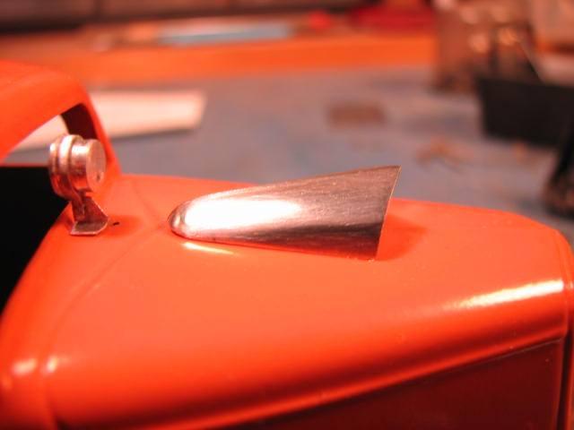

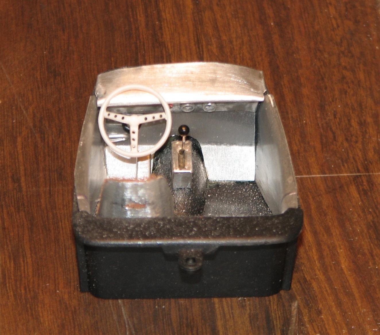

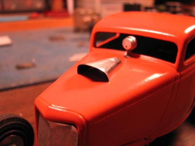

Straightliner59 Posted January 9, 2020 Posted January 9, 2020 While the flashing is a little heavy (about .008", once the plastic coating is sanded off), whatever alloy it is, is perfect for creating compound curves, such as dragster cowls, once it's been annealed. I attempted the same with tooling aluminum, but, it doesn't form complex curves as readily. It tends to buckle, fold. Neither tooling aluminum or roaster pan aluminum feel really stiff/durable enough to build entire bodies with, although they do work nicely to create the odd panel, by burnishing them over a kit part. Tooling aluminum works wonderfully to make things like baby moons, and other plain hubcaps. I rubbed some down over the top of an air cleaner, and in the instance I was super-detailing one, I would definitely go that route. They all have their place, and each is better suited to some tasks, than others. The bottom line is, one can never have too many different materials! ? I skinned this vac-formed tank lakester with tooling aluminum. It was just a quickie build, but fun!
Straightliner59 Posted January 9, 2020 Posted January 9, 2020 55 minutes ago, misterNNL said: I have several sheets of printing plate and would like to be able to shape it to build model travel trailers like the Airstreams built in my home town. That would require multiple curves. How is the annealing process done that I see mentioned here and can it be done at home safely? Here is how I learned/read how to do it: You'll need a good torch (I use a Bernzomatic MAPP gas torch), a bar of Ivory soap, and something to hold enough water to quickly quench the sheet. Coat the metal by rubbing it with the bar of Ivory soap. Light the torch, and heat the aluminum. As soon as the soap coating turns black, quench the sheet, and you should be good to go!
