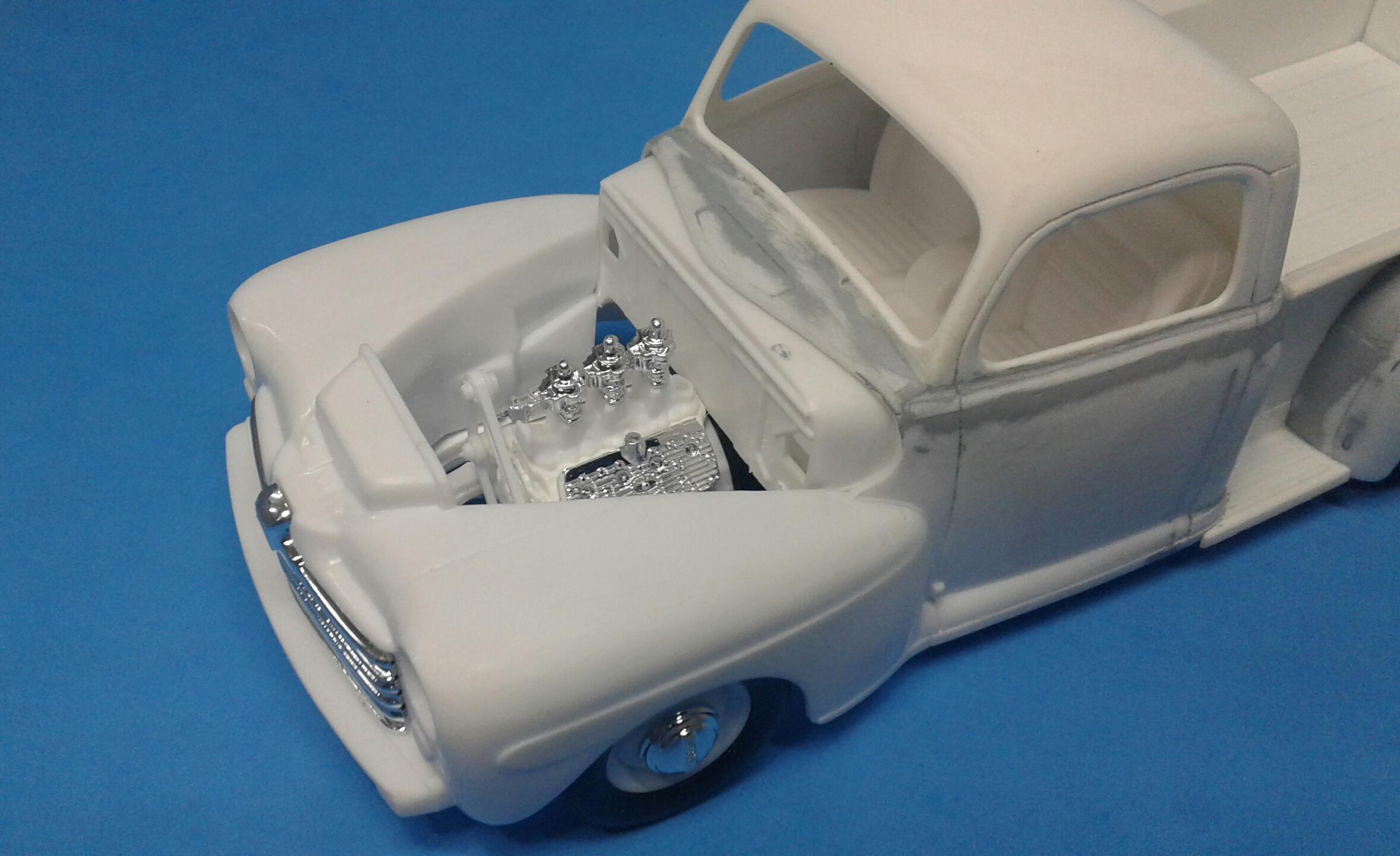

I've had this idea rolling around for some time. After building the '36 last year, the idea for this one really set in. Unable to resist any longer, I started hacking. The chassis is from the F-1. But, will have to be modified a lot to get the wheelbase right and the stance I want. Right now, it's literally resting on the axles. But, it's where I want the stance to be. The body is made from the '48 convertible clip, partial cowl and partial doors. It also supplied the rear fenders that have been widened and made to fit. The F-1 supplied the roof, partial cowl, top of doors, rear of the cab, bed floor and sides. Not sure if the chrome strips on the fenders will stay or not. Also, trying to decide on the interior whether to use the F-1 or the convertible. The F-1s would obviously be easier. Maybe I'll do a combo of both. We'll see. The plan for the engine is to use the truck block/trans with the convertible heads, intake, carbs and headers. The plans are subject to change at any time though. I did get enough cobbled together to get an idea of what it will look like somewhat.

The old '48 is now resting on it's own suspension! Most of my time has been spent on the chassis: cleaning up the frame, converting the suspension to axle over and getting the wheelbase figured out. The stance is just how I want it. I need to get the engine together to check it for clearance. I've made a few tweaks to the body. Just a little more fine tuning and it'll be ready for primer.

Final mockup photos! Everything that needs to be installed has been. Still some tweaks left. But, now I can blow it apart and make some progress. I'll start with the chassis and work my way up. I haven't got a color nailed down yet. It's a toss up between a light gray that may be too subtle or orange that may be too loud. I don't have either one in the stash. So, I may just go with something I have on hand. I also can't make up my mind about keeping the gas door on the fender or putting the filler neck back on the cab. Tail lights are another issue. Use the car's or the truck's?

I didn't do a whole lot of work to the frame. I removed the muffler mount to clean it up. I removed the front cross member of the spare mount, added a new member at the very rear of the frame, narrowed and boxed the truck's gas tank to fit and filled the rear spring mounting holes. Instead of cutting notches for the rearend out of the frame, I cut down the needed amount and gradually faded out the cuts. I removed the running board braces and relocated them to go under the step board. Up front, I added a couple chunks of styrene to the frame horns and shaped them to fit up to the splash pan. This also gives me something to mount the bumper braces to.
The floorpan is a combination from both kits. The pickup supplied the floor pan. The convertible supplied the side pockets. A strip of .020 styrene was used to fill in the front.
