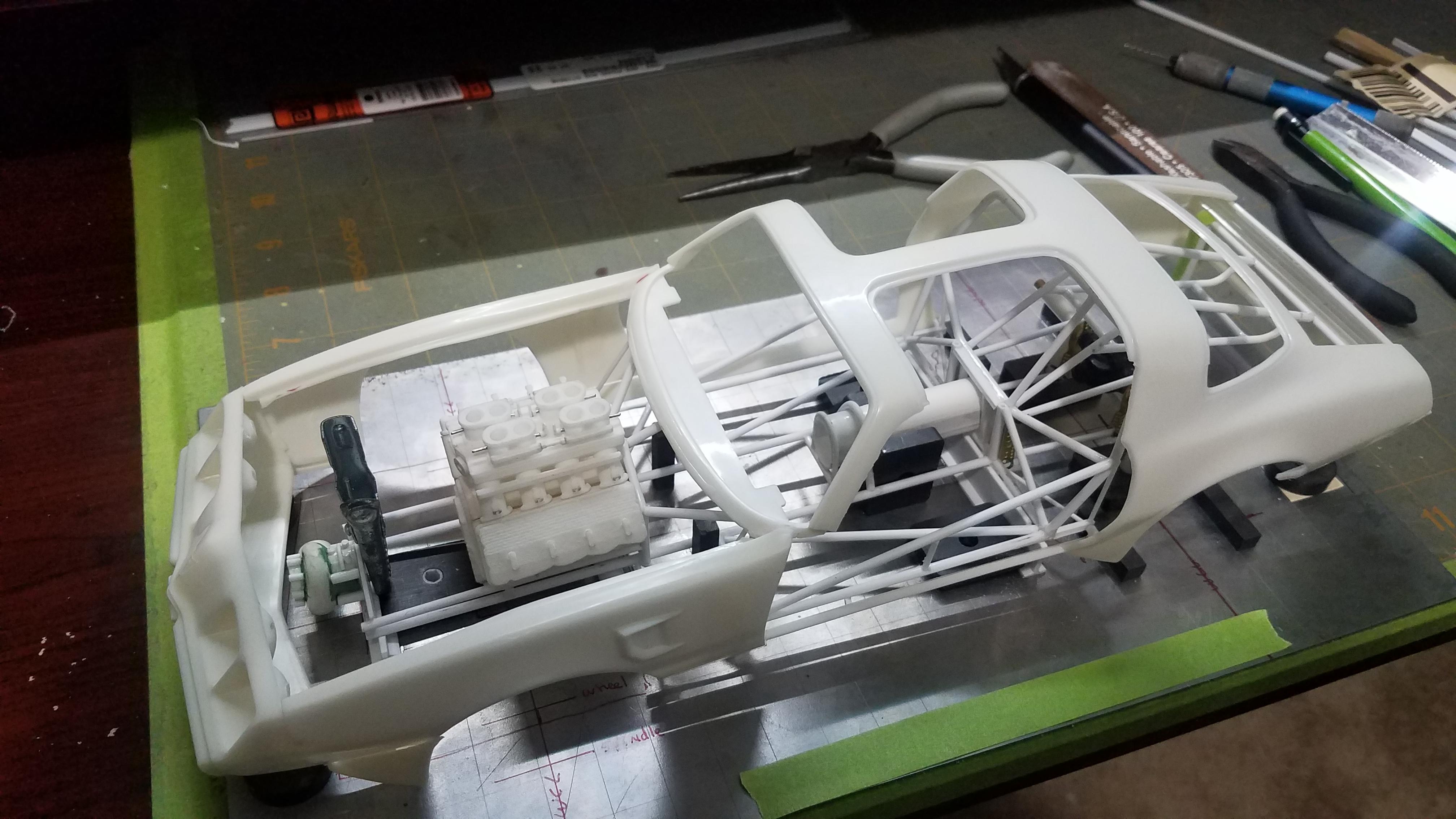

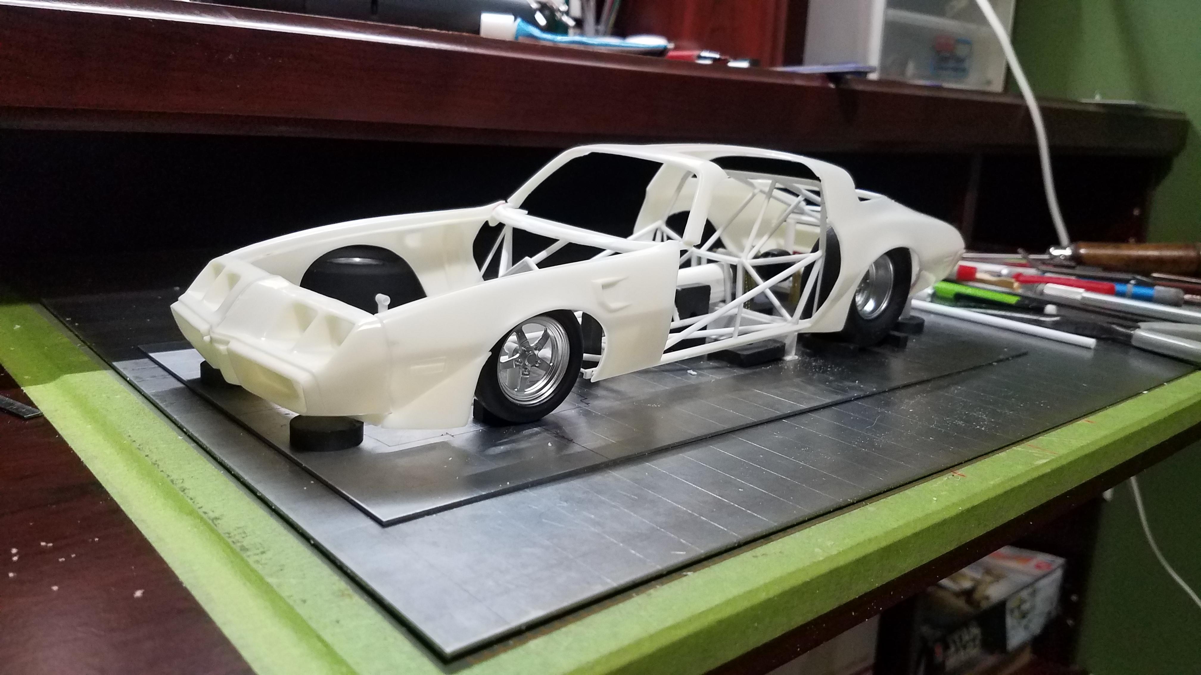

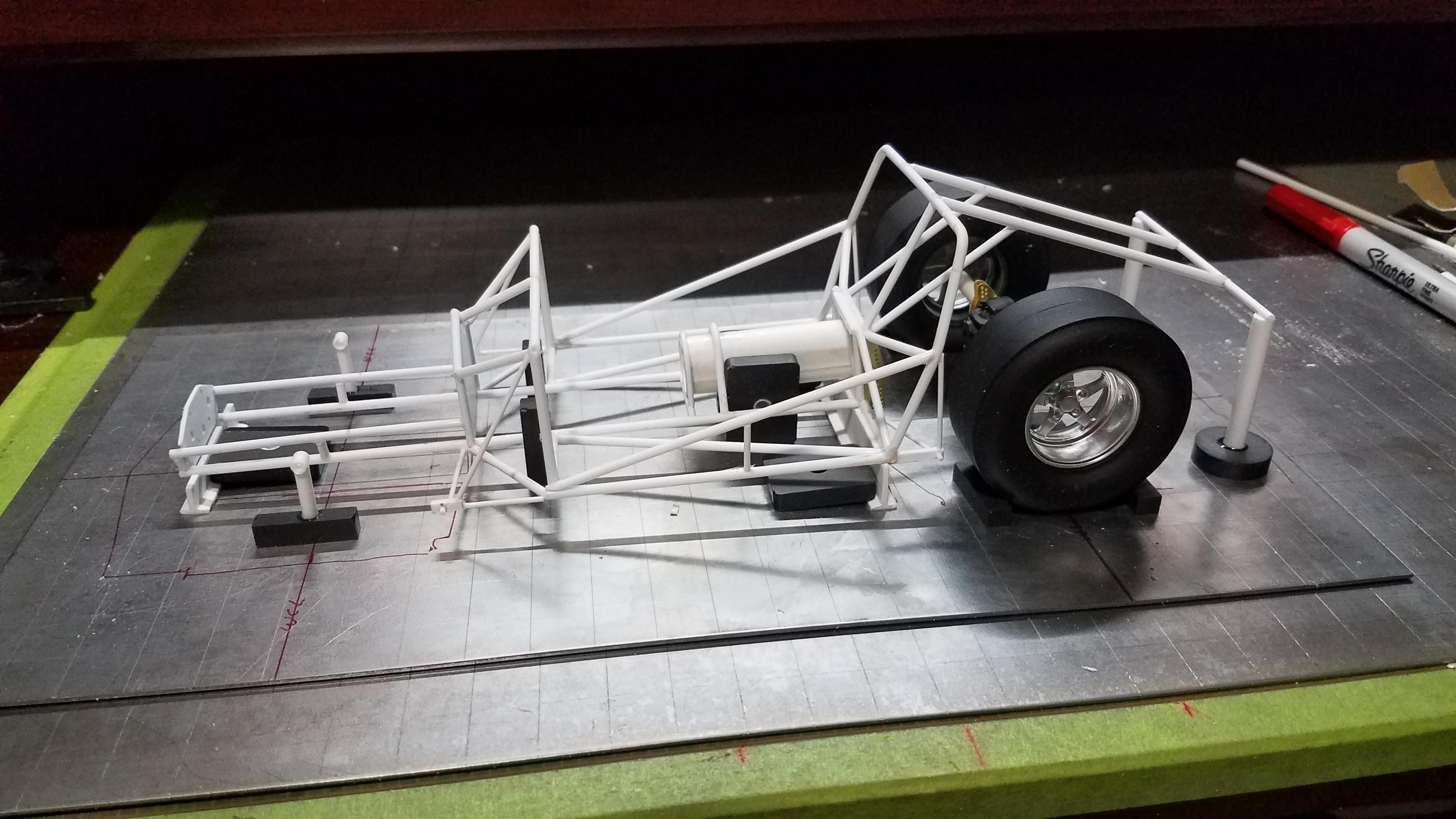

drummerdad Posted March 21, 2020 Posted March 21, 2020 Ive been working on this for a few weeks. I didnt want to post until I was sure I could overcome a few issues I have had in the past. I started a drag week mustang, and the body was old, and the cage just sucked on it. Im in the middle of a 1/12 scale drag VW, but I wanted to do a drag week style car. So, I started this. Hopefully Ill be able to crest the hump, and actually finish this model. Its a 1979 Pontiac Firebird from MPC. The engine is a sonny leanard mountain motor 1000 cid billet engine. The transmission is a 3 speed lenco auto, the rearend is a ford 9 inch from the mustang, and the centrifugal supercharger is scratch built to mimic a procharger F3. There are various other 3d printed parts, and some photo etching. Wheels are from 3d scale parts. I know the joints need a little work. Im going to use some fingernail filler my wife gave up on, after I get it together. Ill get a few more pictures, in a little bit. The front end has been separated now, and the body mounts have been added. I also had to spin the supercharger around. It works better with a driver side exit.

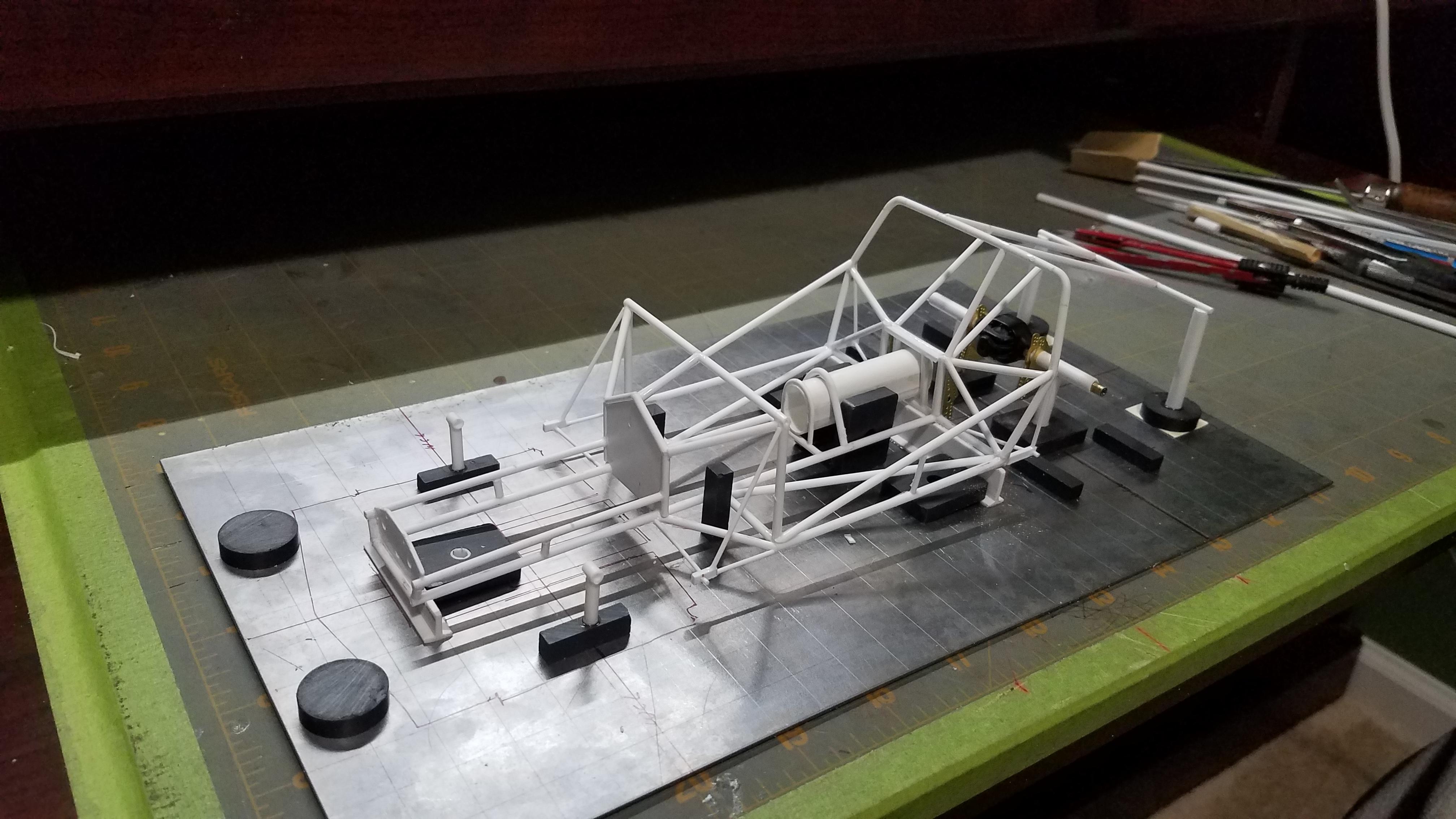

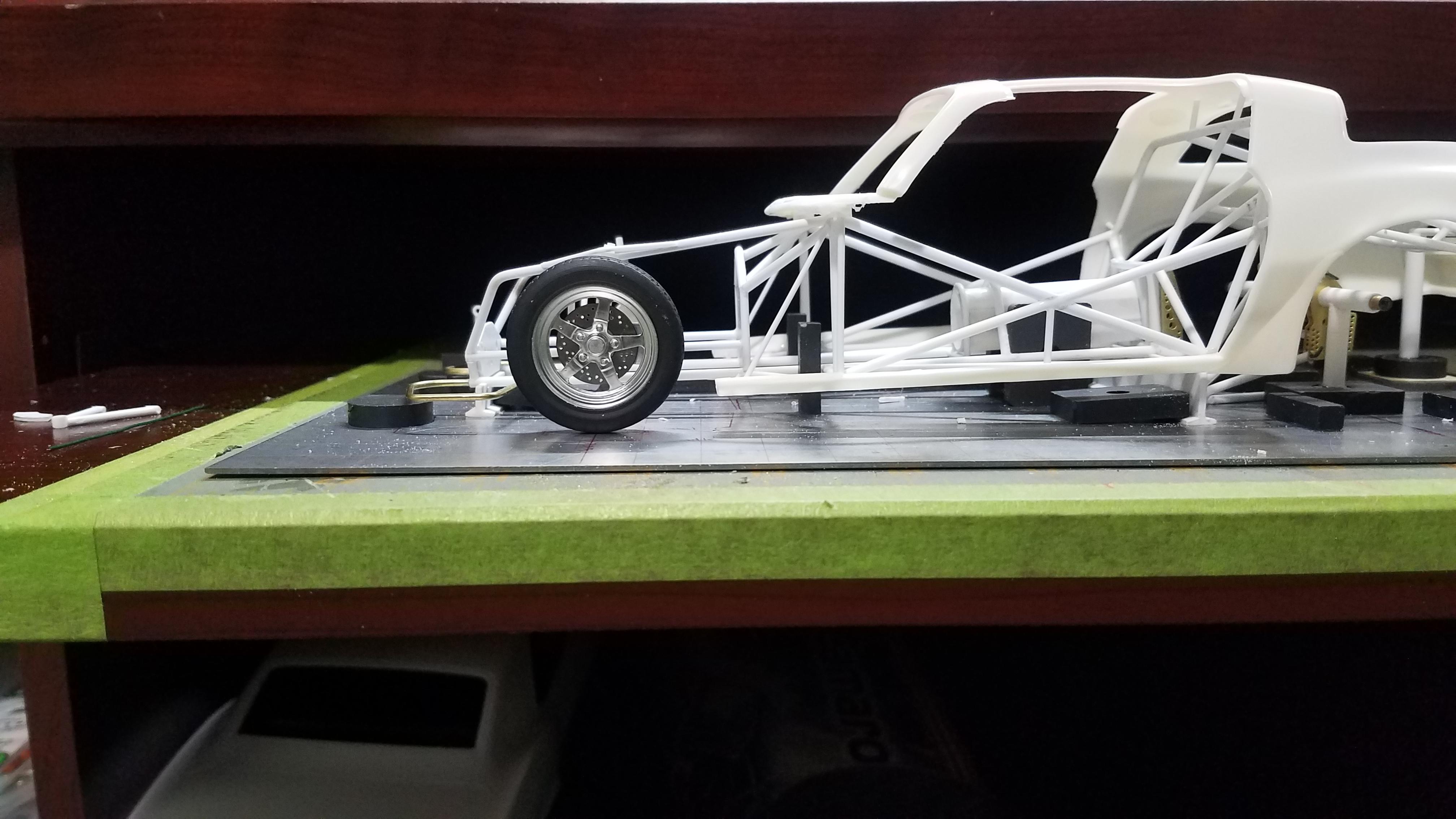

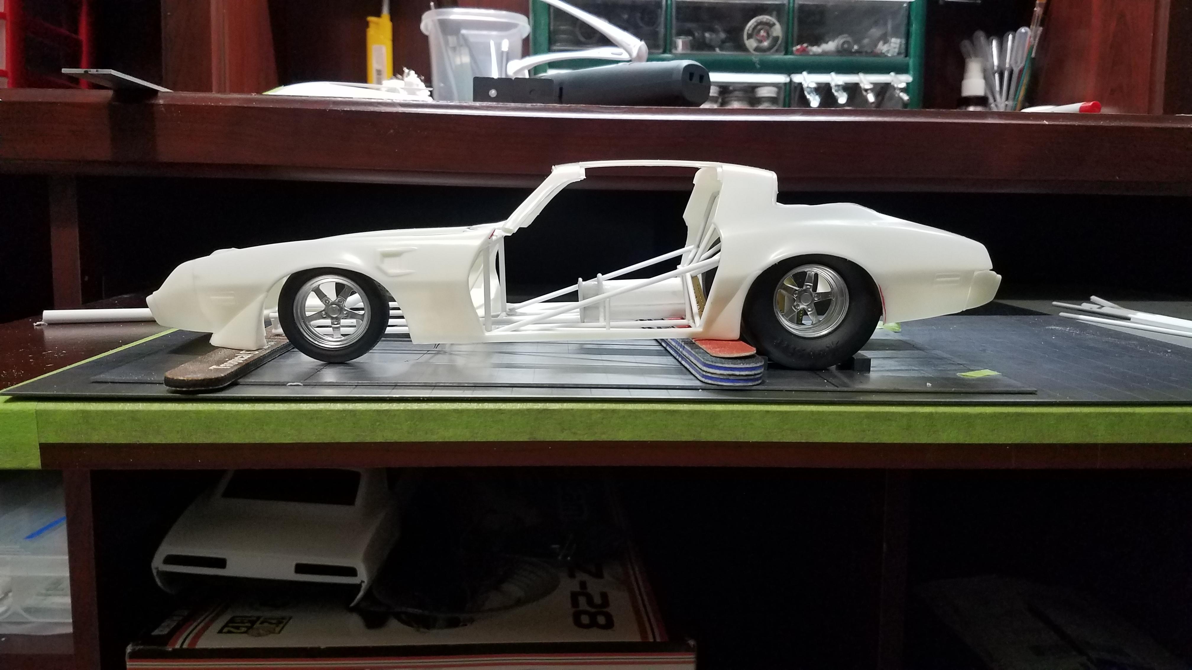

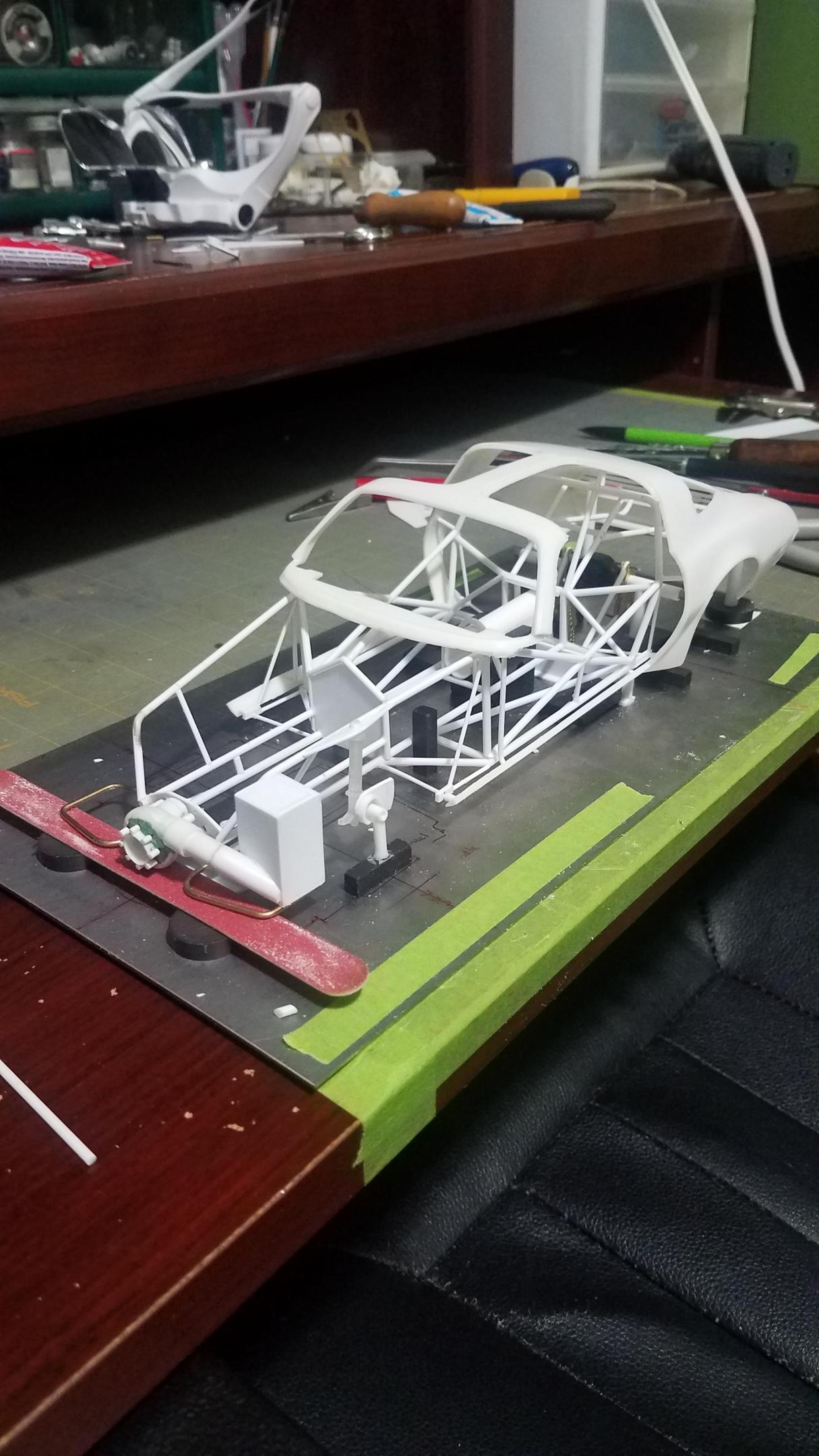

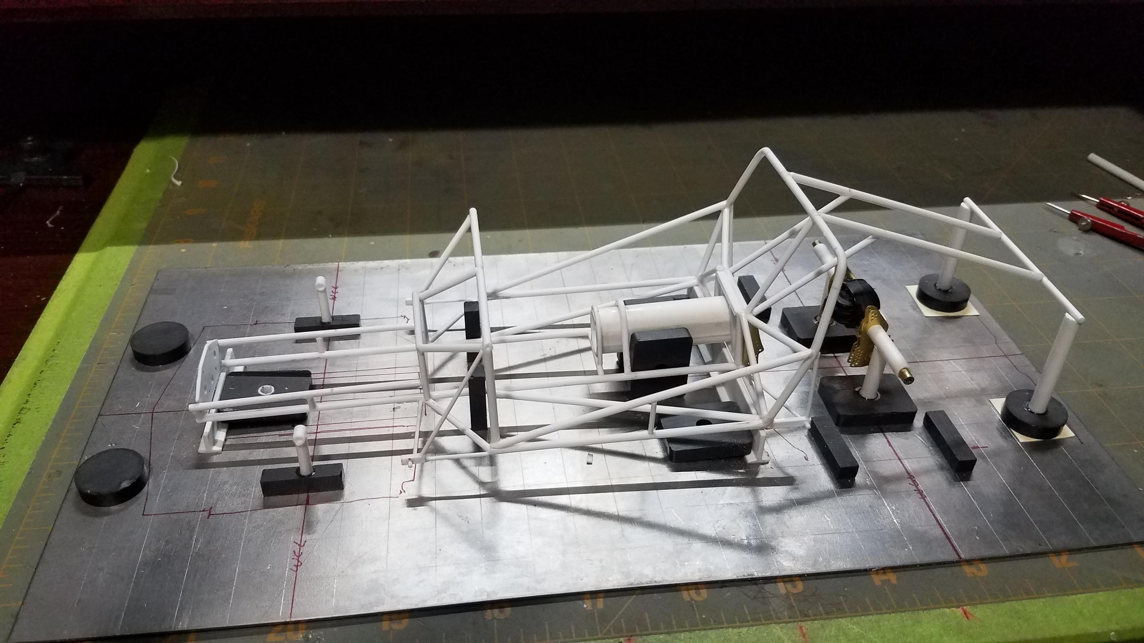

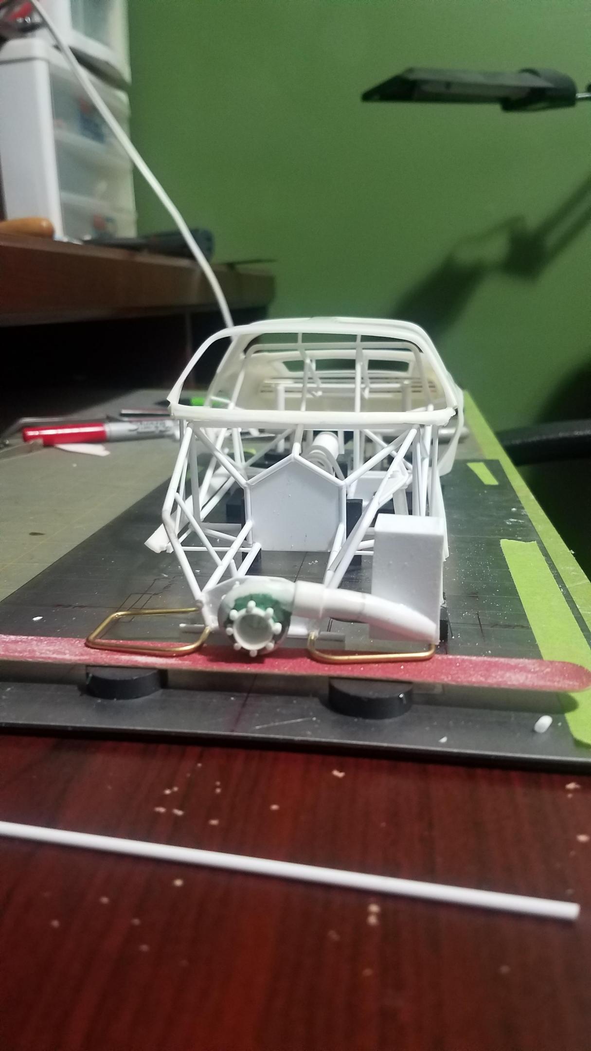

drummerdad Posted March 21, 2020 Author Posted March 21, 2020 (edited) Here are two more. This is recent. I have started the front suspension. I still have a lot of work left. The box will be the intercooler. The hot side goes in where you see, and then the discharge will be on the top and go straight to the intake. You can see the body is a little warped in the bottom picture. The cage is square, but the body is twisted because of the t-tops, just like in the real firebird with t-tops. I bet this one would leak water too. Edited March 21, 2020 by drummerdad more info.

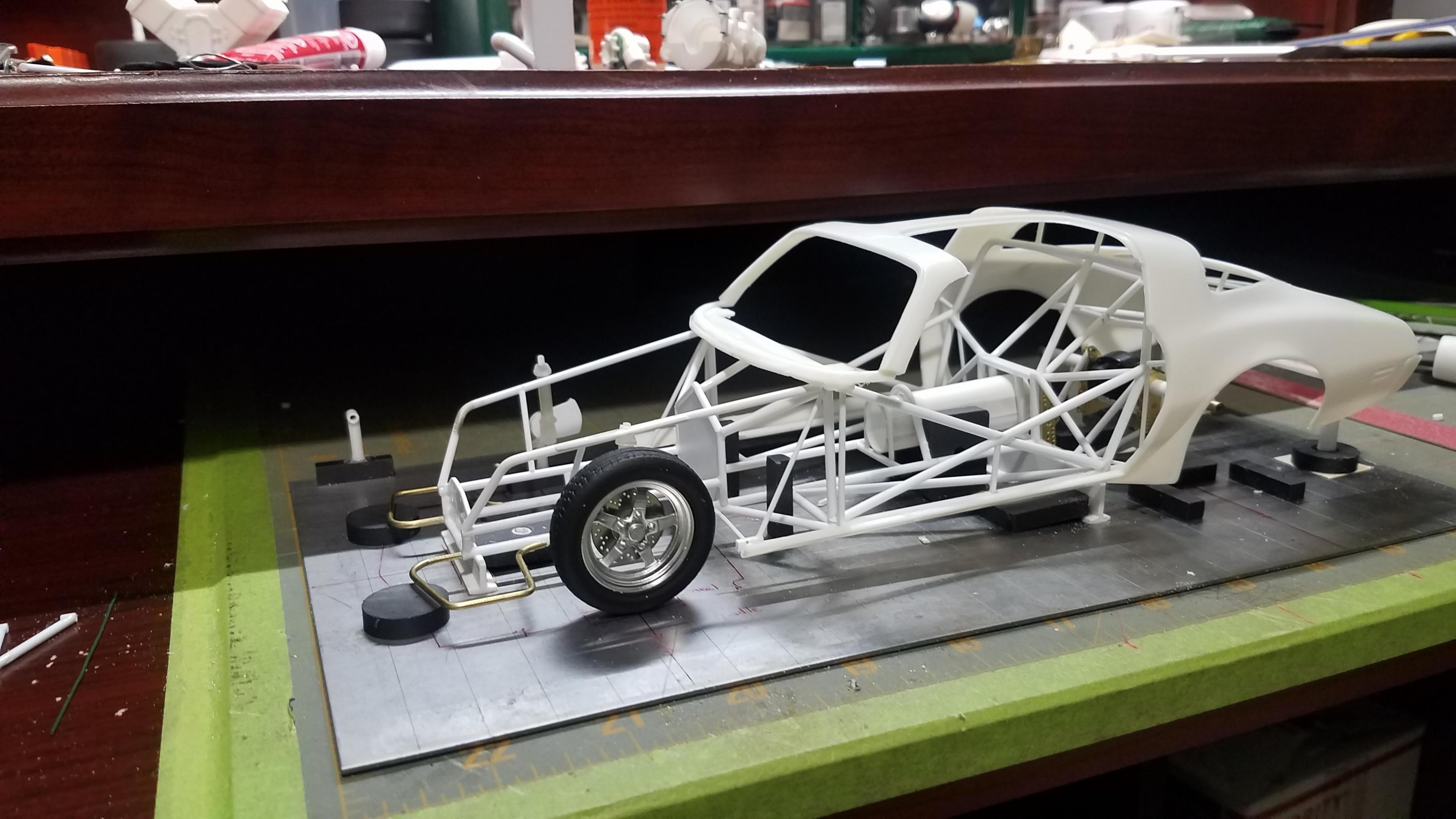

drummerdad Posted March 22, 2020 Author Posted March 22, 2020 On 3/21/2020 at 12:57 AM, afx said: Glad you started a thread on this build, look forward to seeing more of your work. Expand Thank you. I hope it doesnt disappoint. So I got a little done today. We are relocating our sound room at church, and I am doing the sound equipment and rewire, so I had to work on that for a few hours today. I managed to get the upper strut supports in place. The picture only shows the left side, but I got the other one in also. And I made an impeller for the procharger, although I didnt get a picture of it. You cant see the brake caliper in these pictures, because I havent made it yet. Im going to make a detailed front piece that you can see through the wheel, but I havent got to it yet.
