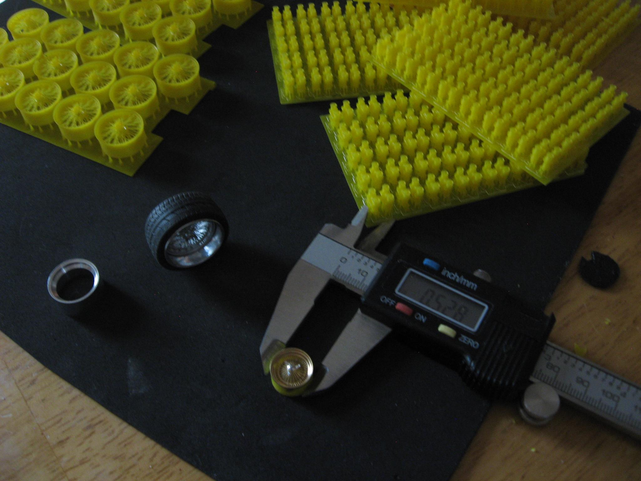

Hey Mike,
   We have been playing around with the larger wheel in some aftermarket wheel sets.  We did print up some 100 spoke Daytons in both 13" and 15" just to see if they would work. This kind of detail is where the 3D technology really excels....

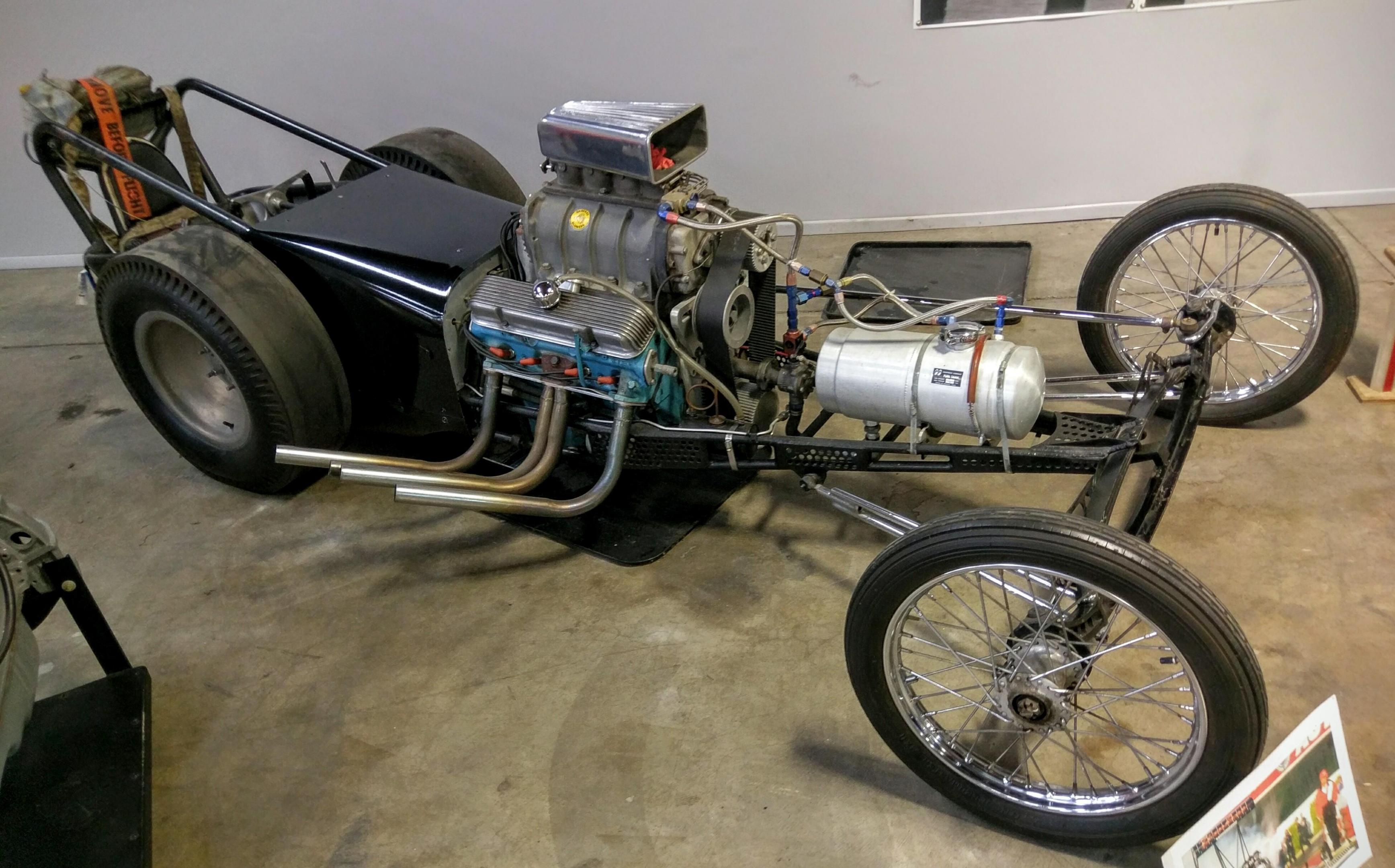

But please, PLEASE...make a good set of old-school dragster front wires.
I've tried everything on the market, even laced my own, and nothing comes close to what you can probably do.

There are currently practical limits to what can be done with 3D printing.  The long spokes are extremely difficult to print due to length and very much so due to the shallow angles of them relative to the axle axis. Hand lacing using a jig is not that difficult.  I can see where hubs and rims designed for hand lacing might be good. Randy is printing wheels that would be very difficult to hand lace, even with a jig. Ask me how I know, but please don't ask me.
OK. I'll accept that. Having seen your work up close, I know you know what you're talking about.
Pico Elgin has printed some vintage-car rims and hubs designed to be hand-laced, complete with printed in holes. They have ferrules or adjusting nuts, and look fantastic assembled...far better than anything using jigs and split rims, or the PE alternatives.
Nothing in old dragster-appropriate sizes though, and not commercially available anyway...as far as I know.
Possibly Randy could seriously consider rims and hubs. I'd buy a bunch.

WOW!!  3D printing is just amazing.  I have a set of Baronis from Modelhaus.  They are pretty nice too, but this is over the top detail.  What printer are you using?  I would like to have a printer but I have no idea about creating files and using it.
I just want to give a shout-out to Randy from Model Builders' Warehouse.
While I have no immediate need for his 3D printed wire wheels, they looked really good in the photos, and I really wanted to "fondle" them in-person.  So I ordered both sets.  The were shipped promptly, and well packed.  They look just as nice in-person.  However, upon close examination (wearing my Optivisor) I noticed couple of flaws (printing errors). I emailed photos of the problem to Randy and he immediately replied with an apology and promptly sent me replacement wheels.  They arrived just as fast as the first set, and were flawless!
While is preferred not to have to deal with problems, Model Builders' Warehouse has excellent customer service!  Thanks Randy!
And since now I have some spare wheels, I was not afraid to test the strength of those thin spokes.  They are very strong, just like the real spoked wheels.  No I didn't push hard enough to break them, but as hard as I pressed against them gave me confidence that they will safely support a model car.
