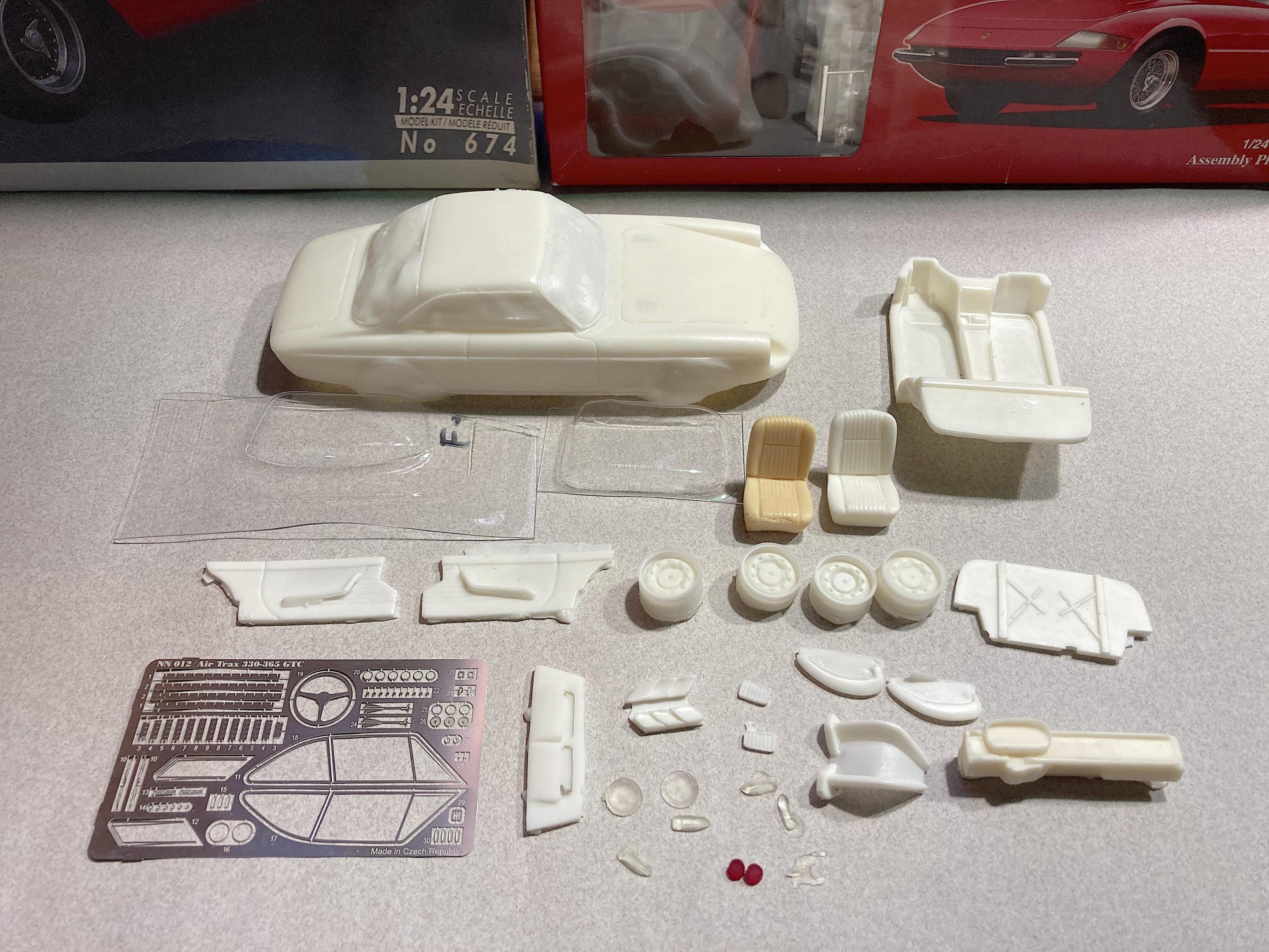

Back to your topic, I ordered one of these this week!  I have an Italeri 250 SWB that is missing the chrome tree and horrible tires, and the interior "tub" over the rear wheels, so it could work as the donor chassis.  I really need you to make all the mistakes of conversion, so I won't.  ?
This transkit will allow me to go banshee on several projects.  Now with the left-over SWB body, I can cut the roof and put on the Testarossa to do what master model builder David Cummins had drawn.  Then I could do a 250 SWS (Spyder) resto-rod.  Anyway, sorry to hijack your topic.

My Air Trax kit is in transit at the moment.
Alex, all I can say is WOW! ?
VERY ambitious project you've taken on and I'll have to echo some of your sentiments about the quality of the kit. It wasn't this one I have, but another one I got a while back that was let's say..........less than stellar.
Keep up the great work! I'm sure it'll be a sure fire knockout when done and it's yet another Ferrari model that's been very overlooked over the years.
