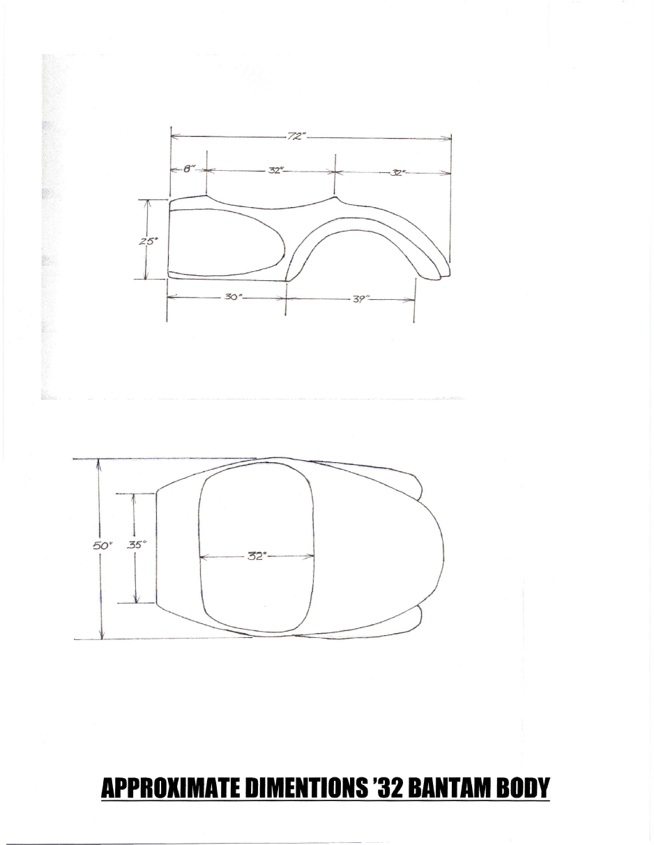

STYRENE-SURFER Posted June 14, 2020 Posted June 14, 2020 (edited) This side shot may be of help, looks like an unmolested steel body on this. This could easily be sized and printed out for a starting point. Did the roadster body share any dimensions? All I could find as far as overall width and cowl hight and width were approximations on this image. Edited June 14, 2020 by STYRENE-SURFER

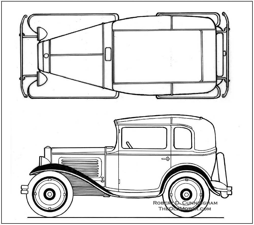

afx Posted June 14, 2020 Posted June 14, 2020 There is a nice drawing at this link to work from. It won't let me posts it however. http://theoldmotor.com/?p=81752

Ace-Garageguy Posted June 15, 2020 Posted June 15, 2020 OK...based on the drawings afx posted above, and a known nominal wheelbase of 75 inches, the current Slingster body measures out to be very close, plenty close enough for a dragster body, to 1/25 scale. The method of determining this: The wheelbase on my screen displays at 4.794". Dividing 75" by 4.794", we get 15.64. That means the drawing displays 1/15.64 scale on my screen. Measuring the firewall height at the beltline, the length of the body at the beltline from the firewall to the rear extremity, and the width of the cowl, multiplying all those respective numbers by 15.64, we get the full scale dimensions. Close enough, anyway. Then, taking those numbers and dividing by 25, we get the real dimensions of the body as rendered in 1/25 scale. Then we measure the kit body and compare. Very close, again, plenty close enough for what the kit body represents. -------------------------------------------------------------------------------------------------------------------------- I haven't unearthed the earlier kit body yet, but I can tell with certainty from looking at the OP's opening shot that it's significantly over 1/24 scale.

Brian Austin Posted June 16, 2020 Posted June 16, 2020 Perhaps this drawing from Special Interest Autos might be of some additional help.
