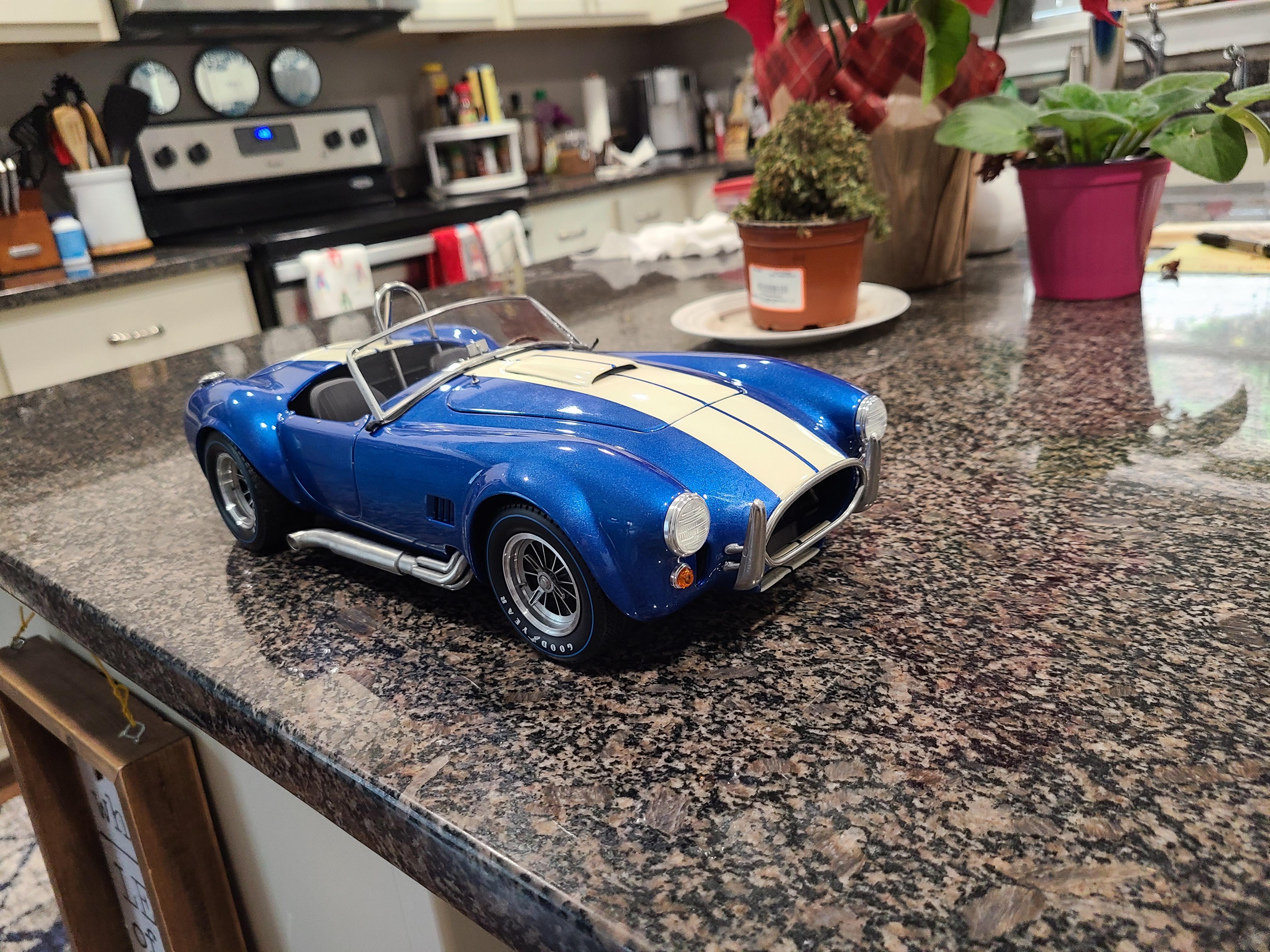

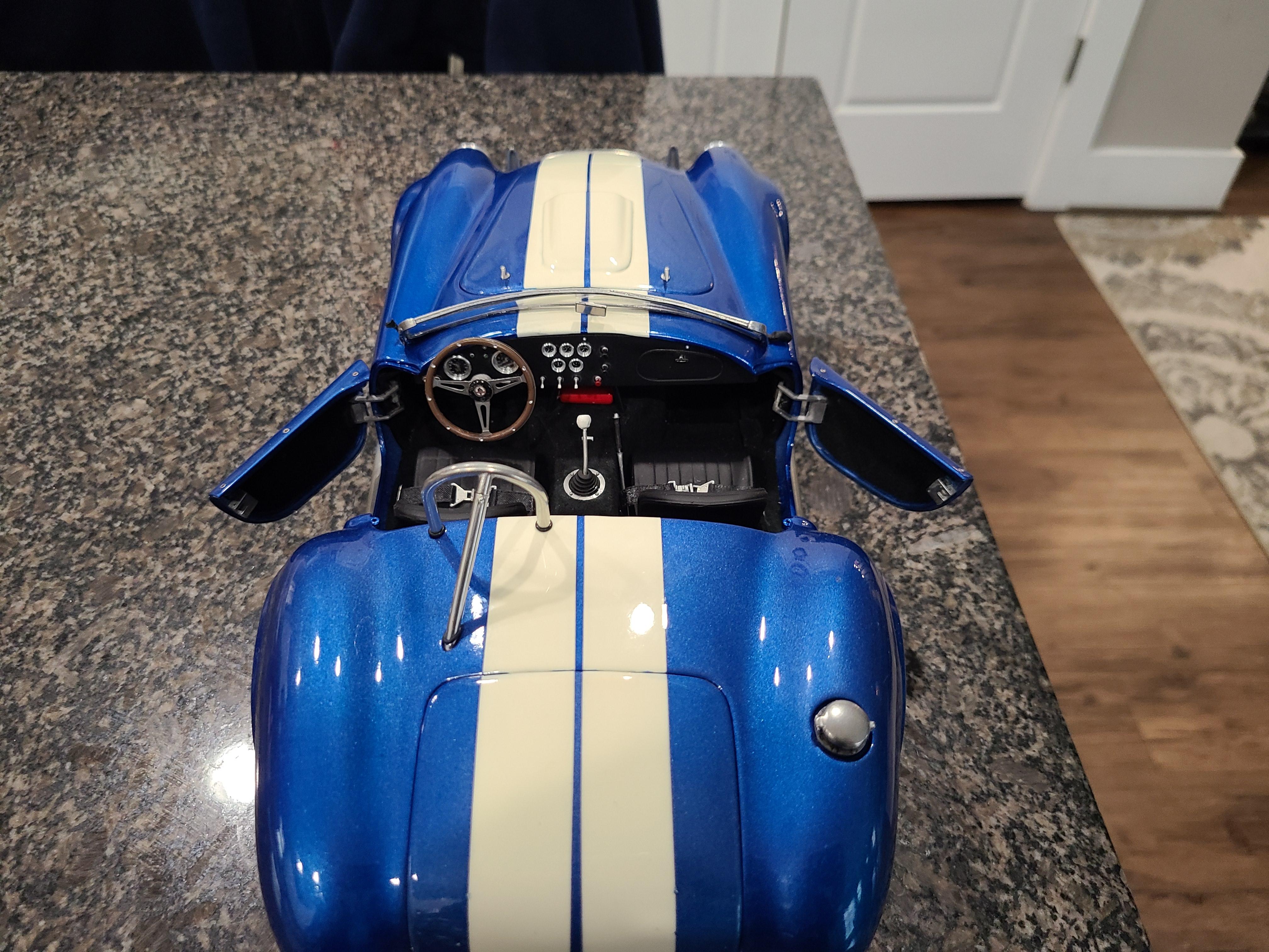

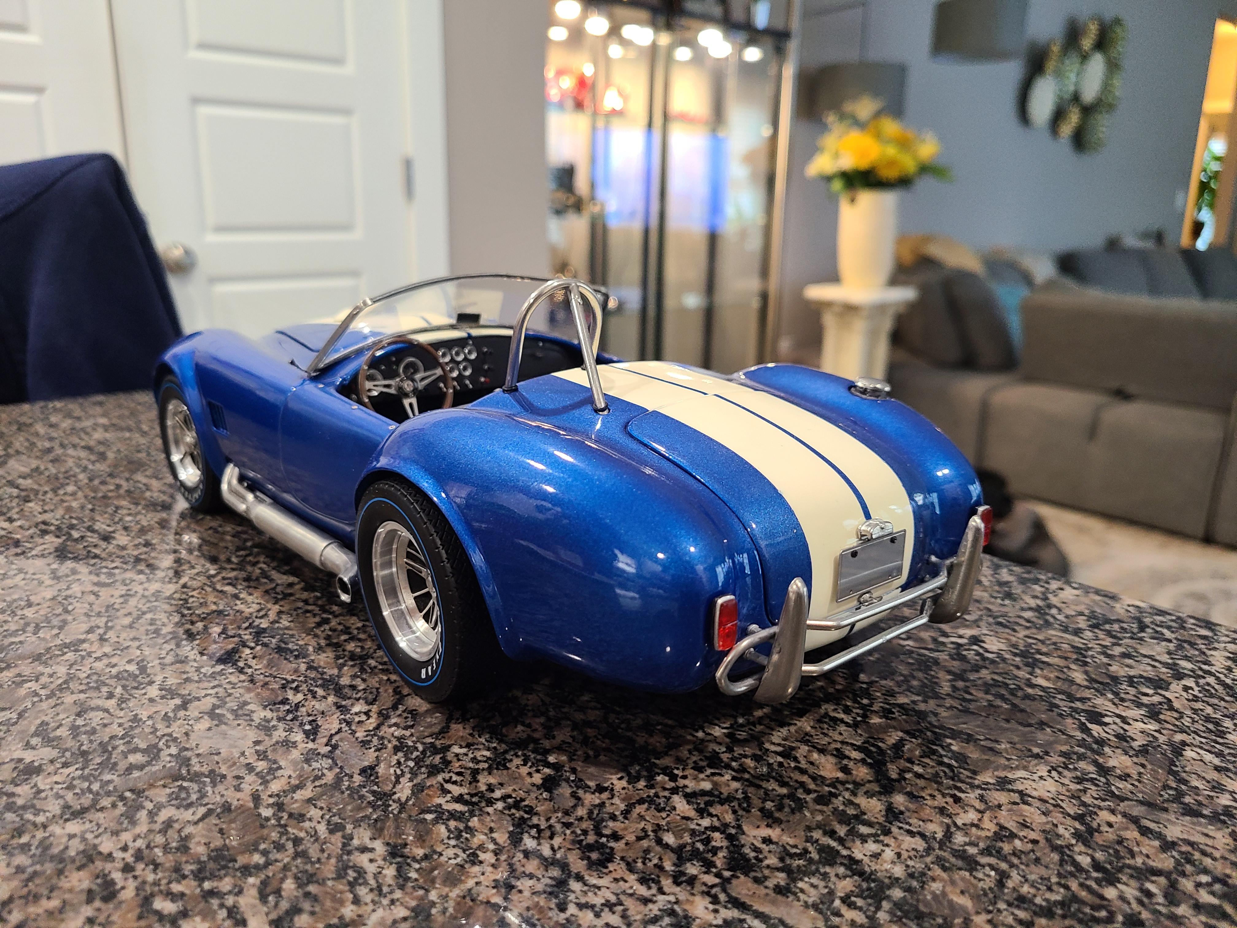

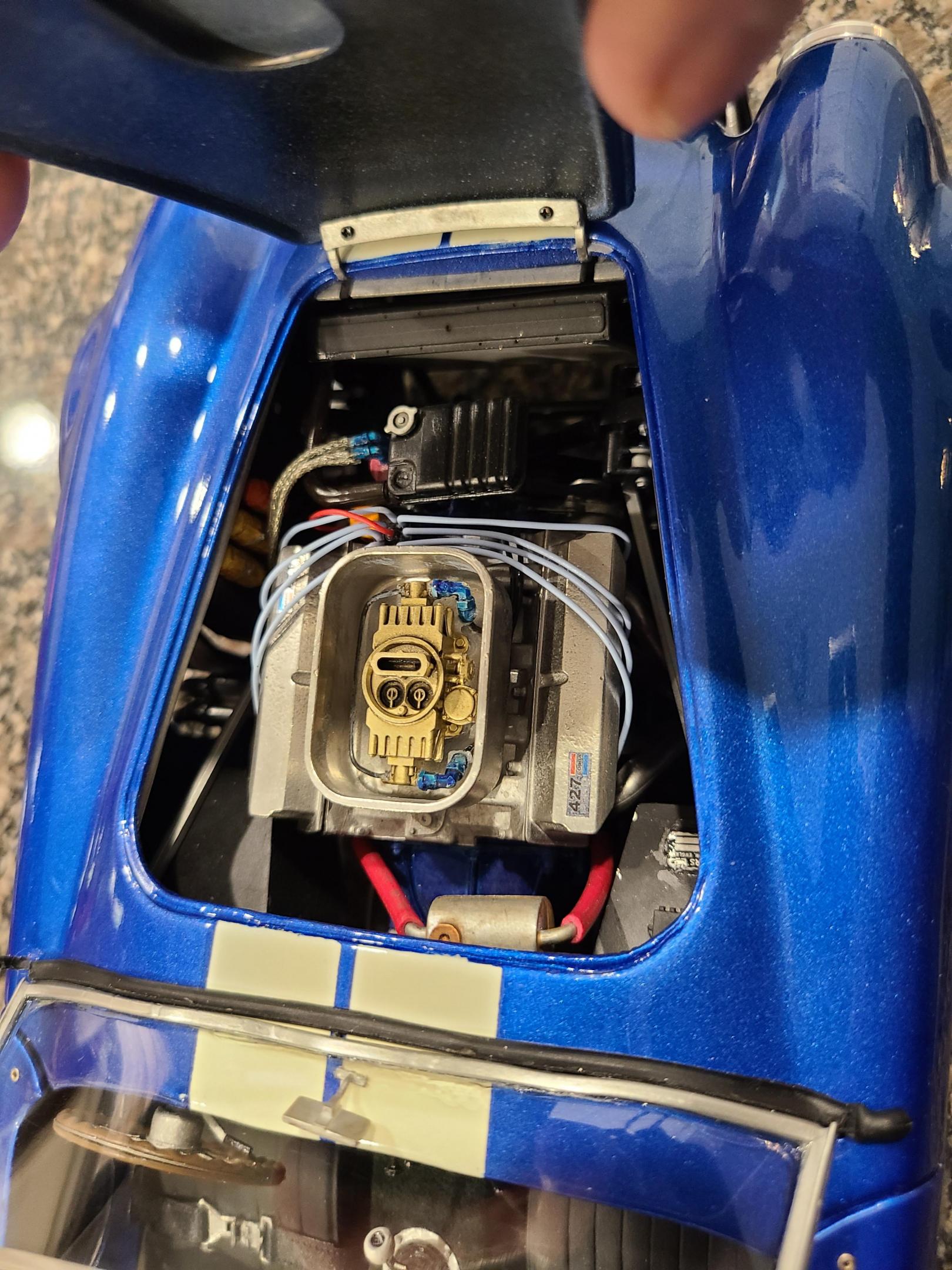

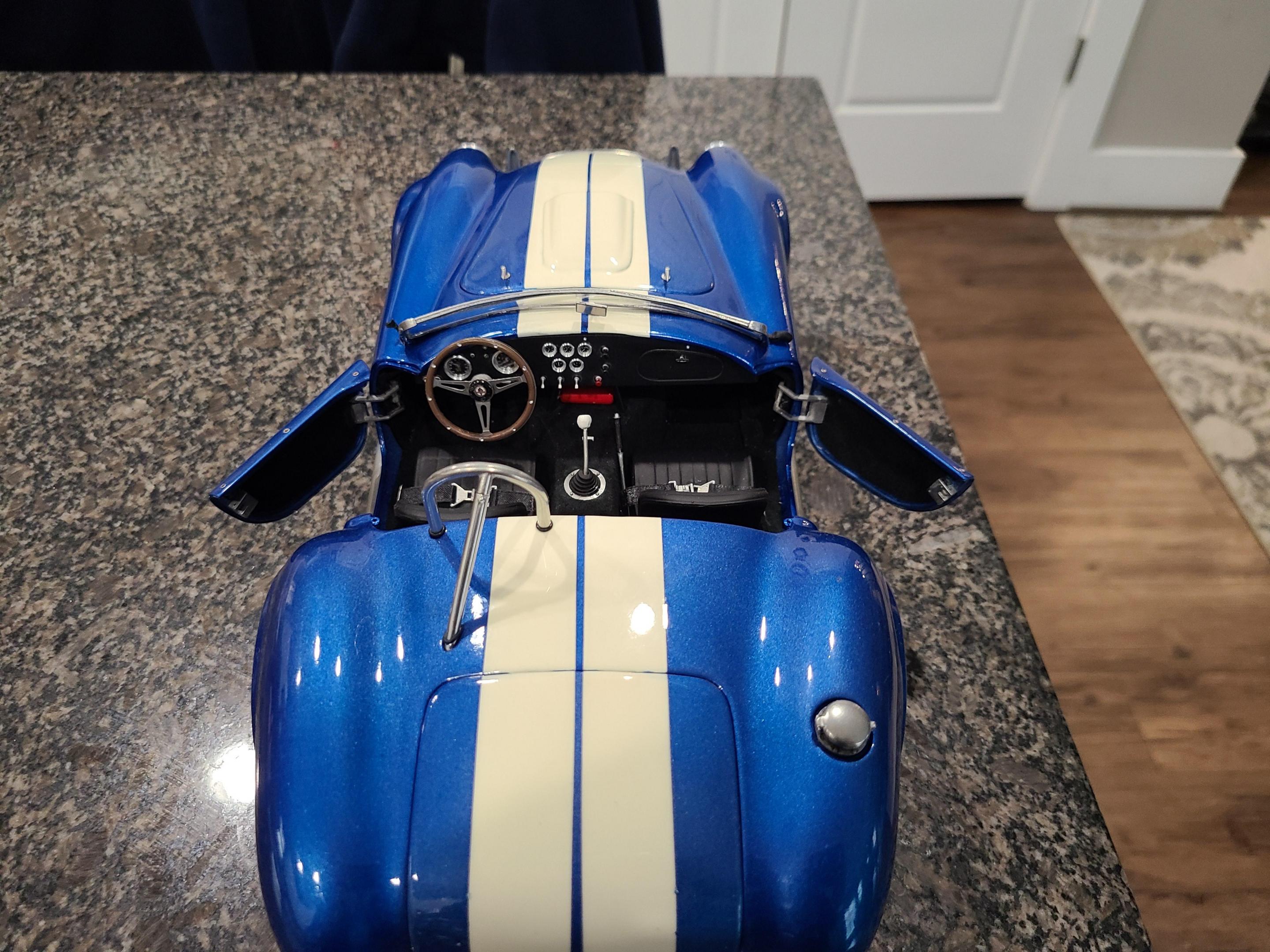

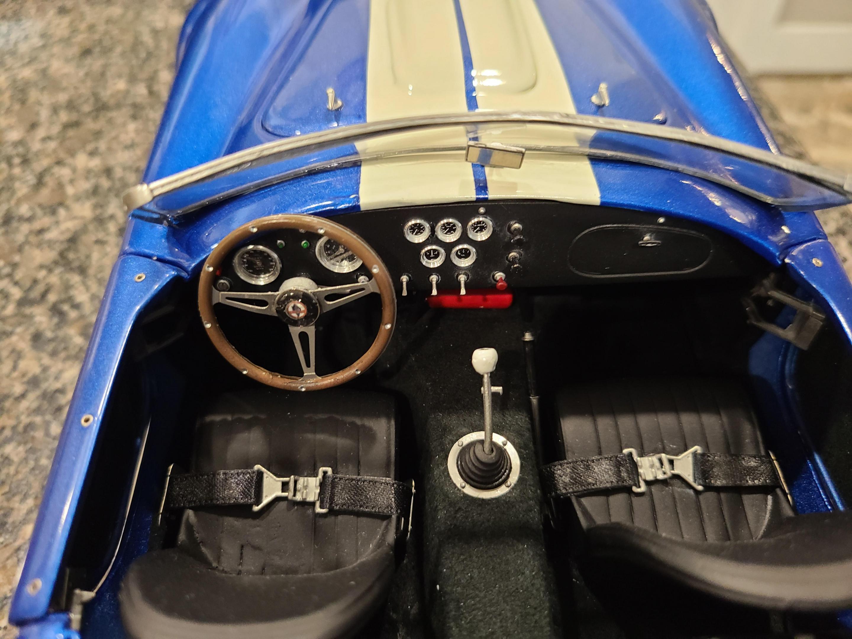

nazdrave Posted January 20, 2021 Posted January 20, 2021 It's been quite a while since this thread has seen any activity. While Bruce was called away to other projects, I soldiered on and finished my build of the same kit. As I've mentioned elsewhere, my skill level is not even in the same galaxy as Bruce's, but I am proud of how my windshield turned out and I wanted to share the experience with the Forum so others will know. In the pictures you will see the finished product (except, I will come back to the side wings and visors). As most know, MFH kits are very detailed and very high quality. As such, I was shocked at how crappy the included windshield was and how flimsy the windshield frame is. The WS is a vacuum formed piece that's not even cut out and was flimsy junk. It was ruined on my first attempt at securing it to the frame. Here's what I ended up doing. I found a clear bottle of cleaner. I made a template from the WS frame and made a rough cut of this bottle. I then found a coffee can with approximately the right curvature and taped the plastic onto the can. I then VERY CAREFULLY used a heat gun on the opposite side (inside the can) to gently remold the plastic (it took three tries because I kept melting the plastic!). I then did some real careful trimming of the plastic on the WS frame - this took forever. I then carefully used super thin super glue on the top and bottom middle to secure the plastic to the frame and when use clear plastic parts glue to secure (and fill in) the corners. OK, here's the rub - the glue made several messes on the plastic because the frame is so flimsy and thin, it couldn't be helped. So, then... I VERY GENTLY used 1500 grit sanding sponges followed by successively finer sand papers and sanded to the entire plastic surface knowing I was going to try using Future (actually Pledge now) for the first time. I was nervous as the plastic was quite cloudy after all the sanding. Well... the Pledge worked!!! And amazingly well in my opinion! I was shocked because I had never used it before. It beautifully filled in all the sand marks and low spots. I dipped and let dry twice and I am amazed at the results. So there you go; if you ever need glass repair, just carefully sand and dip in Pledge and it works like a charm.
Brudda Posted January 20, 2021 Author Posted January 20, 2021 14 hours ago, nazdrave said: It's been quite a while since this thread has seen any activity. While Bruce was called away to other projects, I soldiered on and finished my build of the same kit. As I've mentioned elsewhere, my skill level is not even in the same galaxy as Bruce's, but I am proud of how my windshield turned out and I wanted to share the experience with the Forum so others will know. In the pictures you will see the finished product (except, I will come back to the side wings and visors). As most know, MFH kits are very detailed and very high quality. As such, I was shocked at how crappy the included windshield was and how flimsy the windshield frame is. The WS is a vacuum formed piece that's not even cut out and was flimsy junk. It was ruined on my first attempt at securing it to the frame. Here's what I ended up doing. I found a clear bottle of cleaner. I made a template from the WS frame and made a rough cut of this bottle. I then found a coffee can with approximately the right curvature and taped the plastic onto the can. I then VERY CAREFULLY used a heat gun on the opposite side (inside the can) to gently remold the plastic (it took three tries because I kept melting the plastic!). I then did some real careful trimming of the plastic on the WS frame - this took forever. I then carefully used super thin super glue on the top and bottom middle to secure the plastic to the frame and when use clear plastic parts glue to secure (and fill in) the corners. OK, here's the rub - the glue made several messes on the plastic because the frame is so flimsy and thin, it couldn't be helped. So, then... I VERY GENTLY used 1500 grit sanding sponges followed by successively finer sand papers and sanded to the entire plastic surface knowing I was going to try using Future (actually Pledge now) for the first time. I was nervous as the plastic was quite cloudy after all the sanding. Well... the Pledge worked!!! And amazingly well in my opinion! I was shocked because I had never used it before. It beautifully filled in all the sand marks and low spots. I dipped and let dry twice and I am amazed at the results. So there you go; if you ever need glass repair, just carefully sand and dip in Pledge and it works like a charm. WOW !!! Looks fantastic!!!! What kind of body fitting issues to the chassis were there? Nazdrave your cobra is beautiful!!! To even get a mfh kit finished is a monumental feat! Yes the windshield is really bad. I think mfh could have come up with something better. Great job and please show more pics. I’m going to be getting back to the cobra in a little bit. The paint job on the Toyota is done, the Red Bull car is done and the super snake is just about finished. So all there is , is the ford GT and Ferrari. This cobra just gets my blood going as I wanted a real one all my life. I remember in the 80’s the 427 was $80,000. I said “way to much” When I was in high school there was a used one at a corvette dealer named Bob Shiros , that had a 427 for a outrageous price of $7000! Still the same, cannot afford it. Maybe that lottery ticket will hit ........ HA
nazdrave Posted January 20, 2021 Posted January 20, 2021 3 hours ago, Brudda said: WOW !!! Looks fantastic!!!! What kind of body fitting issues to the chassis were there? Nazdrave your cobra is beautiful!!! To even get a mfh kit finished is a monumental feat! Yes the windshield is really bad. I think mfh could have come up with something better. Great job and please show more pics. I’m going to be getting back to the cobra in a little bit. The paint job on the Toyota is done, the Red Bull car is done and the super snake is just about finished. So all there is , is the ford GT and Ferrari. This cobra just gets my blood going as I wanted a real one all my life. I remember in the 80’s the 427 was $80,000. I said “way to much” When I was in high school there was a used one at a corvette dealer named Bob Shiros , that had a 427 for a outrageous price of $7000! Still the same, cannot afford it. Maybe that lottery ticket will hit ........ HA Thanks, Bruce! The body fitment was actually pretty good with one exception; I just couldn't get the sidepipe mounting bracket to line up properly with the chassis rail and it wasn't even close. Other than that, it went on pretty easily. I'd like to try a De Agostini kit one of these days. Right now, I've started on a Tamiya/EBBRO 1/12 1968 MS11 Matra F1 car and I have another MFH 1/20 Lotus 72C waiting in the wings. I will post more pics of this Cobra build in another post, but here I thought I would share some pictures of the Factory Five Cobra kit car I built a while back. I did everything on the car except the paint which a friend of mine did.
nazdrave Posted January 20, 2021 Posted January 20, 2021 Here are more pictures of this Cobra build. The white stripes are not as "yellow" in person but more of an ivory like Wimbledon White from the old days.

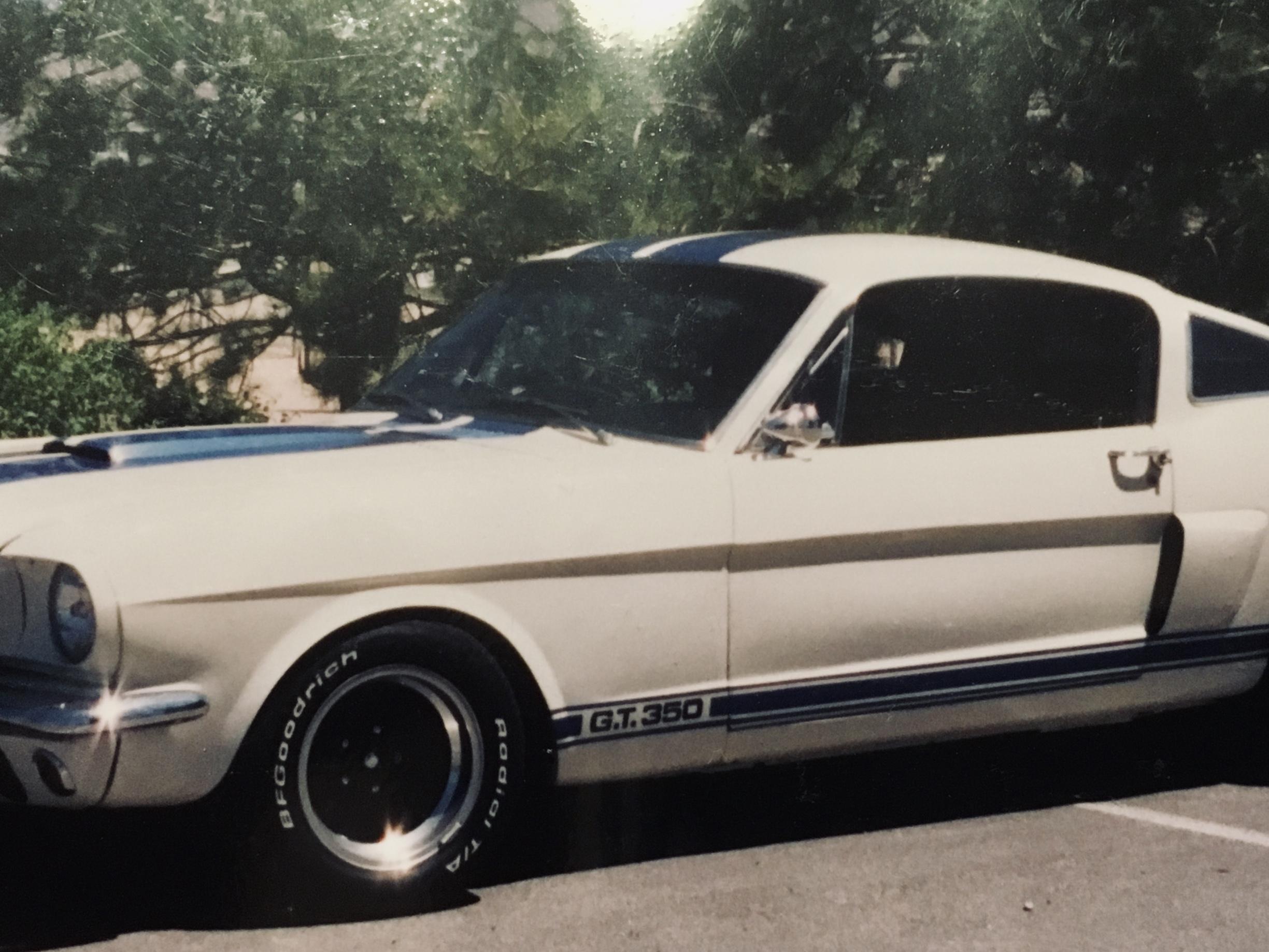

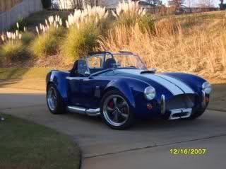

Brudda Posted January 21, 2021 Author Posted January 21, 2021 8 hours ago, nazdrave said: Thanks, Bruce! The body fitment was actually pretty good with one exception; I just couldn't get the sidepipe mounting bracket to line up properly with the chassis rail and it wasn't even close. Other than that, it went on pretty easily. I'd like to try a De Agostini kit one of these days. Right now, I've started on a Tamiya/EBBRO 1/12 1968 MS11 Matra F1 car and I have another MFH 1/20 Lotus 72C waiting in the wings. I will post more pics of this Cobra build in another post, but here I thought I would share some pictures of the Factory Five Cobra kit car I built a while back. I did everything on the car except the paint which a friend of mine did. Hello Nazdrave. Here is a pic of a Shelby I had. Sold it 5 years ago to a bay area dentist. I took the car to the Bay Area and my left leg was wore out. 650lb clutch will do that. Had the car over 40 years. Bought it for $800. And sold it for a lot more than that.
nazdrave Posted January 21, 2021 Posted January 21, 2021 Gorgeous Shelby, Bruce! I love the Wimbledon White with blue stripes. Is that the stock 306 hp 289? By the way, my name is Mark.

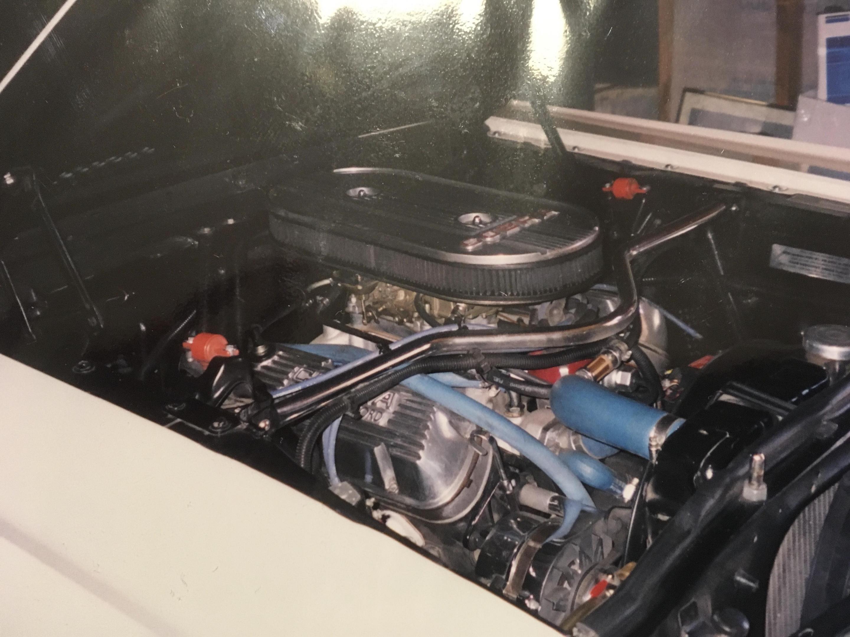

Brudda Posted January 22, 2021 Author Posted January 22, 2021 11 hours ago, nazdrave said: Gorgeous Shelby, Bruce! I love the Wimbledon White with blue stripes. Is that the stock 306 hp 289? By the way, my name is Mark. Hello Nazdrave, I put the original 289 in my garage and the engine in the picture is a 351 Windsor bored and stroked to 418 cubic inches. My friend , Larry Paulsen built the engine. Has dodge rods, Chevy 202 valves.And all different kinds of machine work. Dyno is 450 ft lbs at 420 hp. I went to laguna seca with that car and kept up with 427 cobras . ( I vintage raced this car)Could not pass them but kept right with them. That’s when they looked at the engine and I was not permitted to run. But it sure was fun for the first part of the day.

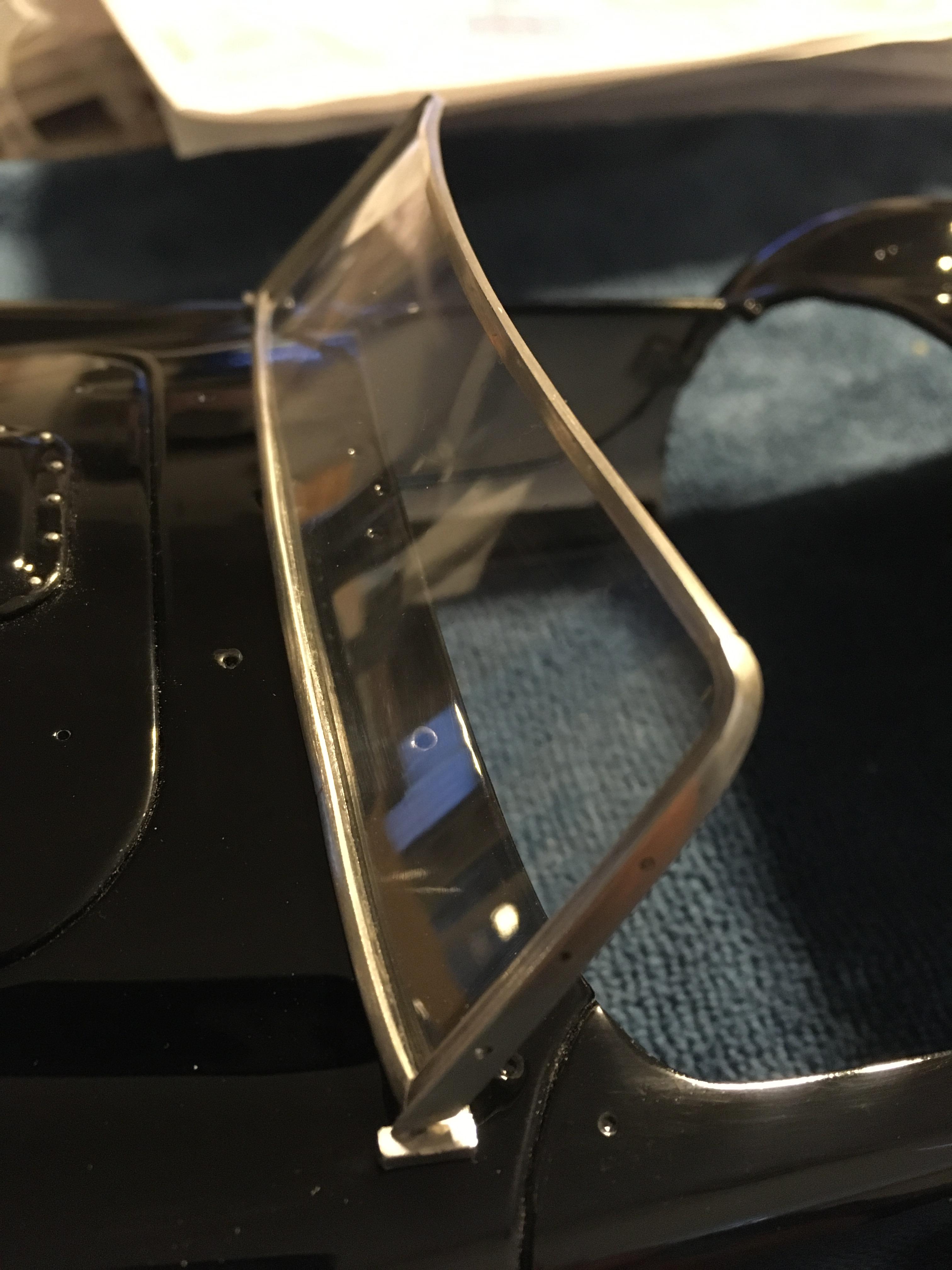

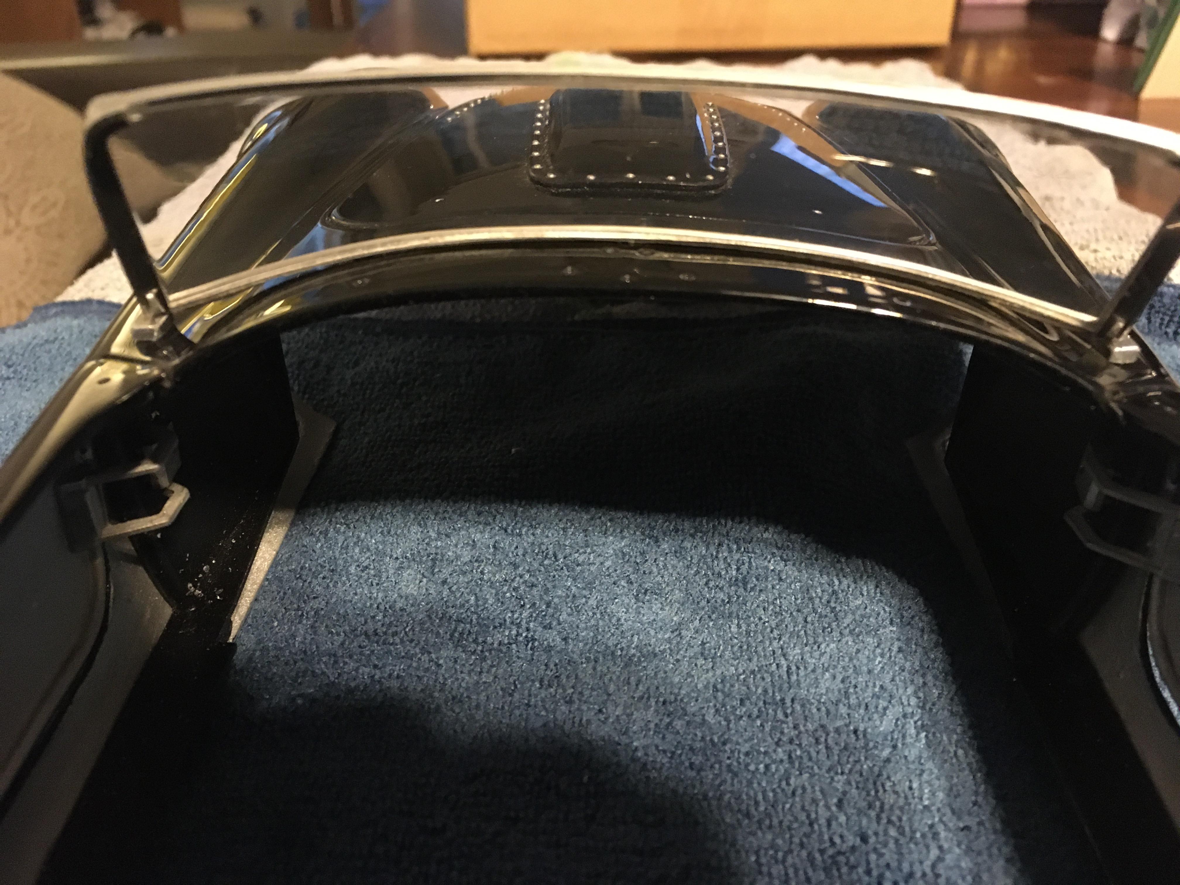

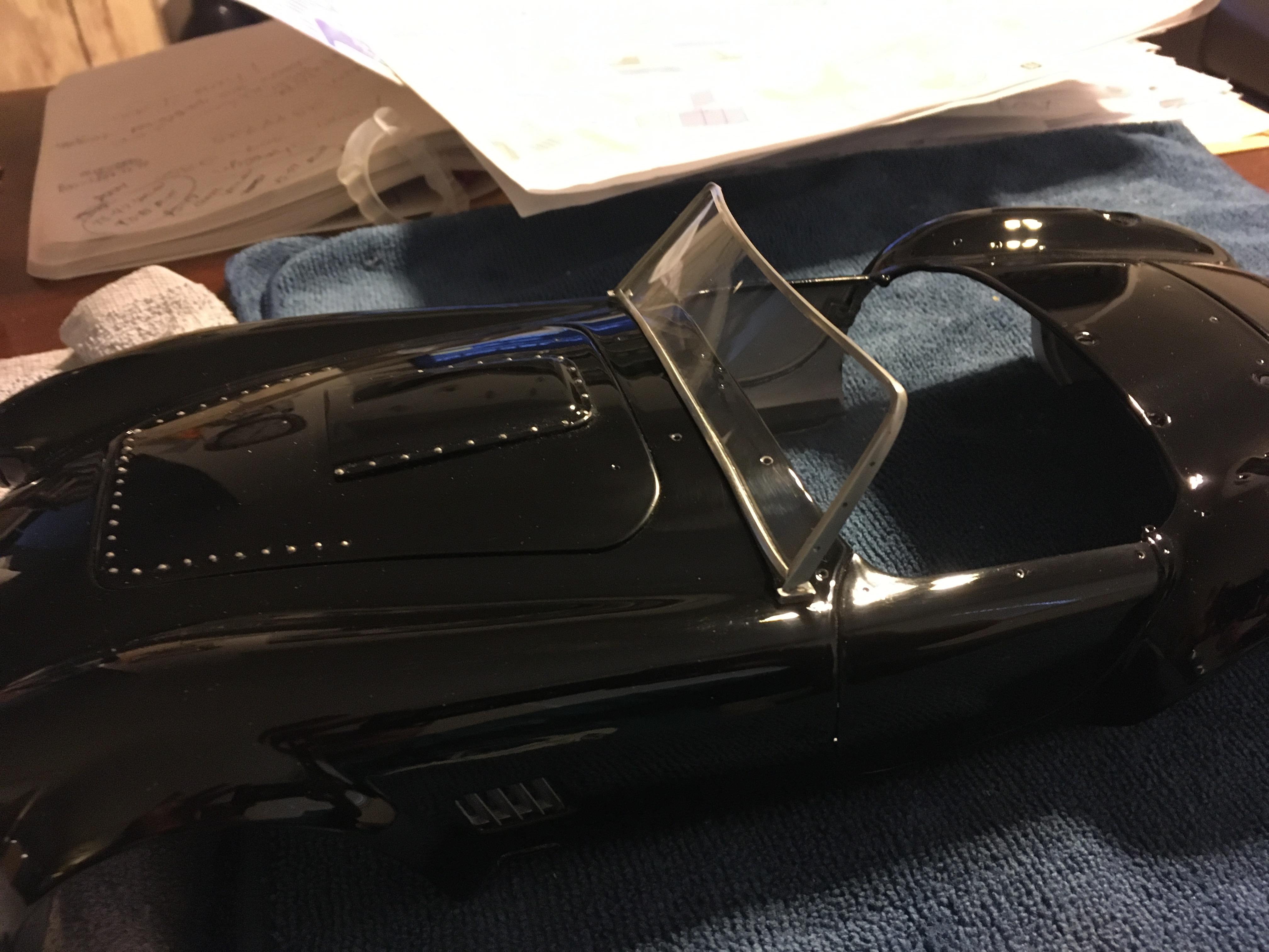

Brudda Posted February 21, 2021 Author Posted February 21, 2021 Hello, getting a break from the big kits. Wanted to get back to this project. Worked on the windshield of the cobra. It’s the hardest part of the build for me. So thin and fragile. It’s looking good . On to the next stage. Rear trunk area

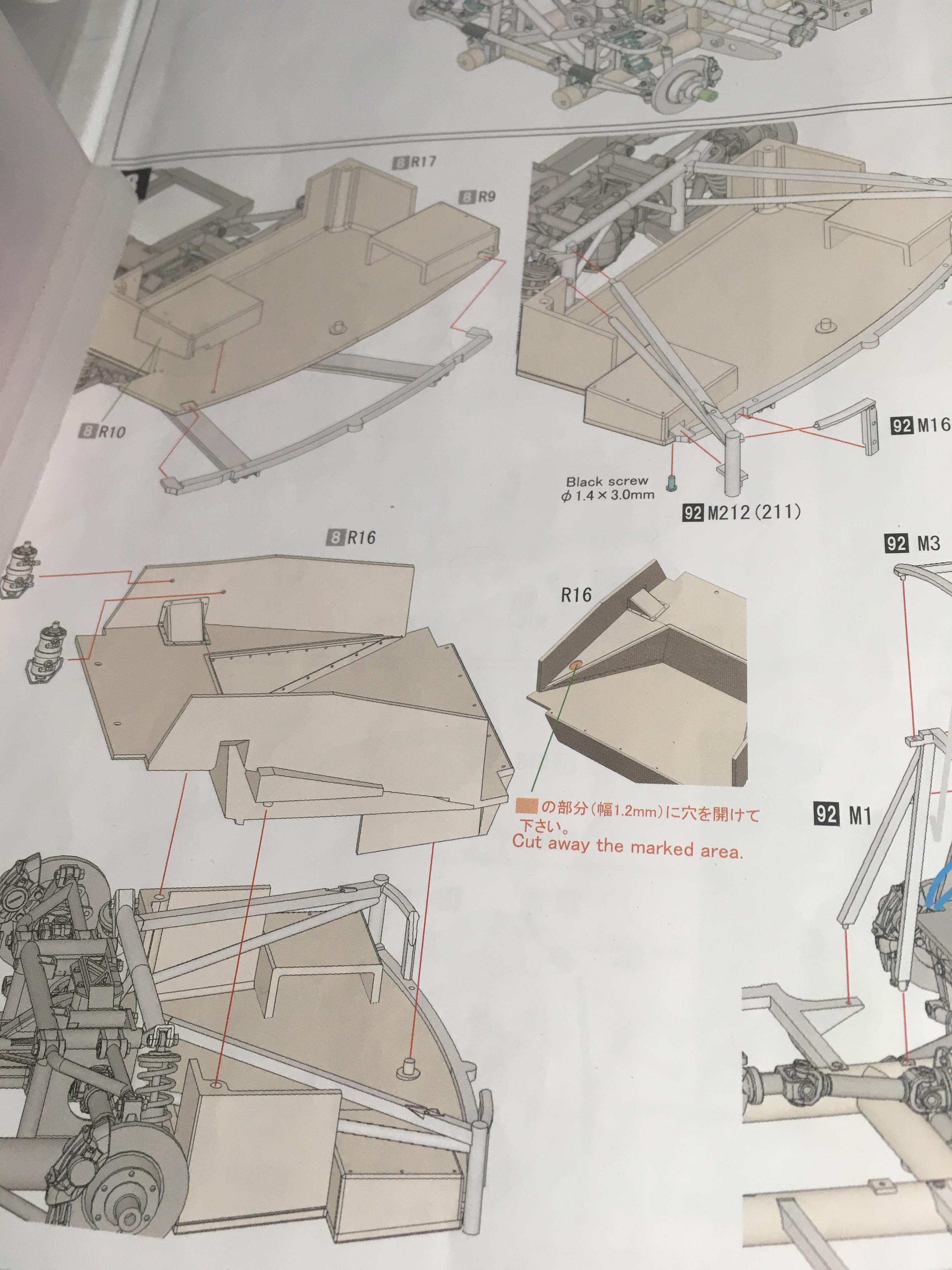

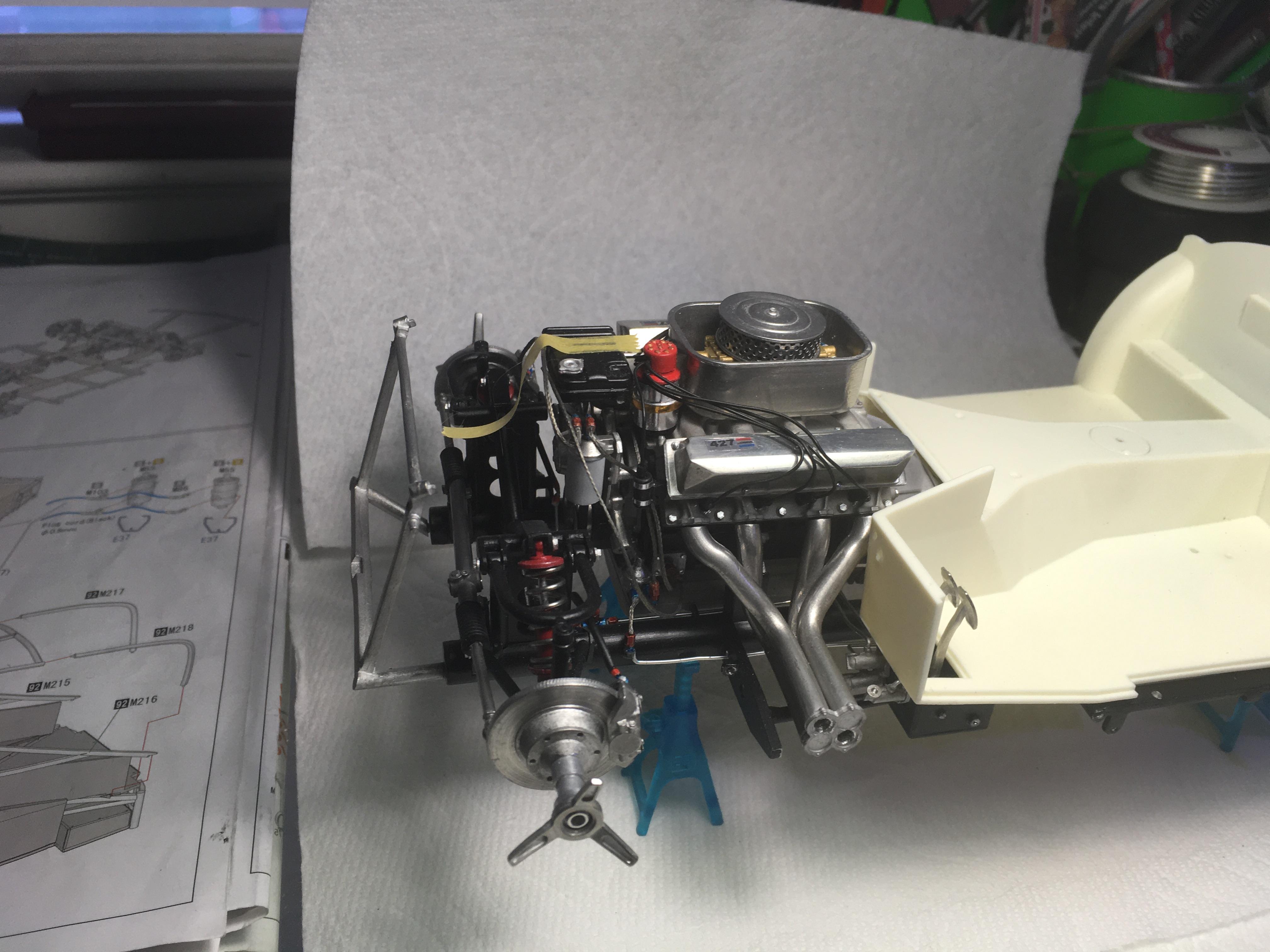

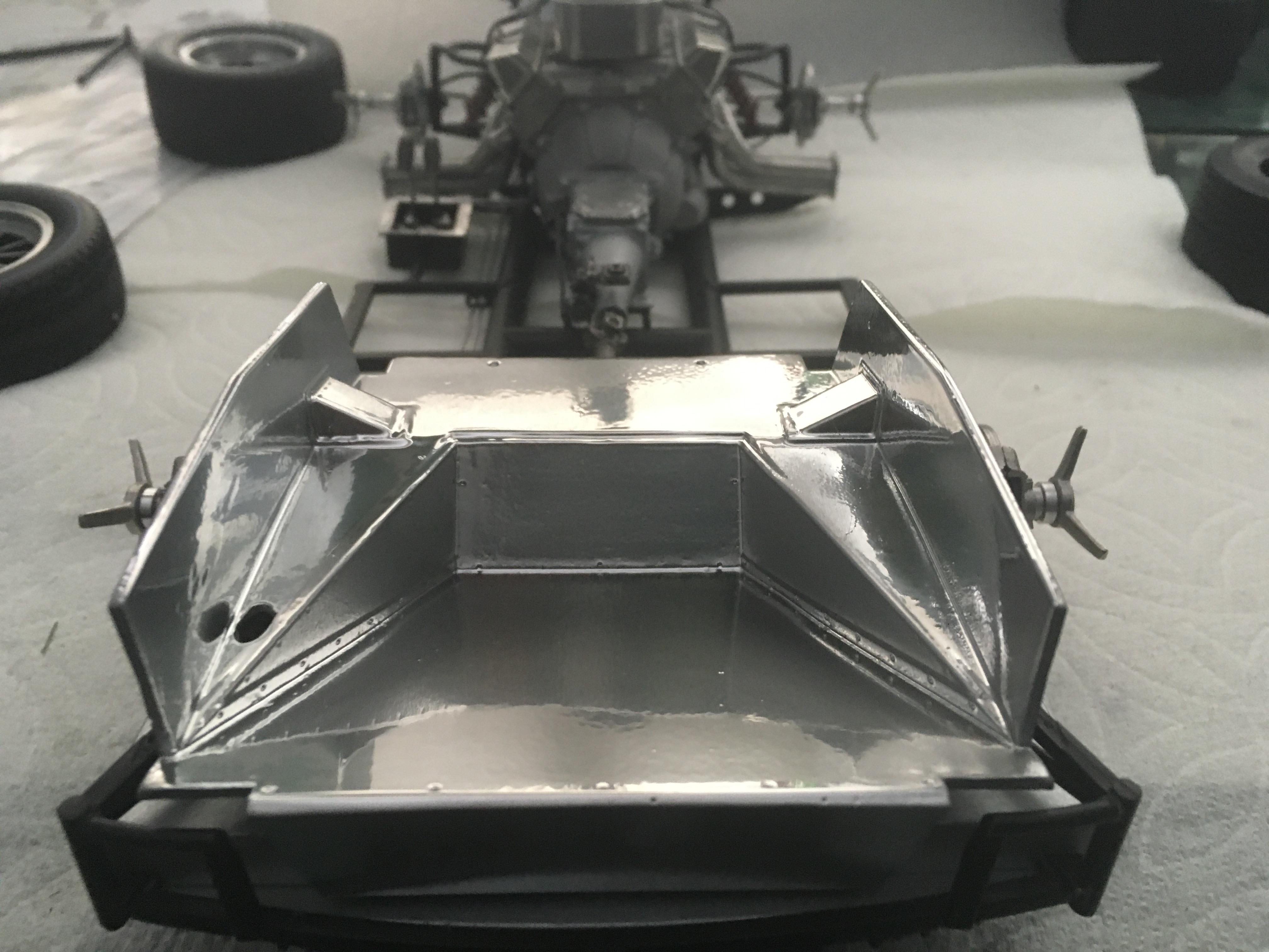

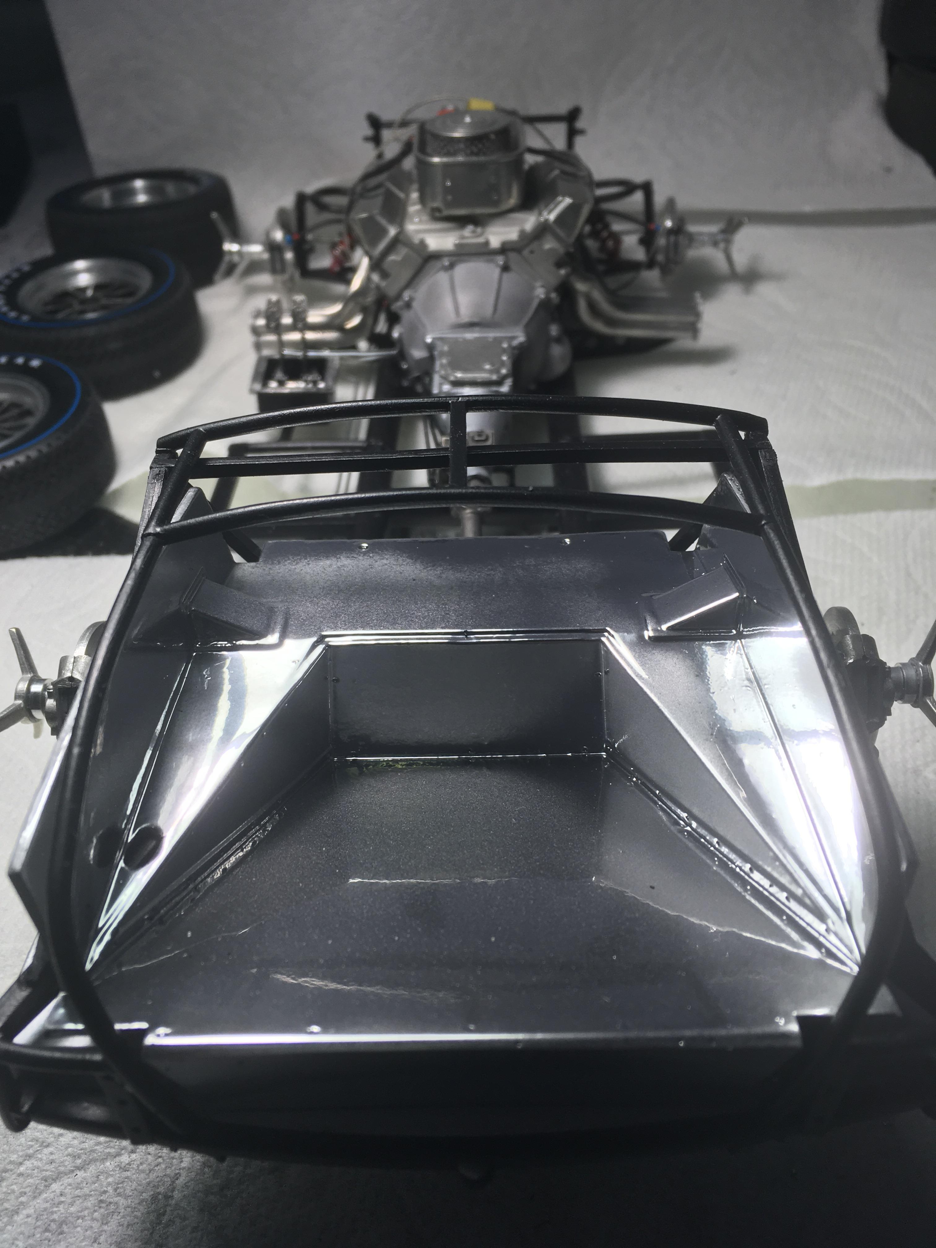

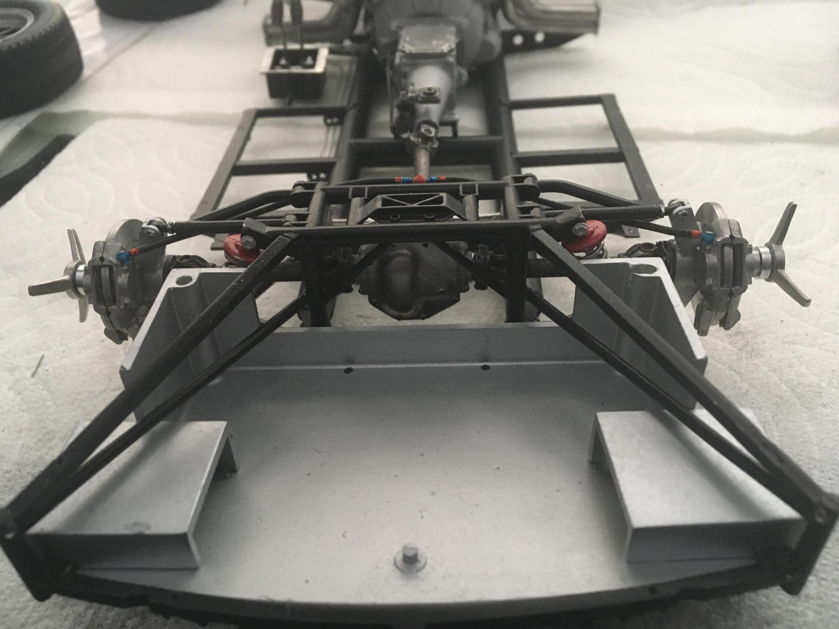

Brudda Posted March 1, 2021 Author Posted March 1, 2021 Getting a break from the big 1/8 kits. Have to get my brain in gear. The rear trunk area and radiator mount. Fitting floor pan. Here we go. More tubes. Fitting tubes. Going to need that therapy

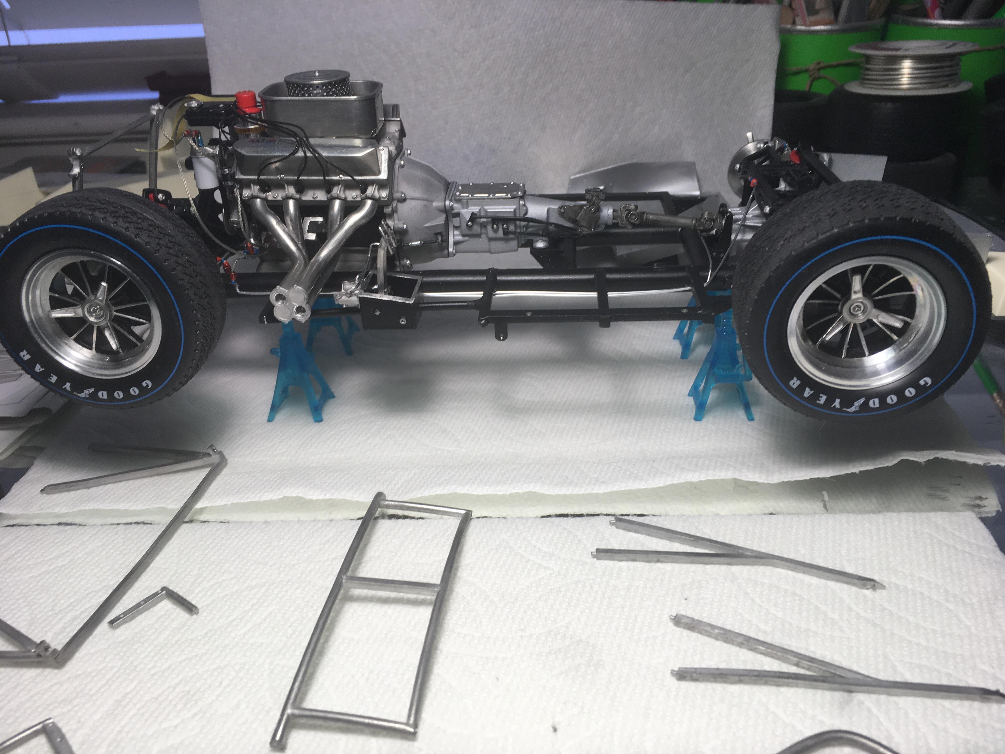

Brudda Posted March 1, 2021 Author Posted March 1, 2021 Thank you Vamach 1 . I put the tires and wheels on just to get the juices flowing.

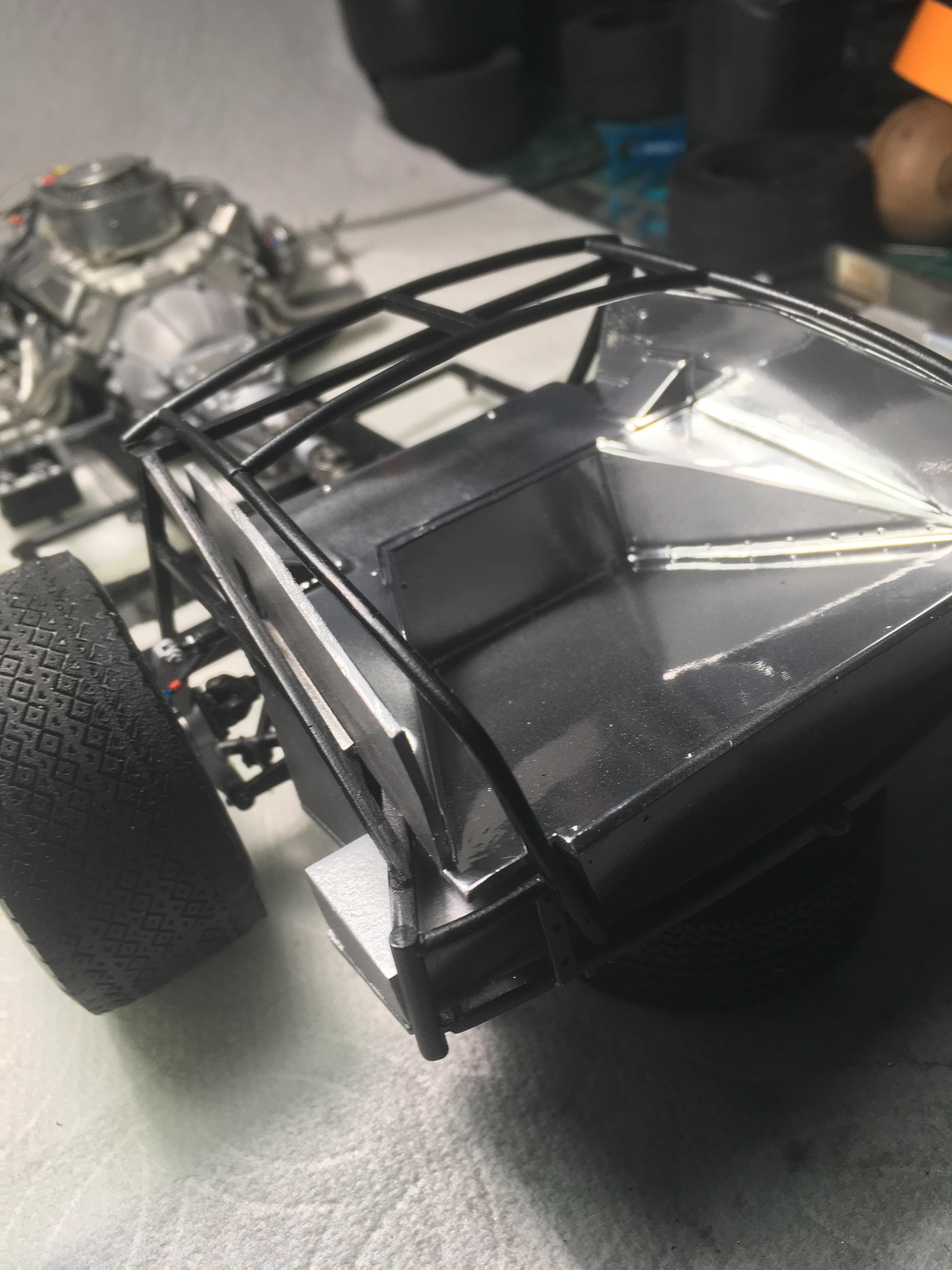

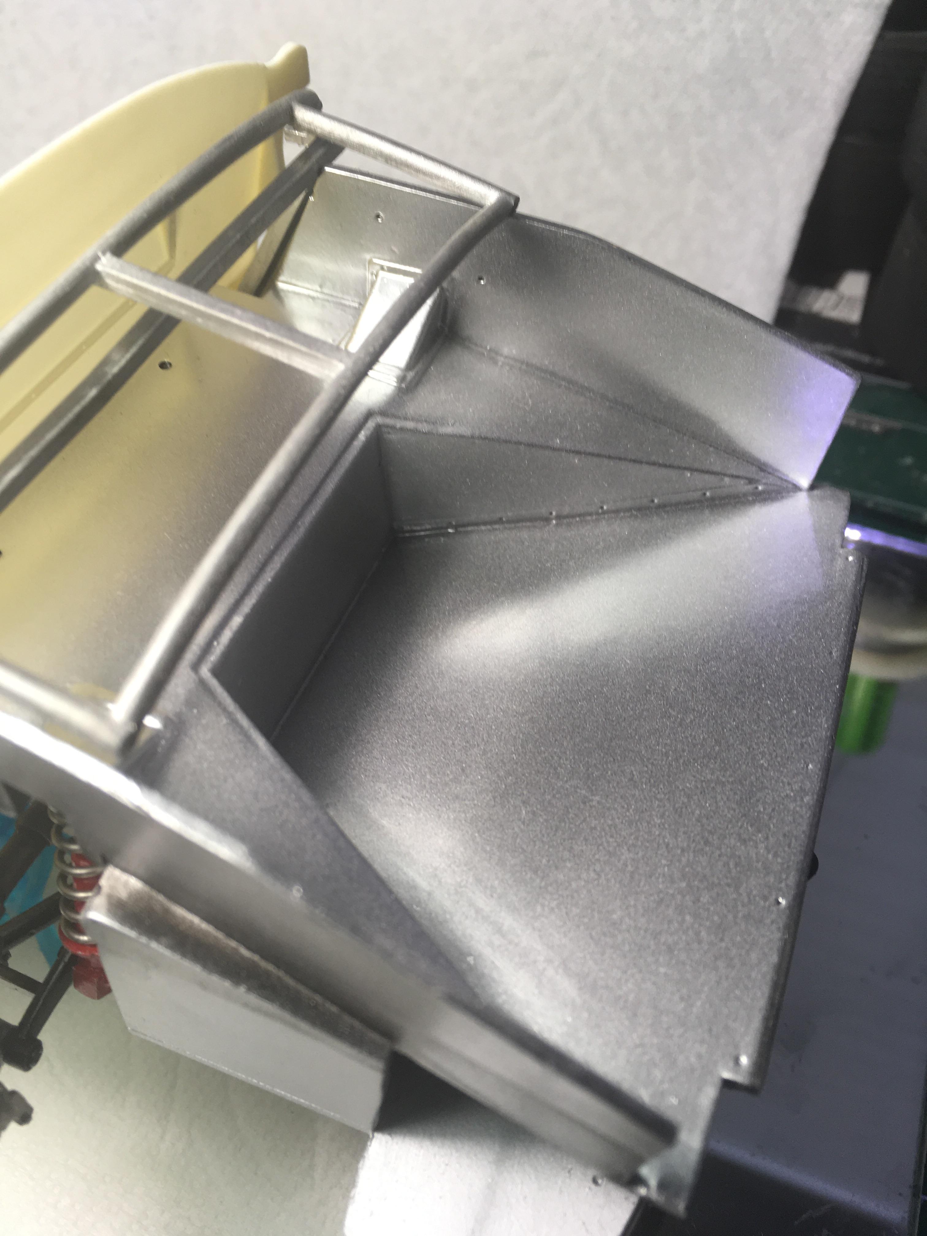

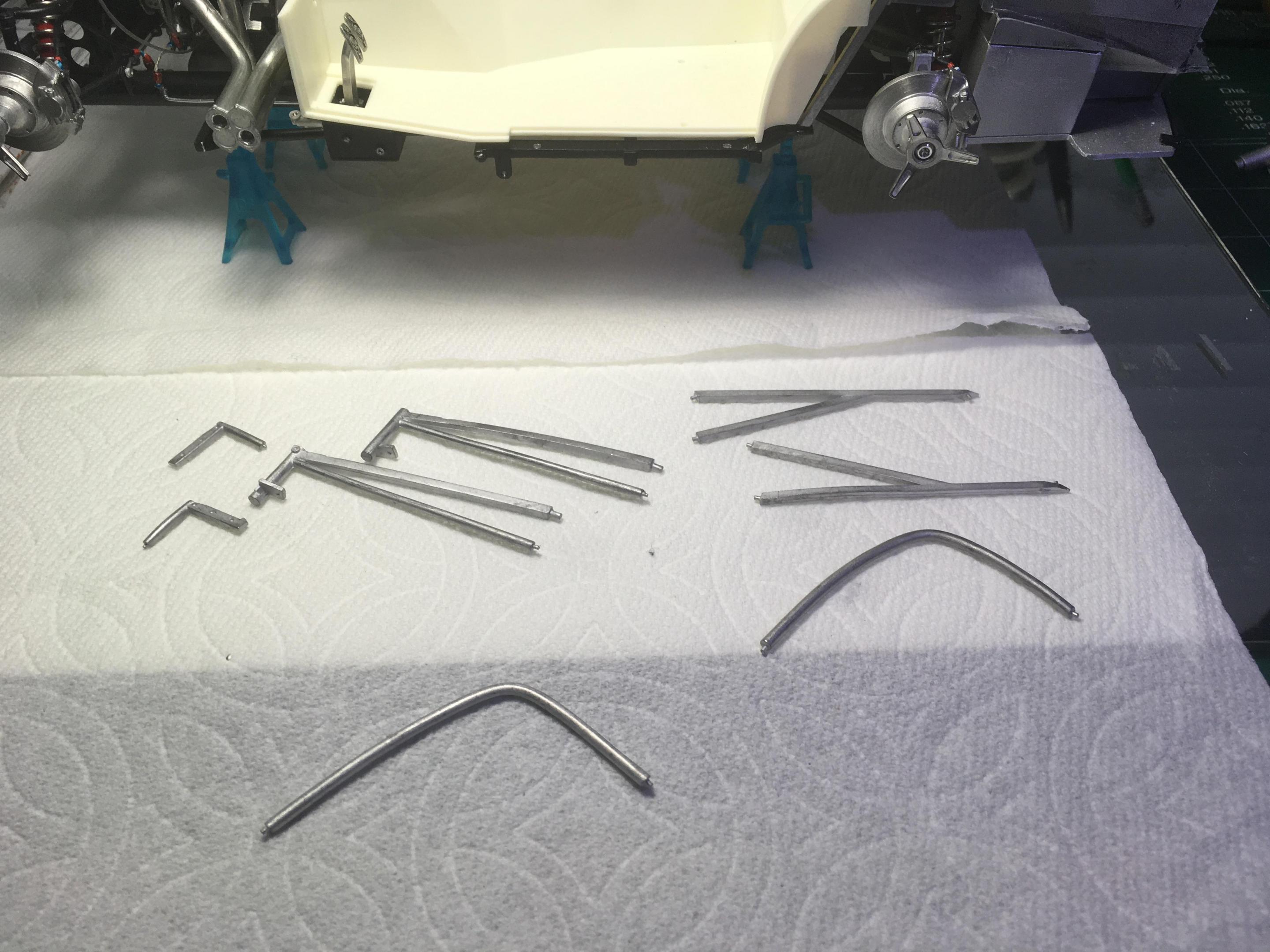

Brudda Posted March 3, 2021 Author Posted March 3, 2021 Thank you Ray. Building the trunk area . Nothing exciting here. More tubes. Painted the trunk area polished alclad aluminum.

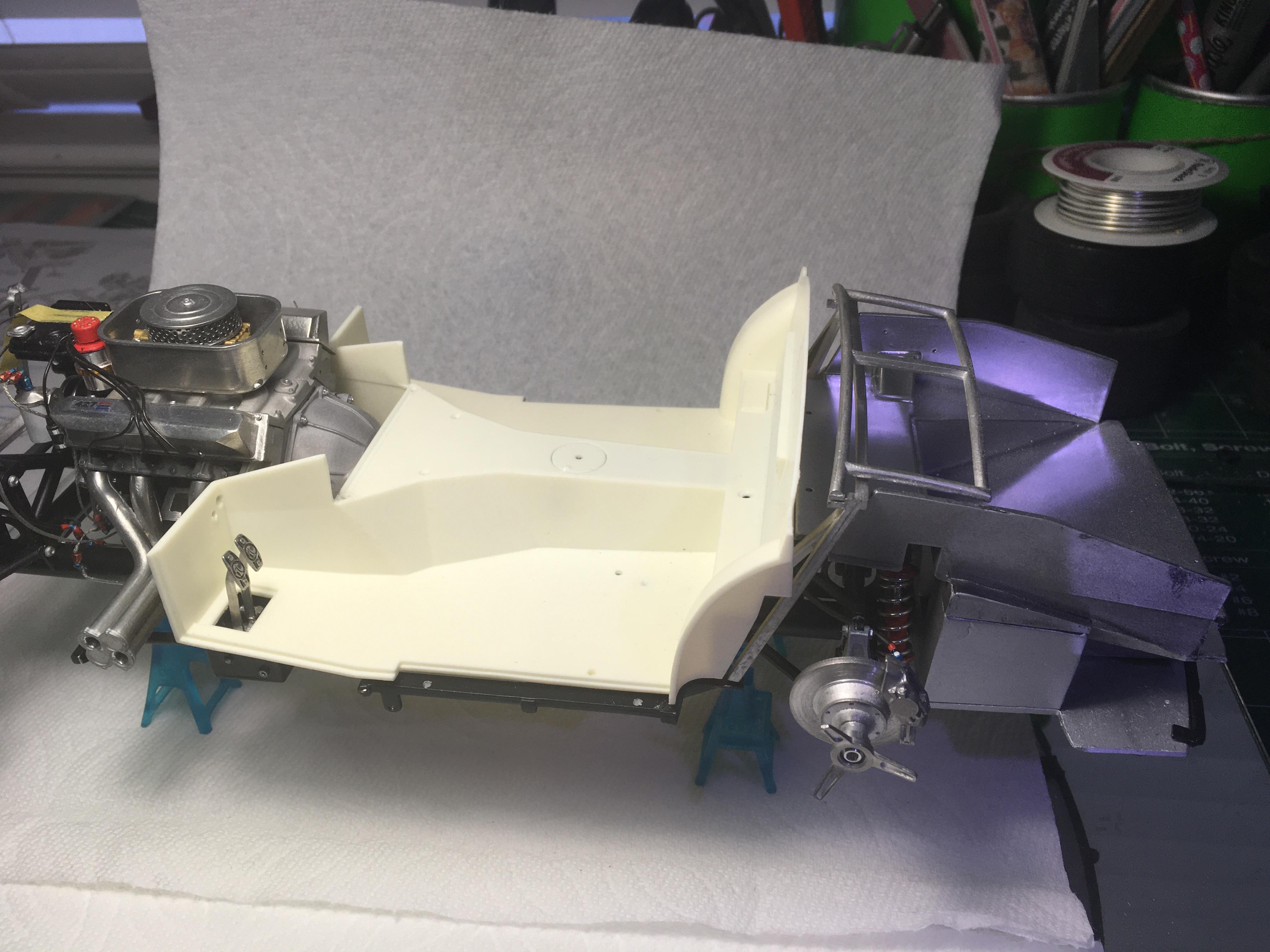

Brudda Posted March 5, 2021 Author Posted March 5, 2021 Thank you Bruce and thank you Nazdrave. Here are the rest of the trunk tubes for the body. Not as hard as yours Chris.
