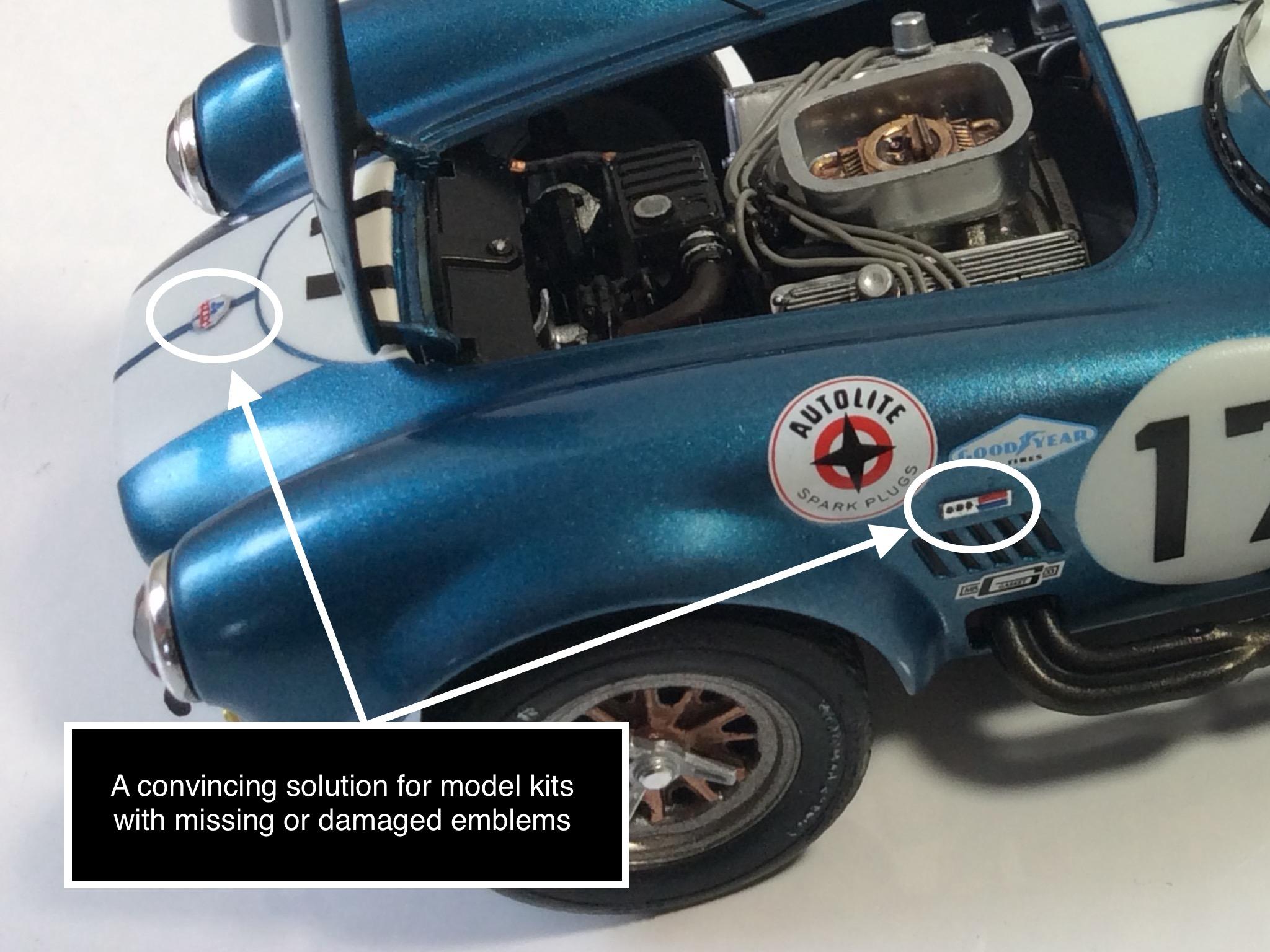

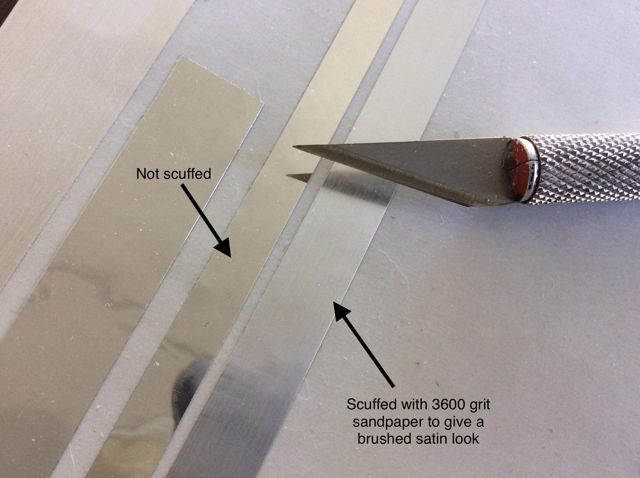

Hi all! I had a forum member ask me for a tutorial on how I did the steering wheel on my 427 Cobra, so here’s my best attempt at it. Thanks, JoshA0CF07BA-2A9F-4634-8903-E867260F4413.jpeg.5bf9f234da7a94eec65f519e779036d9.jpegC6DDC750-8142-42CB-8603-8E73FE1C4CC0.jpeg.bce80a44ba9ef166f1ad2f7a4e3184d0.jpeg7BD90BDD-1B27-4B1B-A1B4-8EAB15885F38.jpeg.d70849df9255819b16af63ad395bec8e.jpegB972658D-7924-4404-8C21-6FAE2000BDDD.jpeg.4105c42e3e0956d67a2a8059e62956cf.jpeg7968DEAA-5B6B-45F1-B567-63DAC057553F.jpeg.27daf0585a248e8b2cdad3b33763f740.jpeg8DABCF06-D5D3-4583-9A8A-6C442D387CFD.jpeg.42c9c170a22355058b499ed3fb299570.jpeg2AAB64B1-A63C-4A7B-97D9-C7E8BACB77AA.jpeg.abeb4ad639e53508477344a39819bbb5.jpeg3AE4235D-4E73-44CB-8745-9659E1918158.jpeg.94a52d0682ca52a4bc6678213a94776c.jpegFCEFF1B7-E79F-4E4F-B7F2-720C0B78823F.jpeg.cfcdd34a310c4dd7c9ce1a9be76a5627.jpegF3C66DDE-3A70-4696-B5CB-1F3B40478B03.jpeg.158f04245e6be5fc69fae8ac5eeecea1.jpeg69B7C90B-9C43-4277-A19D-D4BD82D0AB17.jpeg.1114cc82ed89daa875e474150bda8fc0.jpeg

I’m not sure, but I know they use it on billboards, police cars, etc. but there are at least a few different variations of the chrome vinyl. Some of it is a bit more flexible, but that kind is usually too thick for 1/24 scale and it is not as much of a ‘mirror’ finish. The one I look for is like a perfect mirror and it is no thicker than a piece of notebook paper. It has zero twistable flex, but will wrap around some things. It is sticky on the backside. One of the sign companies said they order all their vinyl from fellers.com, so that may by a possible option too. Thanks!

That type of self-adhesive vinyl film comes in several thicknesses, and different surface finishes. What your sign/wrap shop will have for scraps might not be the same as what Josh found (but it will still be likely usable).
Correct. They might not have the exact same one that I used in the photos, but as long as it is no thicker than a piece of notebook paper and has an actual chrome-like finish, you should be able to get almost the same, if not the exact same results.
