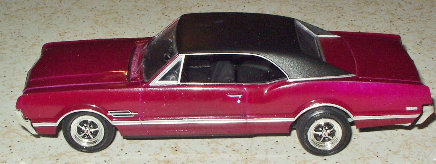

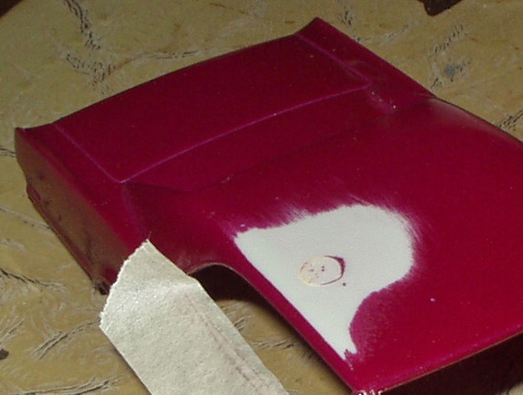

Easy fix! I had to do it on a glue bomb I rescued last year. Had a bad glue booger on the roof that I sanded out, but couldn't match the paint for. BVT to the rescue!
1. Mask off everything else (duh!)
2. Lay down one coat rattlecan flat black primer (I used cheap Touch N Tone, same as Walmart).
3. Lay down one coat of rattlecan satin or semigloss black, holding the can about a foot out so the paint lands "pebbly." If you don't have a rattlecan of satin or semigloss black, do the same thing with the flat black. A second coat might or might not be needed. DO NOT let the paint land wet or flow out, or you'll have to start over.
4. Finish with a coat or two of rattlecan clear satin, matte, or semigloss, whatever you can get. Again, hold the can about a foot out and don't apply it wet. If you used a good satin or semigloss black in step 3, you might have an acceptable finish already and not need to clearcoat it.

Snake what did you do for the chrome trim?
Expand
The roof trim was molded in the kit IIRC. Most of the standard trim on that model was my usual beloved Silver Sharpie but the big chrome side trim I did in Deco Color Premium Silver Leaf (very much like Molotow) I got from Walmart.

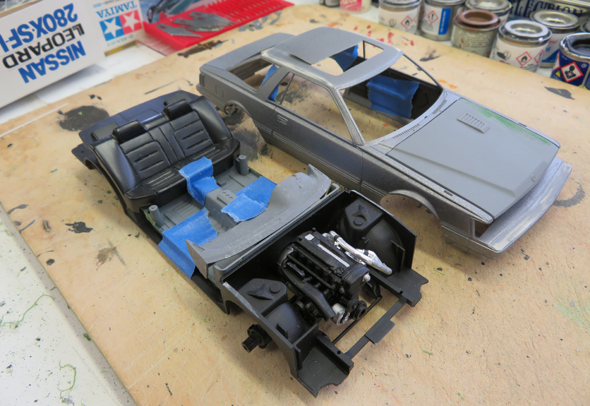

Added a bit of strip styrene around the edges of the bonnet opening, as I'd had to cut that open.
Opened-up the vent in the front bumper. There'll be a big intercooler behind here.
Spent most of my time sussing out the interior. I want to use the tub from the race Skyline, but with side panels and rear seat from the Leopard to keep it stock-ish looking. I'm adding the LHD dashboard from a Nissan Silvia, so the driver can make better use of overtaking opportunites.
Crudely mocked-up, it all seems to fit.
As the bodywork is going to remain pretty standard I'm hopefully not too far off getting some colour onto it, just few bits of filling and sanding to go. Current favourite is a warm gold/light copper shade.

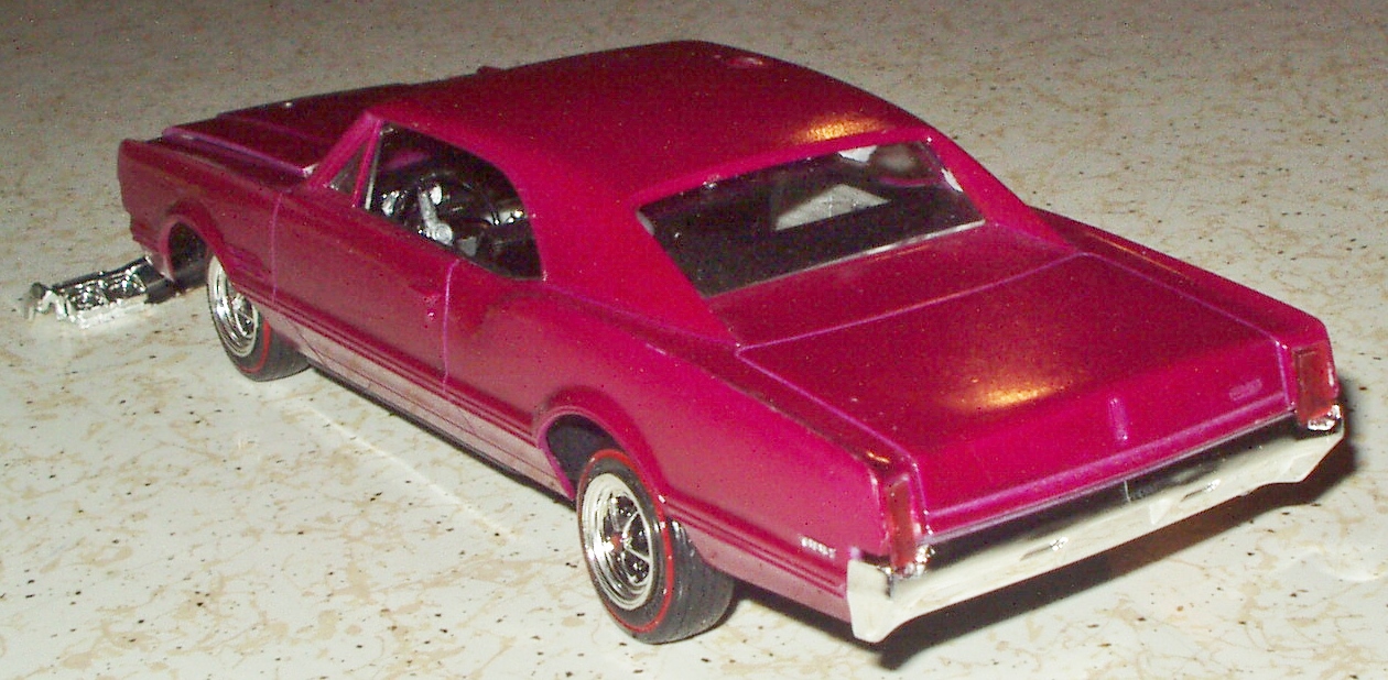

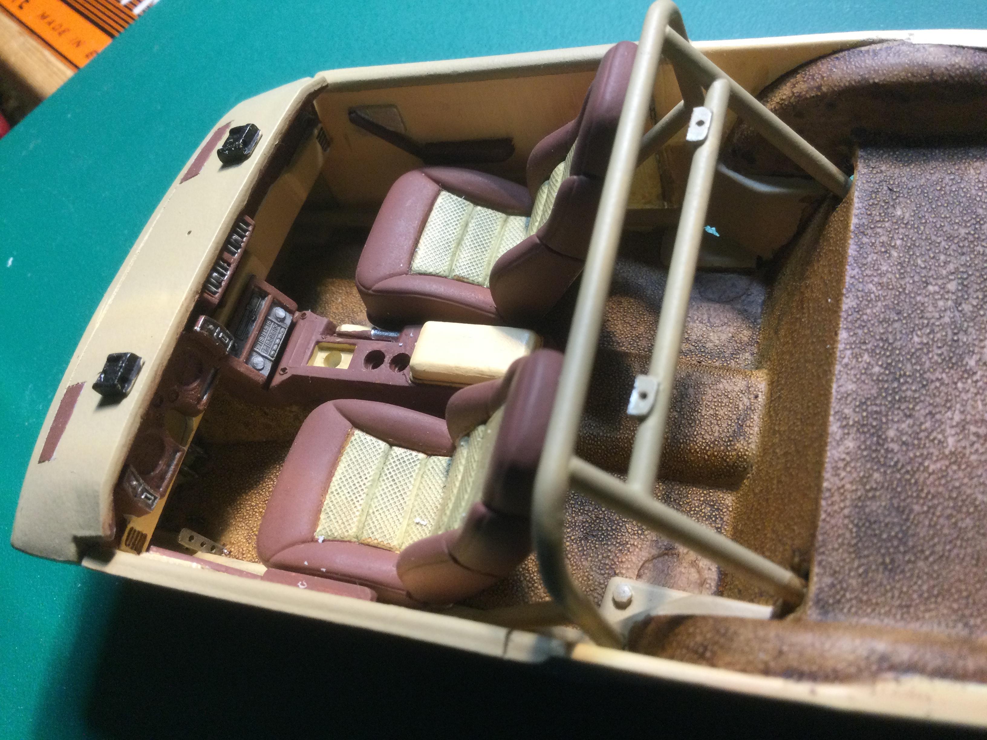

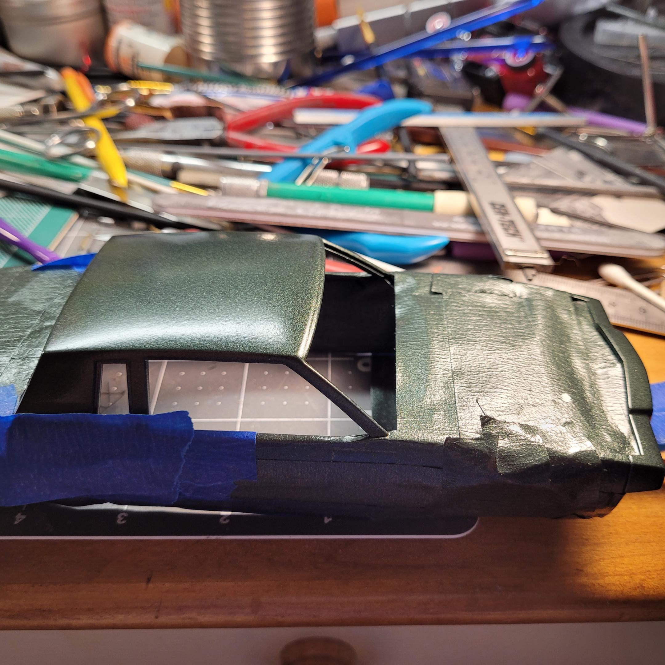

Ok, trying to fix the paint on the roof. Going to clear it tonight.  If this doesn't work I'll try a vinyl top . If that doesn't work it's  getting weathered.20210520_122120.thumb.jpg.bda74f9f1642724e48a8f02f98e6bf73.jpg

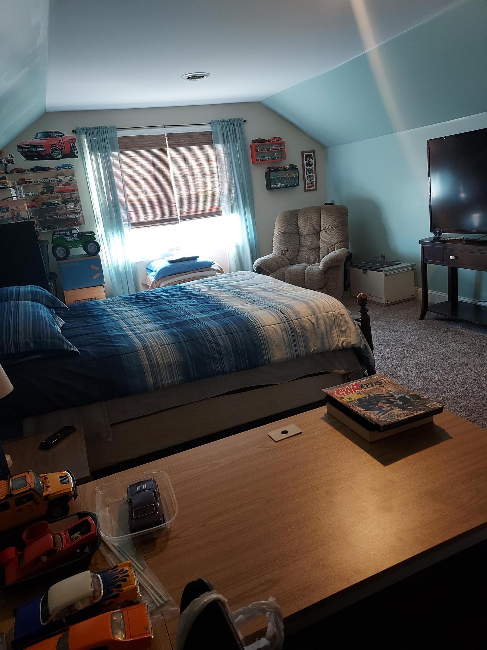

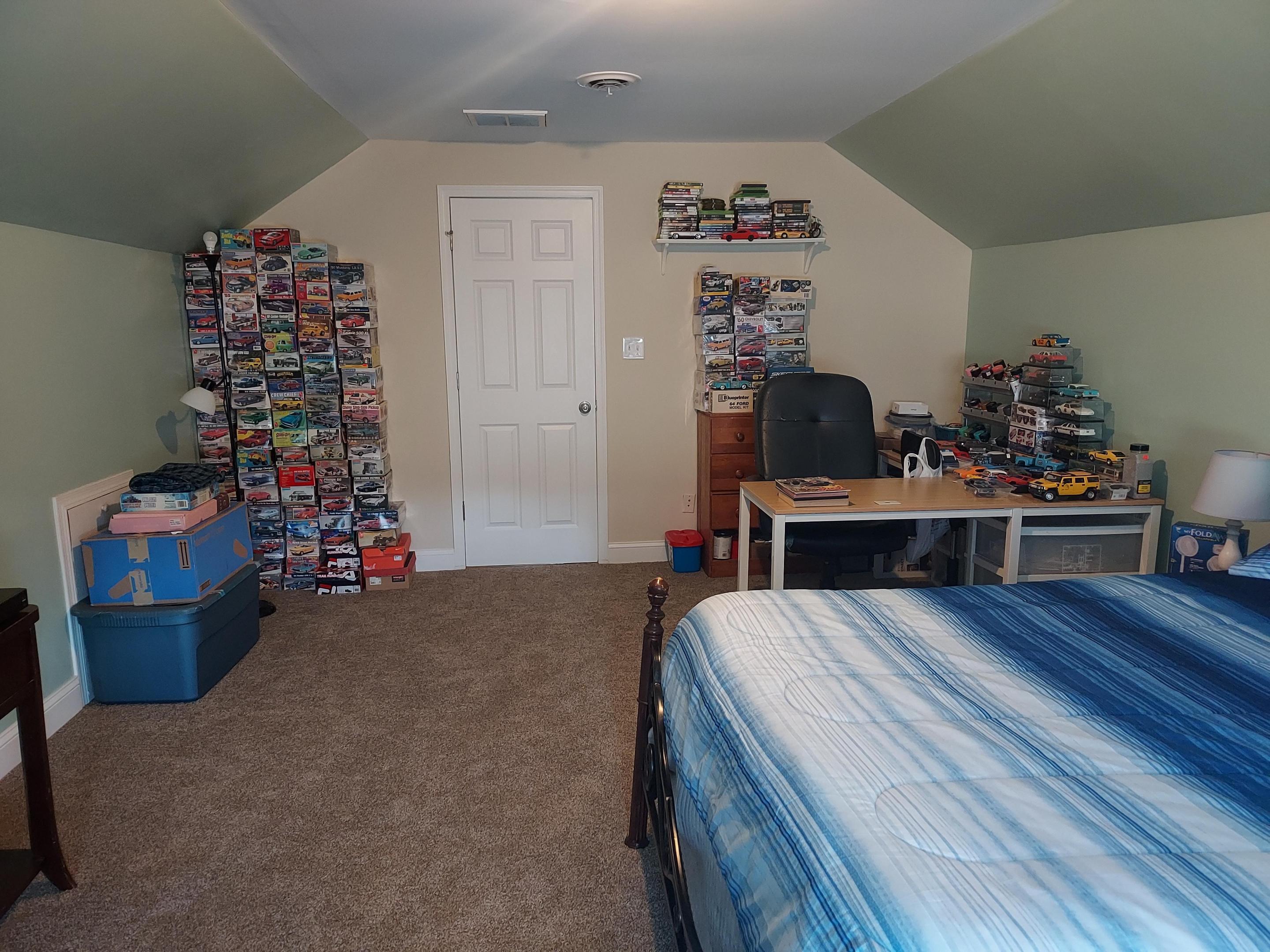

I managed to get my hobby room somewhat back in order. It's not exactly how I'd invisioned it but hey, I'm glad to have some organization. I'm ready to start building agian.
Also I checked out The little old lady from Pasadena 1964 Dodge on  spencer1984.com... what a great article on the build. I recommend going over and reading that. Thanks guys for the support and keep up the good work!
Expand
Well its getting weathered, touch up came out to dark, it did work just way to dark. I hate shinny anyways☺☺☺

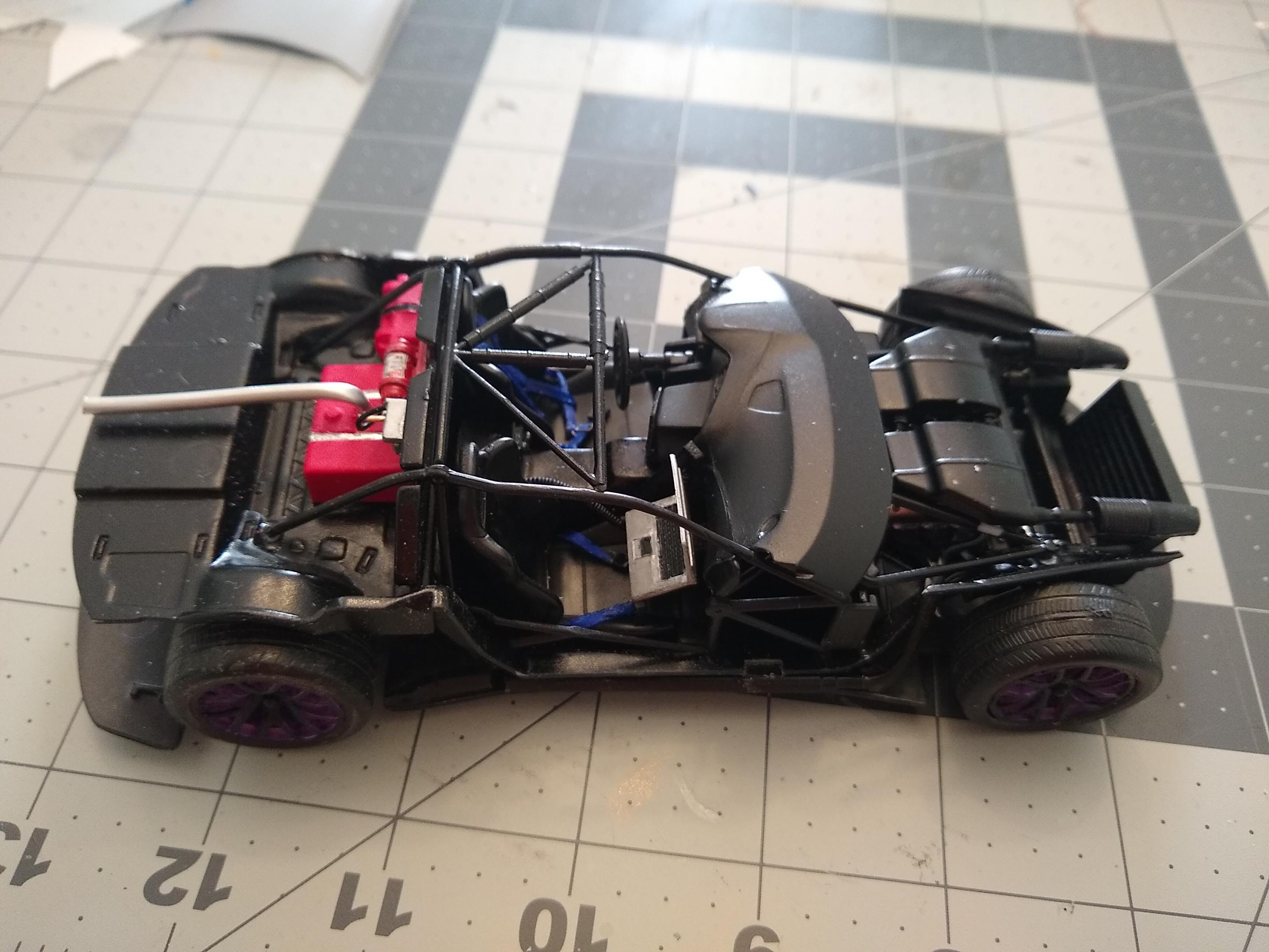

With such great builds coming out of this year's contest I haven't been in much of a hurry to get mine out.
Here is a long overdue update.
Still some body fit issues to handle because the C7R body was so much wider than the C7.
I trimmed the roll cage quite a bit to make it more street-worthy.
Lots of bodywork left to do.
The color will be satin black with some violet accents

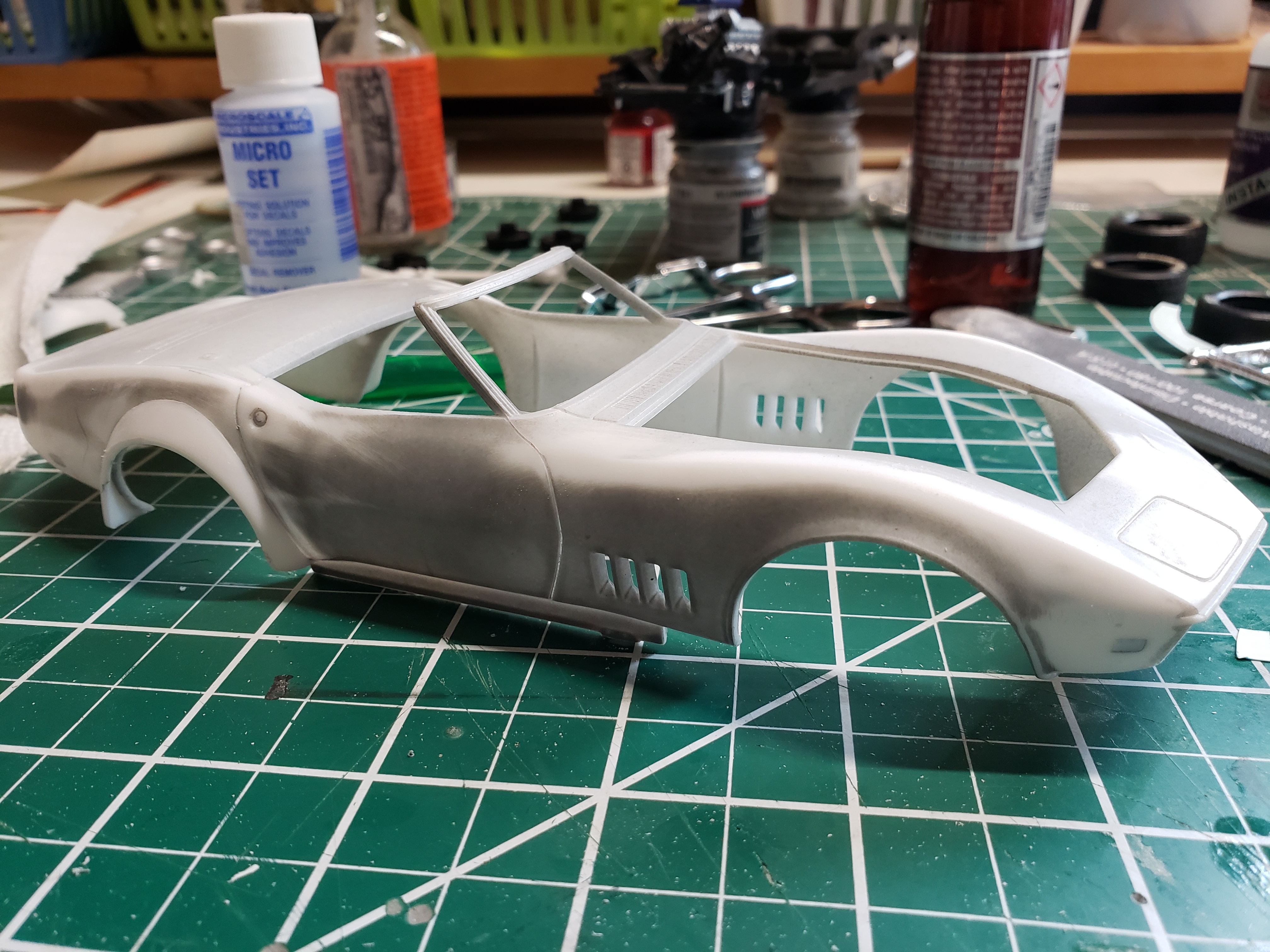

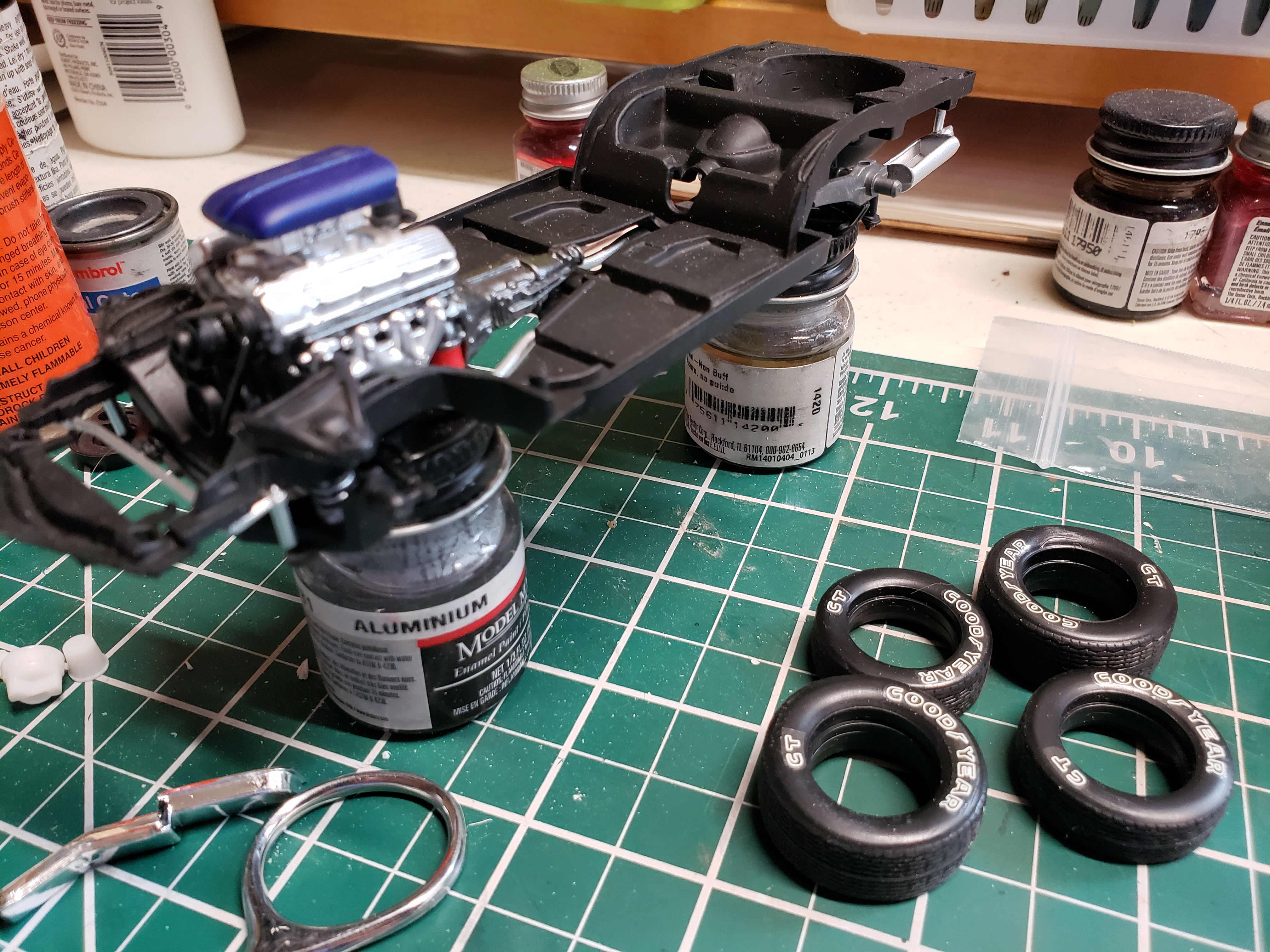

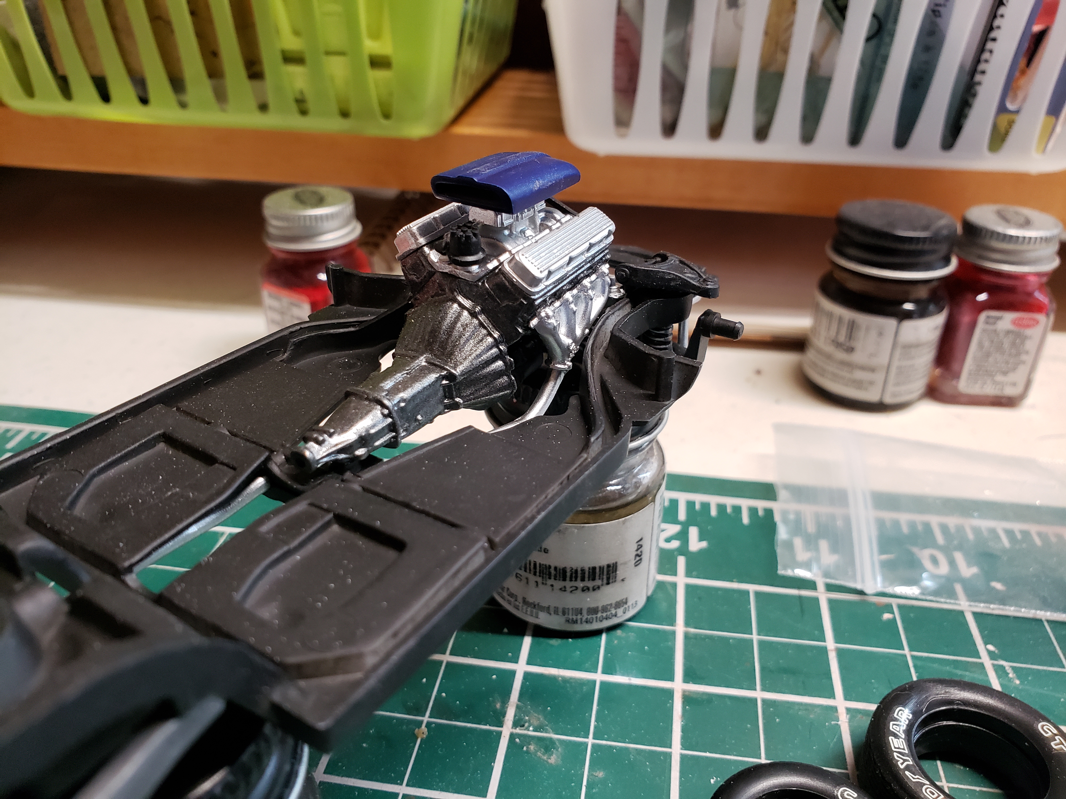

Hi guys. Spencer that red rocket is just amazing.
As I've progressed with this Corvette, as I've never built one,  it's sort of turned into, "if I was going to built a C3 Corvette for myself, this is how I'd do it".
So lots of body smoothing. No side markers,  no reverse lights, no bumpers, no door handles,  no scripts or badges. Custom air cleaner. The color will be suede Testors De Ja Blue.
Enjoying the build.

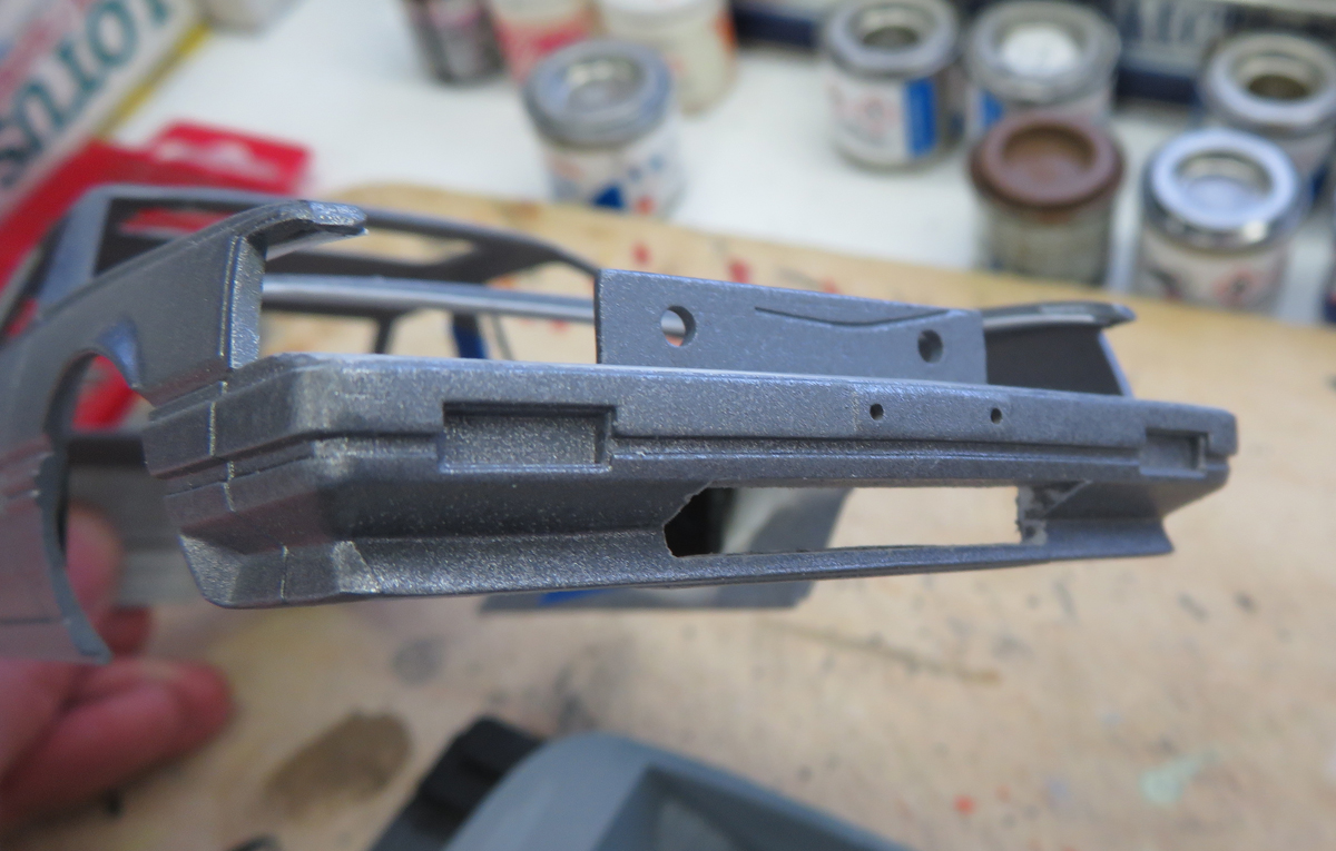

With the arrival of summer like weather my workbench time has been limited by my garden activities, yet I was able to spend a rainy weekend at work on the Camaro IMSA road racer.
Most of the recent scratch building has focused on the front and rear belly pans. The larger front unit will house the engine oil cooler and brake cooling air ducts for the front discs.
5F832C1D-C1AD-4107-8C5A-0477466434AA.jpeg.fe1ce2ffbc03d702648afdd4bc6b6c3b.jpeg0354BB61-1A20-437A-9E89-1FAD7C58B997.jpeg.e4d1a74b17b1b33280132aa1b6be8781.jpegB9430B6E-9CEA-46DA-8627-9FB92E11A6A3.jpeg.1cacd4fd9ea0bd7293be8040bbb3a1c0.jpeg472AF8E2-AE34-47AC-8FA1-4DB739A31E81.jpeg.fbab0b56a3e2559a22e4182ec64a7845.jpeg

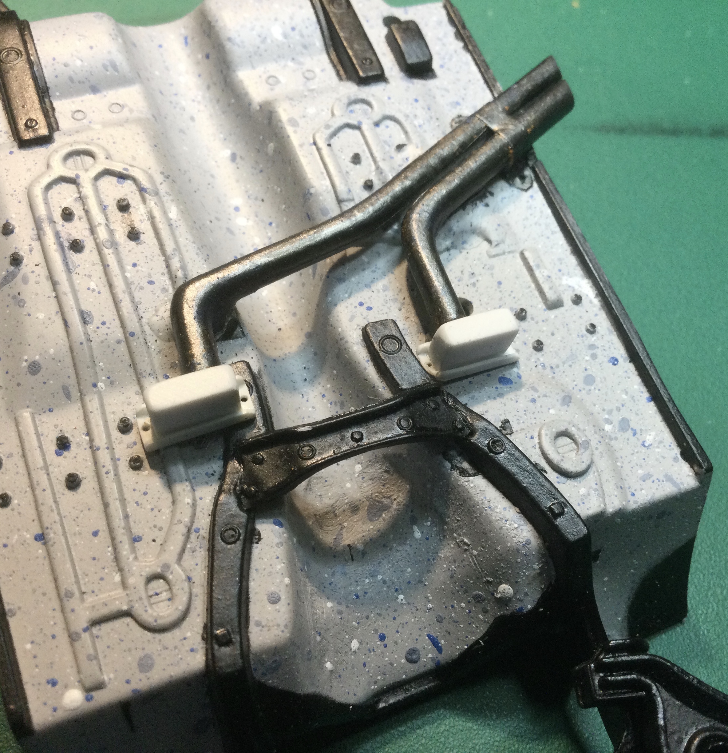

The rear pan will shield the civilian exhaust pipe and have an exit vent for the rear end oil cooler housed behind the rear passenger tire well. For the air ducting I’m using old plastic bendy drink straws that offer the right look and remain somewhat flexible and keeps its shape.
E5D7D562-AB23-46AE-8803-746420B741A2.jpeg.9b28fa9e2cce9329ca87e29d6374365d.jpeg91A15844-332C-4EA5-AC00-6971F2DA2B42.jpeg.b7d65cae7d01c91d9b91755b701d3cb9.jpeg
The interior is progressing with detail painting and washes. Once the base is established the detail bits will be added to complete the “digital” cockpit. The sought after effect is to have the appearance of a road trip vehicle full of luggage and camping supplies to the casual observer, belying the actual evasive measures being employed.
CCAF9A59-C6CC-4DA4-9821-FC890FEBD7B5.thumb.jpeg.b0a6ad881fa1c767ba0222a70771dc9a.jpeg979A8F7E-73E4-47C4-AE79-BB216B851DA6.jpeg.848f7a3e51ca6be67accd6118bc51df7.jpeg
The various scratch built parts are being readied for primer coats followed bu detail painting. At the top, and going clock wise, is the stock steering column and wheel. The engine oil cooler was constructed using guitar string to represent the coils, it will be mounted into the lower grill opening. It is followed by a pair of fire extinguishers to be mounted behind the passenger seat. A headliner control console will harness most of the communications array  on the roof. At the bottom are the dash components consisting of a digital driver’s display, the infra red radar screen for night vision, and an iPad for the copilot. The next section offers the Wink rear view mirror from a NASCAR kit with a forward video camera and the rear mount for the brake light which also houses the rear ward IR radar and video camera. The remaining two sections show the accelerator and brake pedals (running  a Turbo 400 3L80 tranny) and the the foldable foot rest for the passenger compartment, and lastly the picnic cooler and fixture for it to sit on the driveshaft tunnel.
The last item I worked on were the two gates for the exhaust to operate between civilian mode and wide open  dual exhausts. They will be solenoid activated from the cockpit.
That’s about it for now, until the next rainy days! Cheers Misha.

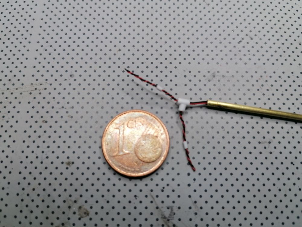

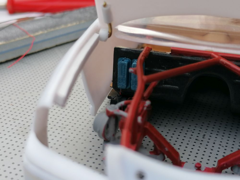

I´m still hanging on the details. First of all I started wiring the MSD ignition boxes.
I choosed a place on the passengers side firewall for mounting them...

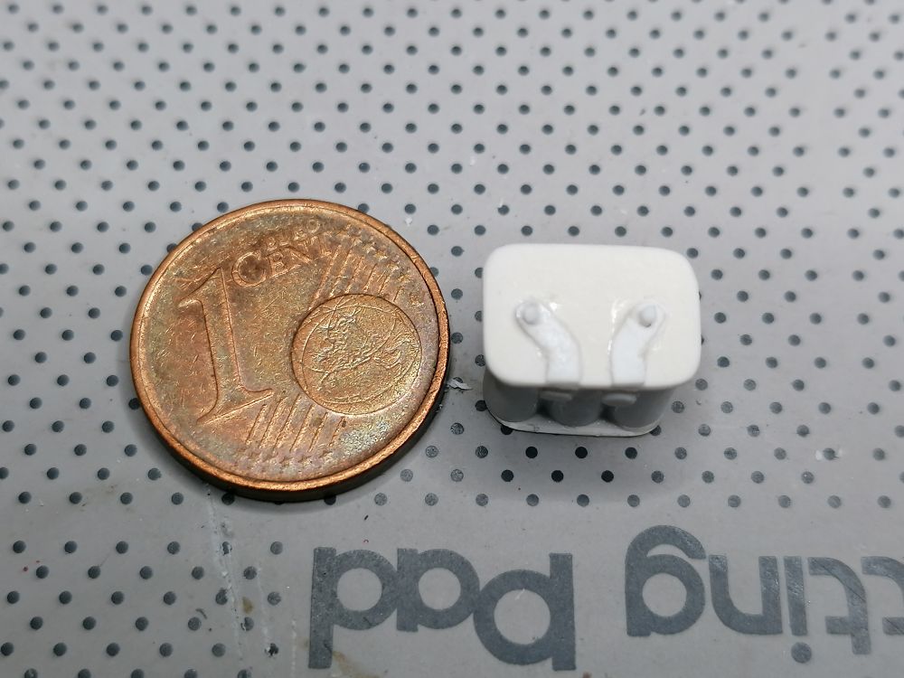

... then, because both kits doesn´t have one, I started scratchbuilding my own Optima battery...
... and an ignition coil.

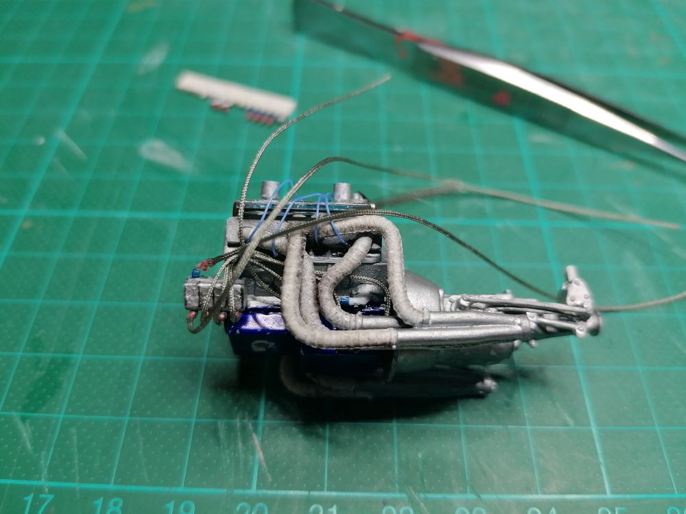

After that I started wiring the engine...
...painted the Optima...
... and this weekend I finished the ignition wiring and started the plumbing gas tank, the oil pan and pumps.
The fitting still have to become repainted after mounting. But that´s the work for next week.
Enjoying the build.
Expand
Nice detail there Rob. I love the tranny color.
