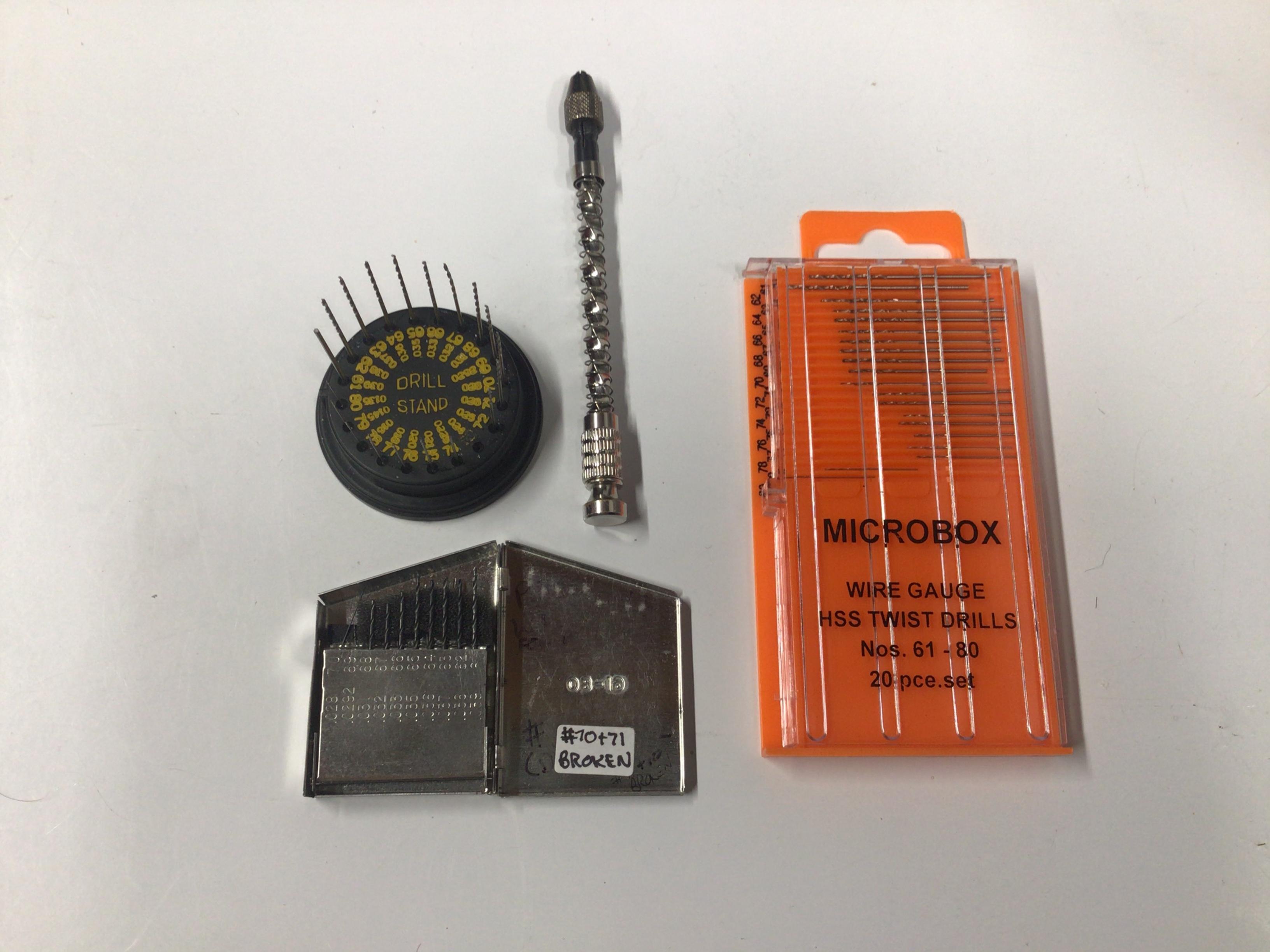

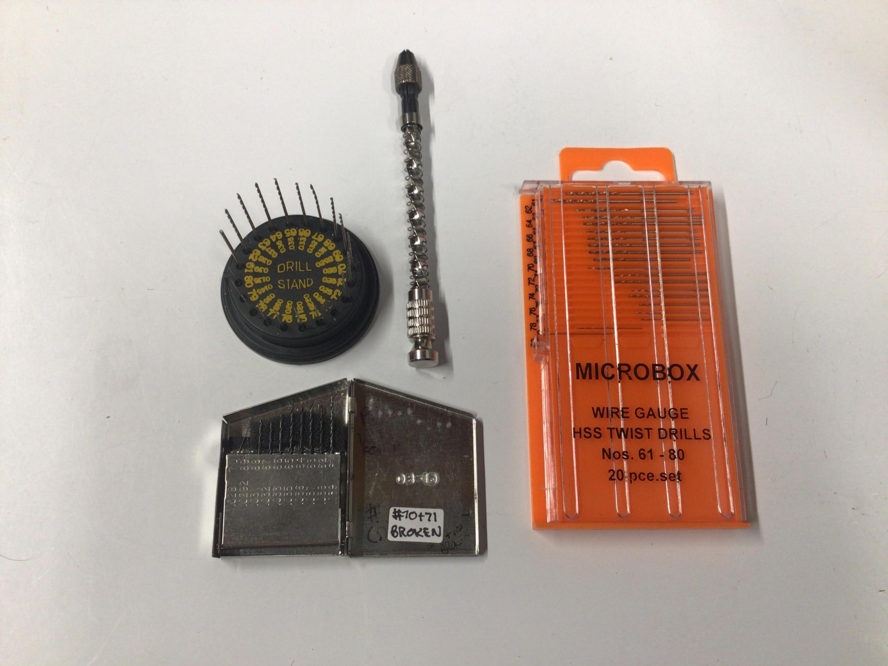

Vallejo makes or imports a really nice set that are made in Spain. The cutting edges on the first set of cheap Chinese ones I bought didn’t resemble a drill bit at all!
I bought the set I use several years ago and I can't find a brand name on the case. I got mine at a local hobby shop. The case is a round flat black plastic stand with the drill bit sizes and the words "Drill Stand" printed in yellow. There is a clear dome type cover that lifts off to get a drill bit out. The reason I'm describing its appearance is that in your search this may help you recognize it. The stand has eighteen bits ranging from #80 to #61. This range should cover a majority of your needs for small diameter use. You will still need a small pine vise if you don't already have one. I also have a larger pine vise for larger bits also. This is one I found at Hobby Lobby and is still something the local stores here have on hand. The bits are stored in the handle that has a screw - off  end on it.  Hope this information may help.

I have one like that , underside says Rodgers drill stand Colo Spr Colo 80908 USA

I have a set of “Mascot” drill bits that came in the round plastic index. They have a decent edge on them. I broke the biggest one and bent the #67 (.032”) bit. I also have a nice Morse set in the little metal index...I have broken a couple of those also.  The Vallejo set I just got, but they seem to be as good or better than the others. And, yes the index or dispenser is likely supplied to the bit manufacturer.
