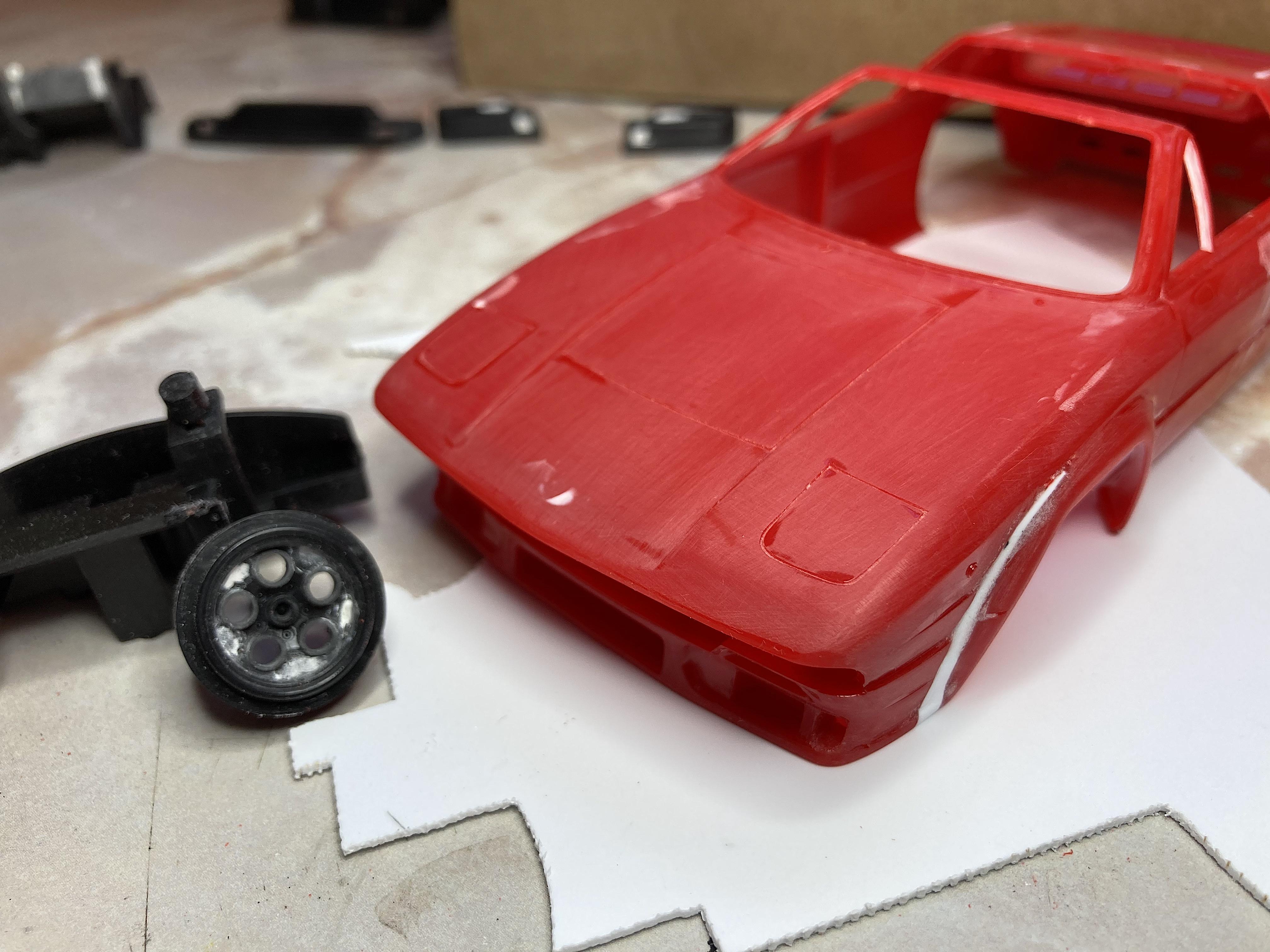

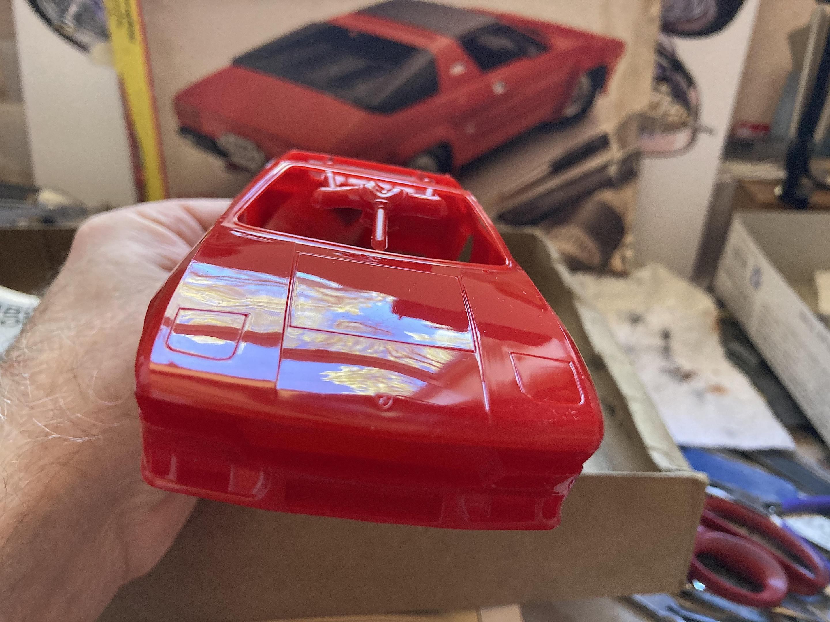

The panel lines need some sanding, and some minor mold seams to clean up.

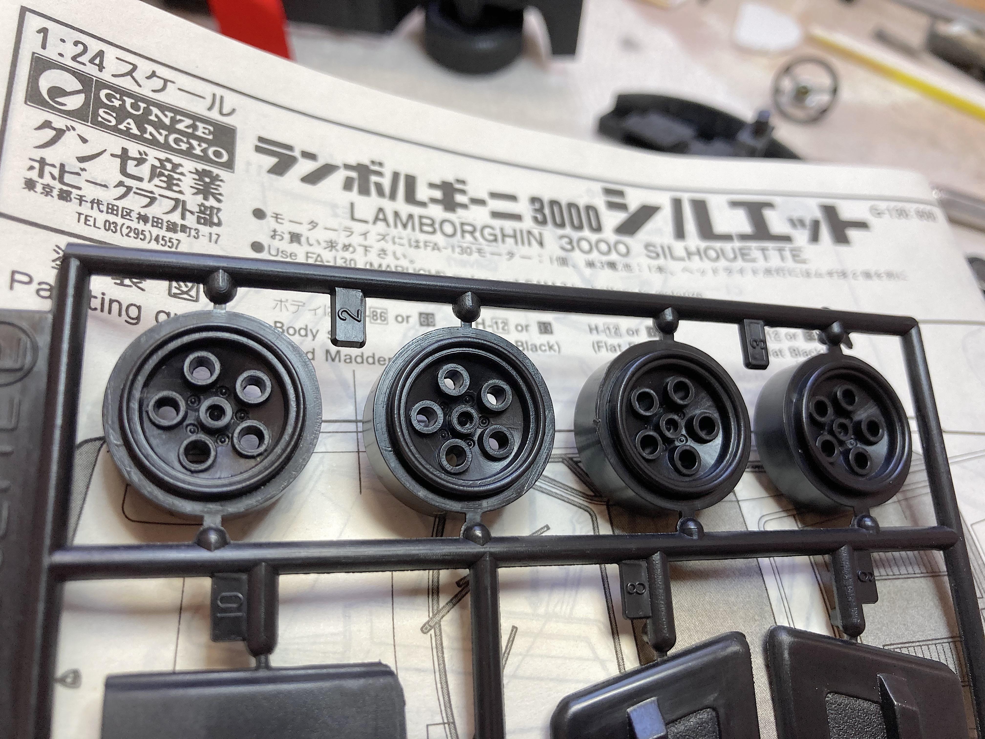

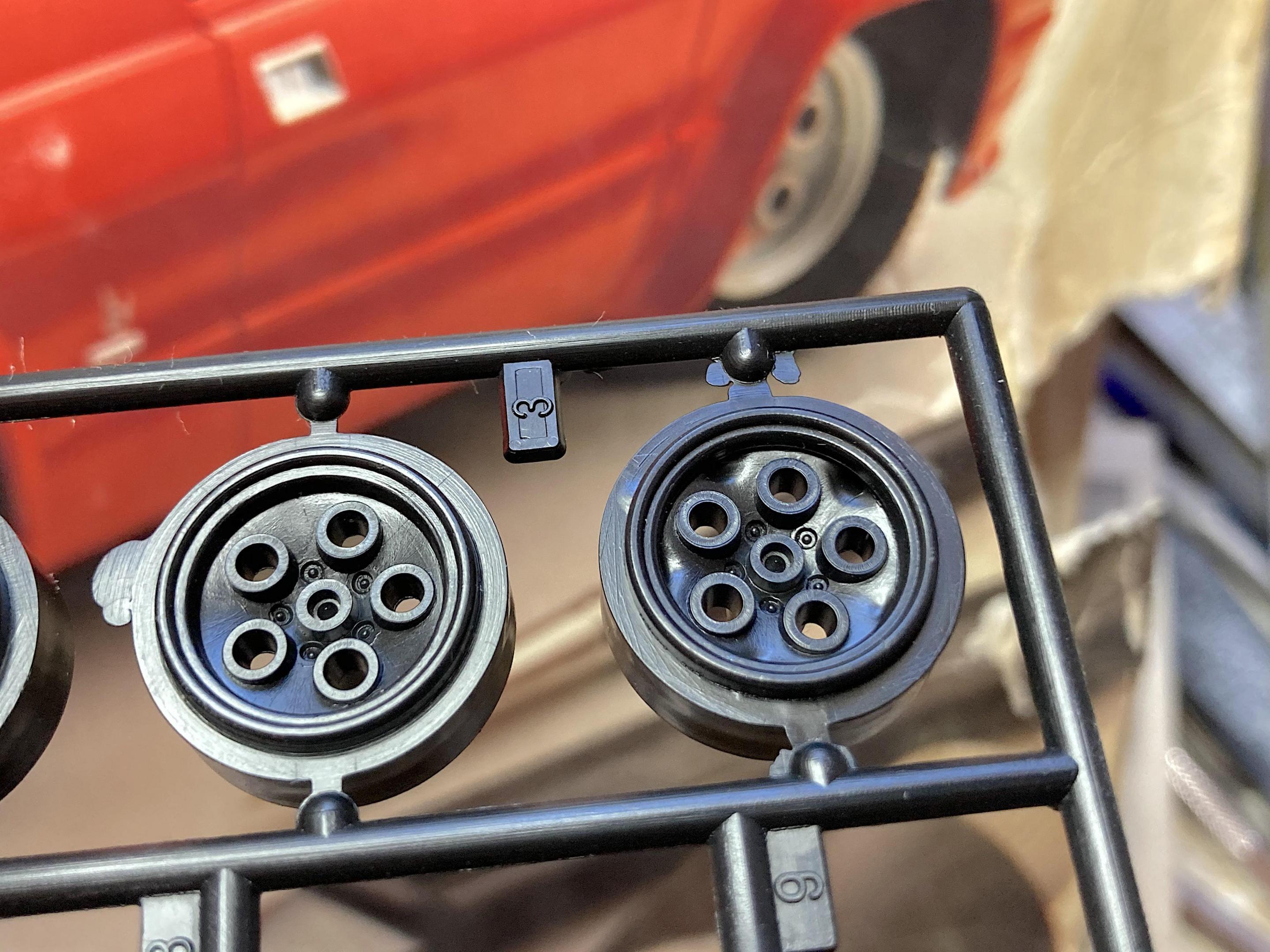

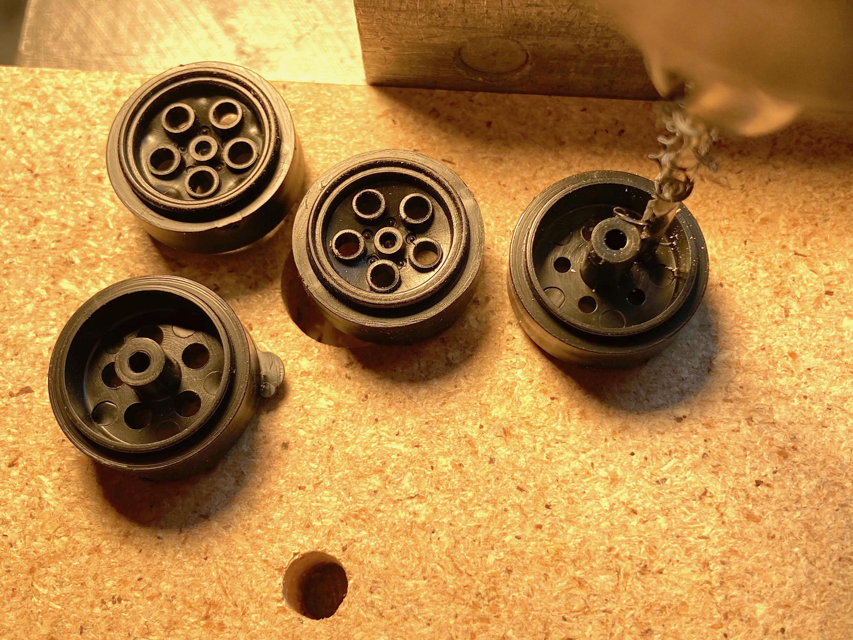

The wheels are the worst part of the kit.  I'm going to drill out the holes a little.  One wheel has bad sink marks, so this will be fun to fix!  Tempting to use Fujimi P7 tires, wider for the rear should be done, but that would disqualify for Box Stock, and that would lead to installing and engine, and then another hero project......
So much for qualifying for the GSL Box Plus category. ?  Would drilling the holes bigger with a #37 .104" bit would be considered a disqualification?

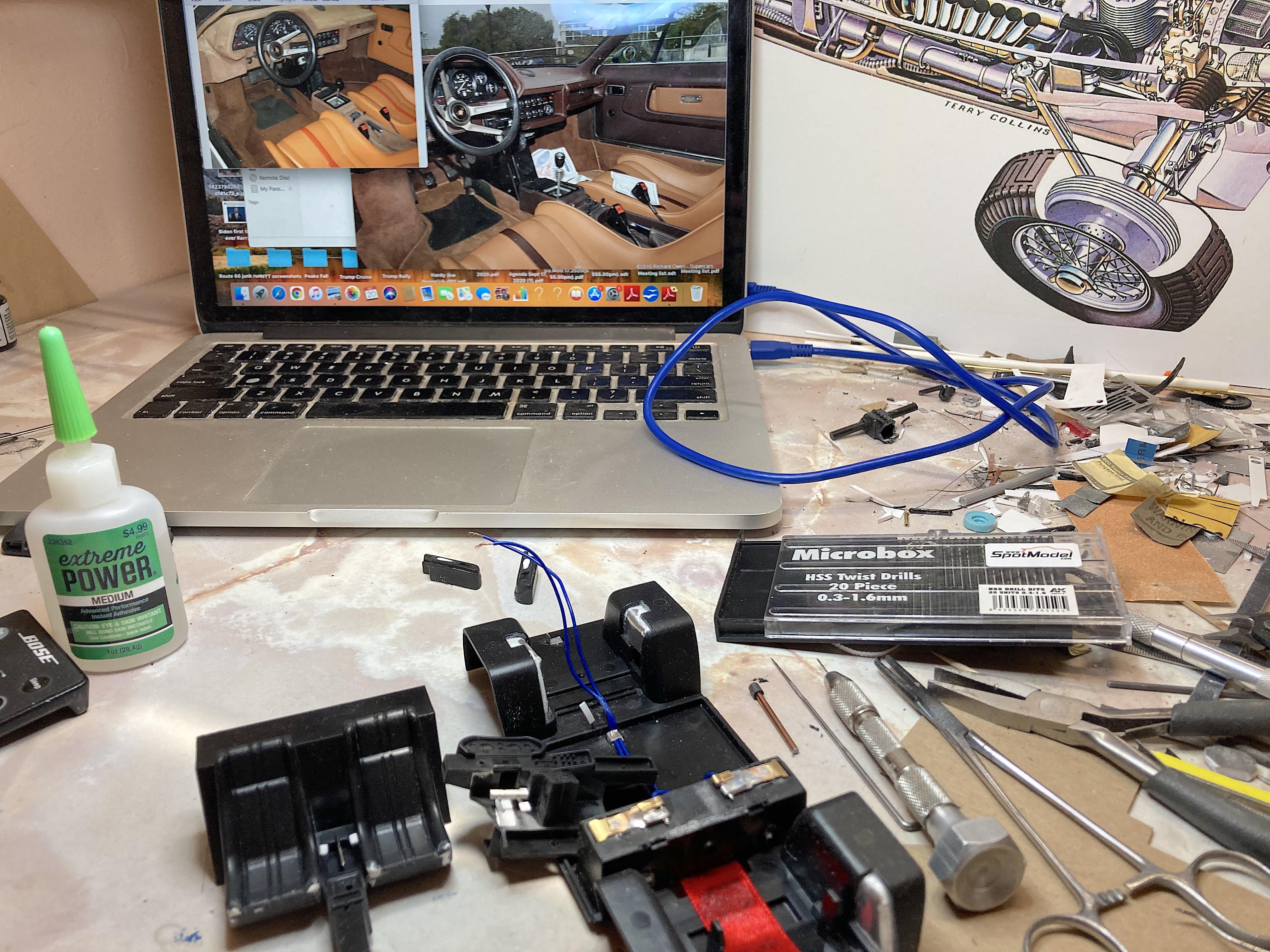

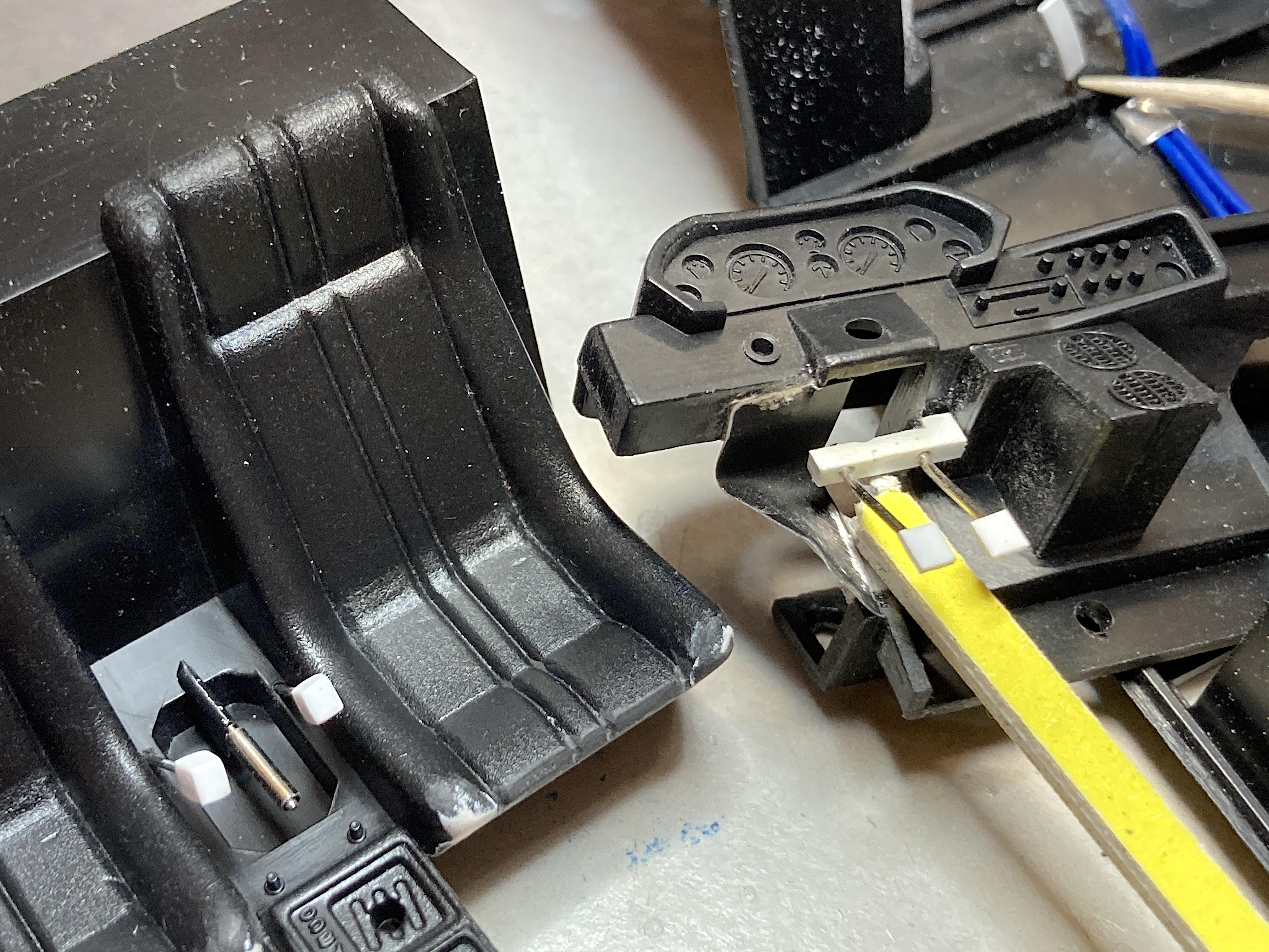

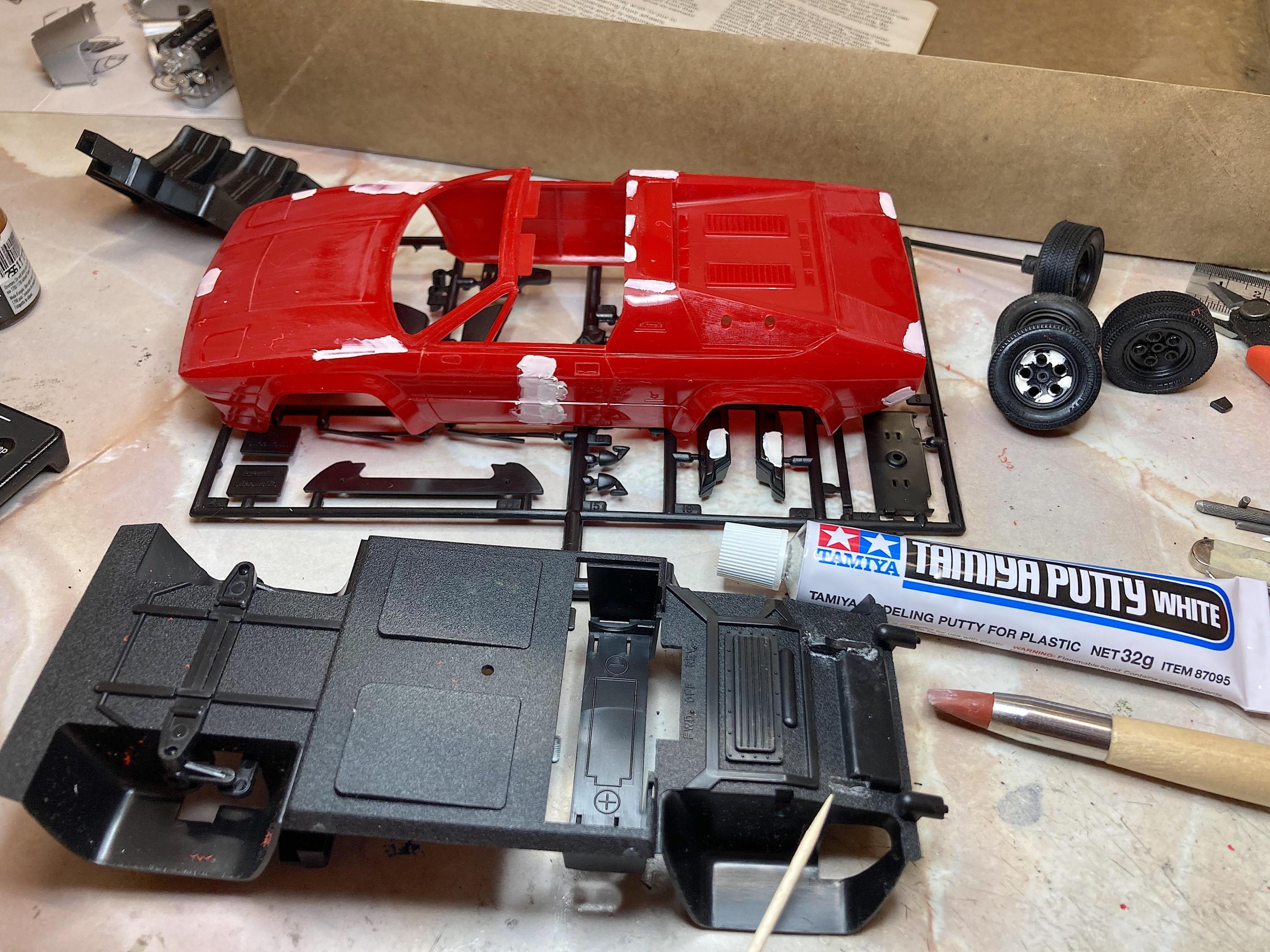

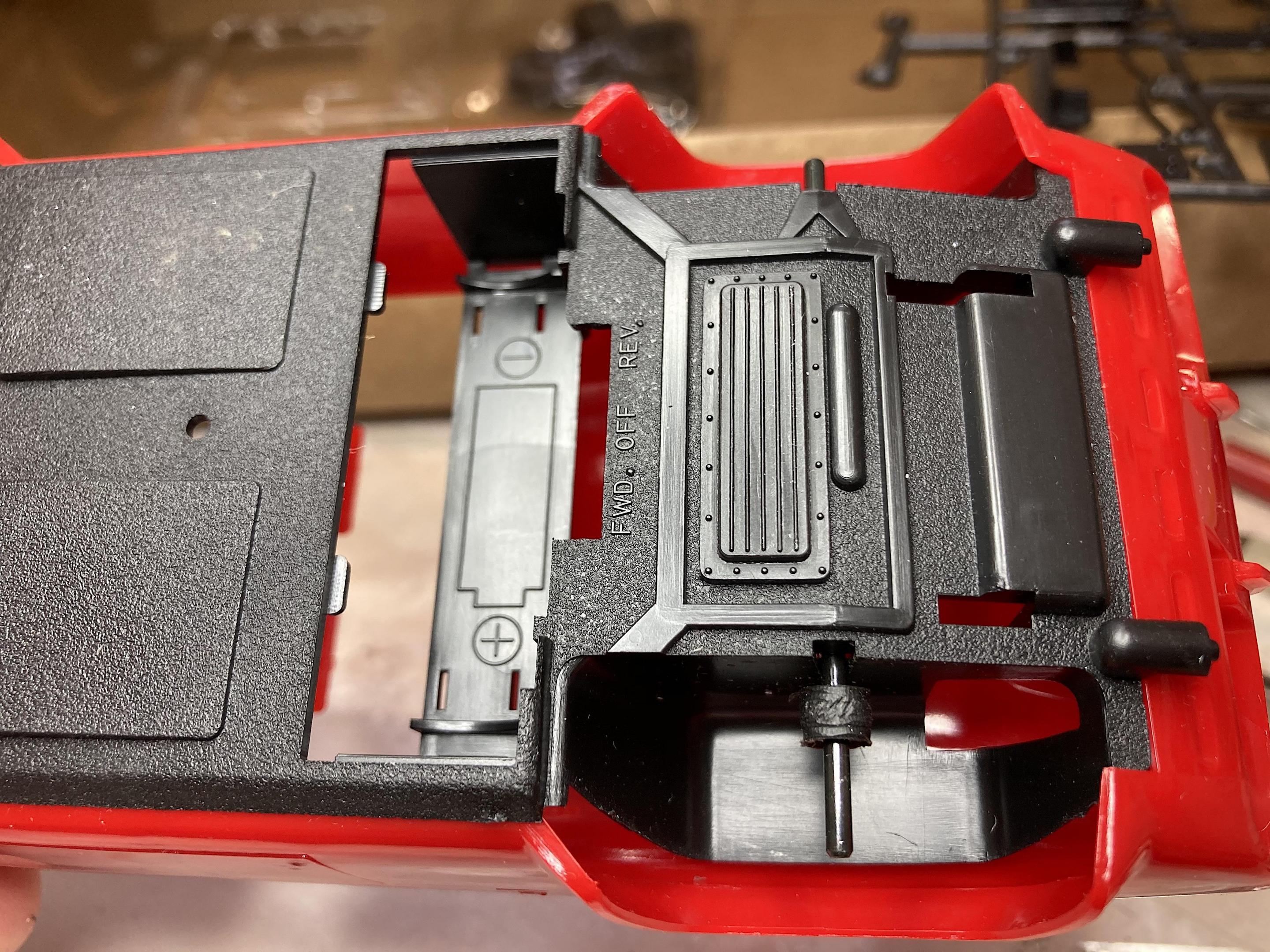

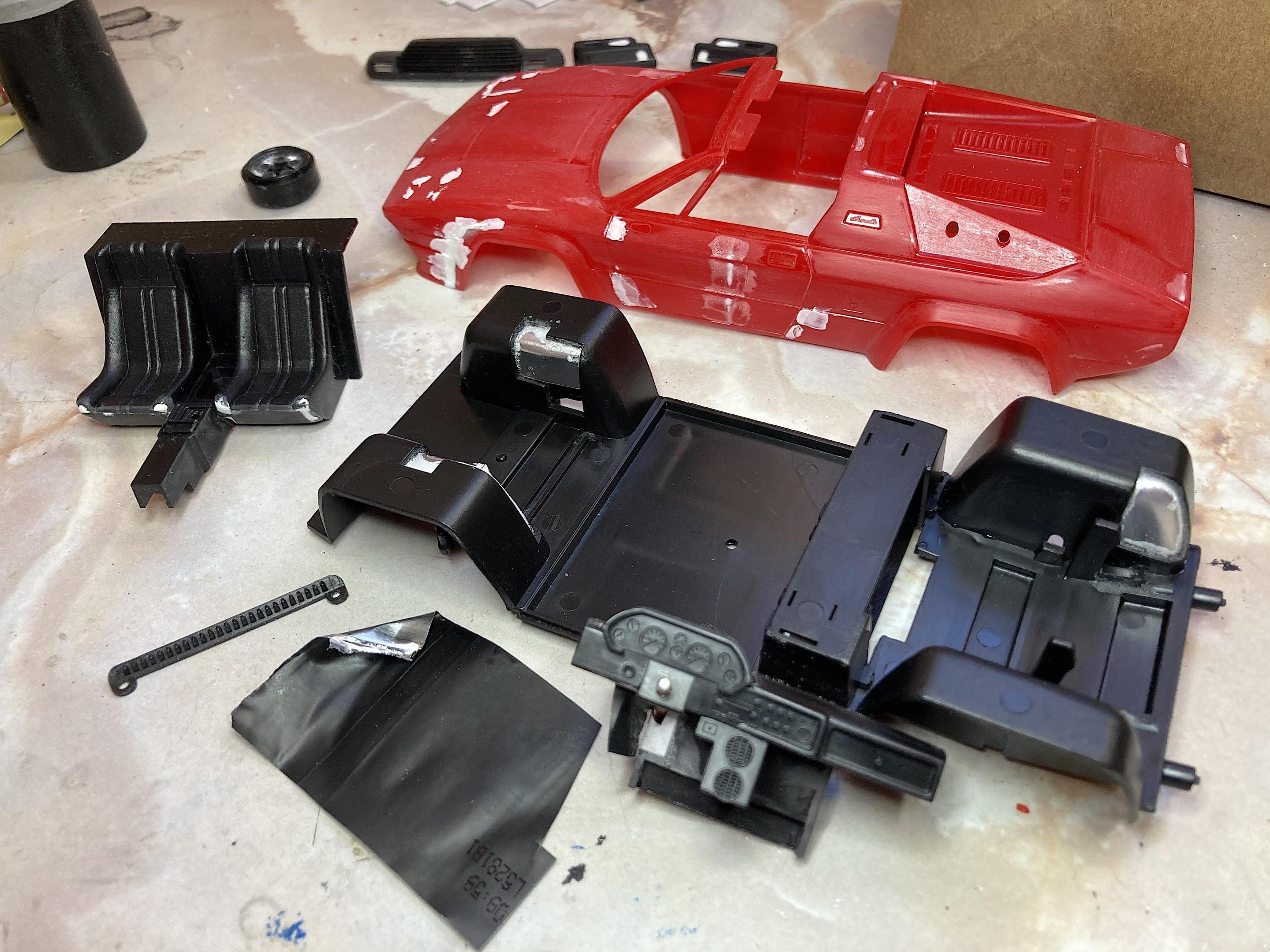

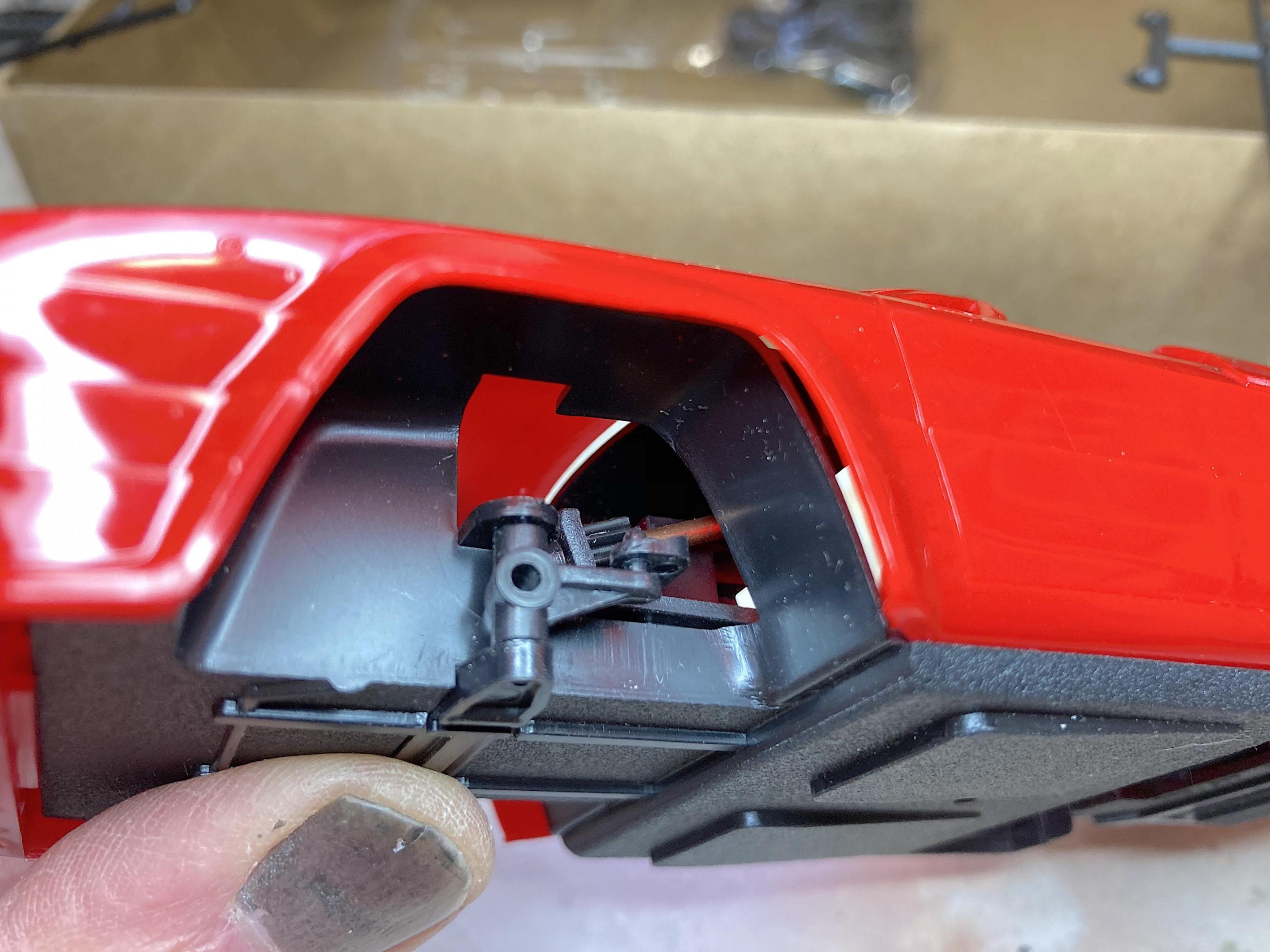

Mocked up the dash and front suspension.  The footwell does not exist, and no pedals.  The hole in the fender well really bugs me.  I dig the moving steering wheel though!
Removed the ring gear for the non-existent motor.

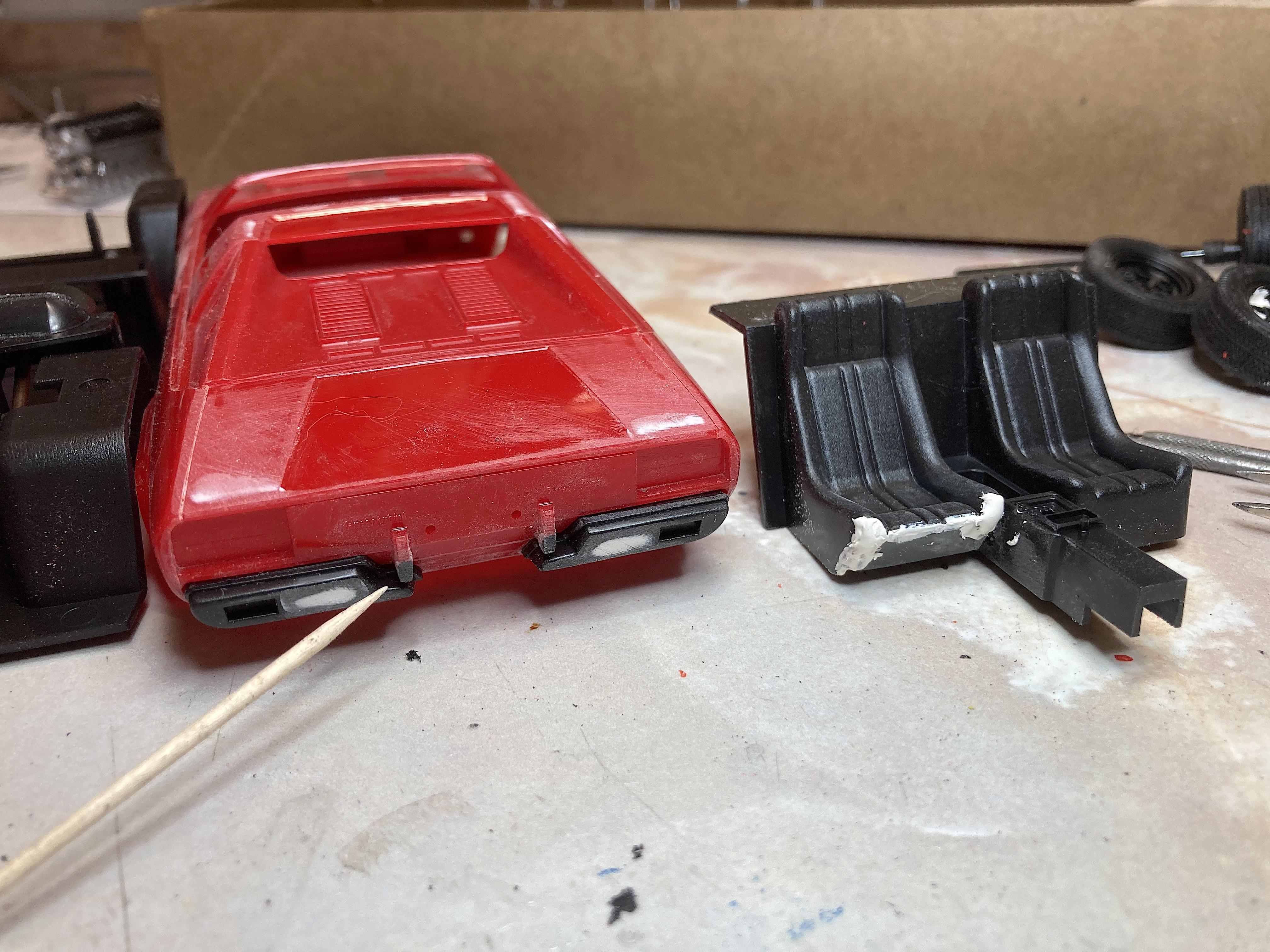

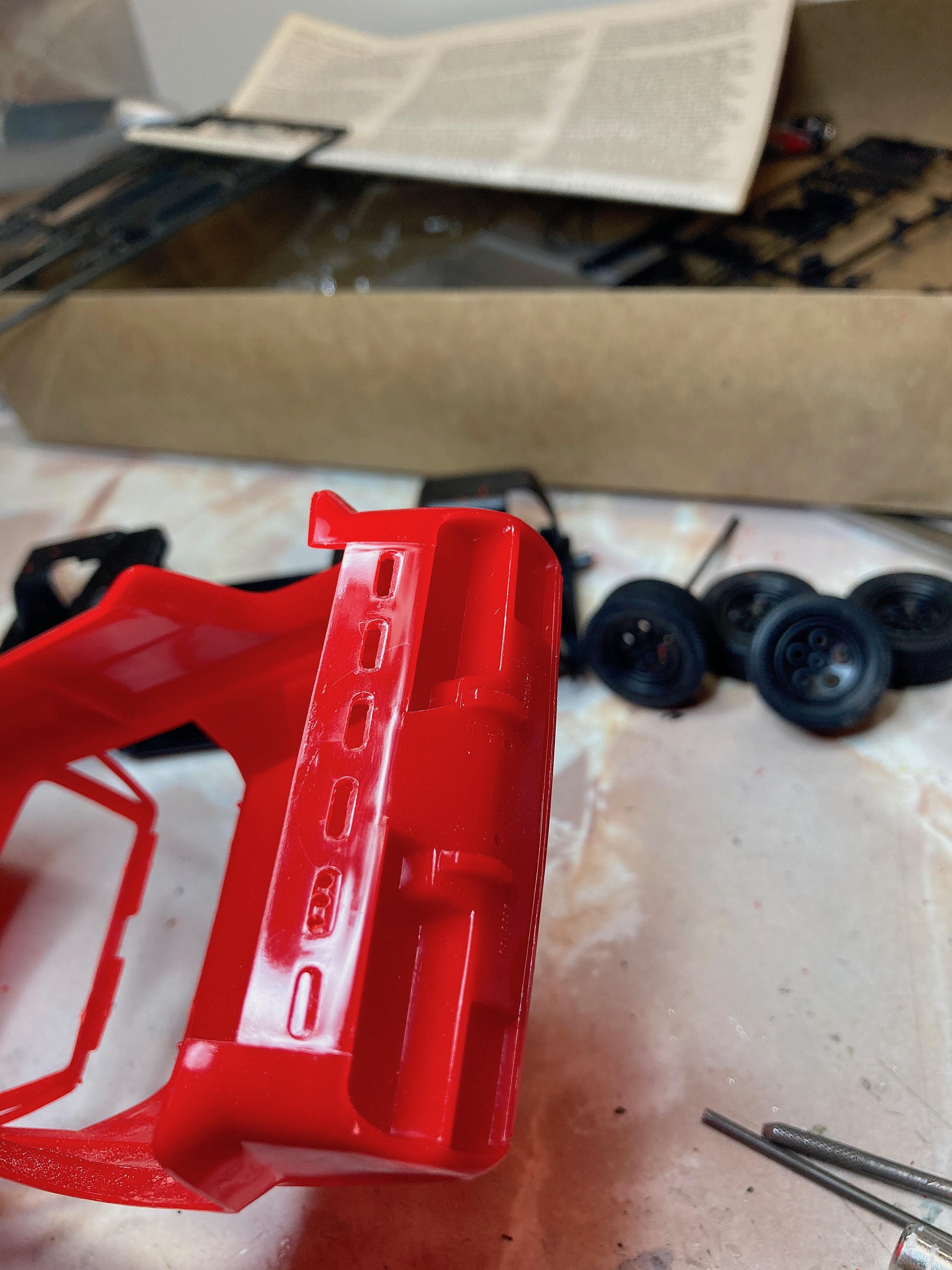

Opened the vents at the back.
Couldn't help myself, filled the slots, using cut off motor mounts (toothpick pointing to).

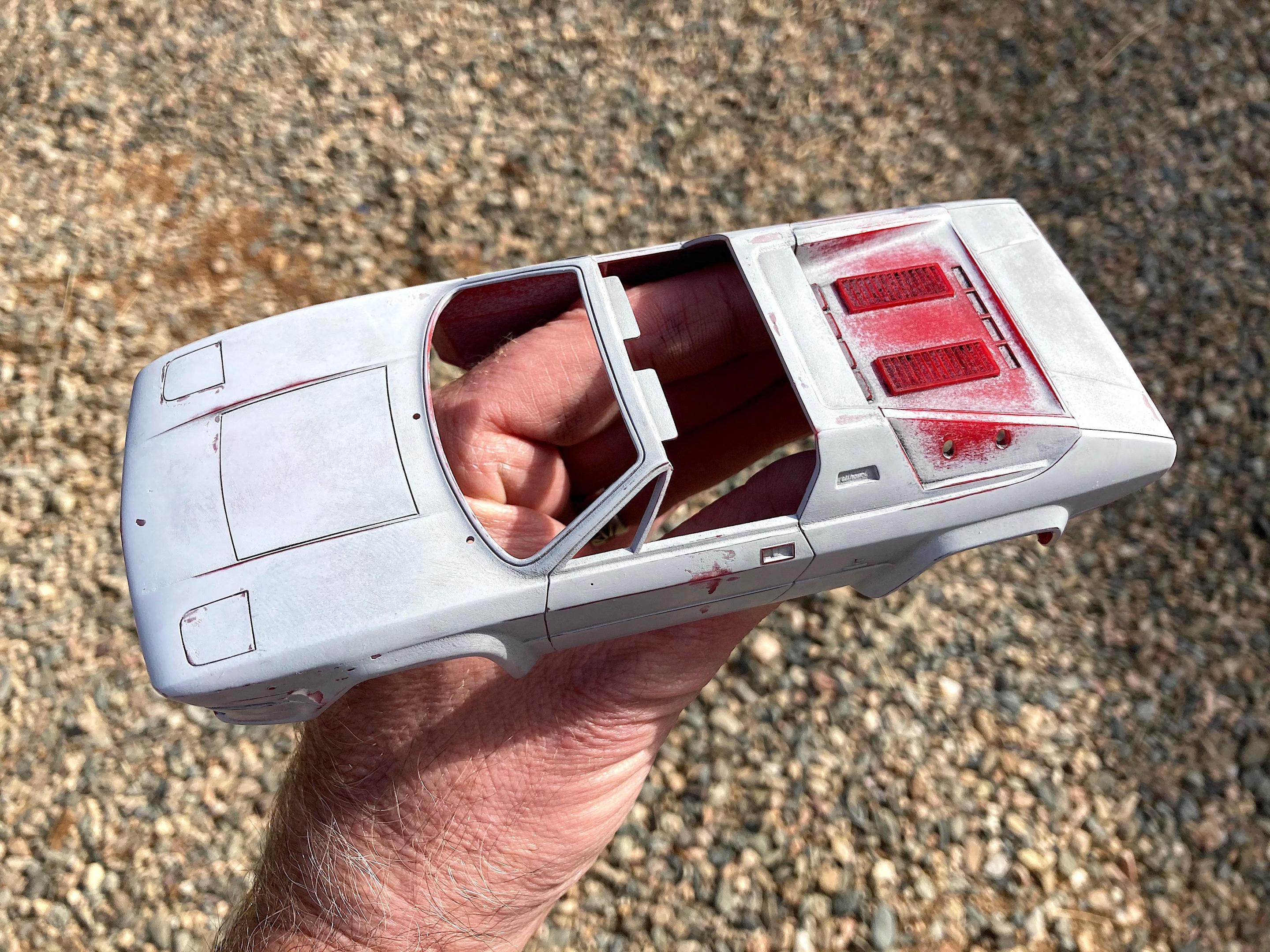

First time I have used Tamiya putty, and the rubber painting tool.  This might be a dreaded red bleed through plastic, it's translucent and stiffer than "normal" plastic, bled through the putty.

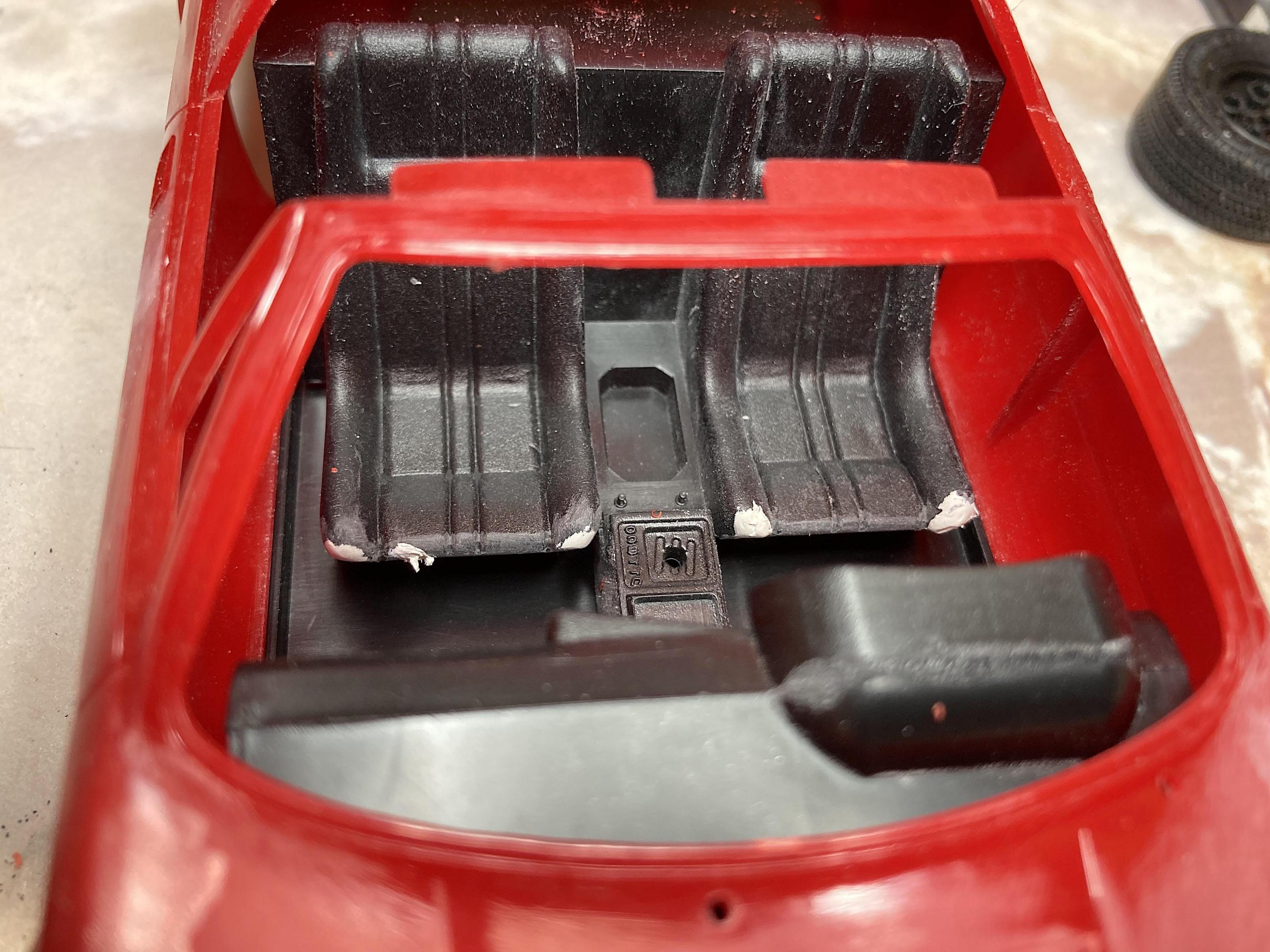

Something I would like to do with the seats, is cut a wedge out, and bend the front under.   It's a pet peeve to see daylight through the wheel wells, could use wine bottle foil and fill the holes.  To add the lights, and the metal parts including the switch, which are not in the Testors instructions, would definitely disqualify for Box Plus.  So I might as well fix the footwell area!   Then I can use steel tubing to make quad exhaust tips.  But that's it....... famous last words
Totally removed from the Box Stock, OOB, whatever class for straight build.  Some things bug me, building what looks good enough.
Fixing the seats, just the front, could cut completely out and fabricate floor and bulkhead, but not this time.  Fixed the license plate light.

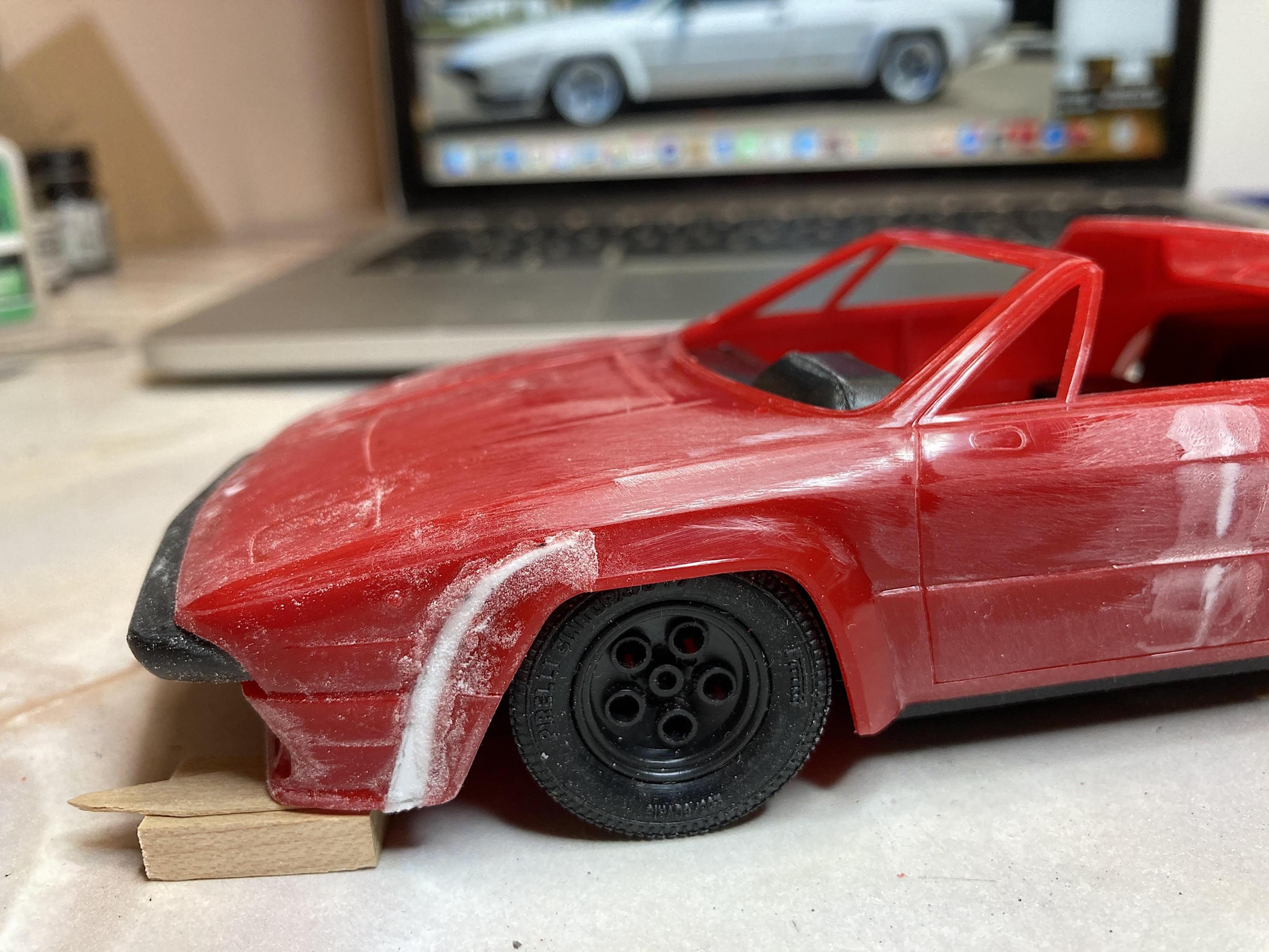

The front wheel flare doesn't look right, decided the front needed to be moved back.  Will reduce the size next, shouldn't be the same as the rear.  Such a shame the tire aspect ratio is wrong, but will live with that.
Noticing the greenhouse is a bit lower than the real deal, leaving that alone.  This white car is a prototype, the door mirror is not like the kit, which is a good thing.  ?

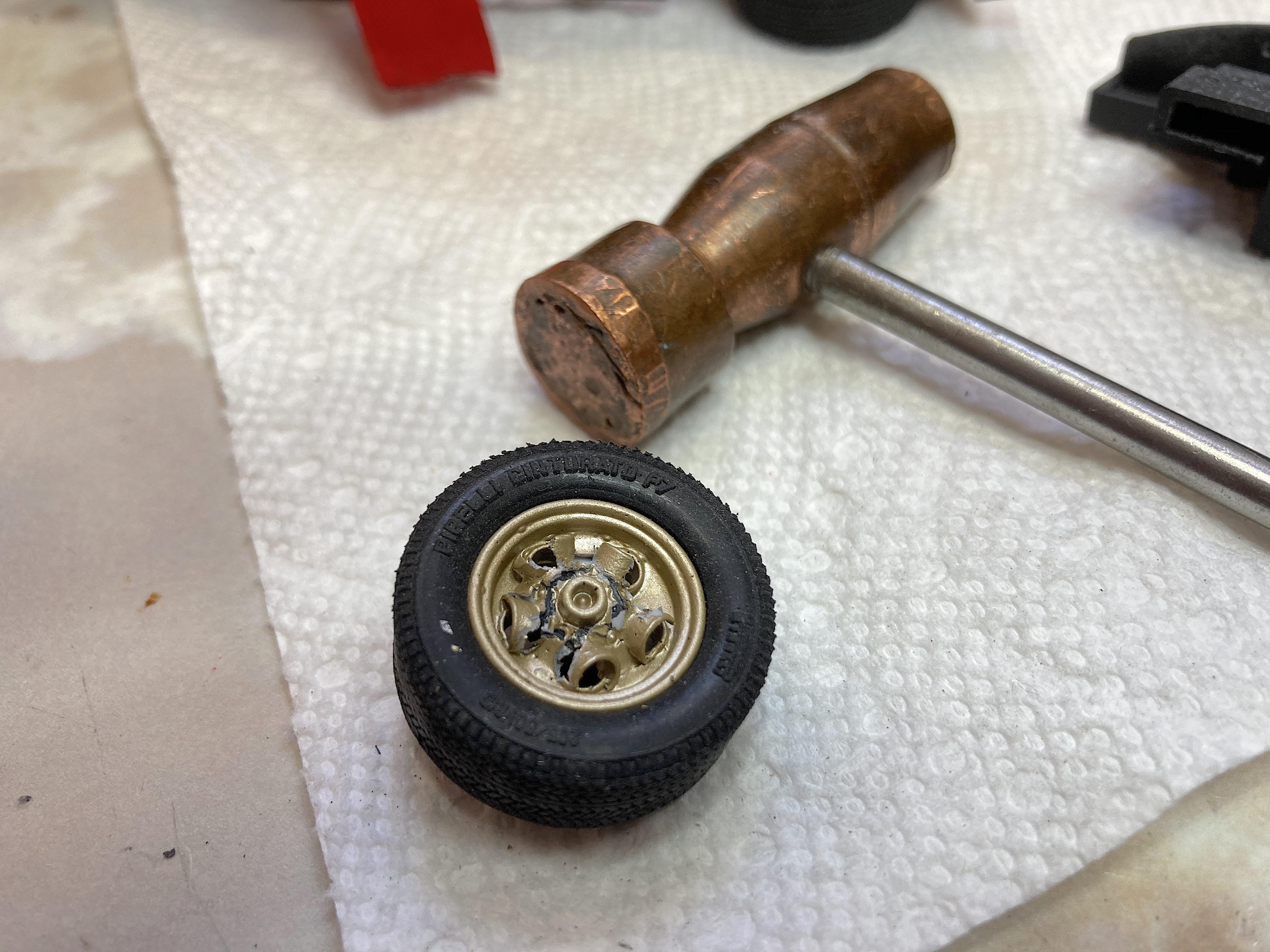

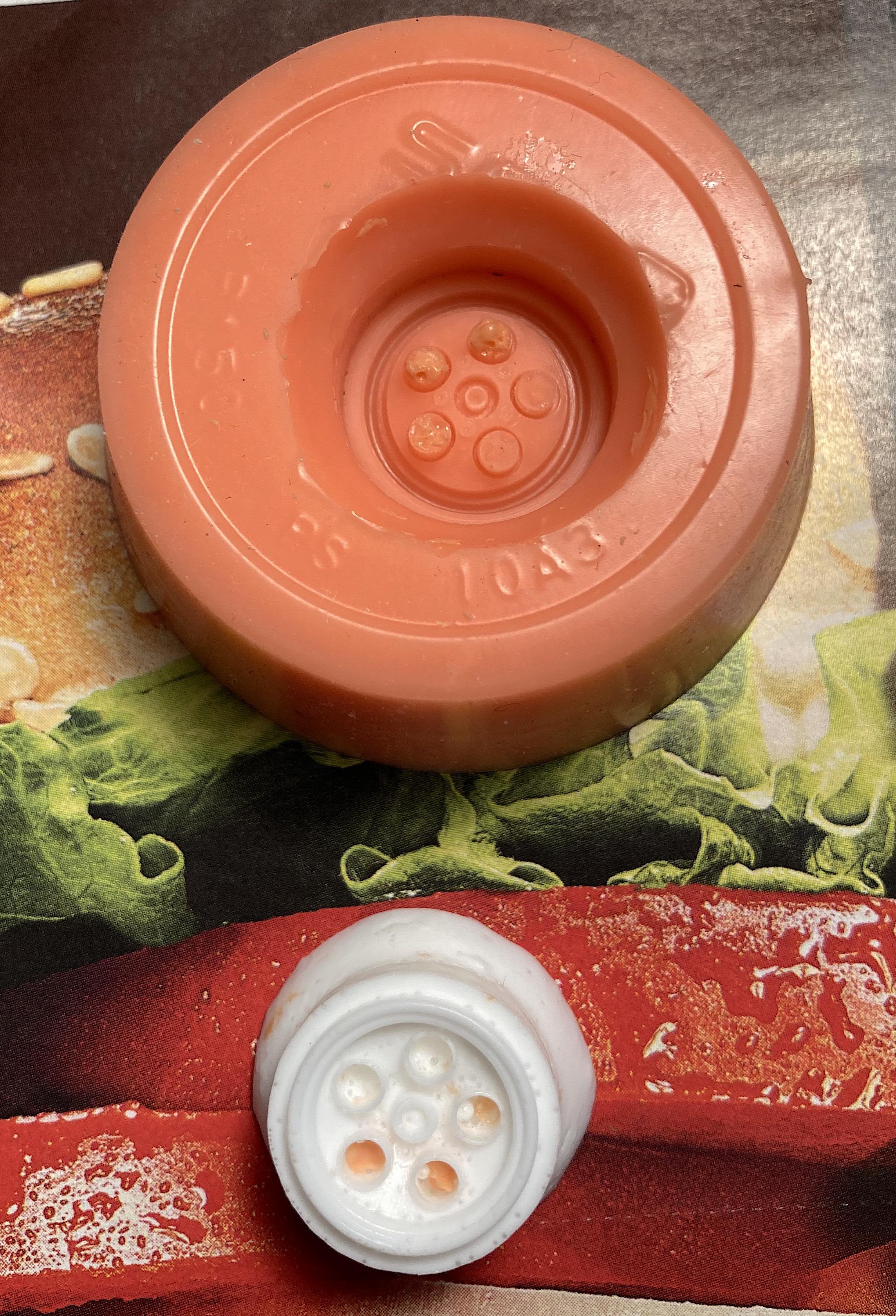

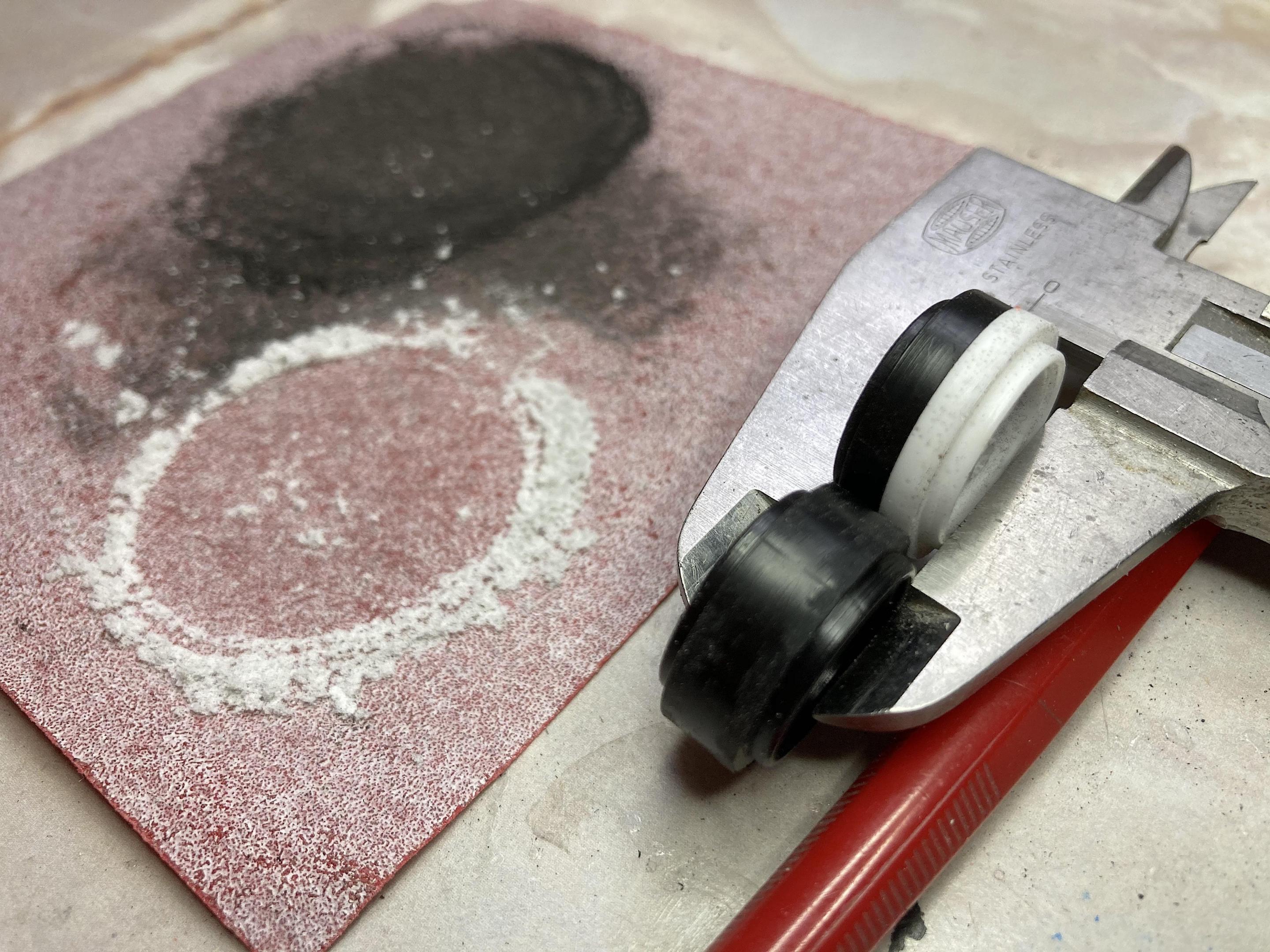

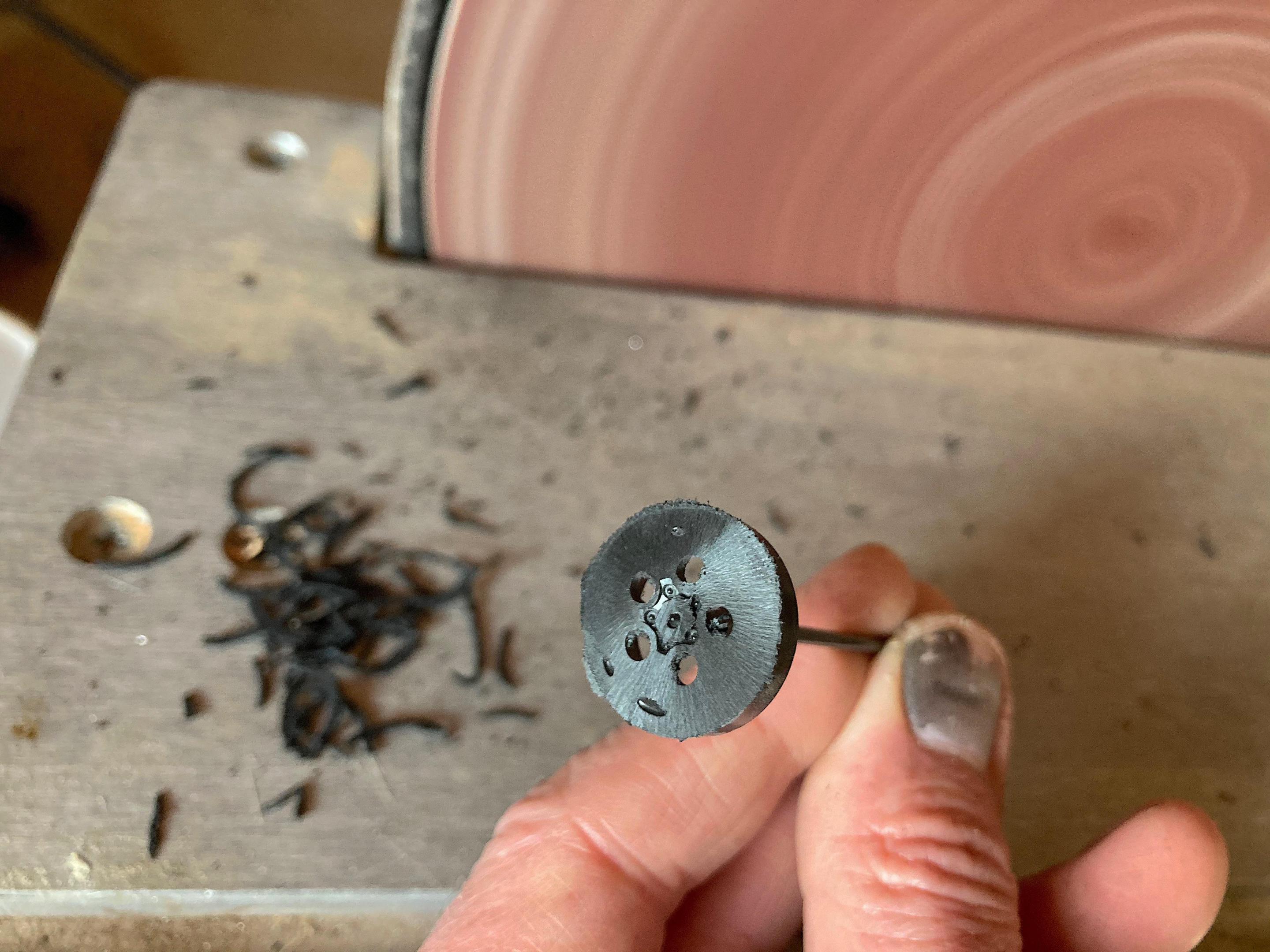

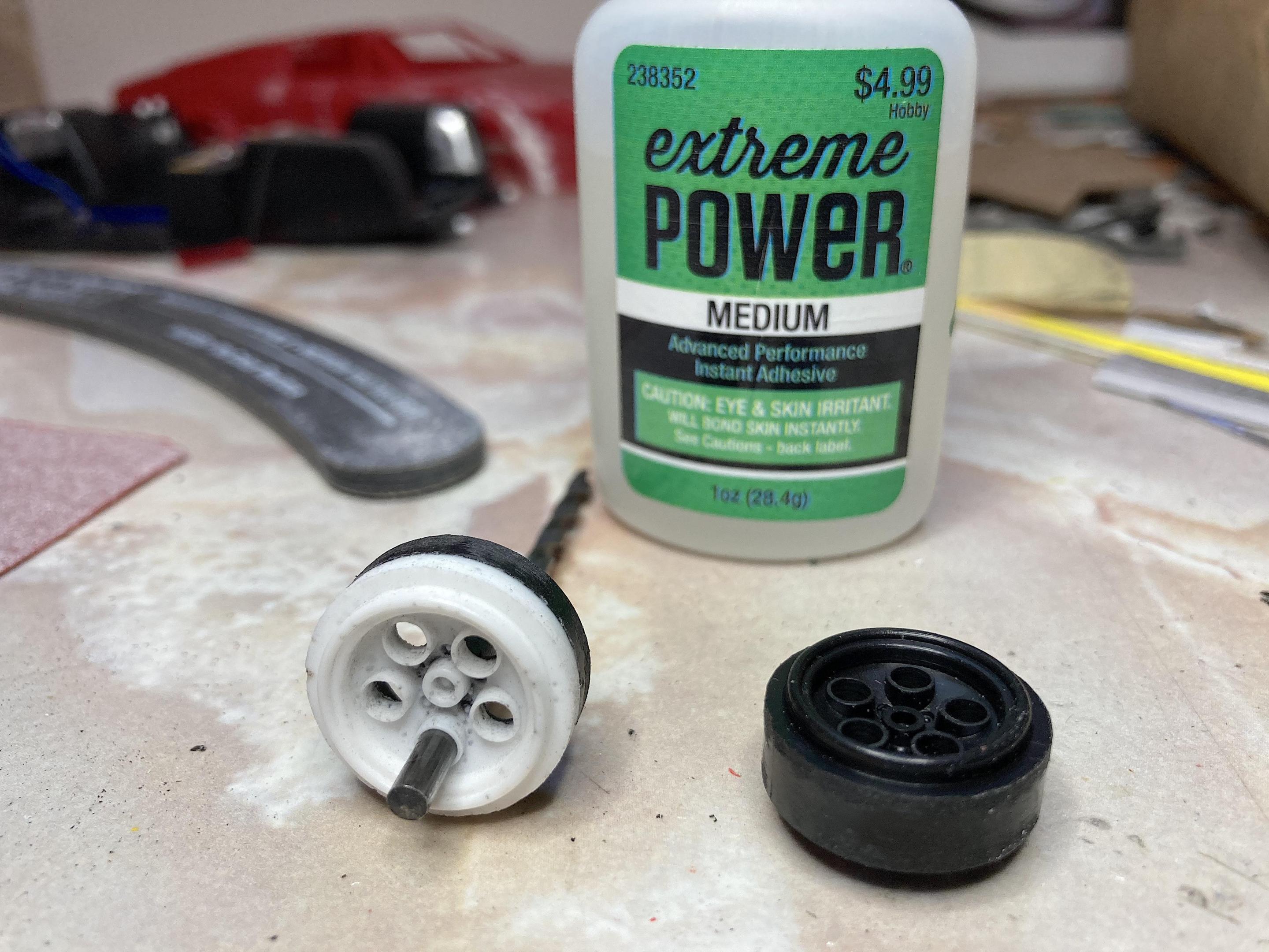

After really screwing up the bad wheel, decided to cast a resin copy.  I could have stolen one from the other kit, but that wouldn't be cool, and will throw a resin copy in that box.  Fixed the other front flare, started to refine the shape and added some putty.  After wet-sanding the body, saw all the other low spots, so putty on those.  Also drilled the wheel holes to .113".

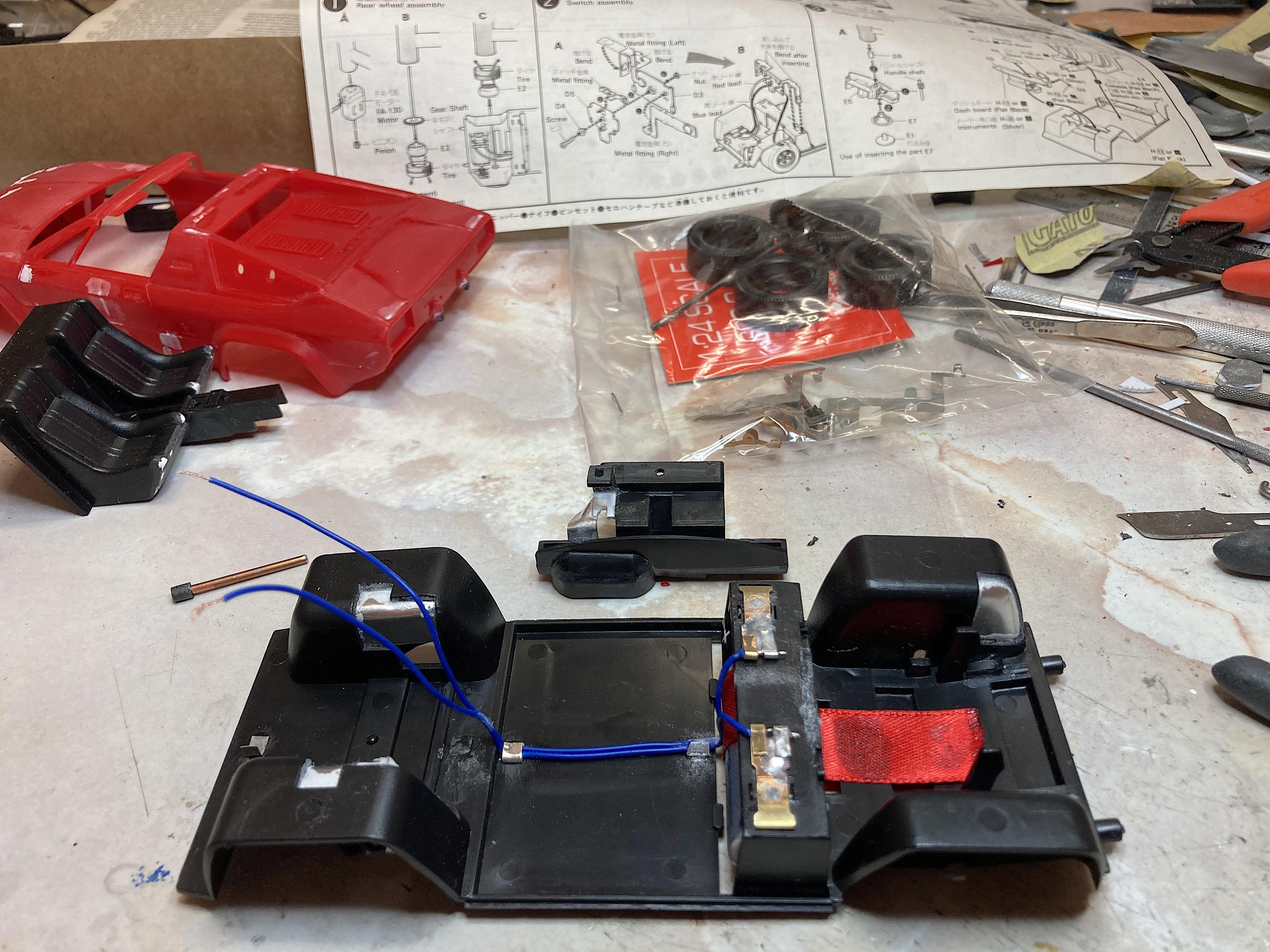

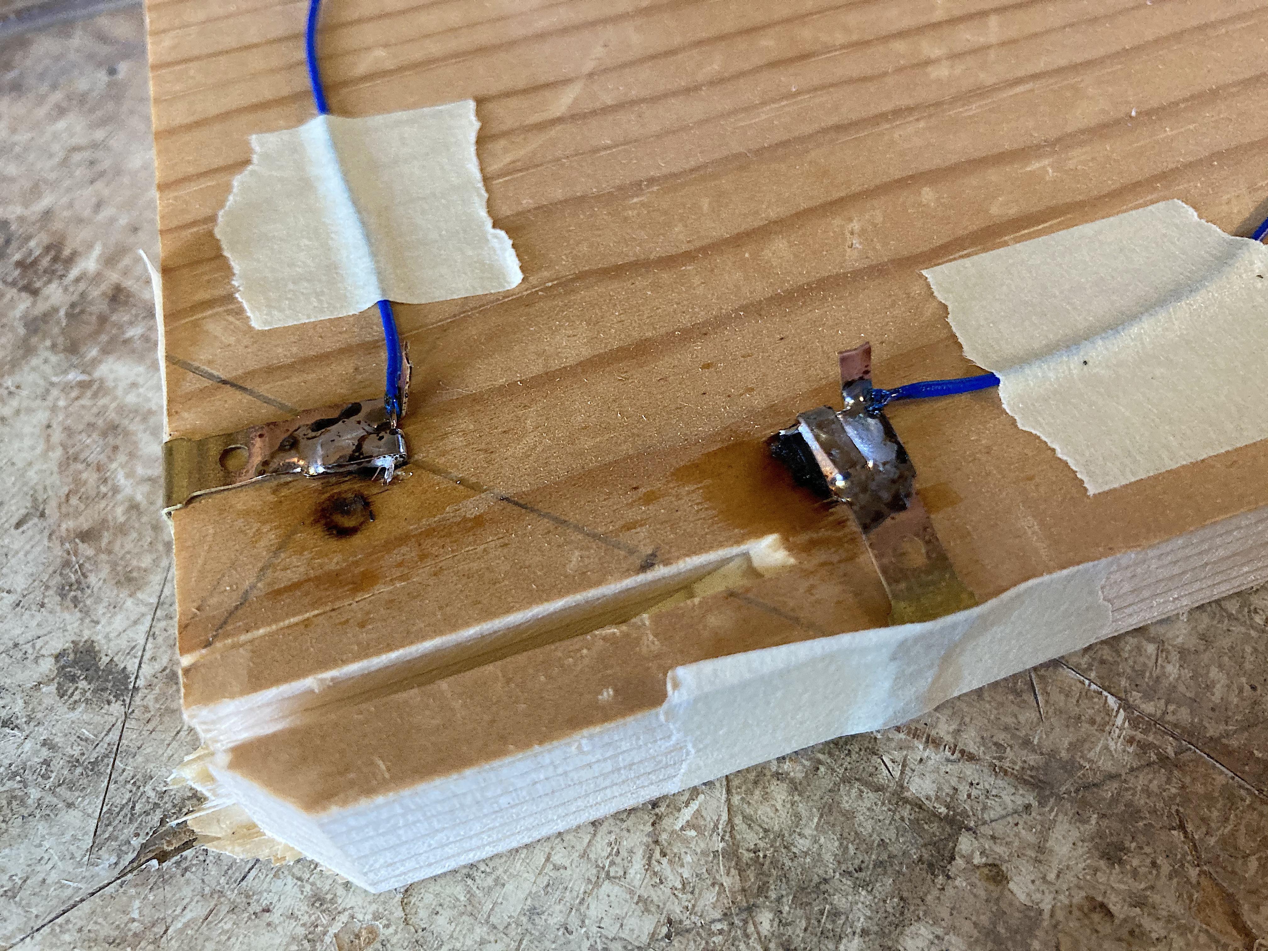

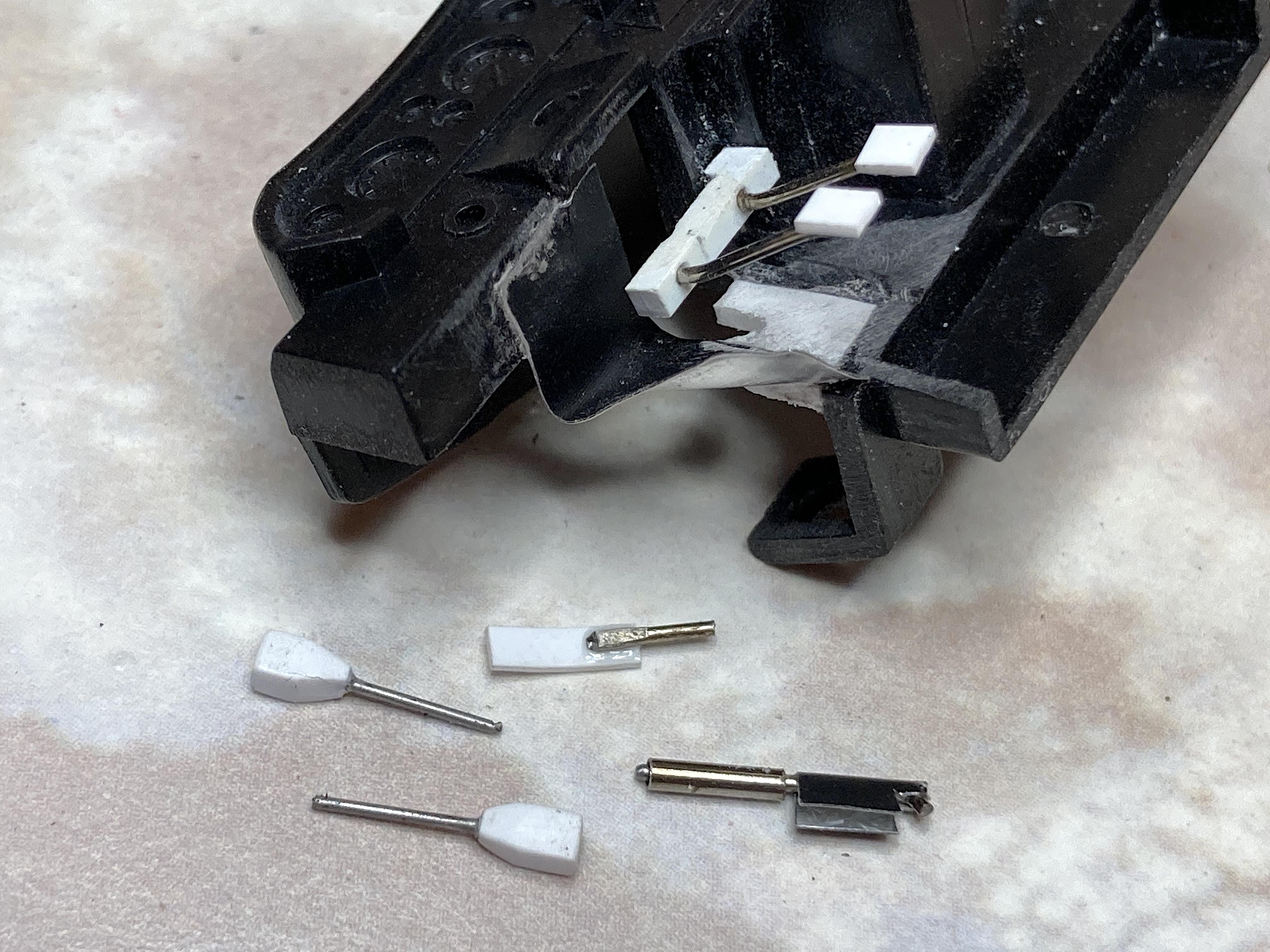

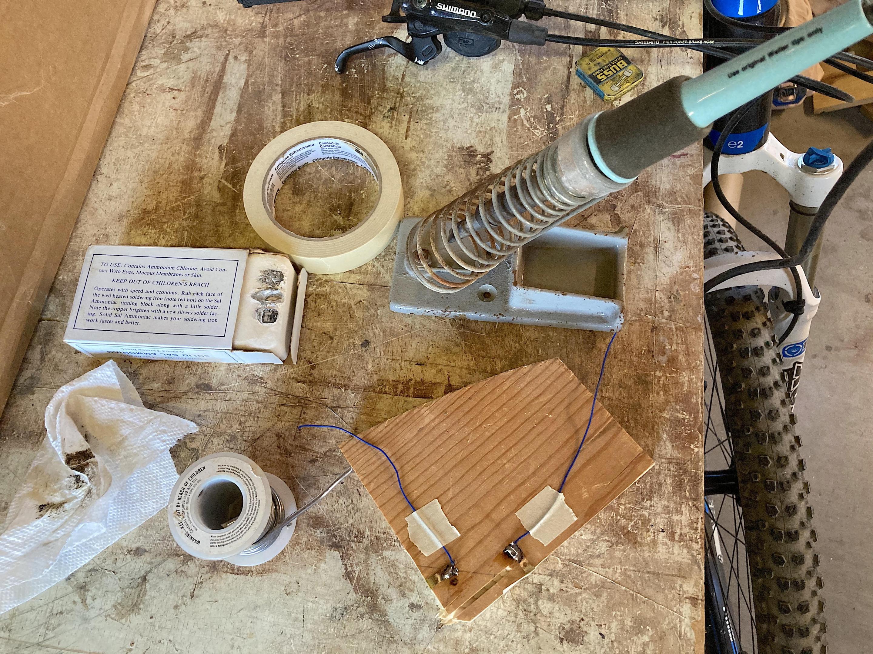

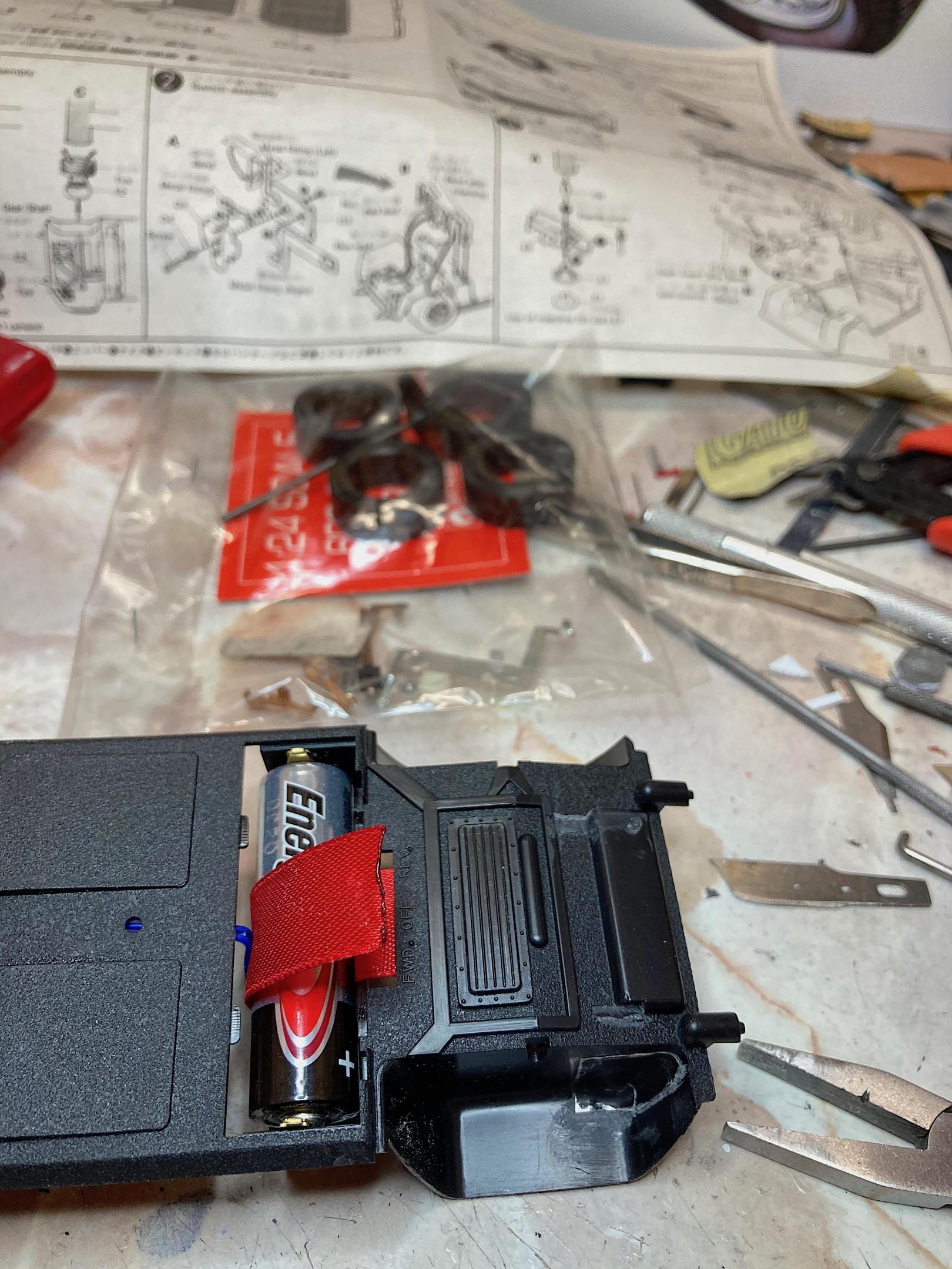

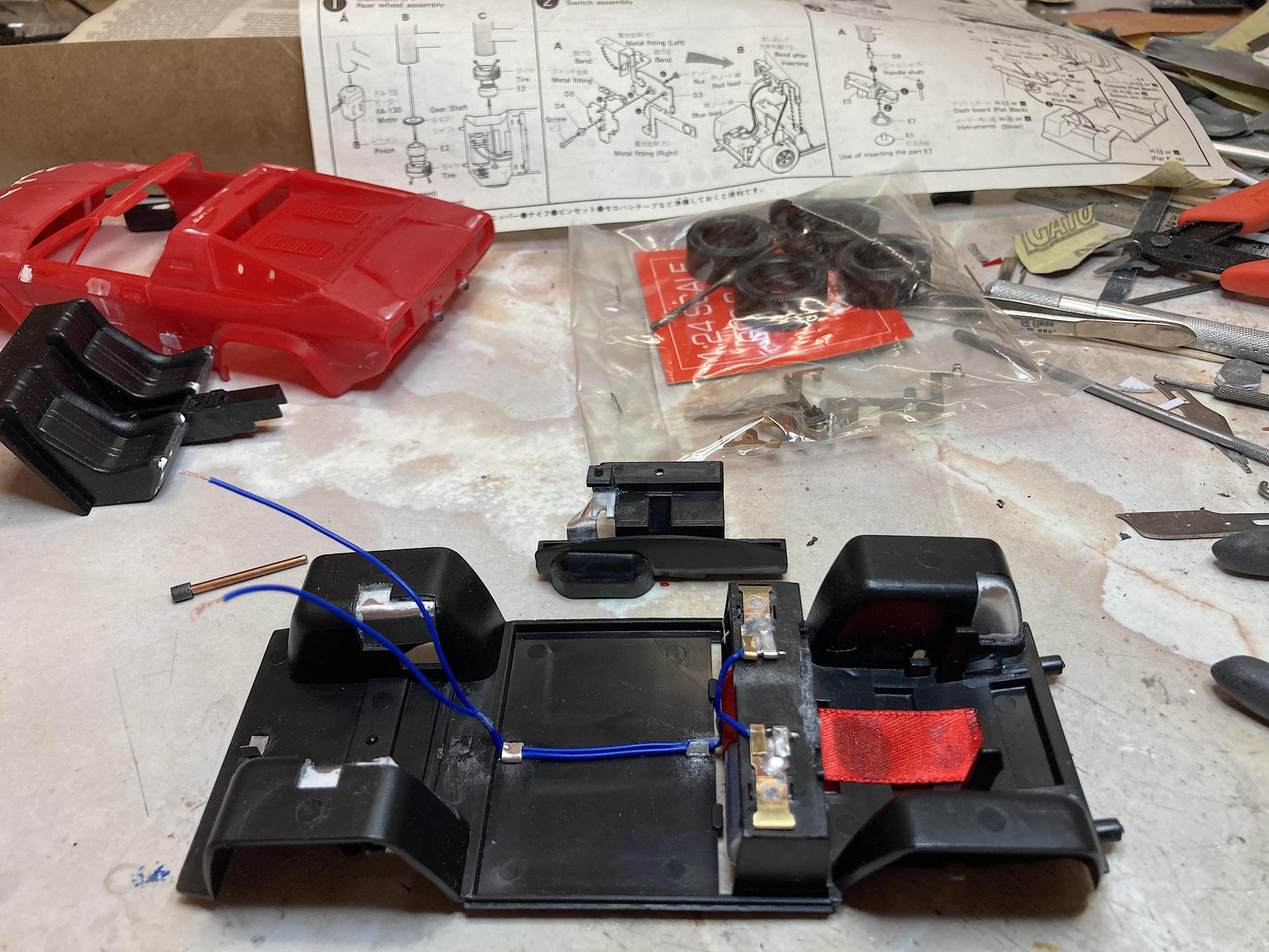

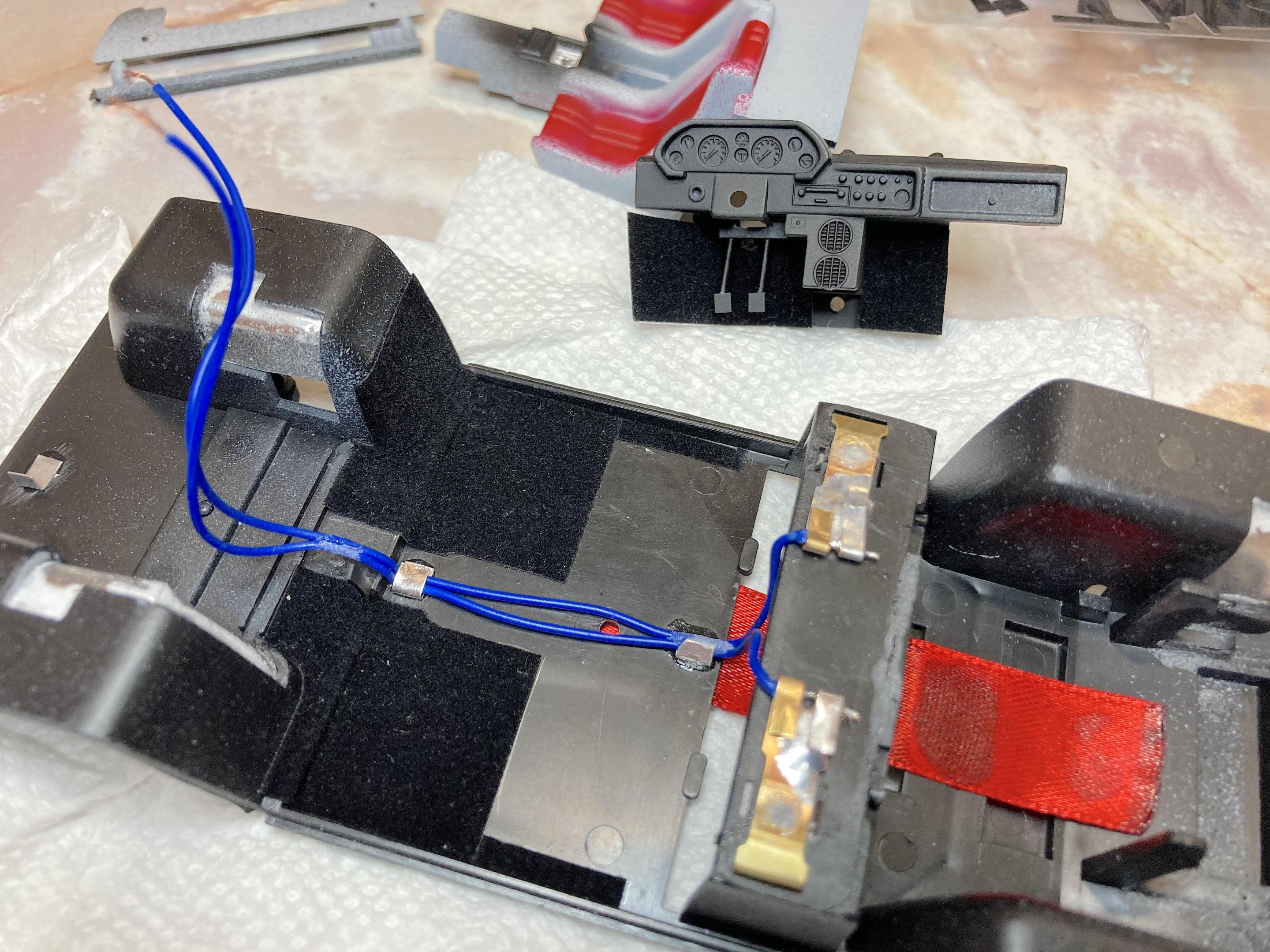

I could have used the other kit's battery contacts, but didn't.  I had just converted my utility room fluorescent light fixture to LED (without the ballast), had salvaged the brass from the 'shunted' terminals, and thought this would work.   Got the stained glass soldering iron out, and made this:
Instead of figuring out a switch, glued in cigar ribbon, to pull the battery out to turn 'off'.  Coffee can lid used for the wire thingies.  Drilled a hole in the 'firewall' for the wires, guess the giant gap was supposed to be where the wire was to run. ?

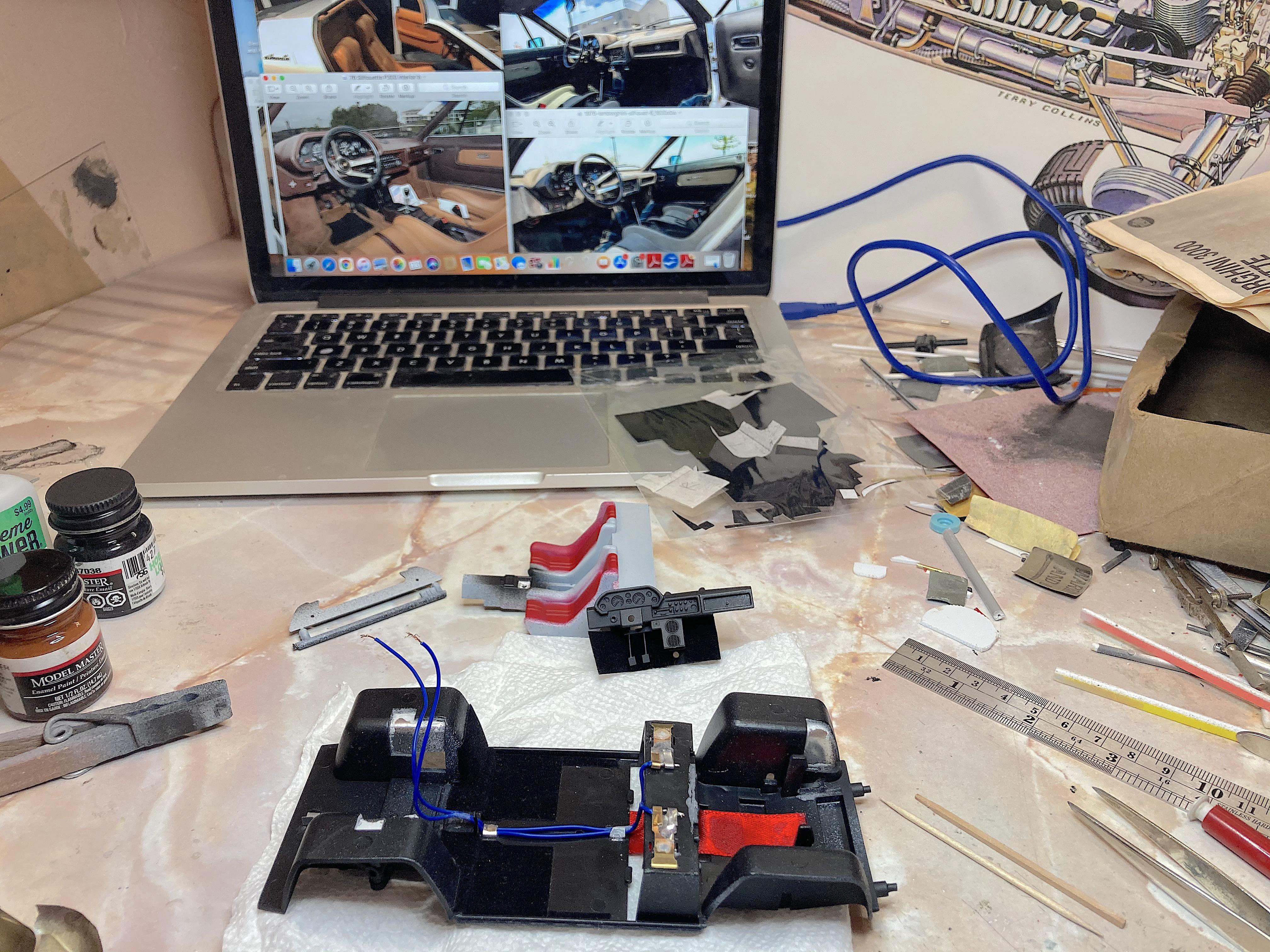

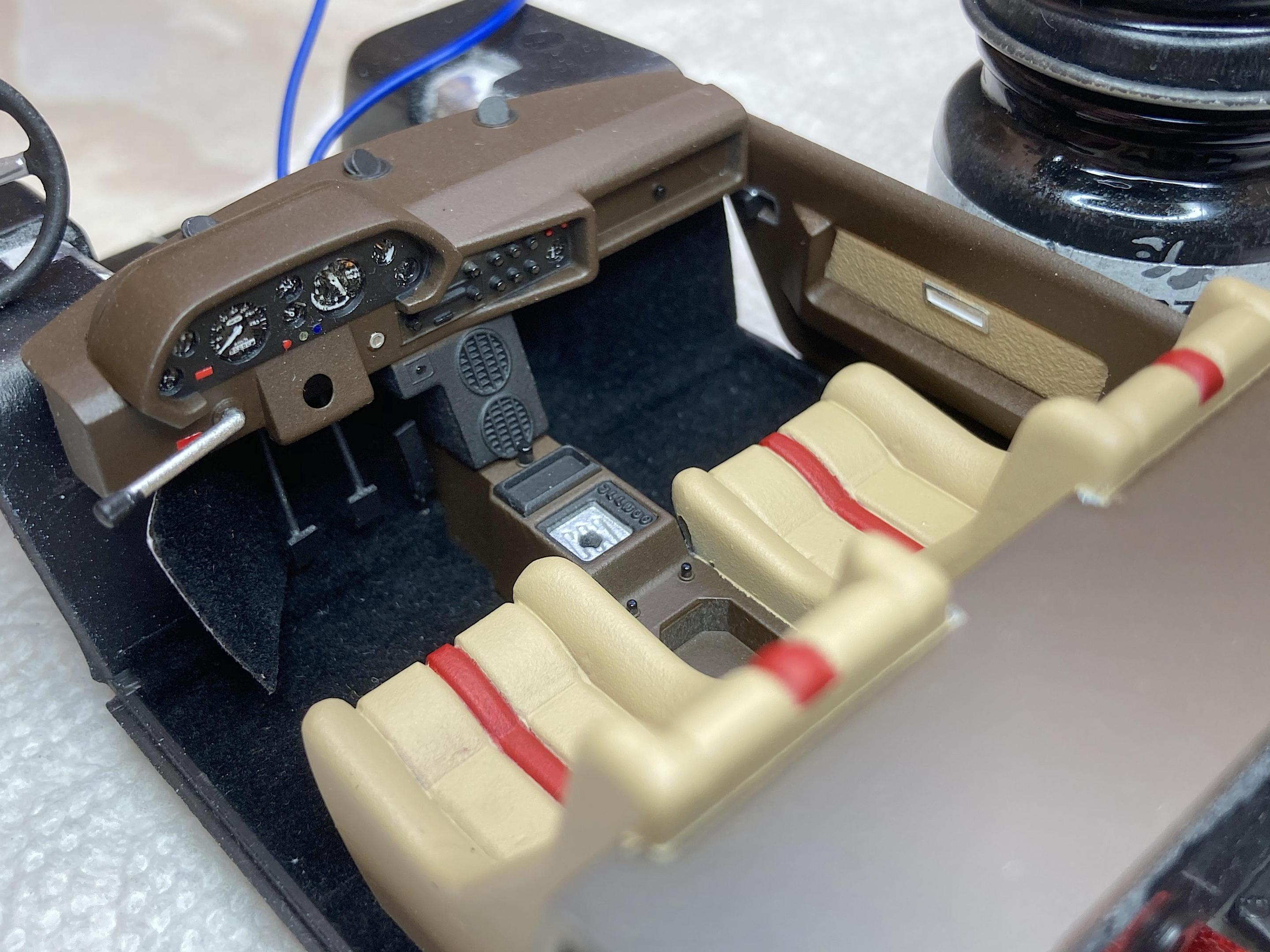

Interior details whipped together.
Gas, brake, and clutch pedals.  Handbrake, seatbelt buckles.
Second try at casting a new wheel.  What remains in the holes is Silly Putty.  My first attempt failed because I didn't shake up the part a/b bottles enough first, mixed the heck out of this batch resulting in all the bubbles.
"Fixed" the wheel, had to be careful how much from each half to remove.

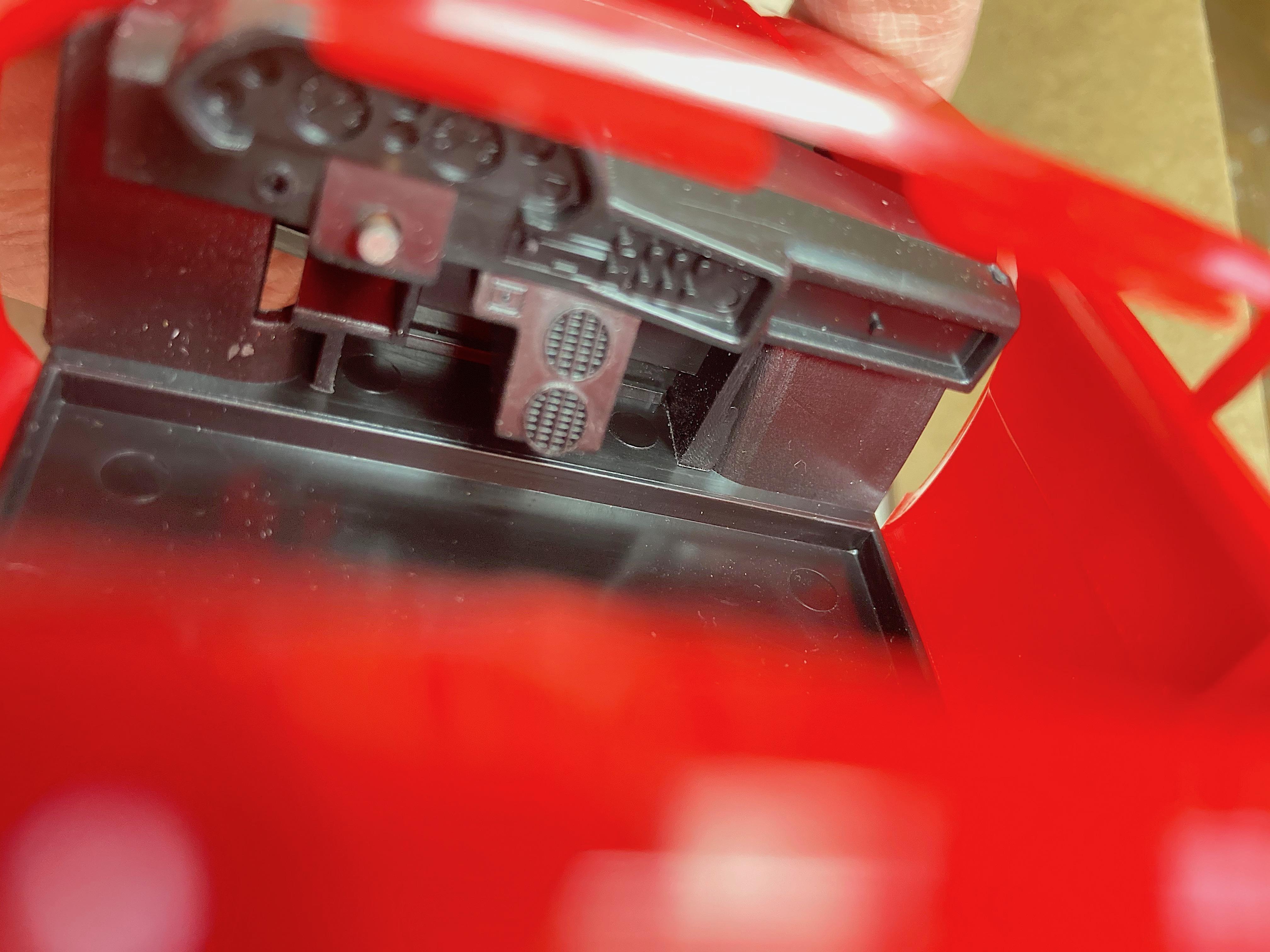

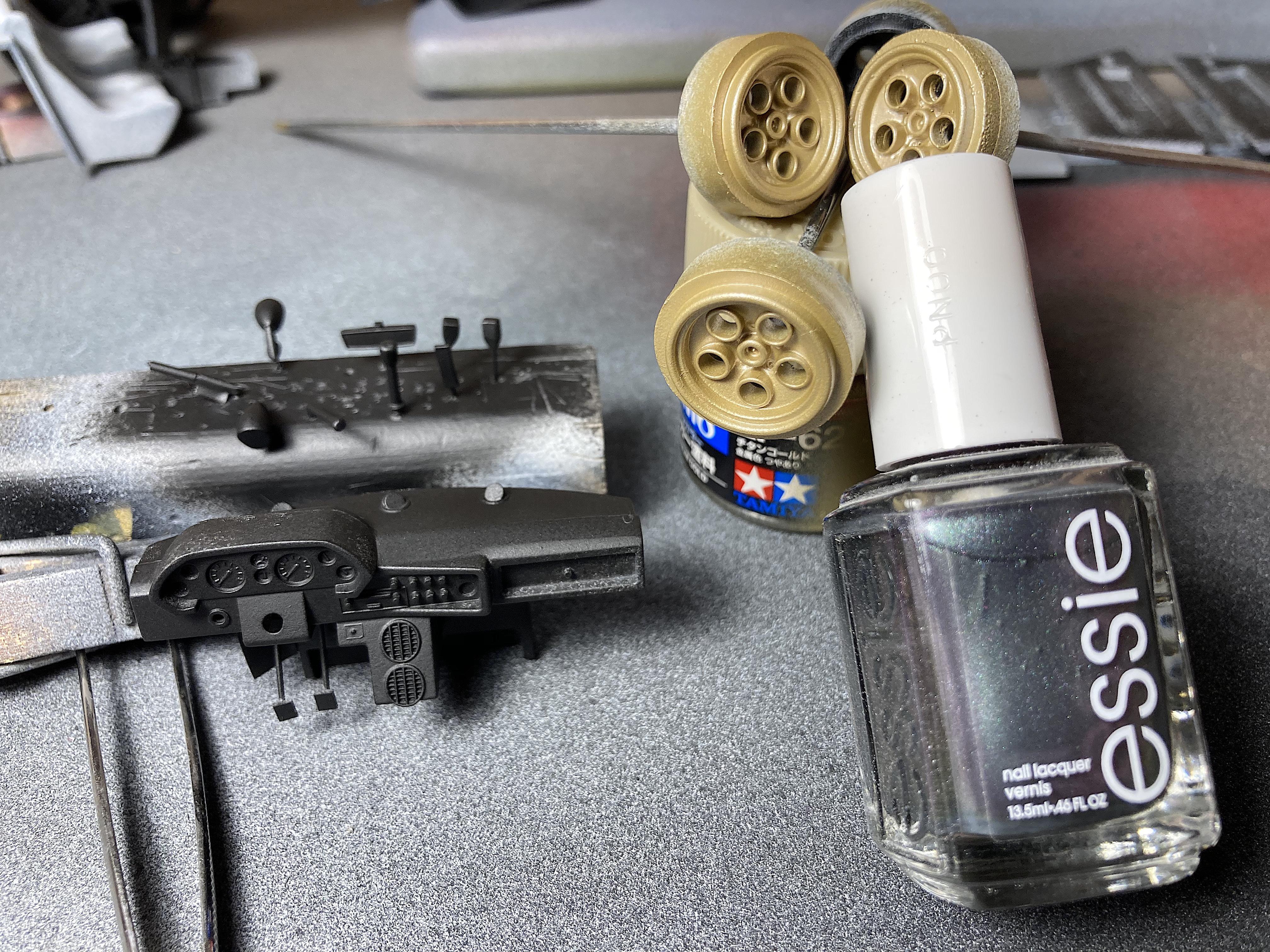

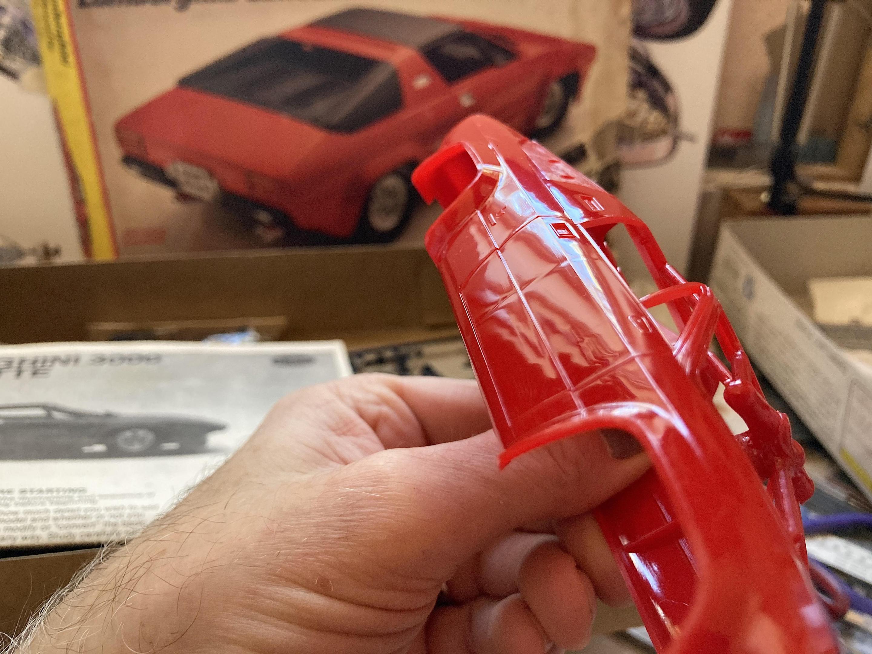

Because of how the mold is done, there were no dash vents.  Based on one picture, fabricated them.  First was drilling a small hole all the way through, then a bigger drill the size of the inside of the Replicas & Miniatures of MD photo-etch rings, then punched out aluminum disks with the Waldron tool.

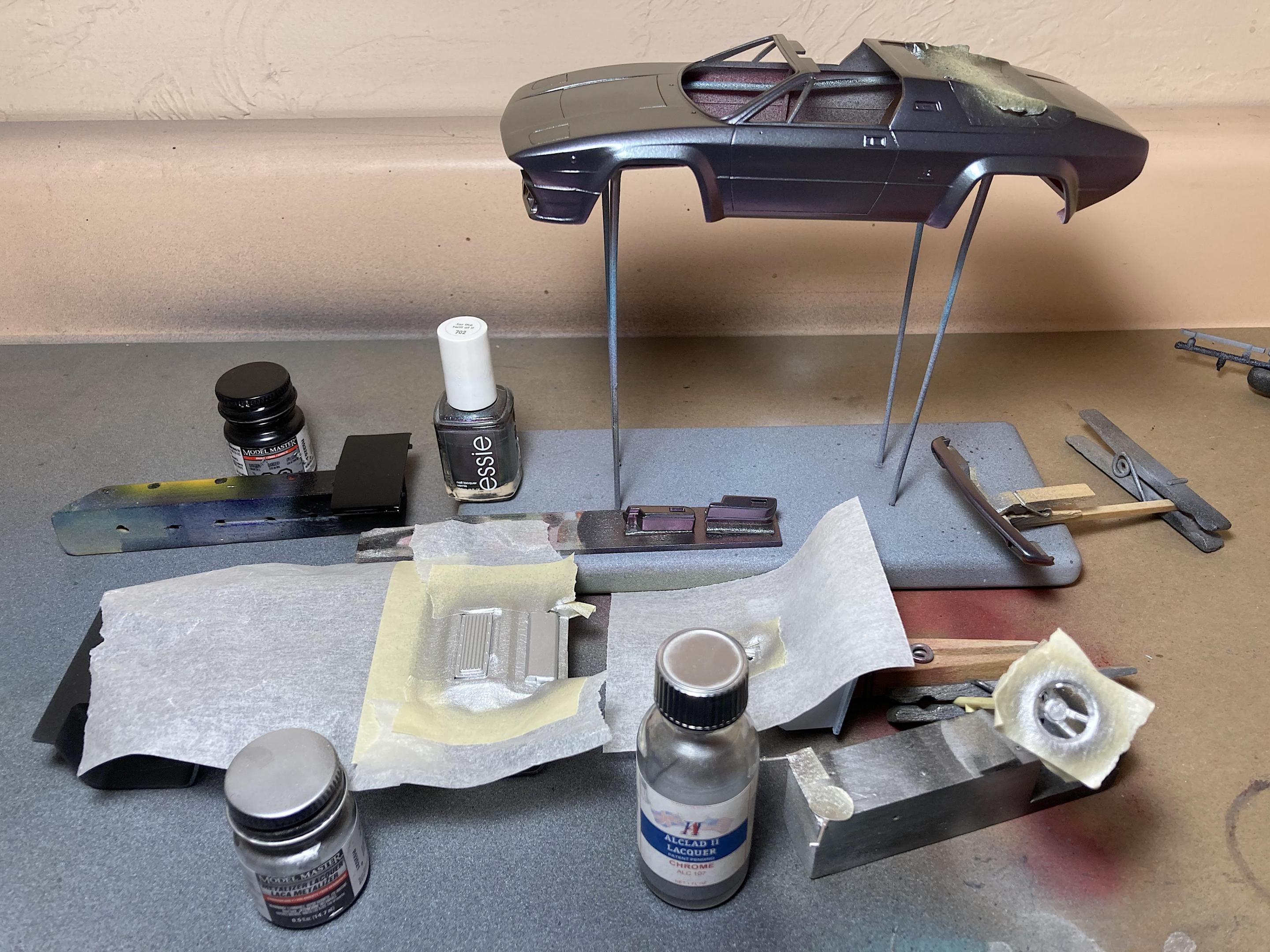

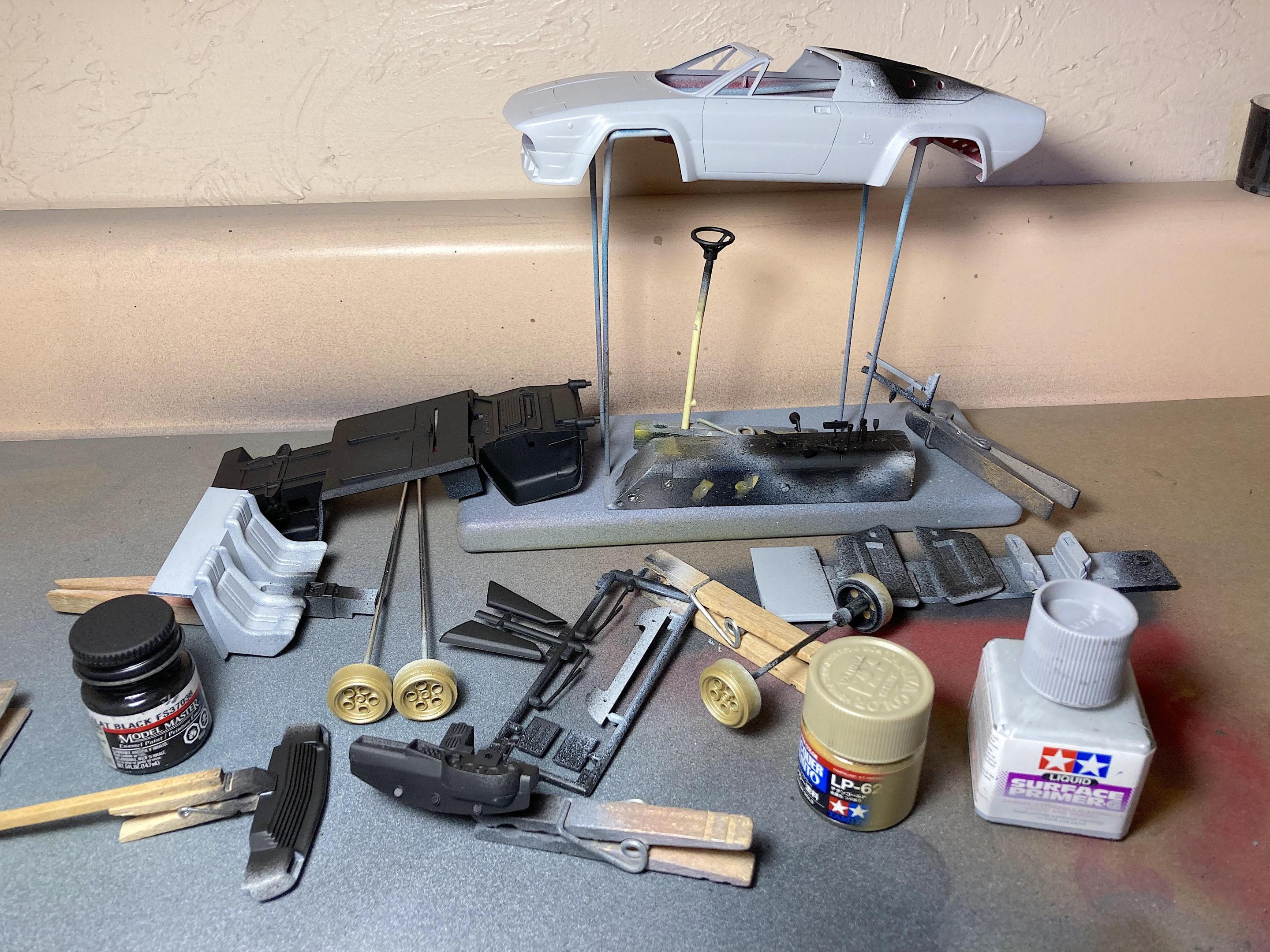

Finally got to painting.  I've noticed the kit's plastic holds a static charge, part of the reason was my polyester blend t-shirt and sweats, stripped down before painting so everything drifting in the air didn't land on the paint.  Tamyia primer, and gold, plus Model Master flat black was done.
I hope this nail polish color compliments the wheels.
Spent most of the day painting.  Needed to refine the front flare, the horizontal creases needed work.  Touched up the primer, then quick wet-sanded, then painted the nail 'polish'.  Also painted Model Master aluminum; the shifter and turn signal got Alclad chrome.

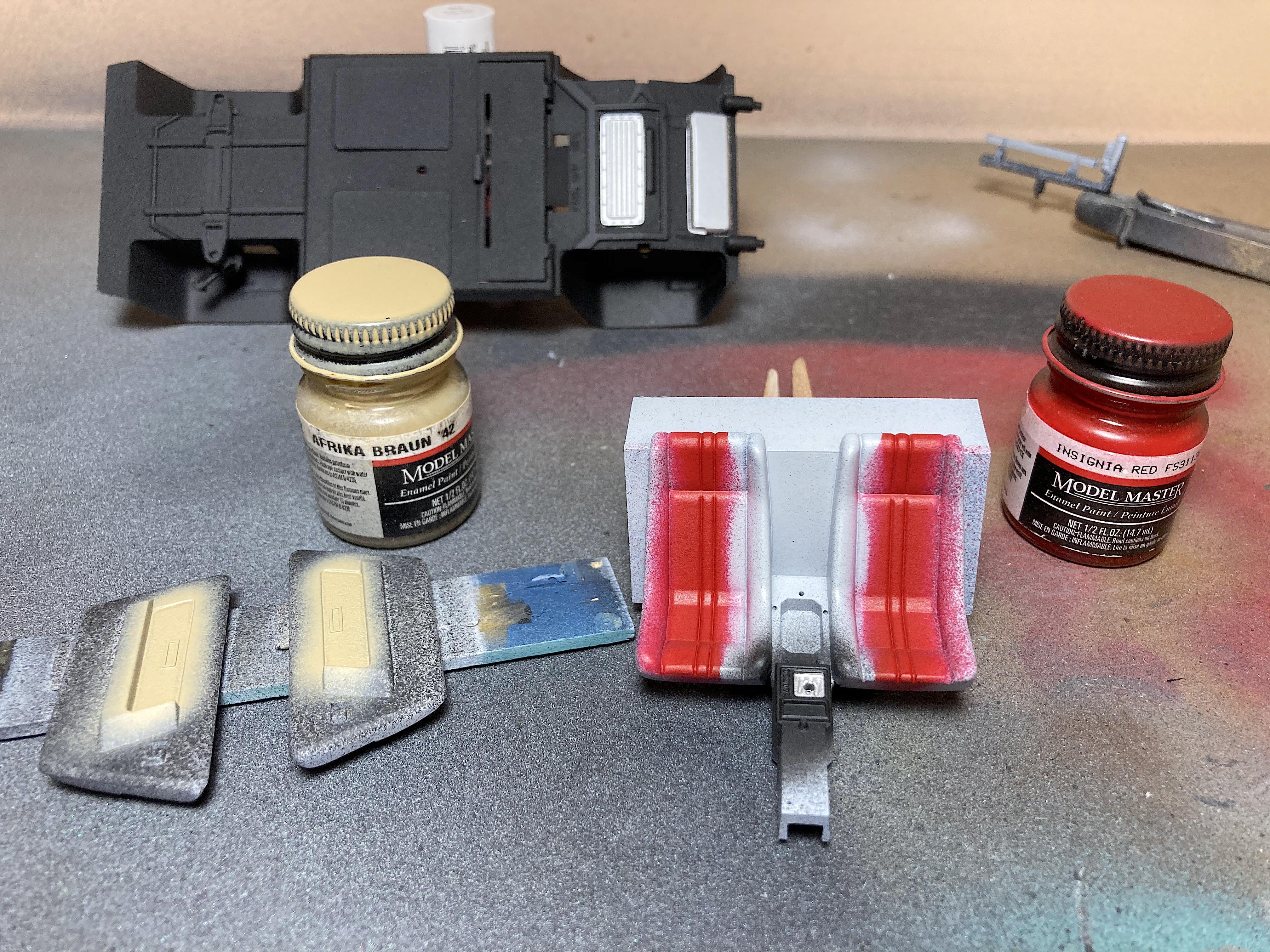

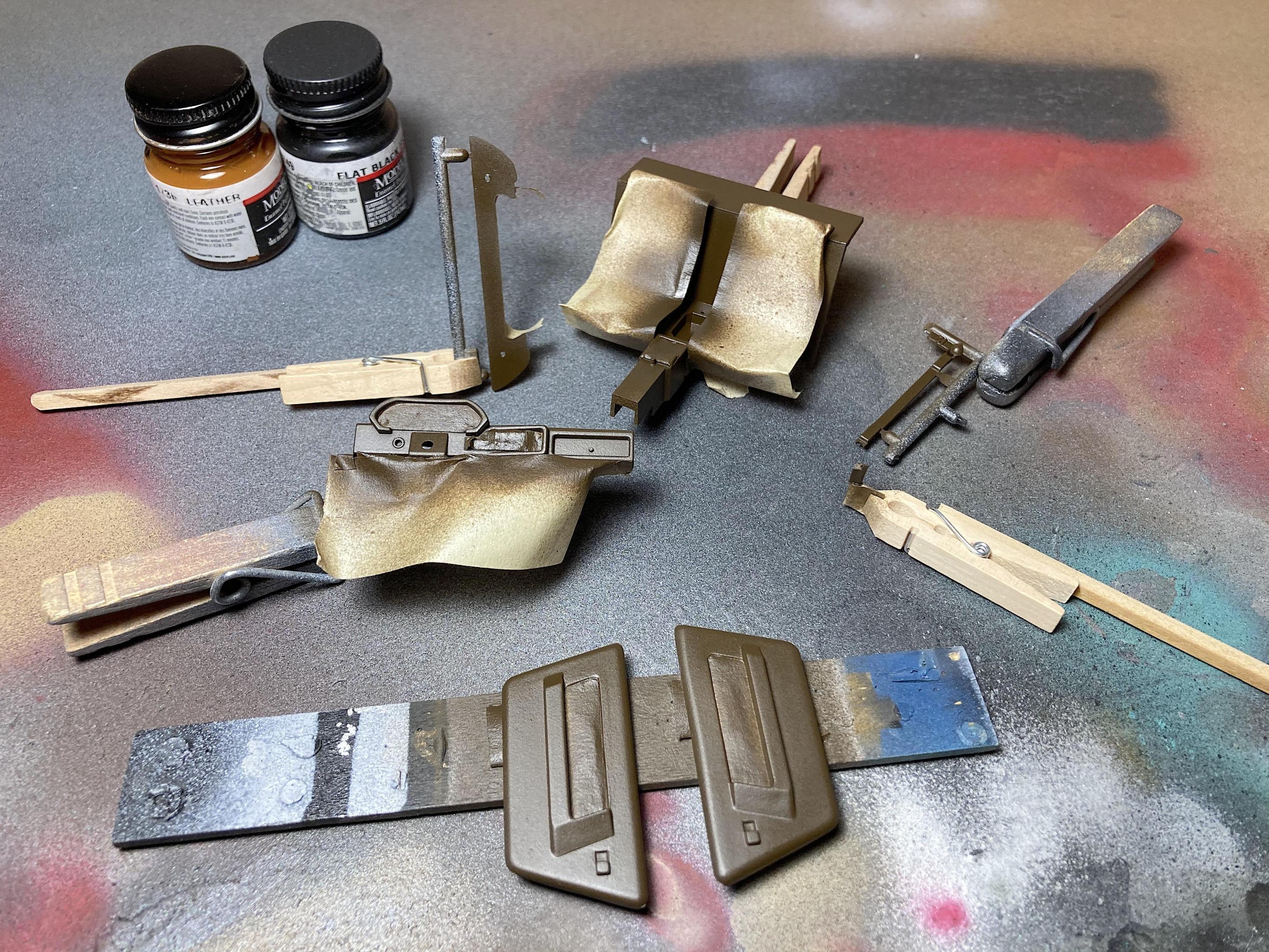

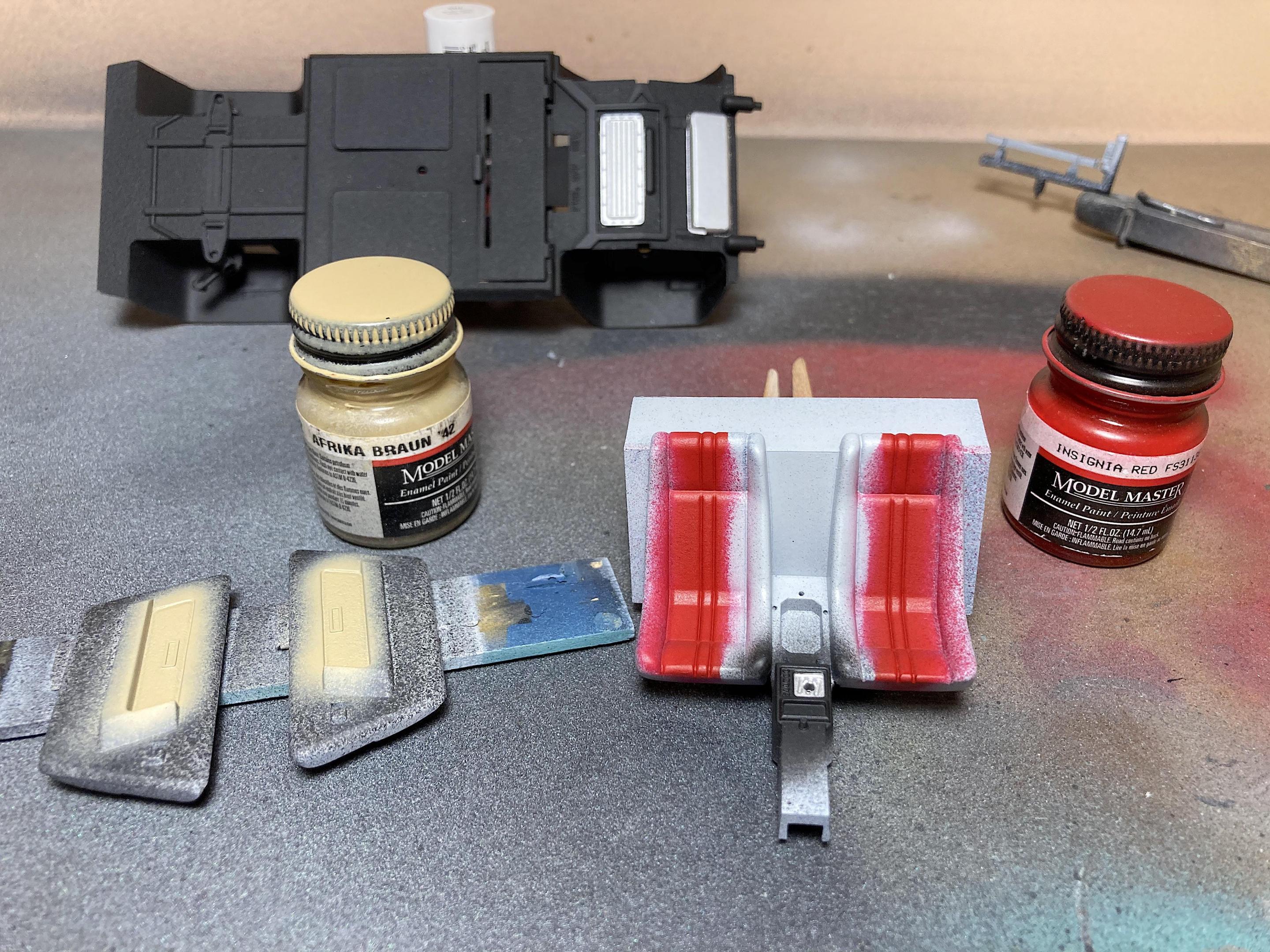

Had to figure what order of colors to paint for the interior, resigned to the fact that some colors were going to need two sessions, depending on the easier way to mask.  For example, the door panel insert first, the seats will be last with the same color.  The steering wheel needed a badge in the center.  I picked Insignia Red for the seat stripe, in homage to the most common color for Italian cars.
Would have been nice to have brown carpeting, it exists, but is never in stock.  So black carpet was put in.  Made patterns with "onion skin" sketch paper, then cut the self-adhesive carpet.
Last color for today was a mix of Leather and Flat Black.  Only used regular masking tape.
Next steps: lightly wet-sand the body, quick spray of nail 'polish', 'Afrika' seats, instrument decals, carbon-fiber decal the roof, some brush detail painting, tube exhaust tips, clear the body.  Might get done this year!

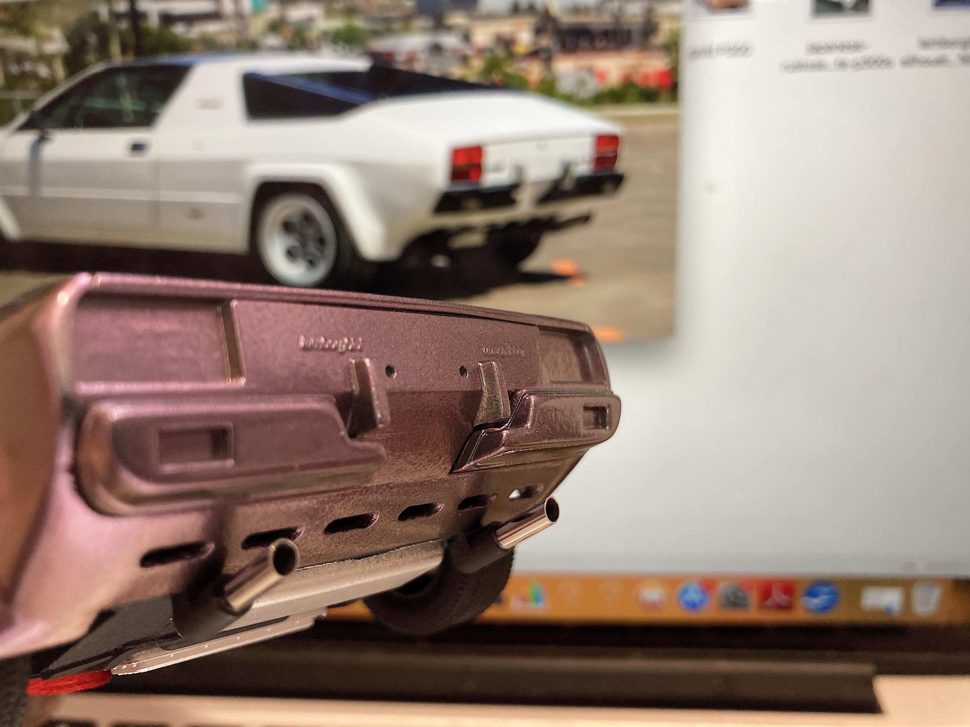

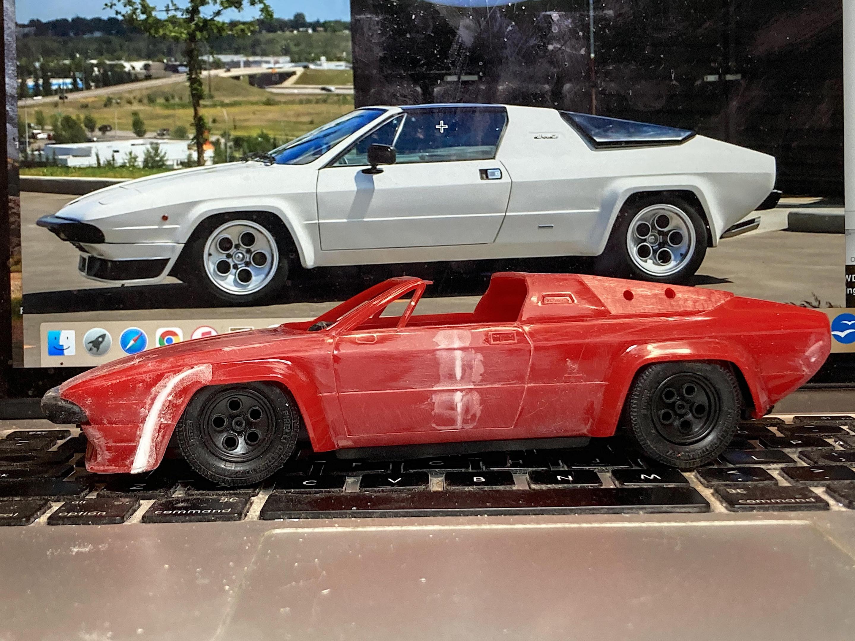

You're doing a lovely job, but man oh man...the shot with the photo of the real one confirms just how abysmally bad the model's proportions are.
I was kinda lusting after one of these, as I had one for a couple weeks back in the late '80s, bit I think I'll pass.
Your phrase "hero build" is definitely what it would take to make this mess actually look like a Silhouette, and I've got a lifetime's supply lined up already.
But soldier on, sir. I'm sure you'll make her as pretty as she can be for anything like a "reasonable" amount of effort.   :D
Appreciate it.  I've seen discussions about this subject with you, and you nailed it.  The greenhouse needs major adjustment.  I have a couple lifetime's of projects myself.  This is fake it until I make it, and call it done.  Good practice for the hero projects.

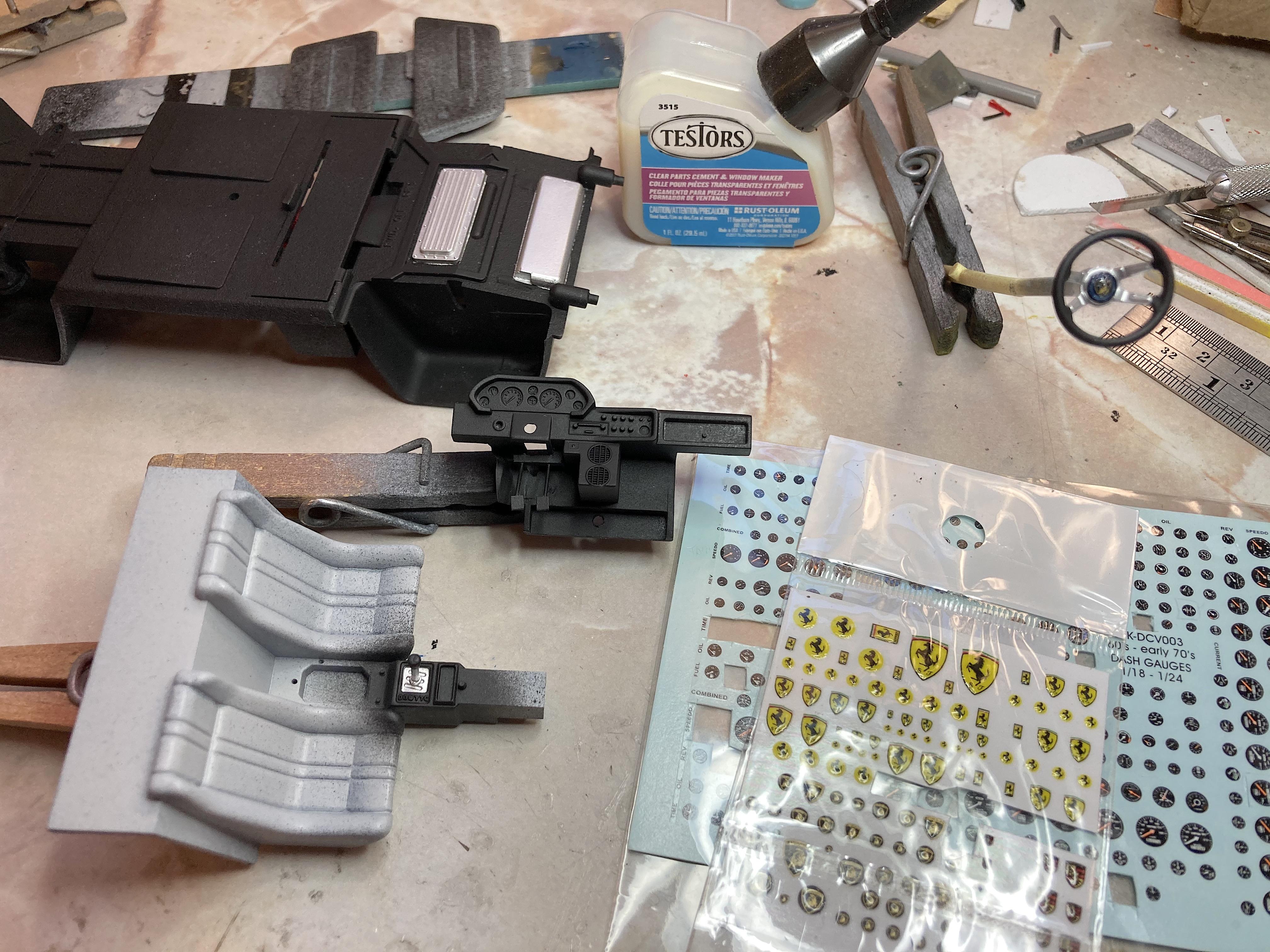

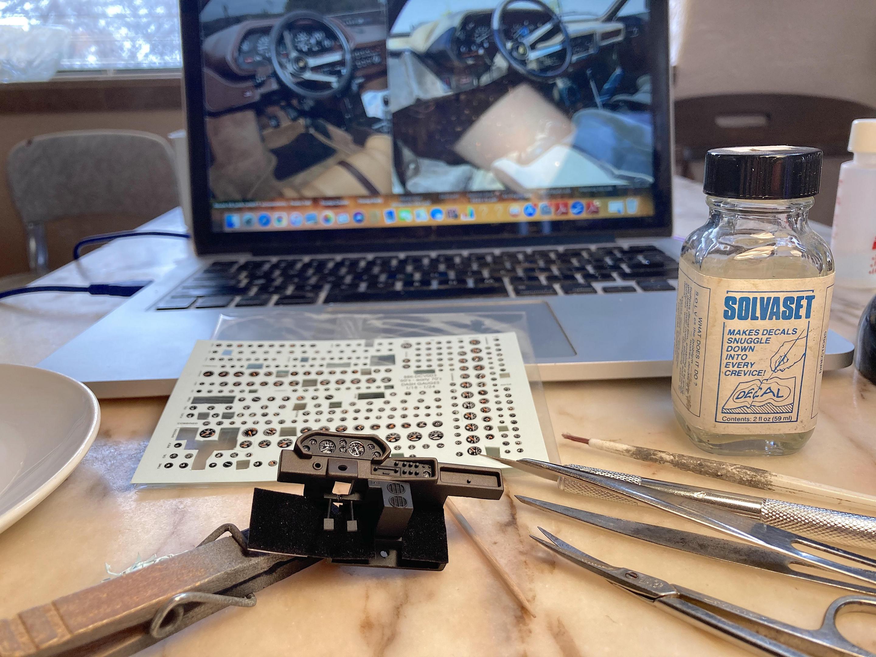

Between baking Pumpkin pie, and making Christmas Eve dinner entree,  I put instrument decals on.   Why did they put 8 gauges in the dash?
I know this isn't factory stock, they may have done fiberglass, but couldn't resist updating with lighter carbon-fiber for the roof (Hobby Design decal, good stuff).  If it was real, would not be a big deal to switch out for the original.
I better start working on dinner.......
Got some done today, last color for the interior got painted.  Detail painted the dash.  Did a quick second coat of nail 'polish' put on.

Sweet looking interior! I noticed the bare dashboard had embossed dials. I have one like this for my next project & am wondering whether to just lay the decals on top, or maybe to drill them out. Can't quite see enough in your latest pic, but yours look cool; how did you do them?
Thanks.  I hate painting gauges, so these decals are my saving grace.  I think they can be found on feeBay.  I used Solvaset to get them down.  Not concerned about the needles not lining up, so to do a killer job, drilling out would be a good idea.

So this is why some don't do WIP topics (seems like I said that before).  Totaled the wheel I cast. ?

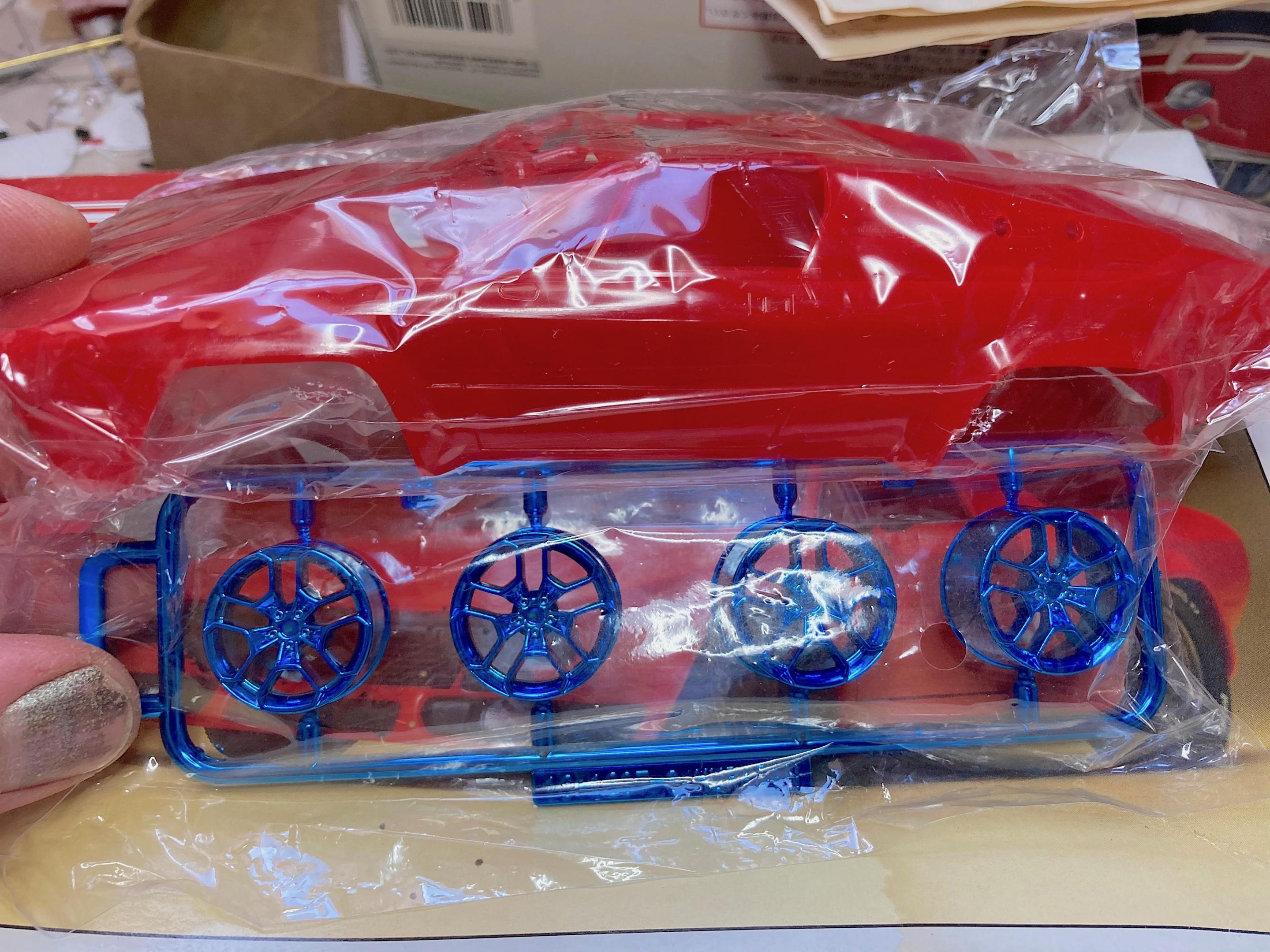

So I broke into the other kit.  I have to make a correction, Gunze-Sangyo managed to cast all the wheels without sink holes, so if anyone is thinking of getting this kit, avoid the Testors.  Drilled the holes, then painted the Tamiya 'titanium gold' without primer, came out good.
Maybe these Huracan wheels would work. ?

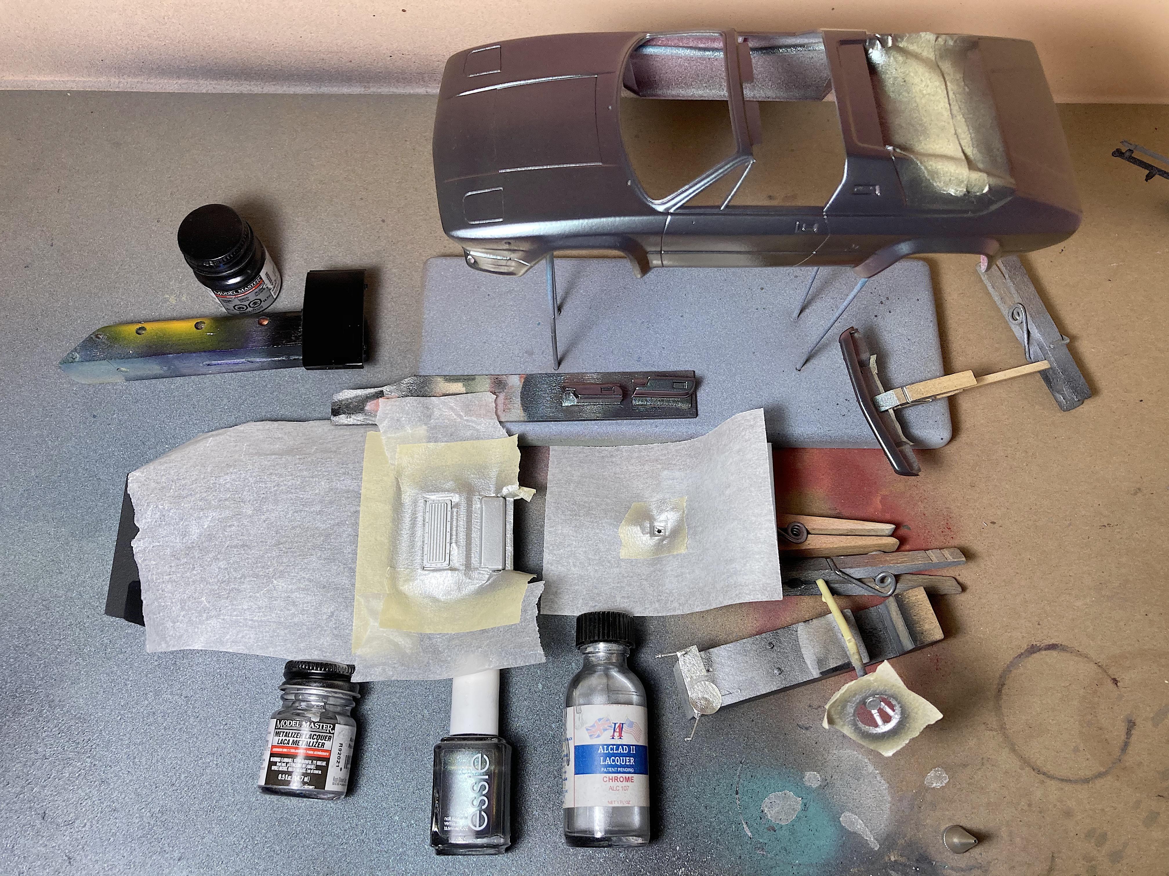

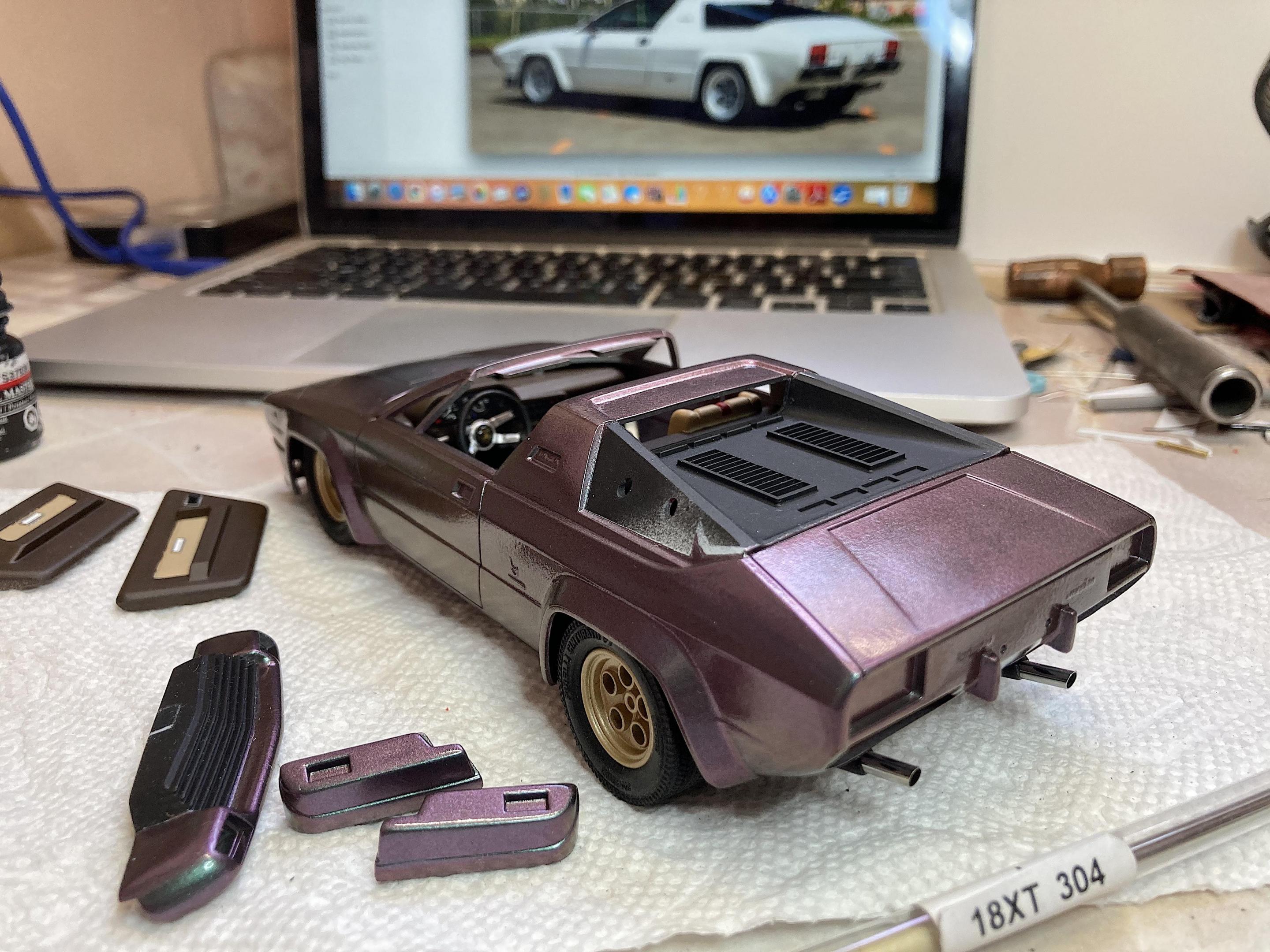

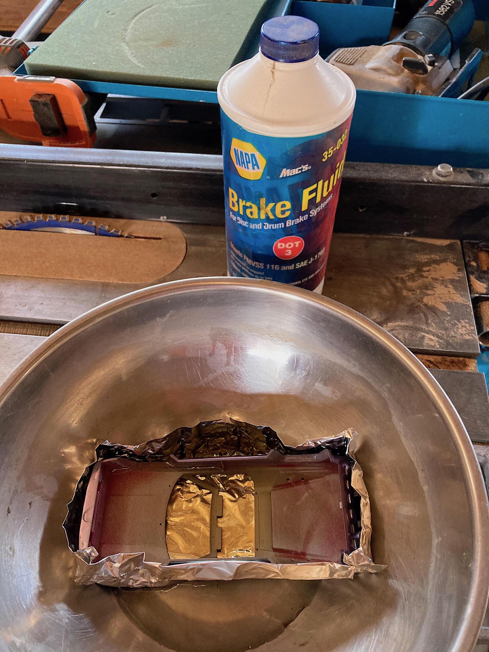

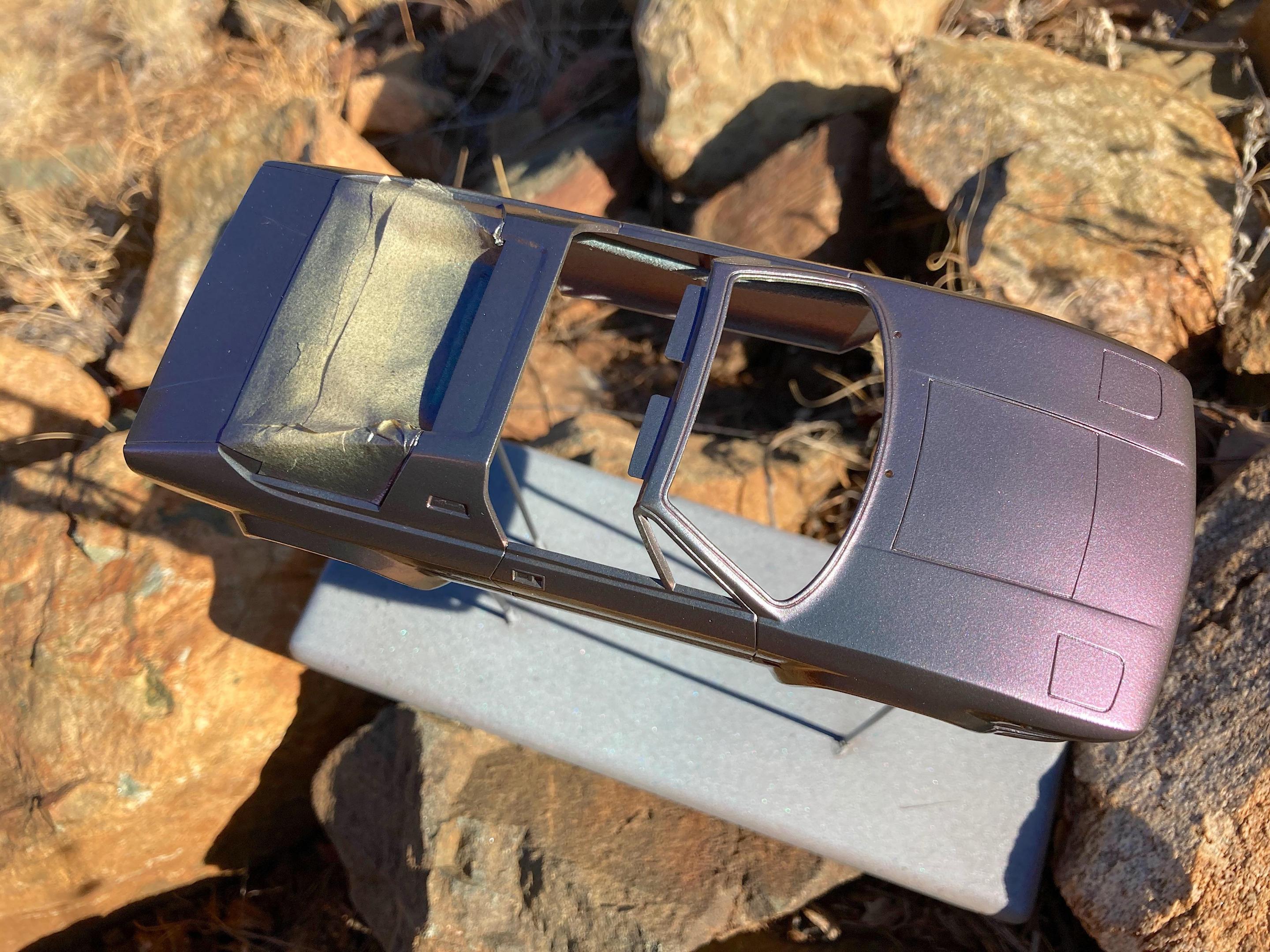

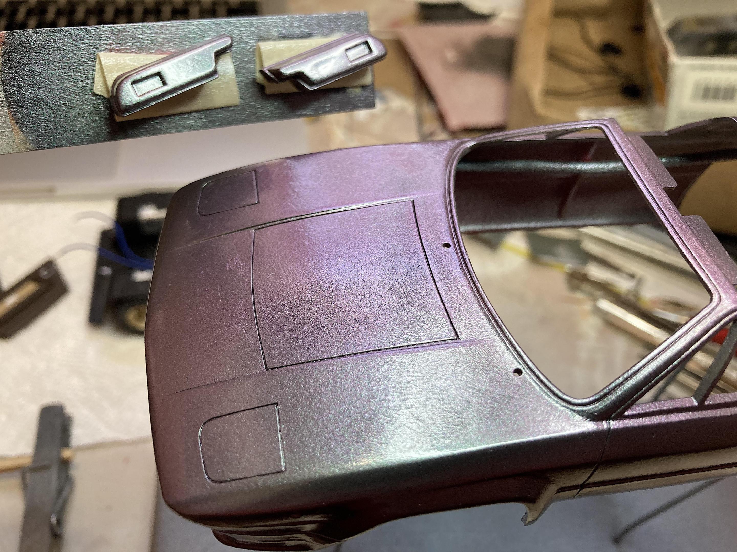

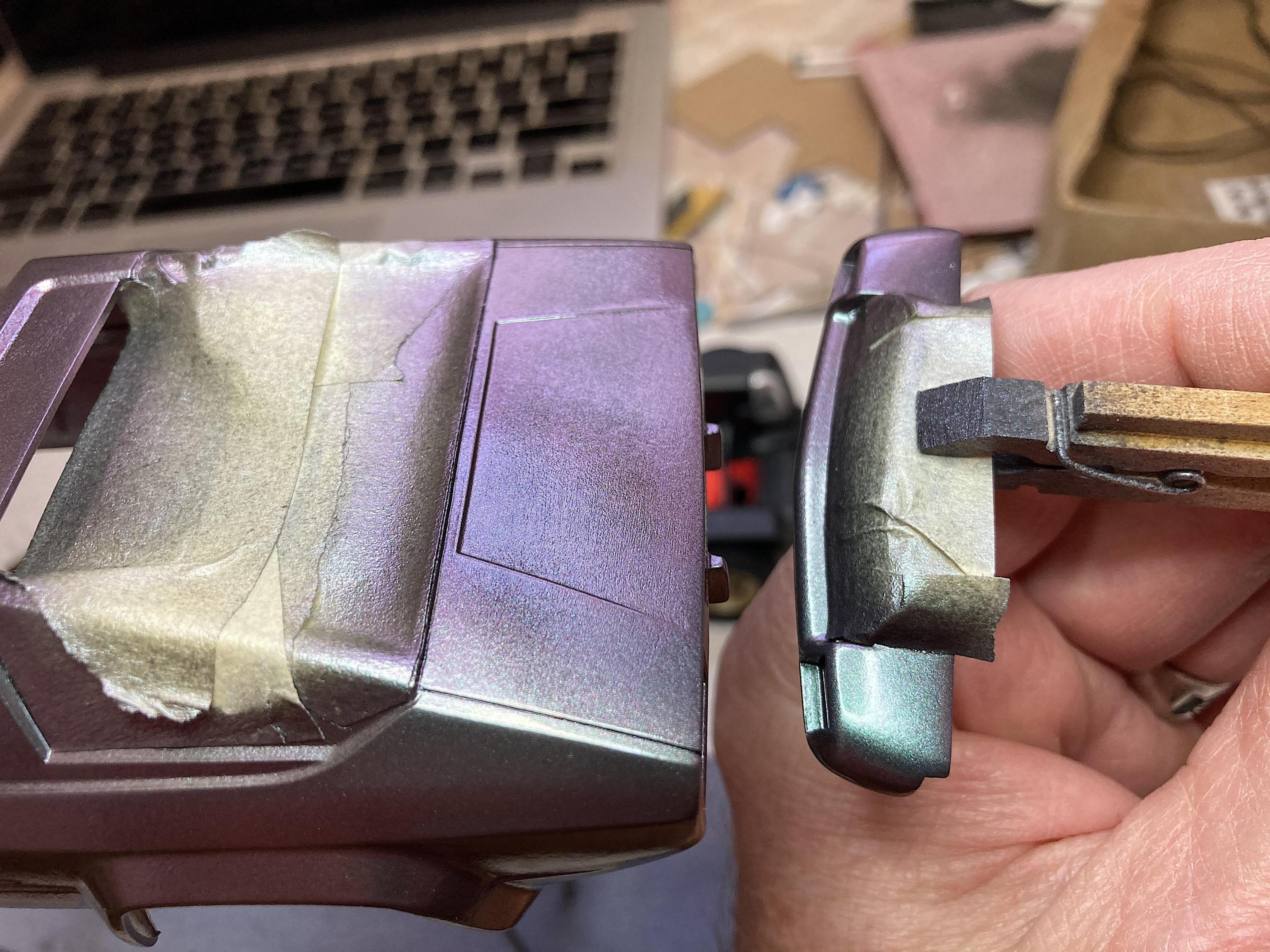

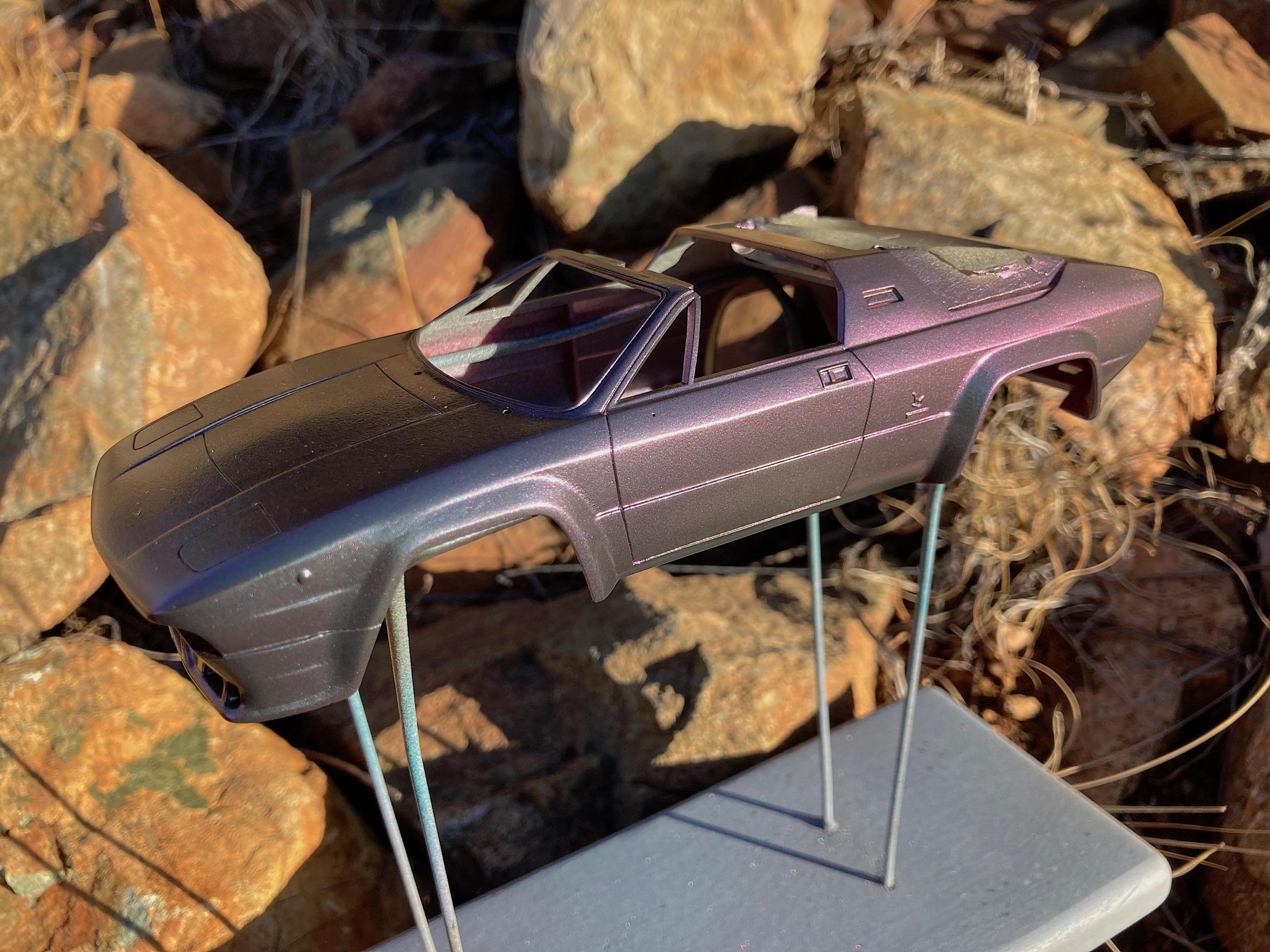

First thing I did today was spray Splash Paints clear.  Found out it's not compatible with the nail 'polish'.  ?  The bumpers are okay.
Needed to have the body on, to see how the new tips will look.
Then bit my lip, and threw into the brake fluid.
Edited by 89AKurt
Shame about paint compatibility problem. The color changing paint actually looked good on that model.
When I try new paints combinations I try to do a "spoon test" first, but sometimes I forget to do it. :(
On 12/28/2020 at 1:10 AM, beeRS said:
Oh no! What a shame about the clear coat. Does brake fluid remove the filler used for fixing the sink marks as well?
Tamiya putty also disolved.

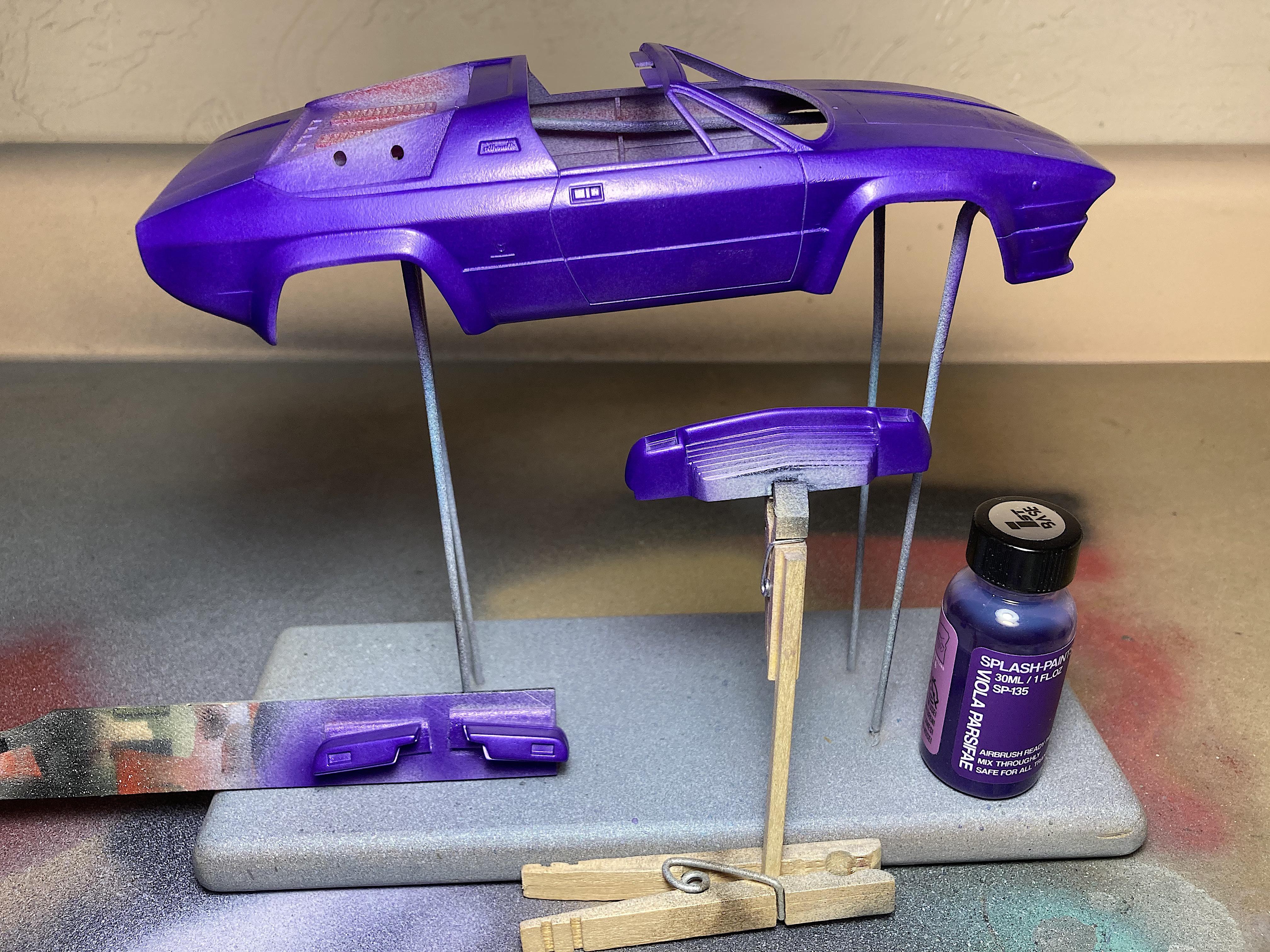

Ok, so this is what it looked like after the brake fluid bath.

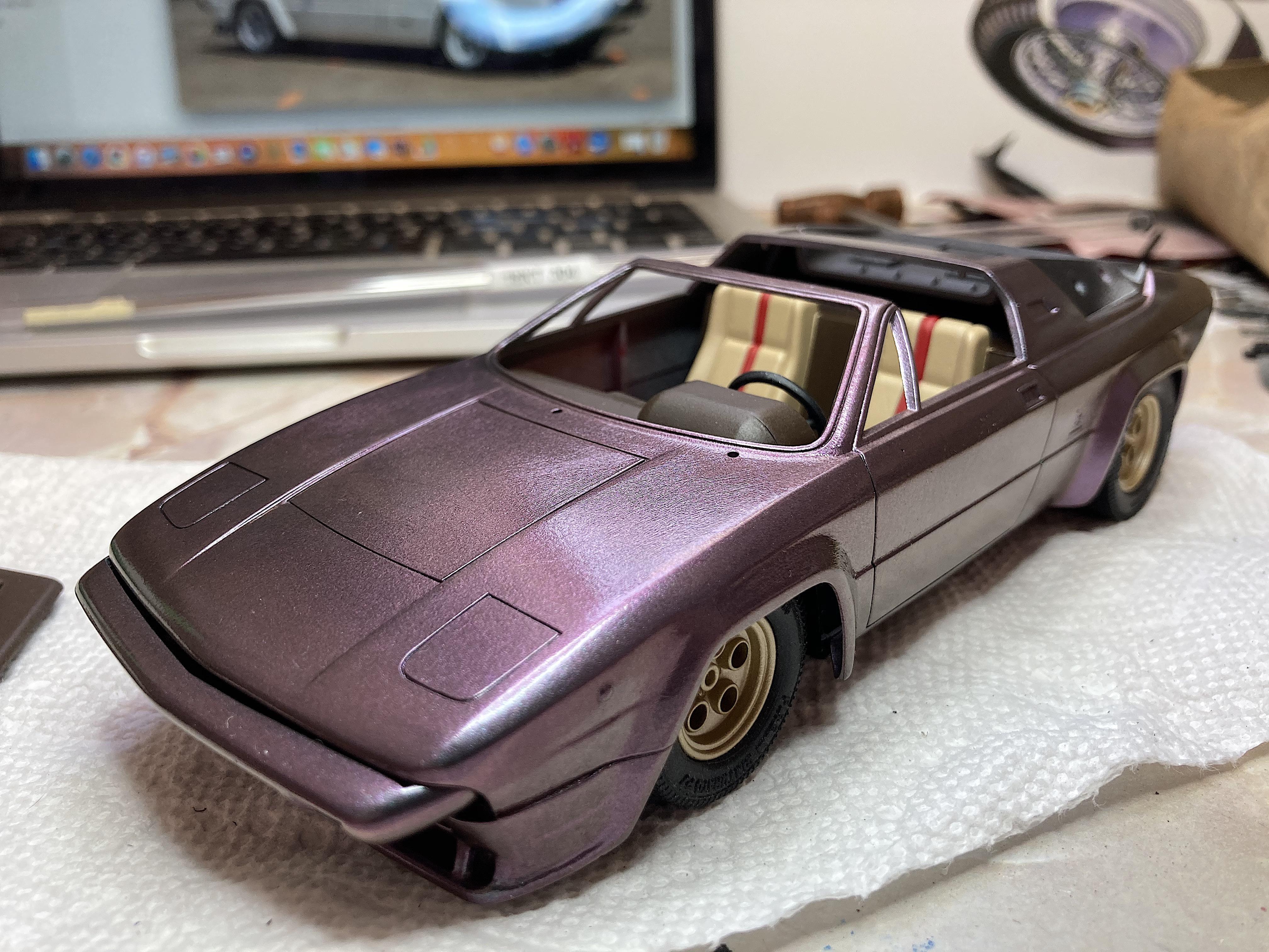

Repaired the putty spots, wet-sanded, primed, then sprayed this Splash Paints that was intended for a Huracan.  I need to wet-sand this next, then do another coat.  I wasn't planning on a contest winner anyway, just wanted this weird Lambo on the shelf.
Shame about the first paint but the new shade is pretty darn cool! I'll say this: stripping airbrushed paint appears WAY quicker than my experiences getting spray can paint off. Looks to be no big deal!
