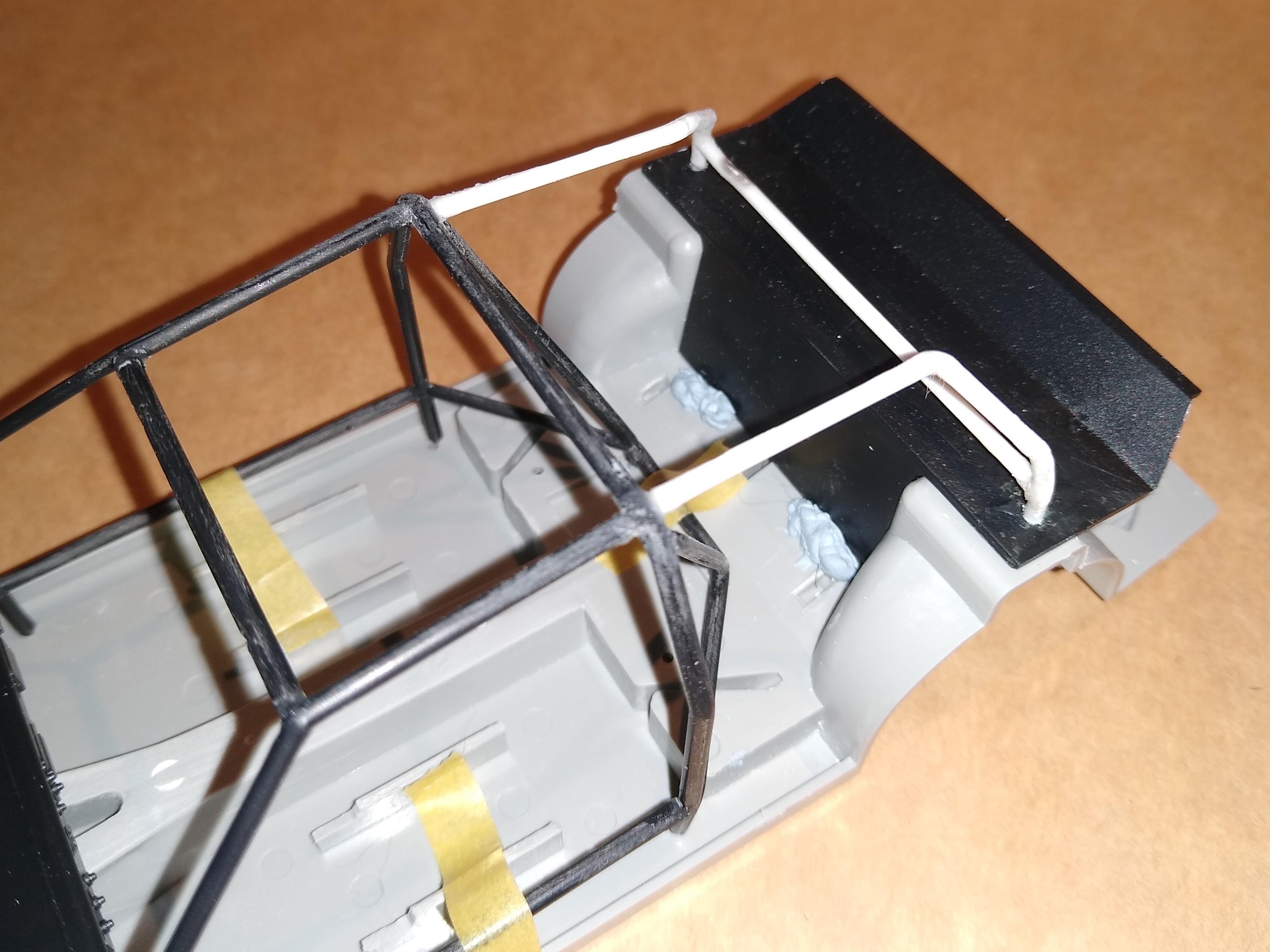

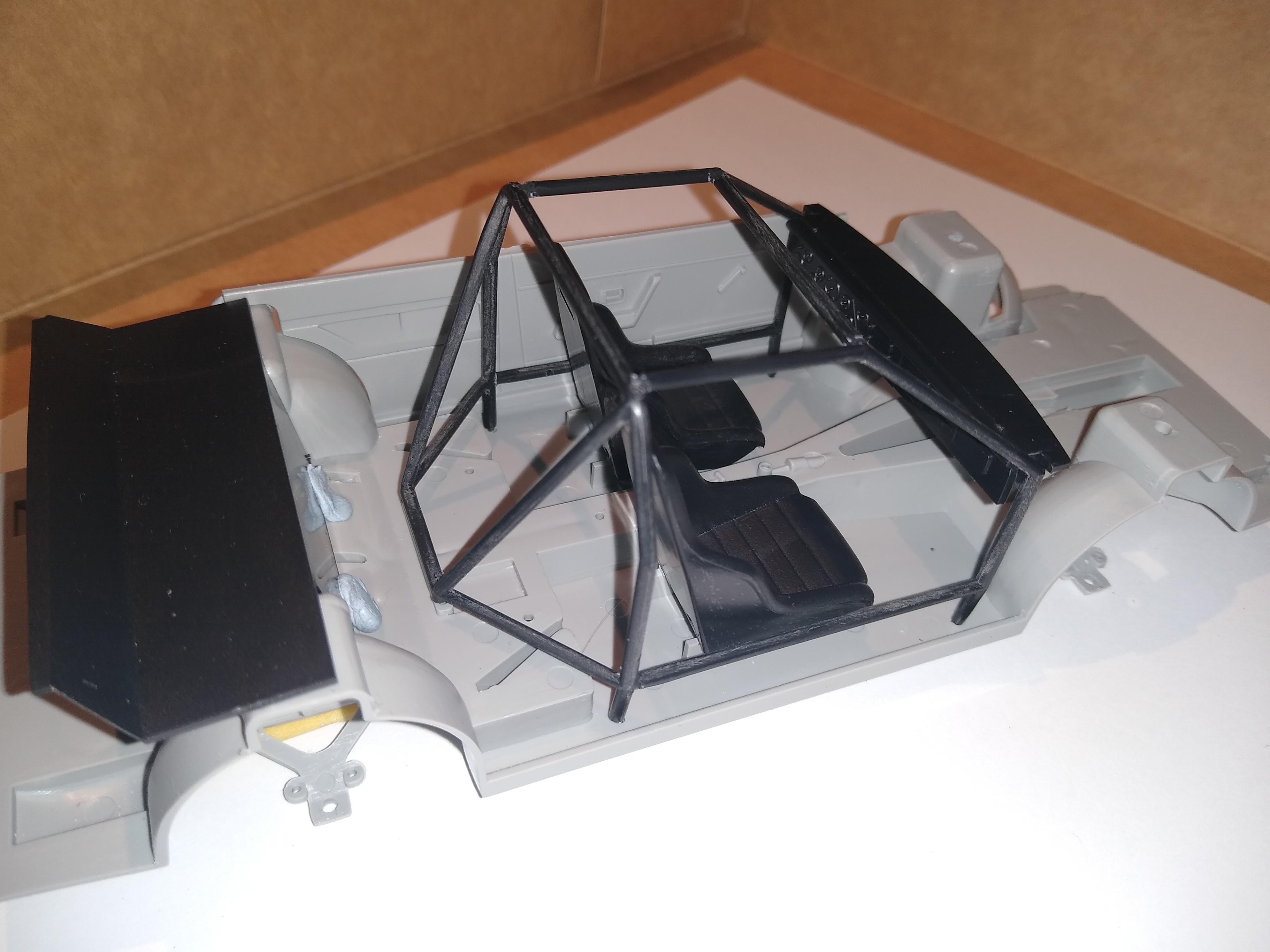

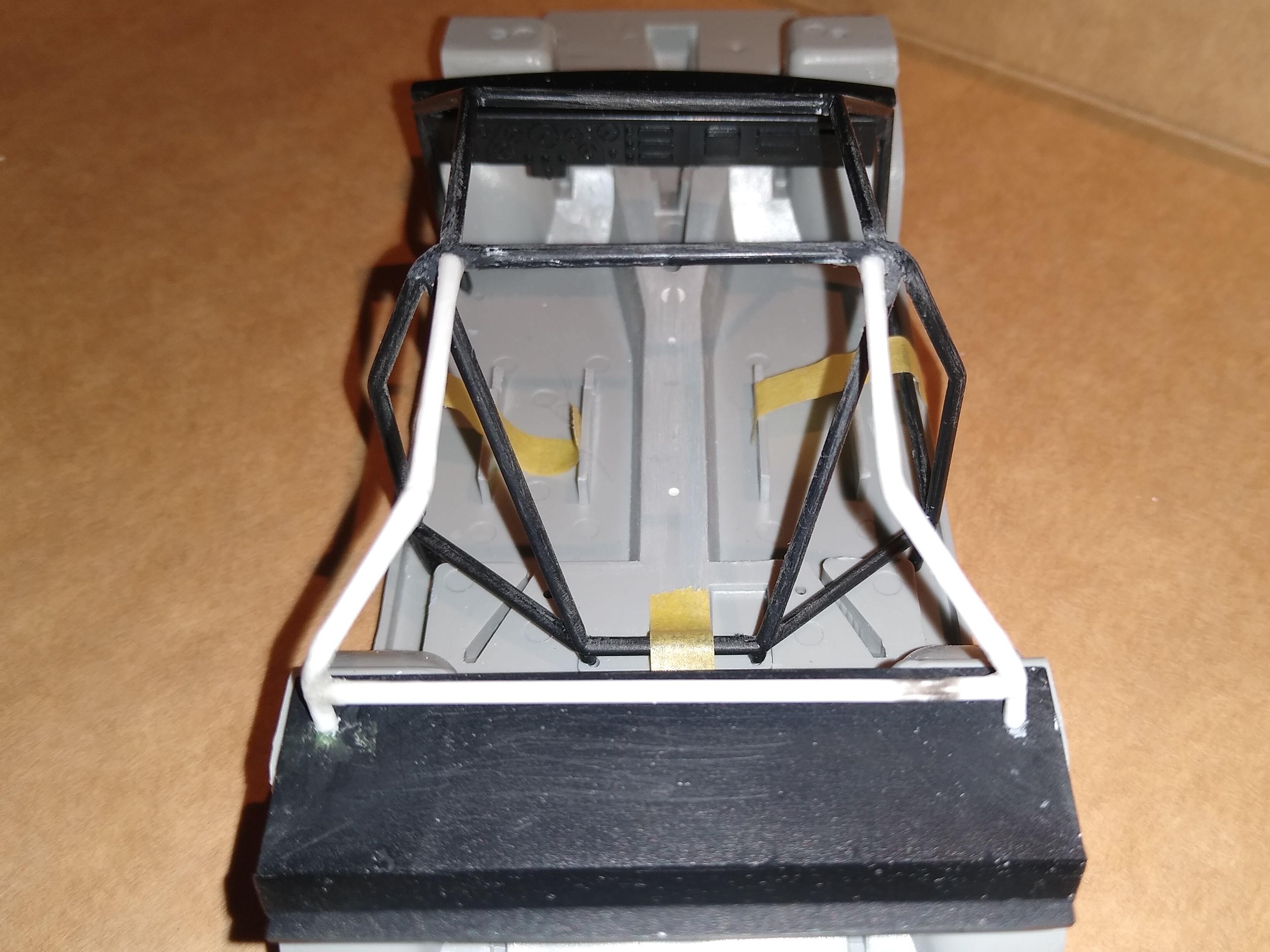

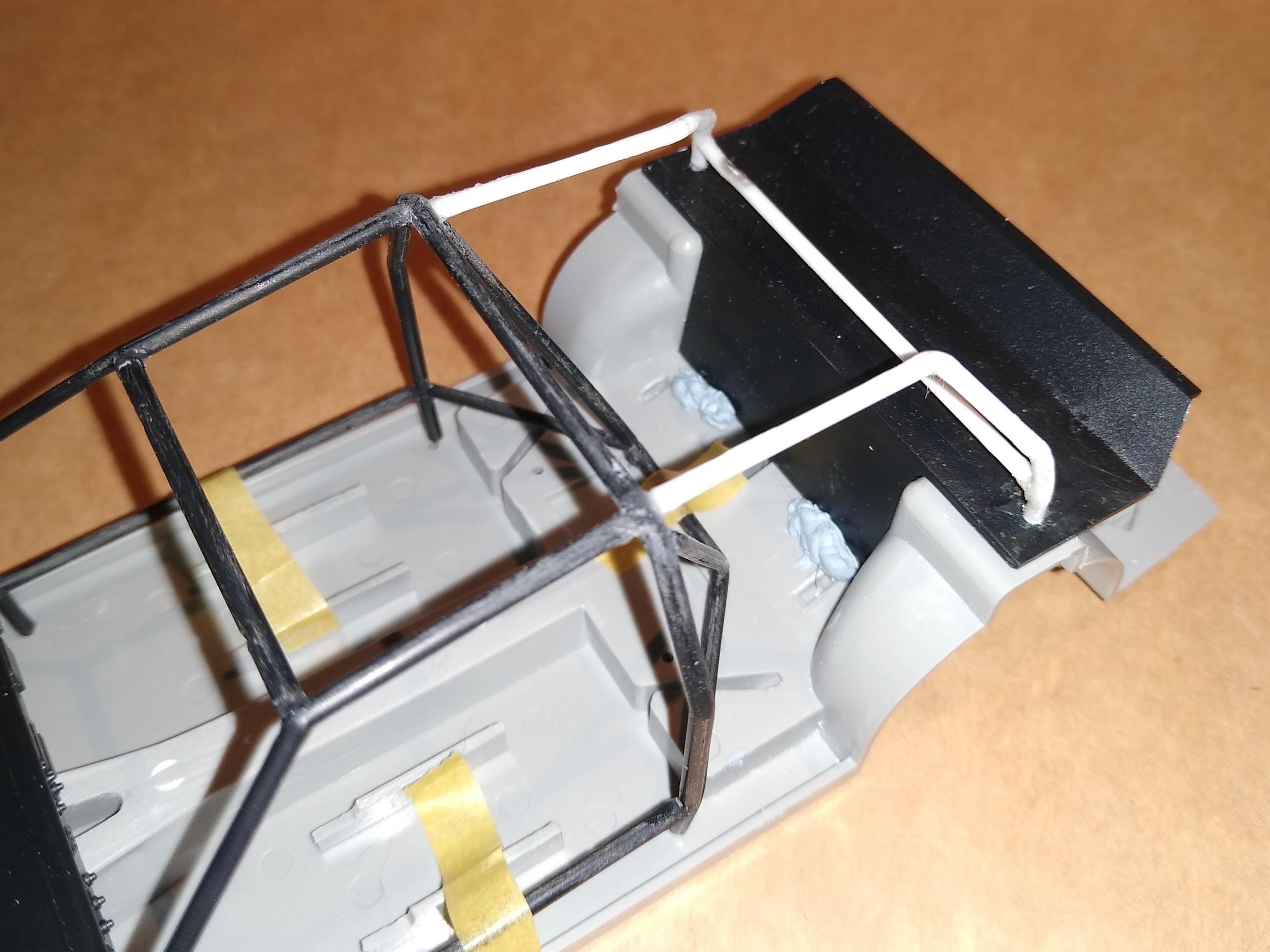

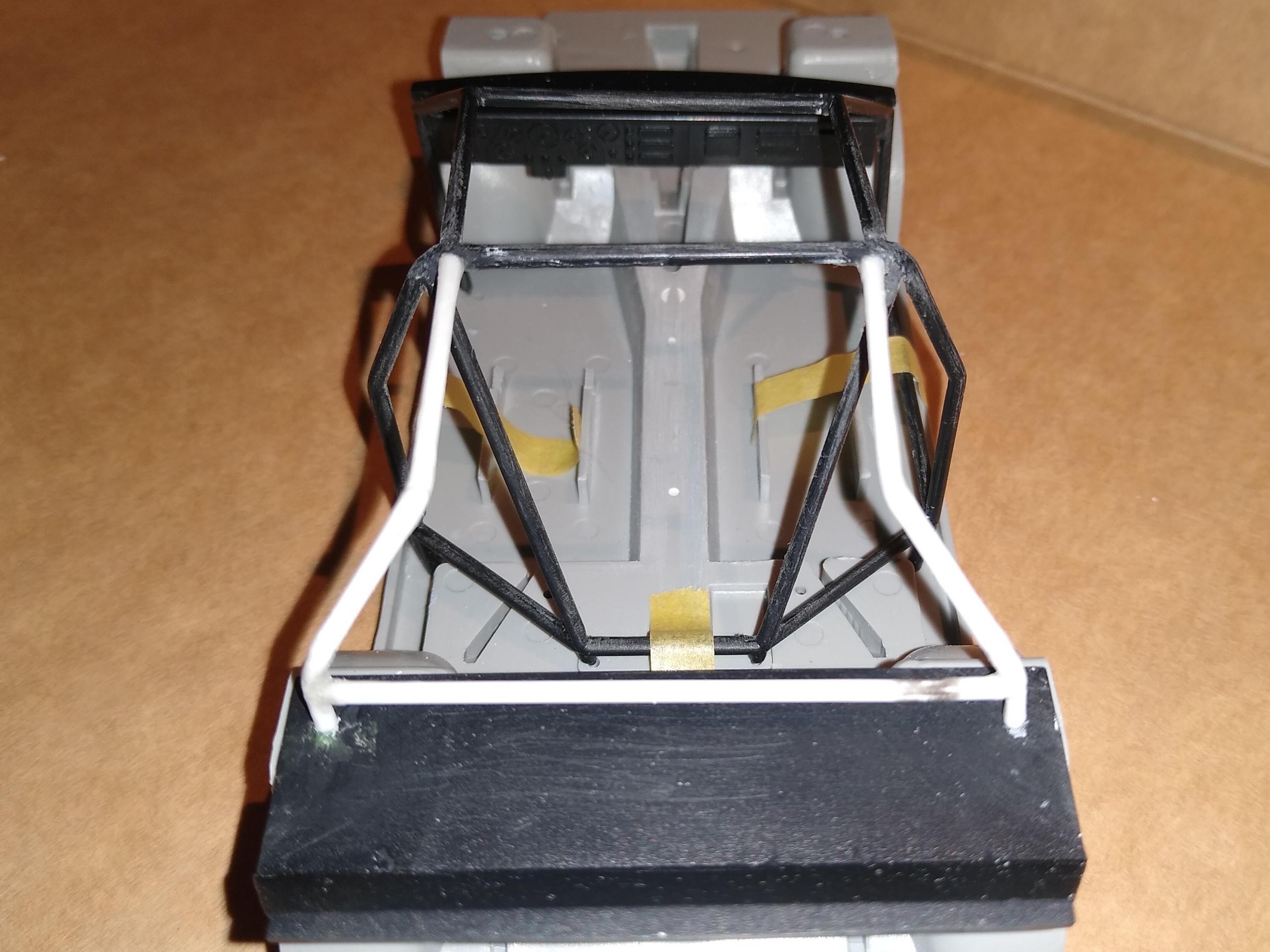

First thing was to mock up the cockpit to see what's what. (The only thing I glued was the roll cage, but not before spending a LONG time sanding off all the flashing). After comparing it with my reference photos, I would say it's pretty accurate: it's not Tamiya, but it's not bad. I was keen to see how to go about fitting aftermarket seat belts.
The 1:1 WRC car had its belts tethered to a bar running between the rear struts, but the kit doesn’t have this rear cage section. I had hoped to be able to simply “weld” in a simple alternative, but no dice. The kit (accurately) has angled bars close to the headrests and in a position where the belts coming through the seats can only pass either side of them and anchor somewhere behind (like the 1:1 car), or the belts would have to be very short and tether immediately behind the seat. I didn’t like the second option so I gathered up reference pics and decided to try my hand at roll cage fabrication…
After taking measurements with the body shell on, I drilled fixed anchor points above the wheels then worked upwards from here, gluing several sections of 1.6mm rod together before then sanding off sharp corners & adding putty to neaten up. A candle was used to bend the small vertical sections, but I should’ve done it before I started assembly because I burned the horizontal bar!
I noticed from the mock up was that the kit seats are positioned too far forward on their runners compared to the typical position seen in my reference pics. A nice straightforward fix here using a razor saw/file to increase the length of the front notched section. (Also, I had to shave off injection nodes from the base of the seats to get them to sit right).

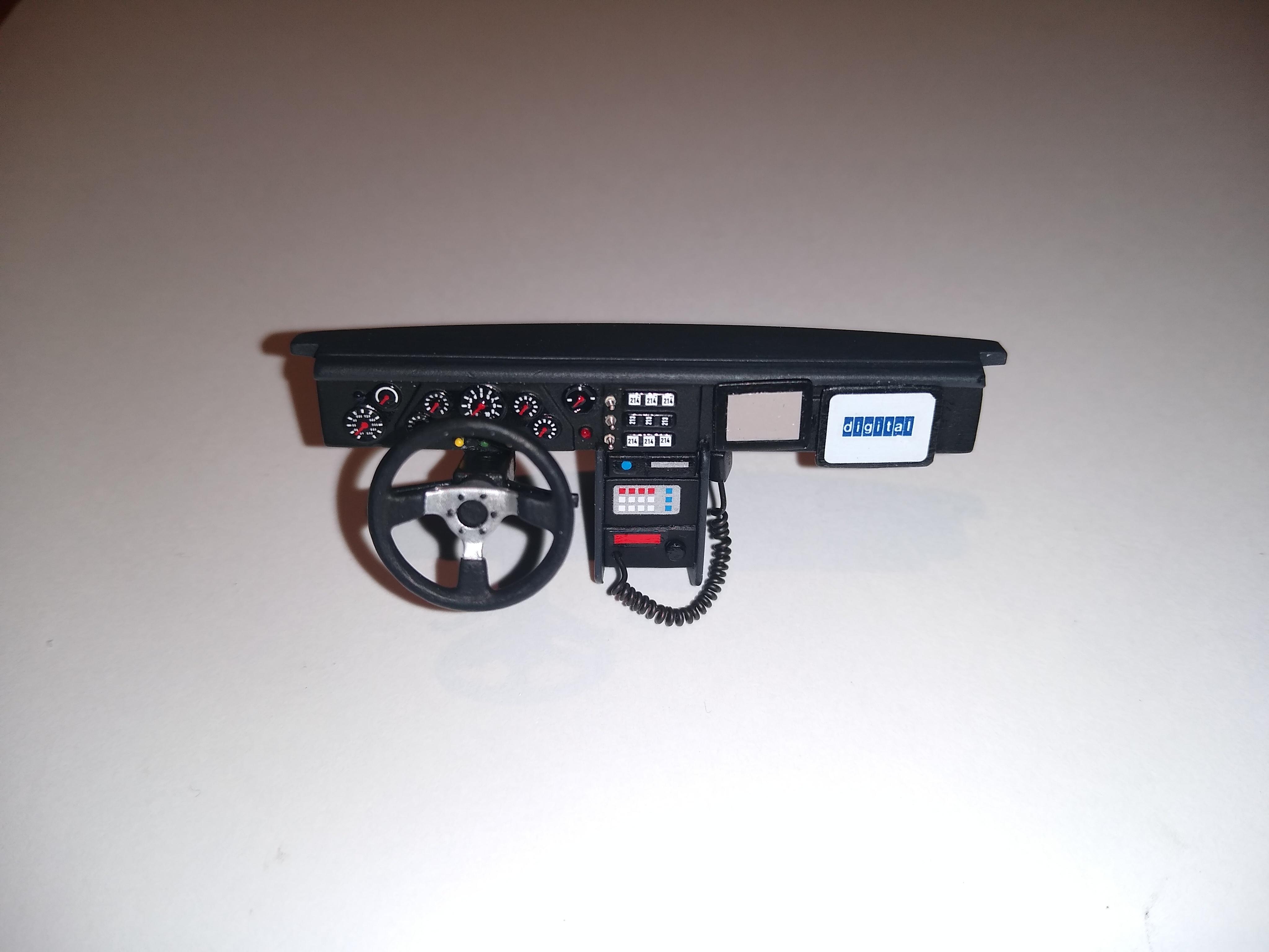

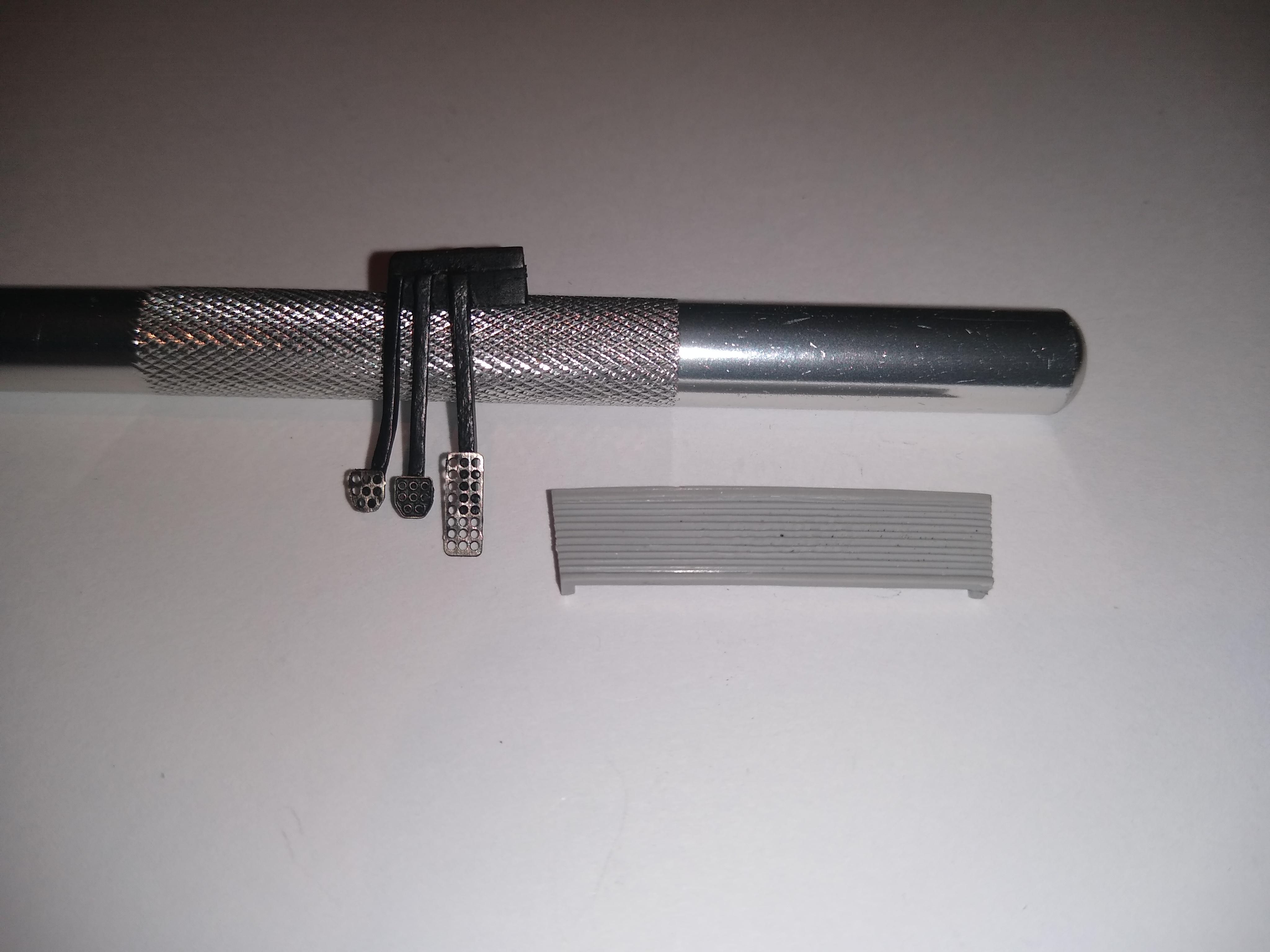

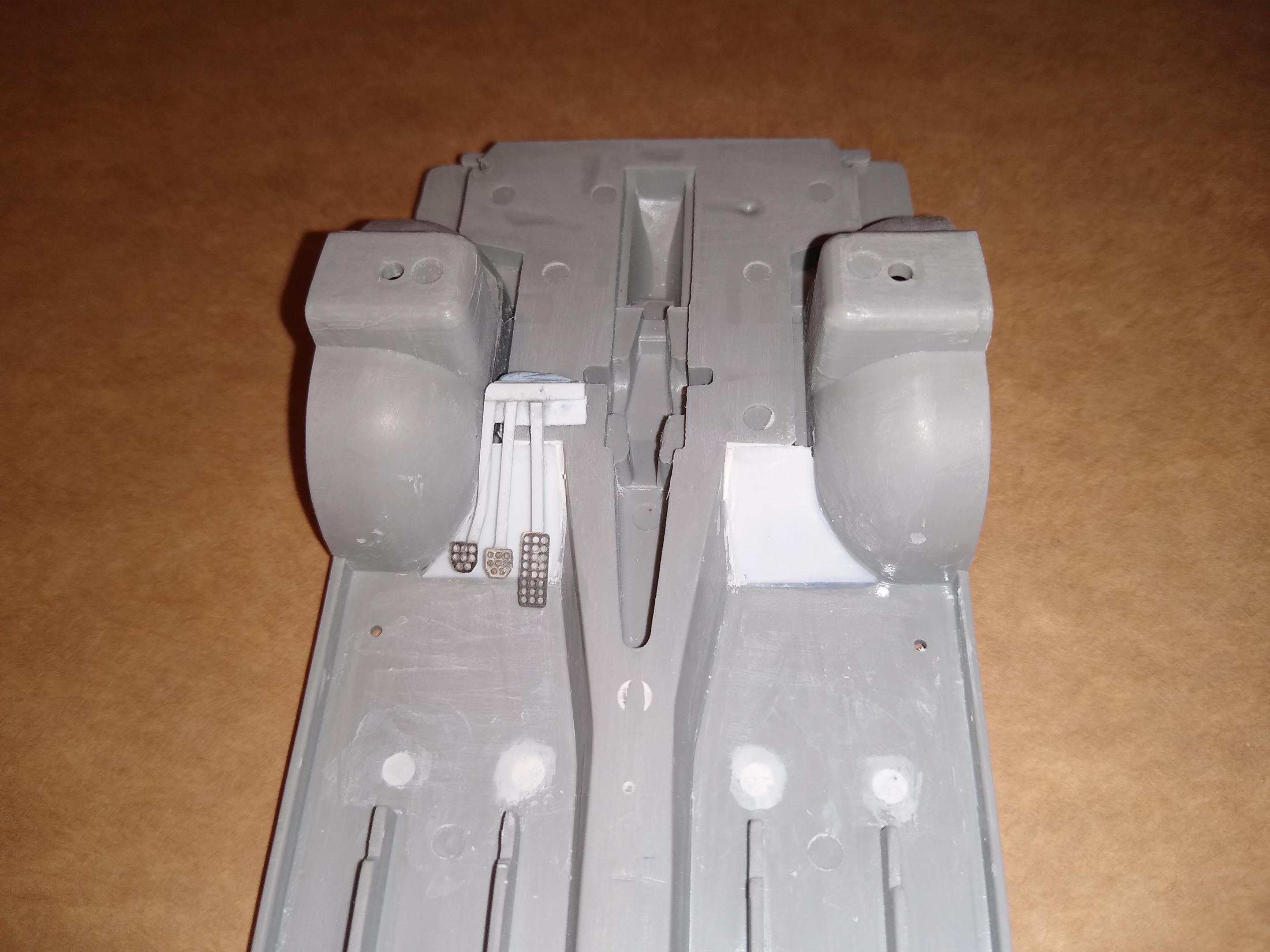

Finally, I had a go at making styrene arms for some PE pedals. VERY fiddly, but I found it really satisfying! I’m thinking I’ll spray the assembly with black primer then sand the paint off the pedal faces? (If that doesn’t work, they’ll have to be all black – the chassis is silver so it’ll look cool either way.)

I already have a suggestion, hope you don't mind.  The pedal arm pivot point should be higher up, perhaps under the dashboard, you need to have travel space.  For example:
That kit needs so many scratch-built parts, like a shirt pin for a gear shift, etc.   Does it come with gauge decals?
Thanks Kurt, that's exactly the kind of input I'm looking for, and the earlier the better! I had a great time reading through your "Celexus" build, although it made me regret including the word "custom" in my thread title... so I changed it!! ? The kit does have correct gauge decals: they're clustered and supposed to be laid over the multiple raised dials in one go, but I'll (probably) try to cut them out and lay each one individually. It may take a while... ?
Edited by Pete75
Another suggestion, if you don't mind is when you install the gauge faces rotate them as needed so that at normal operating conditions the needles would point straight up. The theory being a quick glance would tell a driver or co-driver during a special stage that something was Abby normal if a needle was not pointing up.
Thanks Walt, appreciate the input, and that would definitely be "extra rally!" I recall seeing that on in-car footage when I was young & not knowing why they did it ?. The likelihood is that I won't be employing it here, though, as the dash has embossed dials/needles to match the decals (see below). I'm not a fan of this, to the point where I've even considered drilling them out, but the effort/risk is pointing me in the direction of just playing safe. I am taking a lesser leap into unknown with the dash, however, in prepping for unbelievably small PE toggle switches: I've cut/sanded off three raised buttons in the centre & drilled holes with my very smallest bit ?. So far ok, I think...

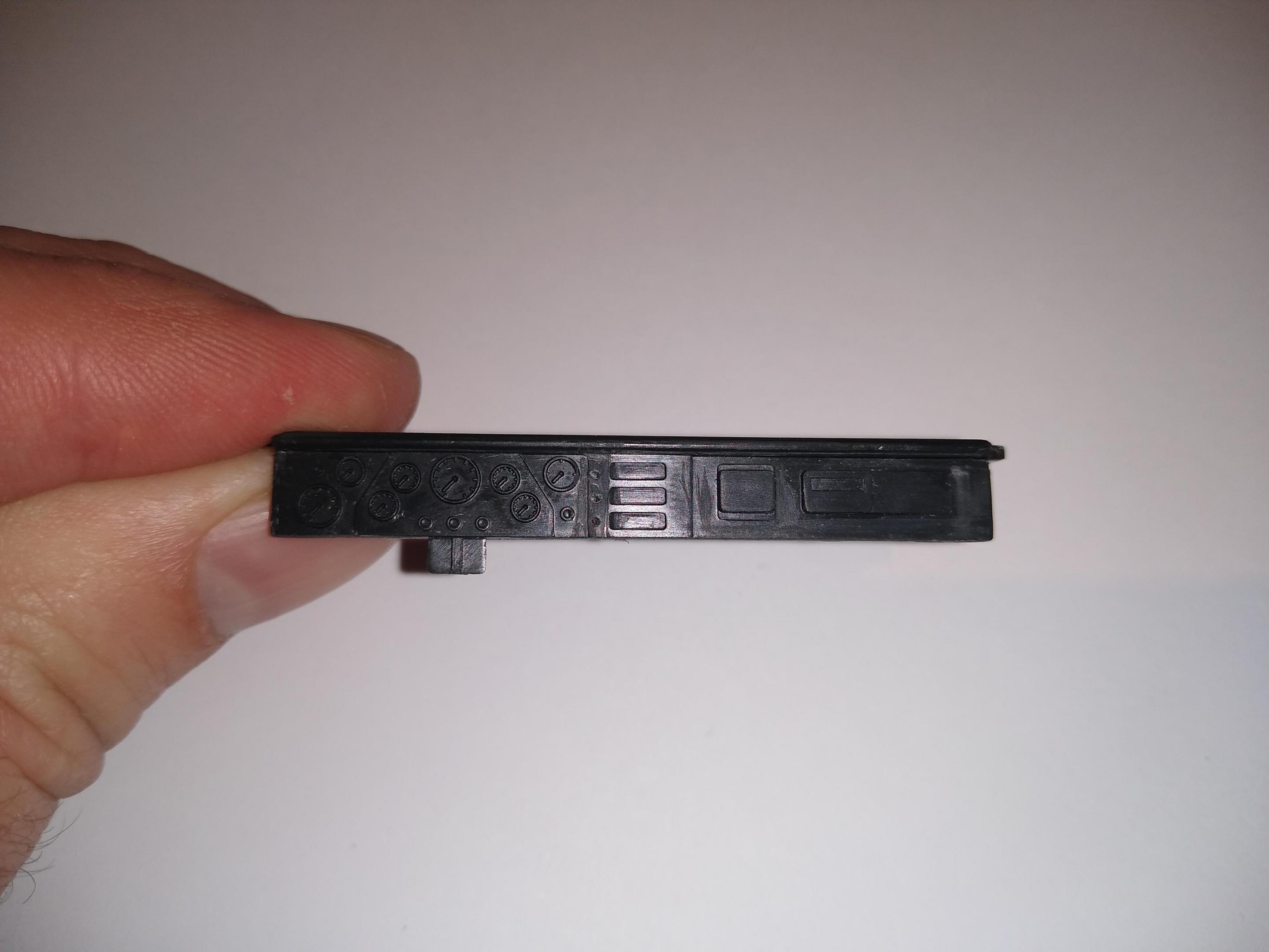

[...] I am taking a lesser leap into unknown with the dash, however, in prepping for unbelievably small PE toggle switches: I've cut/sanded off three raised buttons in the centre & drilled holes with my very smallest bit ?. So far ok, I think...
I've used those too!  Really adds to the whole picture.  One for oil slick, two for back running & brake lights off, three for?  I was planning this on my project too.
I must confess I hadn't thought of assigning the functions! I'll be adding a couple more to the centre console I'm planning to build but I imagine they'll all remain Top Secret. If the ultra-detailed tool kit in the trunk of your Ferrari 275 is anything to go by, your switches will probably be individually labelled!!?
Yes, don't tell everyone your secret weapons.  You're killing me!  ?  Not only labeled, but workable.  ?

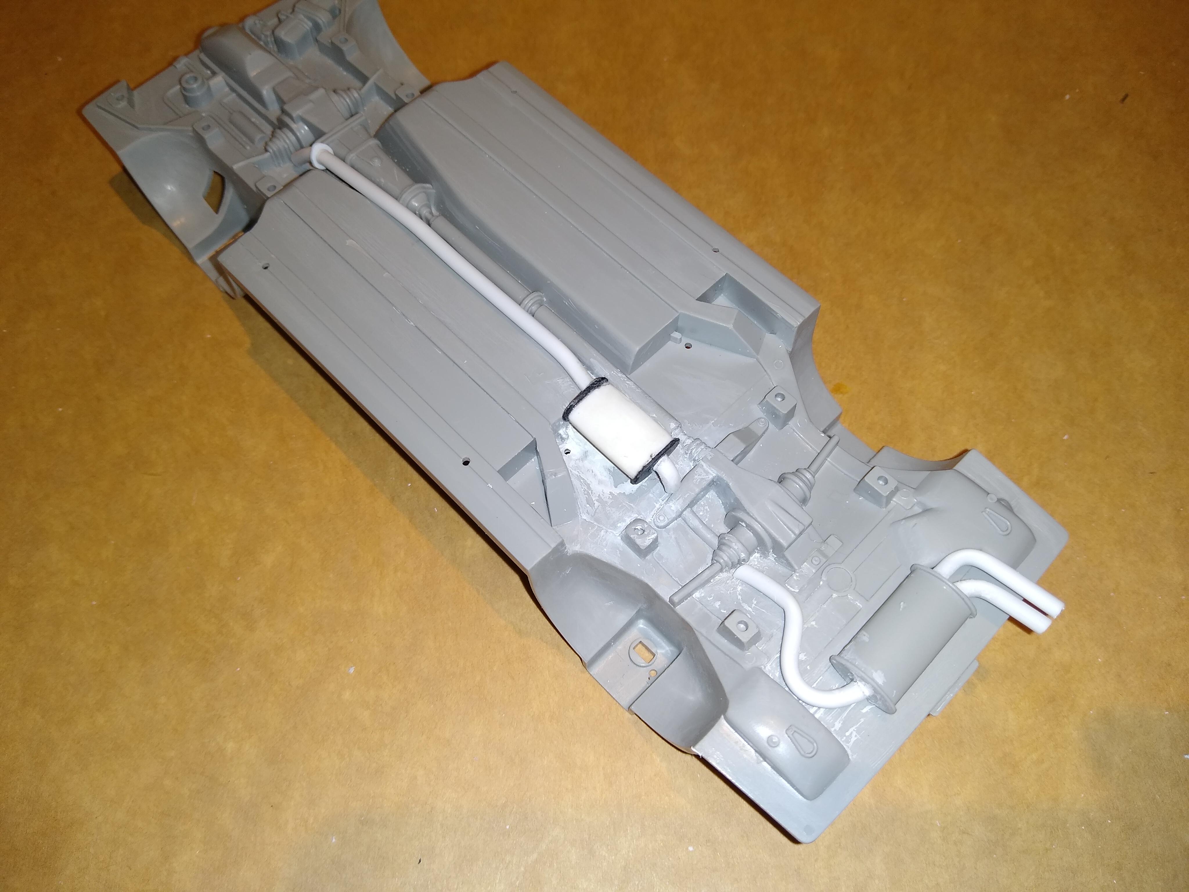

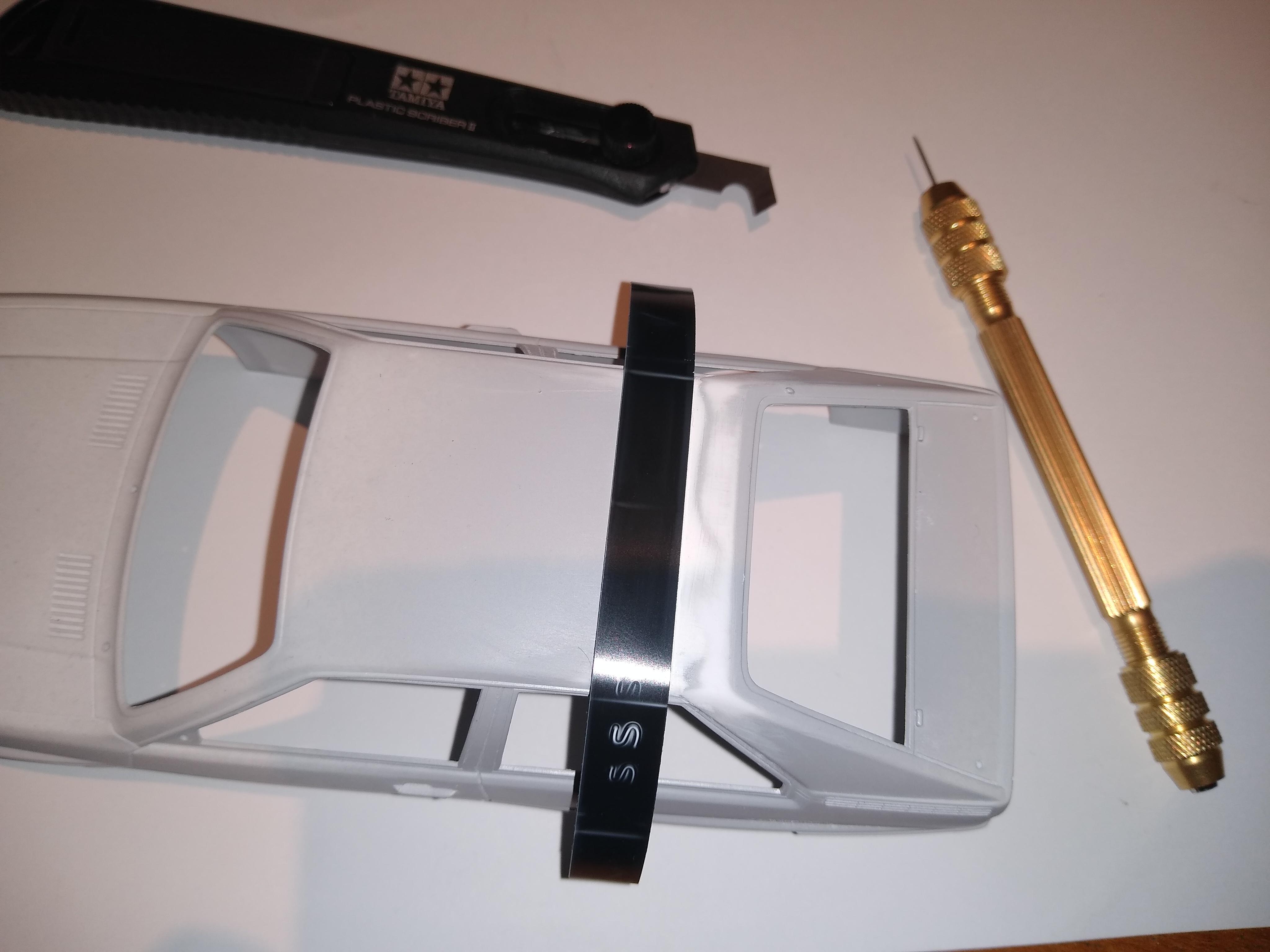

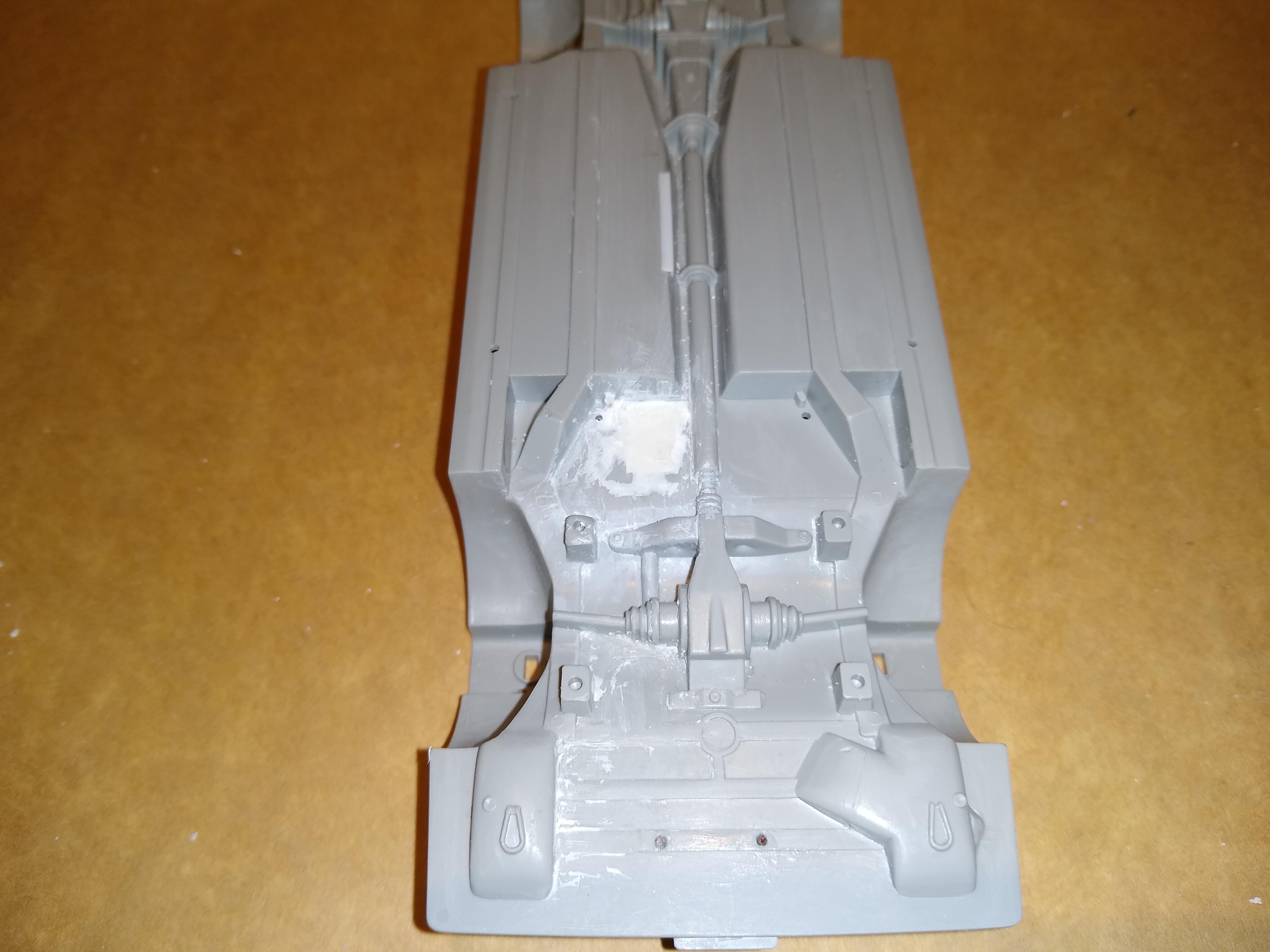

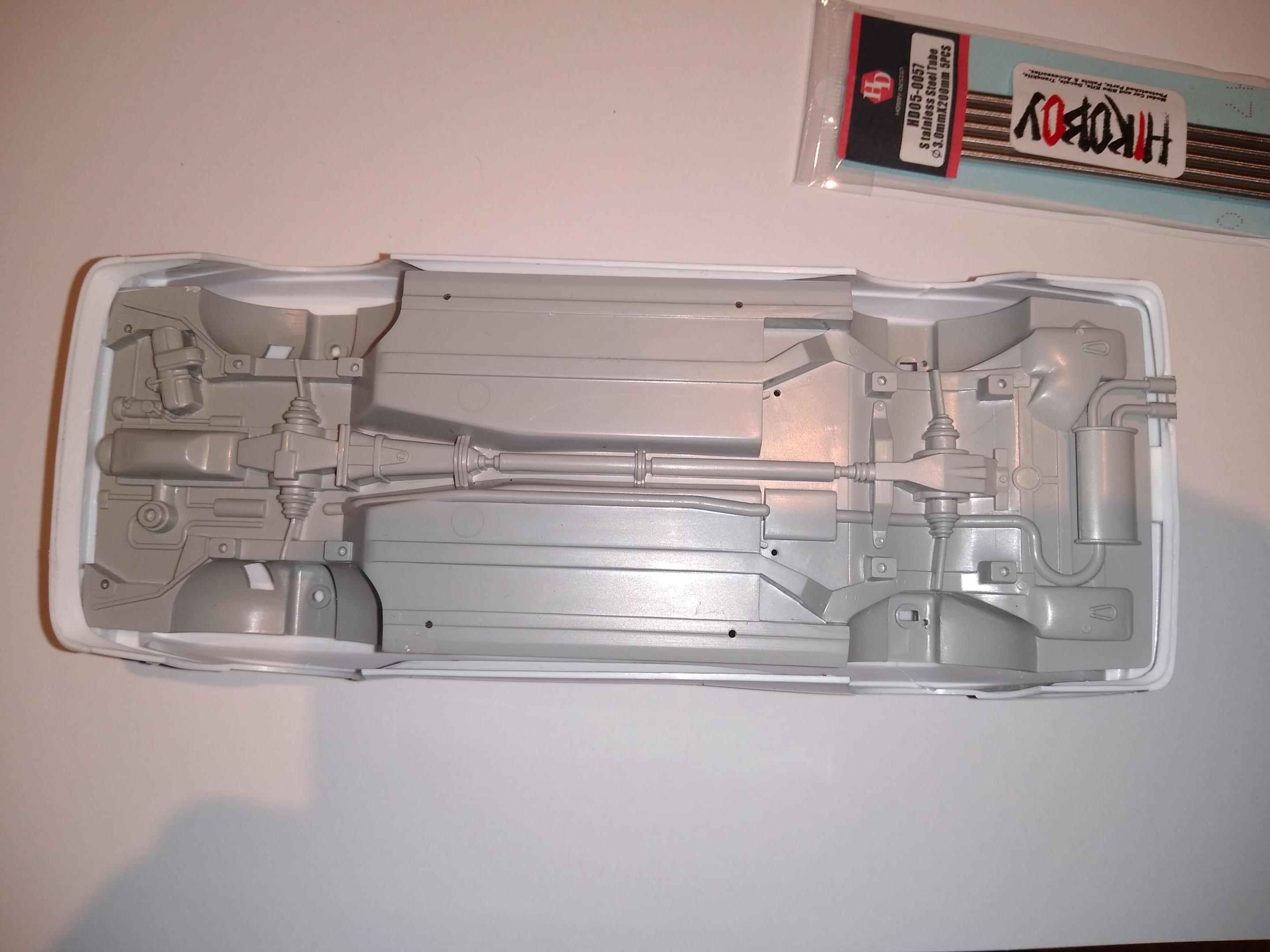

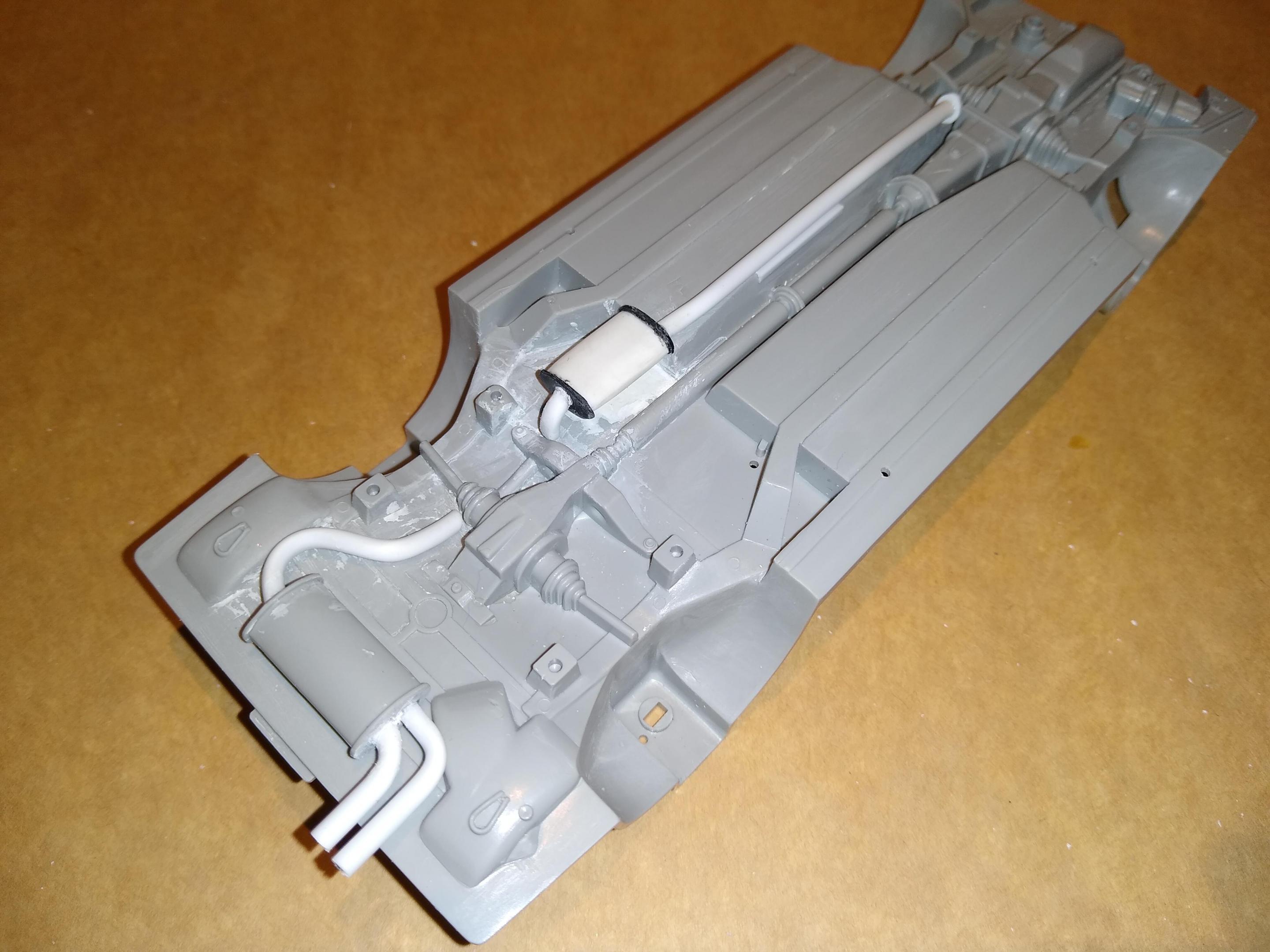

Got myself some 3mm steel tube to do some exhaust tips for the first time, but it wasn't going to look right on the end of the stock system which is puny and moulded to the chassis as far as the rear muffler:
I decided to do away with the whole thing (well, almost all) and set about it with a chisel blade & sand paper. The centre muffler turned out to be hollow and left a big hole to be filled...
When tidying up (above) I managed to sand away the rear muffler locator tabs, so I drilled them out and glued in some wire. Decided the easiest way to mount the mid section was to glue some 1.5mm angle strip to to the edge of the tunnel to sit under the pipe. Also found I needed to file/sand the corner section of chassis where the mid pipe meets the centre muffler.
For the pipe I used 2.4mm tube. I always planned to use wire in the ends as locators but discovered it was best to run it through the whole length of tube to support bending it. I made the replacement muffler by gluing together then shaping plasticard. The final touch was to add a flange towards the front (drilled/shaped plasticard) and close up any joint gaps with putty.

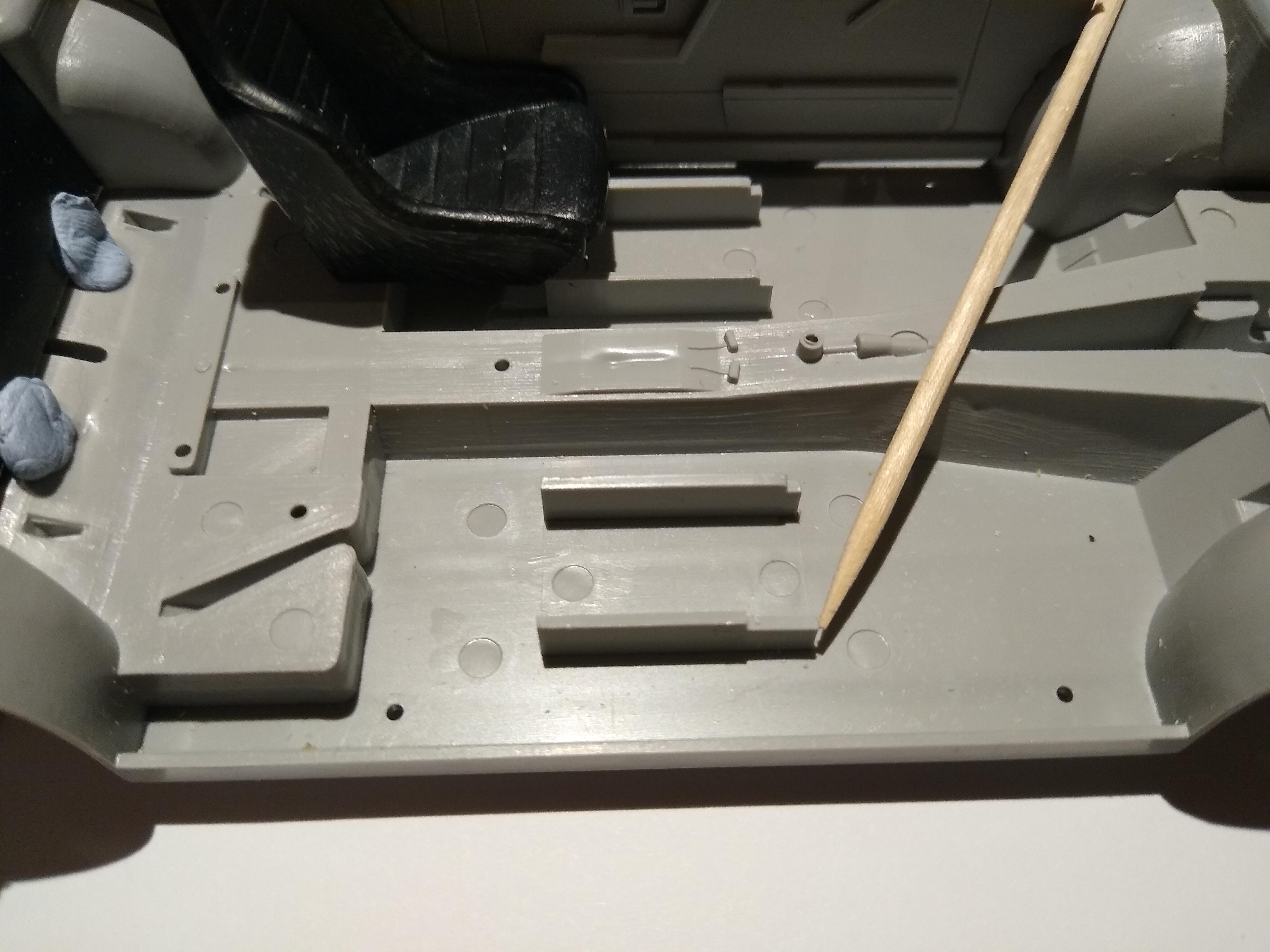

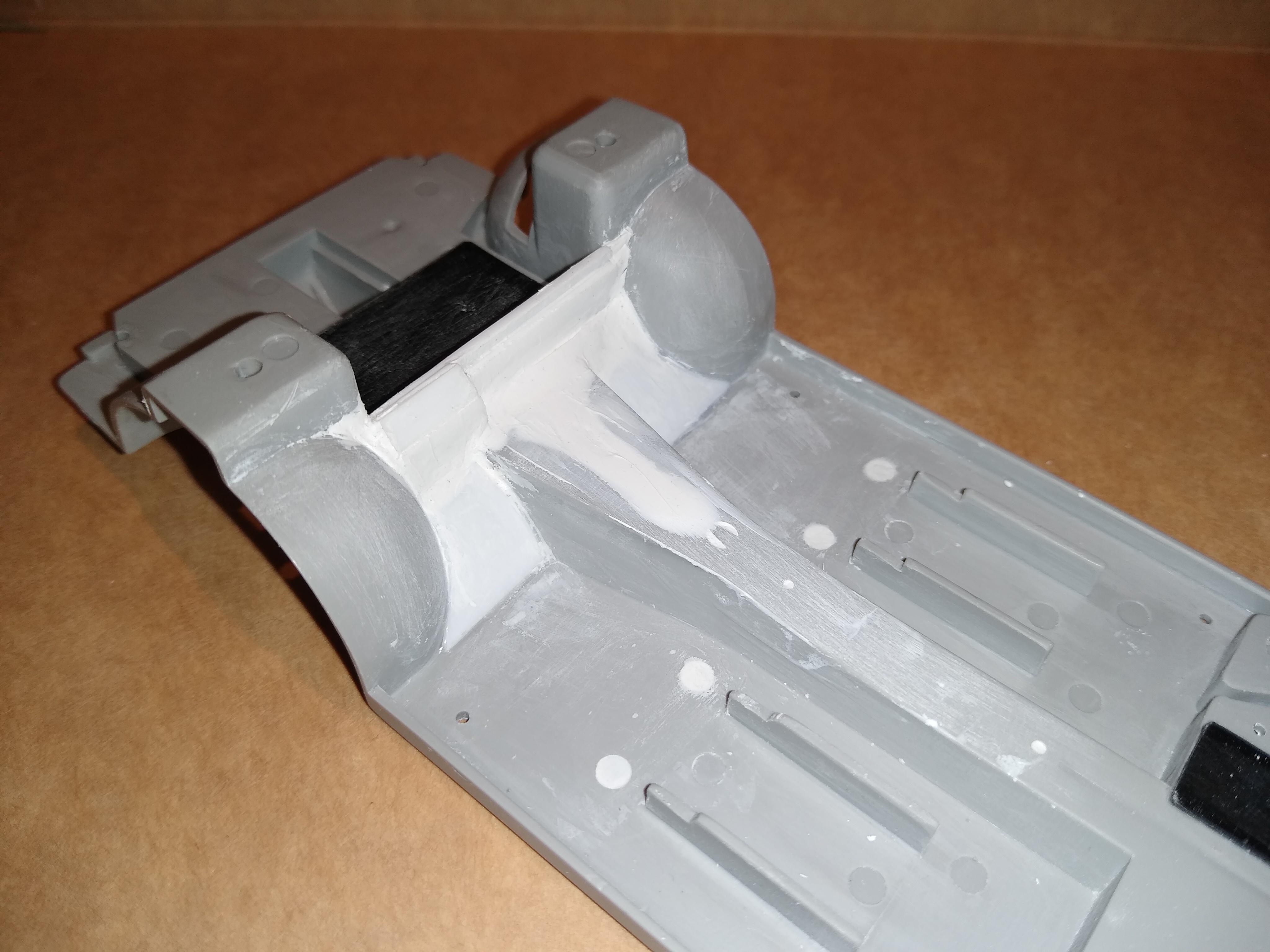

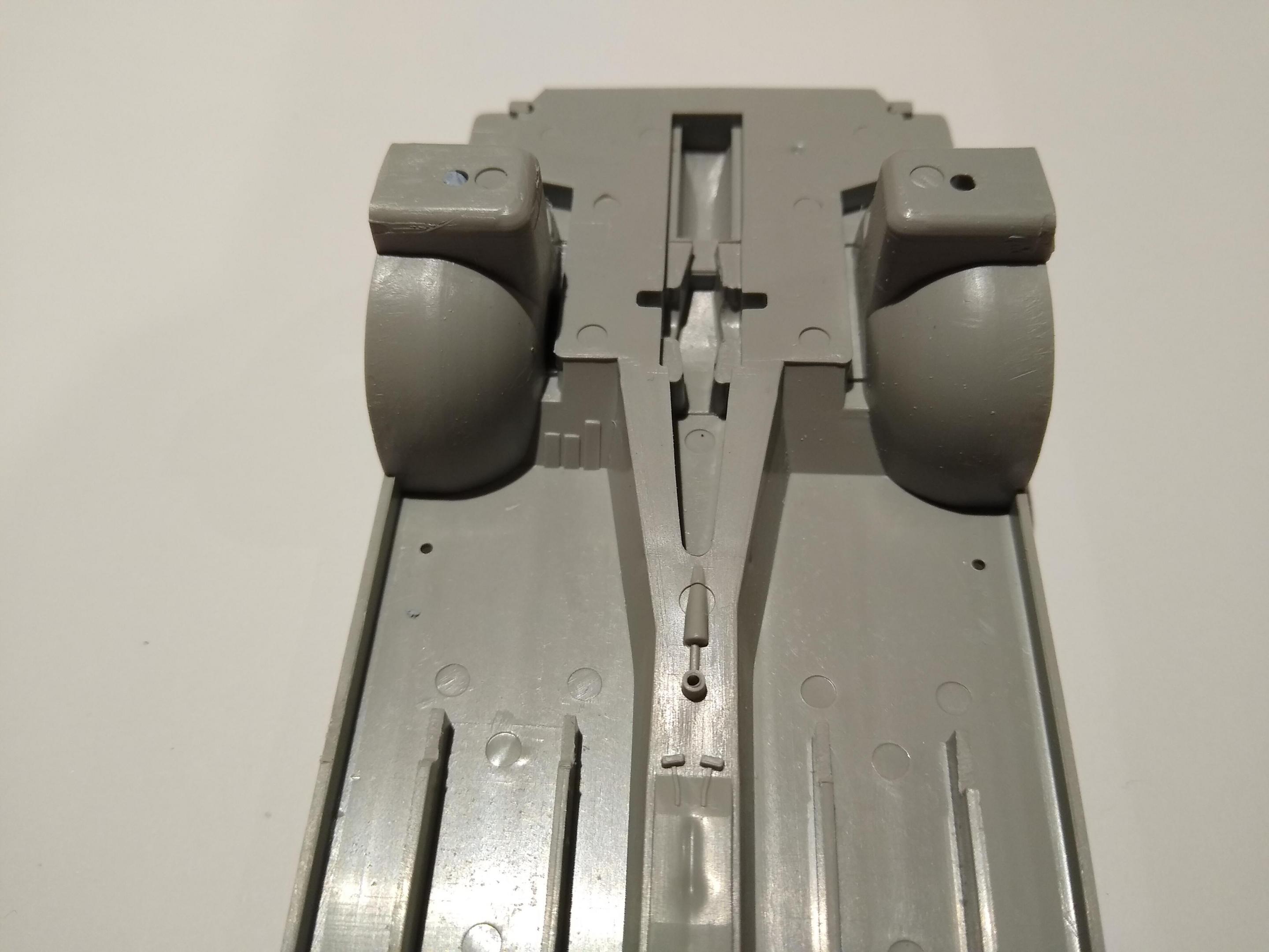

Back on the top side (above) I needed to build a bracket to mount the pedals, so got busy with plasticard & Milliput. Not the most elegant solution - it "evolved organically" -  but all is now set for the pedal arms to sit exactly where I want & at the desired angle. Finally, I've gotten ahead of myself slightly and finished a replacement steering wheel as the stock one belongs on a station wagon...

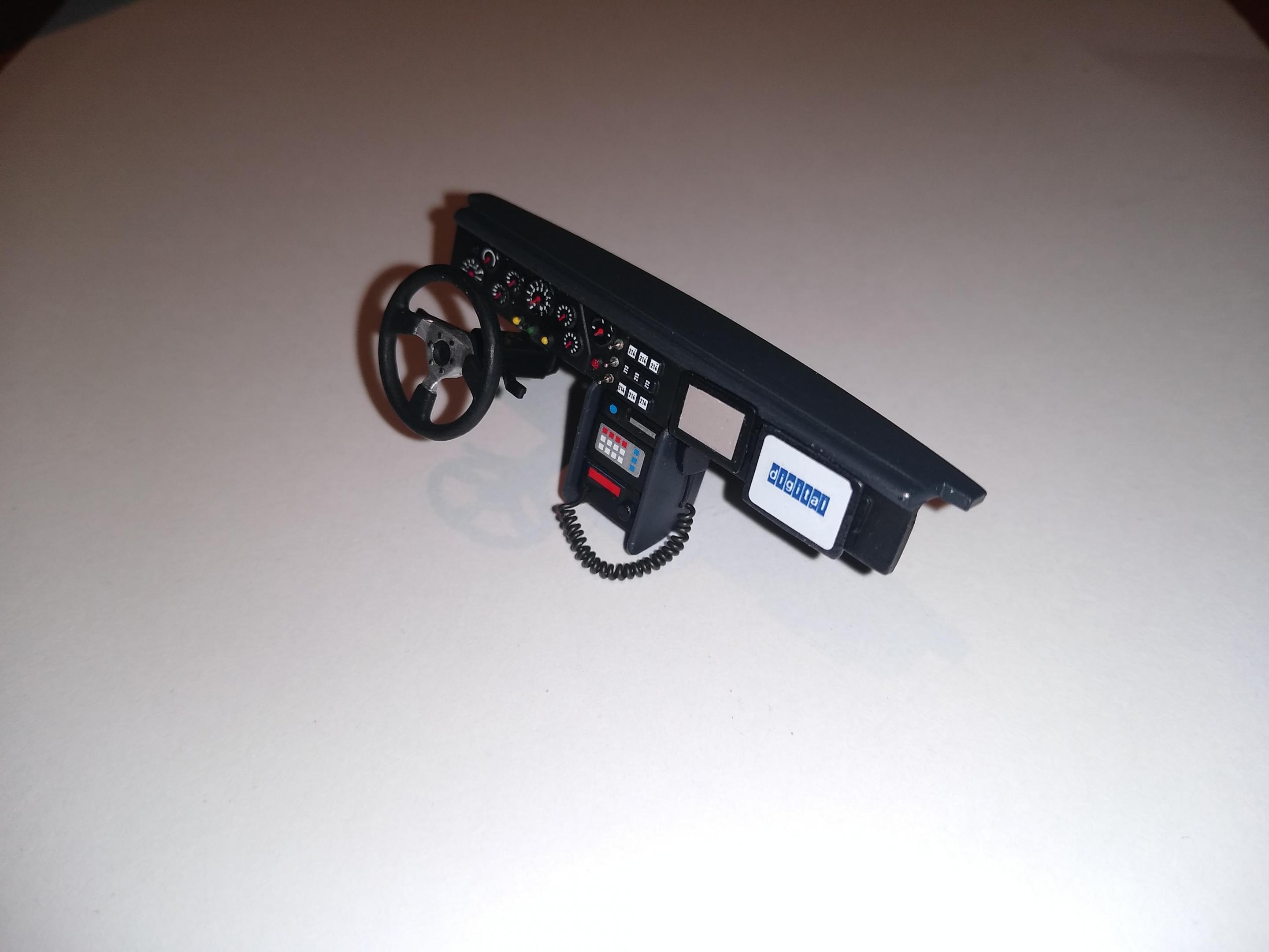

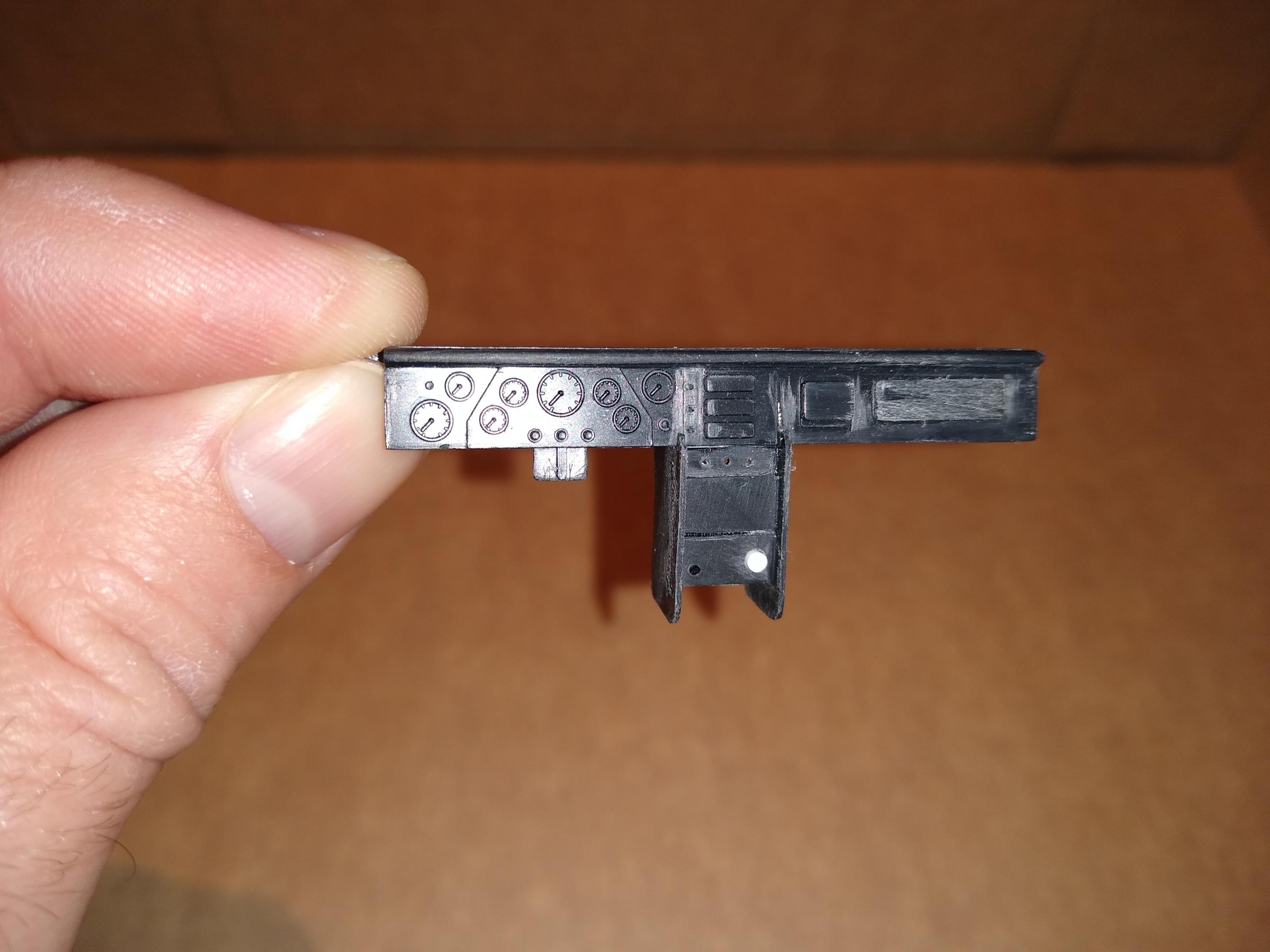

Some more first-time modification work completed. First up, I built a central console to sit under the dashboard as the kit doesn't feature one. After researching, it seems most rally Quattros had custom layouts and cars were seldom the same, which is cool because this is the first build where I'm allowing myself to go my own way! I based my design (loosely) on picture I found of a later Quattro S1:
The top section has holes for some more toggle switches; the middle will be a police scanner and the bottom a CB radio - the hole will house the handset cable. Below is a rear view of the structure which uses angle strip and tubing to brace it.

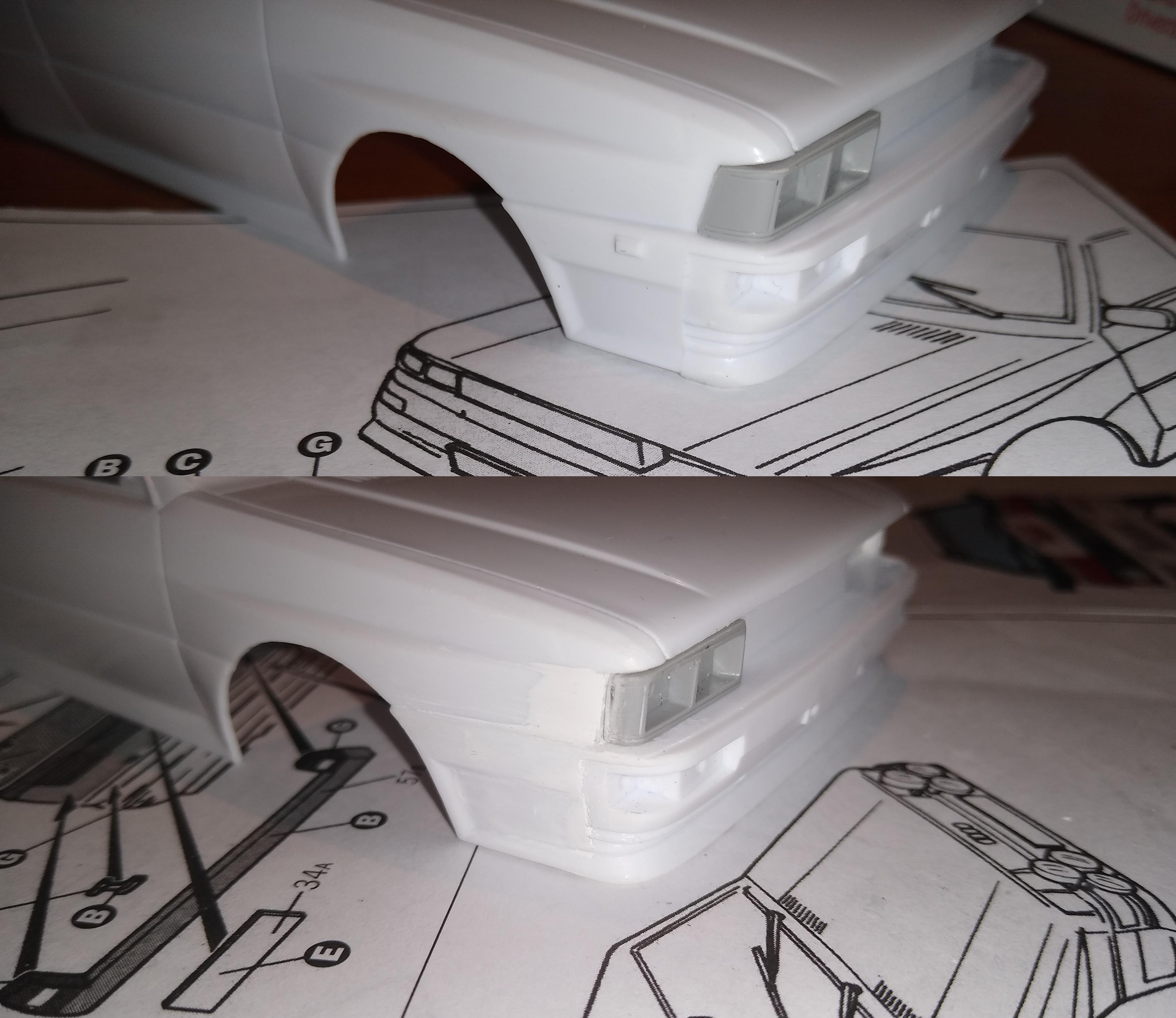

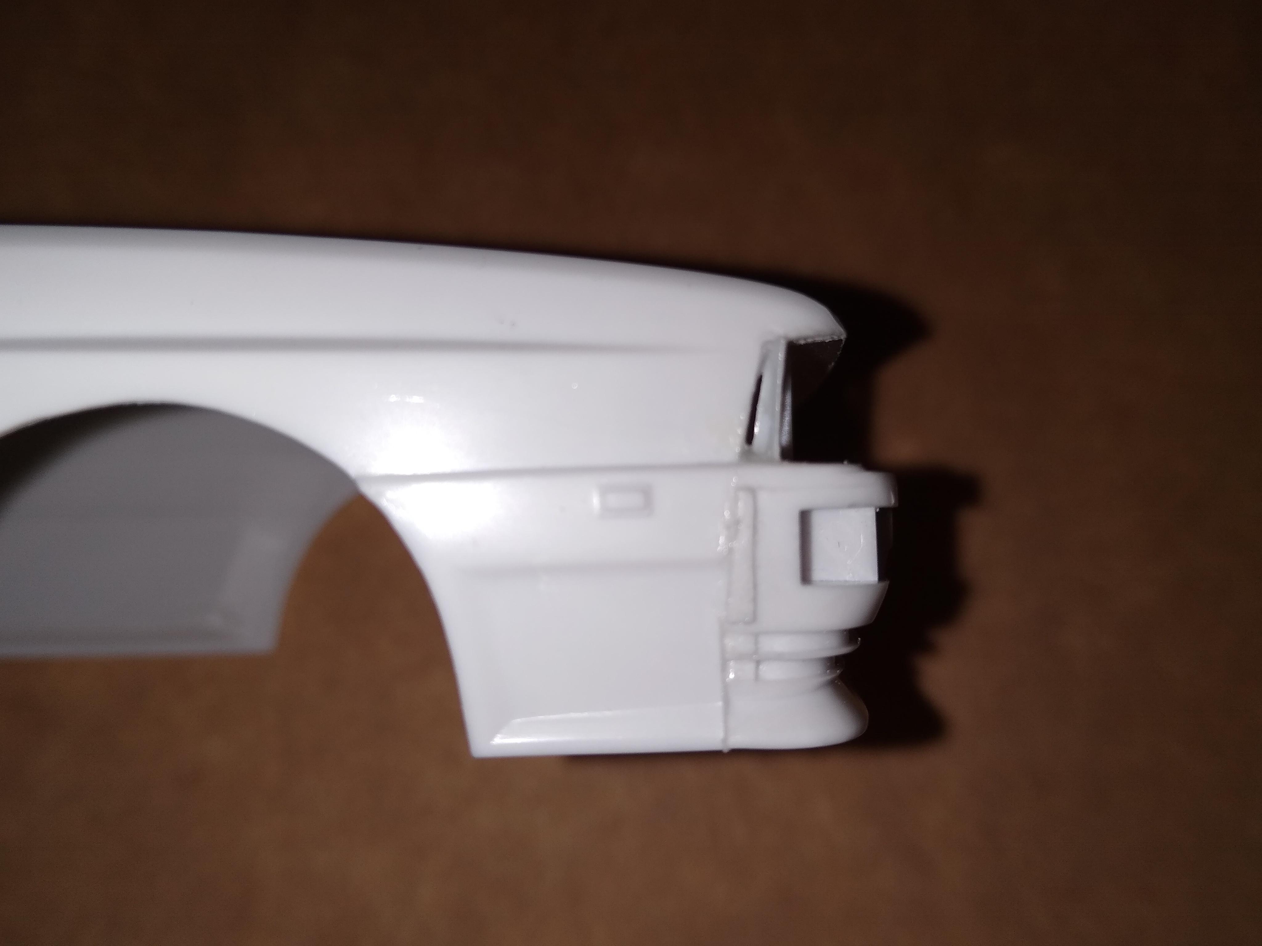

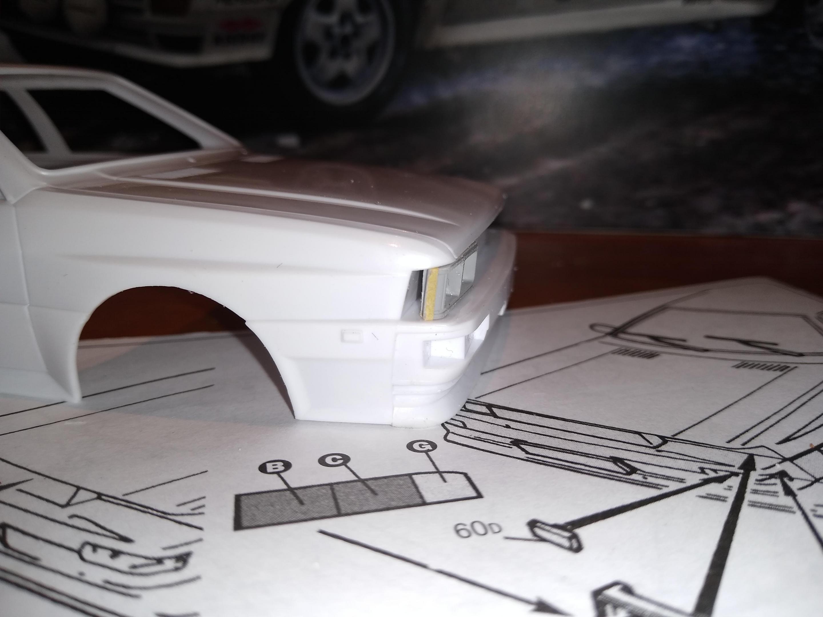

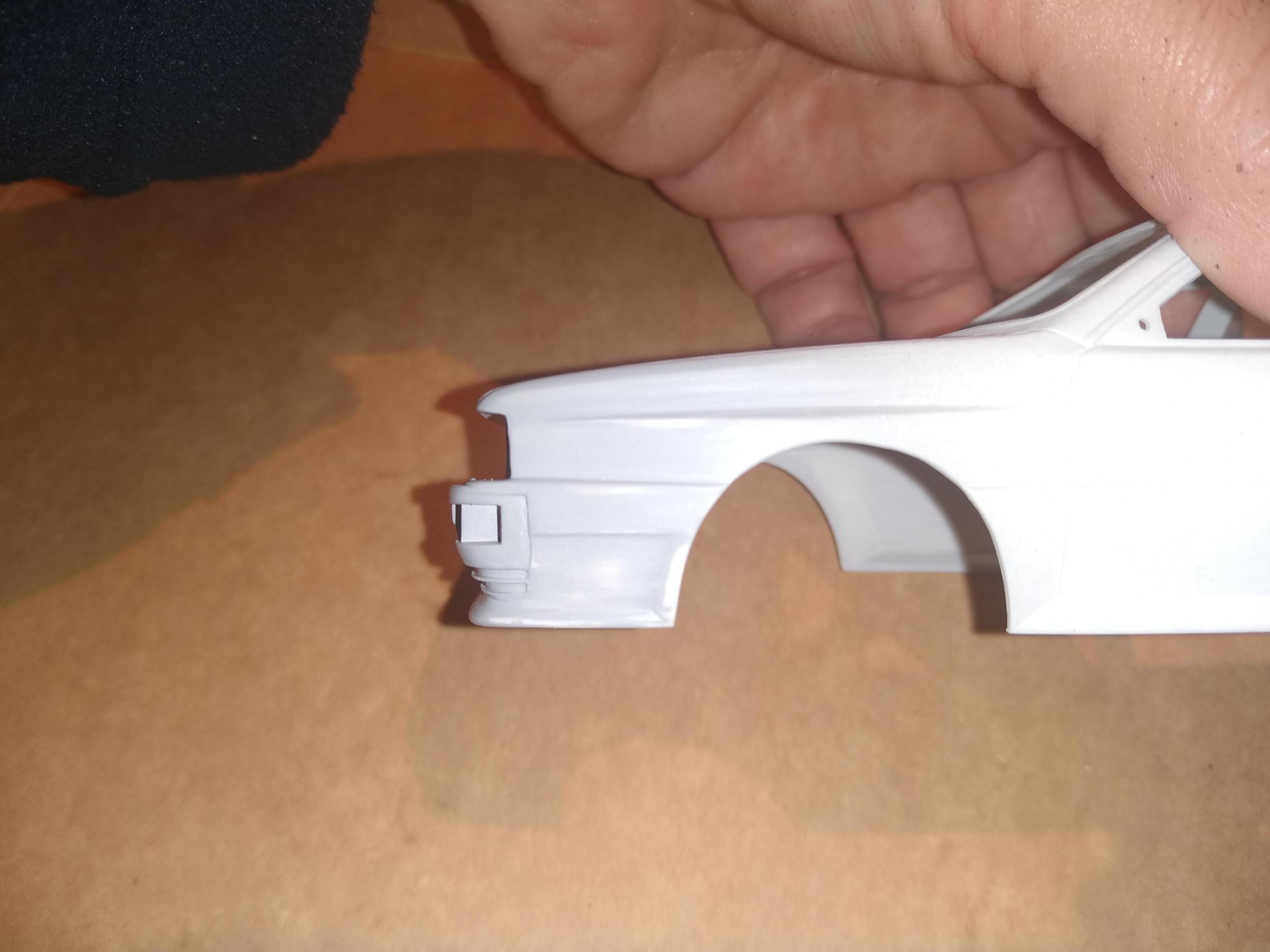

Next, some bodywork alterations. Here is a picture of what a box stock build is supposed to look like:
And here is a reference pic of the '81 era road car. Notice that the upper indicators are somewhat different in width, along with the depth of the bumper recess:
Not a big deal, perhaps, but as I have a chance here to experiment/learn I figured I'd try altering it. First I cut down the lights with my awesome new Zona razor saw:
I actually cut too much away (great start!) and had to build the indicators back up slightly with two bits of 0.5mm styrene. Next, I used 2.5mm angle strip to create a solid square edge up against the lights, plus I glued strips of 0.5mm styrene into the recessed areas beneath:
Then I shaved/sanded back the plasticard and filled the gaps with Millput. I also elected to get rid of the repeaters; an idea I got from Nigel's build (above) and because I've come to realise that no car ever had it's looks improved by them! (Where will this new found anarchy end?! ?)
Had to sand & re-fill a couple of times, but it's pretty close to where I want it now. I'm guessing the primer/undercoat might show up small imperfections but I plan to sort them with a little Tamiya putty - if it ever arrives from Poland!

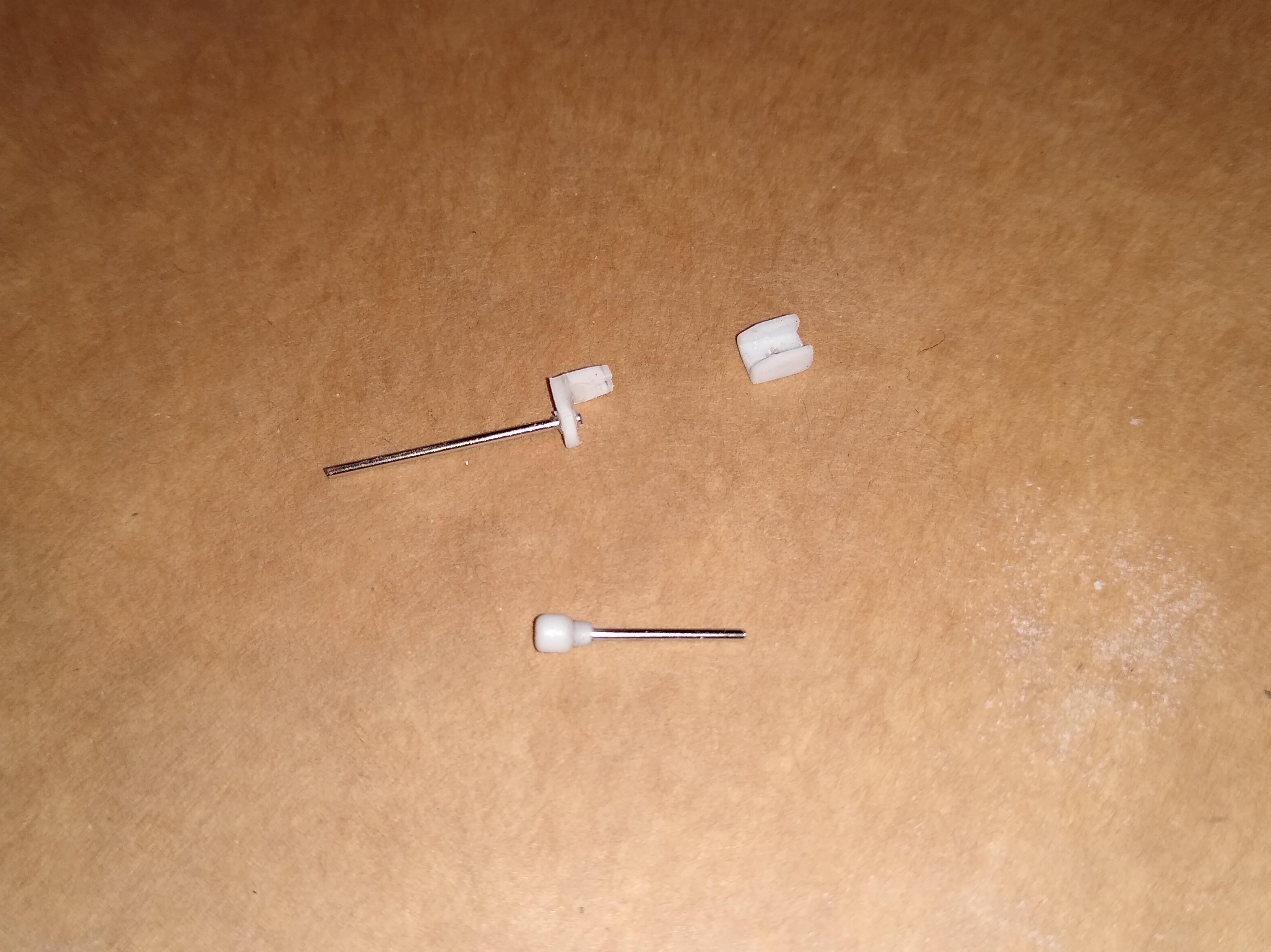

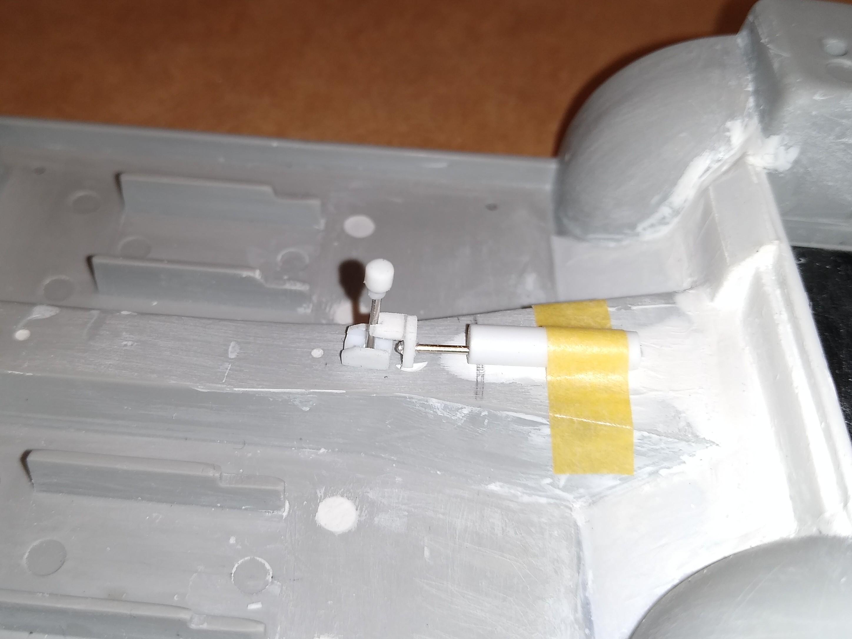

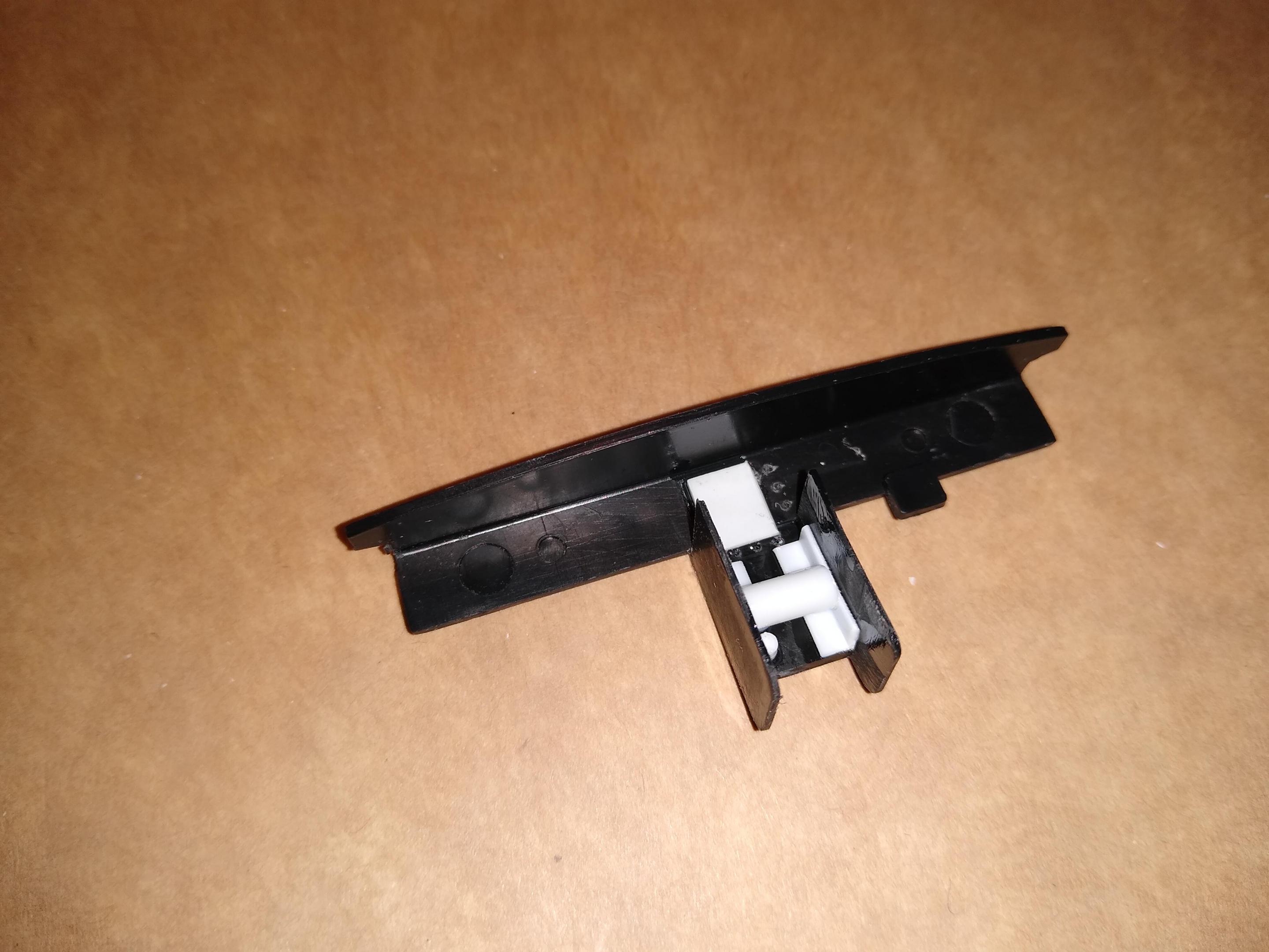

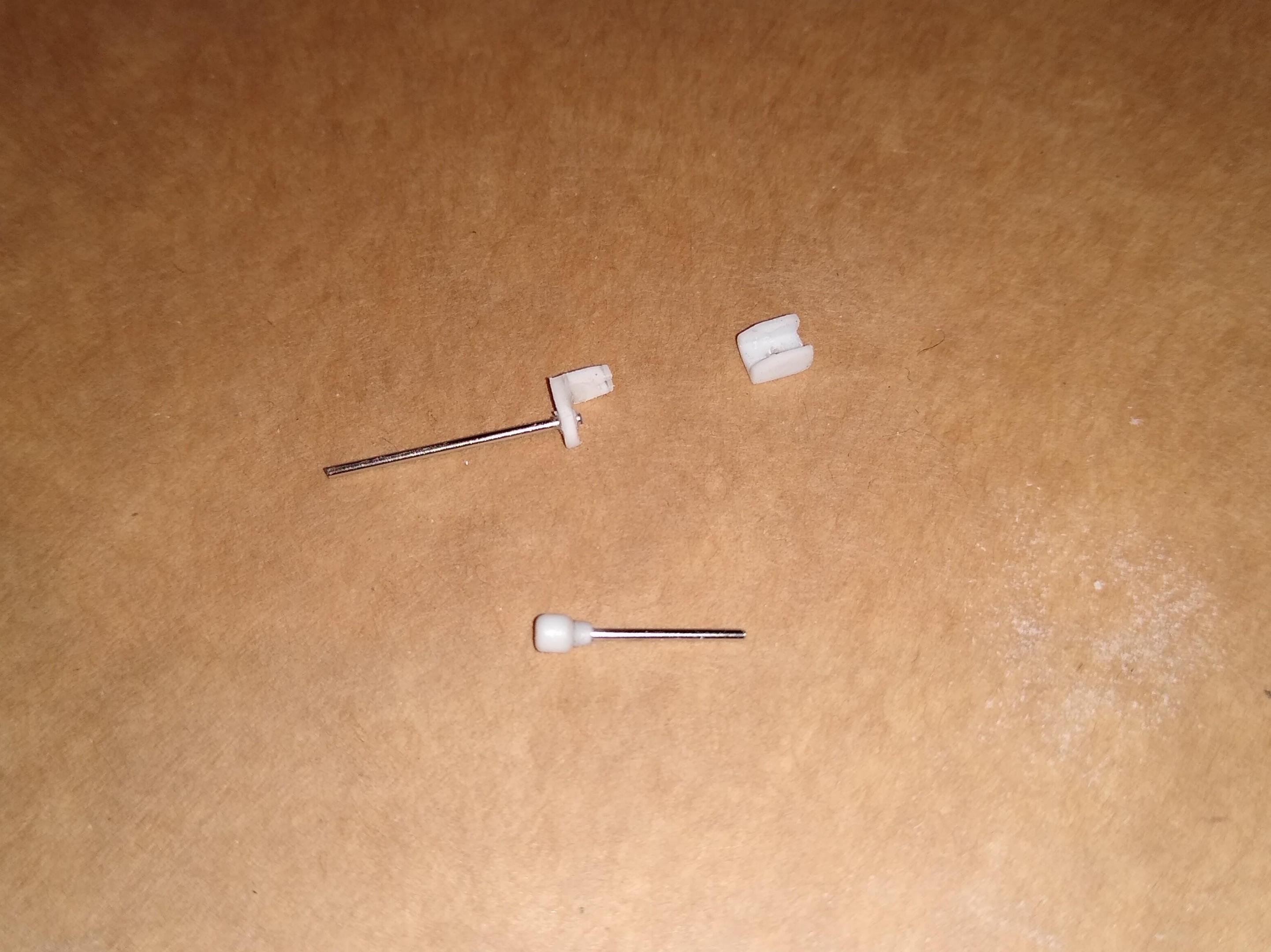

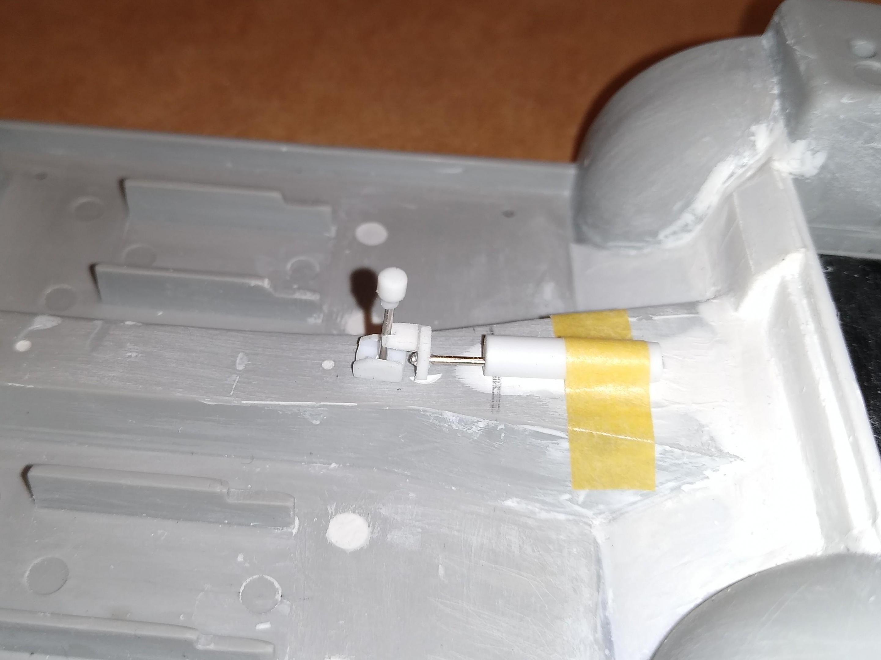

Set about scratch building a replacement gear lever & linkage. My design ended up being a pick-n-mix of various reference photos; I used 2 needles, 1.6mm & 2mm rod, 2.5mm angle strip & 0.5mm plasticard:

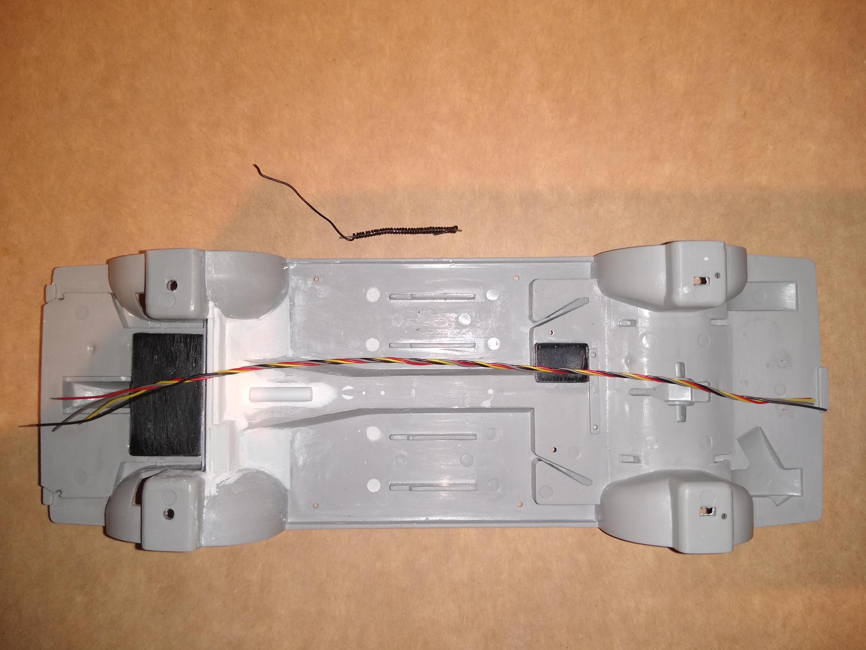

Always one to put off bigger tasks if there's something nice and small to do, I've manfully tackled the issue of wiring... ? Below is the wiring loom I plan to run from the dash to the trunk, plus a curly cable (wire wound around wire) for the CB handset - all wire from Zero Design. Full disclosure here: 1) I might not have some of the equipment I'm planning (e.g. CB radio) if it weren't for the ideas within an article on real life Cannonballers posted by @89AKurt in the 2020 CBR build thread, so thanks to him. 2) The wiring is fully lifted from inspired by @lghtngyello03 and his awesome Pennzoil Skyline build ?: I did warn him I was studying his work carefully!!

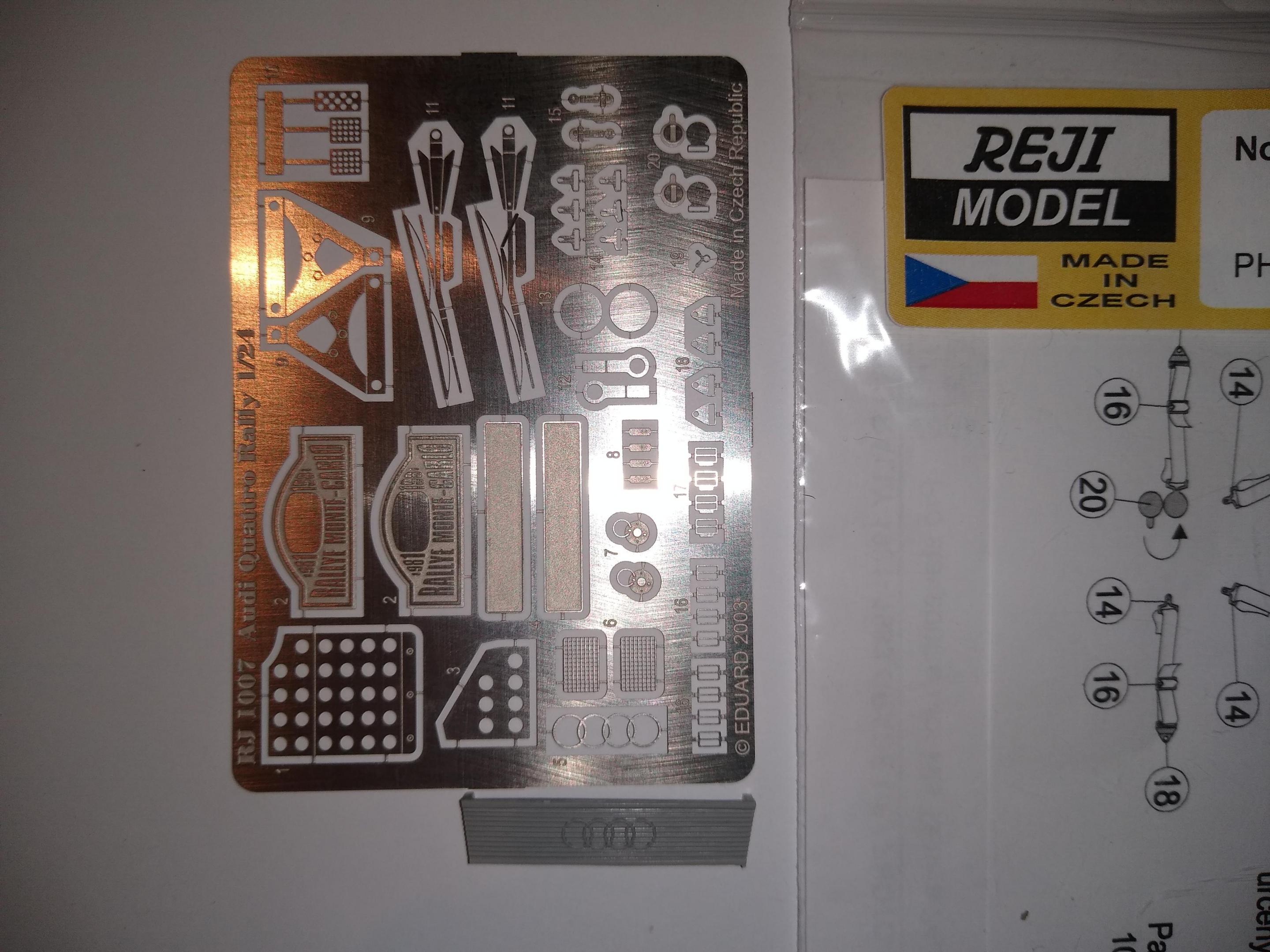

Have also taken delivery of the photo-etch set from Reji:
I plan to use most of it & save the rest for other projects. The front grill (bottom of pic) has an embossed logo on it which is somewhat smaller than the PE version. Having paid for it, you can bet I'm using the PE one, so I've shaved of the raised plastic with a chisel blade & reckon the upgrade will cover it well enough. I'm still fairly new to PE & am undecided on which adhesive to use here. Any ideas welcome - preferably something from my existing range ?!

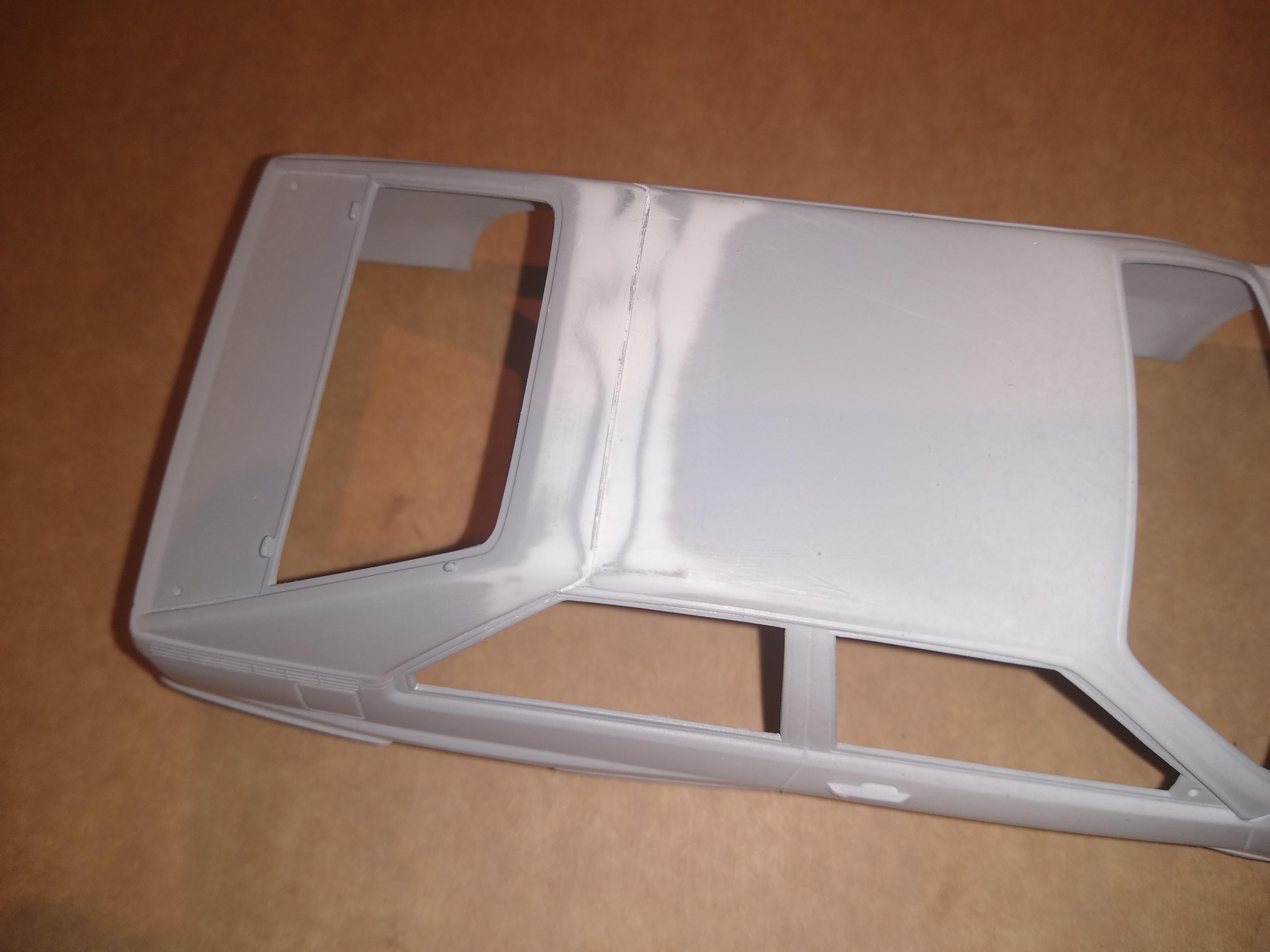

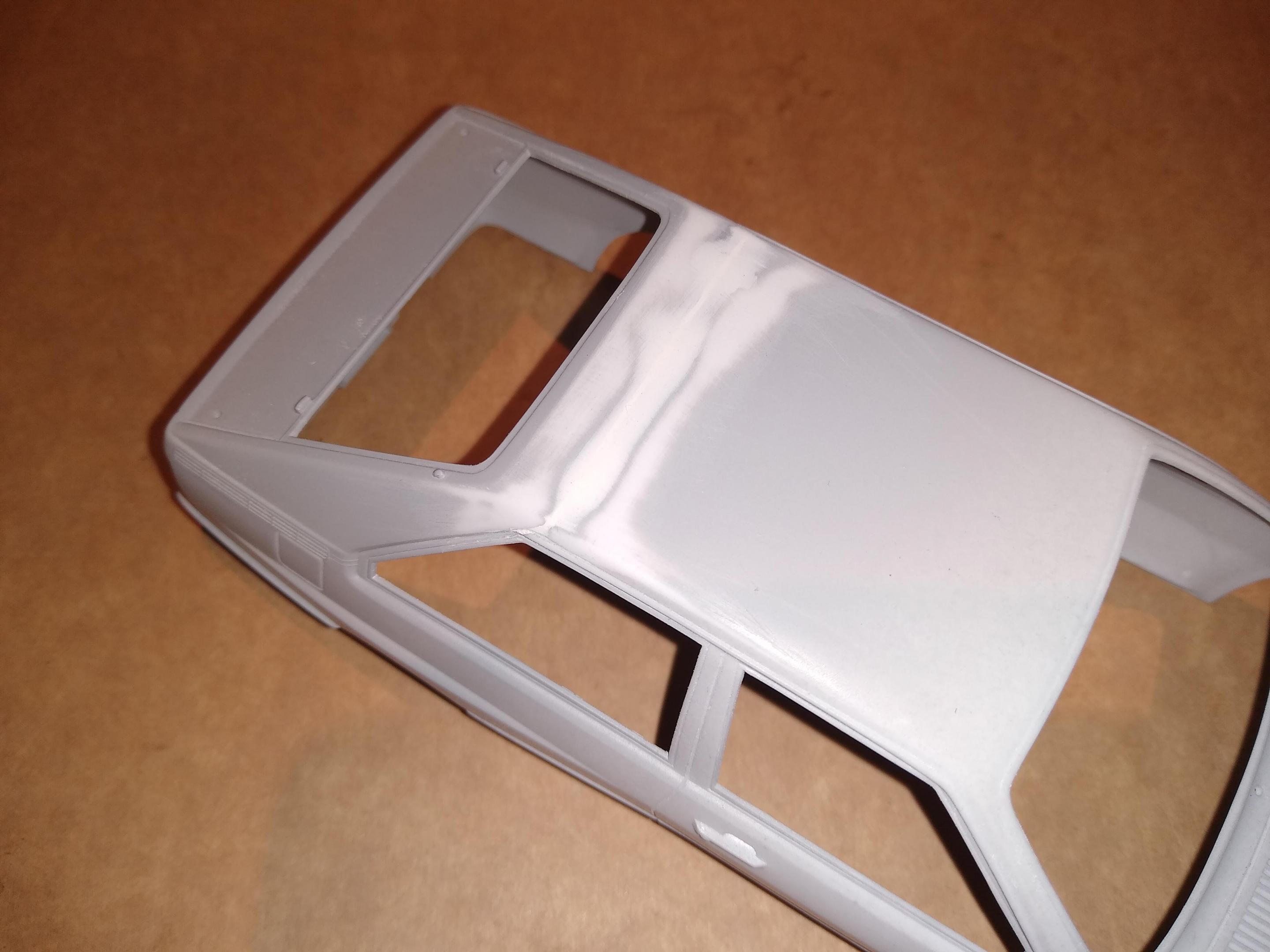

A bit of progress. The bodywork prep has been a long journey that I didn't forsee, not just because of the front end modification but also because of all the cleaning up & scribing needed. First up, I finally got the Tamiya Basic Putty delivered so I could finish the front wings:
First impressions of the putty are favourable: it's quick to apply (and set!) & it sands down nicely. I had to fill, sand, then prime 2 or 3 times to get things right, but it's all good training?

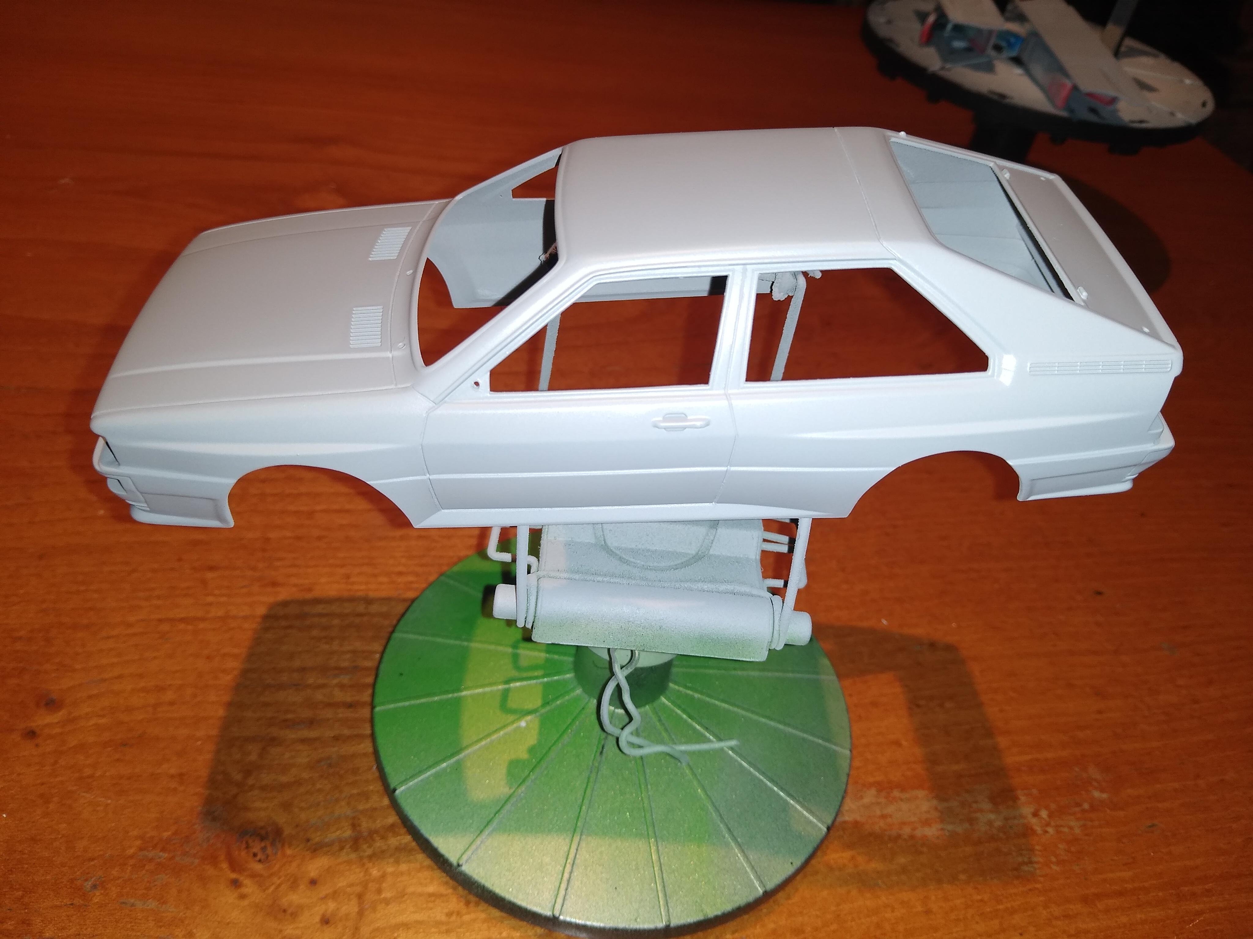

In altering the indicators/wings, I ended up studying the shell pretty closely and unearthed other significant deviations from the 1:1 car. (I'm not a Quattro afficionado, so I'm learning on the job). The most significant of these is the shape & size of the front bumper, but it's beyond my skills to do anything about & I'm content to just make the best of what I've got.
Although not visually obvious, when you pick up the shell you're in danger of cutting your fingers on every single edge because of all the flash! Had to get pretty busy with a de-burring blade before any sanding could take place. I also felt the need to deepen & widen every panel line with my new Tamiya line scriber (which I found to be great) although I got a bit carried away and messed up the boot line on the roof:
I tried a quick repair with the Tamiya putty, but found that the edge crumbled when I came to re-scribe. Ended up having to fill the whole thing with Milliput & start over. When I came to scribe this time I employed a trick I recently read & used Dymo tape to act as a guide:
Starting with a needle scriber I made a number of passes very gently before going to the line scriber:
Still went a bit overboard second time around (I'll have to watch this!) but it's tidy & I'm happy enough. It meant I could finally get the undercoat on!! ?

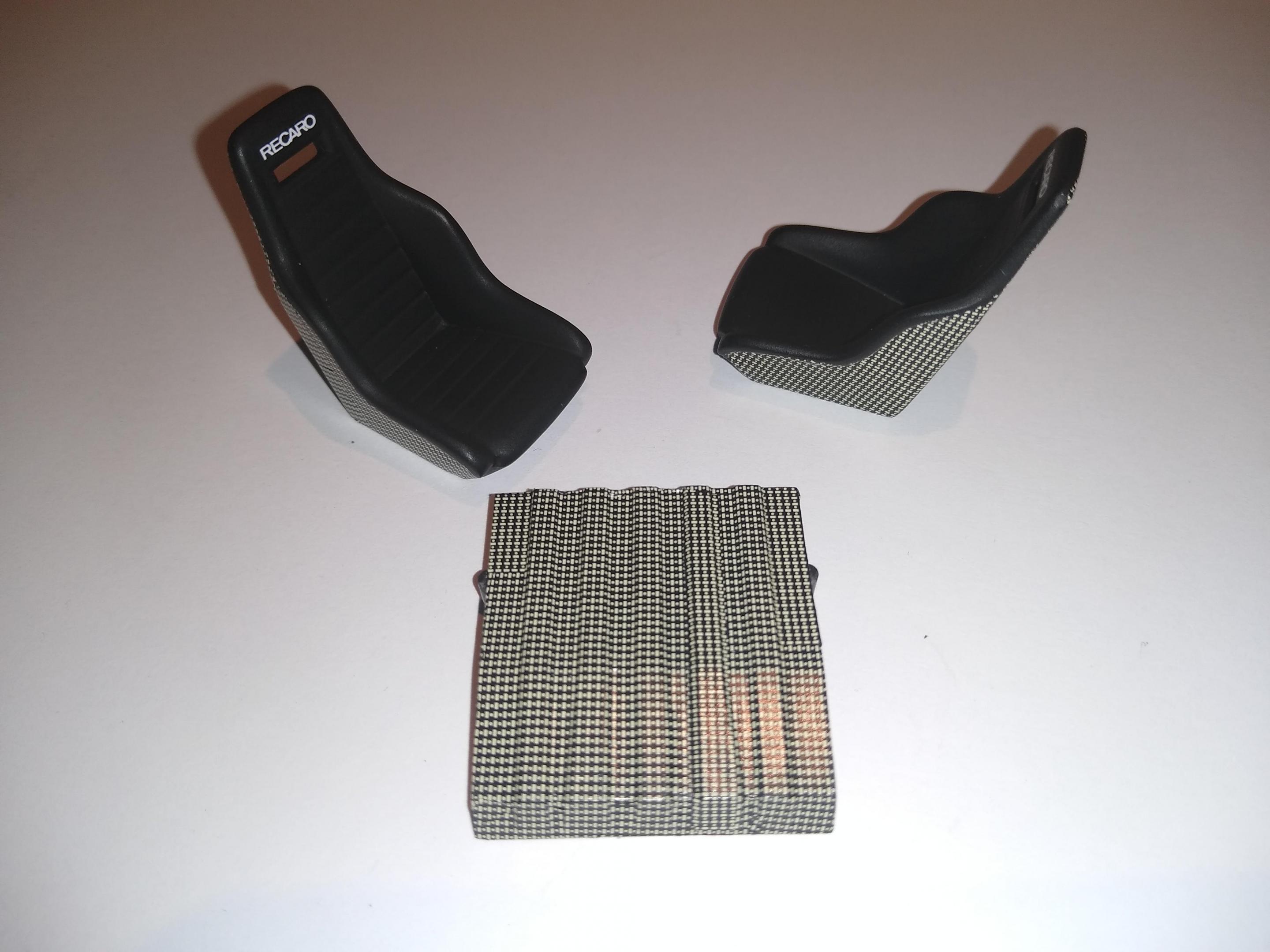

Weight saving is my weapon, so I did some carbon Kevlar decals on the seats & sump guard. I don't think the 1981 cars had Kevlar components (I'm happy to be corrected) but this is 2021 and it's MY car!

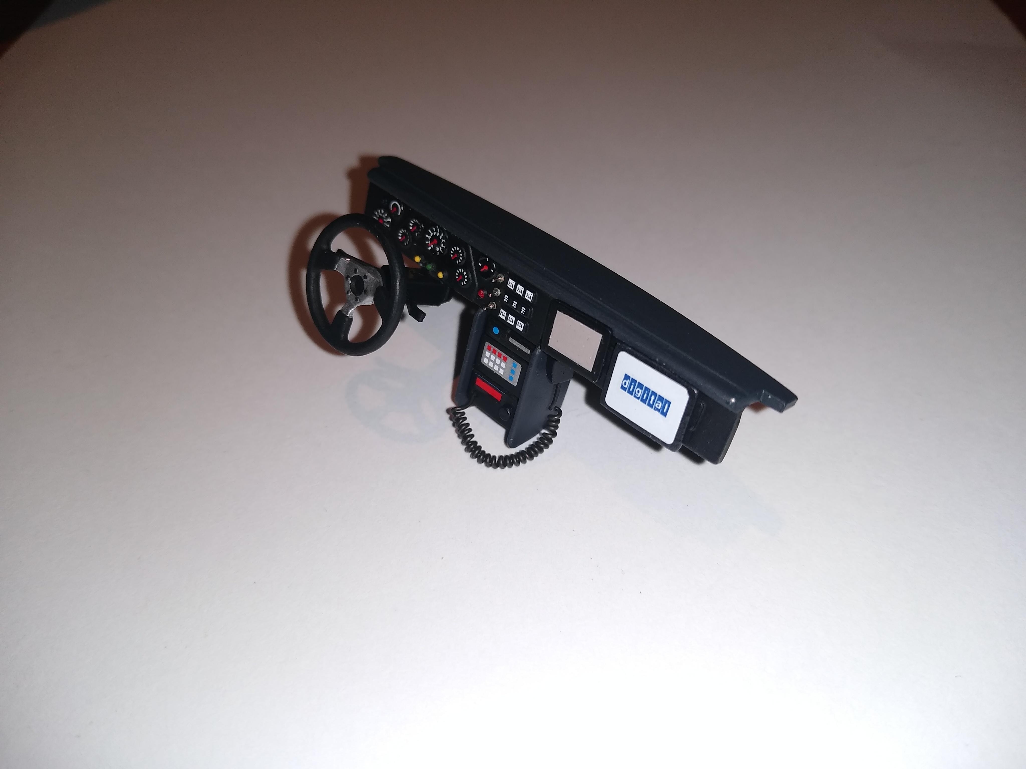

Finished up the pedals. I painted them black then sanded them a bit & decided on the used look. Also above is the front grill which I'm pleased with because I've now all-but-disappeared the embossed Audi badge with a chisel blade & scriber. Lastly, I've been working pretty hard on the custom dash and am now finished:
The PE toggle switches were a nightmare! I lost so many of them that I abandoned ship halfway & just used 3. I made a GPS (grey screen) & a tablet (white) and had fun repurposing old decals for the screens and the CB/scanner. Thanks for looking ?

The dash looks Great Peter...like the Blaupunkt stereo
Carry on Cannonballing !!
Cheers
5 hours ago, Steve H said:
Great work here Peter. The dash looks fantastic!
Cheers, Steve
Thank you both, Bruce & Steve  - I did take a disproportionate amount of pride in the dash!!?
