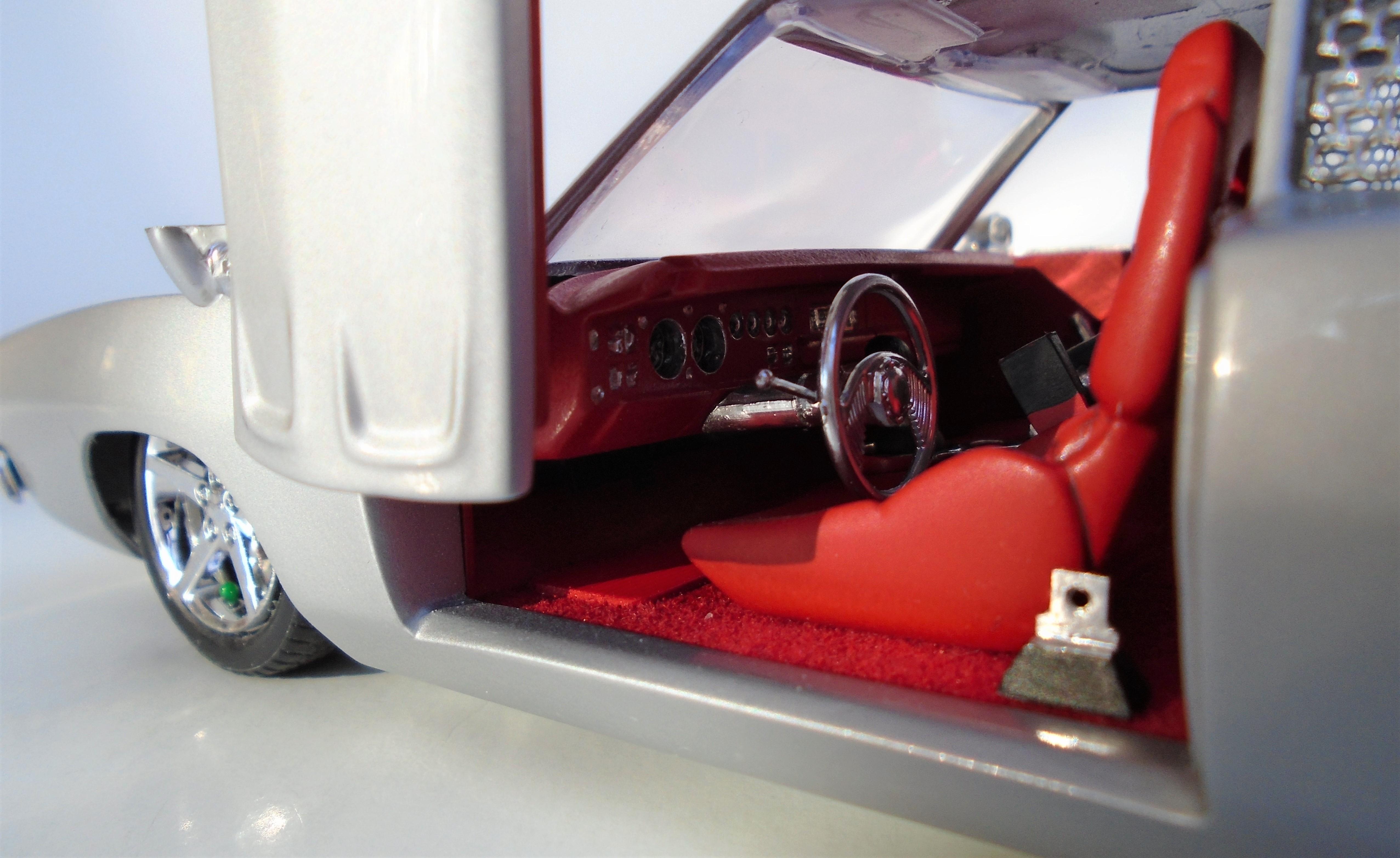

Claude Thibodeau Posted January 20, 2021 Author Posted January 20, 2021 7 hours ago, 89AKurt said: Impressed with the concept, and execution. I know you spent a few hours. The door operates like the Koenigsegg? Hi Kurt! Thank you. The structure of the door has a tube that enters and slide under de dash. You first pull it out, and then swing it up, out of the way. I looked at the Revell Uptown Chrysler 300 kit's pivot mechanism, but it was too bulky, and would have left a gaping hole at the front of the door jamb. So, I duplicated a system that I once used on a 1/1 car to do just as on this charger, powered by an electric actuator. Of course, the Charger unit is "finger powered"... CT

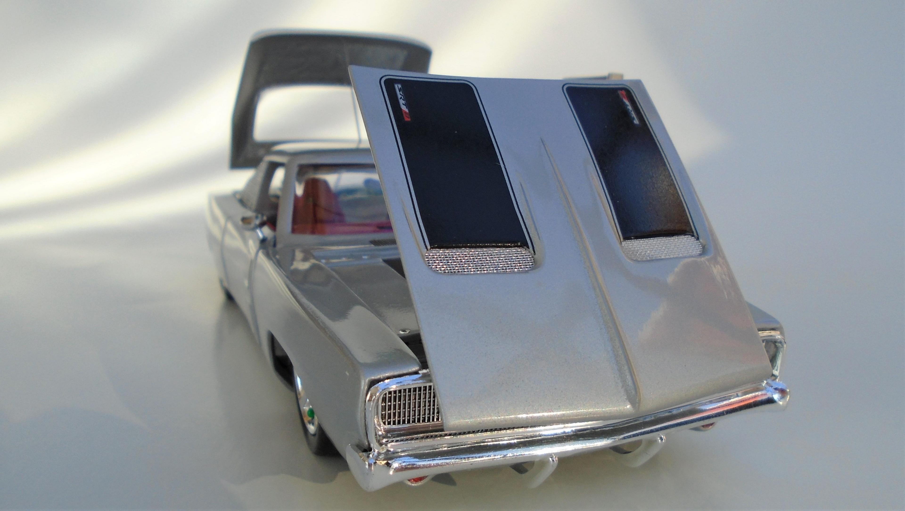

Claude Thibodeau Posted January 20, 2021 Author Posted January 20, 2021 5 hours ago, michelle said: did you do any mods to the grille Hi Michelle! Not, not really. I used black wash to highlight the grille motifs, and some red ink on the R/T badge, but that's it. The real action is at the back of the grille, where I glued the hidden hinge system to the grille itself. The hood and grille were then glued in place as a unit. Took more time, but allows for a smooth projection of the hood when opened. CT

michelle Posted January 21, 2021 Posted January 21, 2021 2 hours ago, Claude Thibodeau said: Hi Michelle! Not, not really. I used black wash to highlight the grille motifs, and some red ink on the R/T badge, but that's it. The real action is at the back of the grille, where I glued the hidden hinge system to the grille itself. The hood and grille were then glued in place as a unit. Took more time, but allows for a smooth projection of the hood when opened. CT cool i was wondring why you had not posted a front shot of it with other pics you posted and was curious if uou might have had the headlights fliped open or some other mod that would have been different

Claude Thibodeau Posted January 21, 2021 Author Posted January 21, 2021 1 hour ago, Koellefornia Kid said: I´m usually not a great fan fan of scissor doors but hey totally fit to the overall concept of this Charger, which is so coooooooooool...!!!! Hi Oliver! Thank you for the comments. Truth be told, I'm not either... Regular hinges were impractical, because the rear engine compartment required a sorter cabin (moving the seats forward a smidge), and the front door jamb would have intruded too much in the footwell... And suicide doors hidden hinges interfered with the headers and turbo pipes set-up. So, it was either no opening doors, or scissor type. My decision allowed me to show more of the interior details, ultimately, since both doors are operational. CT
