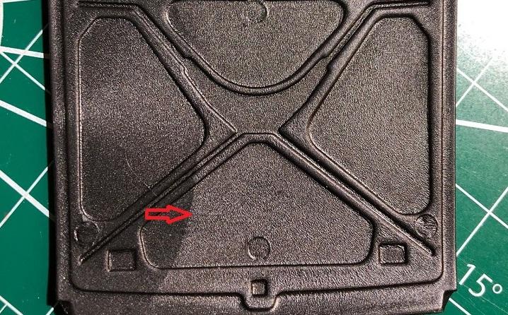

Hello, here is a picture of the '63 nova underside of the hood, you can see the "ghost" line by on the left side by the different shading on each side of the line.
That's exactly what Casey said, it's where the plastic meets in the mold when coming from different directions.
I bet that's a nice coat of Duplicolor lacquer that you sprayed on that hood and the texturing and line wasn't there before you painted it.
Every plastic kit has that somewhere, not just the new ones. It's just a matter of how the plastic interacts with the paint.
A couple light coats of BIN over the primer to seal it before the color coats and that's not an issue.
Looks like you've got crazing in there. Start by trying to sand the texture out - esp. on the top, and use a better primer before spraying the black paint on. I think the black paint is too "hot" for the primer you're currently using.
Think of the scar as the marbling effect you see on plastic kits molded in metallic colors. The plastic flows in the tool and meets at the other end, but doesn't mix together - thus the swirl look. It also creates a plastic variance where they meet, which is why the paint won't hide the mark.

Definitely crazing.
I have a few old scrap parts in my stash that look just like that; leftovers from my early experiments with Duplicolor.
As mentioned above; sealing with BIN or using a paint that isn't so hot should solve your issue.

I think you guys are missing the point.  The discussion is not about what looks like crazed black paint on the underside of that hood. The discussion is about the curved line on the lower left quarter of the hood.  That line is at the place where the color of the paint (or the light reflection) also changes, so the area to the left of that line is slightly darker than the rest of the hood. I had to look at the photo for a while to figure out where the problem was.

No, it has been mentioned...the line is a swirl mark at the meeting point of molten styrene coming together from different entry points.  Not really a flaw in and of itself, but the hot primer sure did make it stand out.

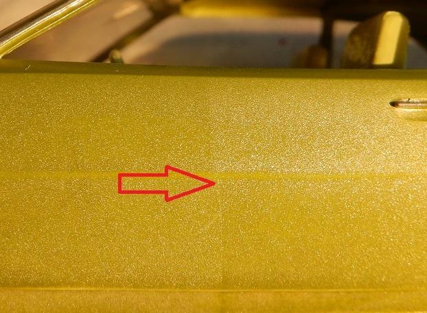

I was referring to the curved line on the hood, very similar to the line on the door of this old green Pinto.
Call it crazing or call it something else....it's caused by too-hot paint.
Yes, looks like we are talking about the same thing. But "crazing" is the rough surface on the entire painted part, caused by the solvent in the paint partially melting the plastic.  Like Steve said, hot paint that causes crazing also makes the "scar", this thread is about, more visible.  The artifact your arrows point to (the "scars") would be visible, even on unpainted plastic (before the crazing takes place).

The primer that was used could certainly have been "hot".  But, an otherwise usable lacquer primer will cause those swirl marks to show up if it is not sufficiently shaken prior to application.  There's been a general cheapening of these primers in recent years; less "solids" or pigment, more reducer.  If the primer isn't shaken thoroughly, you run a good chance of spraying what is essentially lacquer thinner, leaving the solids settling at the bottom of the can.  A good shaking (you should be able to roll the agitator around the bottom of the can) and applying the first coat from further away than usual, will often eliminate or reduce these problems.
As described in the initial post "Hello, I have noticed that in many of the newer AMT kits, the bare styrene bodies and hoods have these random "scar" lines in them.  It almost looks like a fracture, but I don't think it is", the flaw is already visible on bare plastic, before painting.  Spraying the body with hot paint just makes the flaw more visible.  The problem is not with paint, but with the manufacturing process.
