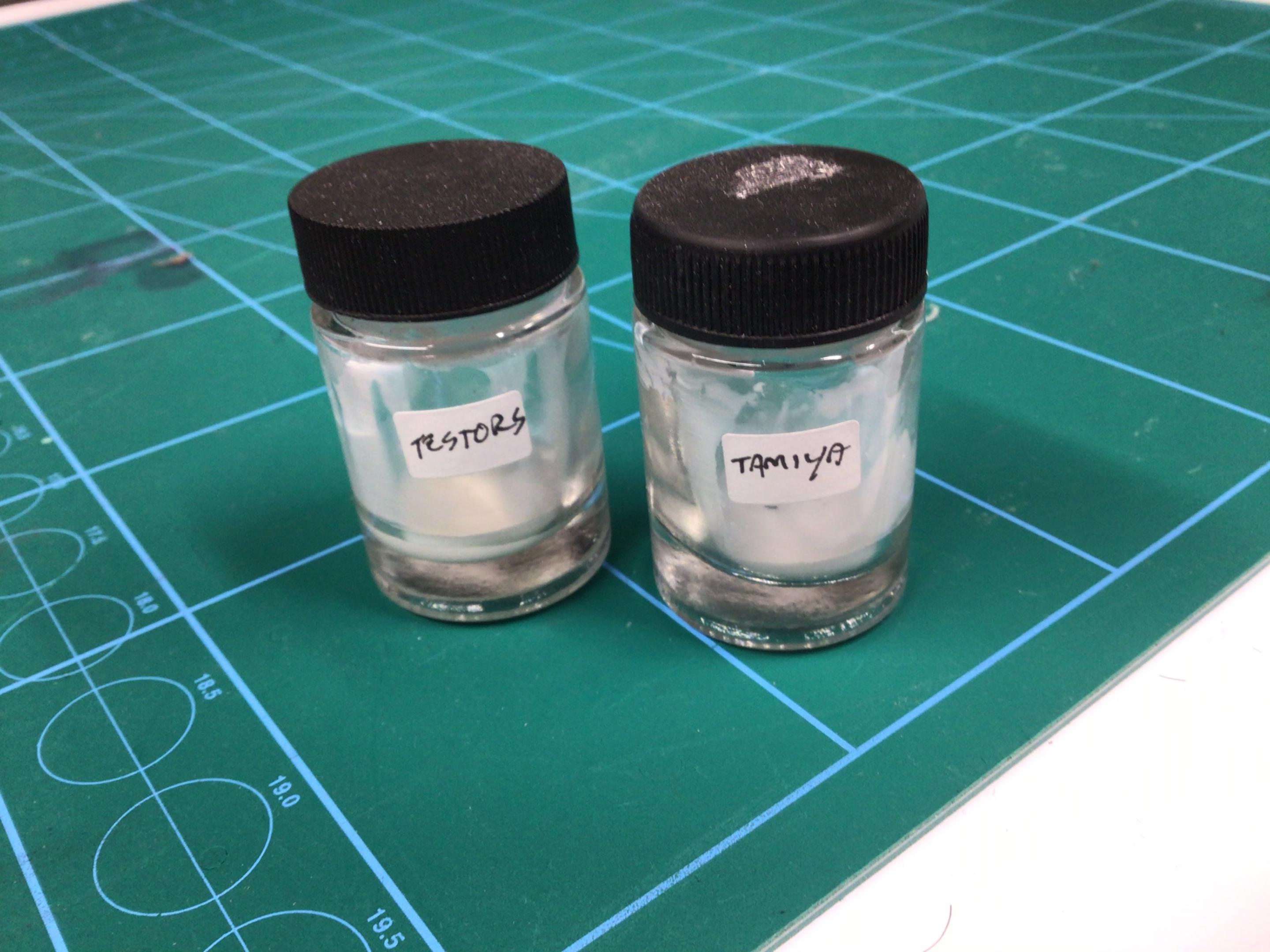

NOBLNG Posted May 10, 2021 Posted May 10, 2021 (edited) 18 minutes ago, Richard Bartrop said: I'm a big fan of using styrene to patch styrene whenever possible. Work some Evergreen rod of appropriate size into the seam with a generous amount of liquid cement, then let everything set thoroughly. I agree, but evergreen rod might be softer than the original styrene. I haven’t tried the epoxy that Bill recommends, but I have made “sprue glue” using styrene chunks and liquid cement. Preferably use the sprue from the original kit if possible. Dissolve chunks of it in liquid cement until you have a thick paste. Fill the cracks and let it dry thoroughly. It may take a long time, (start another kit in the meantime) but when it is fully cured it will be just like the original plastic. Then the lines can be re-scribed. If you have an old scrap body...experiment a bit. Edited May 10, 2021 by NOBLNG
Miatatom Posted May 10, 2021 Author Posted May 10, 2021 2 hours ago, NOBLNG said: Dissolve chunks of it in liquid cement until you have a thick paste. Fill the cracks and let it dry thoroughly. It may take a long time, (start another kit in the meantime) but when it is fully cured it will be just like the original plastic. What do you use to make your paste in? There's always several builds going at the same time. ?
Plowboy Posted May 10, 2021 Posted May 10, 2021 I fill the panel line in with a strip of styrene the thickness of the line, sand smooth and rescribe. I have fixed small areas by filling with Tamiya Gray Putty and rescribe with a photo etch saw blade.
NOBLNG Posted May 10, 2021 Posted May 10, 2021 10 hours ago, Miatatom said: What do you use to make your paste in? There's always several builds going at the same time. ? Little jars that I got from Michaels.
