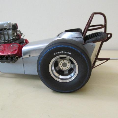

Completed front axle and wing now the proper color steering rod also in place
There's just something about a long-wheelbased FED! Beautiful replica of a beautiful car!

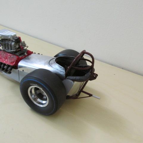

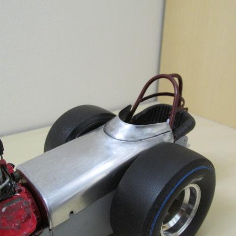

So I've been looking at the windscreen I built for about a week or so and it just wasn't sitting right with me.  I decided to make a change, but how to get it off as it was really well attached with cyanoacrylate.  I couldn't pry it off without damaging the cowl, and that was a non starter.  I had read that acetone would soften the glue after a while, so off to Lowes to buy some.   Filled up a glass and dropped in the complete cowl, went back after an hour and no change, but decided to let it go a while longer.  Two hours later the windscreen was laying on the bottom of the jar and no trace of the glue remained on either piece, amazing.   It really works!   This afternoon I built a new windscreen. I am much happier with the look, I also finished assembling the wheels and adding wheel nuts.  I had also been putting off drilling holes in Jeff's beautiful wheels for the valve stems.  After a couple practice tries on the inside  of the wheels I got up the nerve to drill the real holes.  The holes are exactly where I wanted them and the drill bit didn't slip so the are no scratches.   I'm calling today a win!

Ian, super nice job on the new cowling......subtle BUT it does make a difference and the wheels look fantastic.  Oh so close!  tim

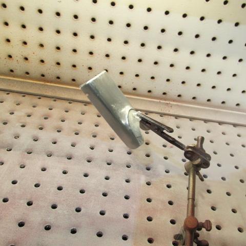

All Body panels now have the self etch primer applied over the 320 grit recommended surface finish for maximum adhesion.  Testing has shown 5 to seven days curing time gives me the best final result.   The next step is the final white base color next weekend.  The the red panels will then be applied.
